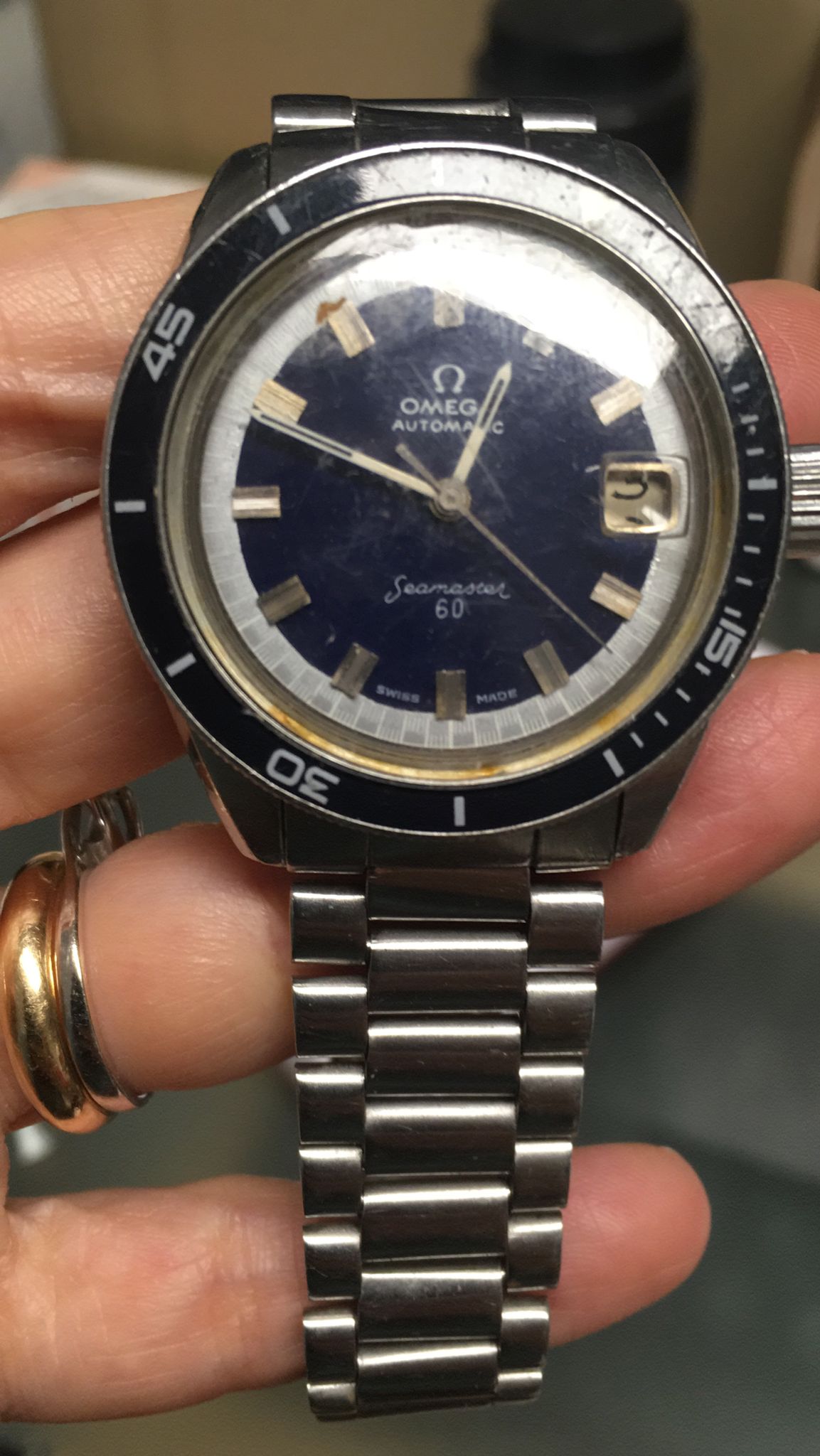

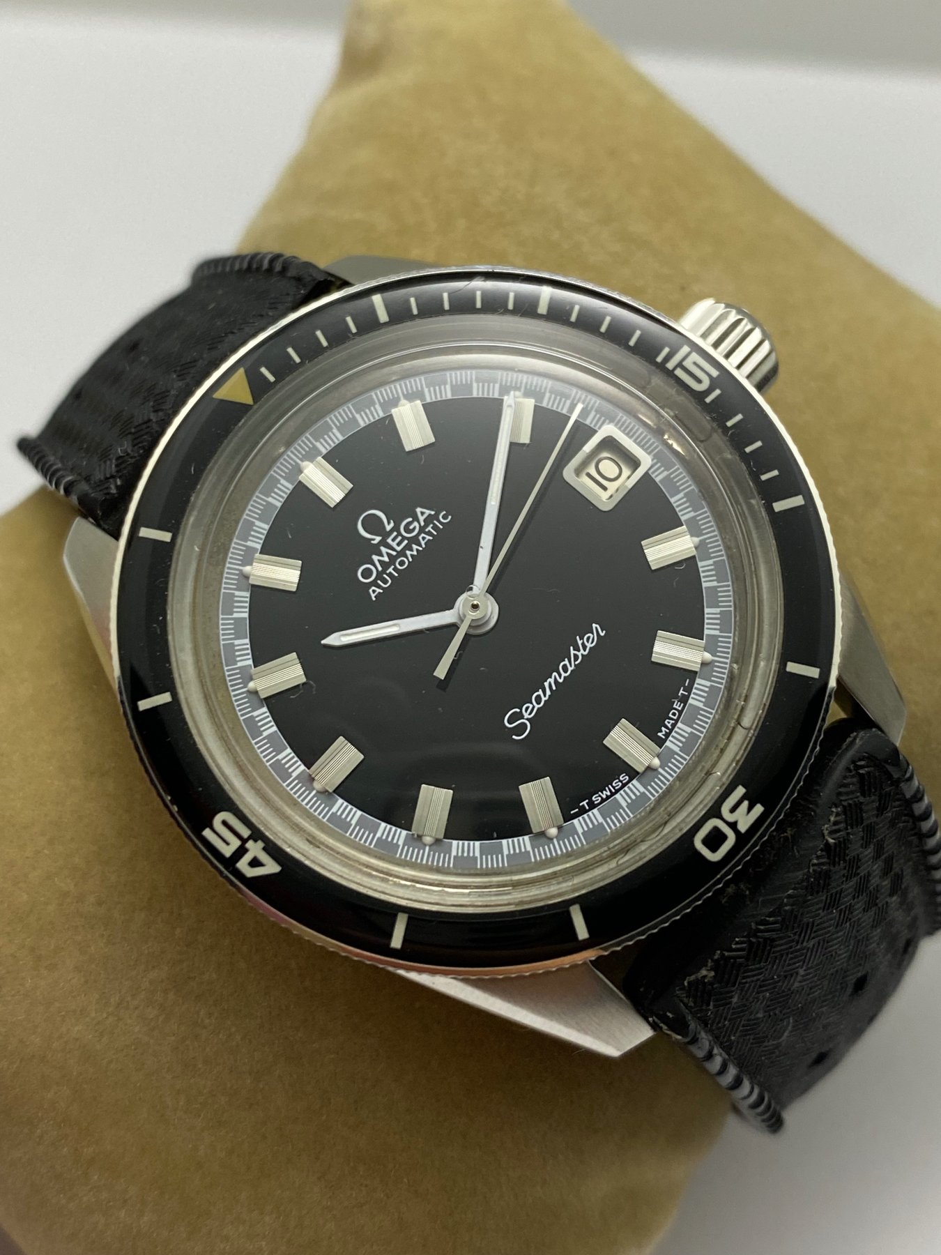

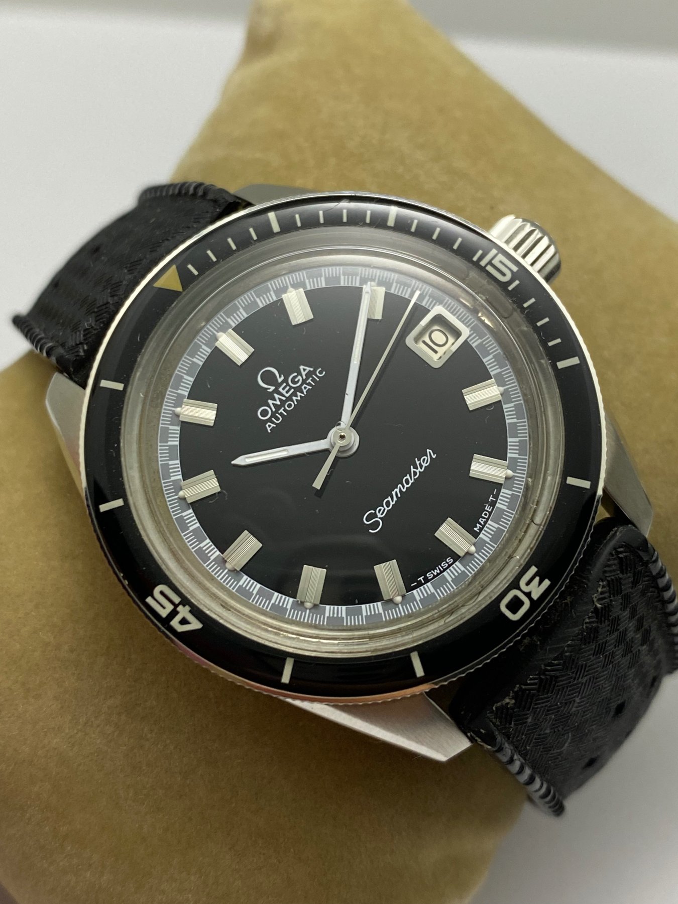

Hi Guys, Need some help here..
I have a Seamaster "Big Crown" that was owned by my Dad who bought it in 60's...
The watch is working but is not in good shape as it stayed in a drawer for 20 years maybe.. so, some oxydation, a lot of scratches on the crystal.. but I brought it to a watchmaker to do a service.. and that will be easy...
Now.. I had some research about the model and I found a lot of stuff and a lof of pictures...
On the Internet many BigCrown don't report the "60" under Seamaster in the lower part of the dial, mine has it... and that's fine.. there are many that have and many that don't have that..
than From my research the bezel color shall be matching the dial color so in this case it shall be blue while mine seems black.. but as I said at the moment is doing a service so I cannot verify that. Anyway I knwo that bezel was very delicate in this model and I think that maybe has been replaced during years and I looked for one and I found a brand new for 800€ so I can live with the black one (even if this detail hurts my nervous system)..
Now I come to the strange thing...
The font of the Seamaster writing..

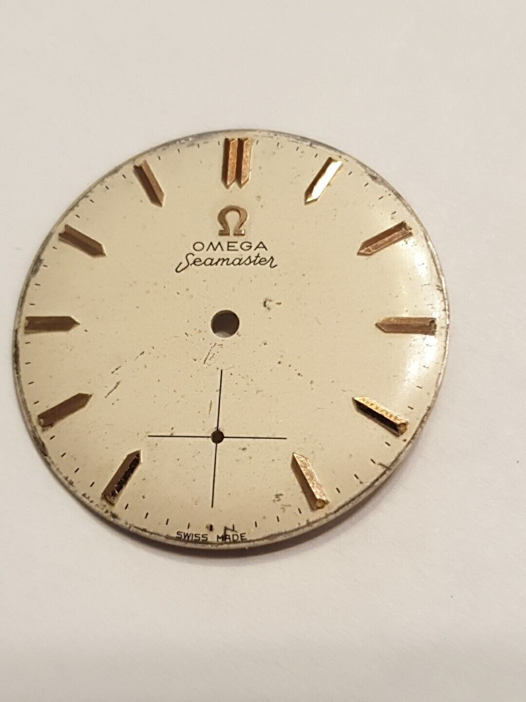

In my Seamaster the font it is similar to 50s/60s seamasters like the white one in the picture..

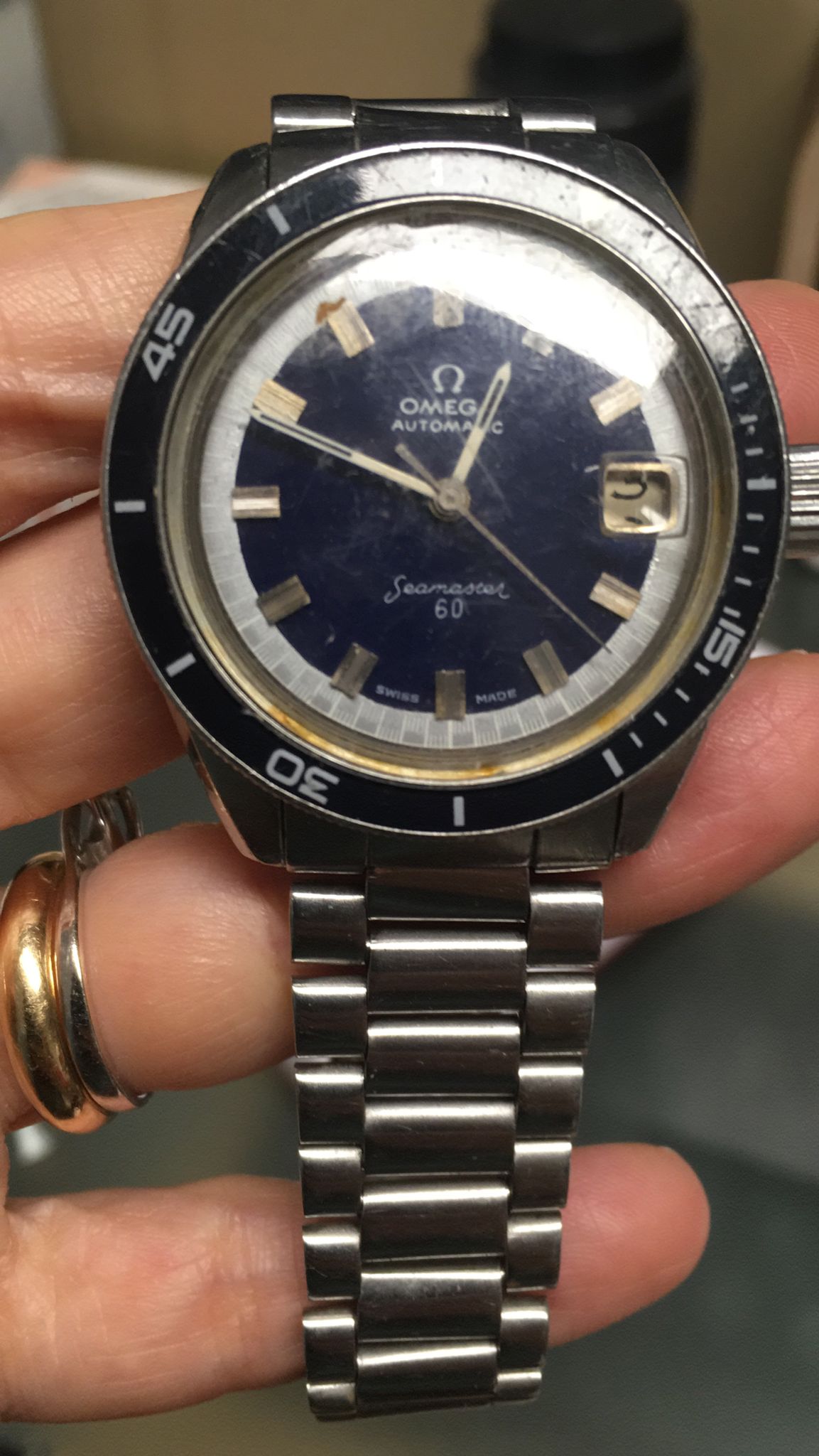

in the end I add a picture from a seamaster 60 found online..
My Dad was used to order things before they came out, so is it possible that my dial is a early version and maybe still have the old font?
Could you guys help me in understanding?

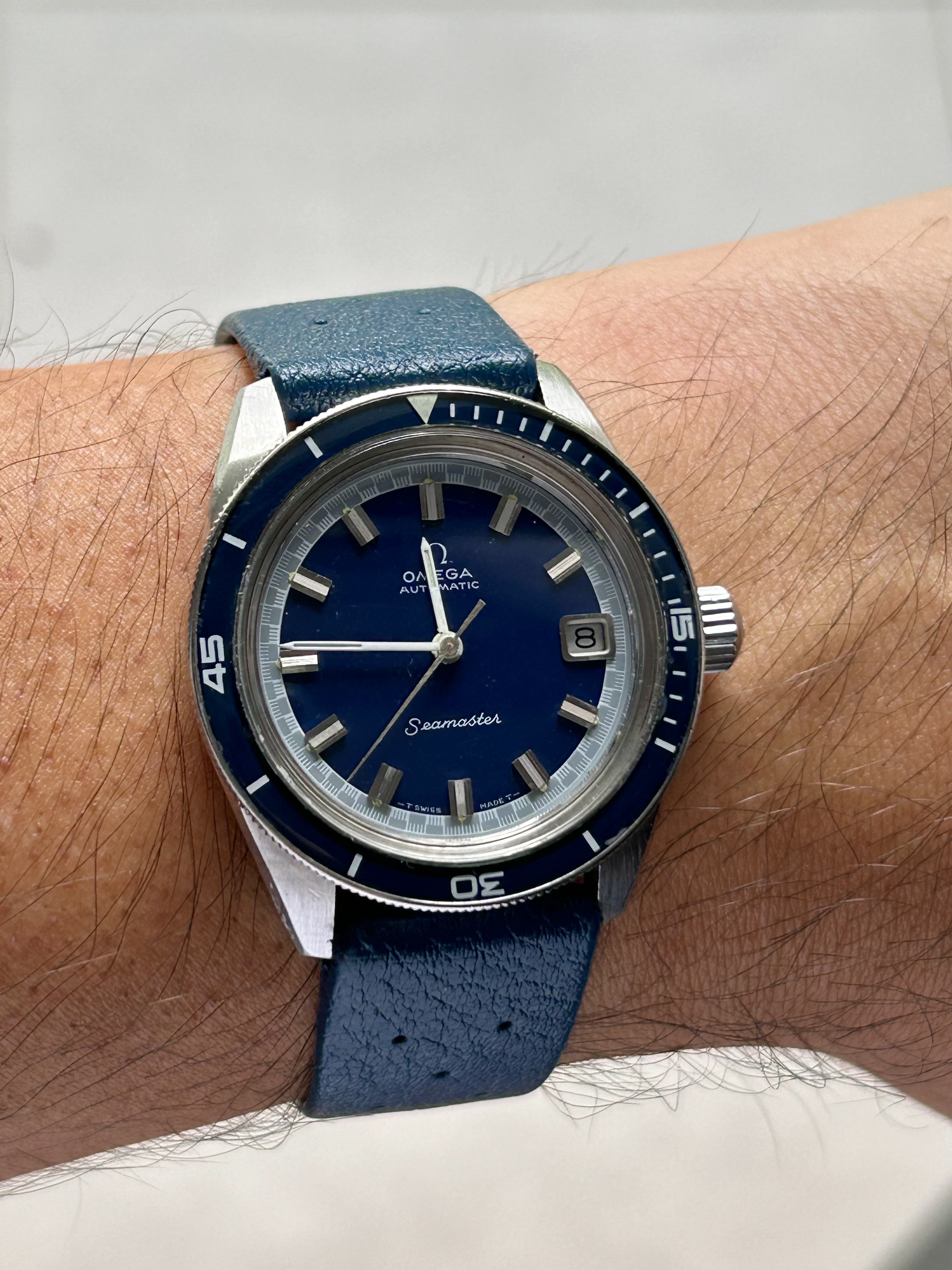

At least it should say T- Swiss Made -T indicating the Tritium lume on the dial, the 60 looks a bit odd too.

Although the pic is hard to see, the lack of lume on the hands and no visible pips on the dial, and the funky “Seamaster” font tells me this was redialed (repainted) long ago. It was fairly SOP if someone brought a water damaged watch in for service- so your dad may have thought nothing of it. He got his watch back and the damaged dial was “repaired”.

Agree. It looks like it was redialed at some point and the redialer likely used the only font they had available.

Yes, as far as I remember It had a seawater incident and got serviced in 80s, then I don't know..
The only conclusion is that it has been replaced when serviced because I verified better with the tremendous pictures they took in the shop and the dial has no Ts near swiss made.. and no tritium on the dial ( I asked to the shop to verify with UV light)..
Then with more attention I've seen in your pictures guys that the external light grey "chesslike" graphics is simmetrical respect to the 3,6, 9 and 12 while in mine is just keeping the alternation... To verify that you can see that in your pics under "SS" and "MA" of the "T SWISS | MADE T" writing there is exact the same grapics (the grey part is on the lower part on both), while on mine is opposite ("SS" has the grey on le lower part while is on the upper part below "MA").
Doh. I think I need to find a replacement Dial....

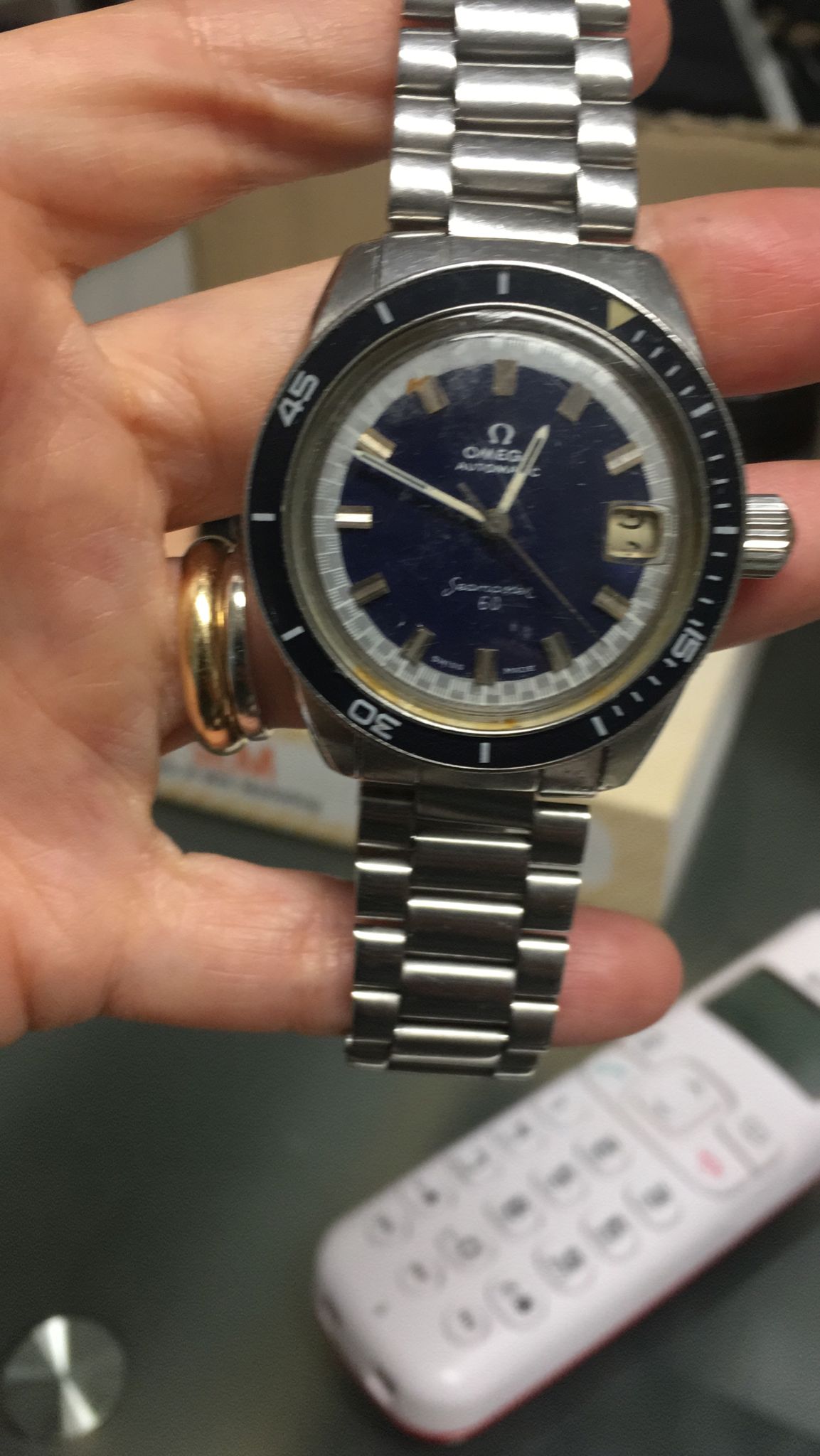

As noted above, in those photos the printing looks very poor, so my gut feeling is that the dial is repainted. I just hate to draw conclusions based on blurry poorly-lit photos with the hands blocking some text.

Yeah, my Apologies about that.. I will do more detailed photos.. but all the info you're giving to me will not drastically condition my decision.. I mean I don't have to buy it as I already own this watch.. and there is no further detail that will make this dial original so, even if I promise I will take more photos, I can only appreciate the help you guys are giving to me.
Talking about the dial: online I found more than a few watches reporting "dial: aftermarket" for example the following sold yesterday on catawiki (https://www.catawiki.com/en/l/87343883-omega-seamaster-166-062-men-1960-1969).
This looks very well made. Do you guys know where to find an aftermarket dial with this level of quality? I mean until I can find an original one I can replace the one that is actually installed that has oxydation startings and I really don't like it. Do you have any resource I can check?

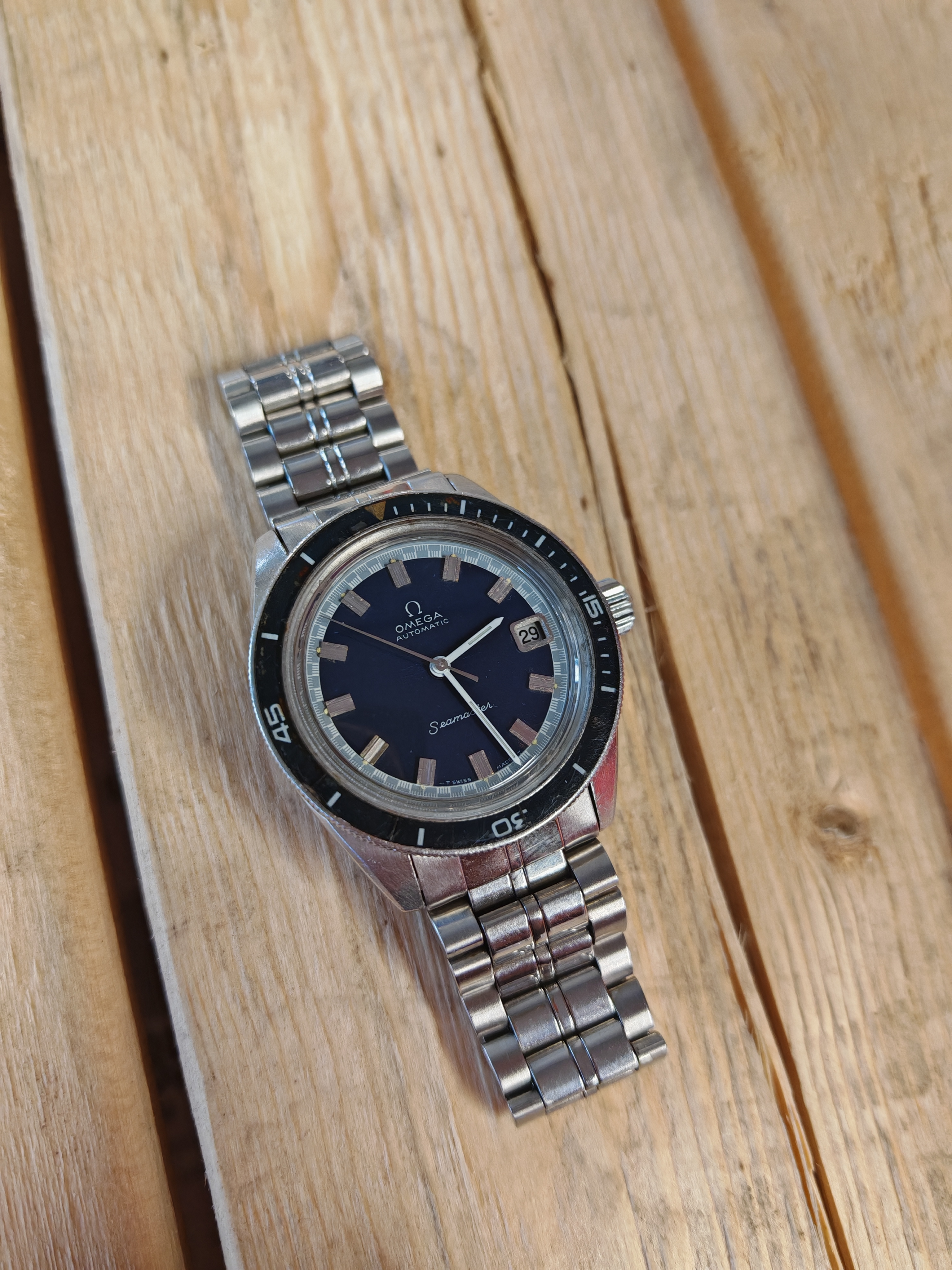

Cool watch, i have the same. I replaced the dial with a NOS one, found on eBay. The same dial, the old damaged one also missed the '60' on the dial. As you already found out, thats common. Some do have 60, some dont. I bought the dial for 450 euro. My watchmaker also replaced the gasket, plexy, rotorlager and rotoraxle. All of that was available from Omega. My bezel is also really worn. But i like that.
