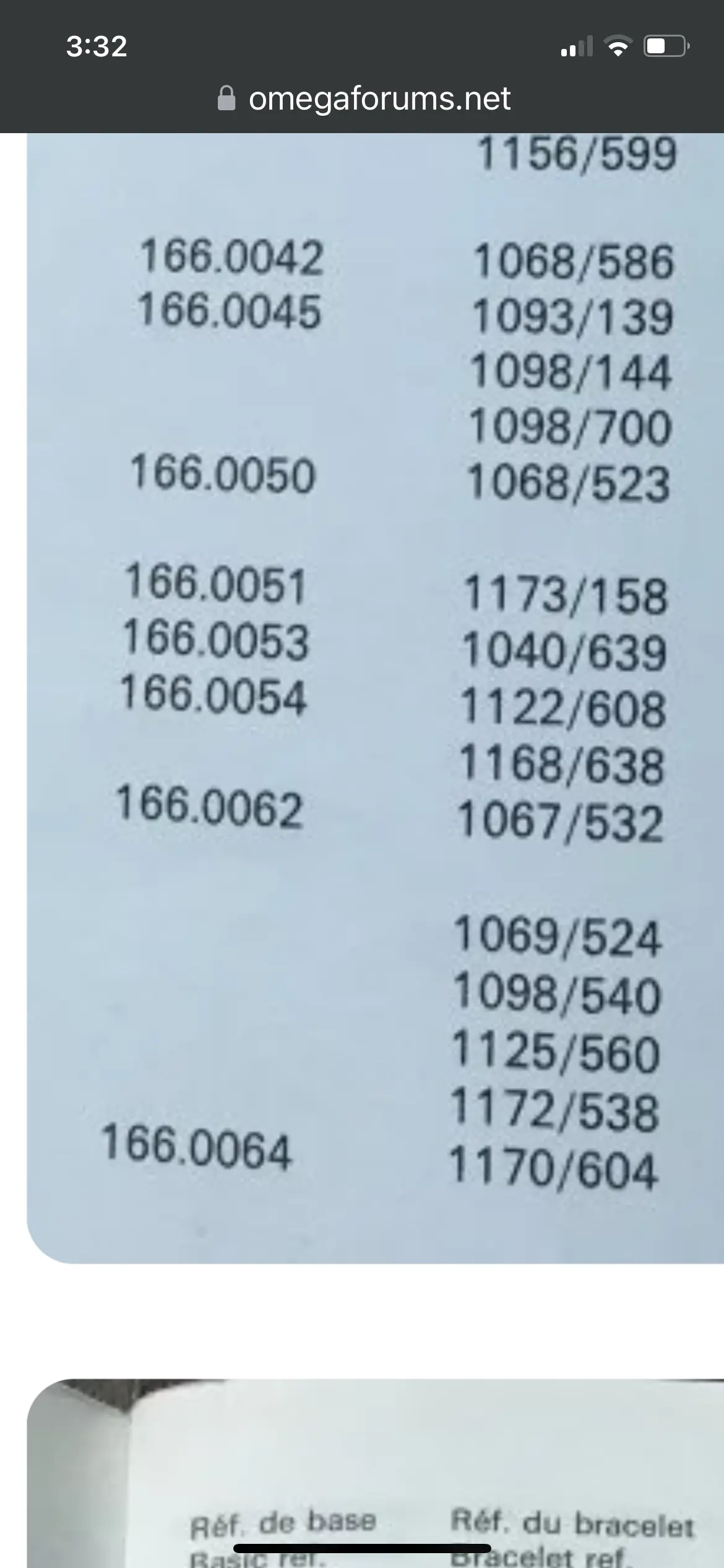

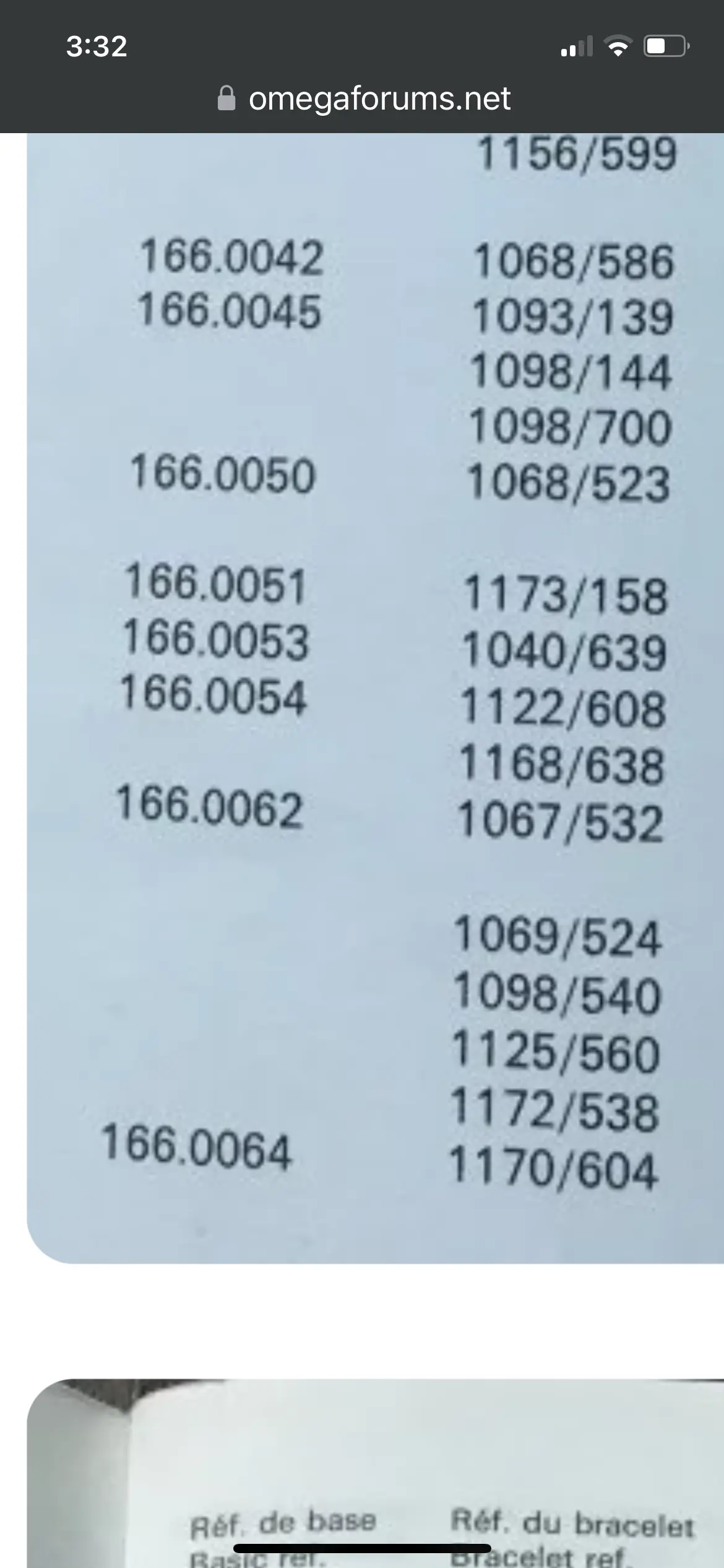

Does this list available here on OF ?
One of our veteran members posted it years ago, it’s incredibly helpful.
Note the case reference numbers are listed with an additional 0 as that is the current replacement part number for that case- but aside of any revisions omega may have made over time (they do tweak them occasionally) it should still be the same fit.

much appreciated !
very useful thread along side with the ref-crown-glass-seal that i find myself looking at every week or so .
going straight to my bookmarks 😁😁

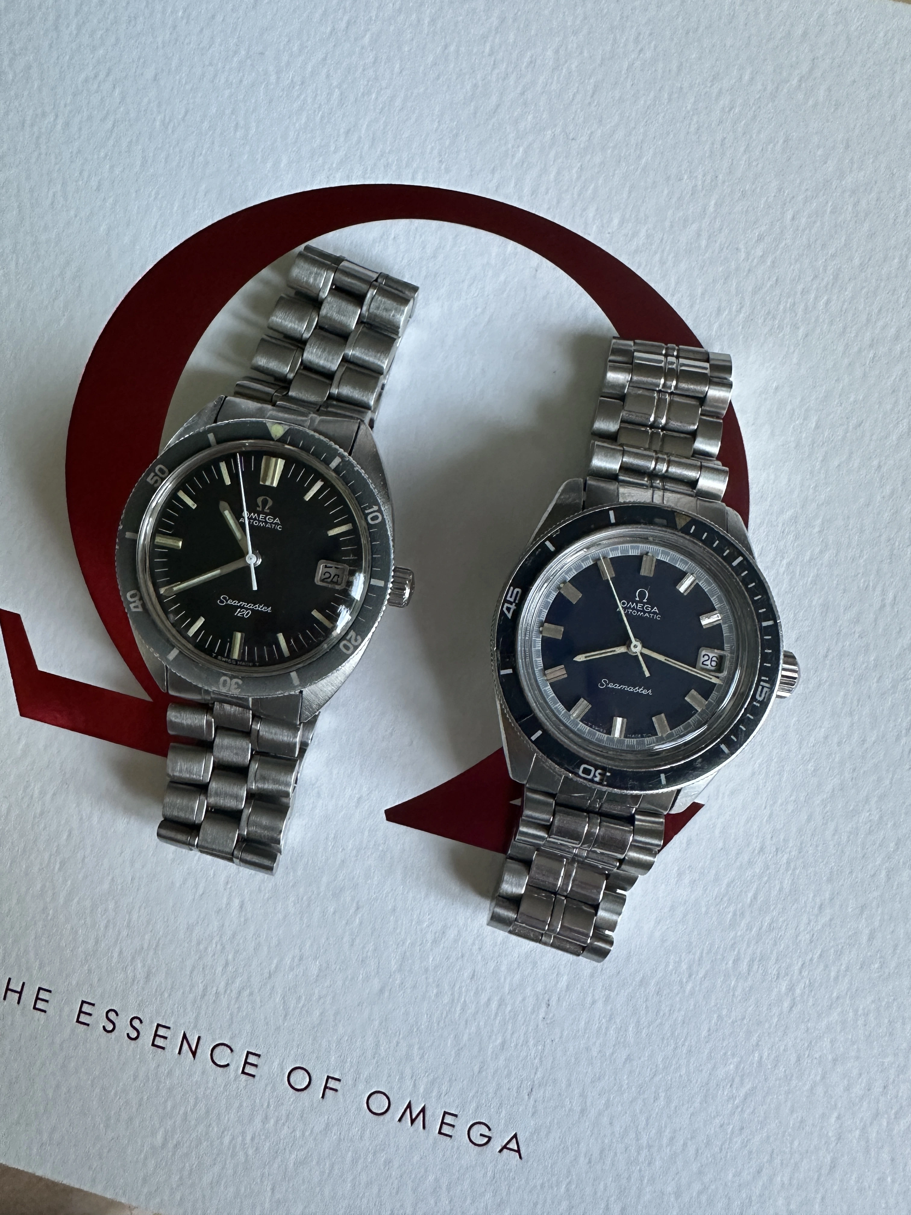

I have a Seamaster 60 and a Seamaster 120.
The Seamaster 60 was intended for snorkeling, not serious diving. So 60 stands for a water resistance to 60 meters, where the 120 (you never guessed it) could go to 120 meters and the 300 could go to (yes unbelievably) 300 meters of water resistance.
Looking at the large crown, you would think it would be just the other way around, that this Seamaster 60 could do a lot more. Oh, by the way, there are models with the word 'Seamaster' under the dial still marked '60' as the Seamaster 120 also has. Both dials are officially from Omega, it is not exactly clear why that was changed at some point. The dials came in three colors, 'Burgundy Red', 'Dark Blue' and simply 'Black'. The bezel is supposed to color to match the dial color, so the red one has a reddish bezel and the blue one a bluish one. That bezel in turn is made of Bakelite, an enormously fragile material (witness also the many broken bezels with cracks).
The dials are no longer available from Omega, which makes them precious and rare.
Here is a picture of my Seamaster 120 fitted the 1098/540 bracelet. The Seamaster 60 is on the 1069/524 bracelet. The bracelet are exchangeable,
