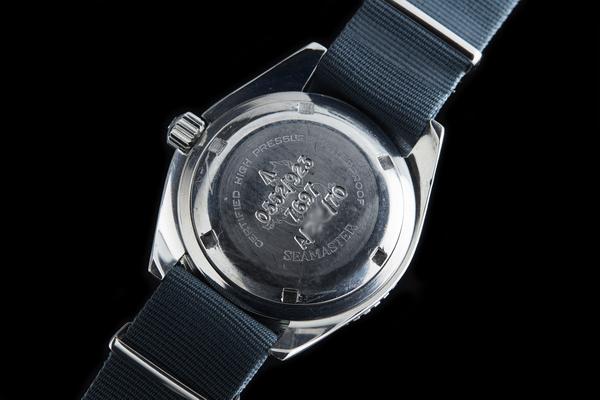

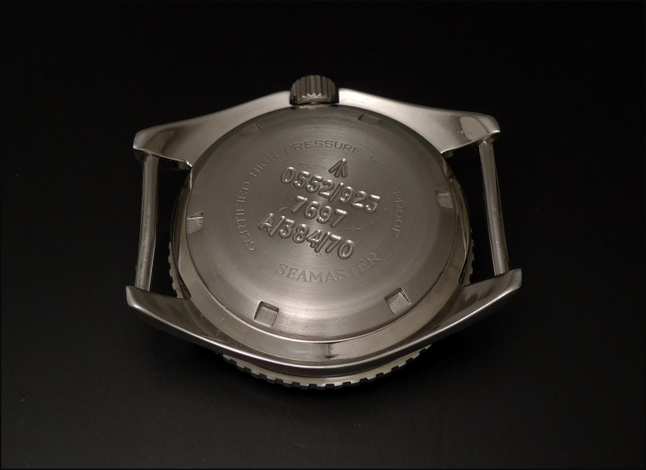

Comparing the back of your watch to other RN issued Seamaster 300s, it appears pretty clear that the case has been milled down at some point.
Even if the watch was not issued (and didn't get the deeply engraved issue numbers), the factory engravings are long gone, along with any of the factory finishes.
Equally, if it had been worn on a NATO strap for any period of time, you would expect wear marks (I've yet to see an issued SM300 or CWC without them)... which are gone.
TL : DR - for whatever reason, as some point the base back has been milled/polished. If you want to know for sure whether it's a legit Royal Navy Seamaster 300, you're going to need an extract of the archives. Bear in mind, that even if the extract states that this watch was sold to the MOD/Royal Navy, the lack of marking will put a lot of military collectors off, and will substantially affect the price they are willing to pay should you ever sell.

Maybe milled down but I dont think so as the caseback is to thick for milling down that deep markings. Anyway, who knows...
I was of the opinion that the Seamaster 300 deliverd to the RN Comes plain without factory engravings and are marked by the RN. Am I wrong?
He told me that watch has been polished a bit when he got it in the 80th and also got a new Crystal lateron. That may be the reason why caseback looks that clean.
I will suggest him getting that extract from archieves. Seems to make sense. He will not sell it for the while but also not wearing it. Watch just lying with the bank for the last years - a pitty.
BUT: If Omega archieve says watch is RN provenience, isn't it an advantage as watch is in that good shape as never worn by soldier although there are no markings. Condition is really excellent, sharp case etc. Checked other on WWW but did not find same condition.
Couple of pictures from a quick google search:

No, that is wrong. The watches were sold by Omega with regular casebacks (with the Hyppocampus, Omega Logo, Seamaster engraving). Until mid 1970 the MoD milled down the caseback before engraving the military markings, after that the caseback remained as delivered.
Before mid 1970 the engravings were thin, after that fat (and deeper). The caseback of your friends watch is A LOT thinner than usual "milled down before mid 1970" 0552 or W10. It has been milled down by far more than what the MoD did. So I assume that has been done by the watchmaker who sold it to exterminate the military markings and keeping himself out of trouble.
Yes, you are wrong as I already answered above.
Good idea and good luck with that!
No, definitely not. The missing engraving is a HUGE disadvantage in the military watch market.

I am in agreement the caseback has been sterilised to try and hide it's military origin...it's quite a common practise when watches leave the service, especially if under illegitimate circumstances.
In any case, as mentioned, however the watch arrived to the present day, without the issue marks it's a a bit of a problem for collectability and value.
