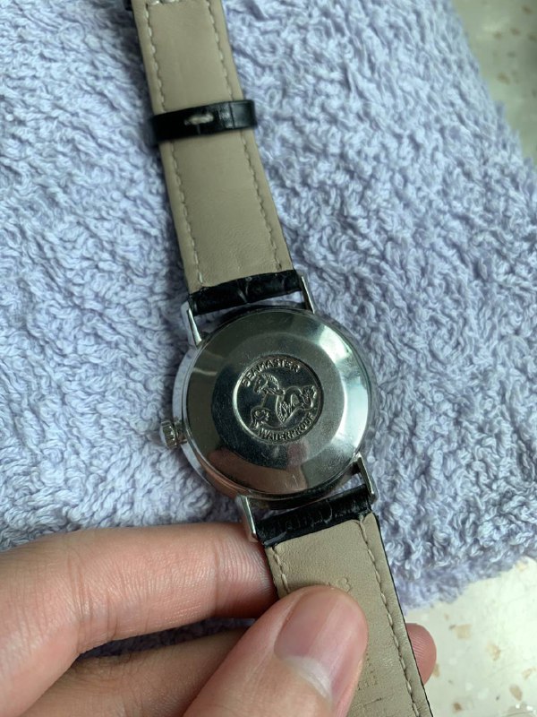

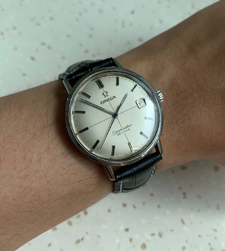

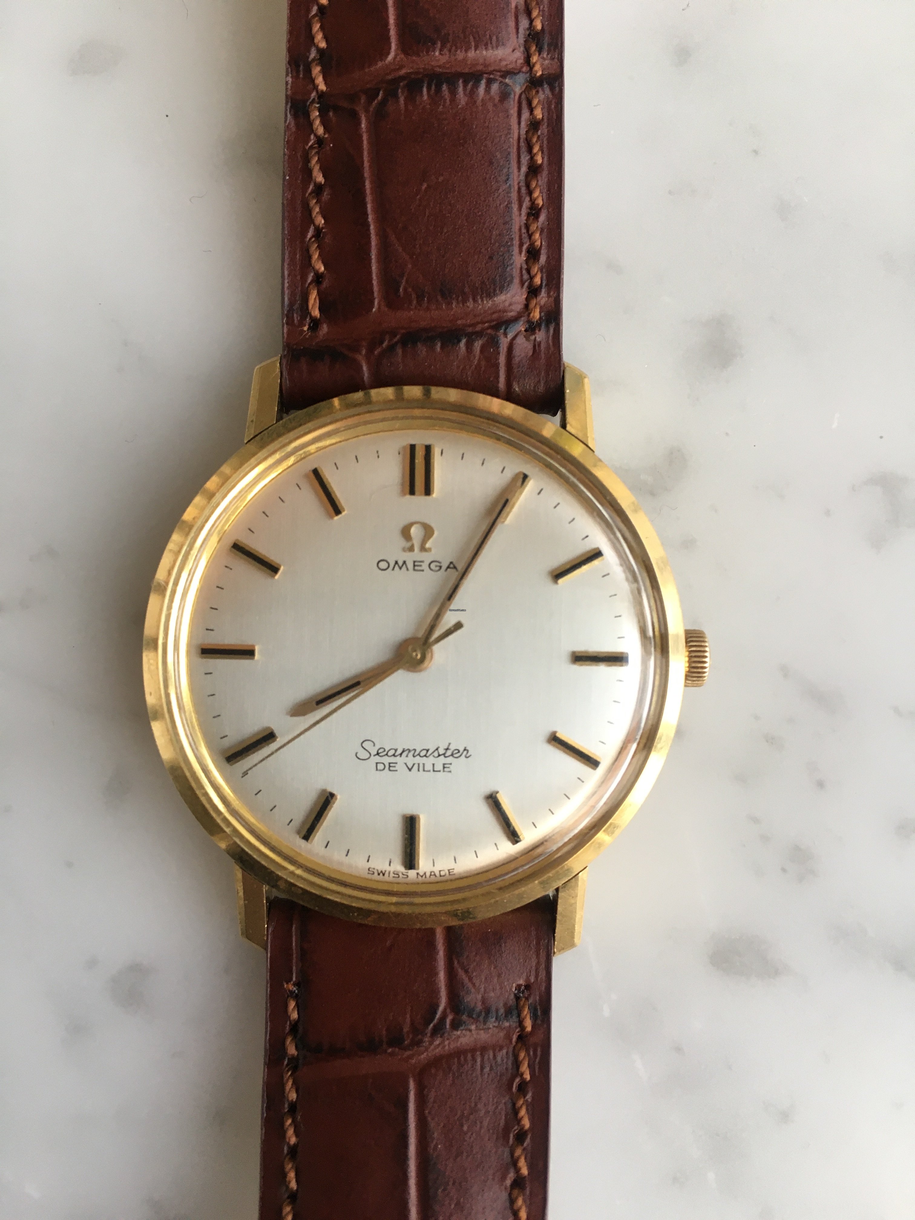

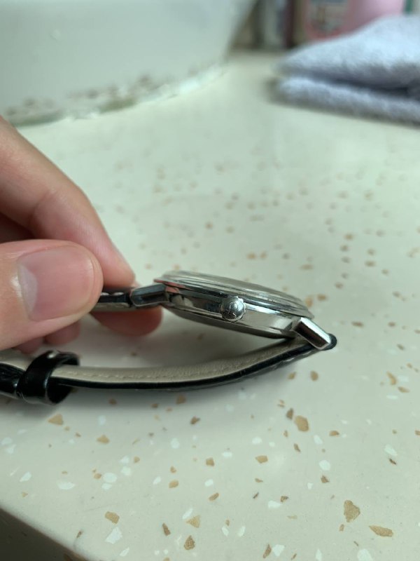

Recently my dad passed me his vintage Seamaster De Ville, but the design deviates slightly from all the models I have researched on so far.This particular piece is about 36mm in diameter excluding the crown.
My main concerns are:
1: The sector lines I have seen usually puncture the logo and Seamaster de ville words, but here it does not
2: The de ville font is slightly different from the usual, looks a bit more crisp
3: The caseback does not have any reference numbers and the Omega logo

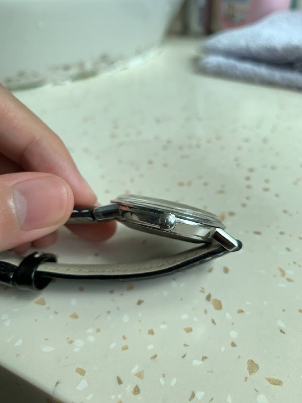

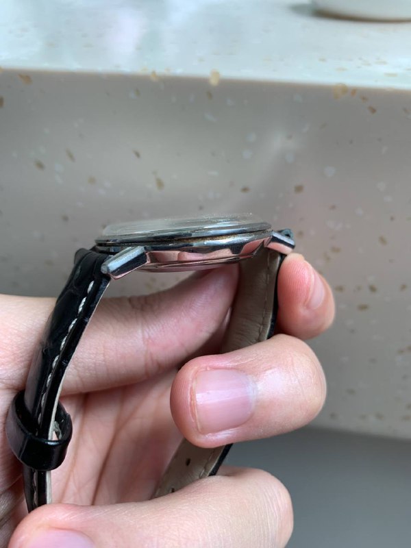

4: It seems to be a monobloc case, I am not skilled enough to open up from the front to identify the movement inside.
Hope that folks here are able to identify if this is a re-dialed model or a replica.

It is a real omega watch. The case is a front loader, and you can see that the crystal is not pushed into place, as evidenced by the gap between the bezel and the case back. . The dial looks like the cross hairs have been applied later as they jump over the text and logo, and with some luck the rest of the dial could be original although there is something odd with the T SWISS MADE T dial and no lume on the indices and hands. I personally like the case variant you have with seamaster and waterproof inside the case back medallion for no other reason than I think it looks good.
I have sent watches to Omega that were really shot, and they do a great job of breathing new life into them, and they are skillful. Its more of a restoration than a conservation job. If you want to preserve what you have , then sending it to an independent shop is the better option. You need to know what you are doing and why you are doing it.
1,610
2,722

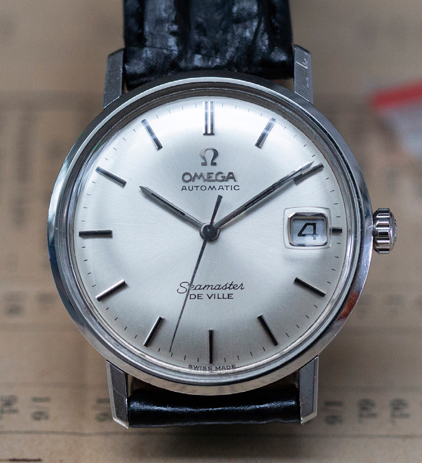

The dial has been completely repainted. Below the 'OMEGA,' there should be a printed 'AUTOMATIC.'
It's up to you whether you want to keep it as is, to preserve sentimental value or look for an original dial to use for regular wear. Omega would probably replace the dial with a service component, which won't be identical to a vintage dial, but may look better than the repainted piece.
I agree it’s a redial but there are manual versions of these which obviously don’t have Automatic on the dial, so that isn’t a tell
1,610
2,722
Manual versions have 'OMEGA' printed on the dial, not applied.

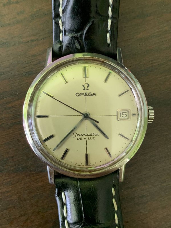

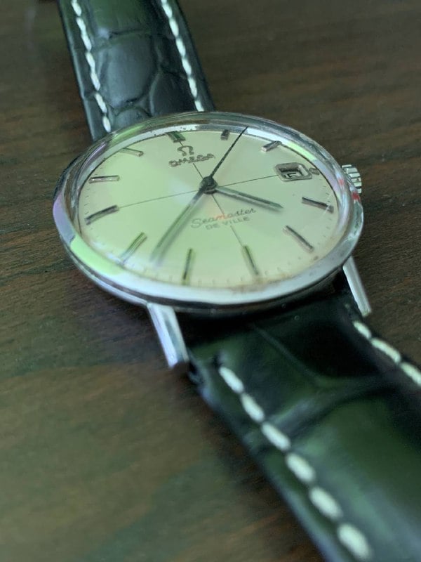

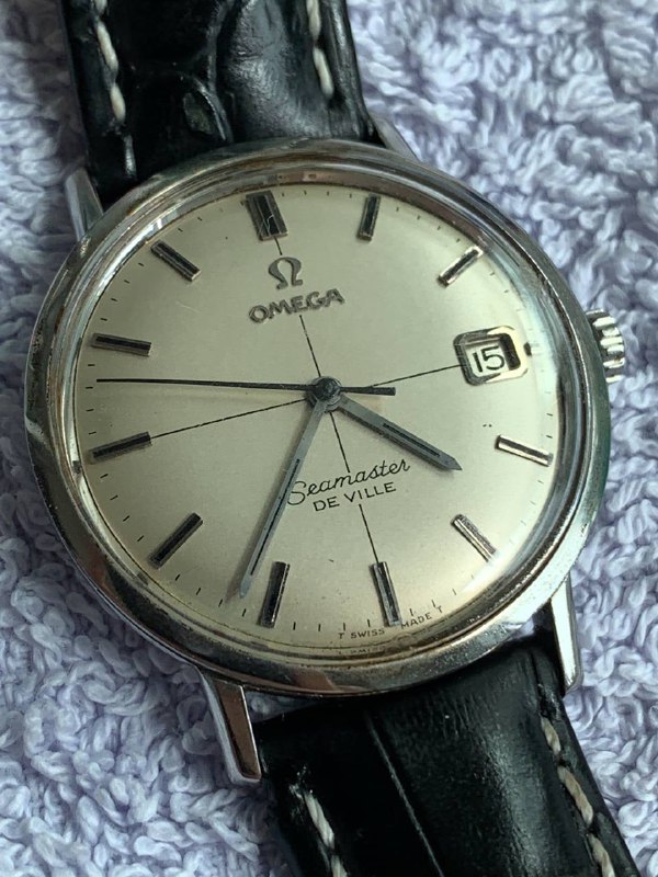

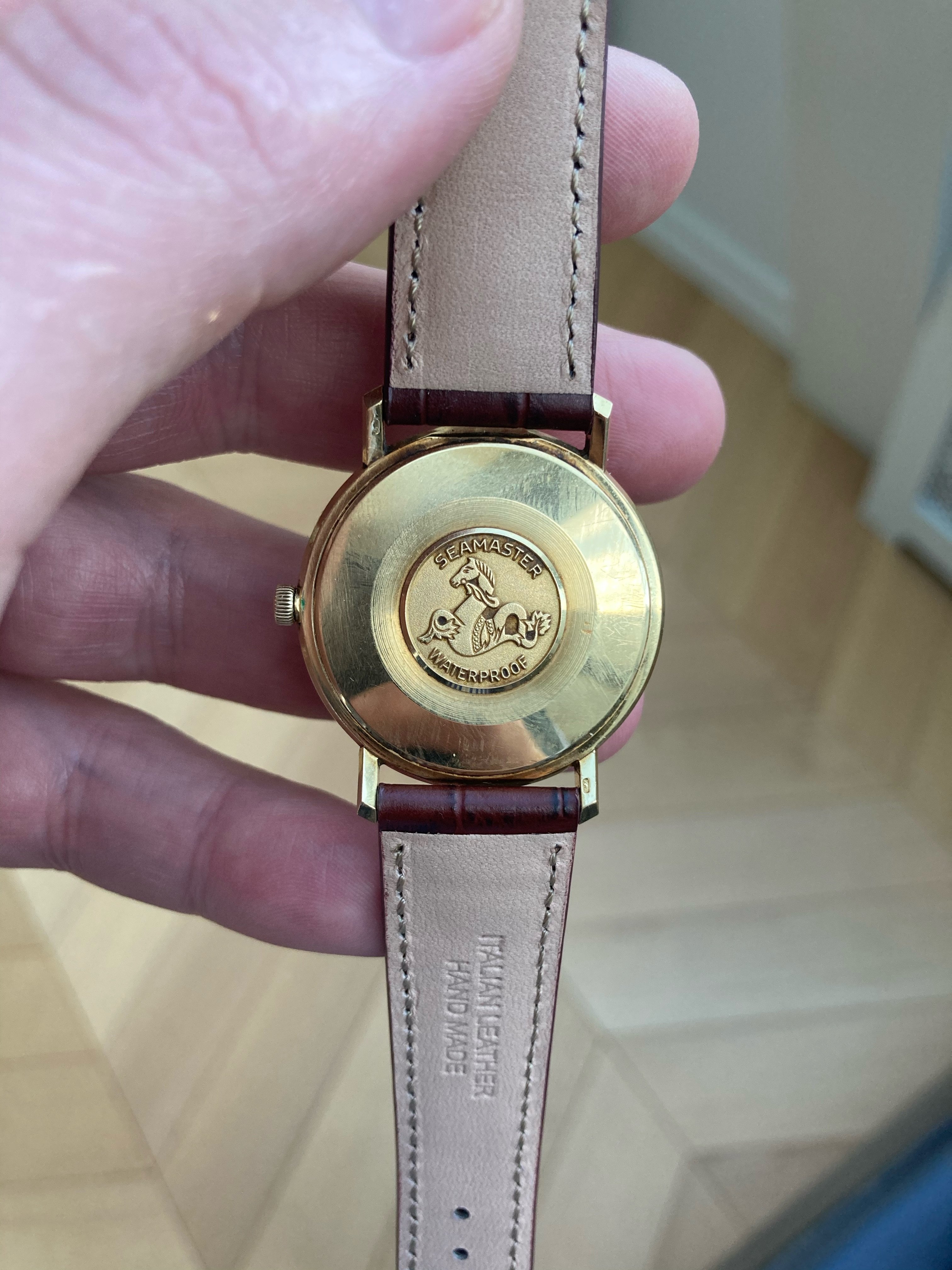

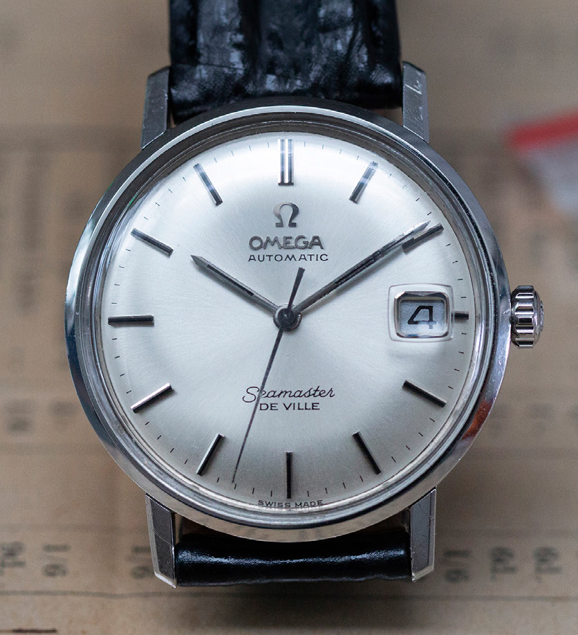

That’s right. I attach a picture of my SM De Ville where you can see it clearly.
491
404

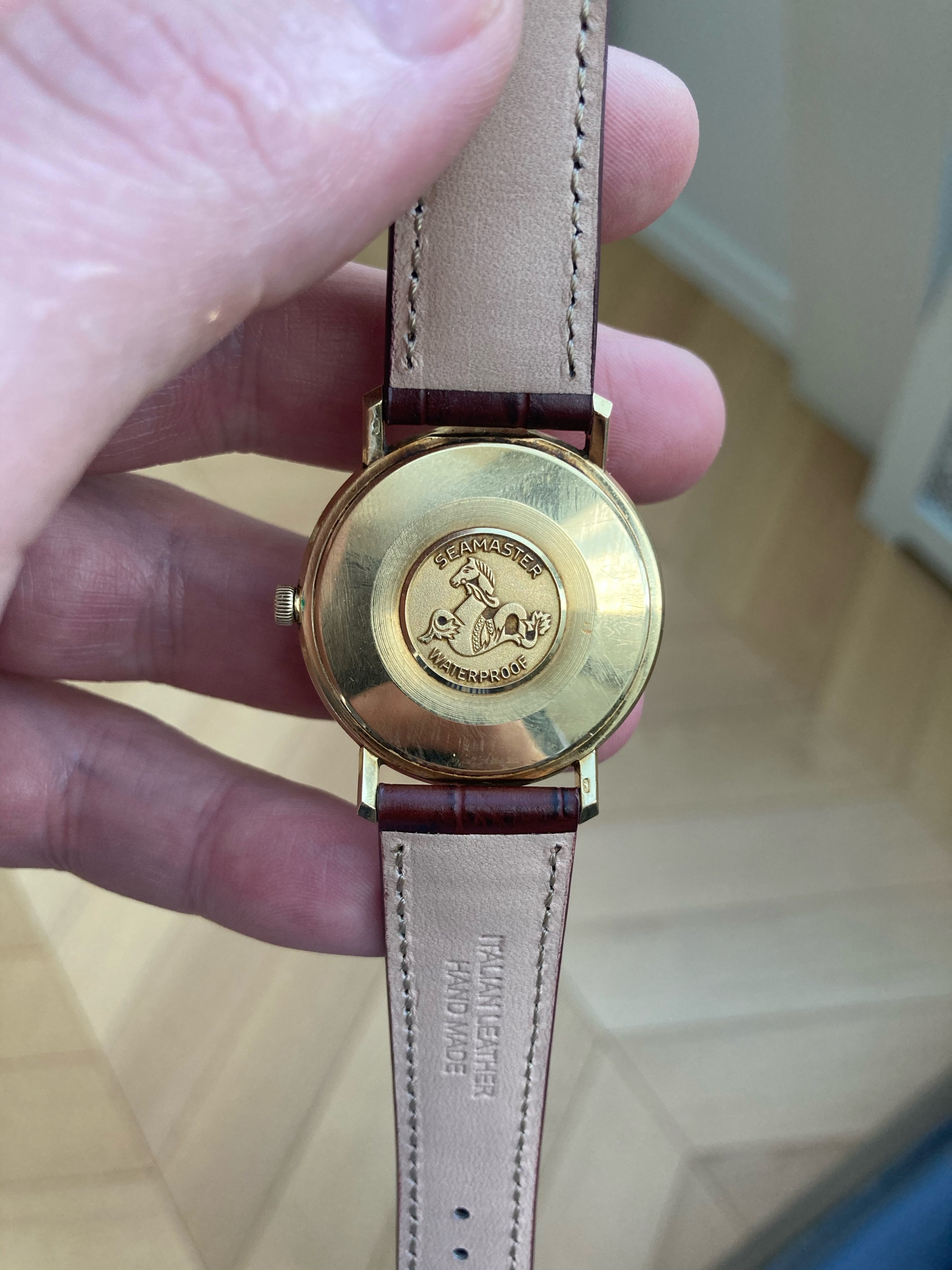

Truva your deville has some beautifully sharp lugs and that medallion on the case back is just lovely.

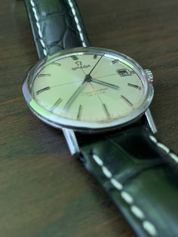

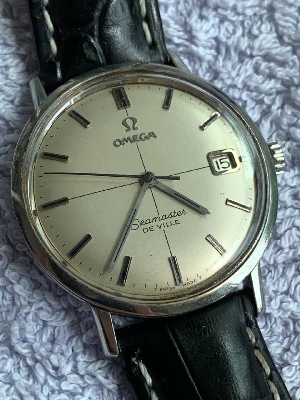

Here is mine just for comparison. It has the same caseback as the OP and Truva's (I don't have a photo).
141
58
Fantastic watch you have nkhandekar. I have been looking for a SS for daily use. Not so easy to find one as yours.
