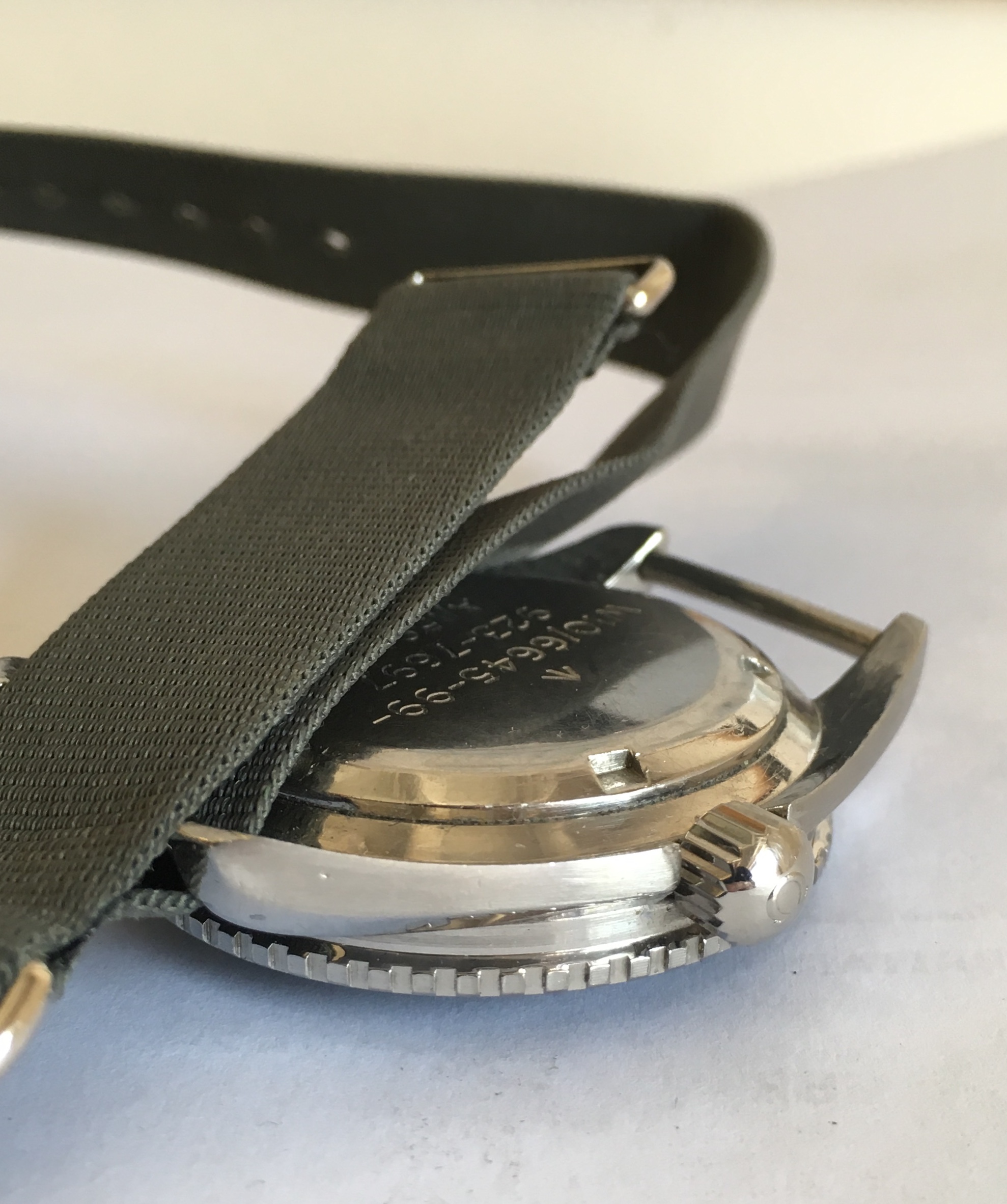

I understand that the original Omega engravings have been milled down. But I cannot believe that the fat, deep Military marking have been milled down. In my opining the caseback is too fat and would be much thinner if milled down These deep figures.
The thin engraving prior mid 1970 is only about 0,2 mm wide and the fat post mid 1970 only about 0,4 mm. Being honest I have never measured the deepness but it should not be significantly deeper than wide. So milling down 0,5 mm will remove all markings I would say. So the caseback still has plenty of flesh then.

Photo of my watch to try and indicate depth of the engravings.
There is easily enough material to remove them.

Our caseback is a CB. No idea if all casebacks are the same size or slightly different. The one on the pic looks thicker compared to ours.
