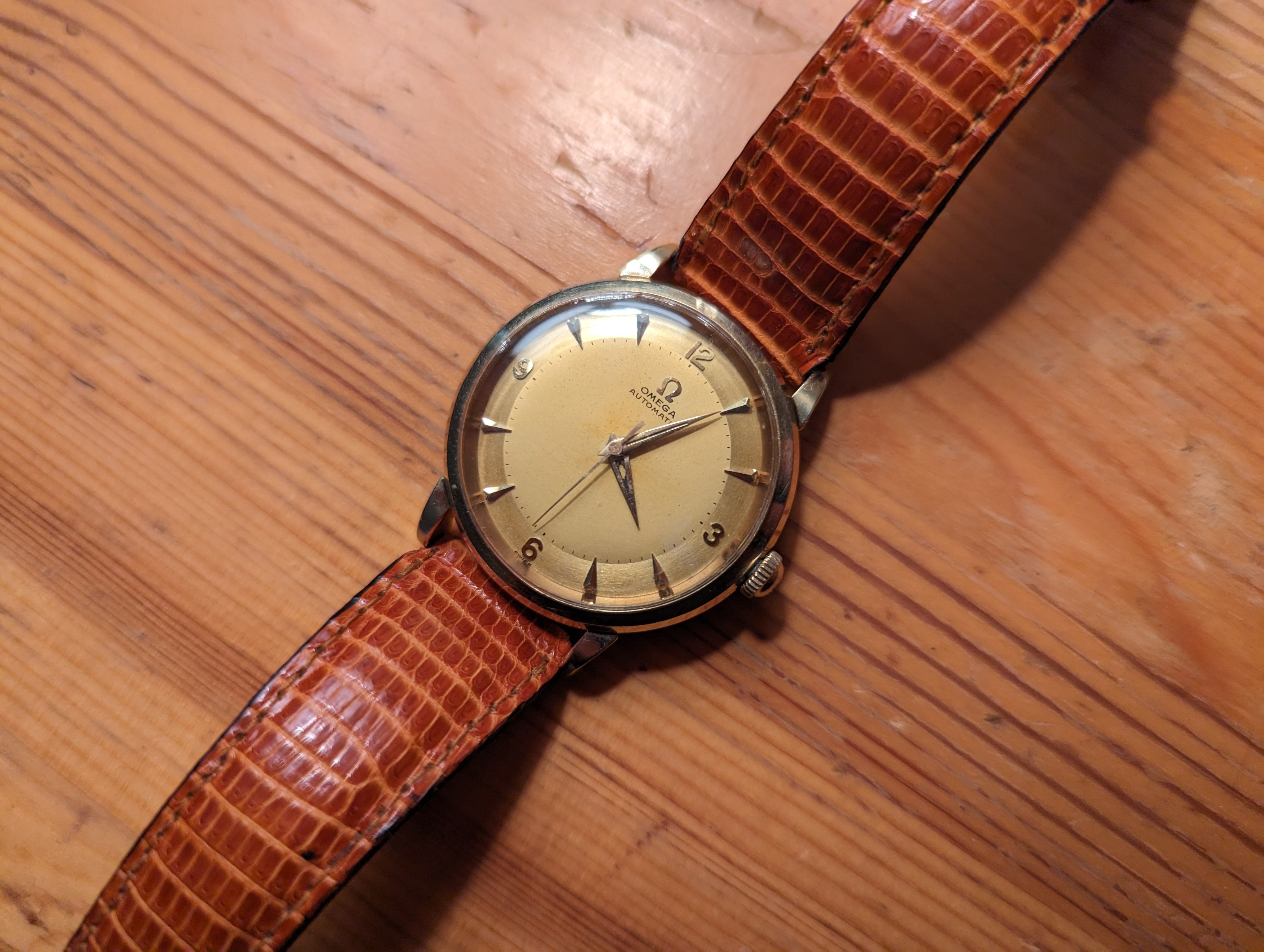

I had somewhat the same issue. Seemed like the seamaster but nothing written. Plus a gold version. It was my grandfathers. Don't know when he purchased but its been sitting in a box since 1971.
Probably was marked Seamaster before the dial was refinished.

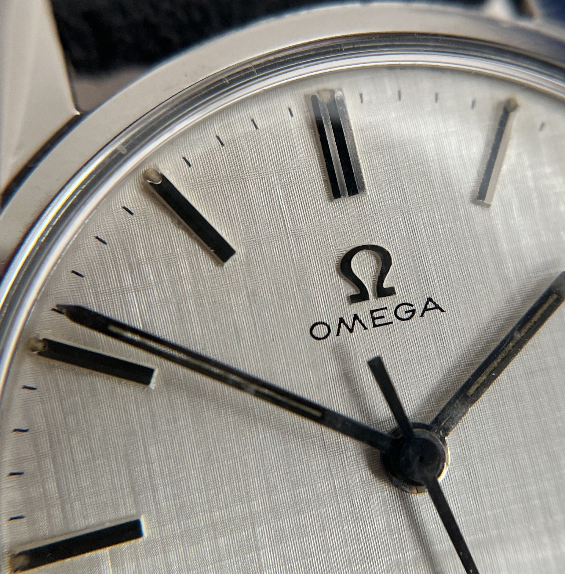

My Seamaster 30 is unsigned. It's possible that the dial has been refinished or replaced, but if so, the quality exceeds my ability to detect it. The watch was a Norman Morris import, which might also be a reason the text is lacking.

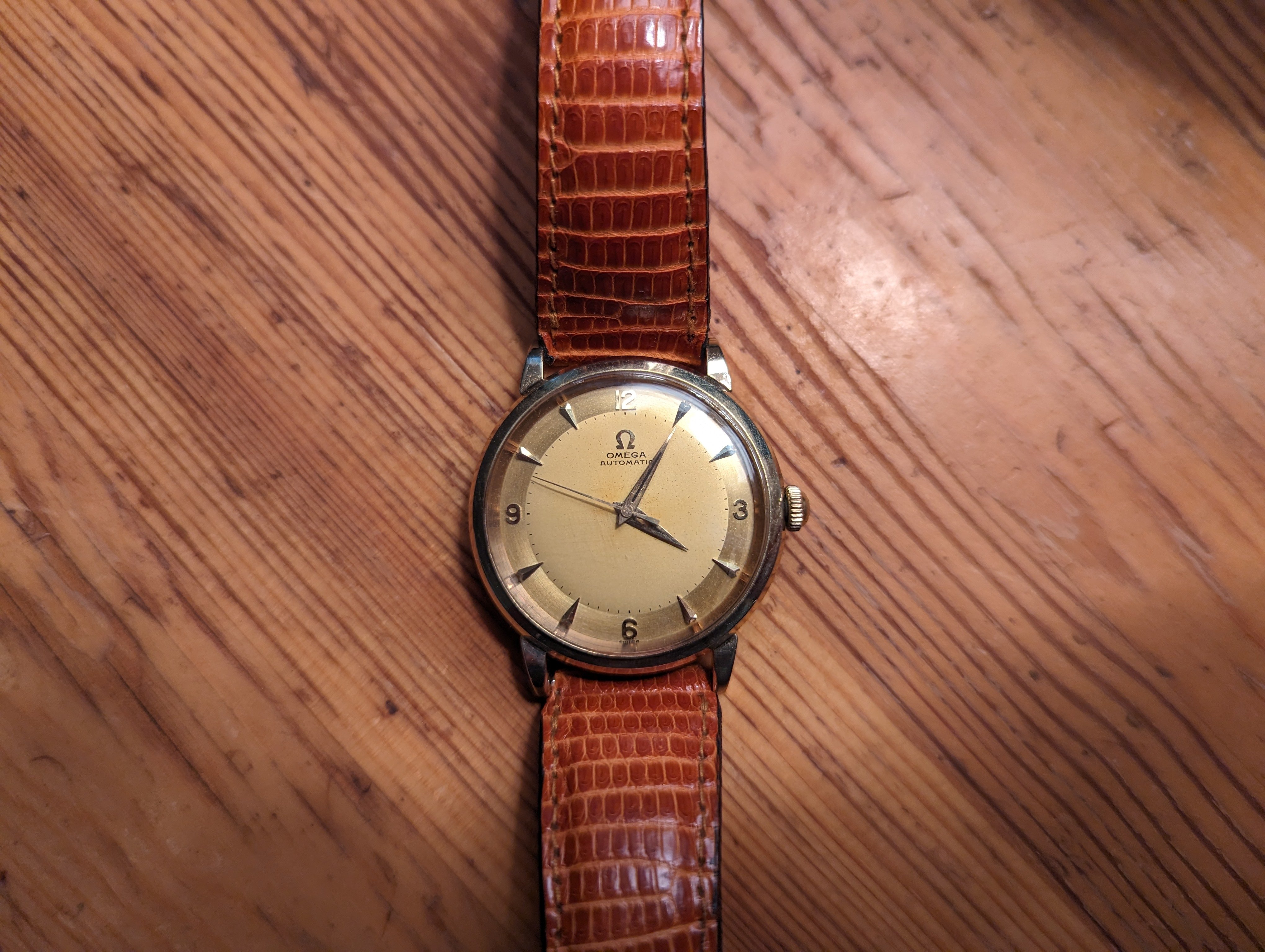

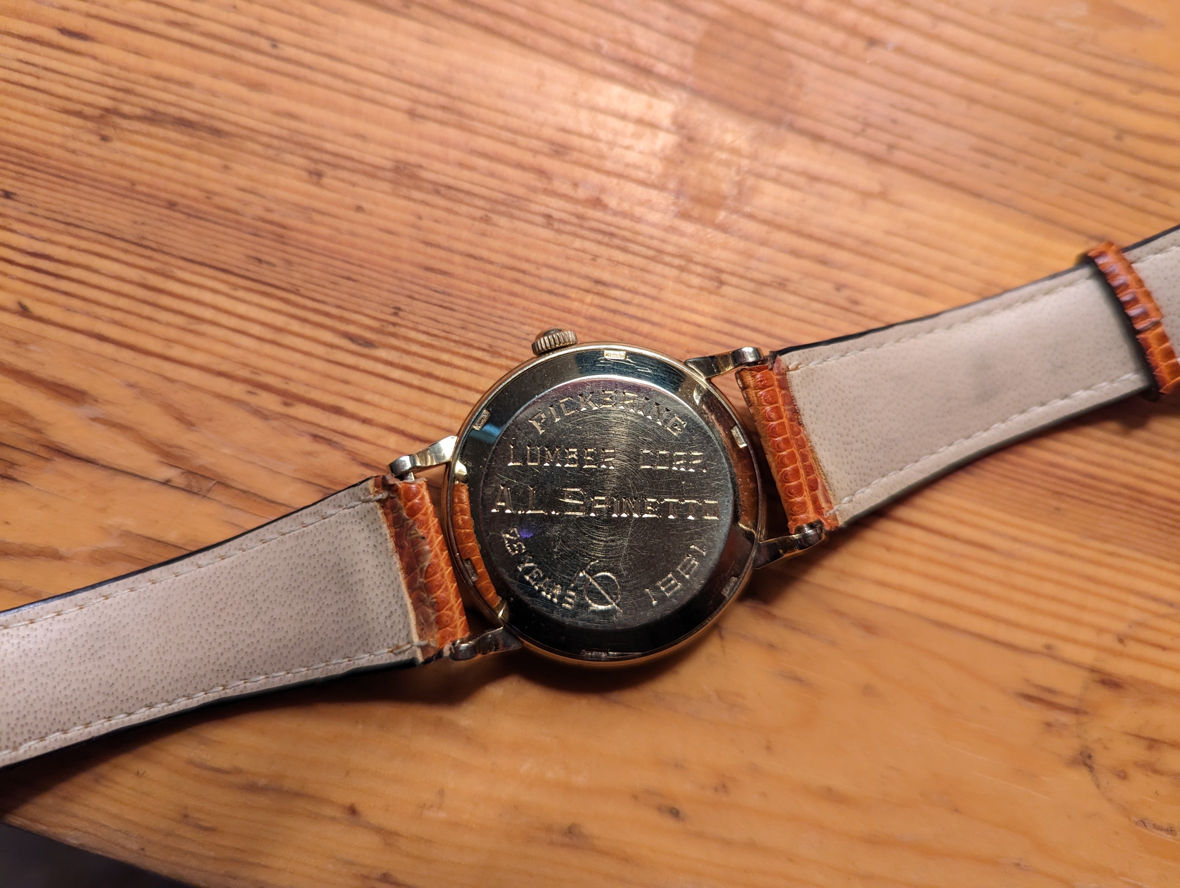

I think I have the same watch, or perhaps the gold filled version vs. your solid gold one. I was researching why this one I bought at a watch shop in Mexico City didn't have the Seamaster logo on it. The owner of the shop, a watchmaker and a gentleman, showed me a variety of vintage Omegas and was very transparent about which ones were redialed or had replacement parts. I bought the one that was supposedly 100% original and not refinished. The dial on mine looks shockingly pristine for its age, but there is some slight oxidation to it. And the printing on the dial looks extremely sharp and factory-made, which makes me think it's less likely to be refinished.
It's also been lightly polished, but the edges are all so sharp that I suspect this spent most of its life in a box and not on a wrist. It's engraved to someone as a retirement gift from the Pickering Lumber Company in 1961 and I wouldn't be surprised if it was only worn a few times since then.
So while I'm not 100% certain the dial hasn't been refinished, I am now 100% certain that Omega did indeed release Seamasters, or watches identical to Seamasters, without it being printed on the dial.
Either way, this is the first gold watch I've purchased and I love it to death.

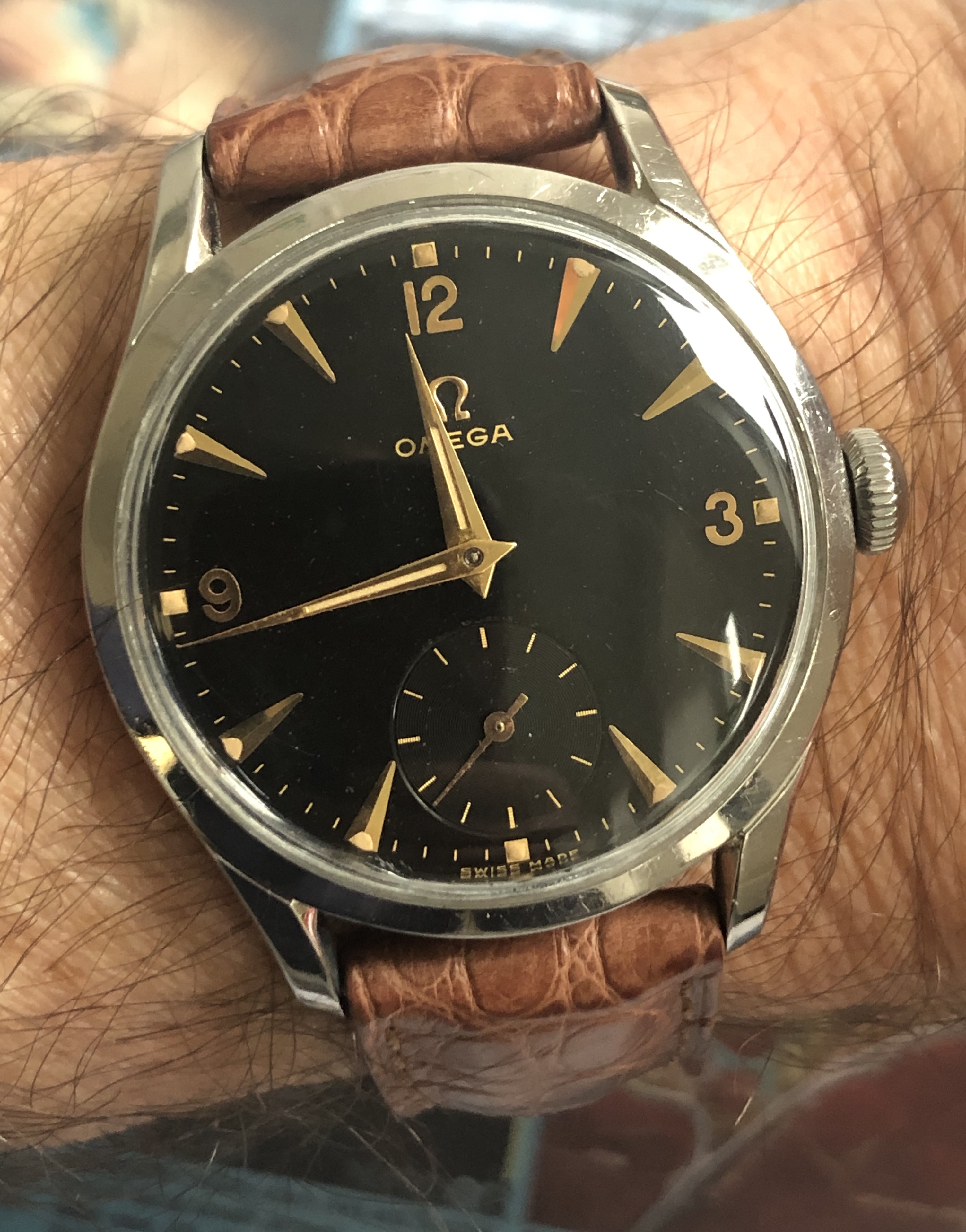

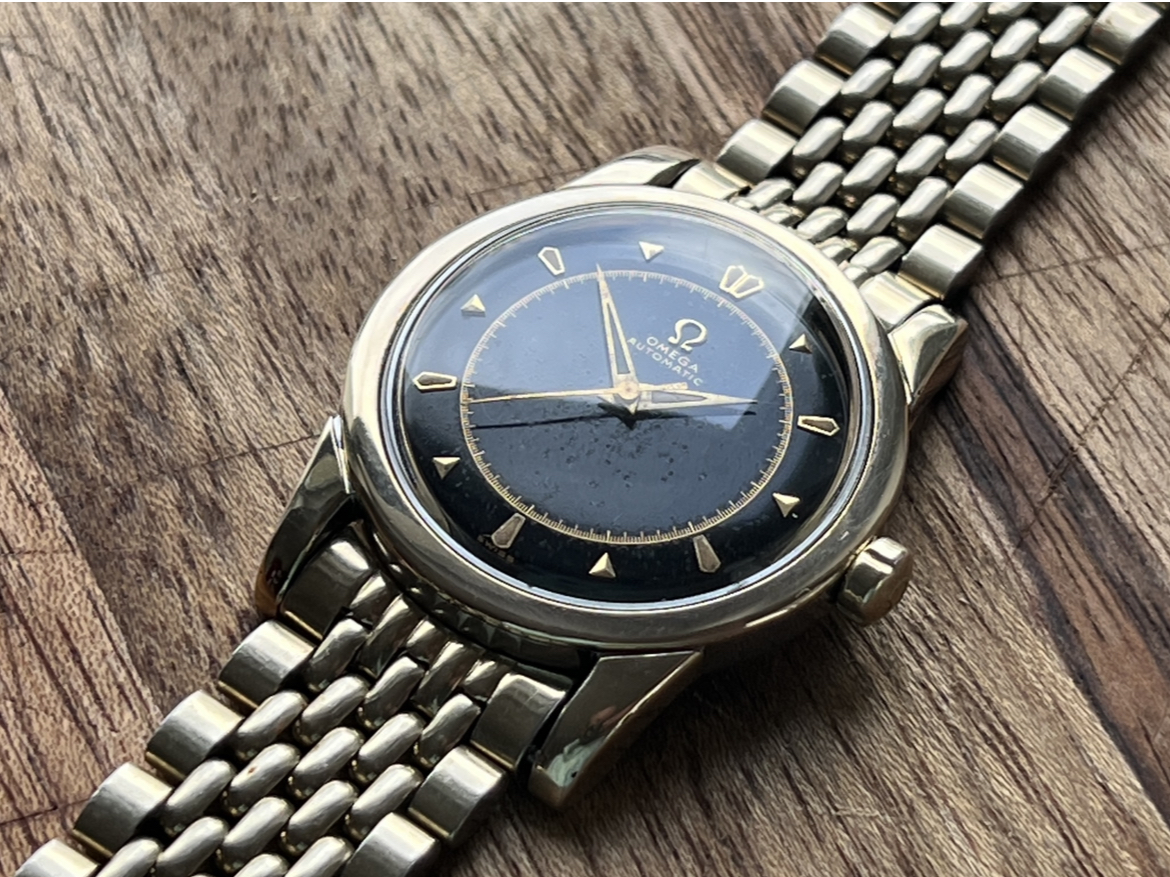

Hello, fellow Omega enthusiasts!
I found this thread because I just bought a Seamaster without the text on the dial (1958, Caliber Ω 470).
I'm new here but feel happy to have discovered the joys of horology. My dad always had a vintage Omega that I admired.
I purchased this one (offered $750 and the offer was accepted!). There are more pics on the eBay listing I provided, and I list the details below from the seller (who is a private collector).
I would appreciate any opinions, or thoughts if this was a good purchase decision. Much appreciated!
I do feel very good about it. I hope I made a good decision, as I'm still very much learning.

“Pre Seamaster” is a debatable term for the waterproof watches Omega made circa 1945-1947. An omega Seamaster made in the late 50s without SM text in the dial is generally a redial, especially if black. Or not a Seamaster at all. That said I don’t know that model. Is it particularly small? The 470 movement is normally seen on ladies watches as at 25mm it’s smaller than normal. It may be that they did sell 31-33mm watches that differed from the norm.
Looking at the listing, does it actually have a Seamaster hippocampus back or is it plain? There is one pic that shows the back and it looks plain. There were examples of the 14473 with plain backs which are not Seamasters, just part of the International Collection. Maybe you have one of those.the dial doesn’t look obviously redone, but the vast majority of vintage black dials have been.
Thank you for your insights and knowledge sharing. I don't have the watch in hand yet (probably in about a week or so). The learning journey is the best part of this new hobby.
It's listed as being 34.5mm which is not too small, although I know the 470 movement is smaller and tends to be on smaller watches. Hoping it all original as listed, and maybe I got a good deal. 😀 I'll look into the International Collection. It makes sense that it could be one of those.

Dial looks ok to me on first glance. What’s definitely not ok is the bracelet, which is a cheap aftermarket repro, not an Omega product. Given that these have a value of 200-250$ when original (and, for an honest person, zero value if counterfeit) I’d personally return it for that reason alone.
Thank you for that information. I did write the seller and ask to cancel the order--before he ships it out (was offered just earlier this evening). The bracelet and the radium are issues for me (my kids like to listen to the watches by placing them against their ears, which makes me a little nervous about gamma rays). Hopefully, he is okay with canceling the order--and relisting it.

Even though I wrote the seller at 5 am to cancel the order, he wrote me back at 11:30 am to inform me it had already shipped so he can't cancel it now. Also, about the radium, the seller said there is no radium. I think this means he must know it's not the original dial as described in the listing. I assume the radium was removed when the dial was redone and re-painted.

Well, you have eBay on your side. You can always return it even after it’s arrived - the counterfeit bracelet alone should make that pretty easy.

Yes, I think so. He is maintaining it's not radium on the basis that it's supposed to be an "original non-radium dial." But contrary to his claims, my research shows that Omega began phasing out radium beginning in 1962; by 1965 only they used tritium (and added "t" to signify the safer material in 65 until the 90's). In the late 50's, though, it was all radium. I wonder how he knows for certain this watch is radium-free? I have a Geiger counter so I'll be able to confirm. If it's a really good redail I don't mind keeping it if the price I paid is reasonable, and use it as a daily wearer. Or maybe I can negotiate a discount. I think if this guy has been a watch collector for 25 years, he should know better, no?
New message from: rsh5 (892)
"Hi Gio - was supposed to be original non-radium dial. Omega transitioned dress watches to tritium about that time. If refinished, was done long ago. I bought in Glasgow, Scotland about 2005-6. Serviced regularly so doing well and should be to you early next week. - Bob"
