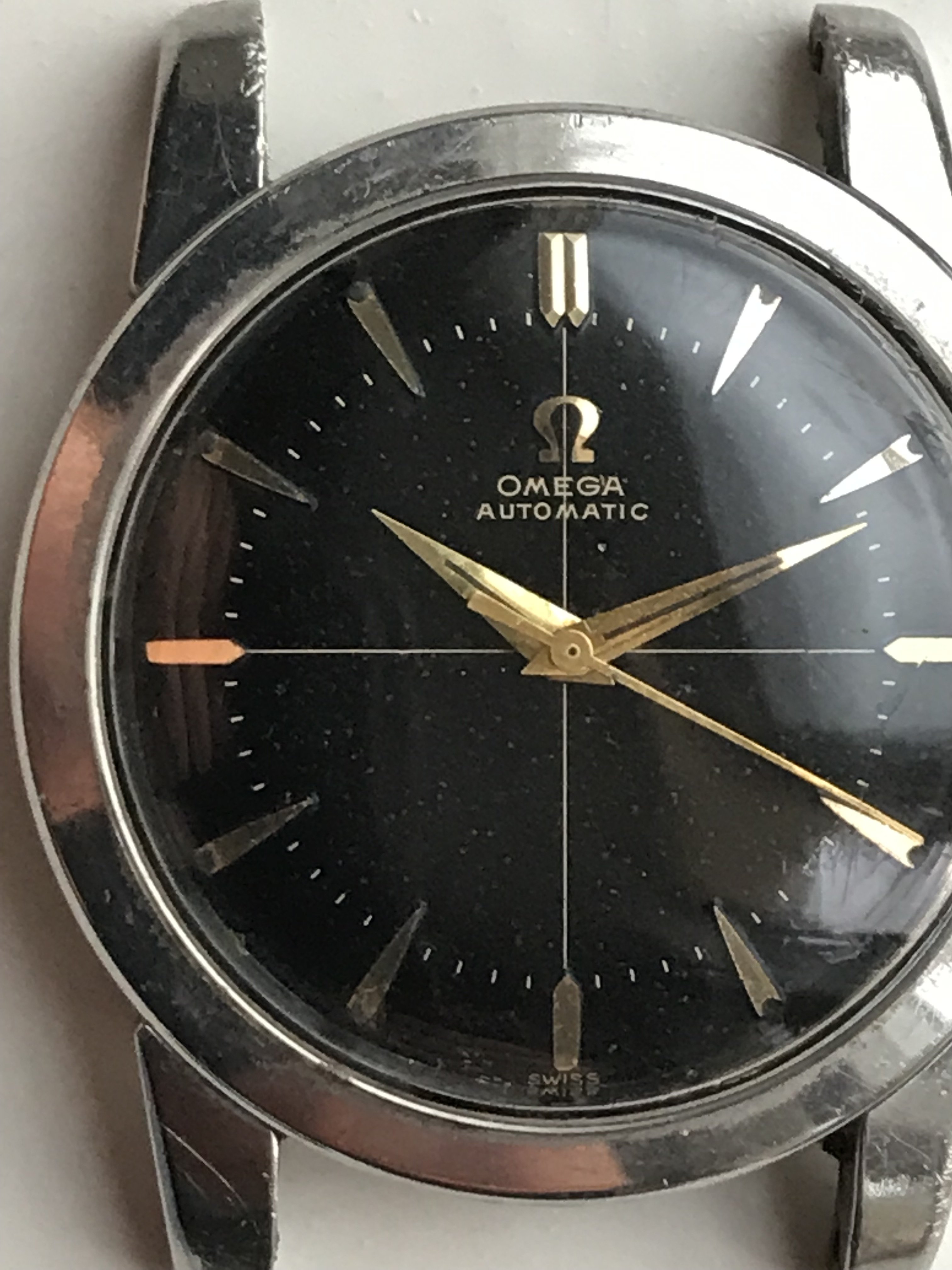

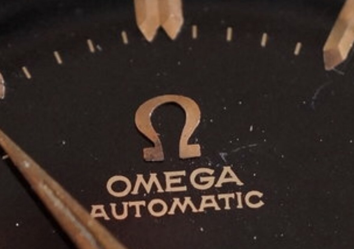

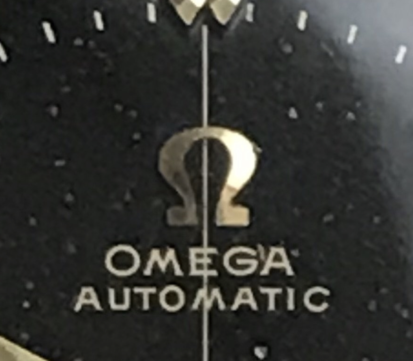

Seamaster 2846-1 SC without Seamaster text on the dial?

Another one... Ref 2677-6. Serial: 13.16m

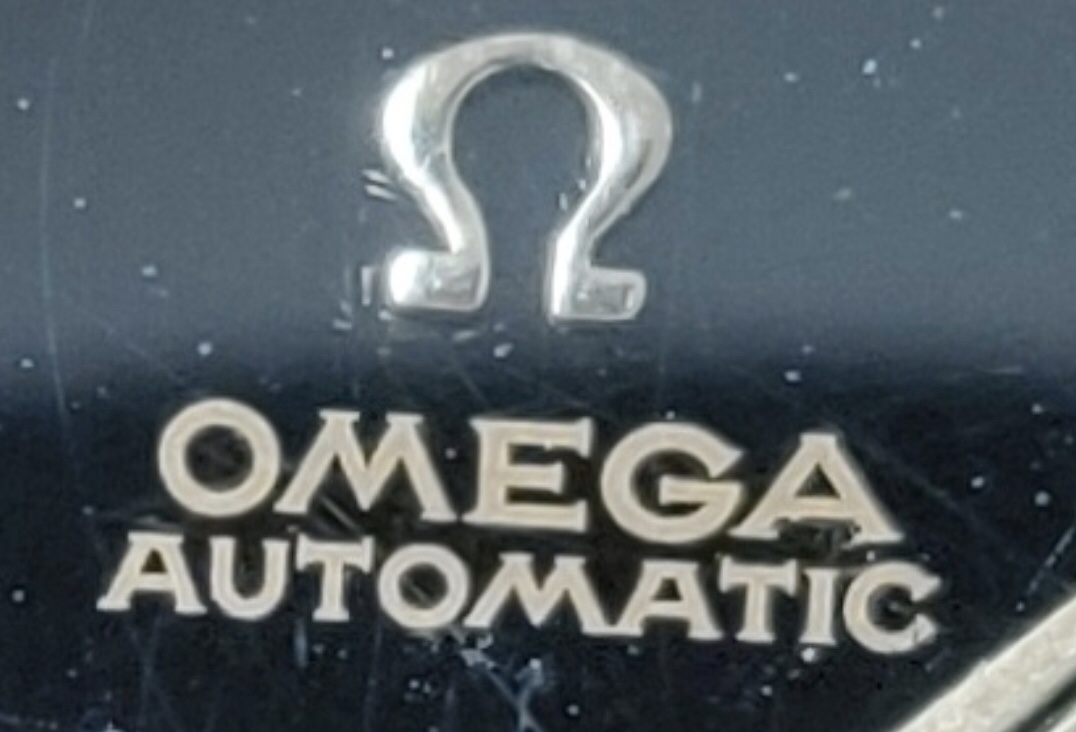

Funny to see the C in automatic seems to be bigger 😀
2,418
19,755
Could it have come from a pre seamaster bumper? There's a relatively small gap between the production of those and the 2846.
If memory serves correct, dial feet are in different locations between bumper and early full rotor models.

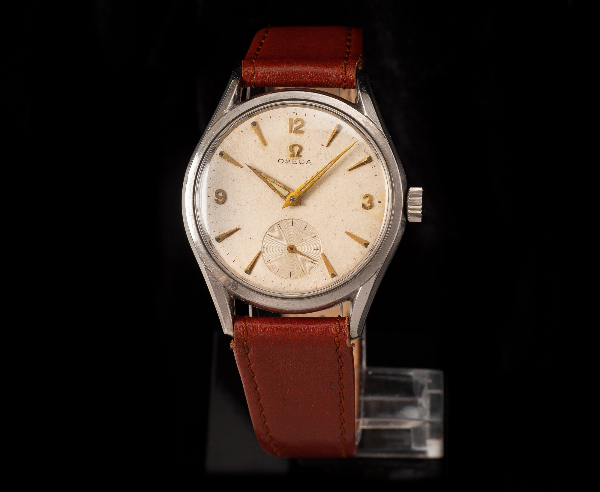

Sorry to revive a dead thread but I've created an account just for this purpose.
I think this question can be answered via the ads at the time that clearly show there were Seamasters without the "seamaster" text.

Hello and welcome to the forum.
We know that early Seamasters did not have Seamaster printed on dials in the first few years, then Seamaster became the must have on Seamaster dials.
The OP watch with dial in question was produced in the period that required a Seamaster on its dial. Not the early ones like in your advertisements.

The Seamasters without the text were produced between 1947 and 1949, I had one myself, a 2577. Ive never seen a straight 2846, introduced 1955 without the SM text on the dial.

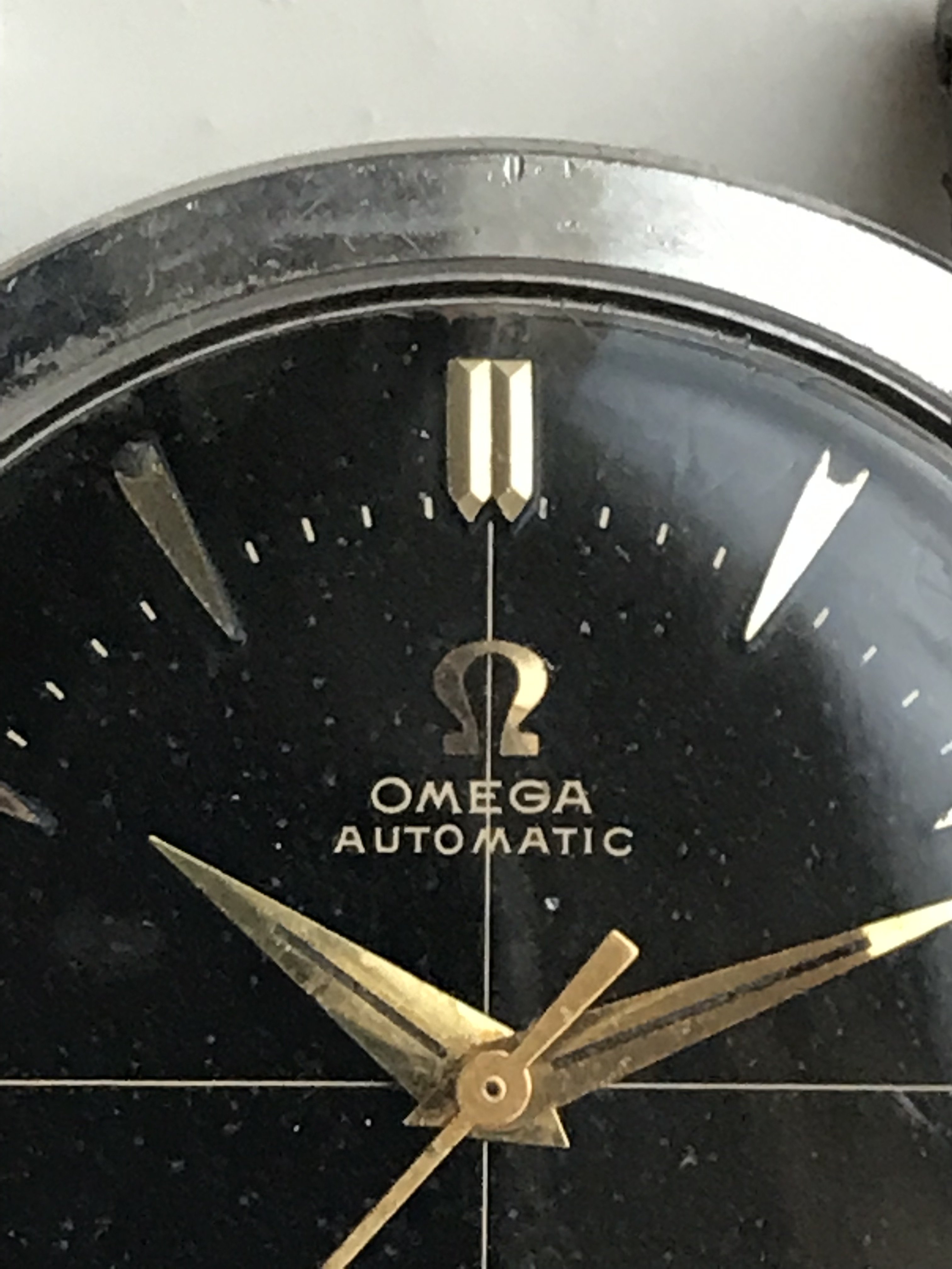

BTW, I just bought this piece from 1952 for 300 bucks

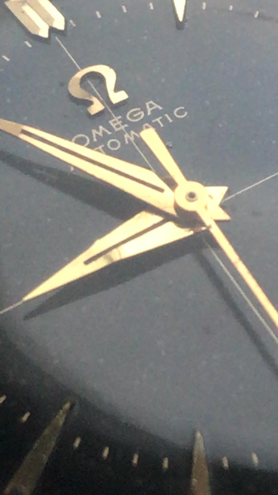

I think there is something off with the word "automatic" and I need to find a crown but I'm quite pleased with the purchase for 300 bucks.

That looks like a wonky redial to me!

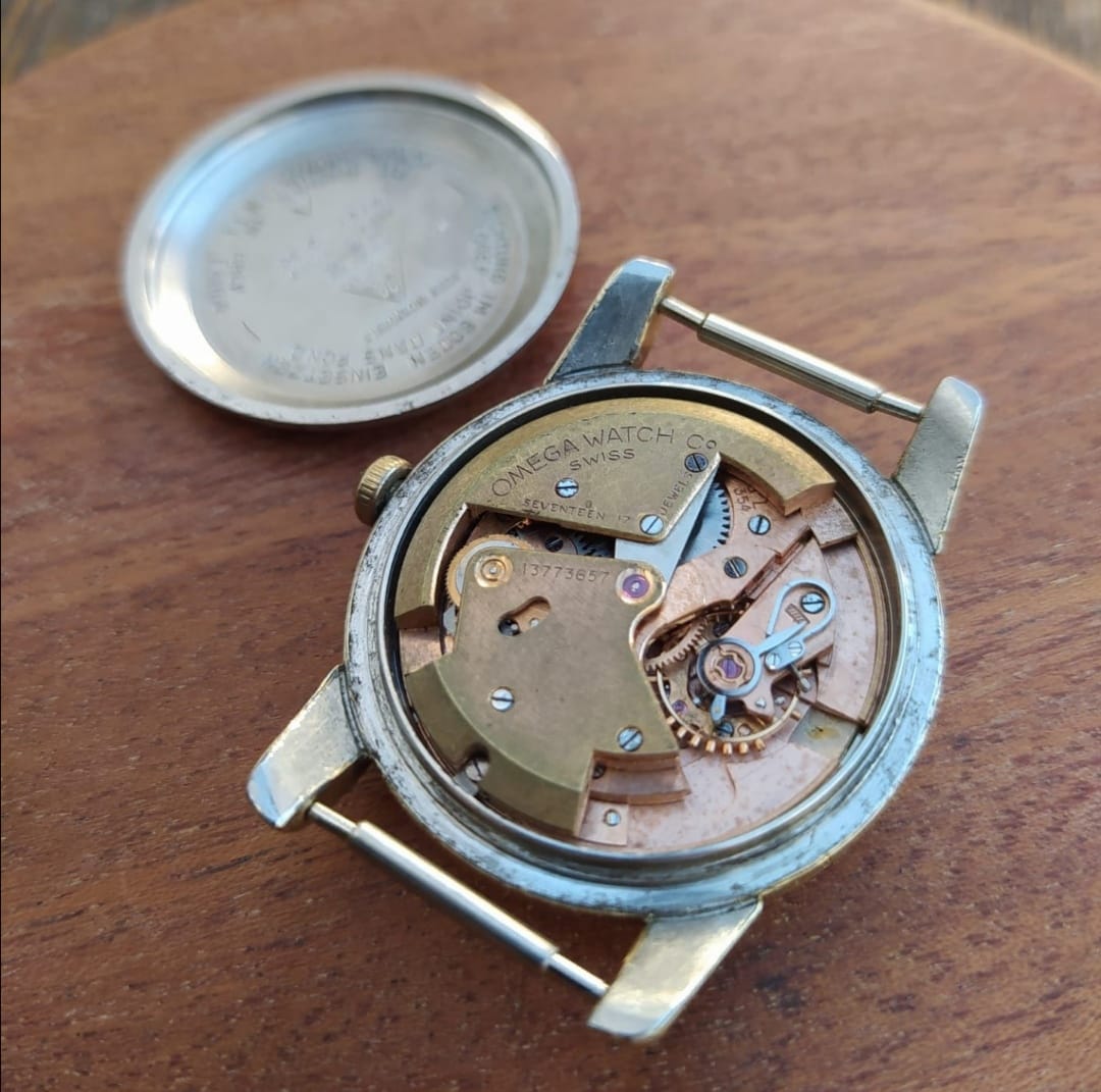

What serial is on that movement? The AUTOMATIC text on yours is very suspect.
10,297
16,112
OK, as you say that is circa 1952. It's difficult to be definitive from just a photo but as I say the Auto text and lack of visible Swiss text suggest historical redial. Yours is of the era when they did usually say SM on the dial, advertisements, particularly those using illustrations are not a great reference for spec for a given year.. The Swiss text may just be hidden under the rehaut though. It may of course have had an earlier dial swapped in.
Given your observations, do you think that it was a good price?
10,297
16,112
Well it clearly needs a service so you are really into it for circa $550-$600 which is a good but not great price. If it is indeed a changed or repainted dial as we suspect then maybe good becomes so-so, in short you did OK but not great.
Well, one of my closest friends is a watchmaker and usually the damage isn't so severe in terms of price (usually charges me 125 euros for a complete service) so I guess there is still hope. Thank you for your advice!

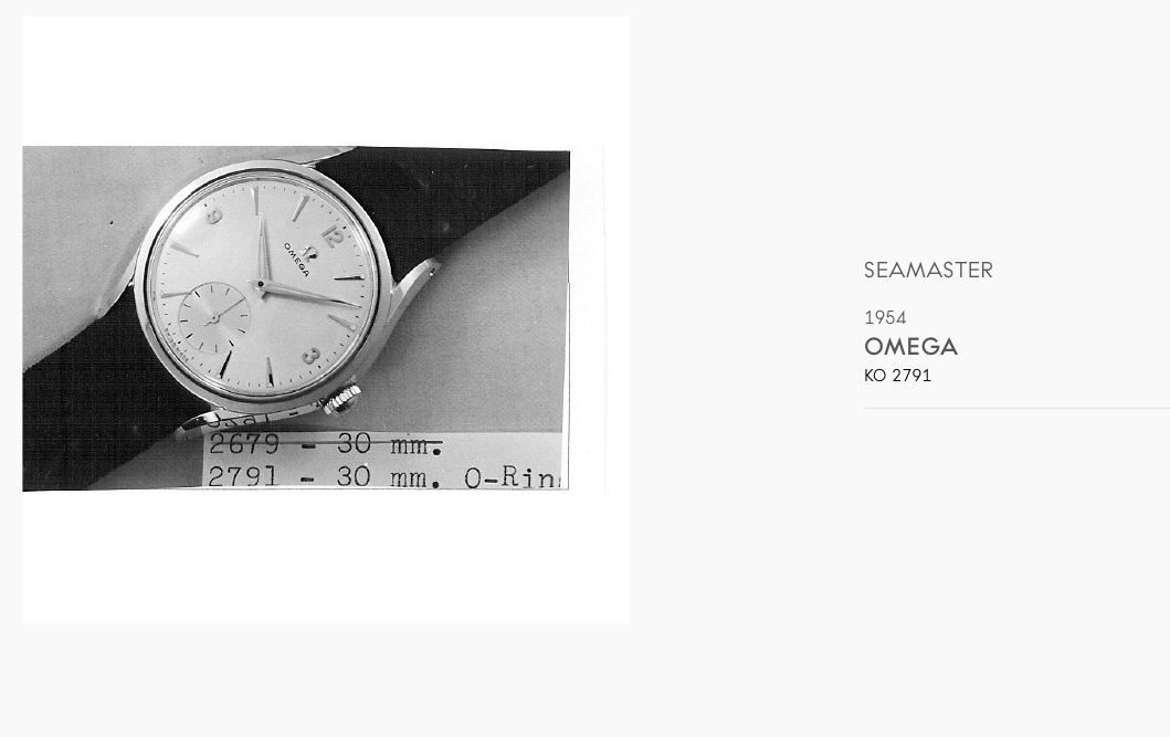

Do you have a source regarding that? According to Omega there were unmarked Seamasters like the 2791 made in 1954.

- I see, and I agree about the anomalies. In case of the 2846 I have three versions and all with Seamaster on the dial. Here is a picture of the unmarked Seamaster 2791 (1954) I mentioned (marked waterproof on the caseback).

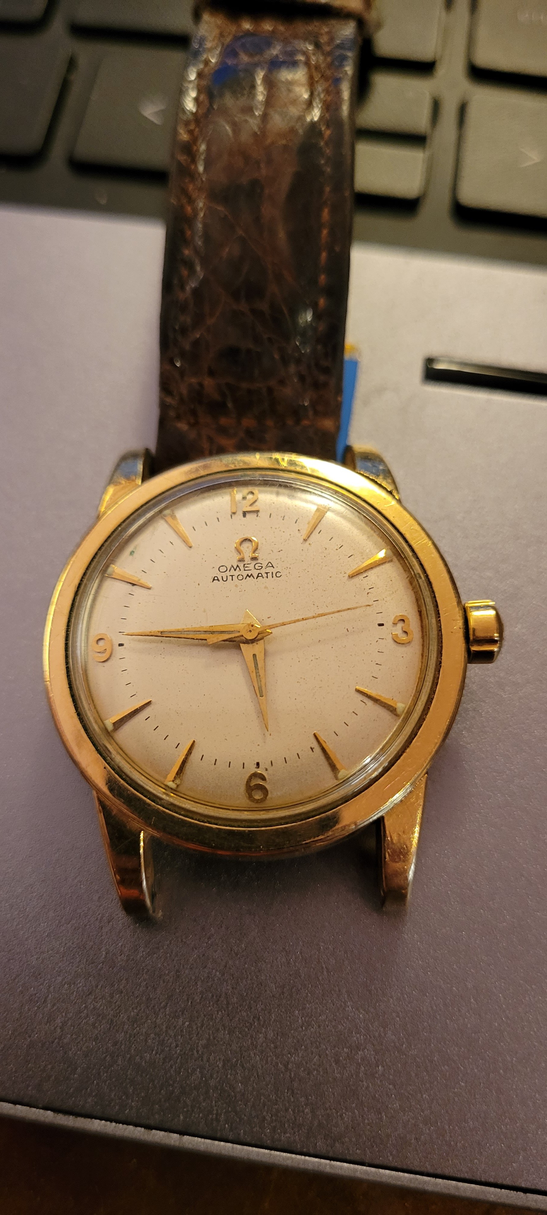

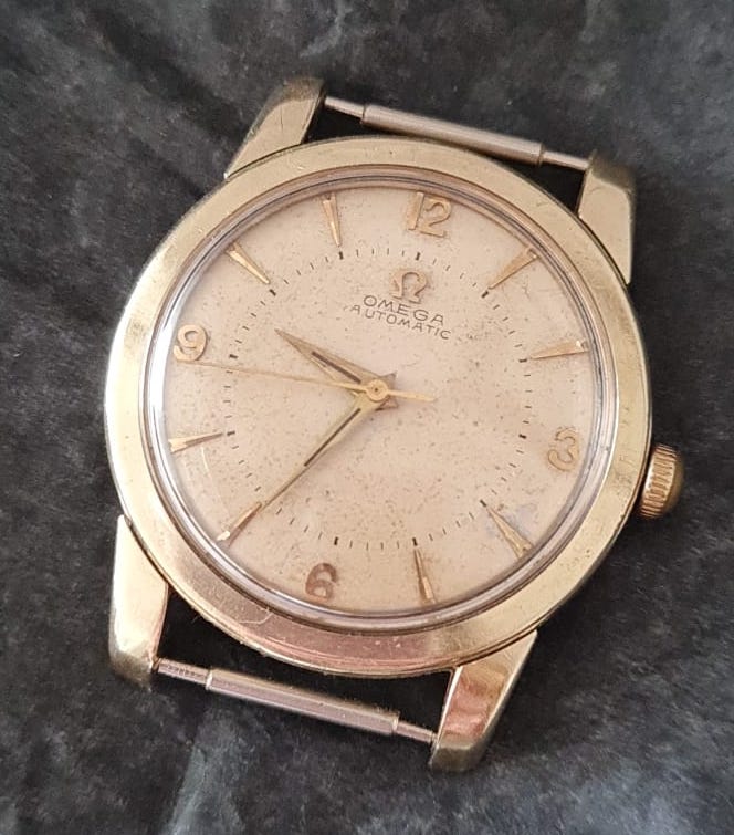

I had somewhat the same issue. Seemed like the seamaster but nothing written. Plus a gold version. It was my grandfathers. Don't know when he purchased but its been sitting in a box since 1971.
