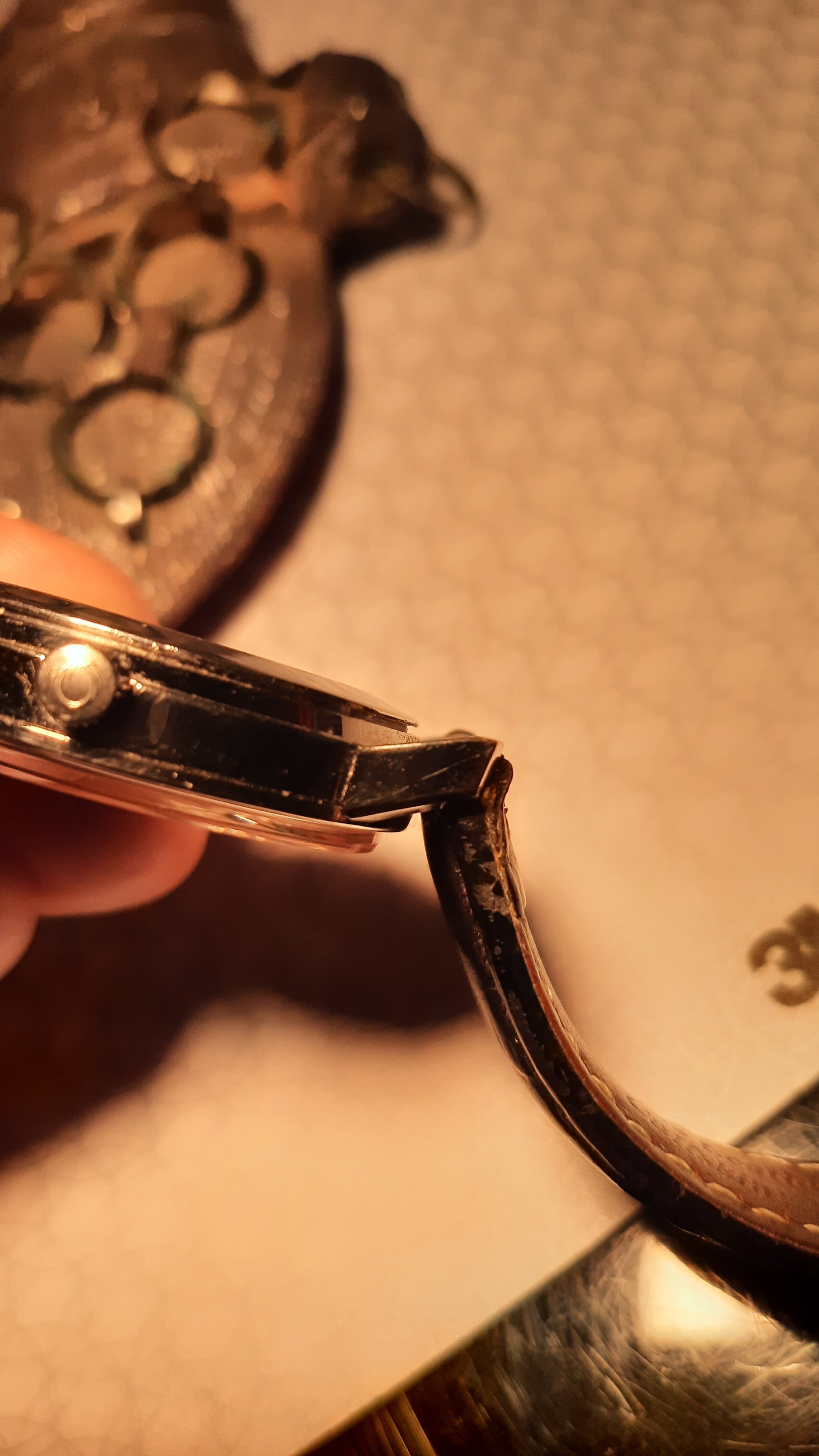

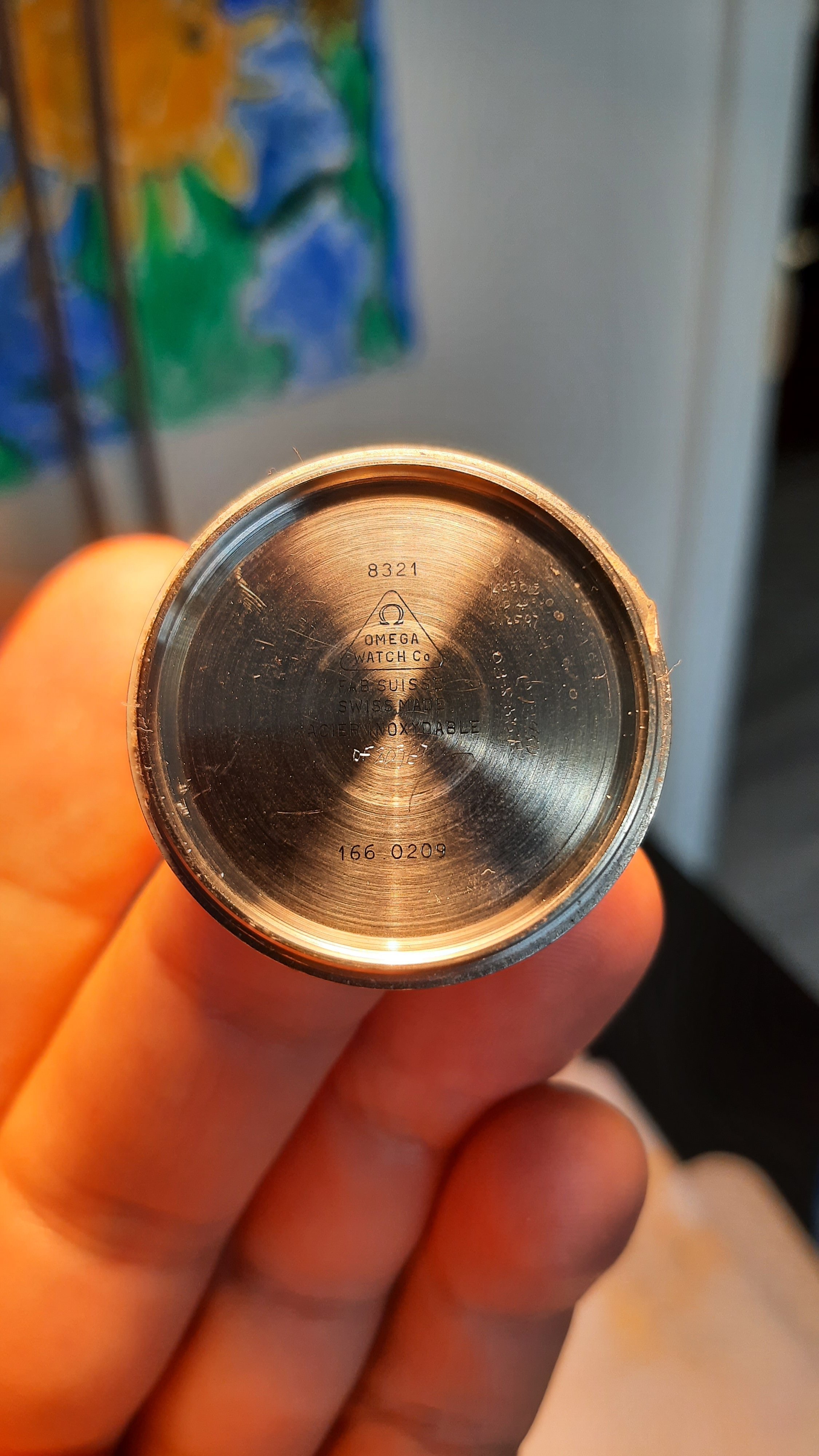

Hi everyone, thanks in advance for your help. I own a
ST 166.0209

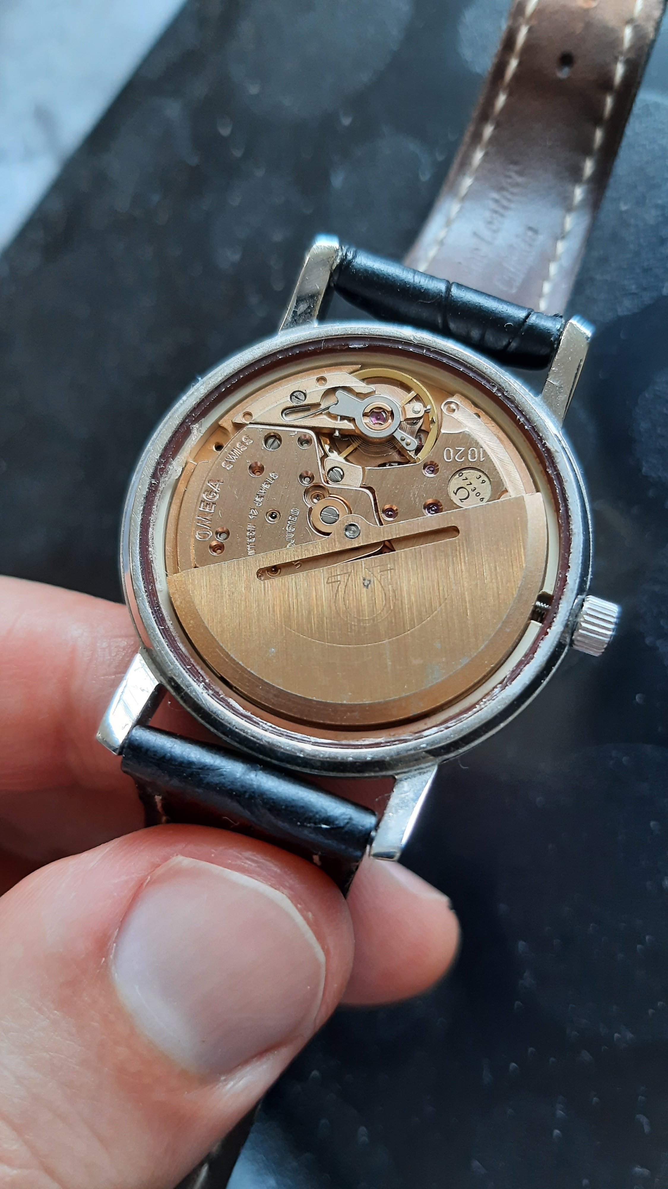

and the back popped off. I brought it to a watchmaker and they popped it back on, but not all the way. I brought it to another watchmaker, they said the crystal was wrong, which caused the back to pop off. they replaced the crystal, but again, the caseback is not all the way on. when I pointed it out, they said that was normal.
thoughts? I know it is wrong.
photos of watch, etc attached
12
oh, also, in the first pic, you can see a.. gasket? tape? running around the edge of the caseback on the top half. that is now missing (I took the first three photos when the caseback first popped off). Is that tape important?
the fourth photo was taken after getting it back from the second watchmaker.
also, the back popped off in my watch box. apropos of nothing. I am afraid to wear this watch now.
thanks again!

You need a new sealing gasket, the red thing. It holds the caseback in properly.
I'd find a competent watchmaker.
18,840
39,182
The gasket should be replaced every time the watch is opened, it deforms when the case is closed and continued use of the old gasket causes problems.
The gasket part number is 198-0050.

ok, UPDATE: Gasket received. I went to another watchmaker, and explained the history. they examined it, and said the old gasket was 1.4mm, and this new one was 1mm, but that the movement ring was too thick, and causing the caseback to float like that. So, now I am looking for a new movement ring I guess. Wish me luck!
12
I am not having any luck finding this part. I have brought it to four watchmakers in Vancouver (Otto Freidl, The German Watchmaker, Roldorf and Co., and Time and Gold), and they were all unable to close the caseback. I have contacted swatch Canada to see if they would take a look - no reply.
Any ideas on where to send this watch?
12
another update, someone suggested checking to make sure the lip on the movement was inserted into the movement ring, so I did that, and it is. it closes slightly better now with the new gasket though. Swatch got back to me and said they'd need to send my watch to Switzerland, which seems like it would take a year. I think I will hold off on that, and jsut wear it as is. Thanks everyone for your help!
