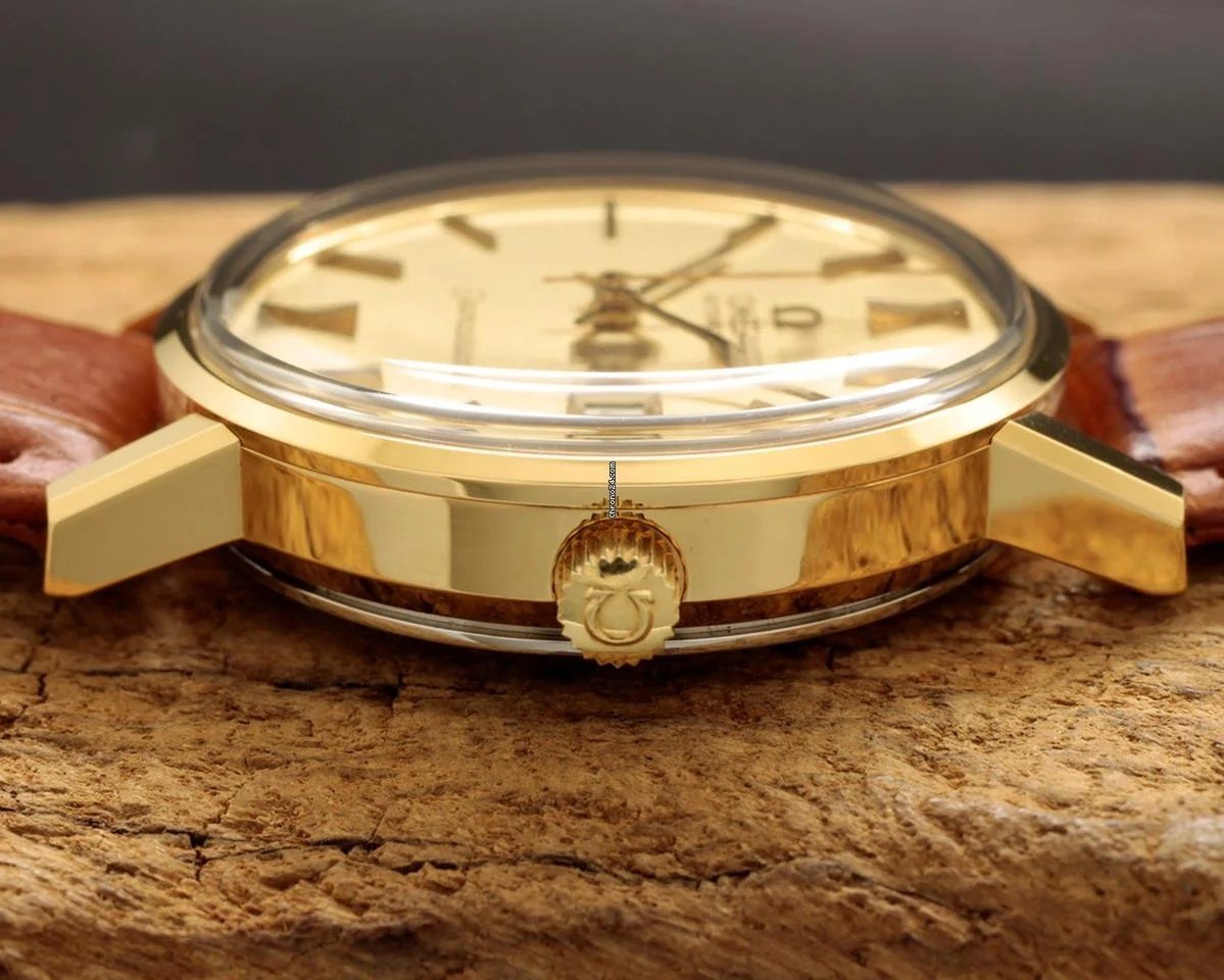

SEAMASTER 1978 ST 166.0209 - back not closable by watchmaker
12
no, I never did. I brought it to three separate watchmakers, who could not change it, and I saw that there were many online like it, so I thought perhaps it was fine.
for example, here is a photo of the same watch, seller listed as "
TIME CAPSULE New Old Stock vintage LAST ONE untouched since manufacturing NOS
" w a giant gap....
