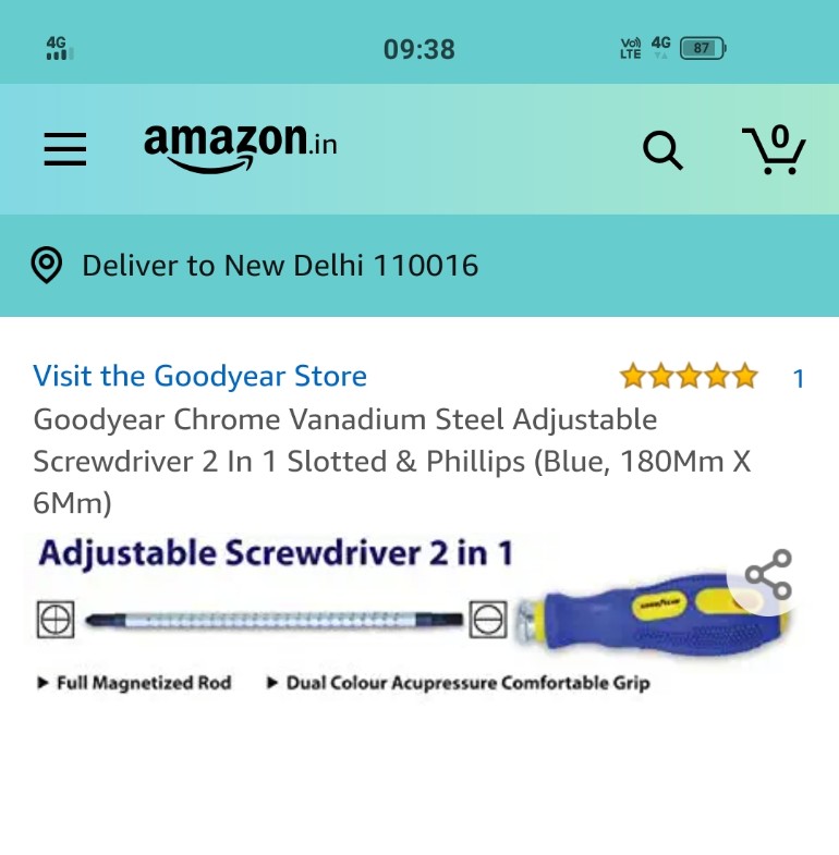

If you shape it right. But starting from a 6mm wide tip is maybe not optimal; lots of filing. Plus (or rather, minus), 'fully magnetized' near your watch is also not great.
1,933
8,481
Yes indeed so. I just didn't think all that. Its so nice of you to remind me the basics.
