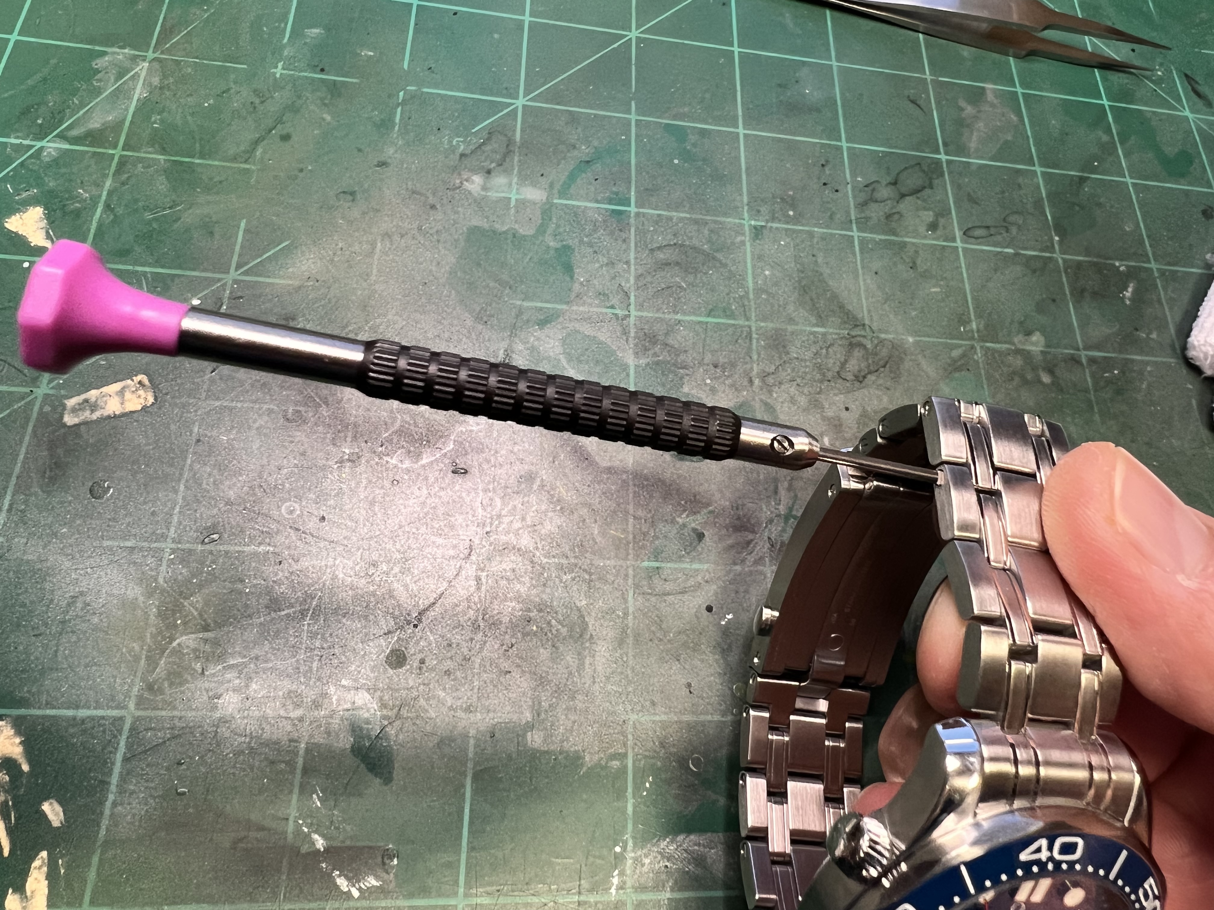

Screwdriver for Omega Seamaster 300

Ive always used a Wiha 96018 for Omega bracelets. Perfect fit and zero wiggle room within the screw head
One of my favorites too.

Is the profile of the Wiha 96018 hollow ground ?
Wiha 96018 Slotted Screwdriver with Precision Handle, 1.8 x 40mm https://a.co/d/j0LvDLl
Don't know if it is hollow, swallow or round ground -- but it works & worked perfectly.

That pic i posted of horofix is showing it suspended and attached to the screw. Hard to see. It fits perfectly.

The Wiha is hollow ground and fits exactly in the screw head. I've never damaged any omega screw head with it.
