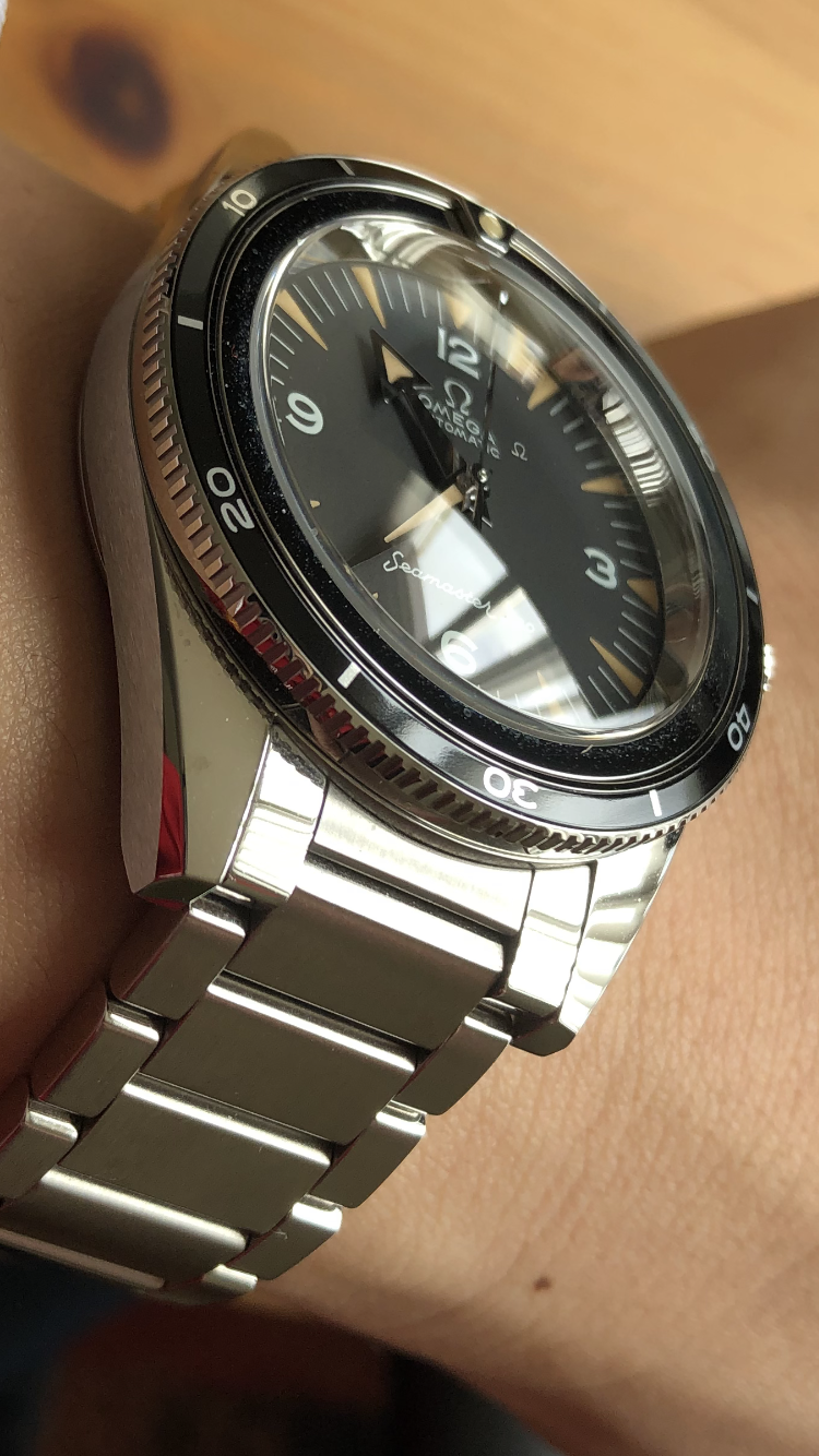

But the minute you looked at the dial you would notice due to the refractive properties of the two different materials.
It may look the same side on but it will never look the same looking through it. That's the main point as I rarely look at the profile of a watch compared to the amount of time I actually look at the watch.

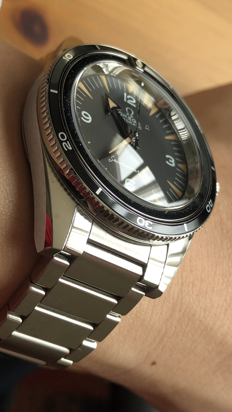

Just look at the distortion on this picture posted on page 2 ( this would annoy many more than the milky ring )

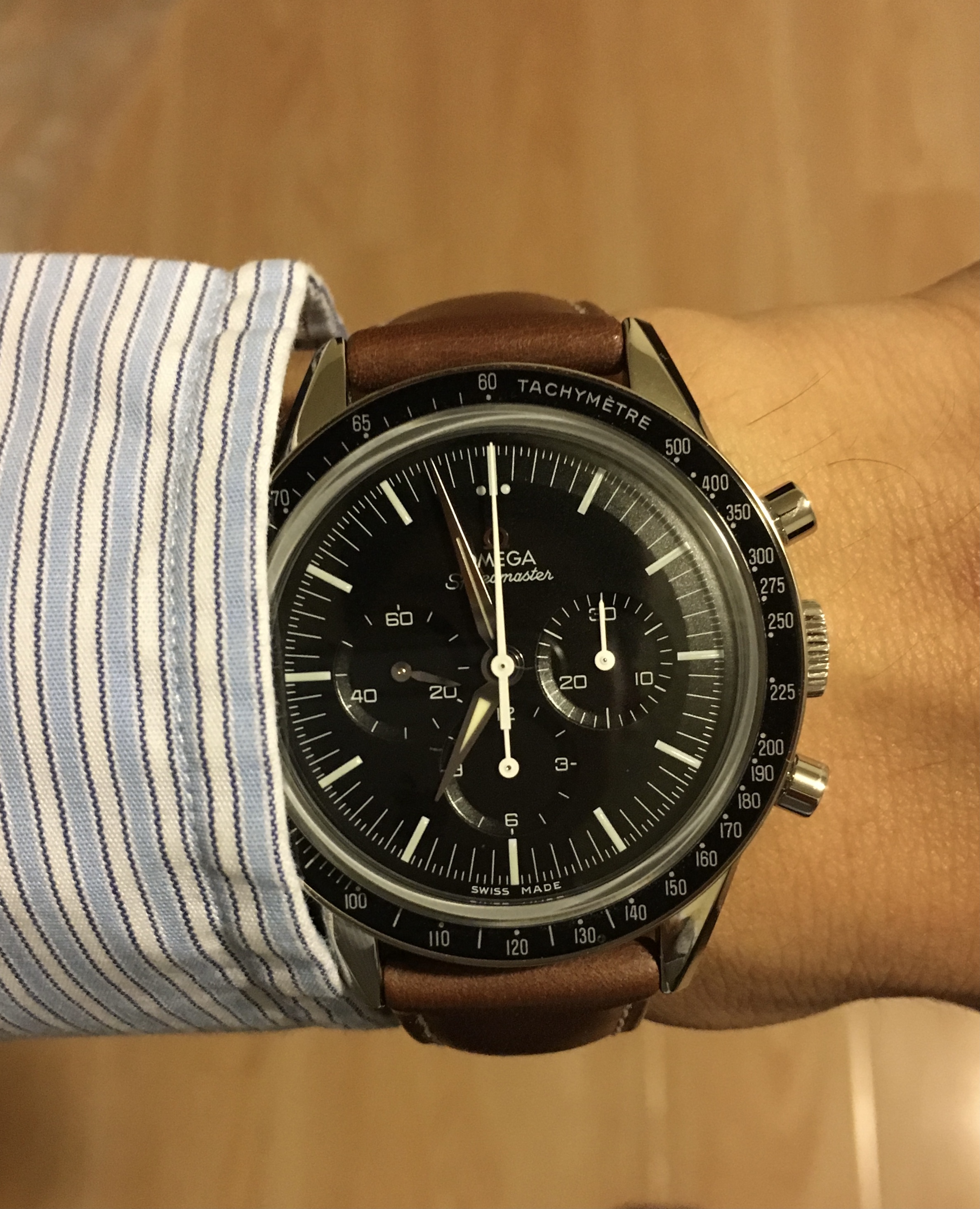

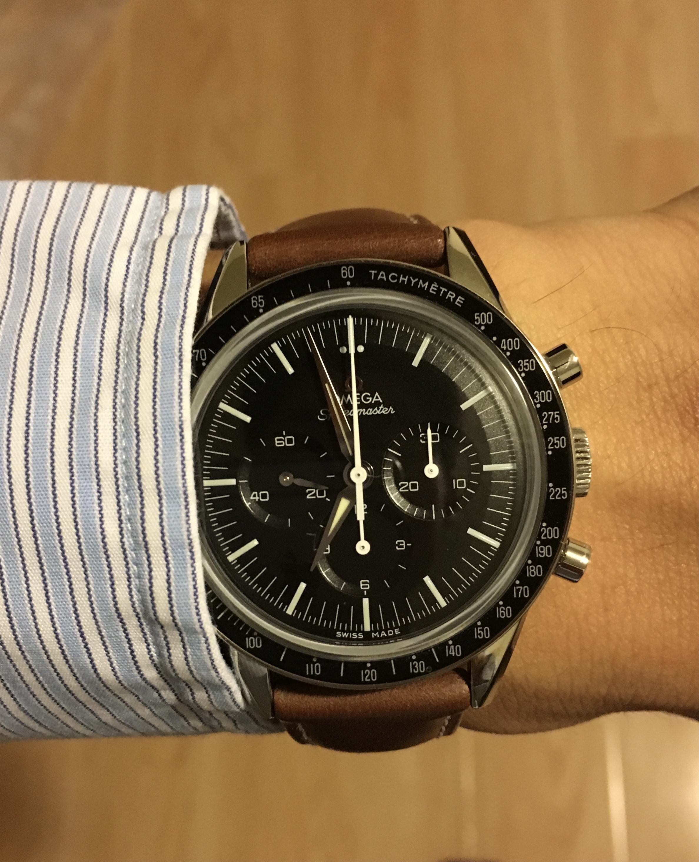

Scrolling through old photos on my phone, I definitely see the milky ring now on the 60th SM. Especially in close-ups from angles like this:
It didn't jump out at me during daily wear, when worn on the wrist. Or when laid side-by-side with a Hesalite Pro.
Especially in comparison to this:
I'm definitely one of those in the camp of: "I'd be much more willing purchase a Sapphire Sandwich if its crystal was curved like the 321 Ed White's crystal, and had less of a milky ring".

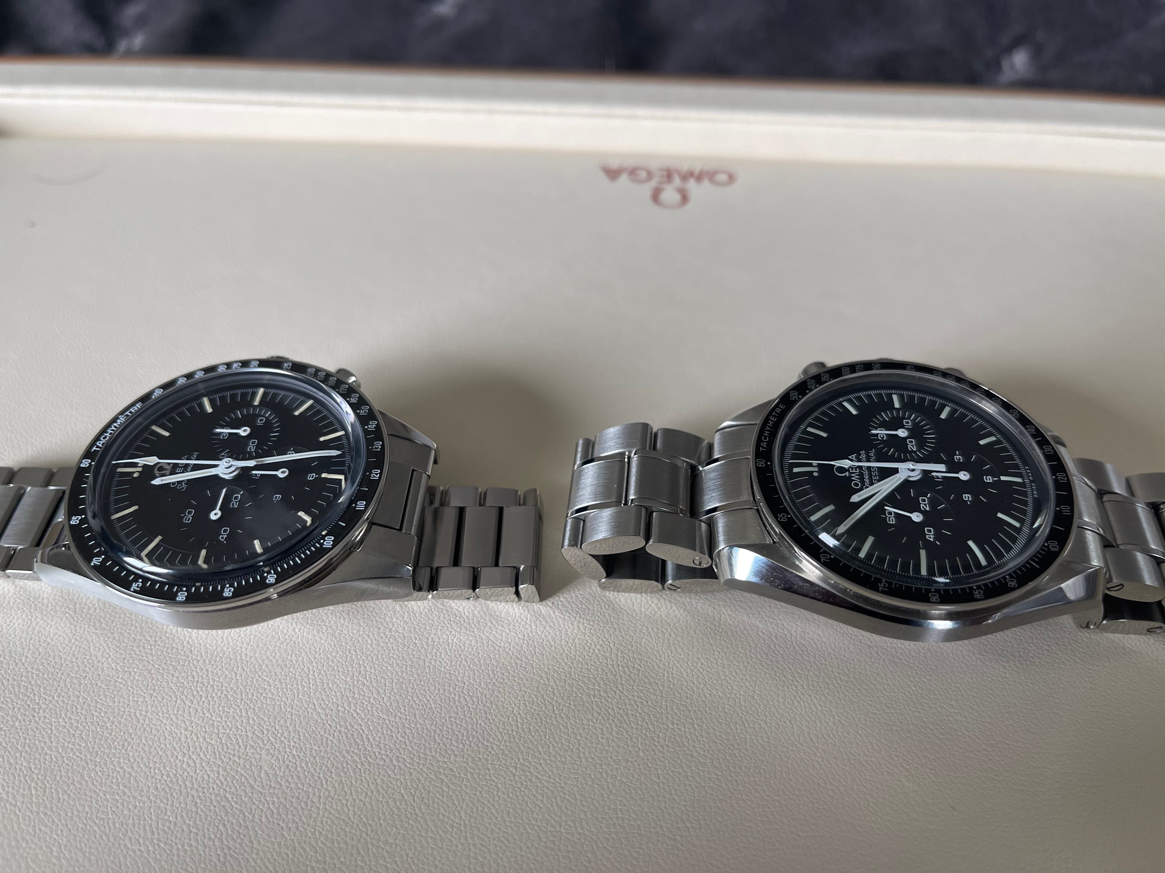

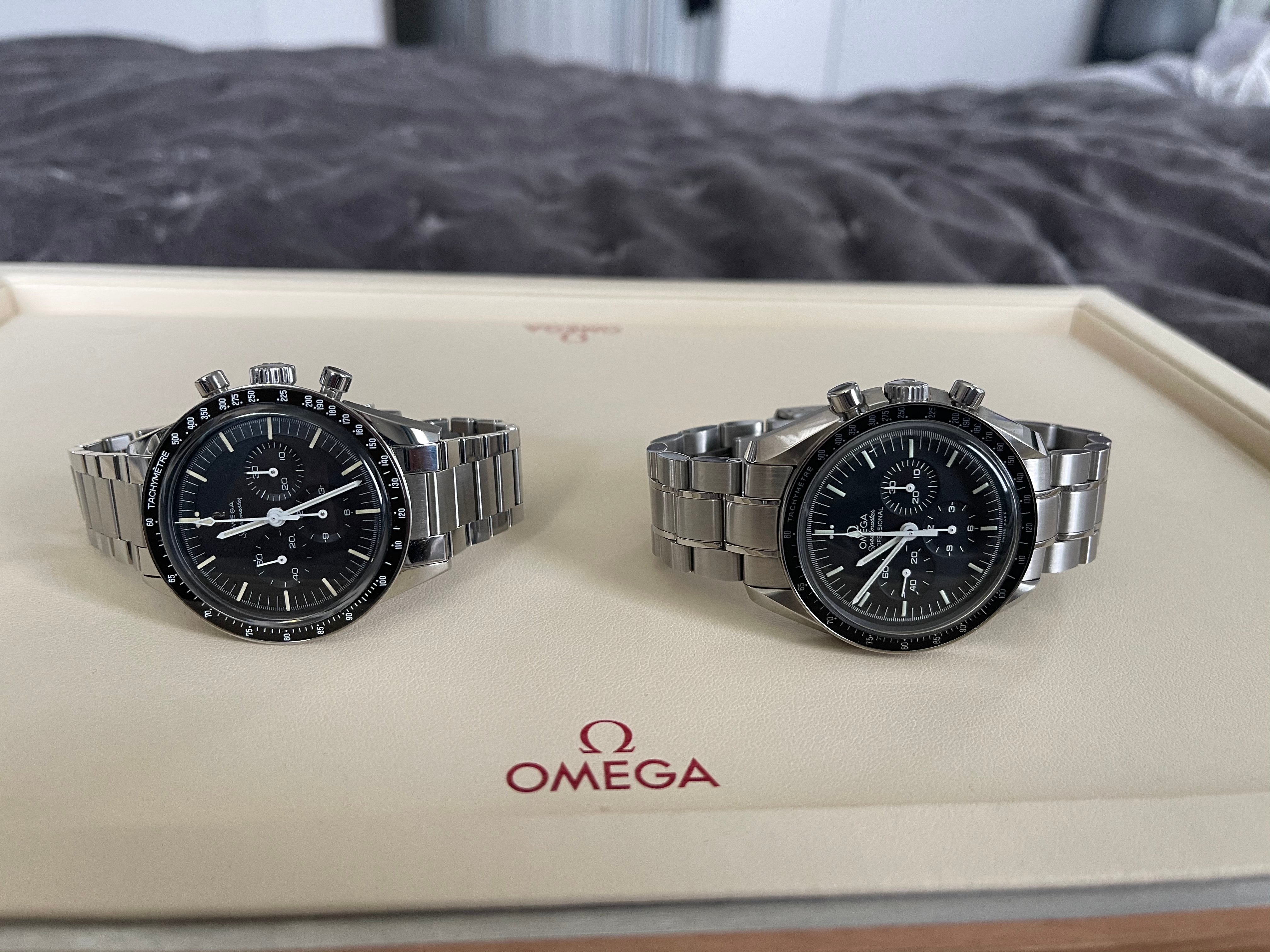

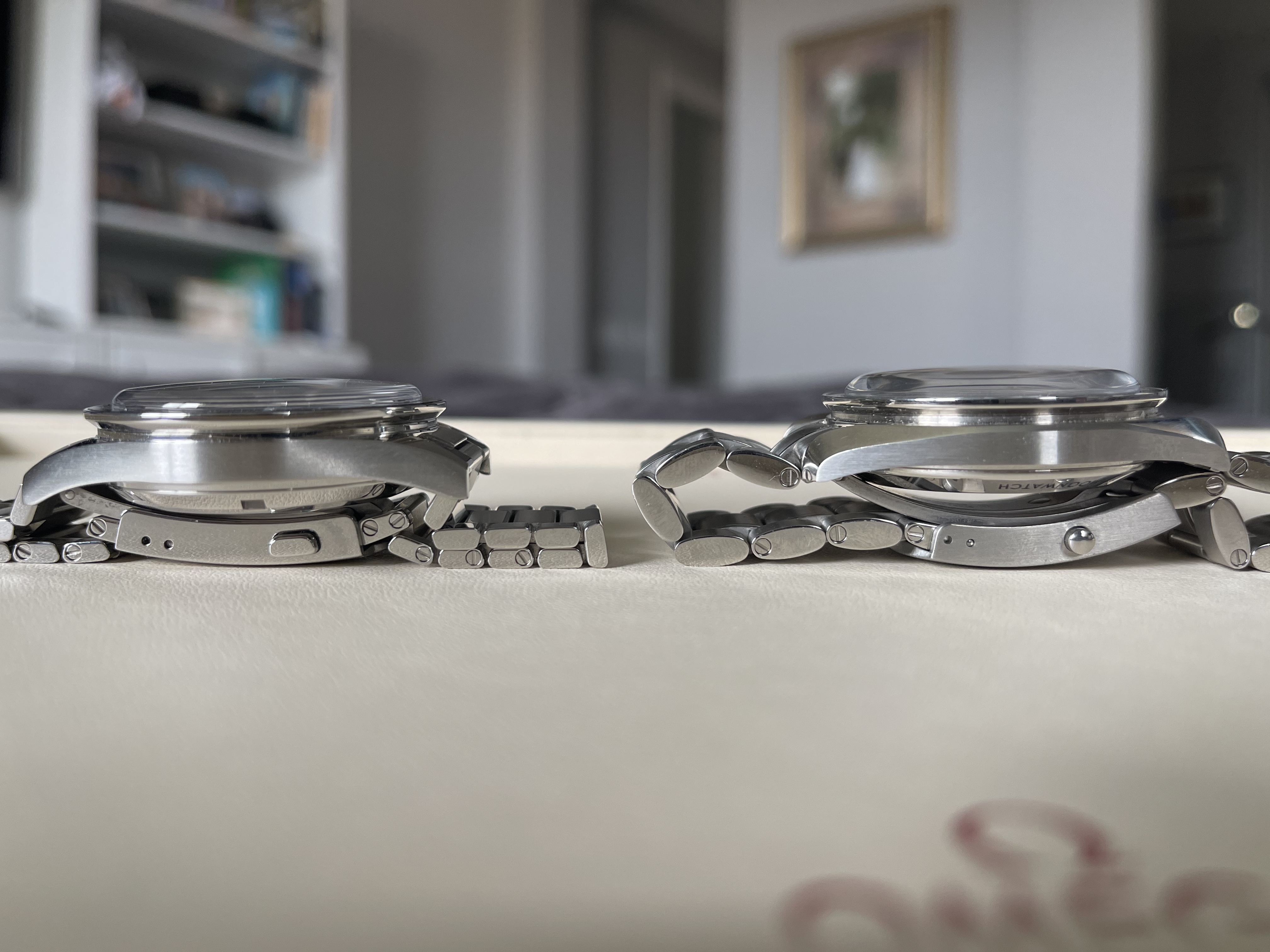

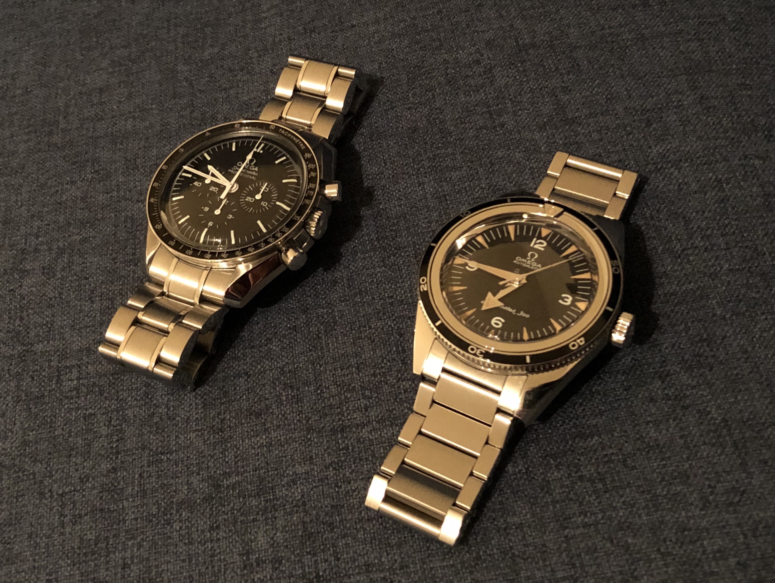

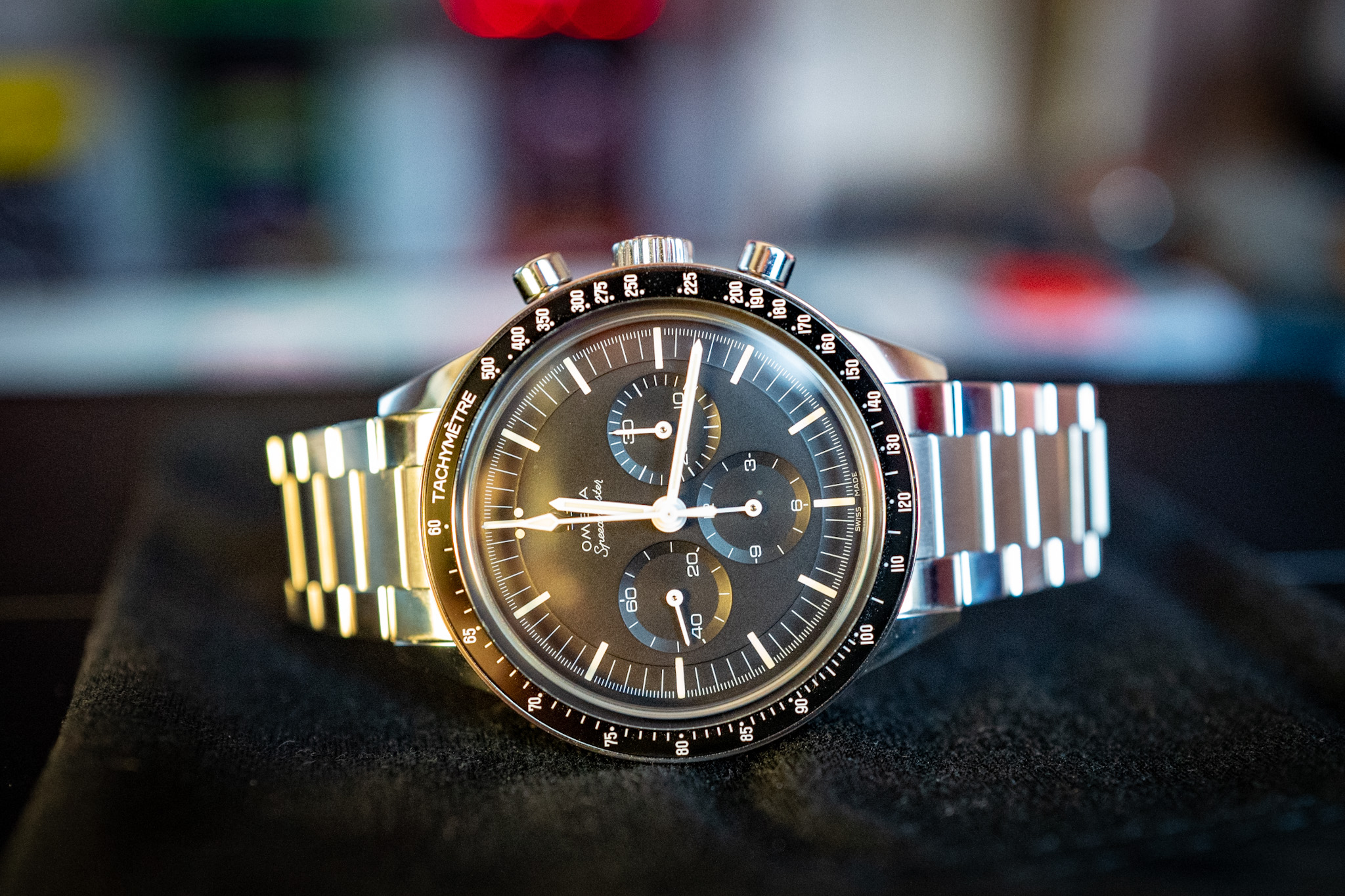

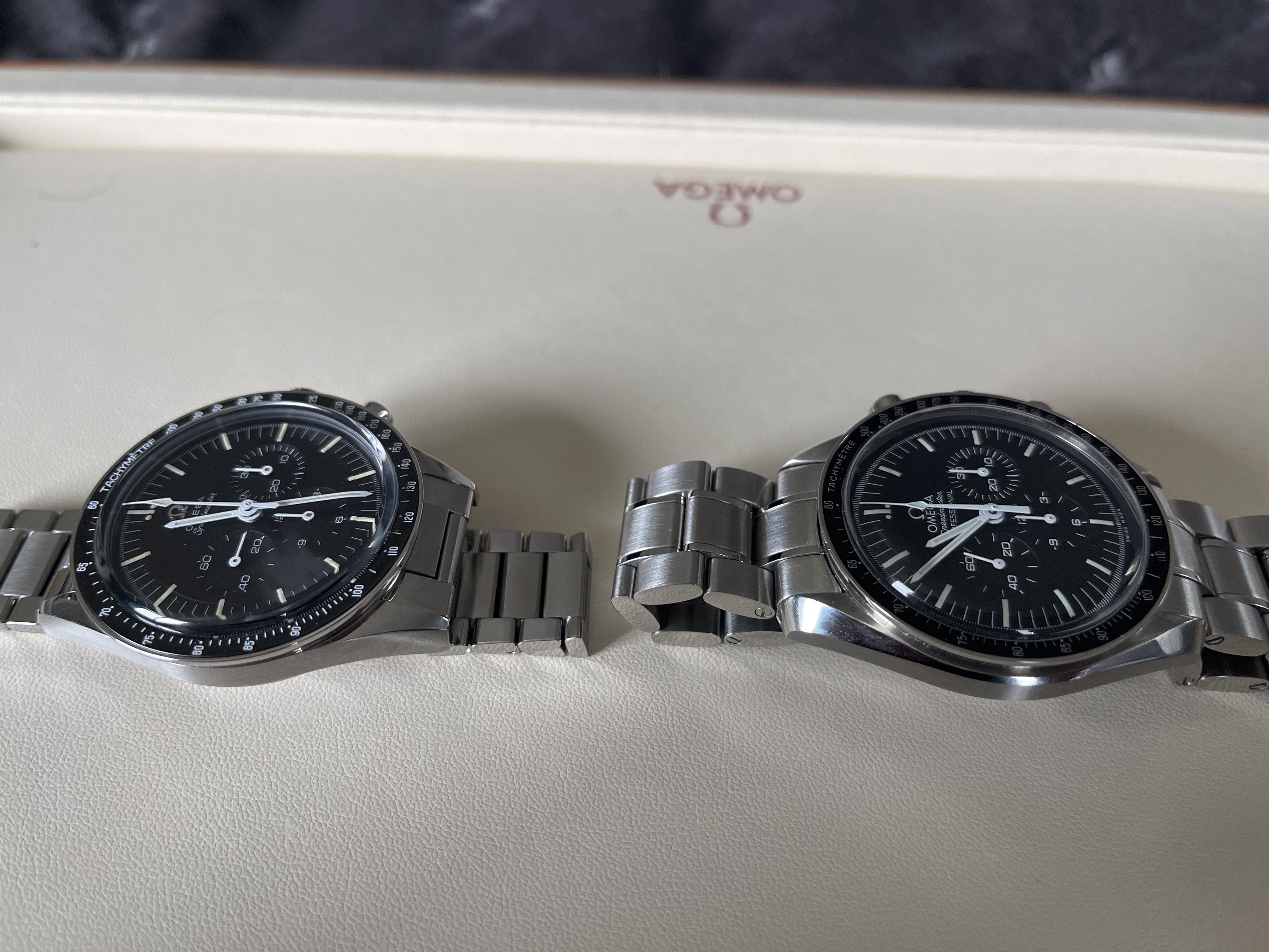

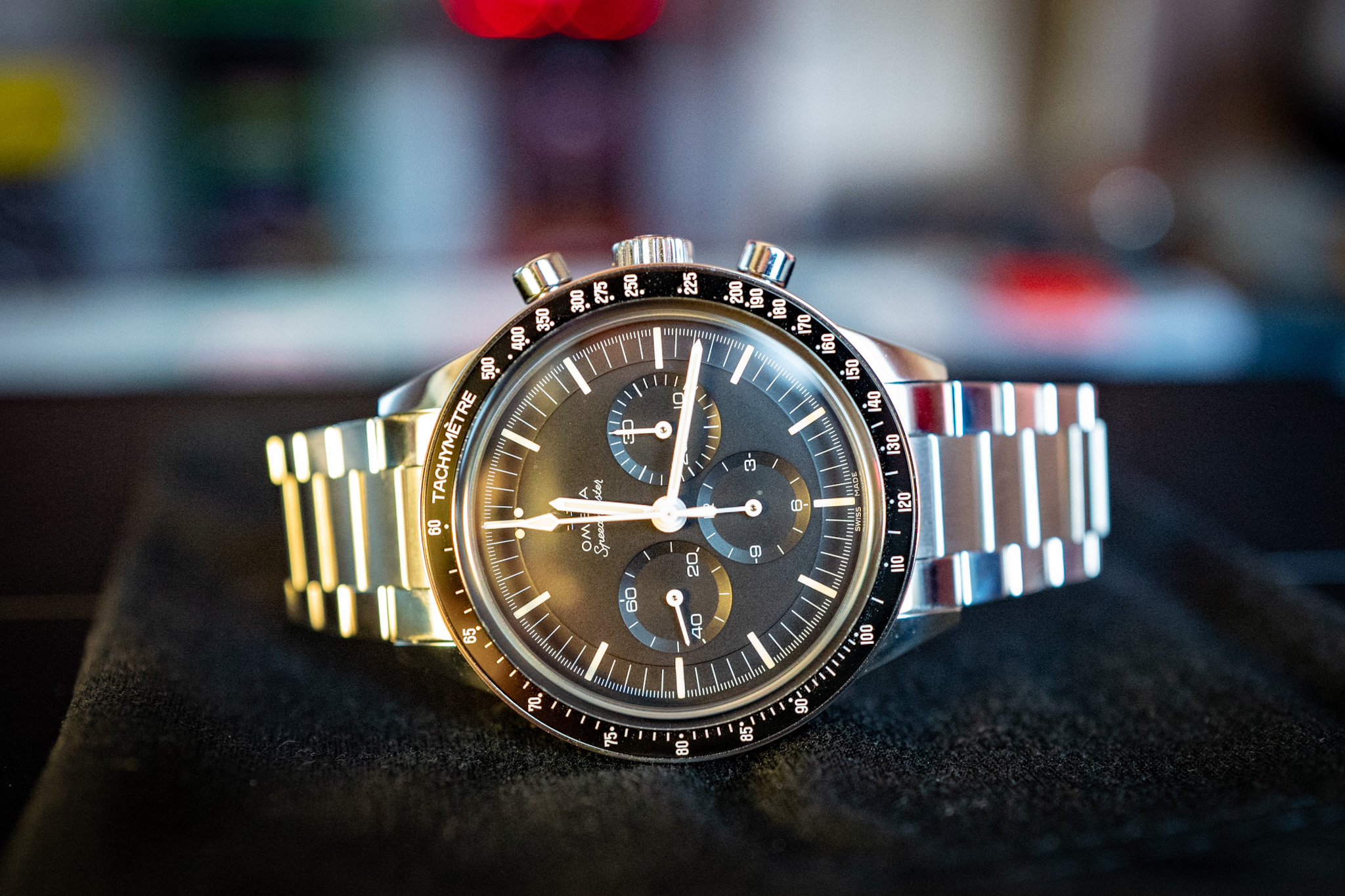

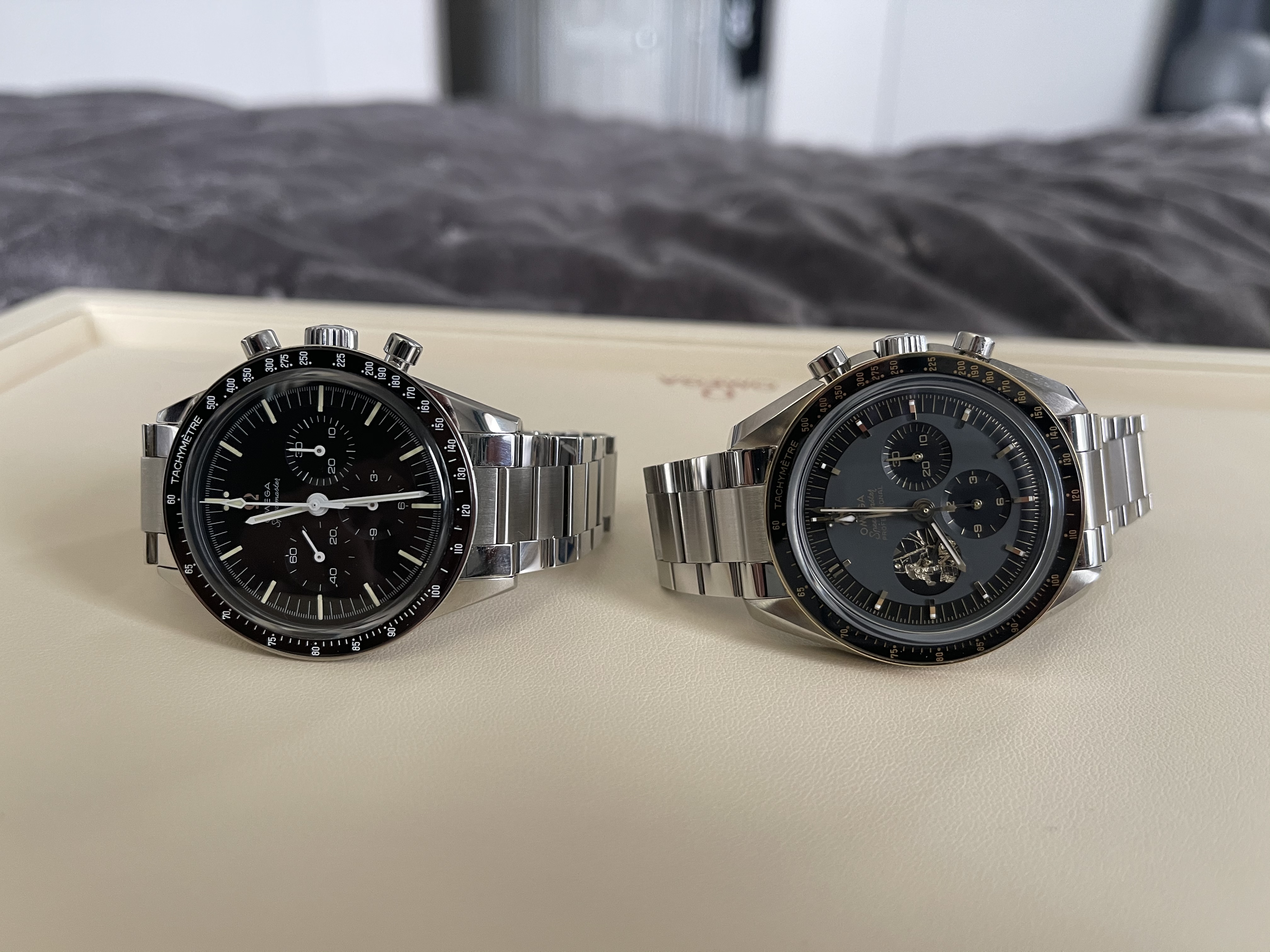

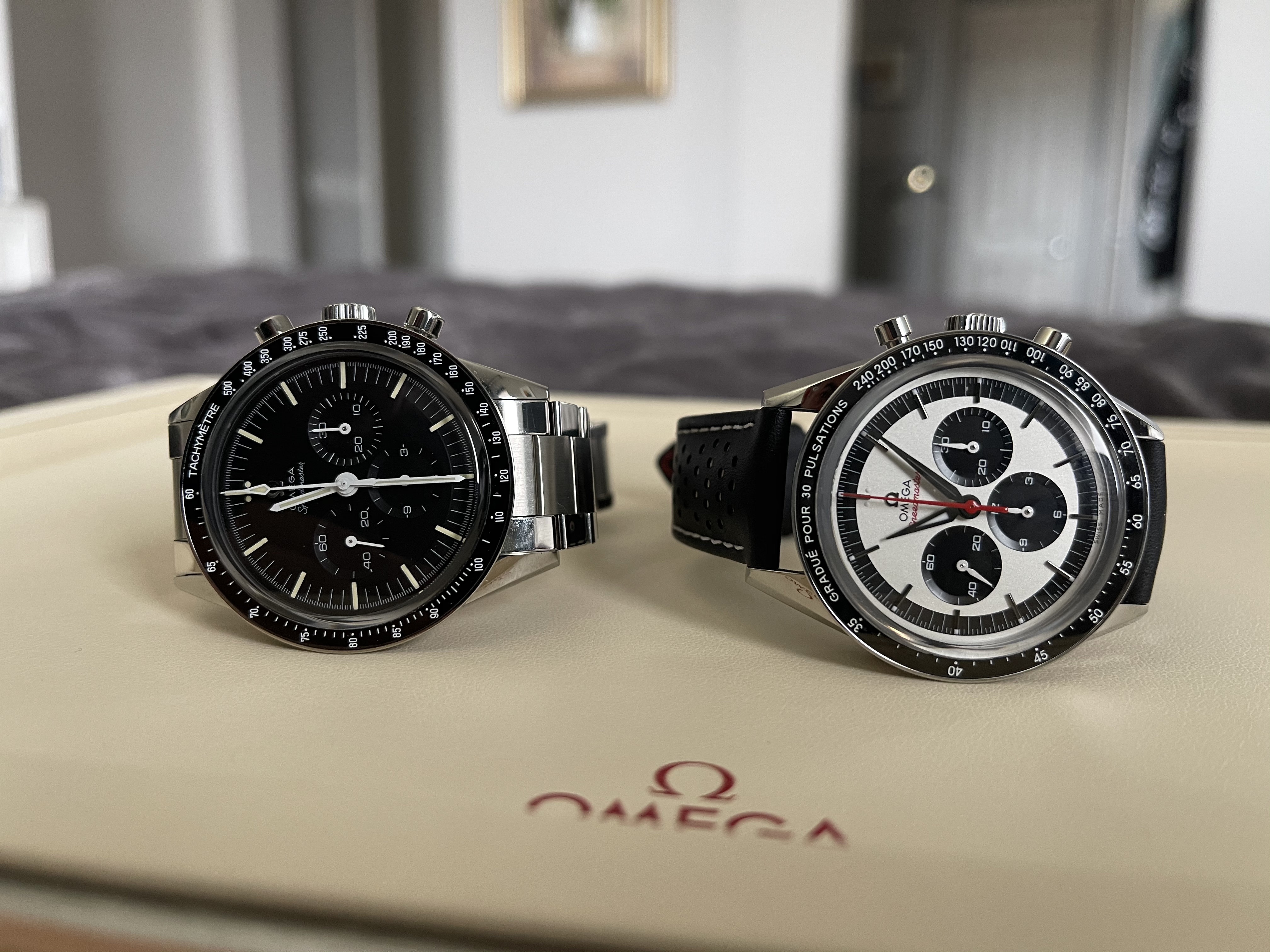

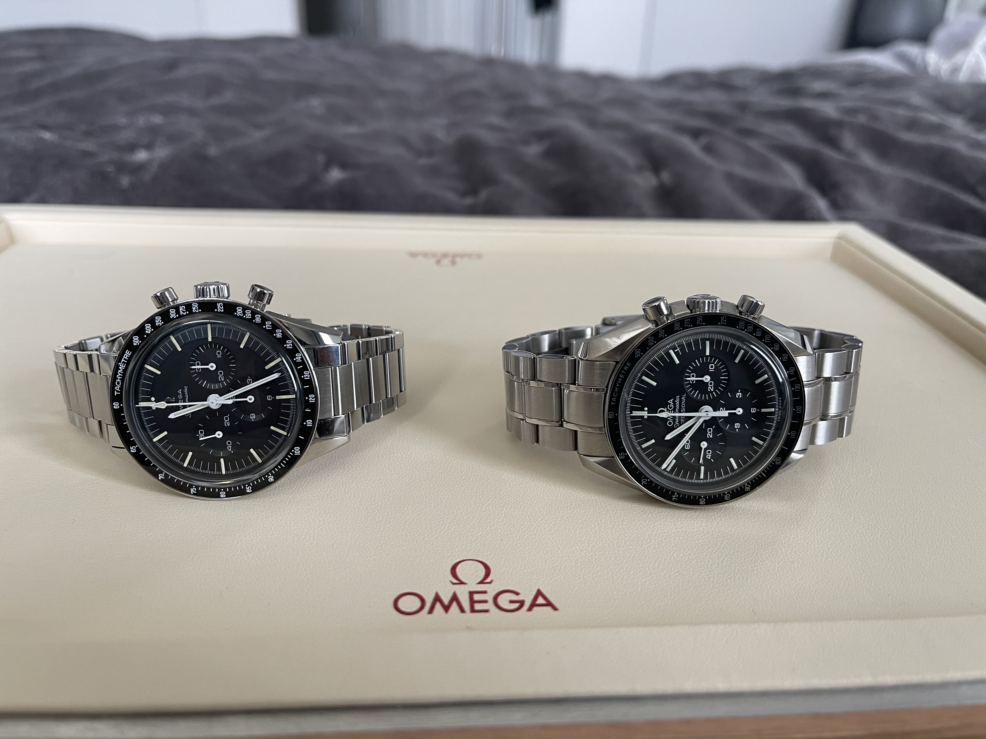

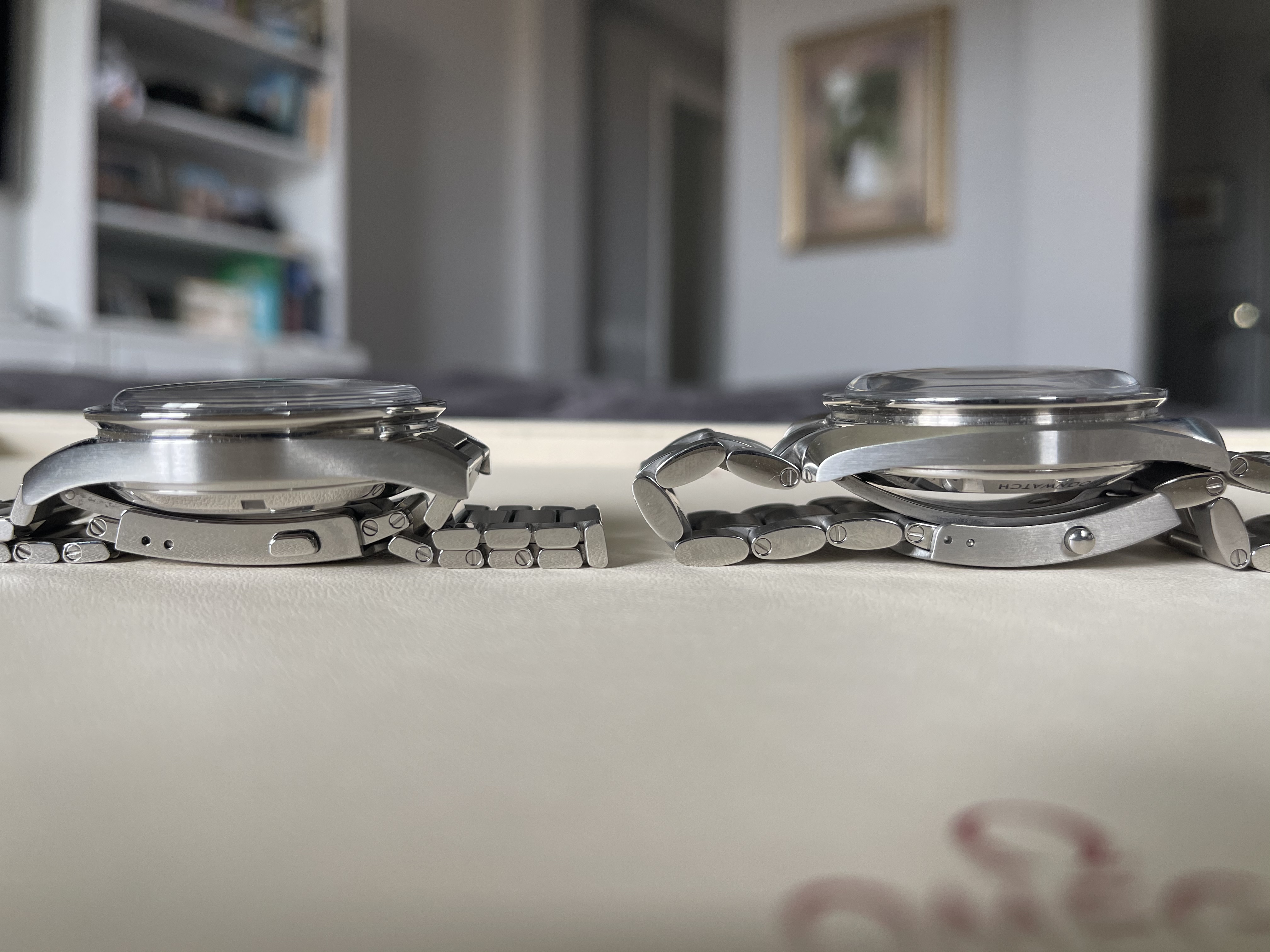

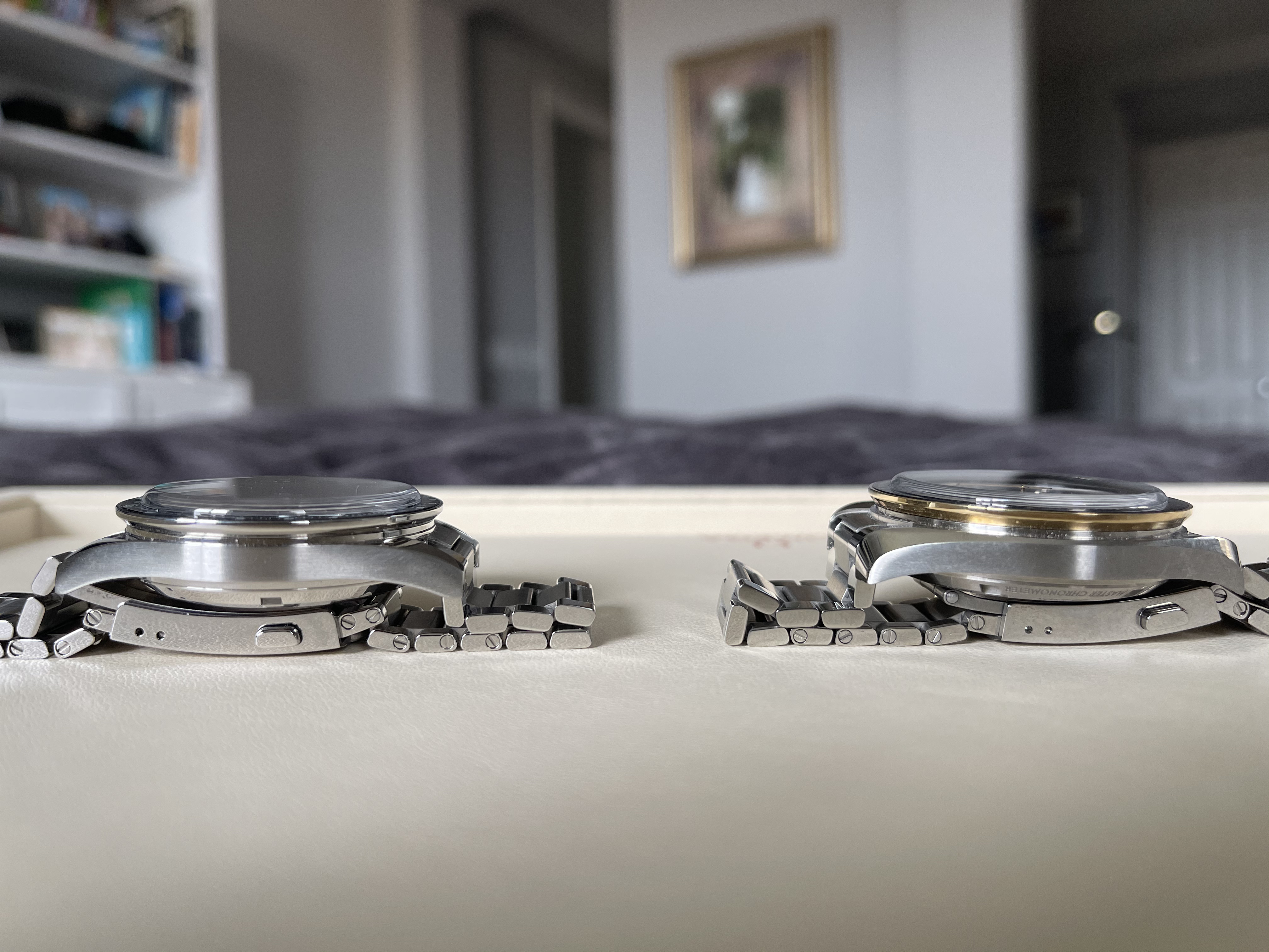

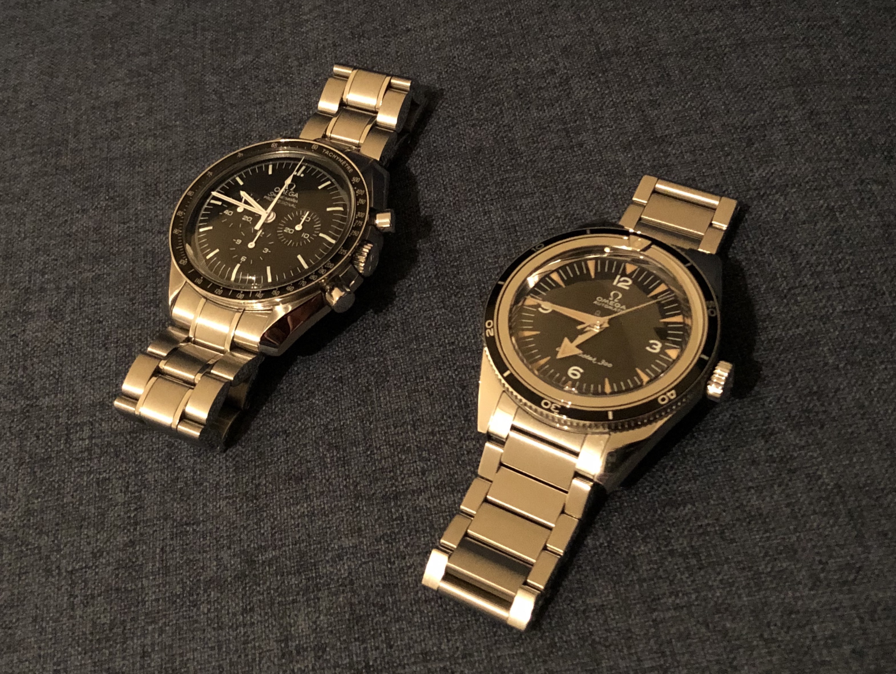

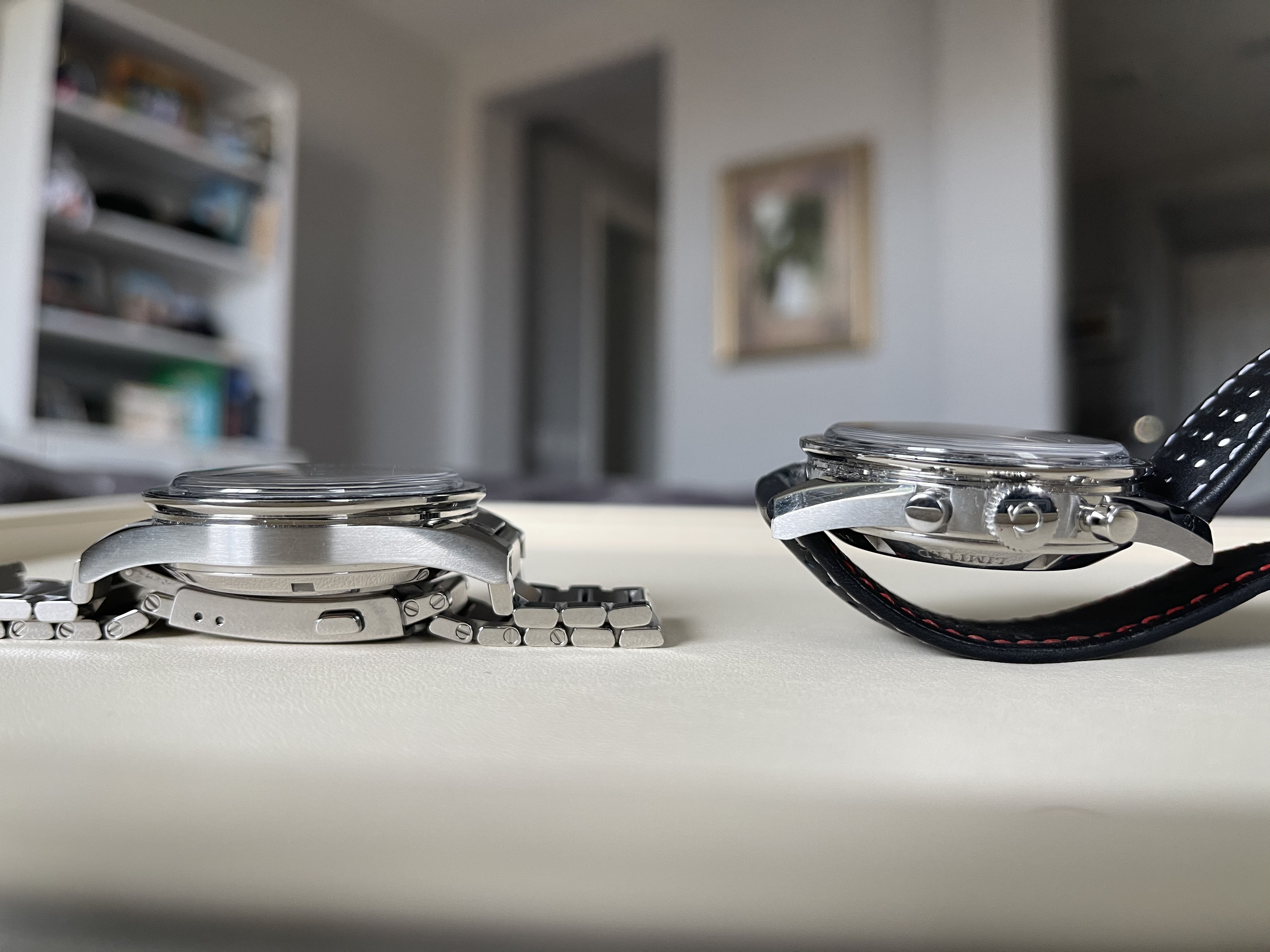

Since I own a variety of speedmasters including a 321 I’ll add some photos here that might help.
321 v 1861 hesalite
321 vs Apollo 11 50th sapphire
321 vs CK2998 pulsometer sapphire
I’d have taken nicer photos with a nicer camera but I’m lazy and this is what I have time for. Hope this helps.
edit:

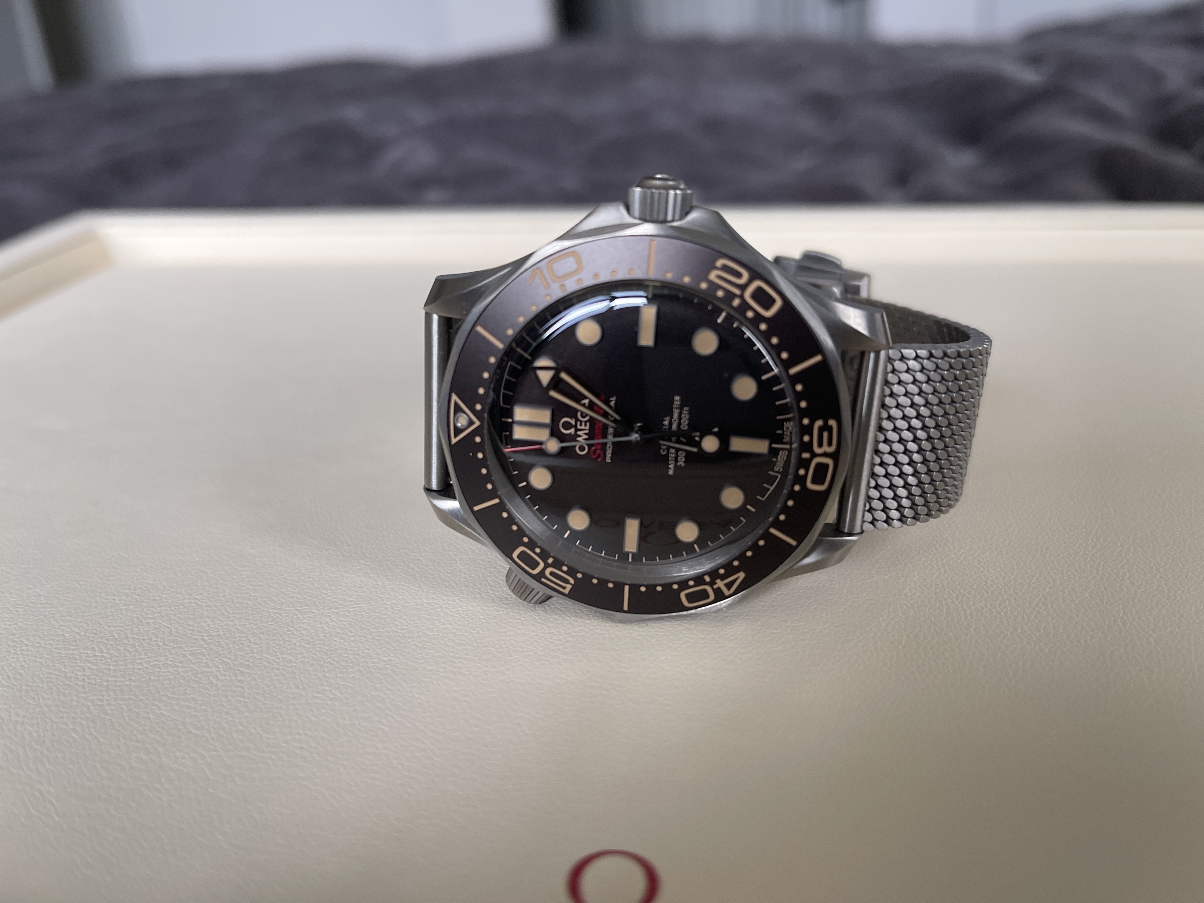

this NTTD also has omegas domed sapphire:

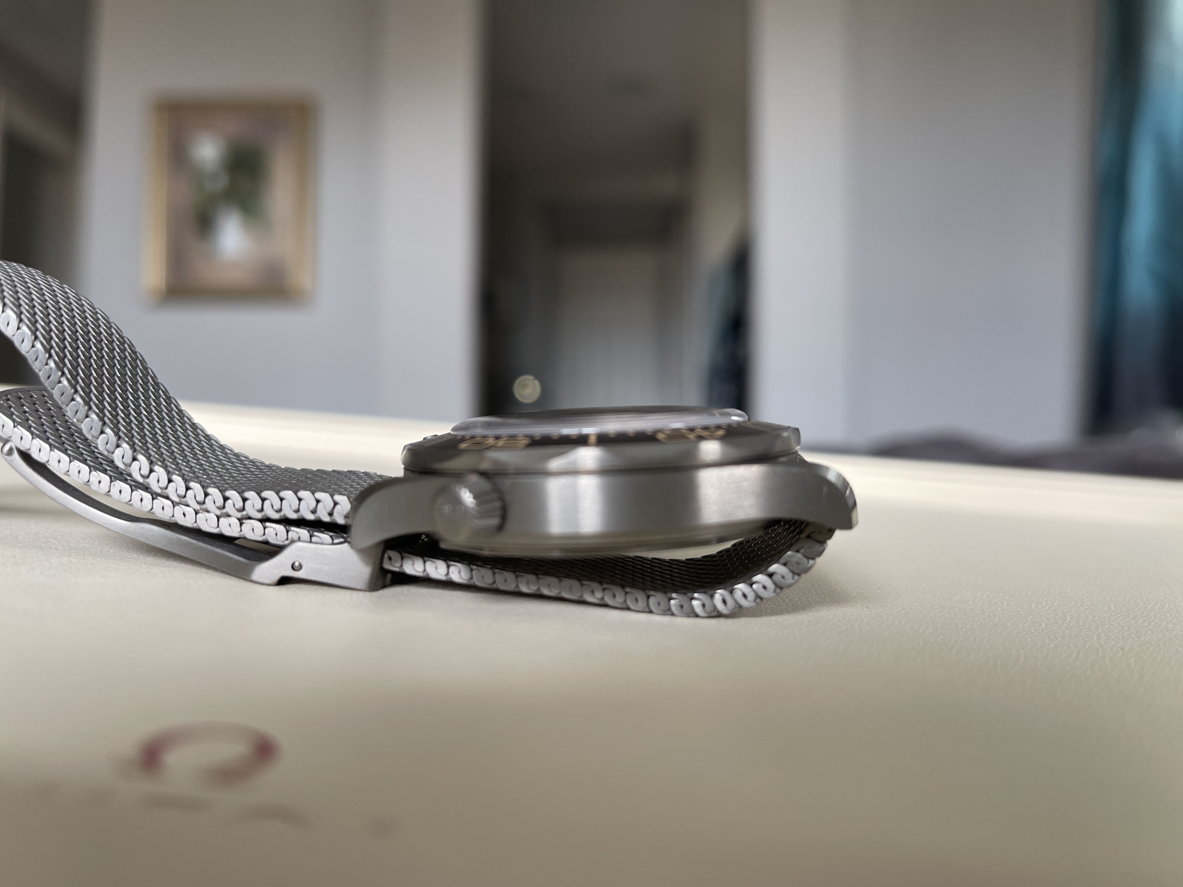

When I scroll through these comparison pics, it seems pretty obvious - to my eye - just how much the cal.321 lacks those qualities compared to other sapphire speedmaster offerings, and how much more similar the cal.321 sapphire appears to the plexi speedy offerings. Not complete in either direction, but worth remark.
