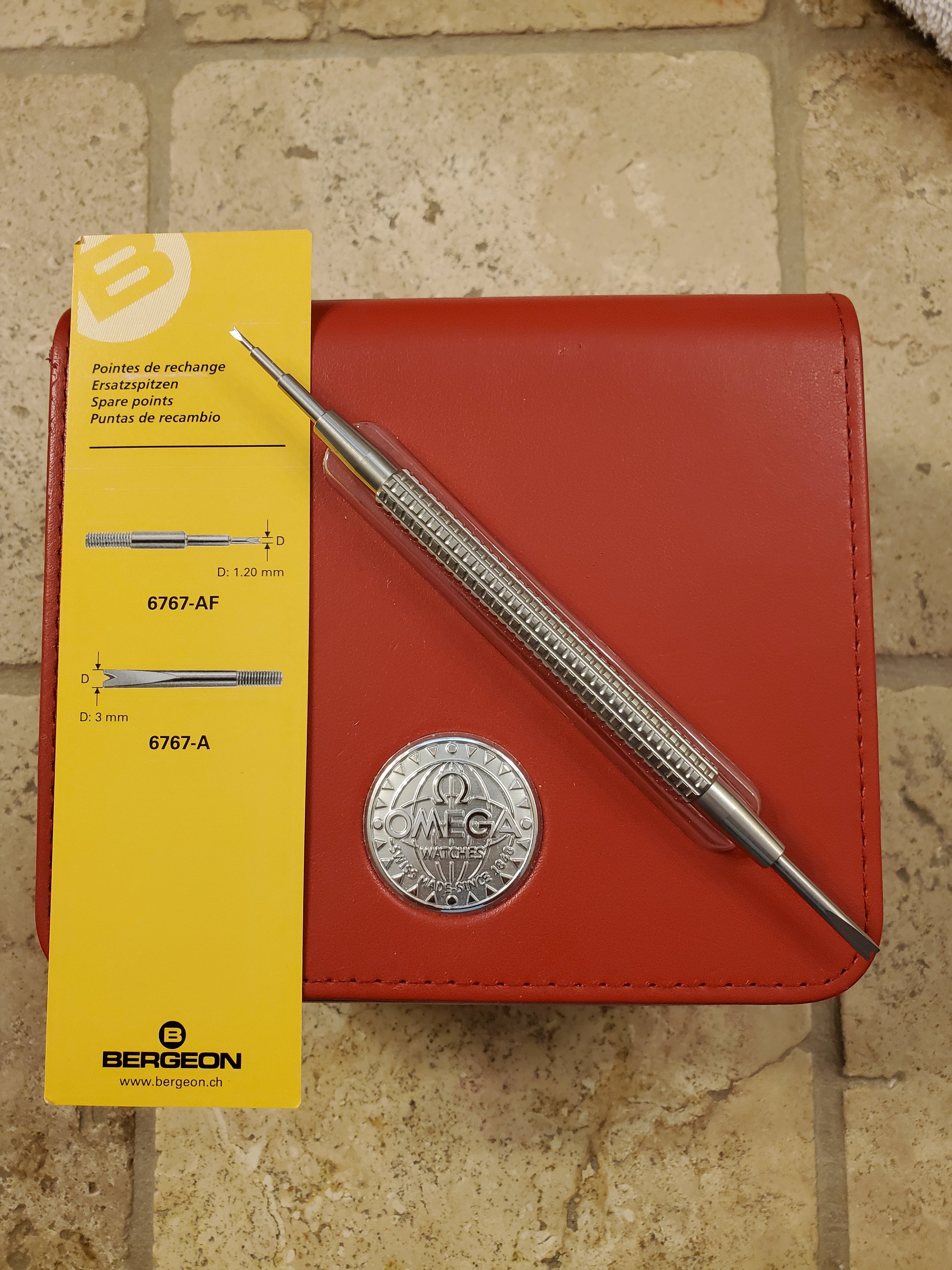

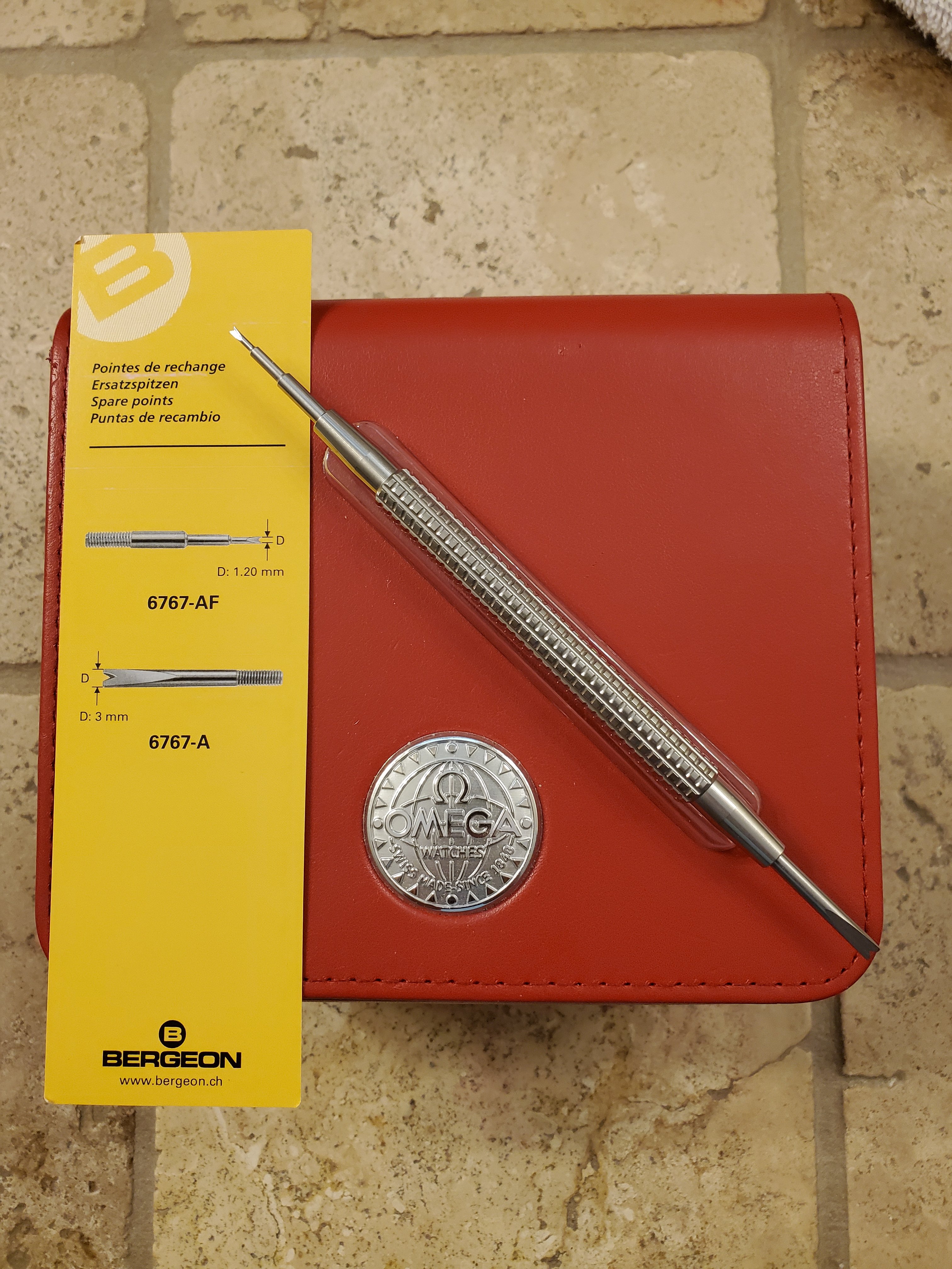

This Bergeon 7767-SF tool (specifically the end with the 6767-AF 1.2mm tip) is great for bracelet/endlink removal.
I've used it on my Speedmaster and a 60's era Seamaster. Very easy to use even for a novice. As mentioned, taping the lugs with some thick painters tape that won't leave a residue is good insurance in the event the spring bar does not want to cooperate.

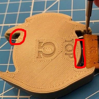

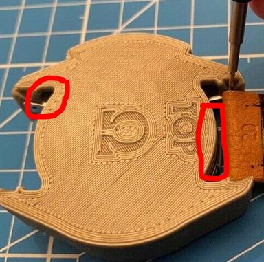

Someone on Ebay is selling these. They are made for the 1861 and not sure how they would fit on a new speedmaster. There are a couple of areas (circled) which still expose some of the watch. The creator told me it was to accommodate the tight fit of the bracelet .
That looks great, I hope it fits the 3861.
Thanks very much for the link! I left the seller a message asking if it fits the 3861 or he’s making one for it
