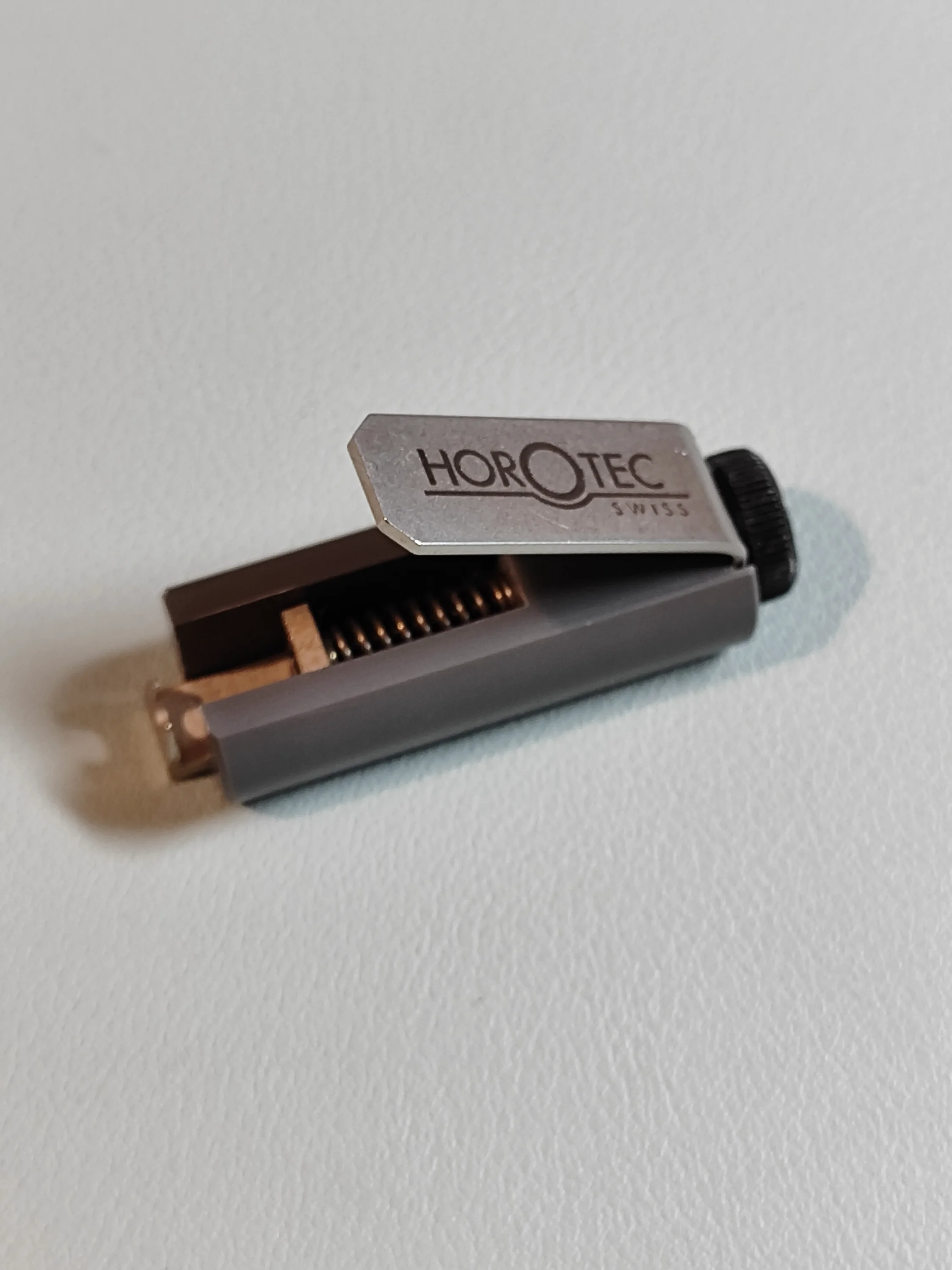

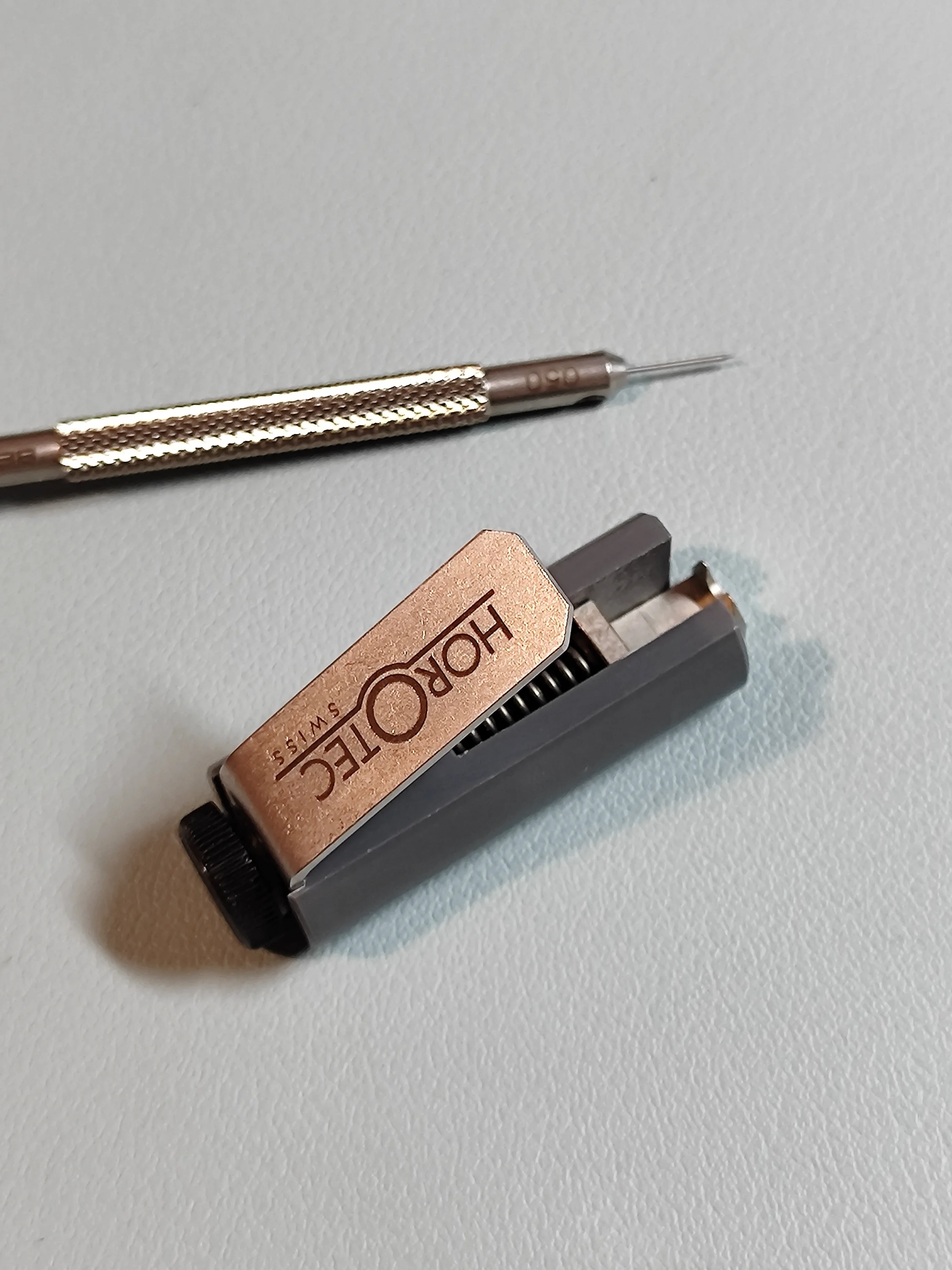

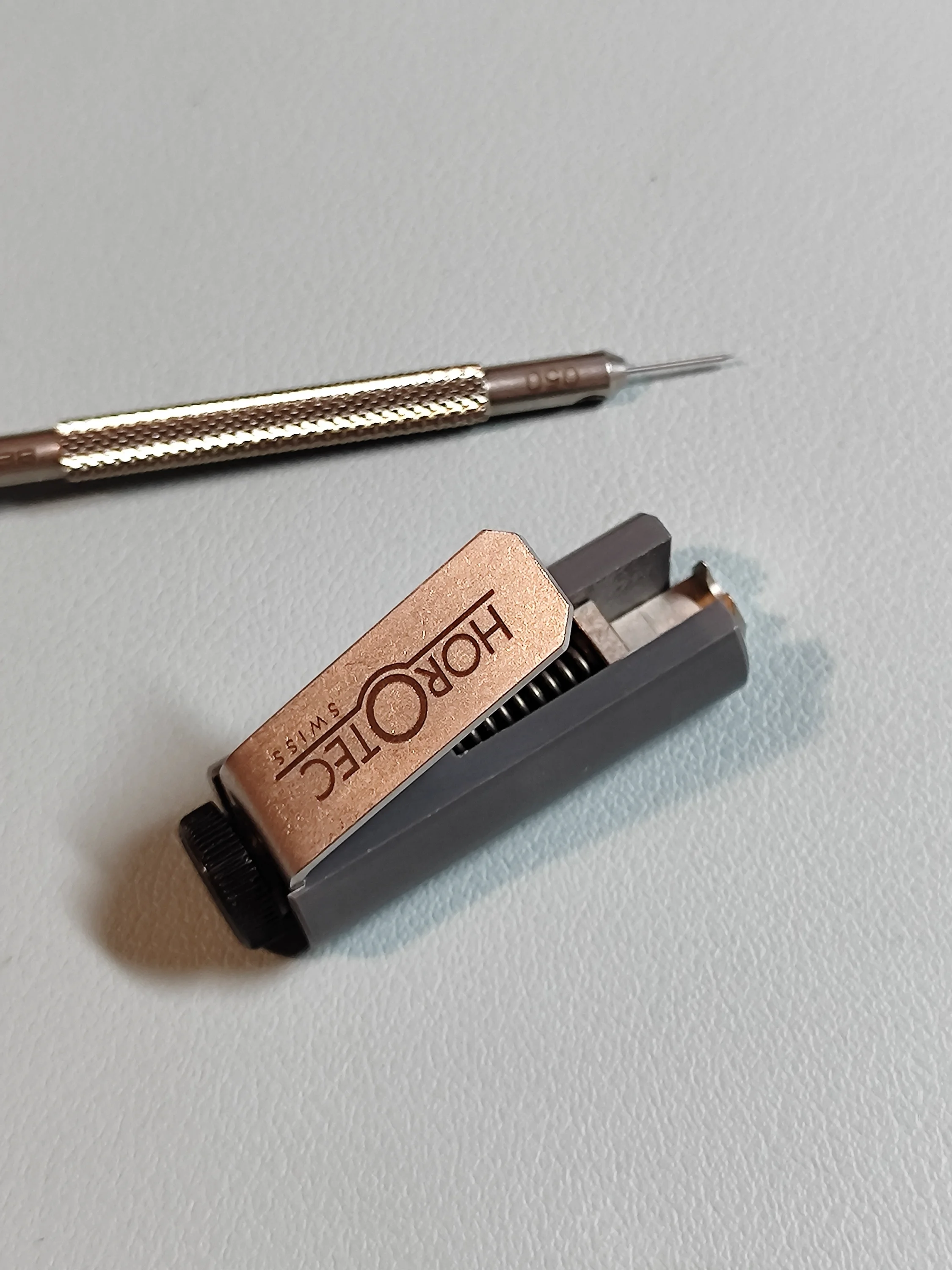

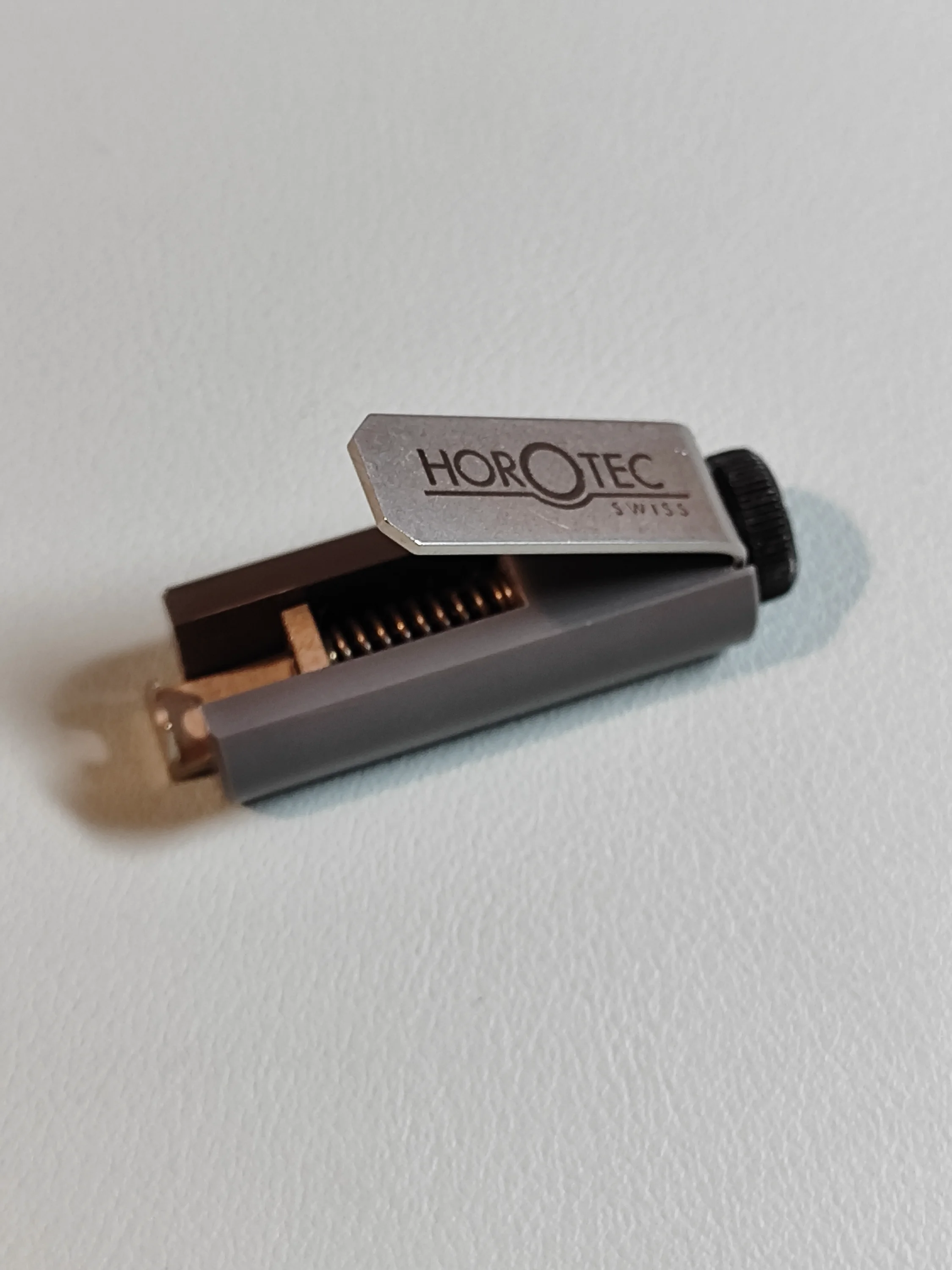

To anyone wondering, here's what the Horotec MSA03.604 looks like. I imagine the Bergeon looks and works in a similar way.
It's much smaller that I had imagined. You hook behind the crown and push on the spring loaded lever to pull it off. That's it. It has a screw that pull or pushes the metal hook to match the depth of the crown.
A good tool to have around, but absolutely not necessary. A beefy presto tool will work the same. If it was like 40 bucks tops, I'd be happy to recommend. For $70+? Get a Bergeon 30637.2, since it costs the same and does double duty for the cannon pinion.
