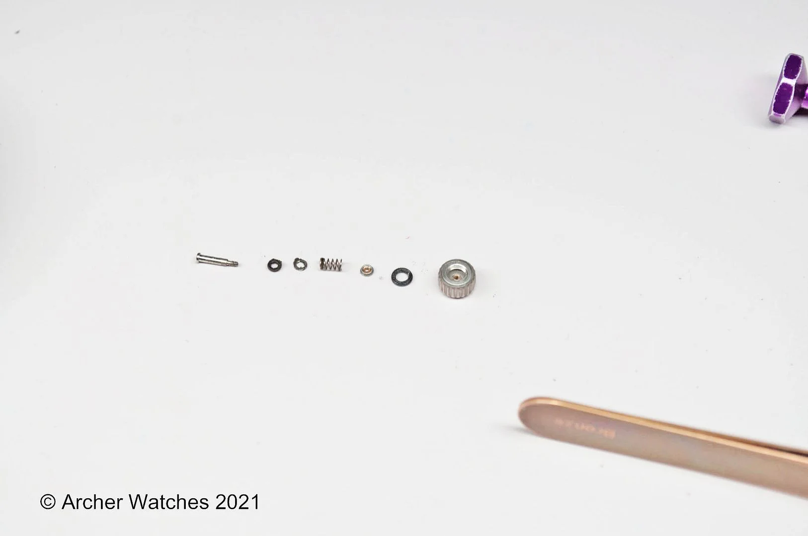

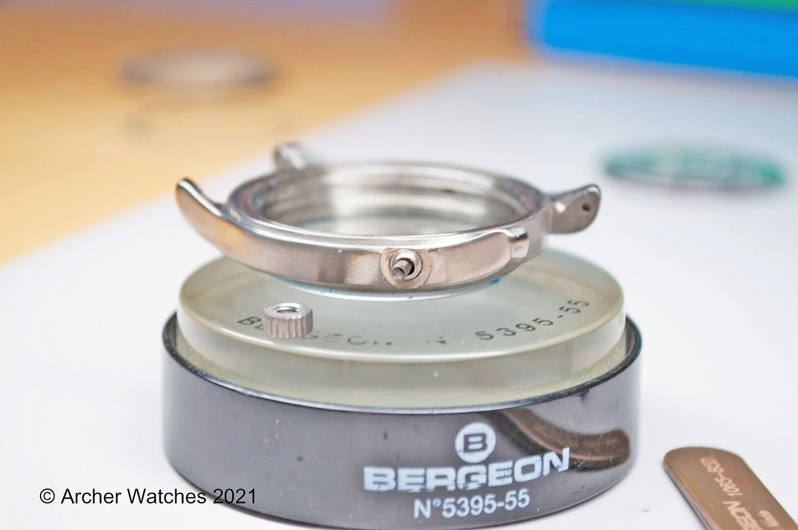

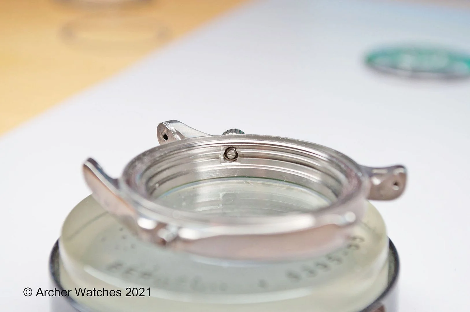

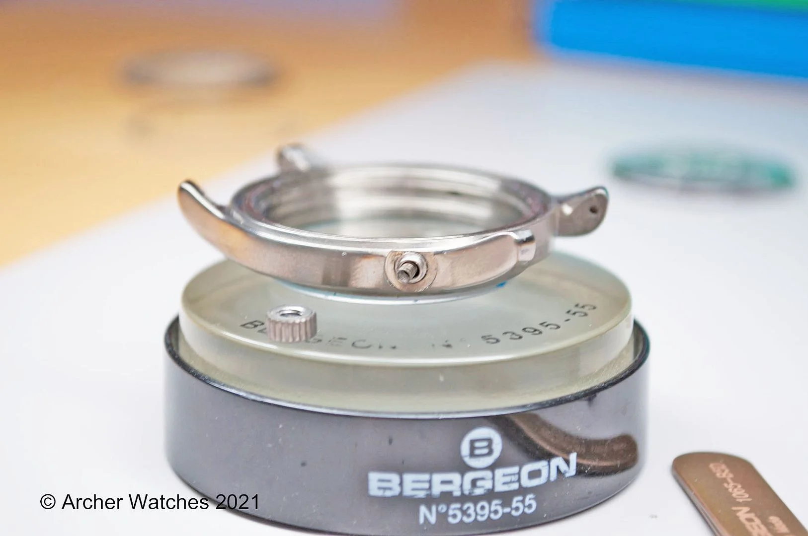

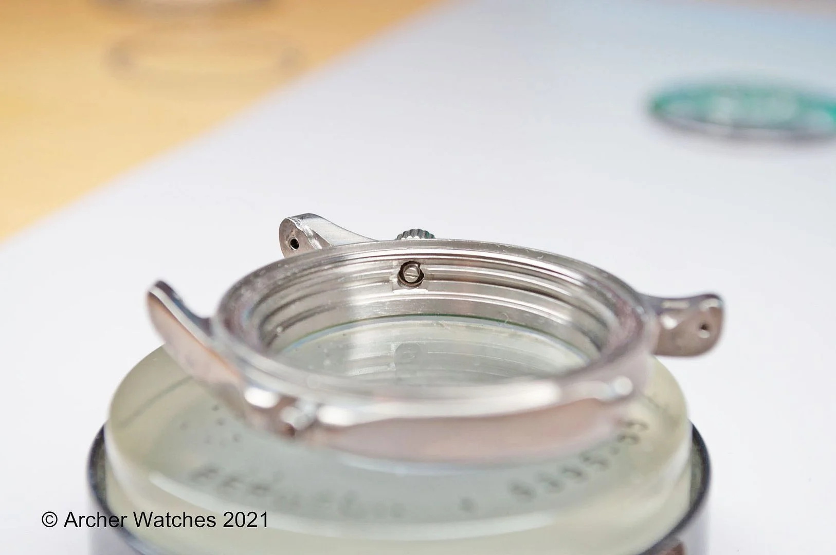

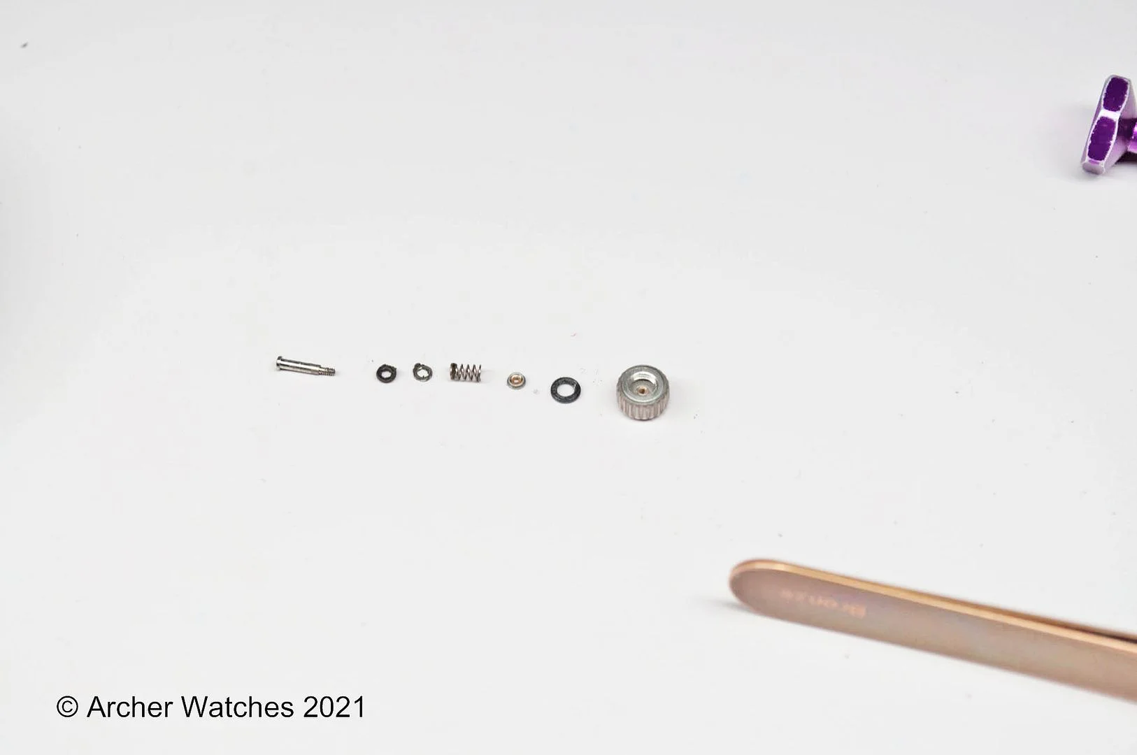

Well, there are generally 2 versions of the HEV that Omega has used. One can be disassembled and the seals changed inside it, and the other "cannot" but it really can if you are very careful. The original HEV's were easily disassembled so the 2 seals inside could be replaced, and the primary HEV tube is not removed from the case unless it is for other reasons. Here's an example of the HEV being disassembled:
You unscrew the cap from the inside...the main tube that screw into the case remains in place:

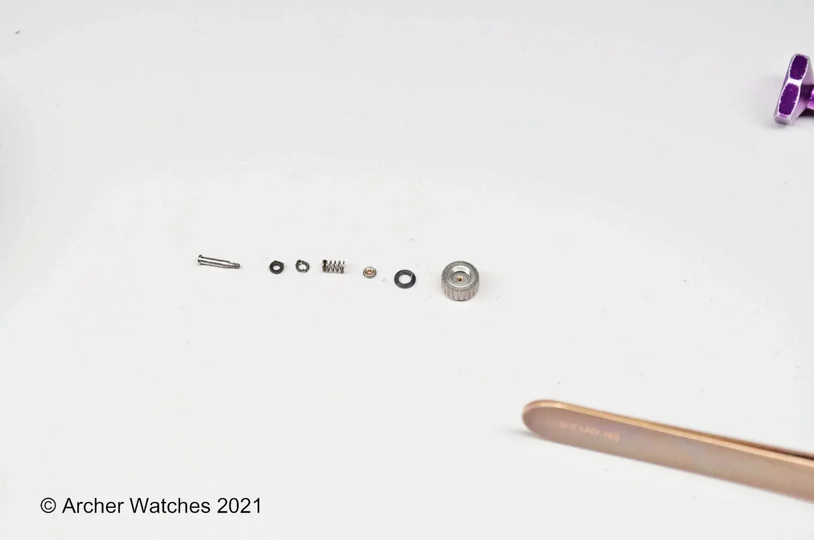

Now the seal inside the cap and inside the tube can be replaced, and all the other parts put back:

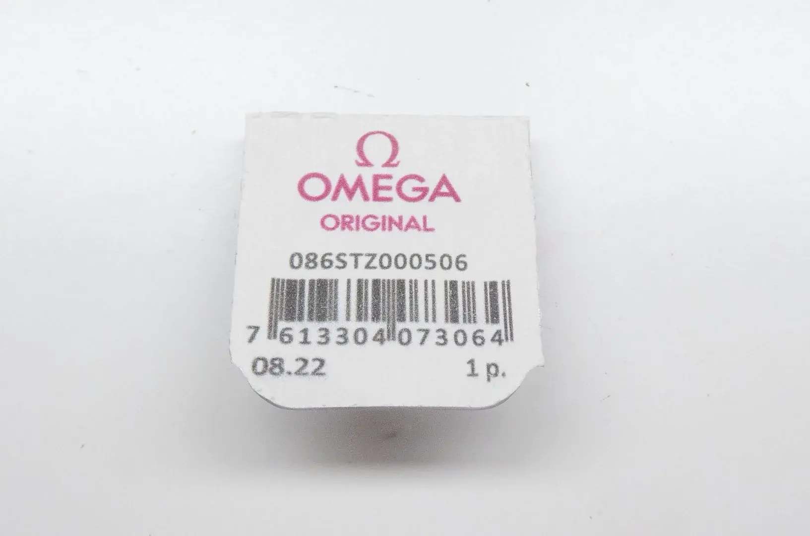

The old style use a regular right hand thread on the screw that holds the cap in place, so there is only one screw slot in the ehad of the screw. The newer versions use a left hand thread, and to identify that they put 3 slots in the screw head - this is a new HEV assembly and the slots are visible through the unopened package:
Since Omega generally refinishes the case, they remove the complete HEV including the tube in the case rather than just disassemble it, to facilitate that refinishing. When they do that, they automatically replace the HEV with the latest style. There's no real "need" to replace it because of the valve itself, but they replace it because they remove it for refinishing - that's the most common reason.
If the watch is getting a paid service, this is included in the standard price - it should not be an extra charge at all. It is treated just like the crown, case tube, pushers, etc.

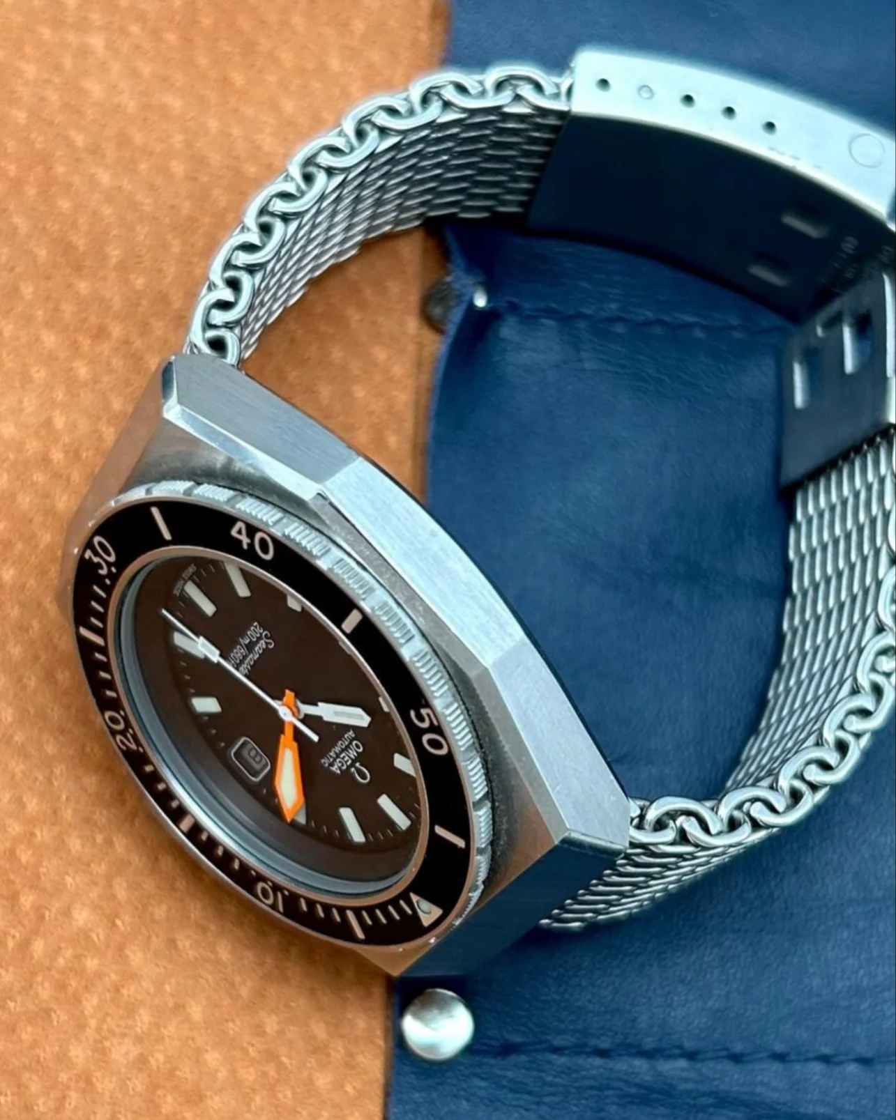

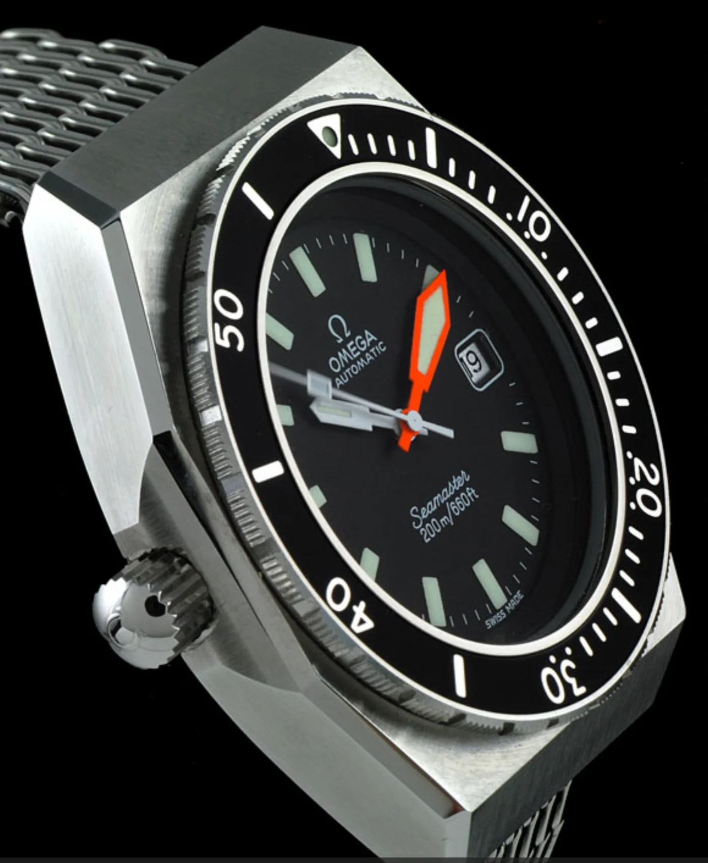

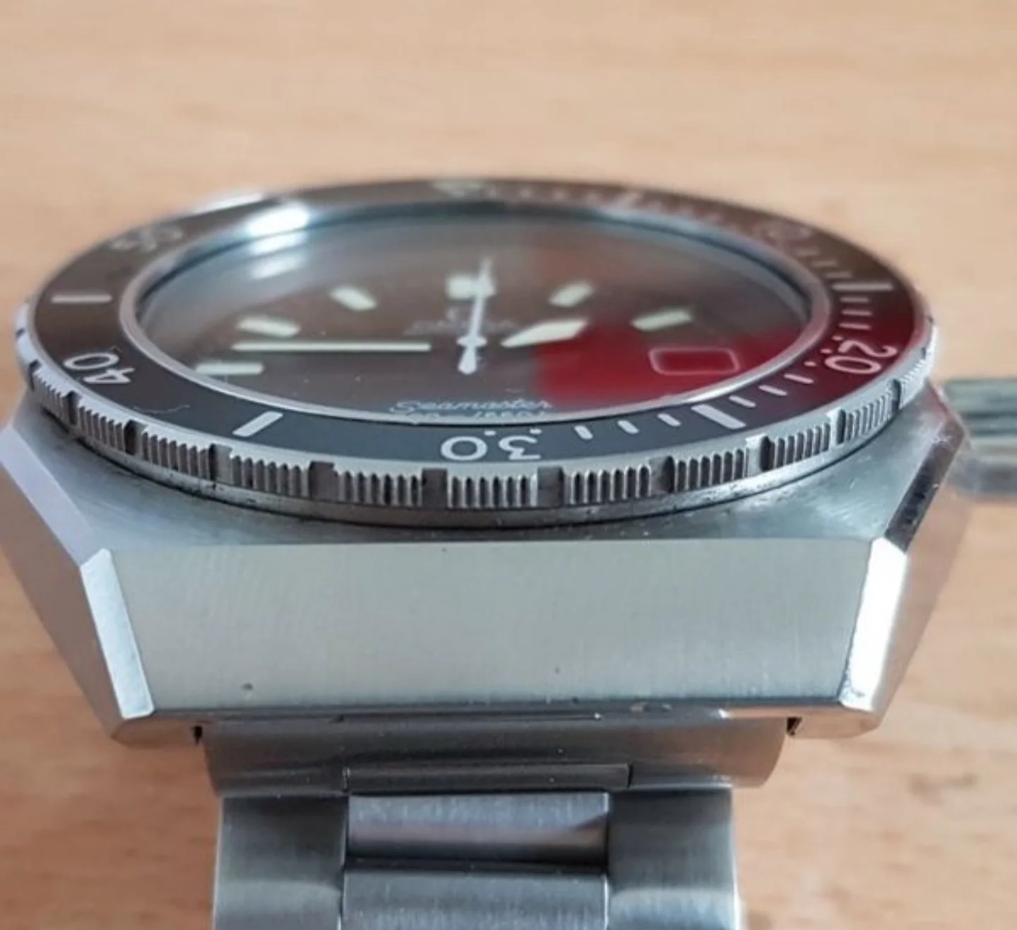

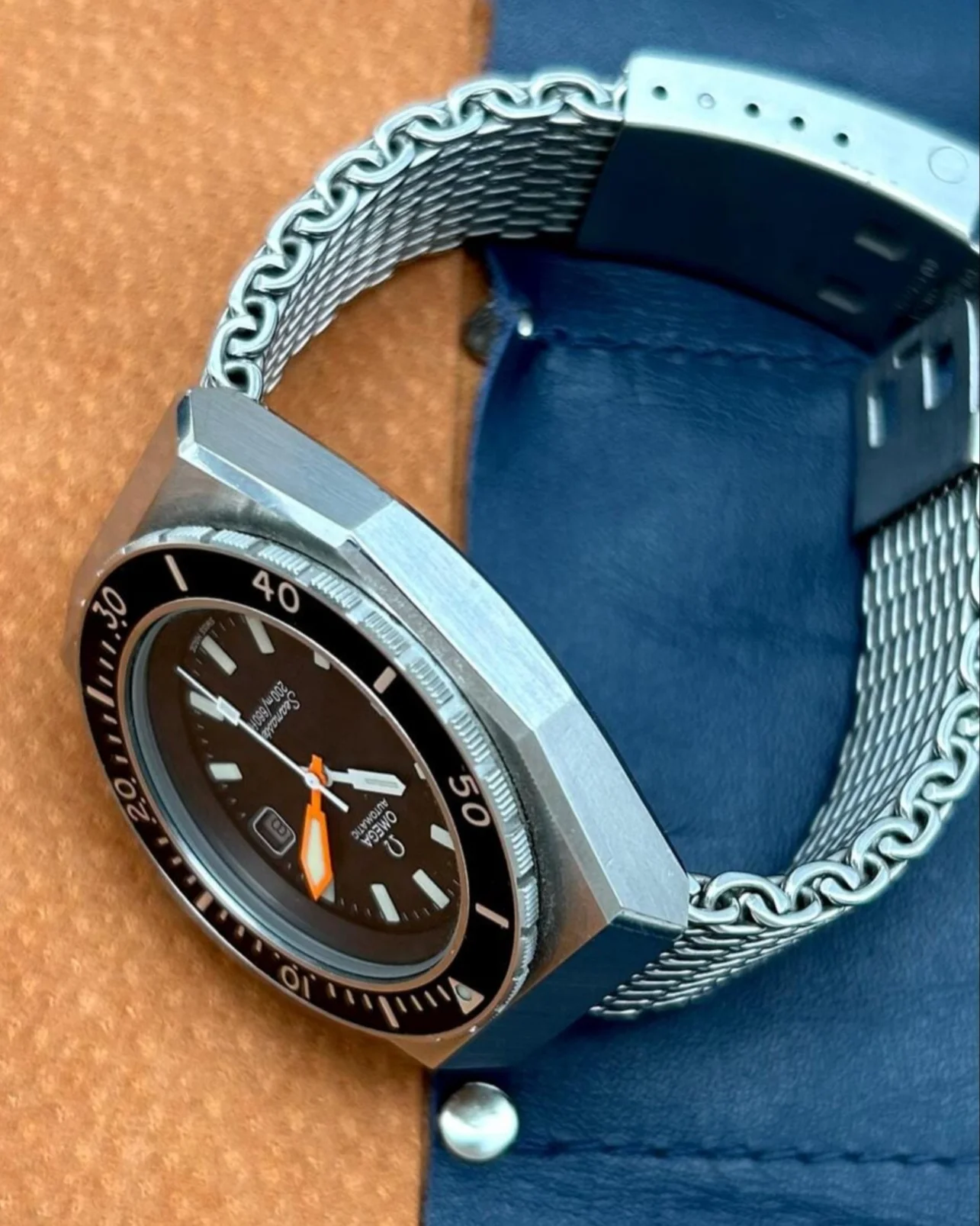

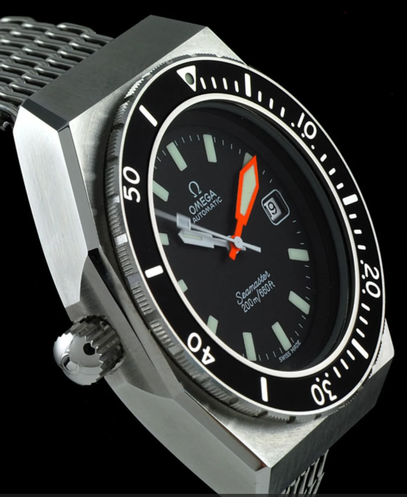

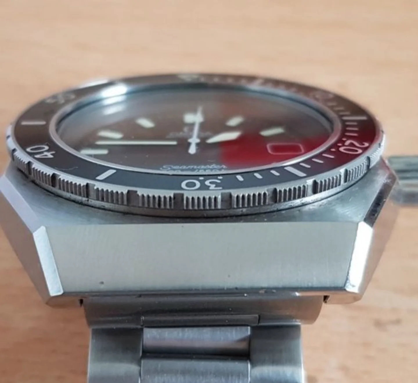

After looking the video and pics some more, looks like they took a lot of inspiration from the SHOM case (Service Hydrographique et Océanographique de la Marine) with all the angles.
The difference between the two is the SHOM had contrast with the brushed/polished case. The new PO is all bling.

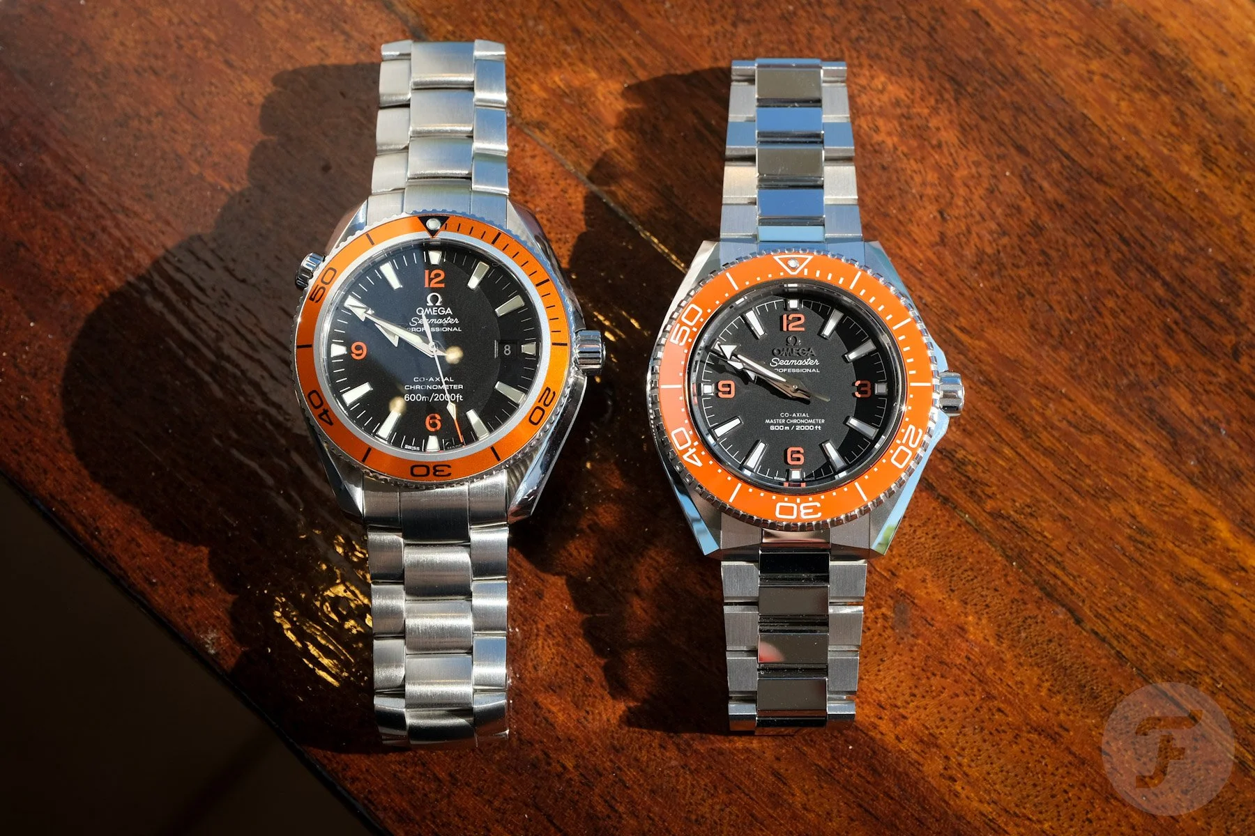

My guess is that the wider bezel is a necessity: If they have gone for a He-safe design (as the removal of the HEV would suggest), it may be necessary to use a different crystal fixing system involving different gaskets and some kind of retention ring. The bezel has to be wider to cover that. I guess this is the case for the Ultradeep too.
So, this sort of makes sense to me on the surface level, but makes me ask: what's different about the SM300 heritage? It genuinely does have a larger dial and smaller bezel (steel ring included) and no He valve.
To me, this (the PO) looks like they followed the bezel proportions on the UD a bit more closely. it lines up a bit more with Rolex's diver proportions, which have always seemed a bit off to me.
That said, the dial proportions themselves on this PO don't seem out of balance to me, so the bezel generally works. I'm not the biggest fan of big bezels but it seems like some people like them.
440
573

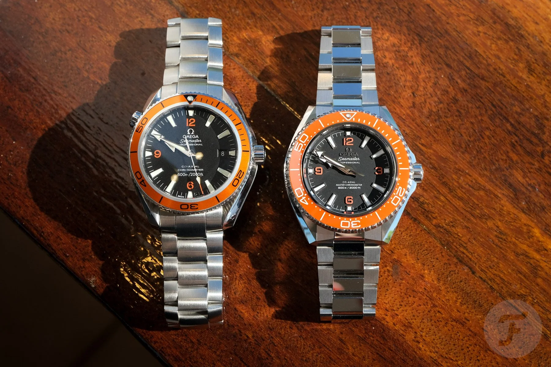

I think the bezel is about the same size as the previous gens, except now they got rid of the fake ring that gives the illusion of a smaller bezel in favor of the Rolex Sea-Dweller style bezel markings.
Maybe this picture shows better what I was trying to say (badly, I'm not very good in English, sorry) about proportions between dial and thickness of the bezel (©Fratello)
