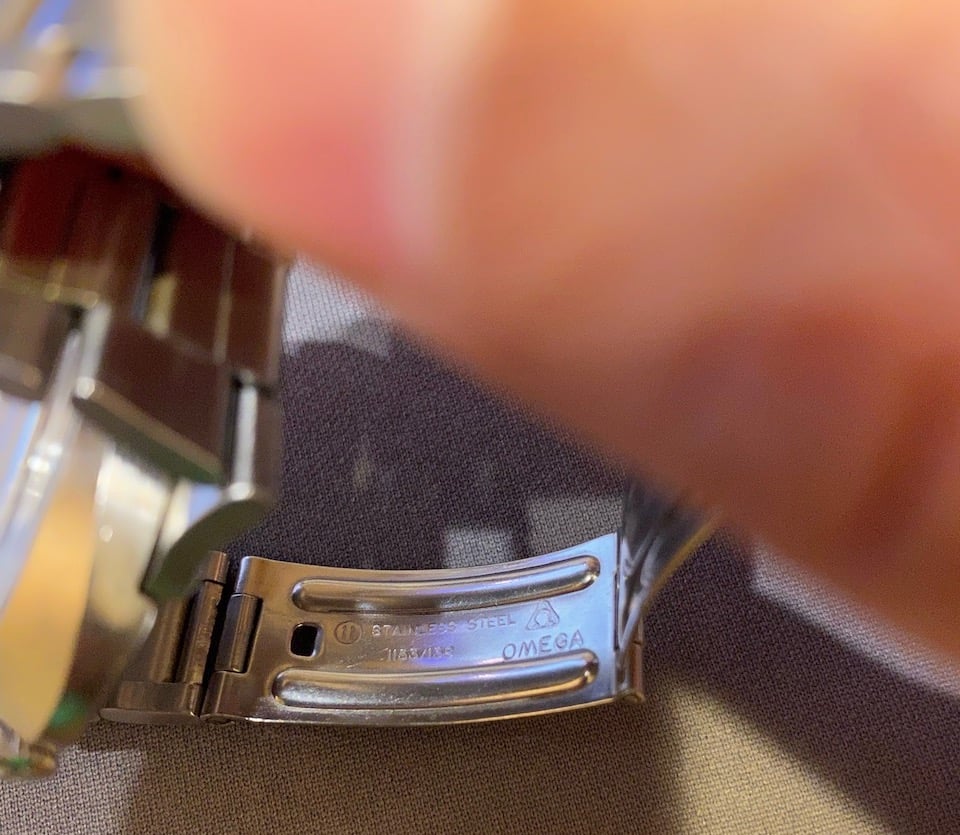

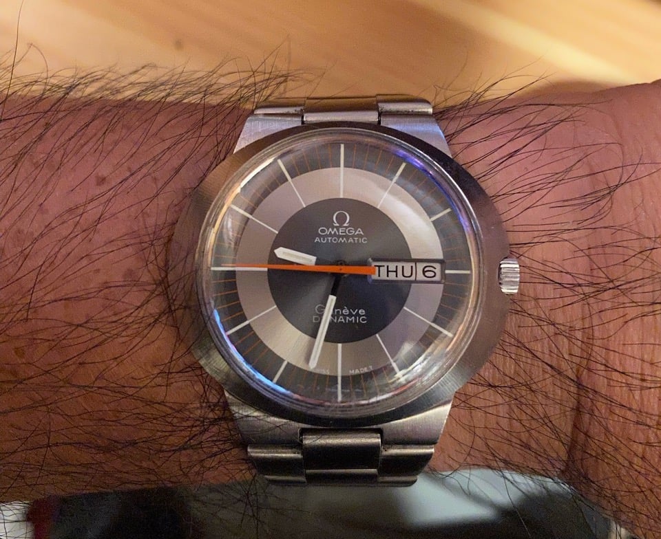

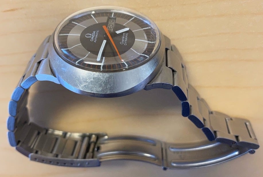

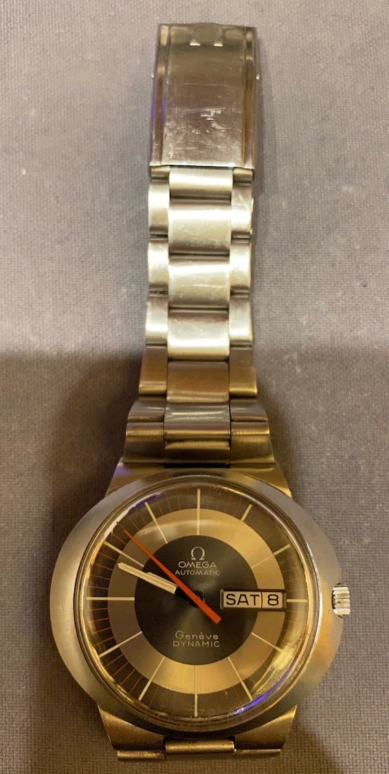

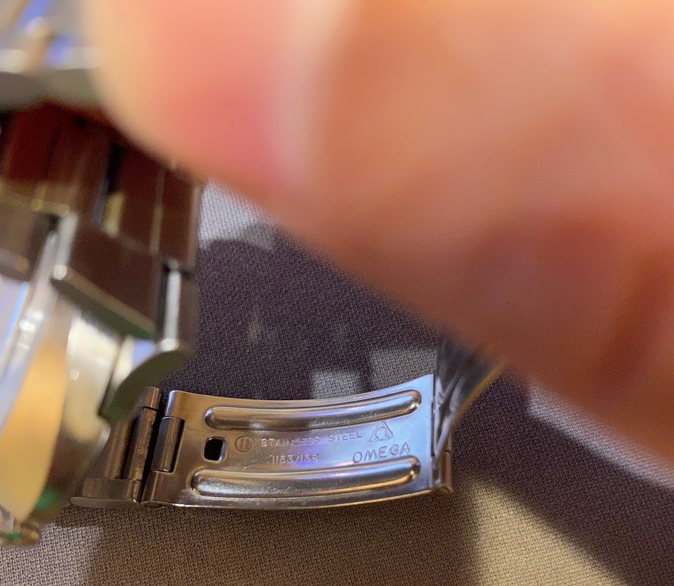

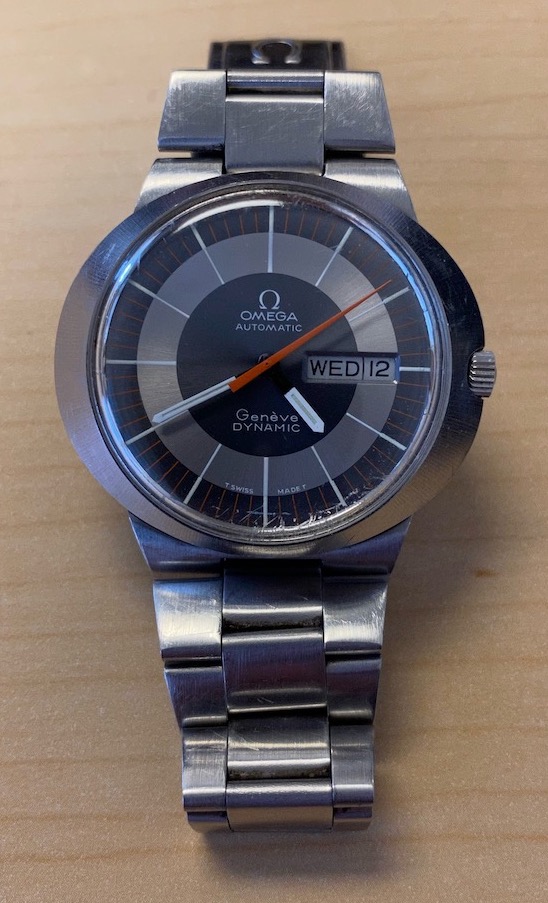

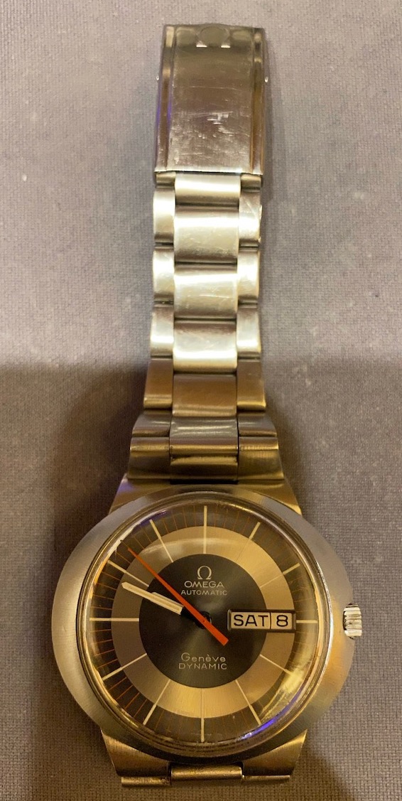

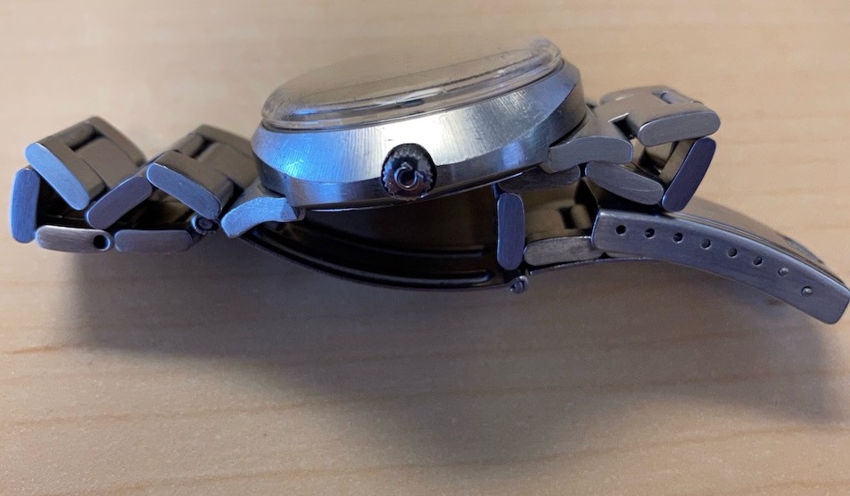

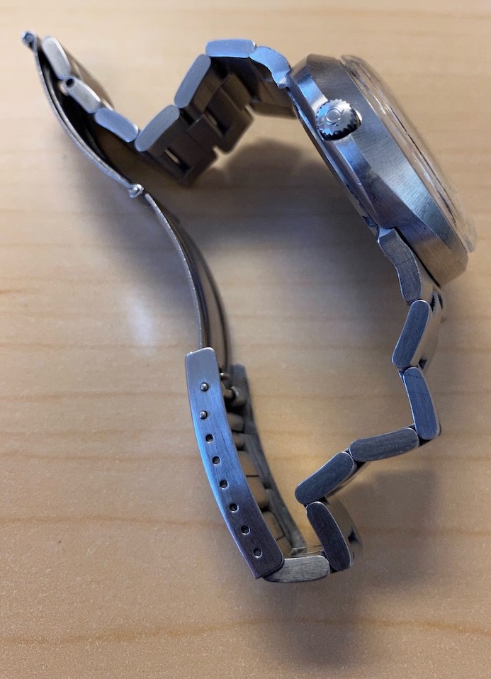

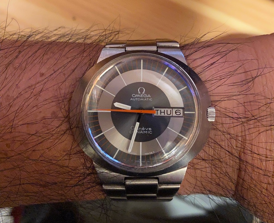

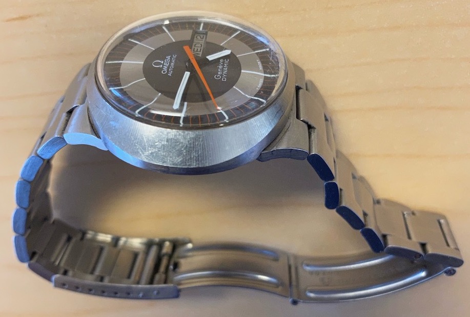

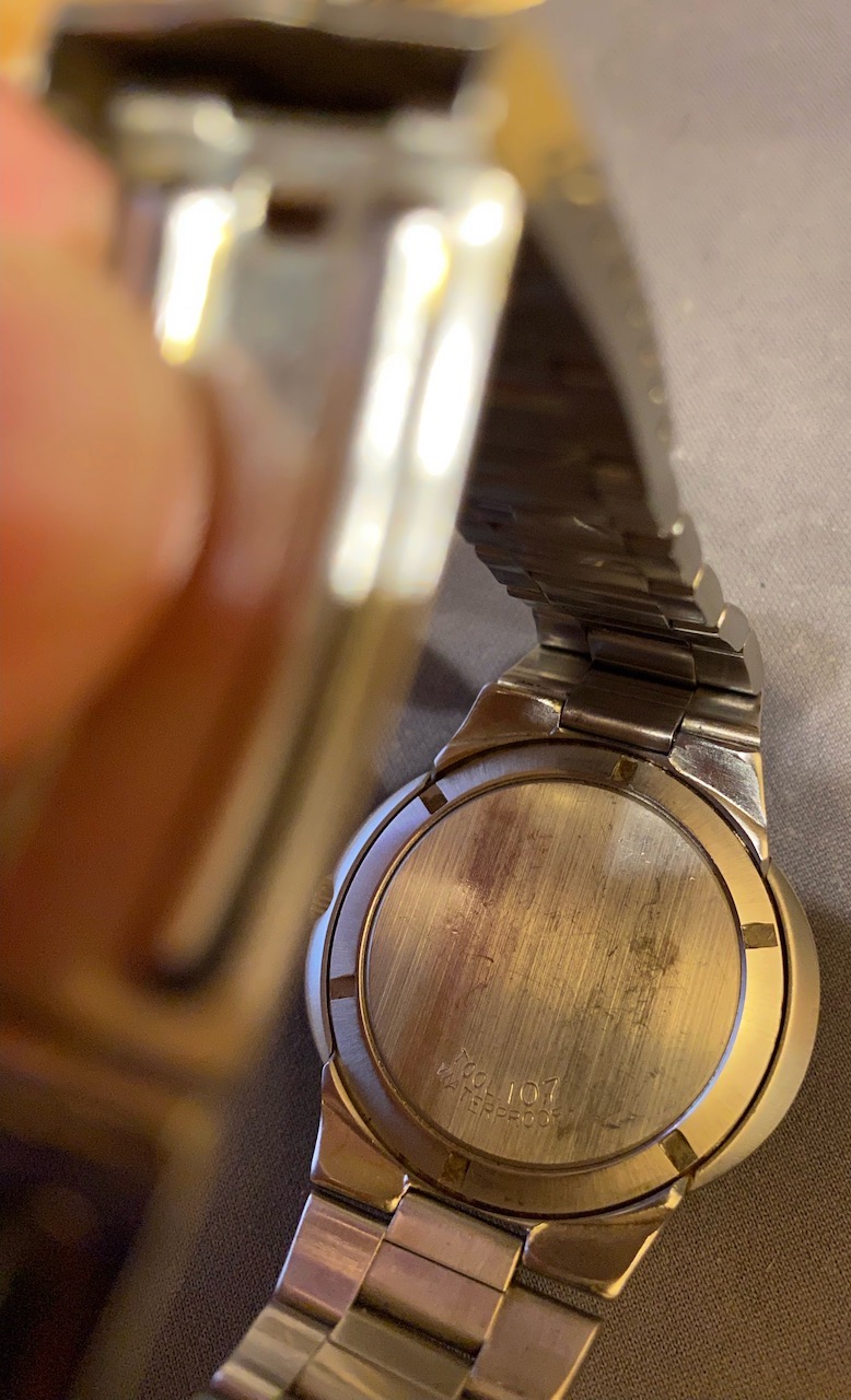

As far as I can tell, this looks like a reference 166.0079 (also seen it as 166.079 in many places) with the 752 calbre day-date movement. Again purely based on what I've read and what I can see on the exterior of the watch, it looks all original (but certainly if anyone sees anything that stands out, please point it out!). My dad said it came with both the "leather" (Corfam) and steel bracelet; he has no idea what happened to the Corfam one over the years, so it just has the steel one. The watch winds easily using the crown or via the automatic mechanism as I wear it, and setting the date/time seems to work consistently with how I've seen the 752 described (pull out one position to set time, no hacking, need to move forward 24 hours at a time to get the day of the week to advance, pulling out to the next position advances the day of the month by one number each time). The dial says T SWISS MADE T, and there is lume on the hands and hour markers that is very very dim, consistent with 50 year old tritium (gone through 4 half-lives at this point). If I shine a bright flashlight on the face, the lume will glow for just a few seconds before fading back to its very dim level. The crystal has the Omega logo in the center; not sure if it was replaced when it was serviced. It "looks" old to me, with some scratches and such, but I have no way of knowing. Similarly, the crown has the Omega logo on it, but I have no idea if it was replaced on servicing. The case and bracelet overall have a number of scratches and wear on them as well, but the sunburst finishing on the bezel is still there, so whoever did do the servicing didn't do any polishing as far as I can tell. Heck, all of the scratches could have just come from rolling around in the box with the other watches - all the wear on the caseback looks like it just came from the bracelet rubbing against it. 馃榾

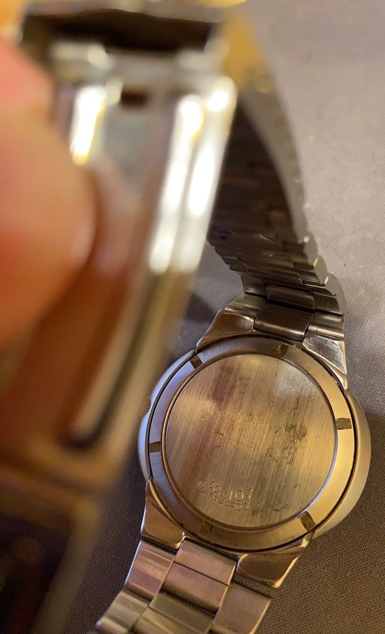

I have not yet opened up the watch (and I do not have the tools/skills to do so, especially with it needing to get opened from the dial side), so I cannot verify the condition/originality of what's inside to get the serial number and other markings off of the case interior. The watch does run consistently over the few days that I've worn it. Seems to gain a little over 20-25 seconds per day, and it did the same when I left it sitting on its back (crystal up) on my desk to check power reserve (it ran for 49 hours and 15 minutes). I have not yet gotten any kind of actual time grapher measurements to check actual gain/loss, amplitude, etc nor have I done any real study of how much time gets gained/loss in different positions.
I know many here would recommend that I get the watch sent in for service, and I'm looking around at options both via mail in services as well as in person in the northern Chicagoland area. I've perused some of the threads that talk about service recommendations, but if anyone has ones that they'd like to share, I would love to hear. I would like to get someone who has access to Omega parts and who is willing to put up with my level of attention to detail without getting impatient/testy. I'm not too interested in making the watch look like brand new (after all, part of the charm is the vintage look), but I would like to do what's necessary to make sure that it's mechanically sound and clean since I do want to wear it regularly and have it stay reasonably on time from day to day.
OK I think I've blathered on long enough, and it's time to attach some photos. I know the lighting isn't ideal on a many of these, so if there are particular angles that people might want to see in more detail, let me know and I'll try to get some better shots with an actual macro camera. I will say that the wrist shot makes it look a lot bigger on my wrist than it actually is just because of the angle of how close the camera on my phone was.
Once again, thanks much for reading this far if you made it this far, thanks as well for all of the educational material on the forums and links to other sites, and thanks in advance for any specific input/insights that people might have about this watch in particular!

Having watched my watchmaker open up one of these (I have two manual wind ones myself), I would not recommend trying yourself. Leave it to the pro. One of the benefits of the Dynamic design is that they're extremely hard to mess with, so they're unlikely to have non Omega parts.
Yours looks fantastic and probably only needs a quick clean (bracelet and case into the ultrasonic) along with the movement service.

Treat it well and it will last another generation or more. That's the lovely thing about a well-made watch. Great story!
2,012
3,409
Great intro, welcome to the forum. I love a good Dynamic, and this ticks all the right boxes. As opposed to many of these I see on the bay, yours has hands that touch the edges correctly 馃憤. Have it serviced and enjoy it.

Welcome! Great watch and backstory. I've not used their services myself but MJ Watch Service in the Chicago suburbs is sometimes positively recommended on these forums so you might want to check them out for a local option. I believe they have an Omega parts account.
197
255
Thanks for the mention of MJ Watch Service! I've sent them along with a number of other folks a list of questions and such. Obviously no one can (or should) give a detailed estimate without actually examining the watch, but this will be a good start to get initial impressions, very rough/ballpark cost neighborhoods, and start building relationships.
