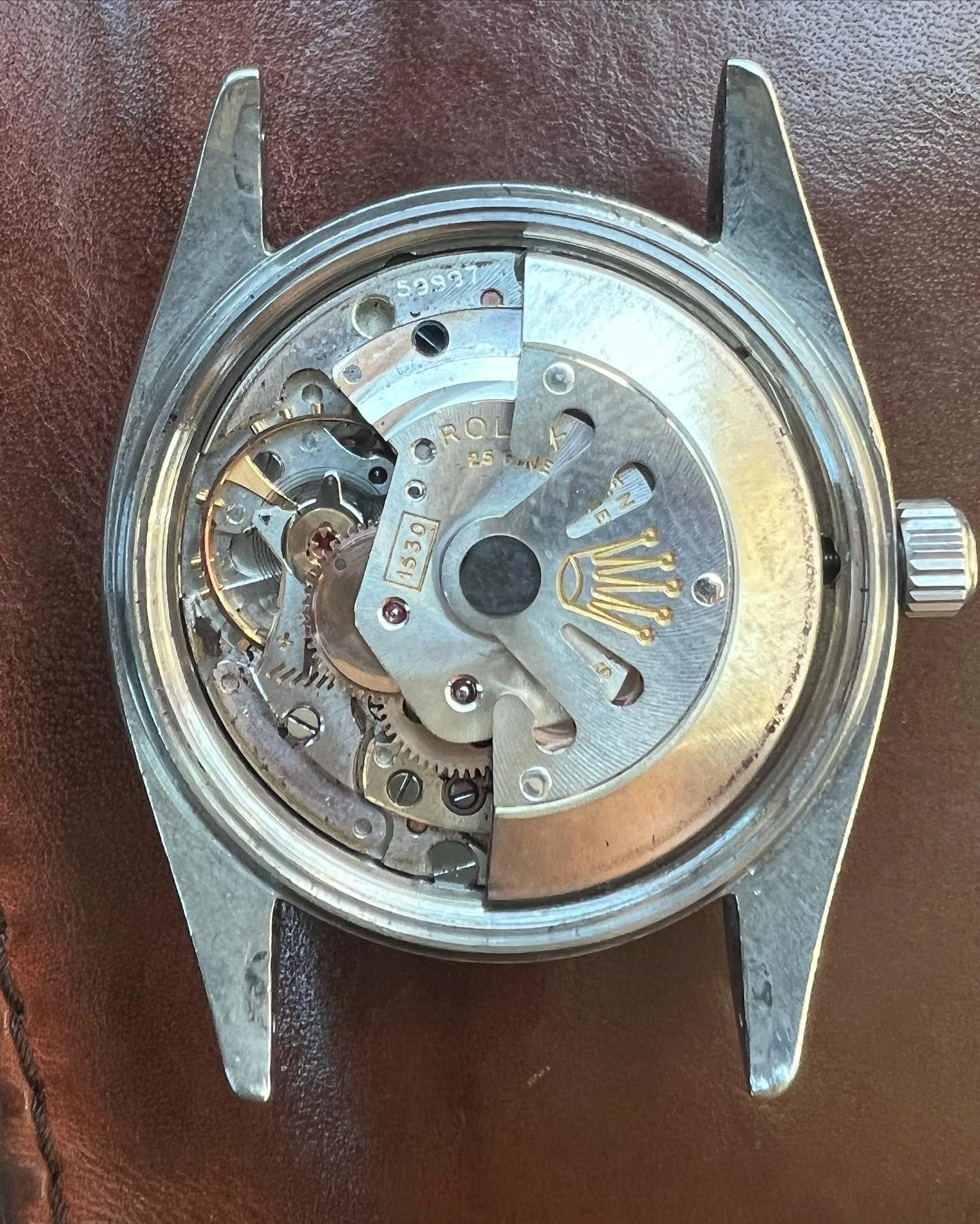

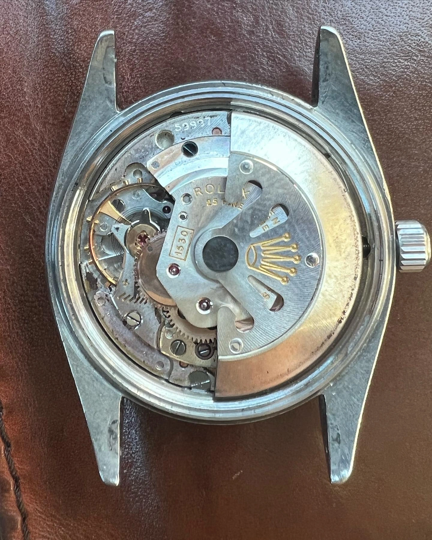

I love to travel with my 1959 Air King and that 1530 loses a fair bit of time.I had it serviced a year ago at rolliworks. These calibers are super accurate but difficult to regulate. It’s a minor annoyance,
