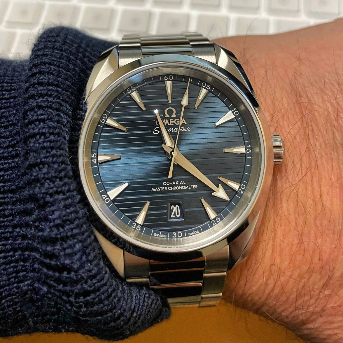

I just got a new Aqua Terra 38mm from an authorized dealer. I wound it about 40 times, have been wearing it every day and putting it on a watch winder at night, but it’s losing about 2 seconds a day, which I think is outside of the METAS chronometer spec.
What am I doing wrong?
