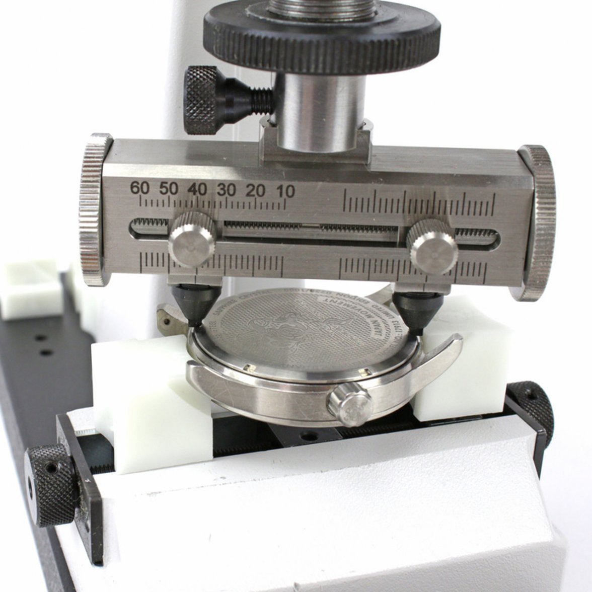

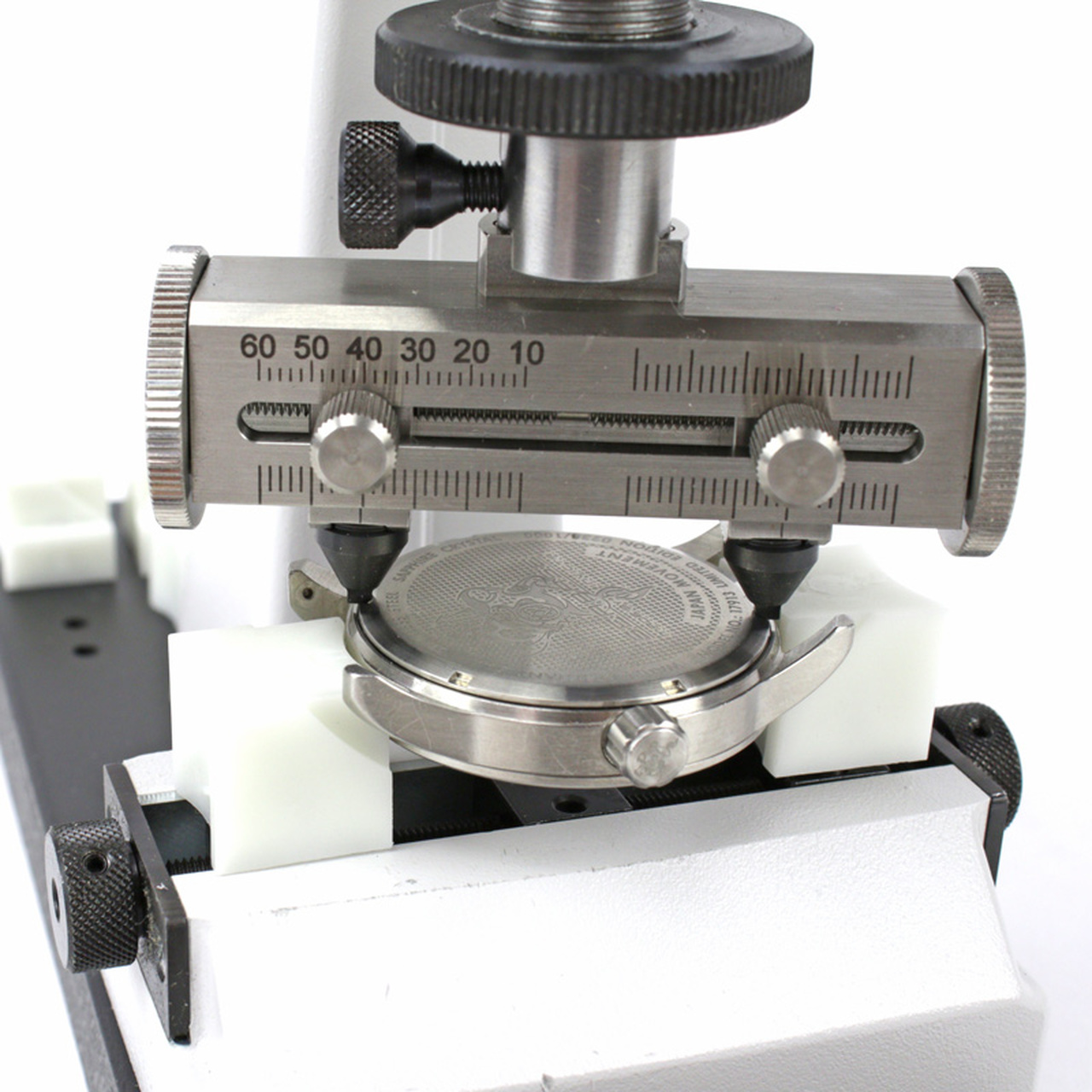

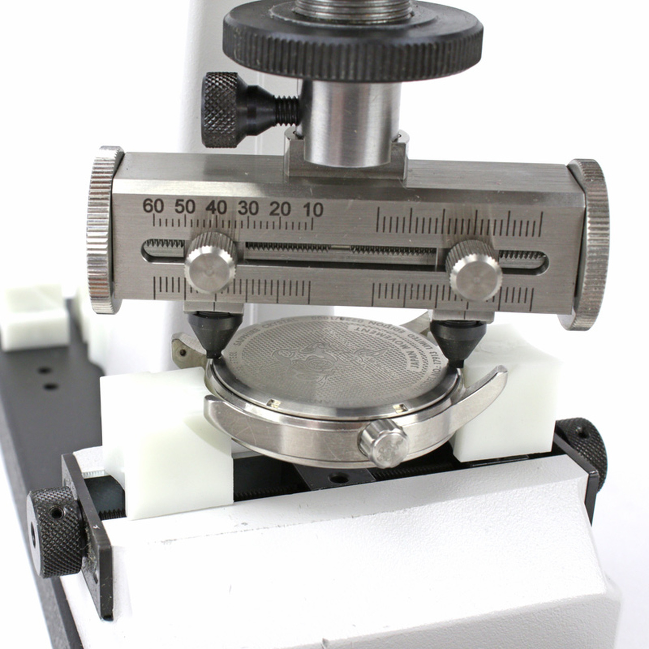

I use a Bergeon 5700. The vast majority of times the friction dies I have will open watches, but on occasion they won't. When that happens, I use plastic between the case back and the two pronged opener, as you can see here:
Note that the two pronged attachment I'm using here can be locked so those prongs to not move in the slots of the case back, and the red arrow points to the jam nut that holds the securely locked in place. The case back doesn't unscrew far because of the jam nut, but once it's broken loose, you can move the nut a bit and carry on unscrewing the case back.
Of course with a Rolex case back design, you can't really use plastic between the case back and the die like I have used here, so on those it's even more important to make sure the die can't slip and is held down firmly. I use Bergeon Rolex dies (they actually came with the 5700 when I bought it years ago), but they do work well. Of course making sure the case is held securely helps as well, but this vise in this unit does the job fine.
IMO anything that is just hand held is asking for trouble.
Cheers, Al

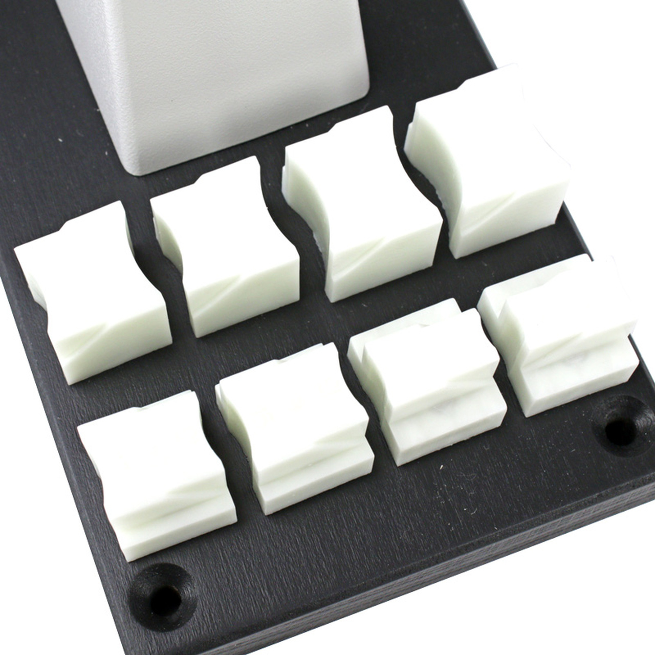

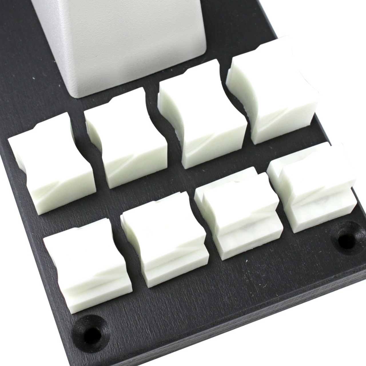

Okay, I totally misunderstood the term "die." What I meant to ask about are the nylon "things" that hold the watch case as the back is being removed, as in the photos below (Bergeon 5700):
I believe I've seen openers that use metal "things," and of course I've seen watchmakers use a "standard" case holder as in your photo (or maybe that holder is part of your Bergeon; I don't know). If you have the time/inclination, please elaborate on the best way to secure a case for opening. Thanks----------

The die is the part that contacts the case back, and the case holder holds the case. There are lots of different types of case holders, so the style on my 5700 is a bit older than the one you show as the pins are round plastic (with steel posts inside) and the newer style are more blocky in shape.
These rely on clamping the case in place, but brands will make profiled case holders a bit like Doug (Canuck) showed. Omega makes these and they are made of a hard plastic (thermosetting plastic rather than softer plastic) that simply cradles the case. These work great and I have some, but it’s specific to each case design, so buying these gets very expensive. Rolex has very limited case designs and sizes compared to Omega, so it would be easier to get them all for Rolex compared to Omega.
Now if you don’t have something like a 5700, you can buy case holders that clamp the case the same way mine does, but then that can be mounted in a bench vice. Once you clamp the case in the case holder, and then the holder in the fuse, it’s pretty solid.

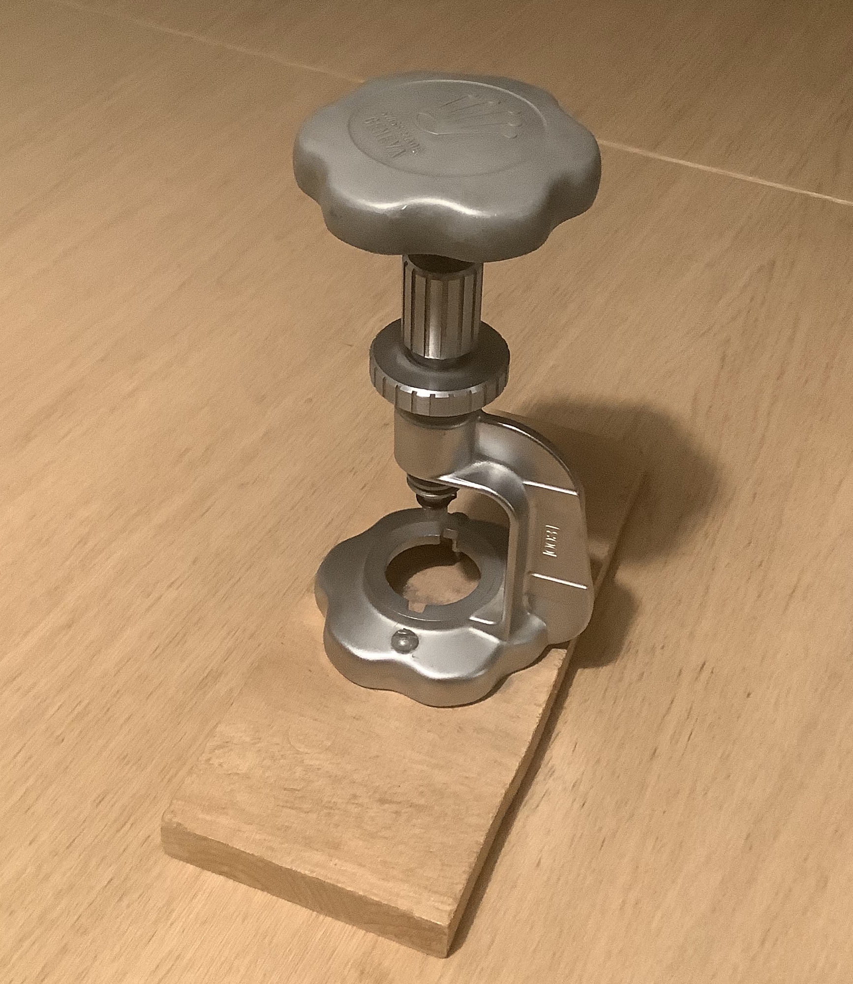

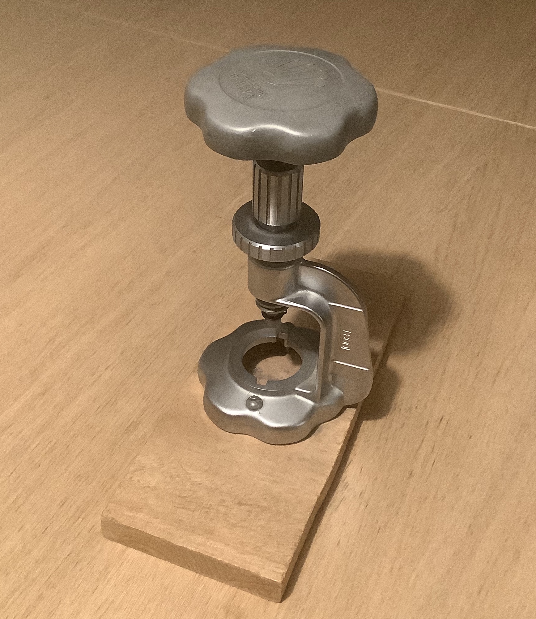

The best bet for Rolex and Tudor case backs. The Easy Oyster Opener. This tool is equipped with jigs to hold most Rolex and Oyster cases, as well as the proper “sockets”. Tend to be pricey.
Ok, now I really want one of those. There are some on eBay, but they are listed in the $3k USD range, and I don’t think any of them are even 100% complete.

I got lucky a few years ago with an eBay buy it now. Couldn’t resist it and it’s a great thing, but anyone paying asking prices must be a collector. As a tool there must be better options for far less. It came without the box but I found one of those a few years later. Now just missing the plastic trays, the manual, and the metal bar for additional leverage.
