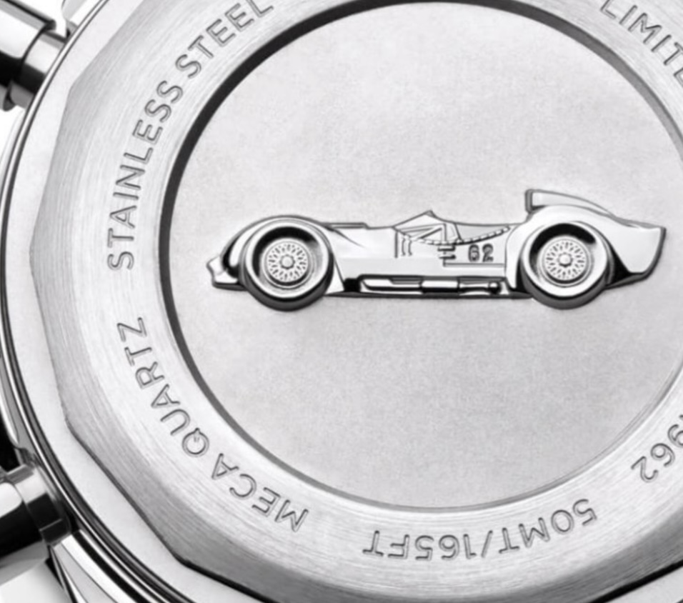

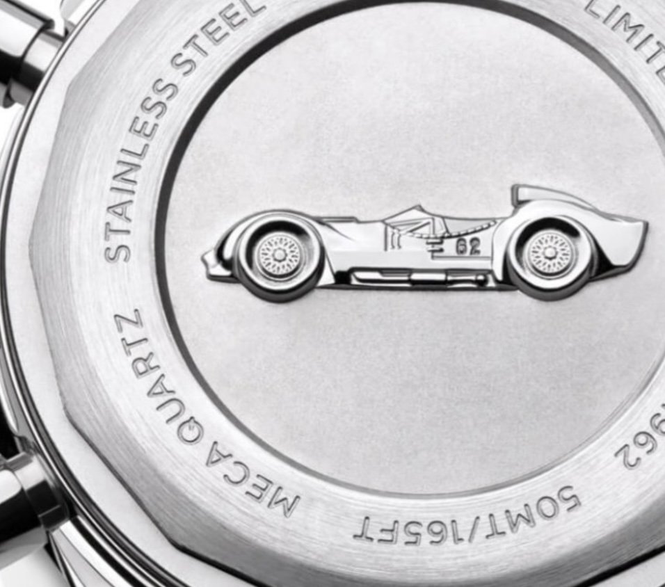

So a friend is very happy with a Dan Henry racing Meca Quartz but it is now battery change time.
It looks to be a screw case back but what tool to use? He could try a sticky ball I guess. It’s an LE so he won’t want to scratch it. As he is a novice another option is to try DH or a UK service company but he does not have anything locally. Any help appreciated. He is new into watches and OF helped his selections so I want to keep the momentum for him. Thanks.

I think it will need to be 14 sided
Or a tetradecogonal wrench.

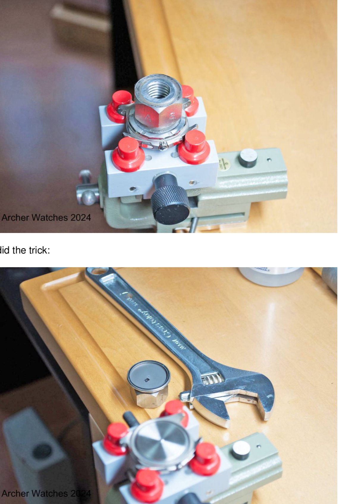

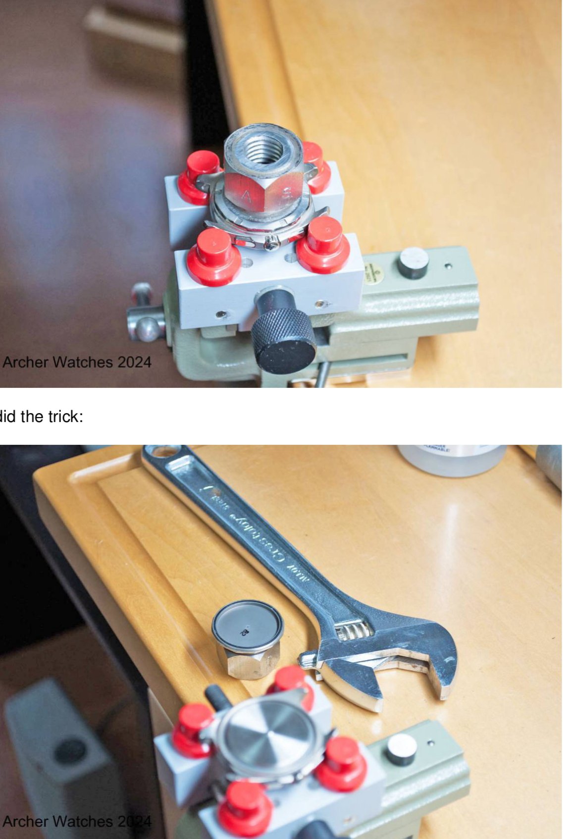

Could try a "Rolex" tool with superglue.
Can be undone with acetone when it's off.

It does annoy me when companies use unusual caseback shapes, and it's even worse when they use proprietary screw heads. When stuck I've used the large nut superglued to the back trick. Works well and @JimInOz says acetone will clear all traces.

And the “nut job” described above really works. My Titanium Tissot needed just that.
On your friend’s nice case back I wonder how the glue and nut would interact with that car.

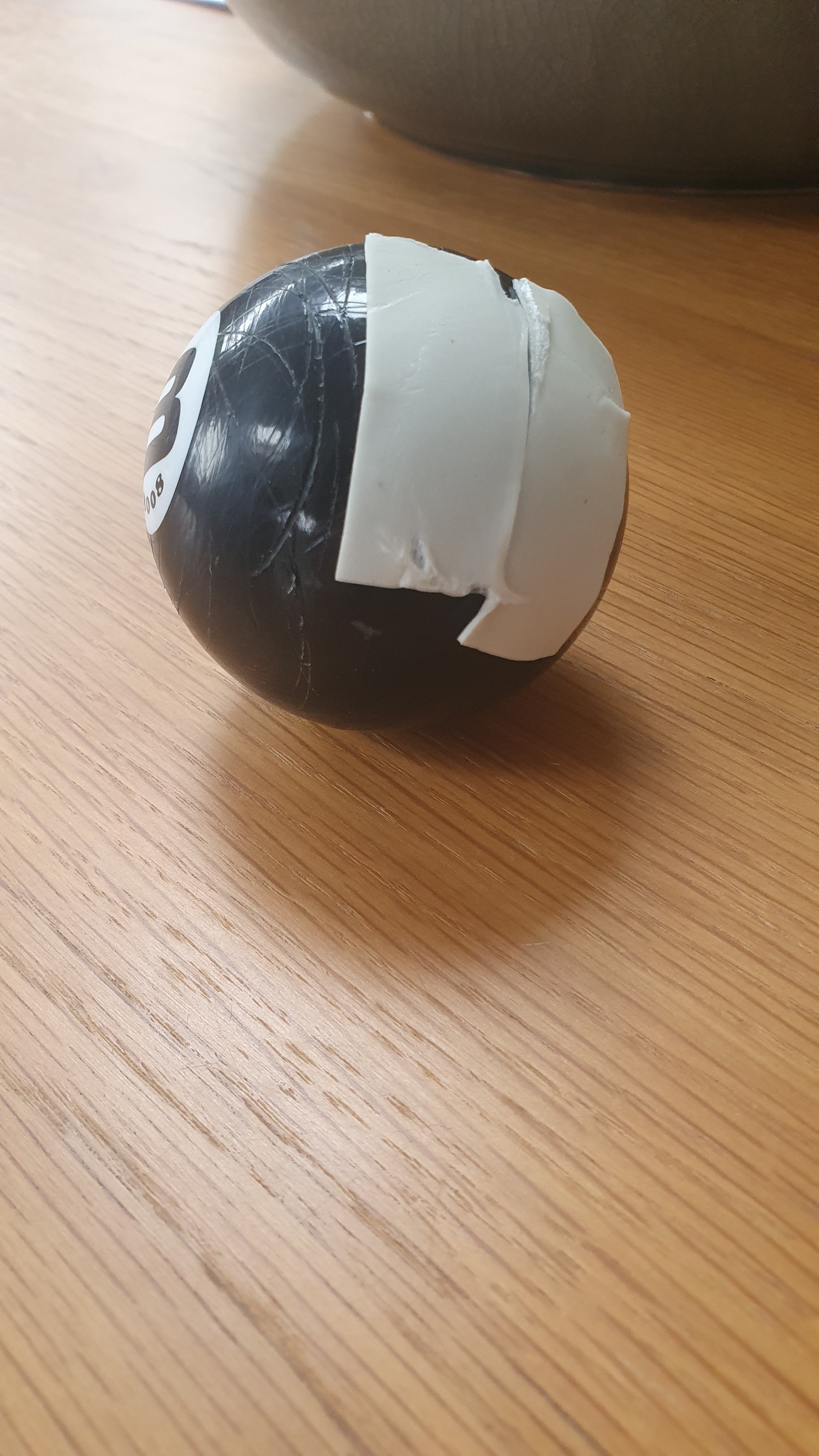

I would still give the sticky ball a try. You don’t need a completely flat surface for it to work. It’s more about the overall texture.

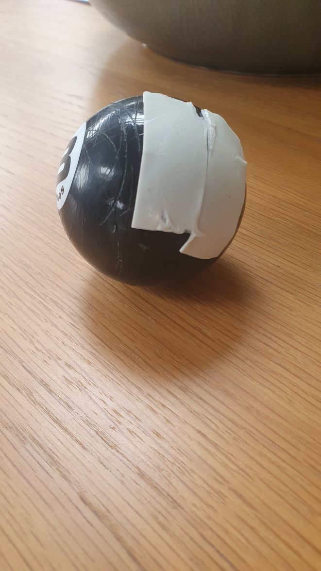

I got a new sticky ball (as modelled by Old boy tonight)…. Wish it came inflated / another problem to fix. When I see my friend we will give it a go….

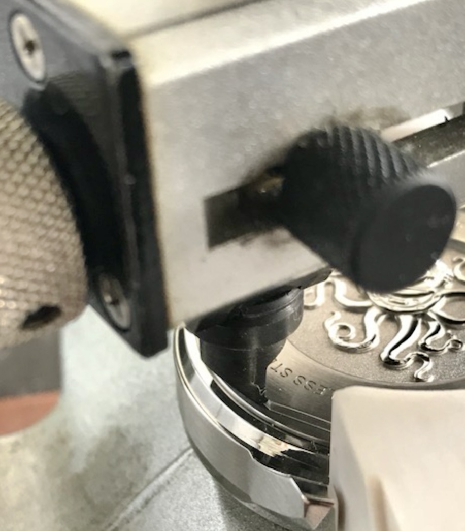

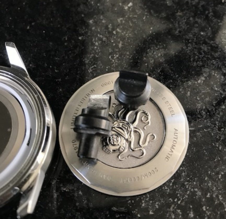

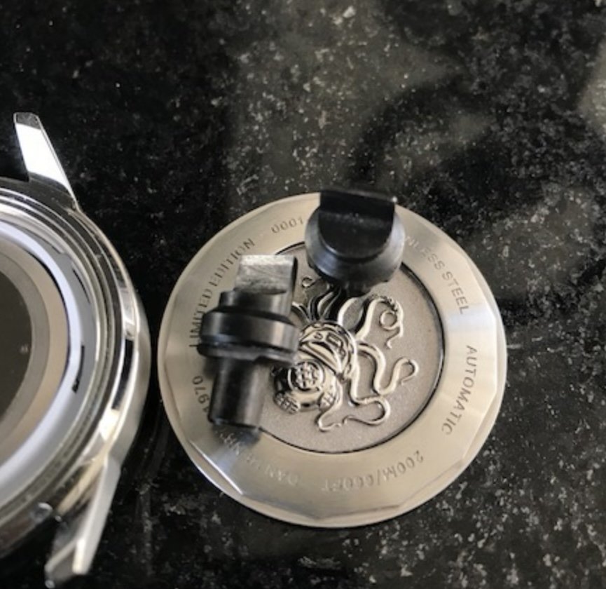

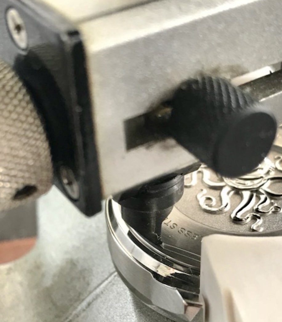

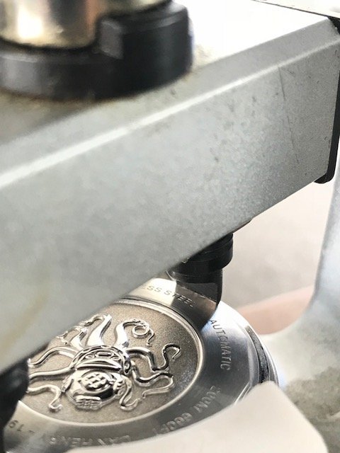

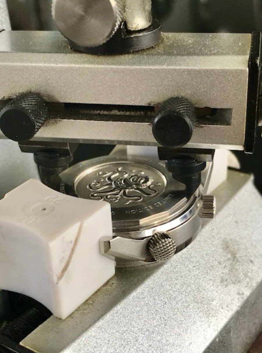

I did get a response from Dan Henry. I suspect they don’t have a UK service centre. See photos below for the solution suggested. Can anyone point to straight case opening bits like this? I have a standard 3 bit opener with a few bit options but not these I fear. My friend has a pillar drill so we could rig something up to hand turn if needed and maybe some Kapton tape would reduce any scratch risk. The nut and glue tip also looks a viable option and I have used acetone being a messy worker with superglue in the past so it does work (but a pain to do it every 2 years for a battery). A plastic hexagonal (14 sided?) wrench looks the best bet if any entrepreneurial 3D printers see a business opportunity;0)
Any links to suitable parts appreciated, otherwise it will be bolt nut and glue time if the ball does not work.

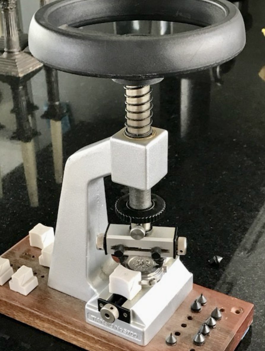

I would recommend against this option. Better off to use friction dies in a 5700 style case opener, and if that doesn’t work, glue a nut to the case back.
Of course taking the watch to someone who is fully equipped is always an option...

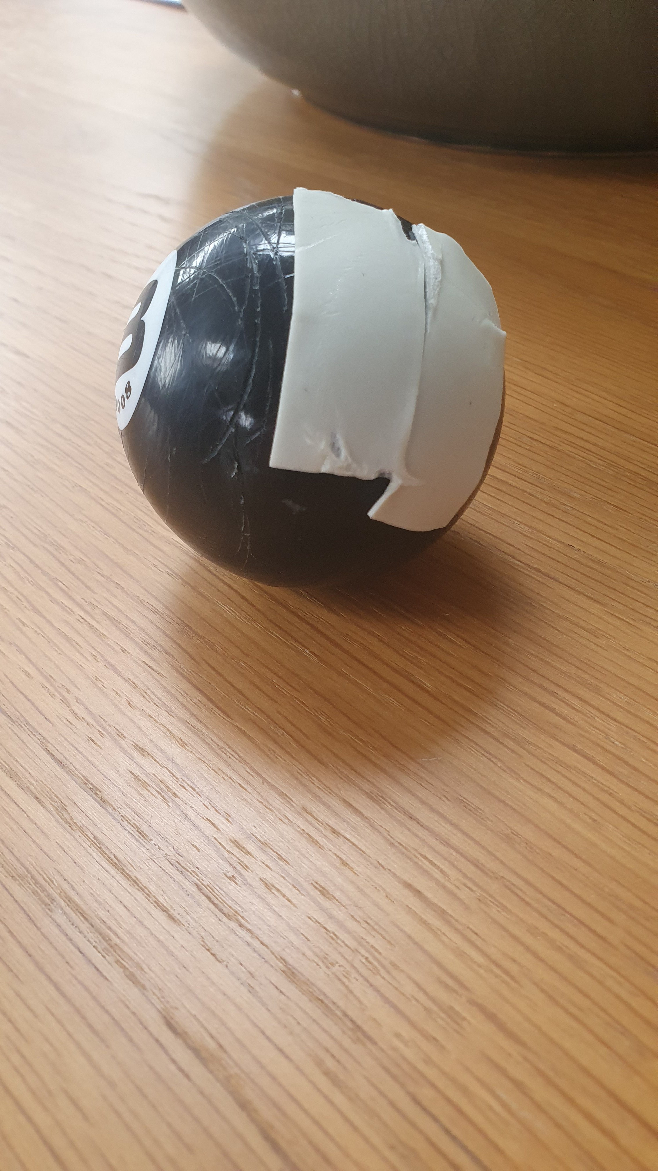

If the ball is slipping you could try padded double sided sticky tape. My mate works for Aston Martin and they use this stuff on plastic panels, very strong hold, but I'd imagine 3M, gorilla etc would work. You don't really need a proper sticky ball I used to use a stress ball.

I had to use a crescent wrench on my DH racing, it was to tight for a ball. They really had that thing cranked down.
