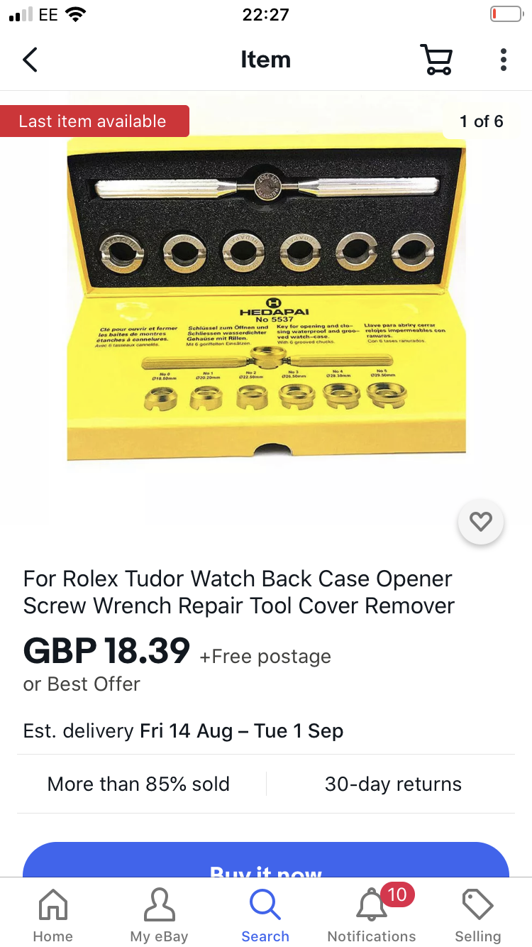

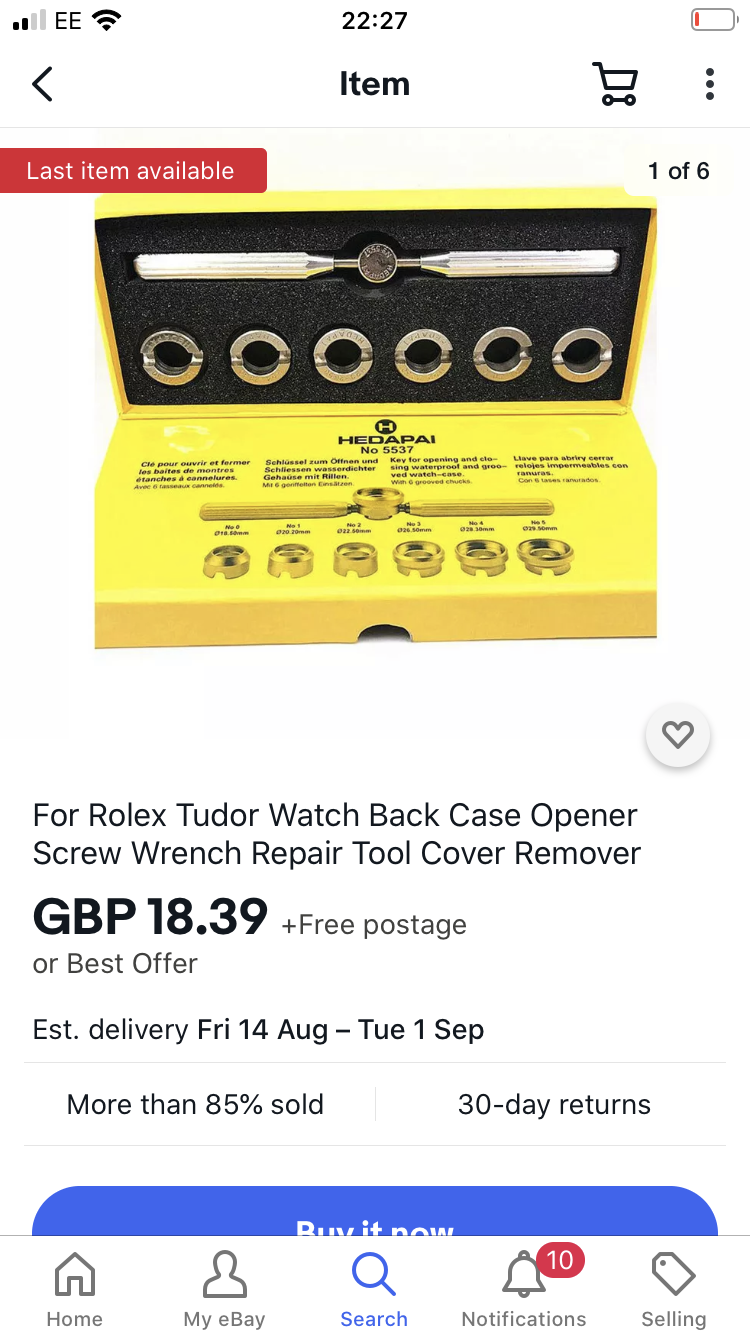

I have a couple of the generic three prong case back openers for opening vintage Omega cases (as well as a trusty Stanley knife blade for snap back cases) but I now need one for opening Rolex Oyster cases.
I’ve been looking at the Burgeon and Errslinger versions but then came across this on eBay for a fraction of the price.
Has anyone used this before? It basically looks like a Burgeon rip off so I assume the quality isn’t particularly good.
What do you use for removing Rolex case backs?
Disclaimer - I know some people will say take it to a watchmaker. I like to be able to remove them myself to check movement condition/calibre etc as I buy most of my watches privately.

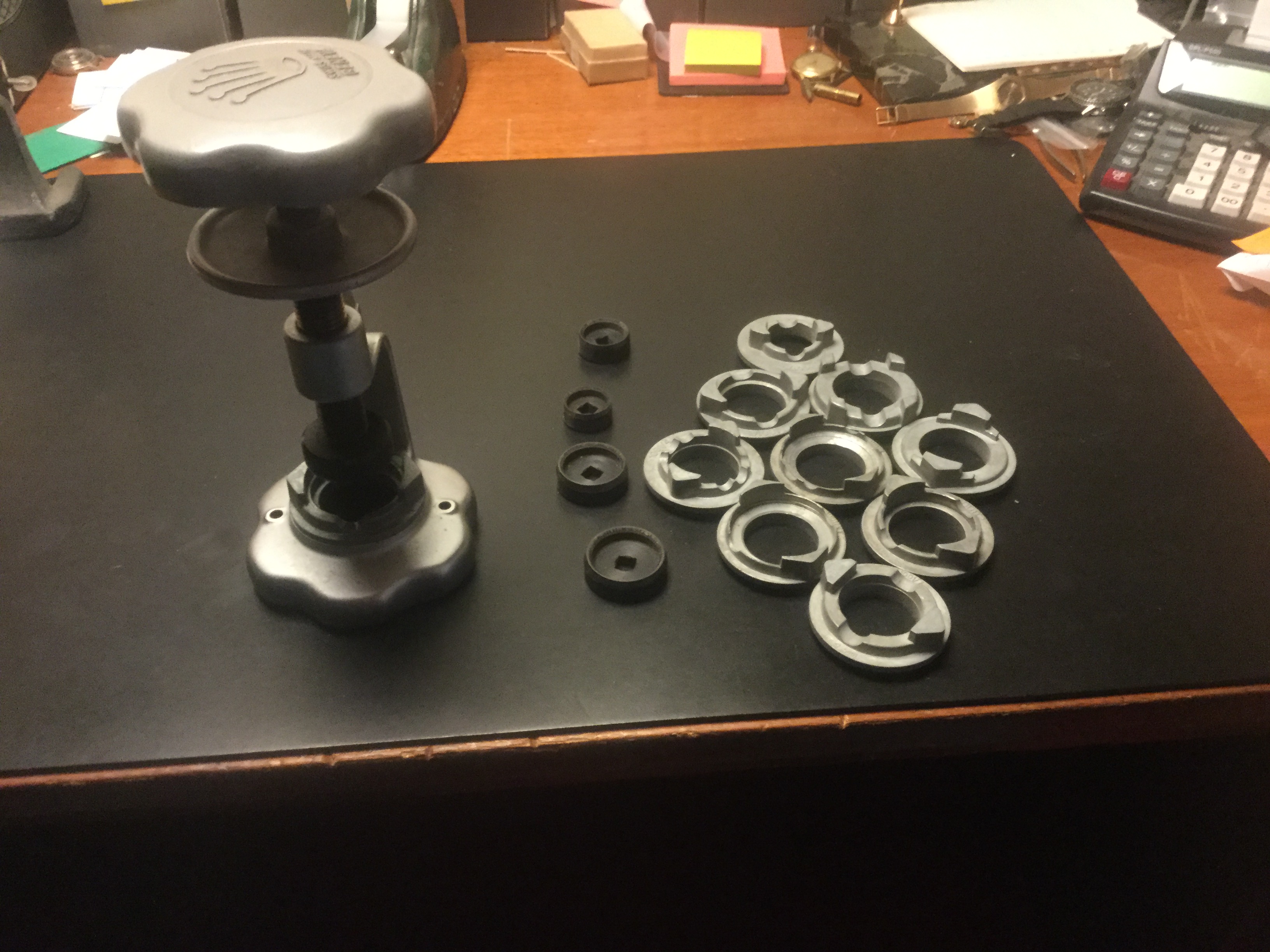

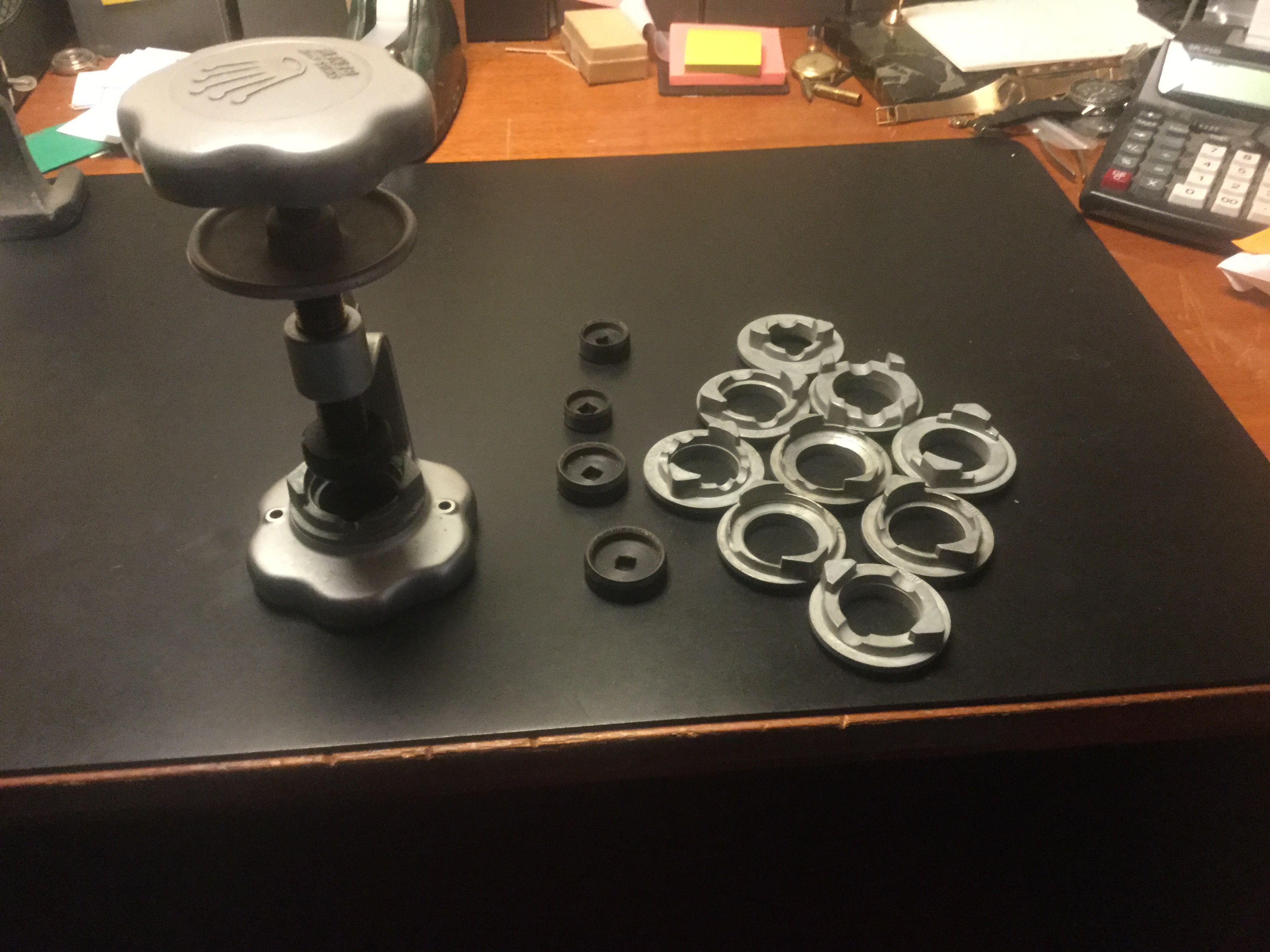

I use one with a press. More or less like this. I mount it in a bench vise, and sometimes I hold the watch in a regular watch holder with nylon pins instead of this holder. I've successfully used this watch holder without scratching the watch, but you definitely need to remove the bracelet so you can clamp it using the two surfaces between the lugs. I've also experimented with using thin leather to cushion the watch inside this holder.

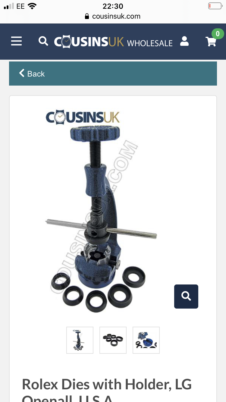

Similar to this?
Yeah, I edited my post to add a photo and more detail. Mine might be L-G brand.

Looks like it’s the same model actually!

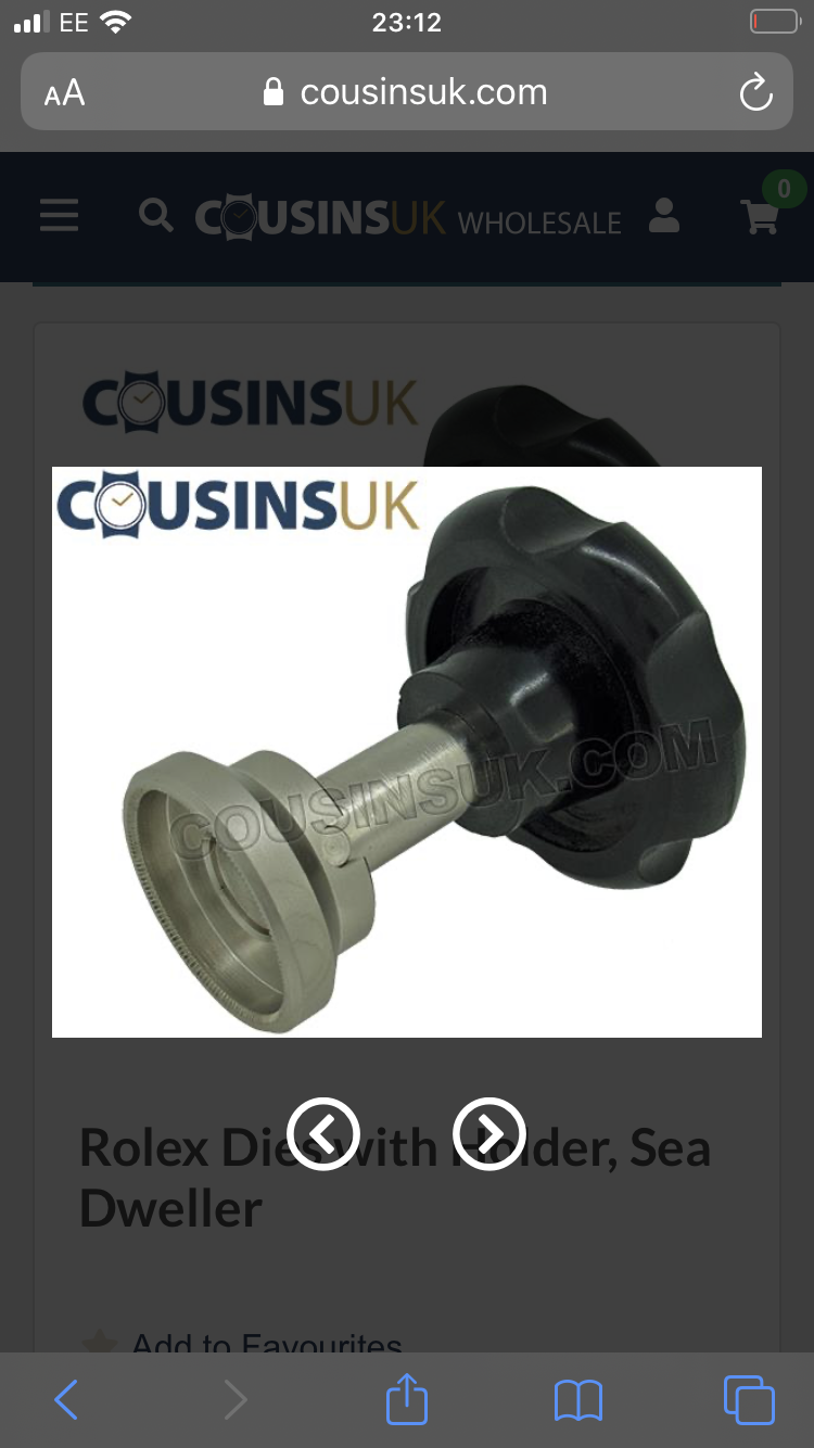

The press version on Cousins UK is only £10. Is about right - I was expecting it to be more expensive.
I can't believe that price is correct if it includes all those parts.
13,533
23,476
You're right. Prices for the individual components start at £10, the full kit is £90. Looks like a decent set up though.
@janice&fred is this the same as what you use or are you describing the handheld version like this?
Yep that's it in your picture. You will love it as you can really apply some safe torque and pressure at the same time.

You might find that the dies aren’t an exact fit for vintage Rolex. Trust me I have the tee shirt. The Cusion options are worth a go

Personal experience. The HEDAPAI only works well if the caseback is easy. The Bergeon is much much better quality.
I'm close to a watchmaker with Rolex propellers and the big machinery if need be.
Don't bother with the HEDAPAI. You won't regret spending the money on the Bergeon, especially if you can find one lightly used, like I did.

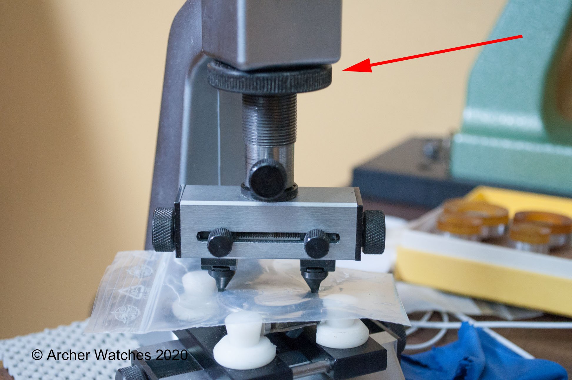

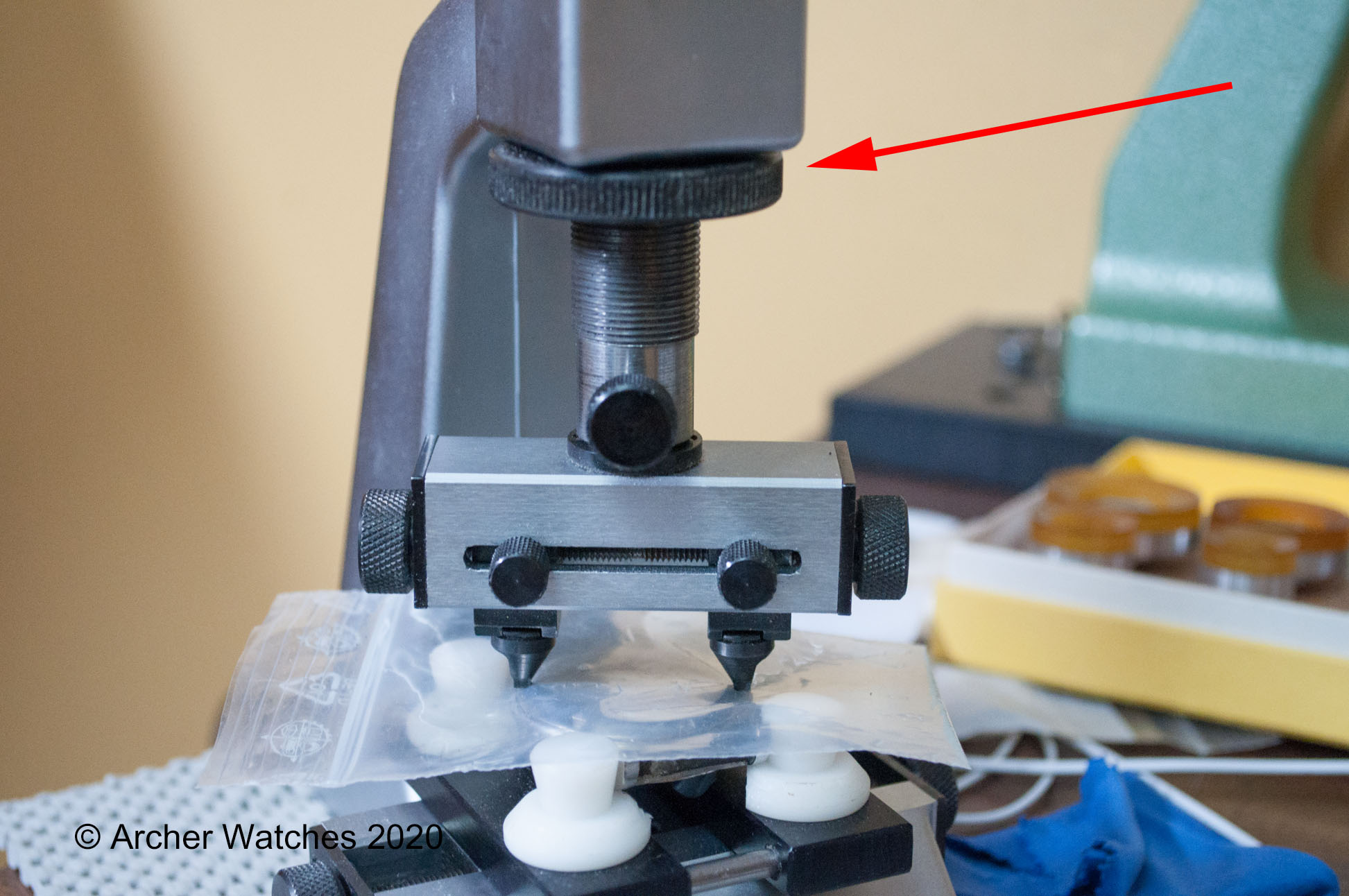

I use a Bergeon 5700. The vast majority of times the friction dies I have will open watches, but on occasion they won't. When that happens, I use plastic between the case back and the two pronged opener, as you can see here:
Note that the two pronged attachment I'm using here can be locked so those prongs to not move in the slots of the case back, and the red arrow points to the jam nut that holds the securely locked in place. The case back doesn't unscrew far because of the jam nut, but once it's broken loose, you can move the nut a bit and carry on unscrewing the case back.
Of course with a Rolex case back design, you can't really use plastic between the case back and the die like I have used here, so on those it's even more important to make sure the die can't slip and is held down firmly. I use Bergeon Rolex dies (they actually came with the 5700 when I bought it years ago), but they do work well. Of course making sure the case is held securely helps as well, but this vise in this unit does the job fine.
IMO anything that is just hand held is asking for trouble.
