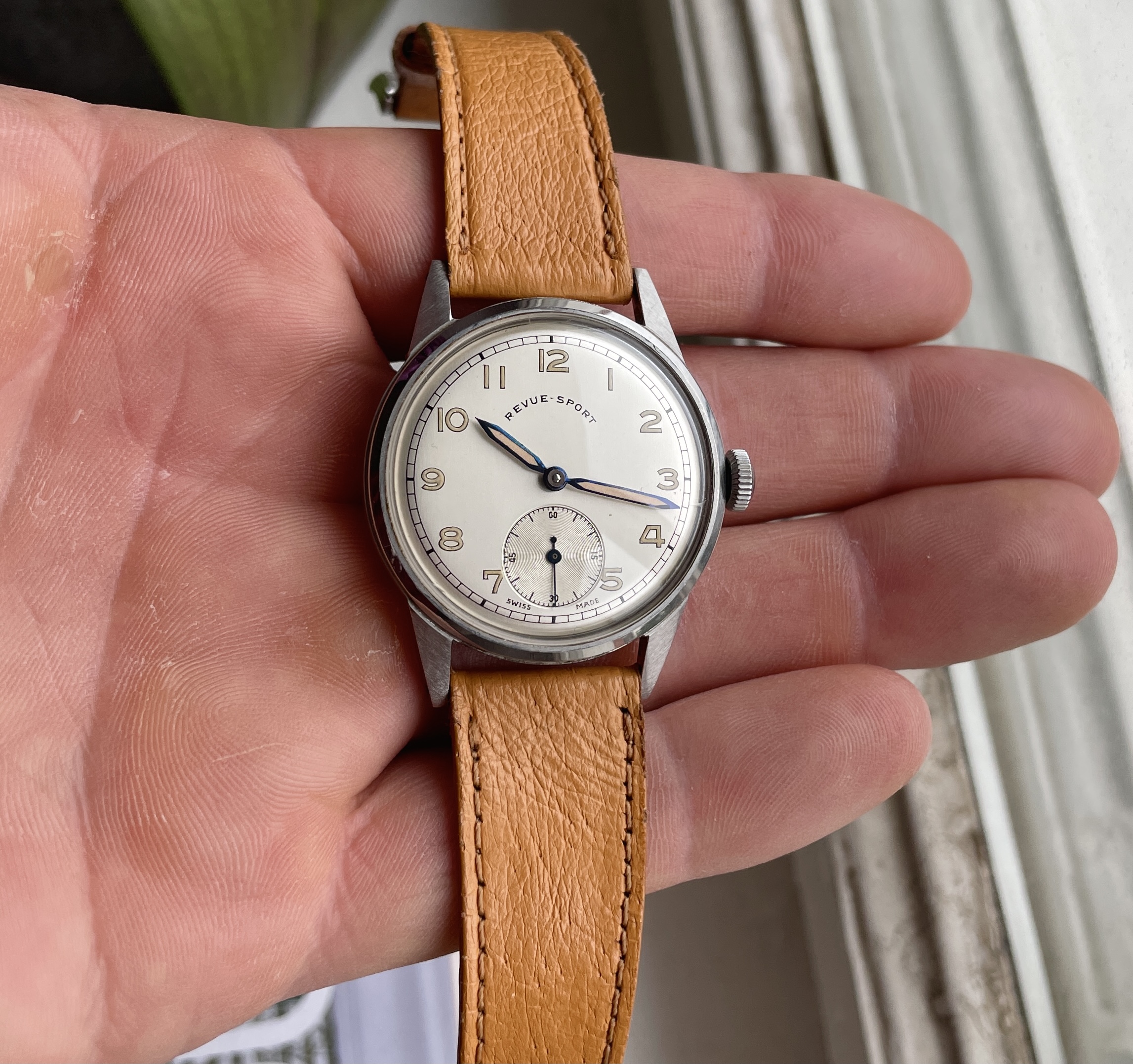

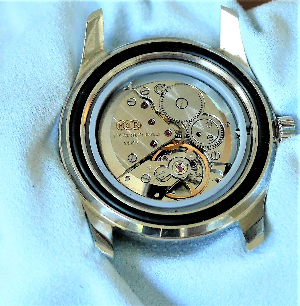

I just secured a Revue with MSR T4628A , which is stuck unfortunately so it is with my watchmaker. Overwound for 1 but probably dried out too. Any special particulairs to look out for ?
P1030254.jpg" alt="P1030254" border="0">
I see on the small crown winding wheel 3 holes and 2 screws only but that is because there is a jewel underneath to reach so designed like that i think.
Thanks !

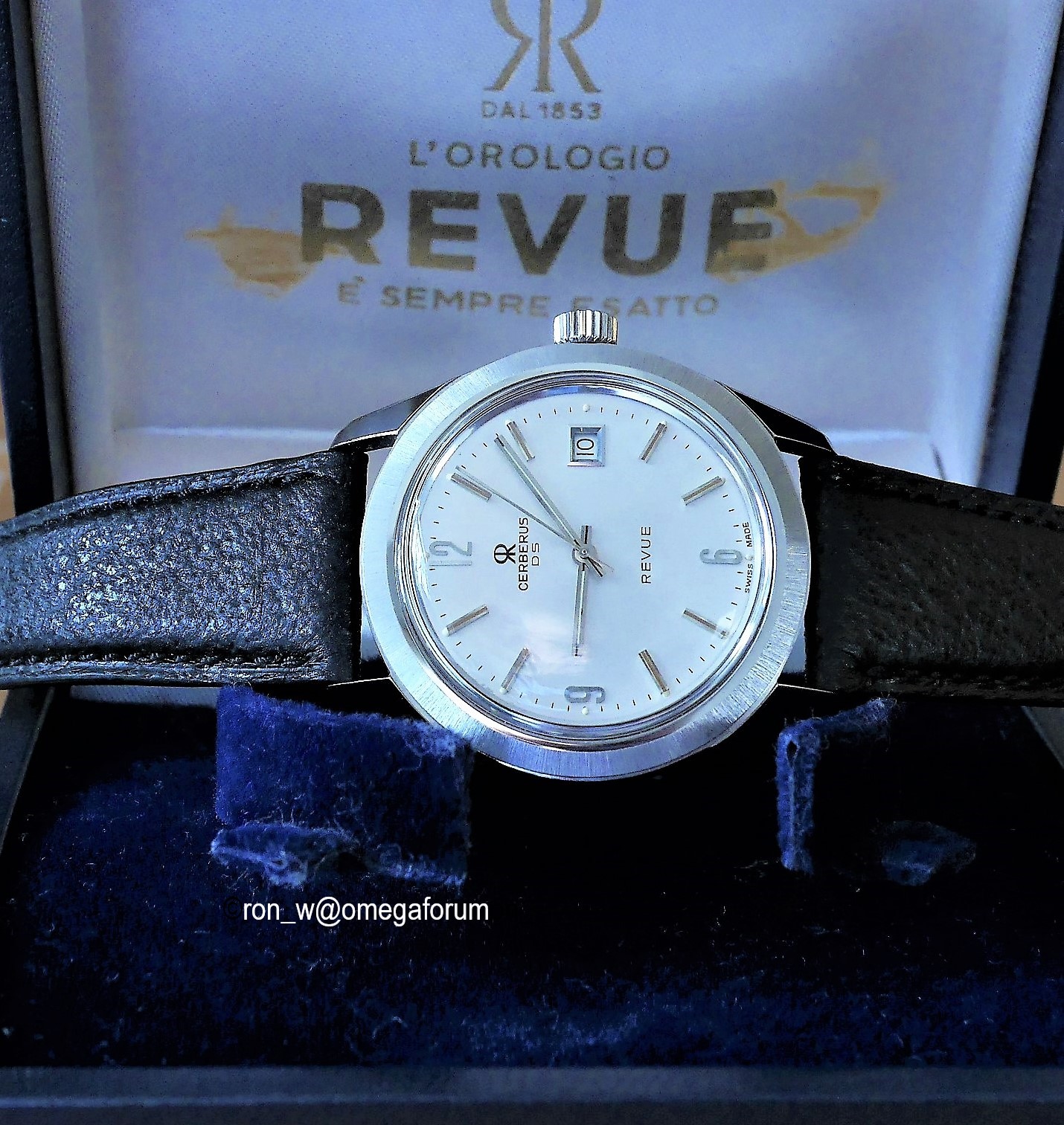

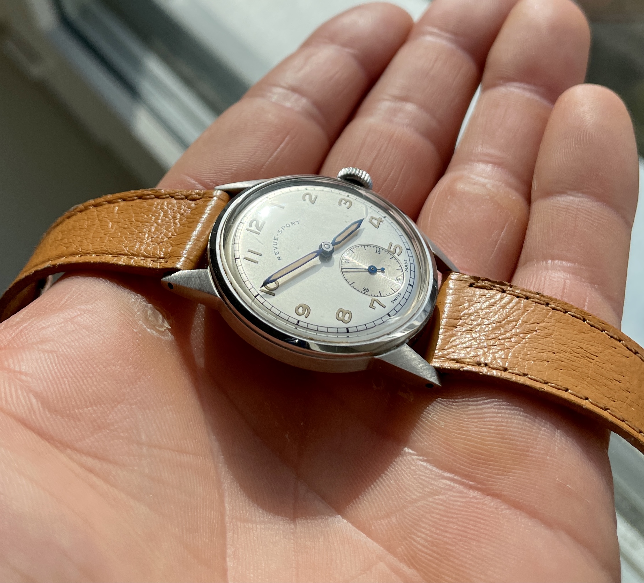

Here is the frontside ;-)
does anyone know if cerberus is a sub brand of some kind ? or for a specific market ? My guess it is late 60`s early 70`s but i have no way of conforming so please let me know if you have any information. Thanks !

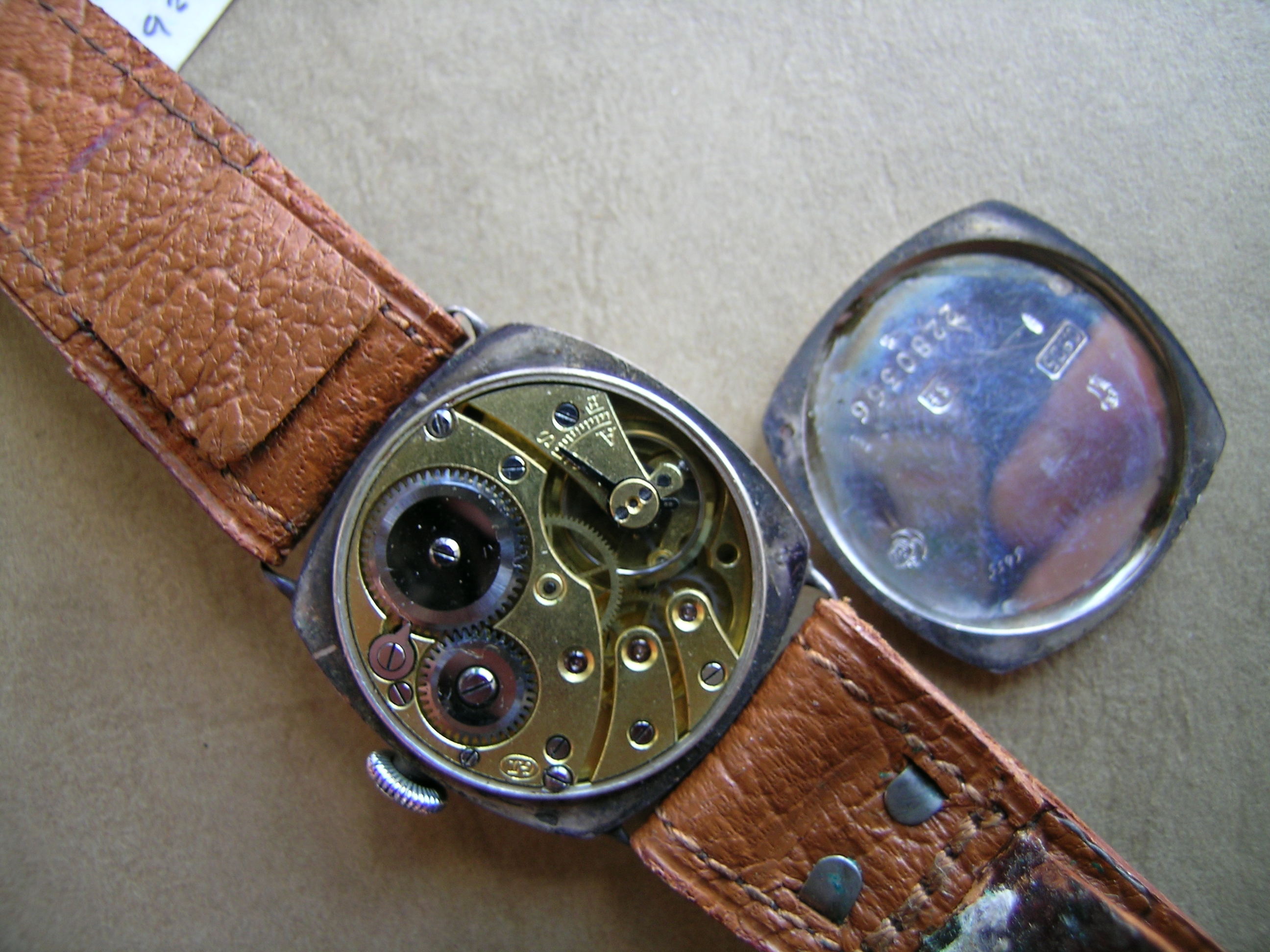

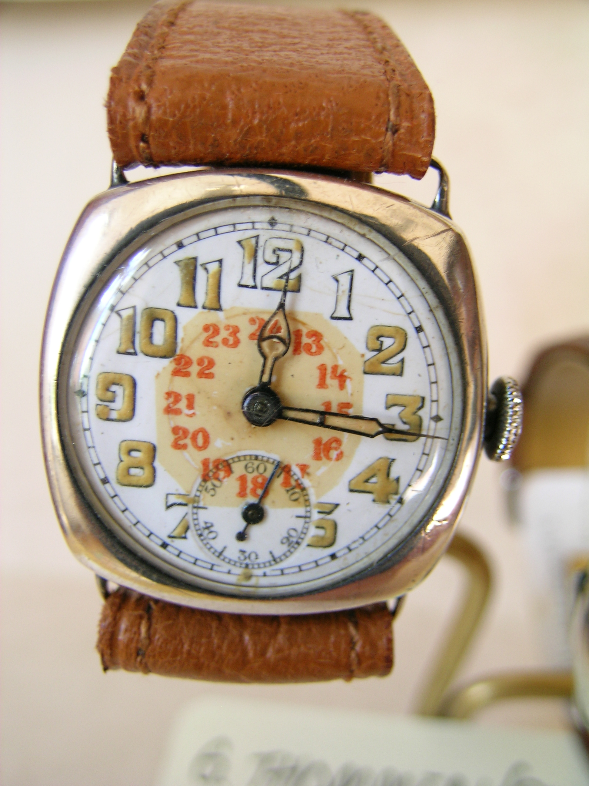

HI,
A year or so ago I managed to but this nice J.W.Benson watch hallmarked in 1925.
I`m looking for confirmation that the movement is a Revue one..suggested as a calibre 38 on another forum.
I presume any markings are on the dial side as I can see nothing under the balance.
The actual movement diameter is approx 28mm if that is of any help.
Thanks in advance for any opinions

Congrats, it’s a beauty.

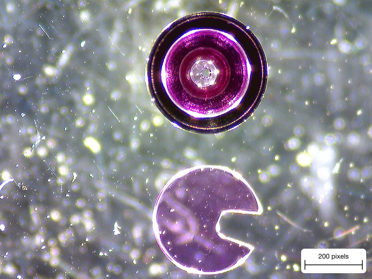

Back from the watchmakers and all is well, just a dried out movement. Funny capstones though .. like Pacman !

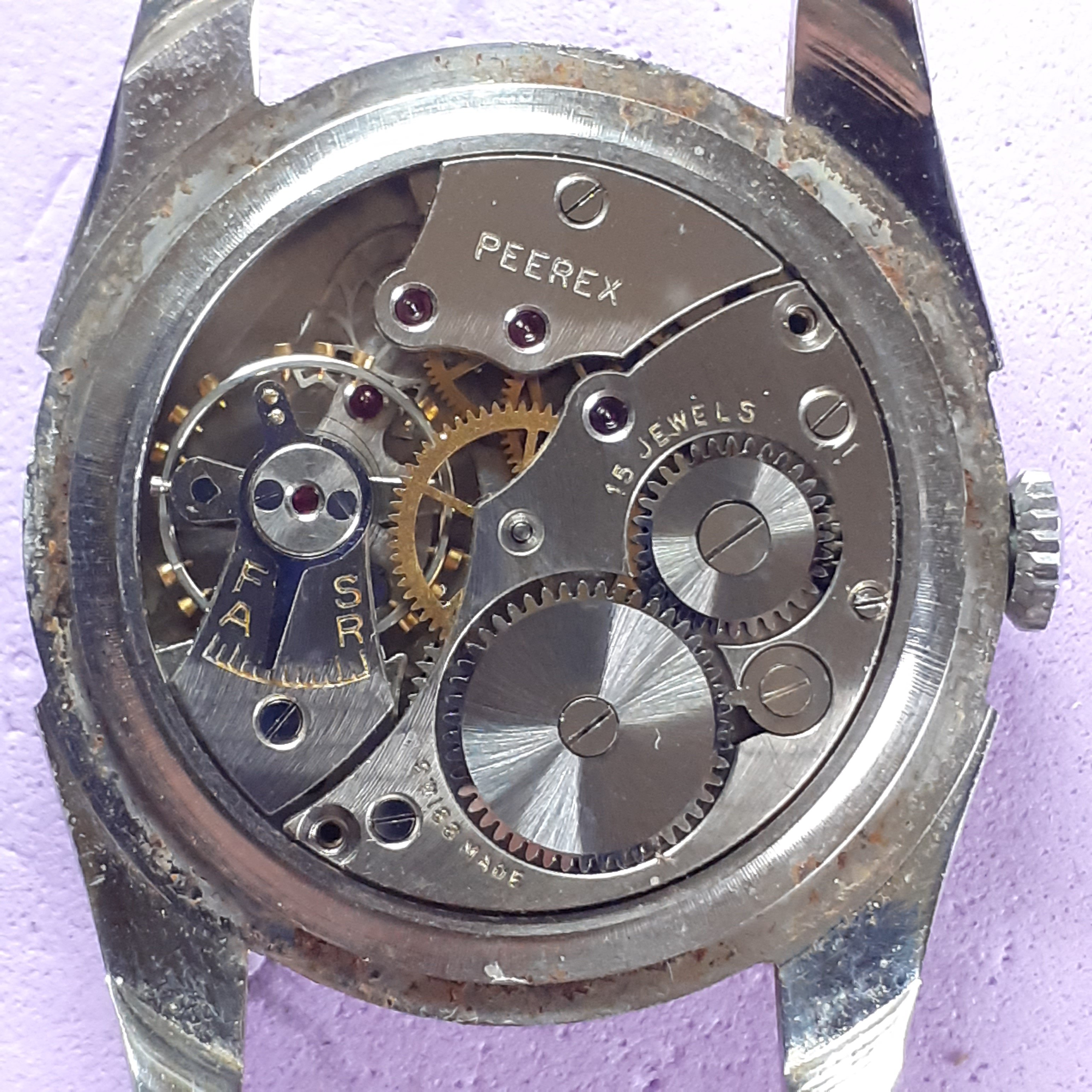

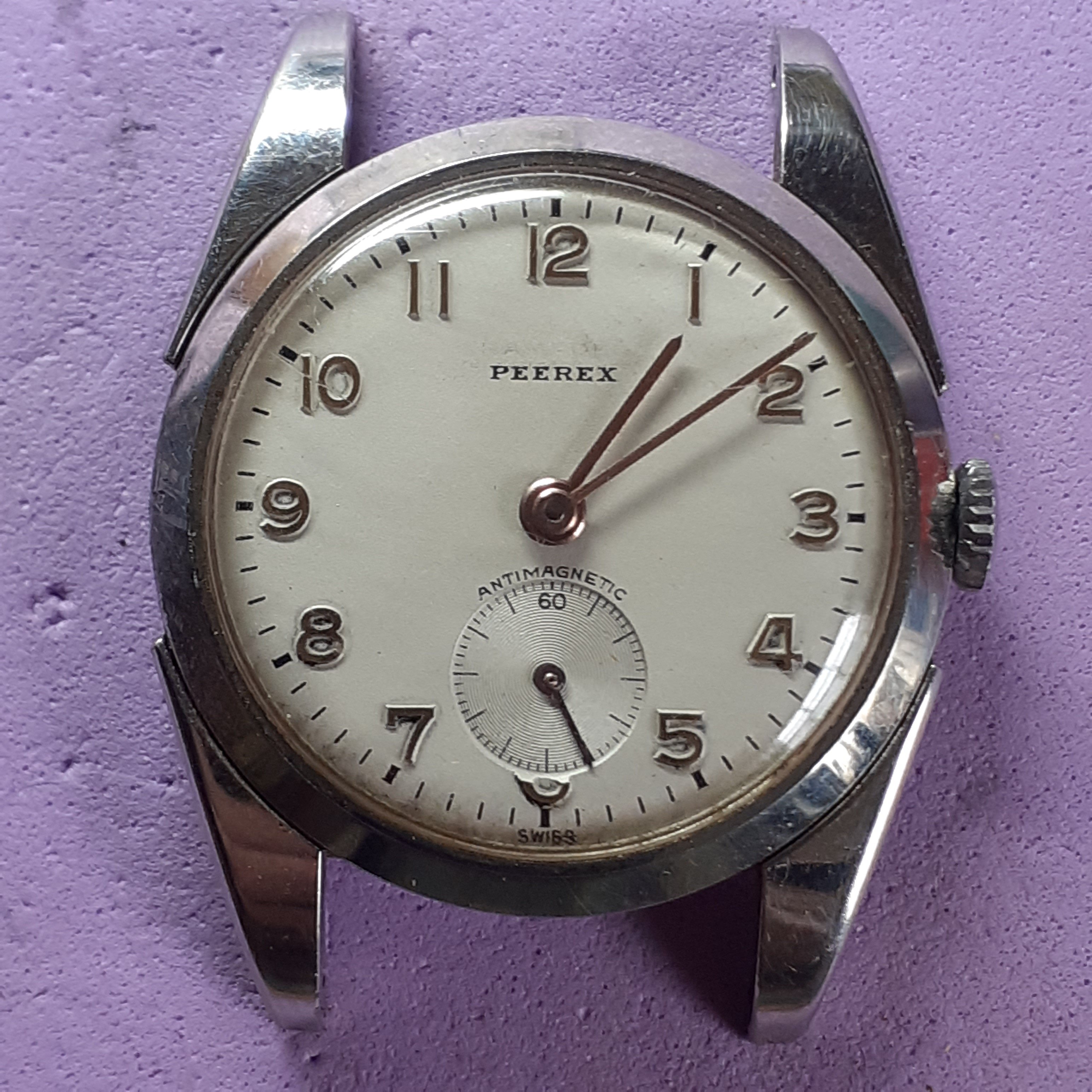

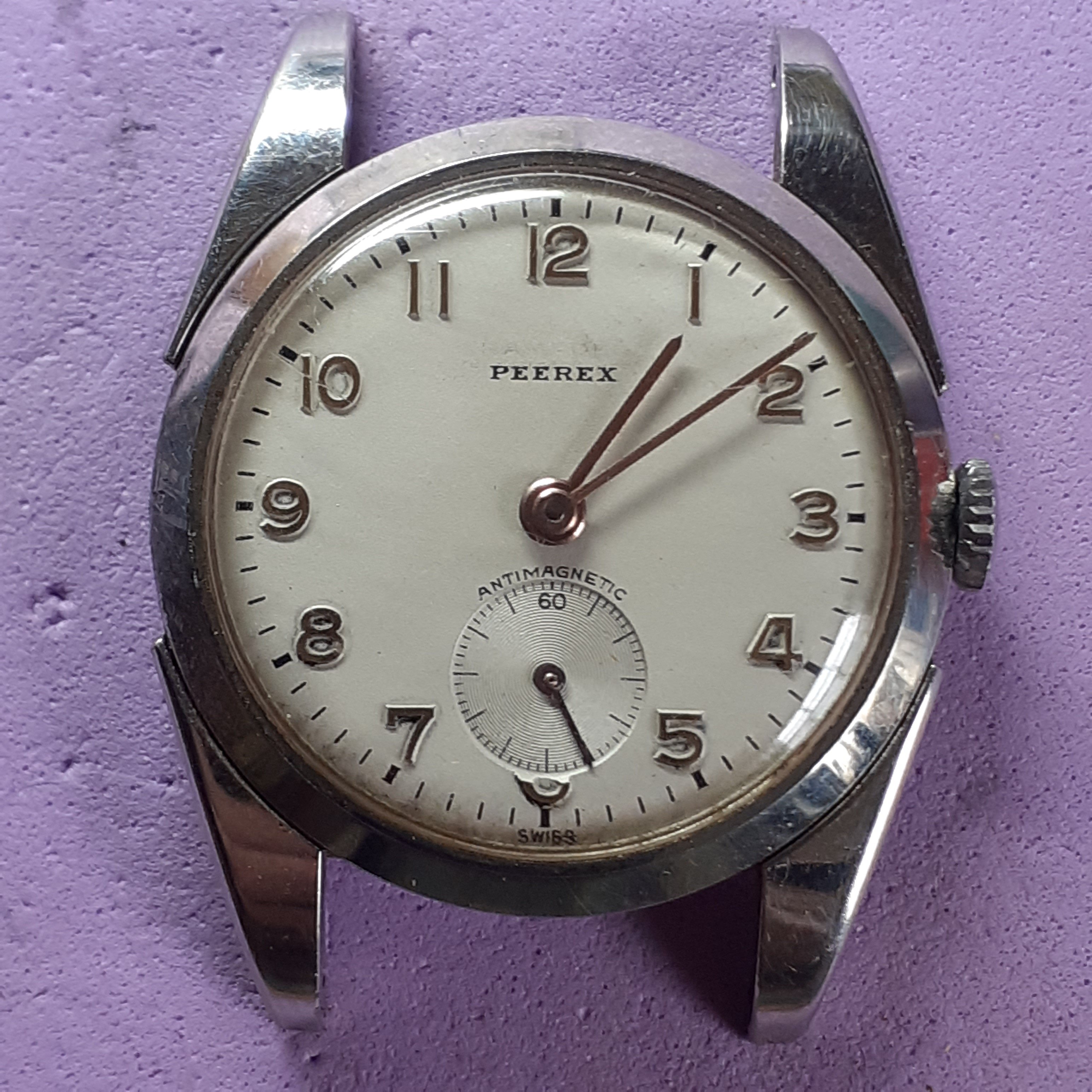

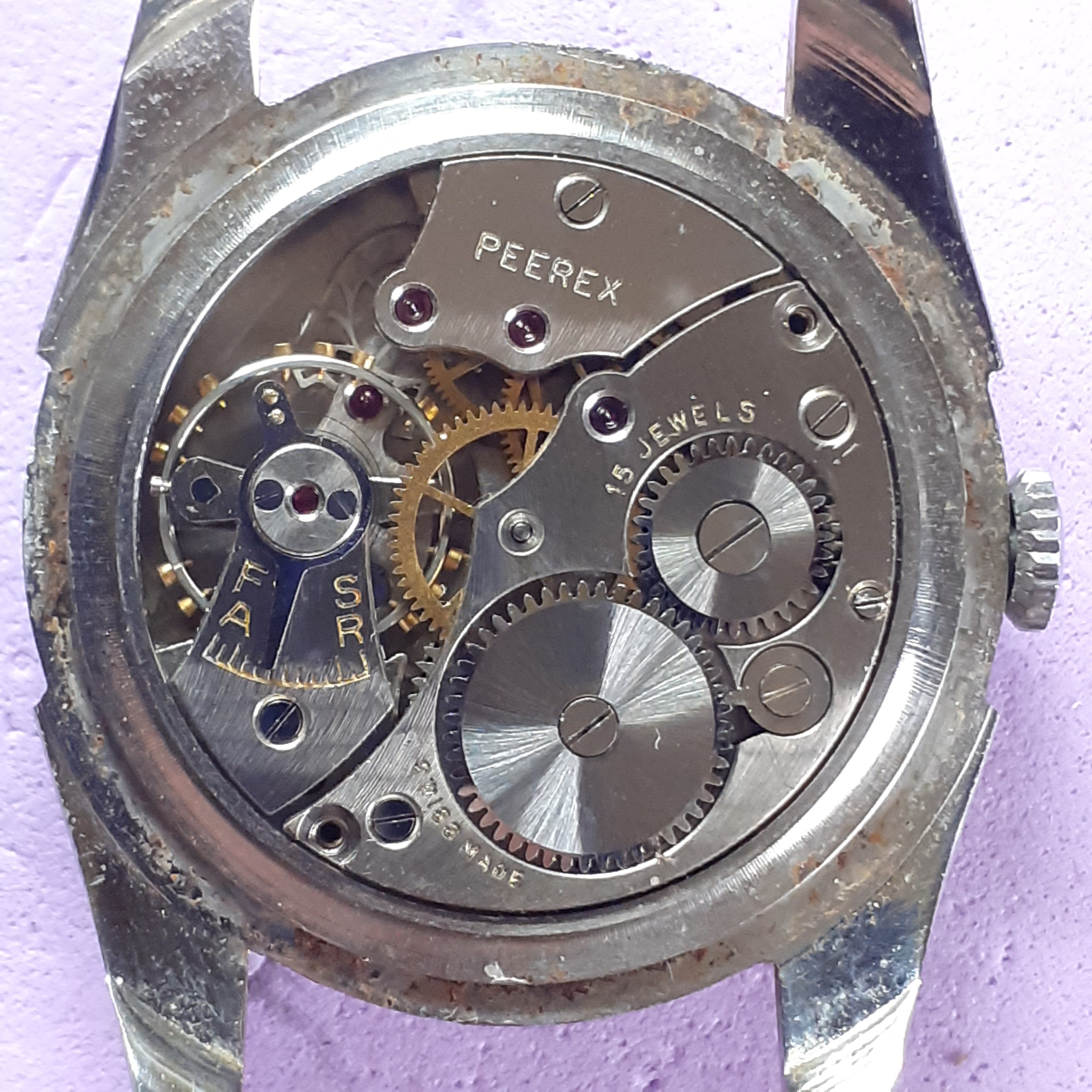

Is this a Revue ? Balance staff was broken. I measured it and Revue 59 fits.
I also remember the layout of this movement from years ago. Reminds me of Revue.

I couldn`t say , but you can check Ranfft to see if it is similair to any Revue ?
9
21
Thanks. I will do that. Ranfft has an incredible number of movements classified.
I believe the end caps are cut like that to facilitate ultrasonic cleaning.
BUSER 25 movement.
It didnt become a popular idea ..👍 , but apart from the capstone my watchmaker really loved the MSR movement.
