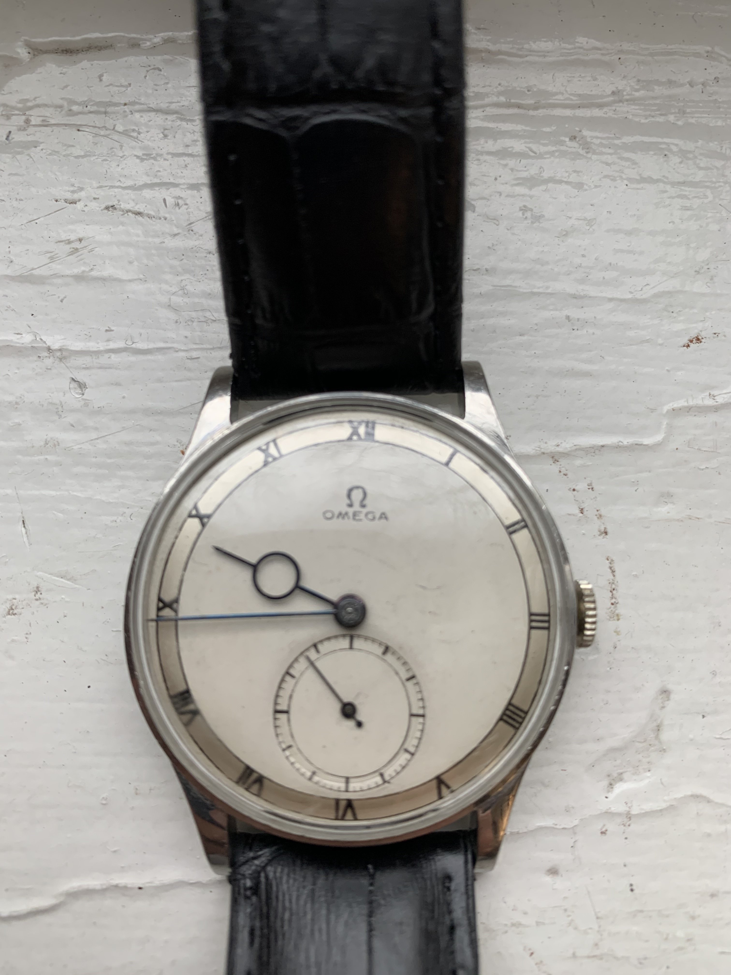

Hello,

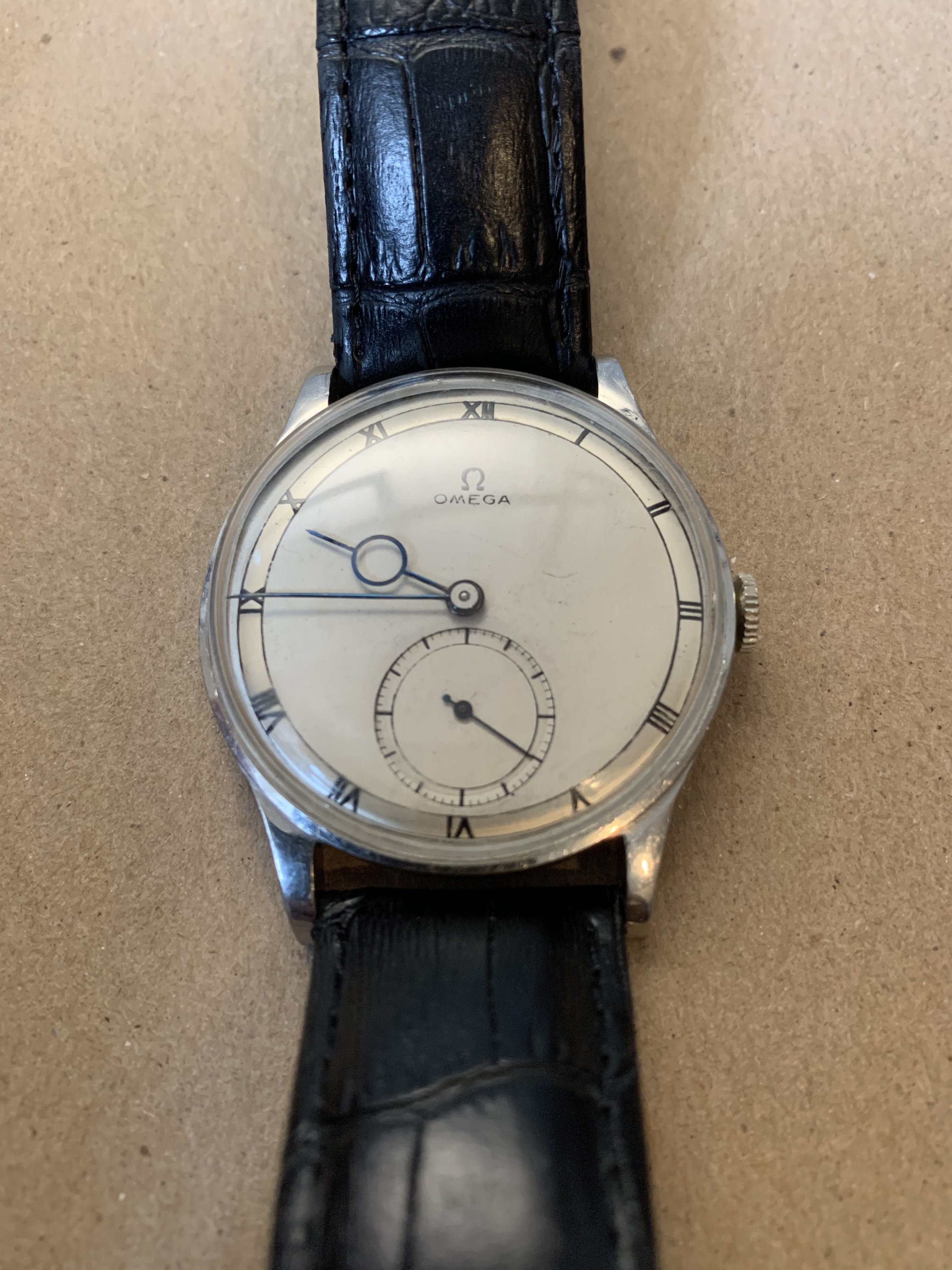

A few years ago I found an Omega watch that belonged to my grandfather, and I would love to get whatever information I can about it, including reference number and date and location of purchase (and anything else you might be able to tell me). I would also be curious to what extent you think it is original (including dial) -- I will not take any offense to comments on condition, originality, etc. -- to me the value in the watch is sentimental and no assessment will change that.

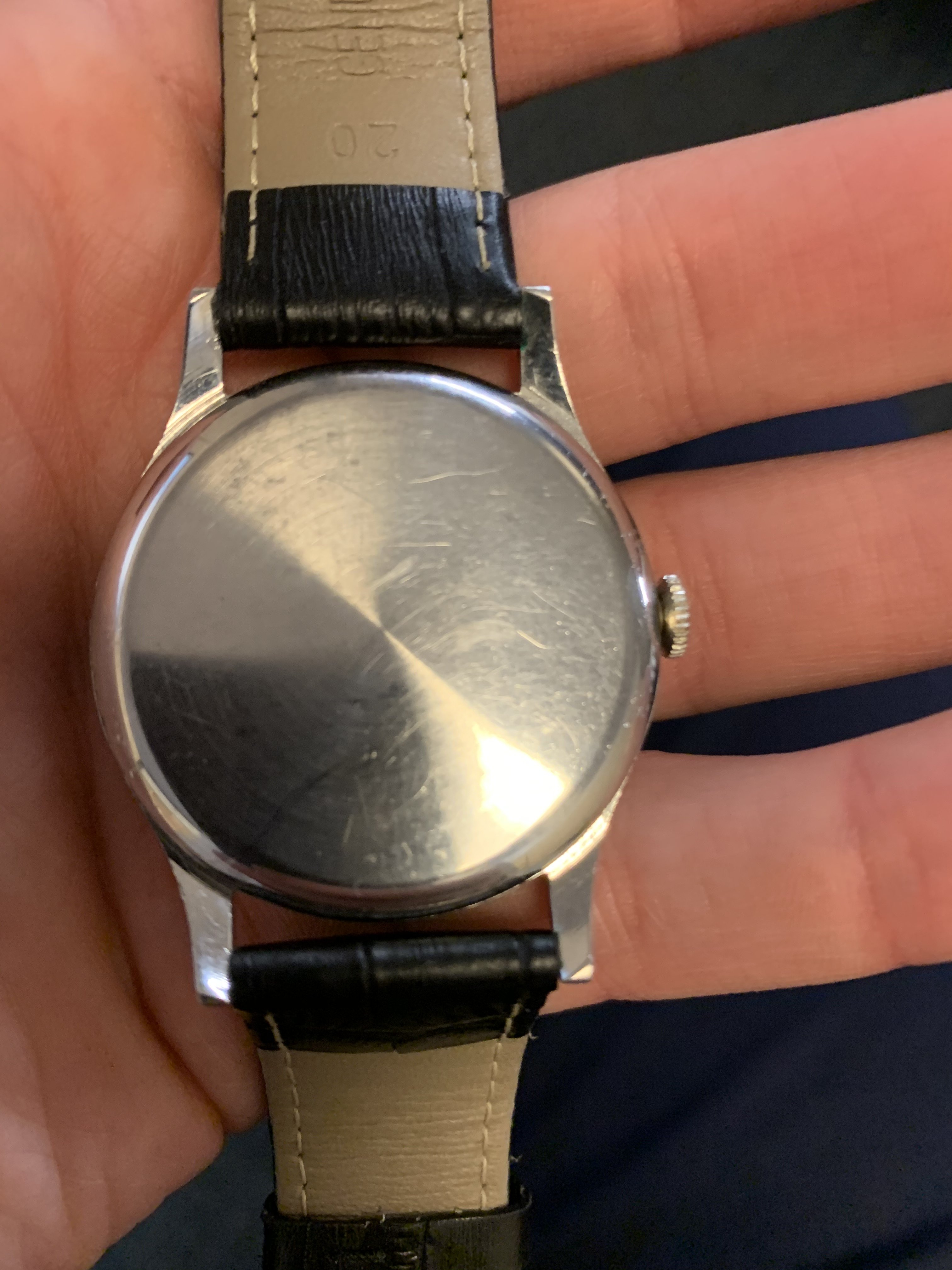

I have attached below some pictures that should be helpful.

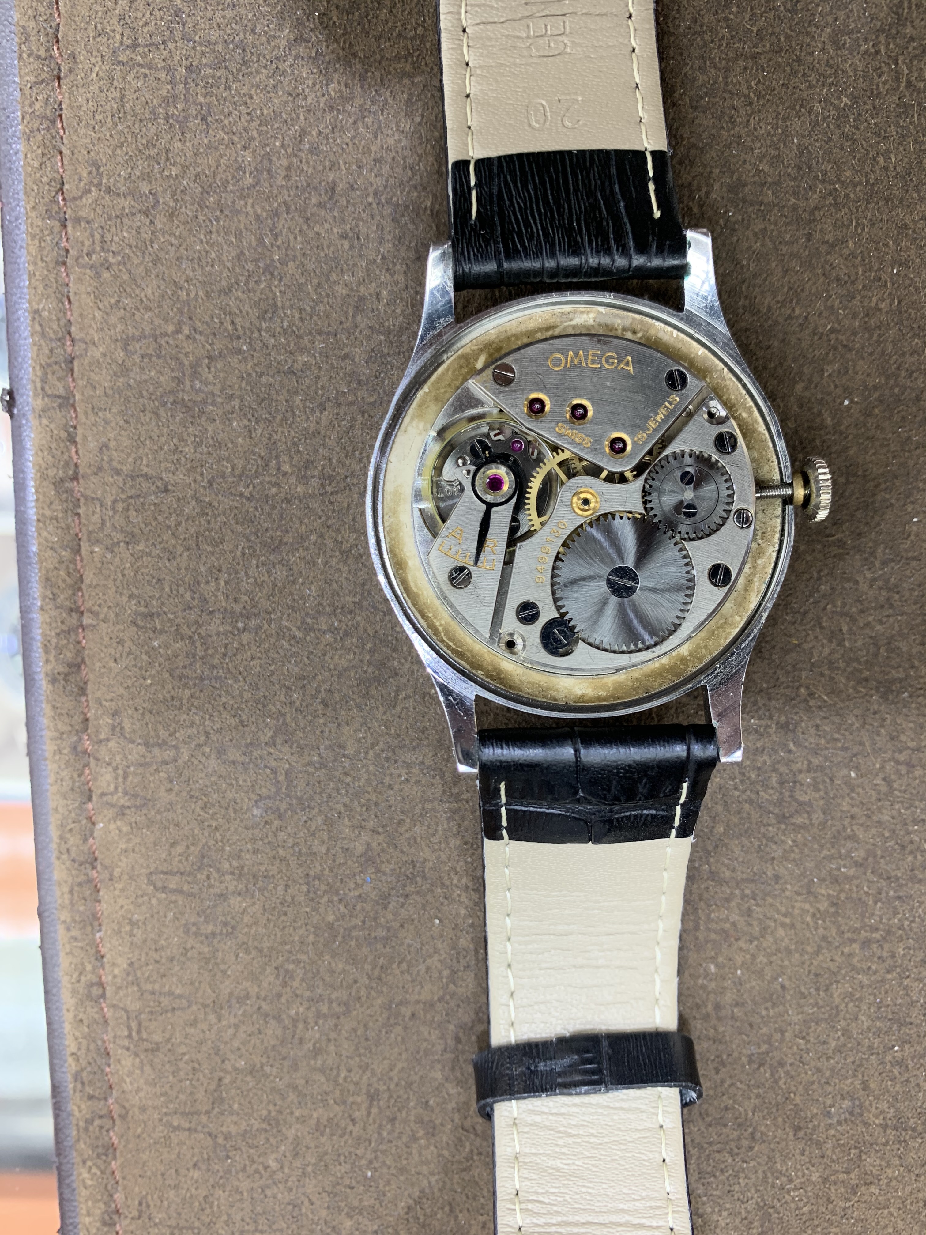

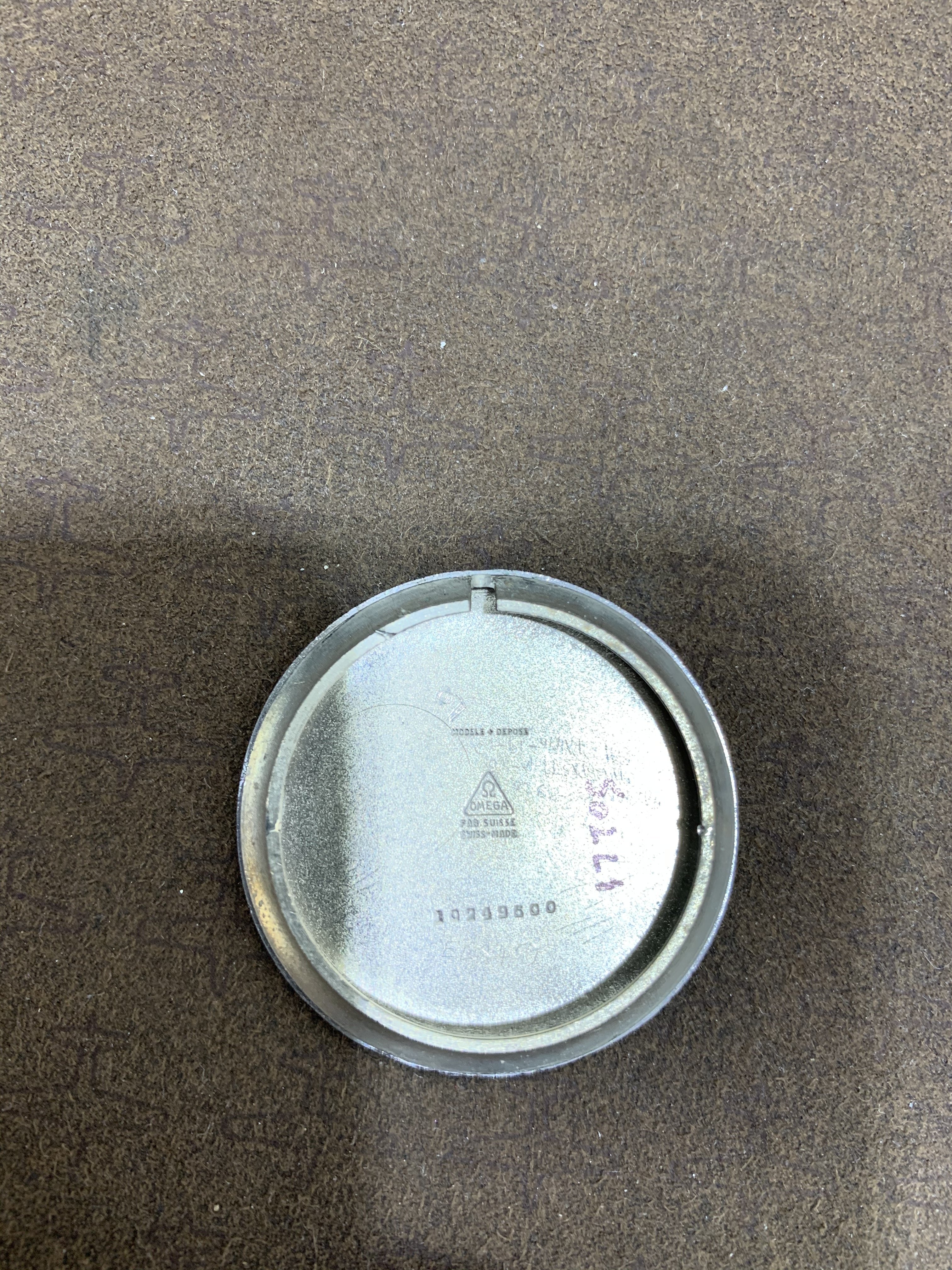

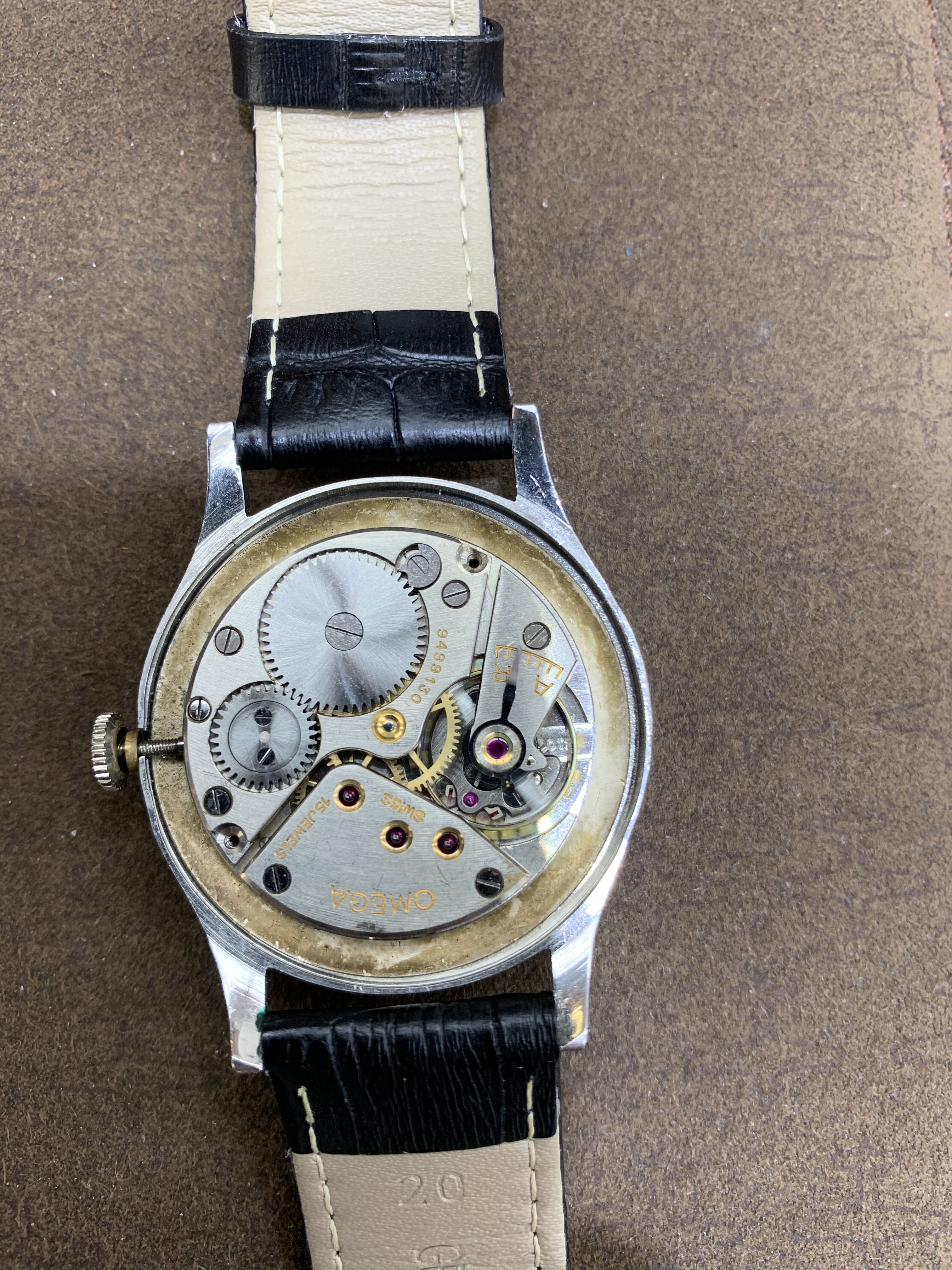

As for what I can tell you: I had the watch serviced recently, and it is in good working condition. The strap is not original. It appears (to my untrained eye) that there are mismatched serial numbers on the movement (9499130) and caseback (10249600) -- what does that tell us? The movement seems to be a 15 jewel 30mm caliber - is that correct? As for where the watch came from, the original owner would have traveled extensively throughout Europe, the Middle East, and North Africa during the 1940s. He was an officer in the British Army, but I see no indication that the watch is a military issue of any sort.
Once again, I would be very grateful for any help with: identifying the precise model and movement; thoughts on the originality and condition of the dial and other components, and dating the watch. I would love to know where the watch was sold, but I fear that I will not be able to pull from the Omega archive with mismatched caseback and movement serial numbers, but please correct me if I am wrong.
Thank you for your time and for helping me learn about a special object.

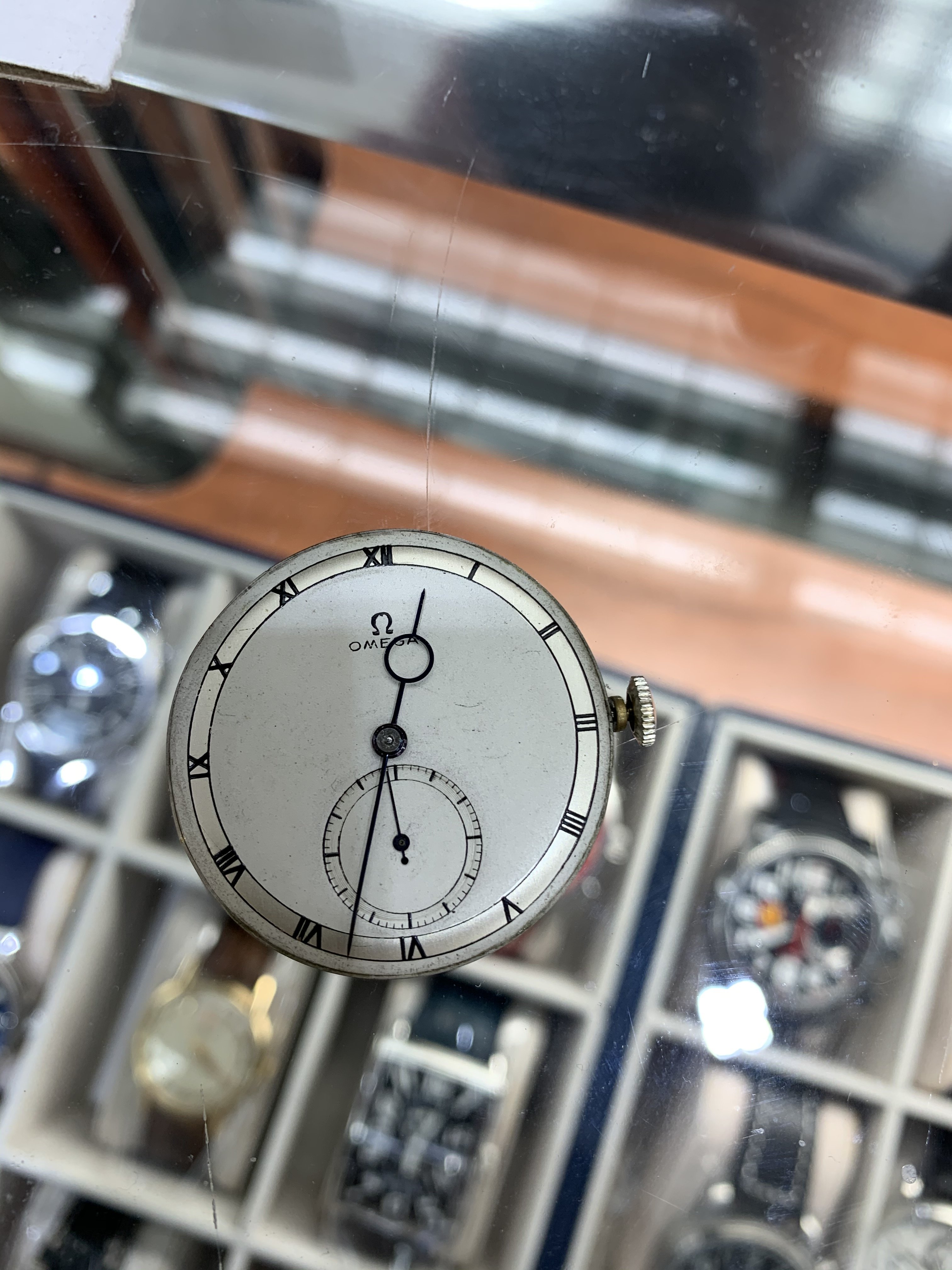

Dial is redone I'm afraid

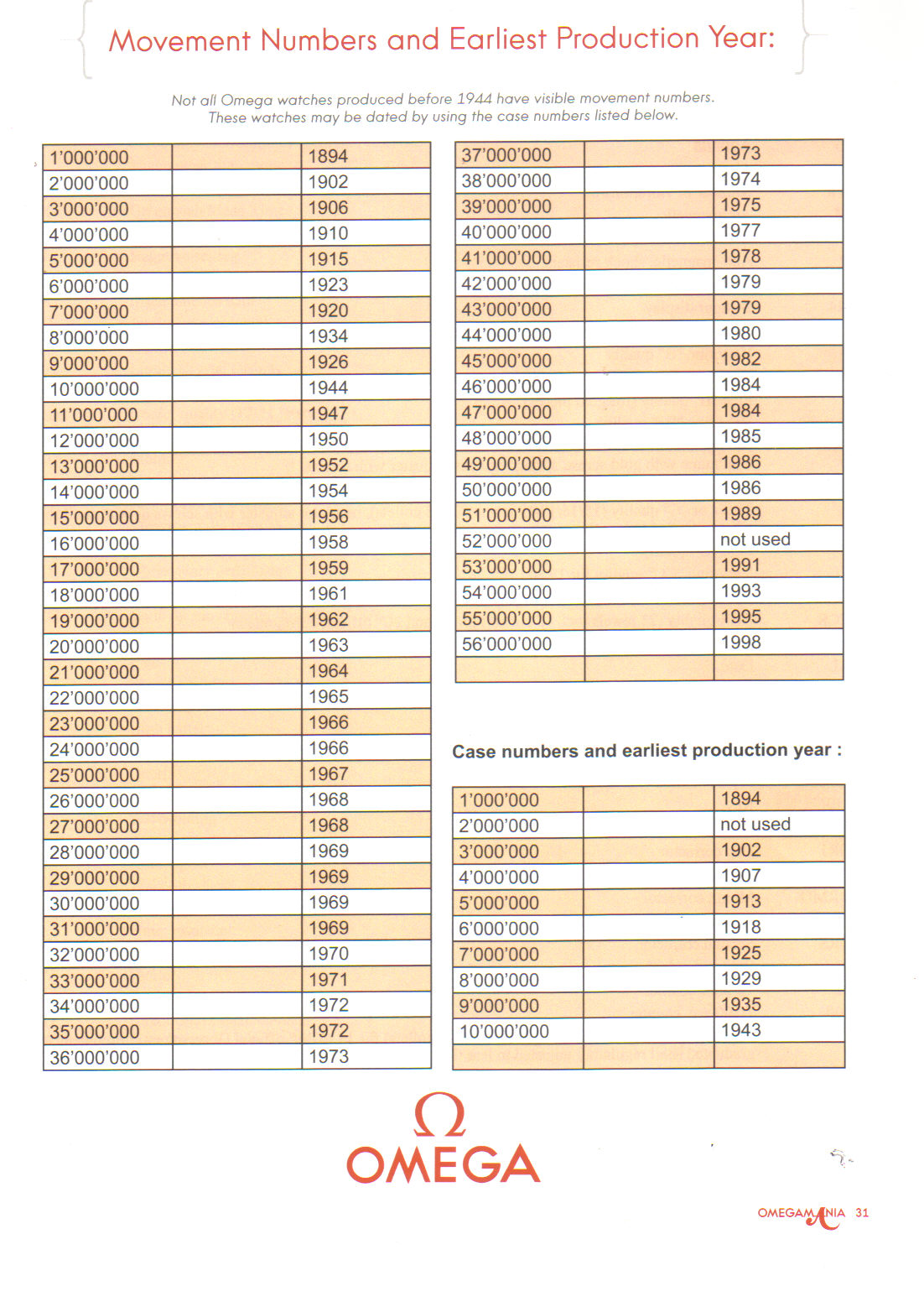

Movement and case serial numbers are not expected to match, just to correspond to the same general time range. Here is the standard chart that shows movement and case serial number ranges. Unfortunately, there are obvious typos where year numbers have been transposed (e.g. 1926 and 1934), but hopefully you can figure them out. Your watch is probably from the early 1940s.

Dial refinishing was a more common part of servicing a watch back in the day. Get it serviced and wear it with pride 👍
3,653
7,770
As mentioned above the dial is a bad re-paint but otherwise the watch is fine.
You hardly will ever find an Omega wristwatch with same movement and case serial numbers.
The ranges of your numbers are reasonable - so most probably you will receive an EoA when you ask for one.
There you will have the reference number, the production date and country of delivery - so all you want to know.
Go for it if you don´t mind the costs, but maybe service could be down at the moment due to the virus situation - just ask.
