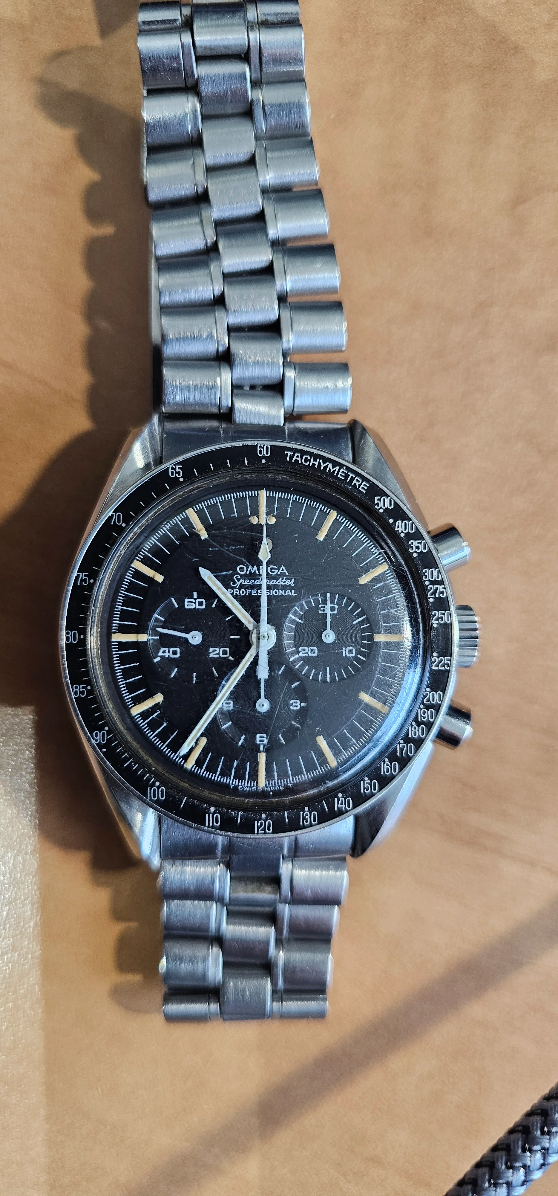

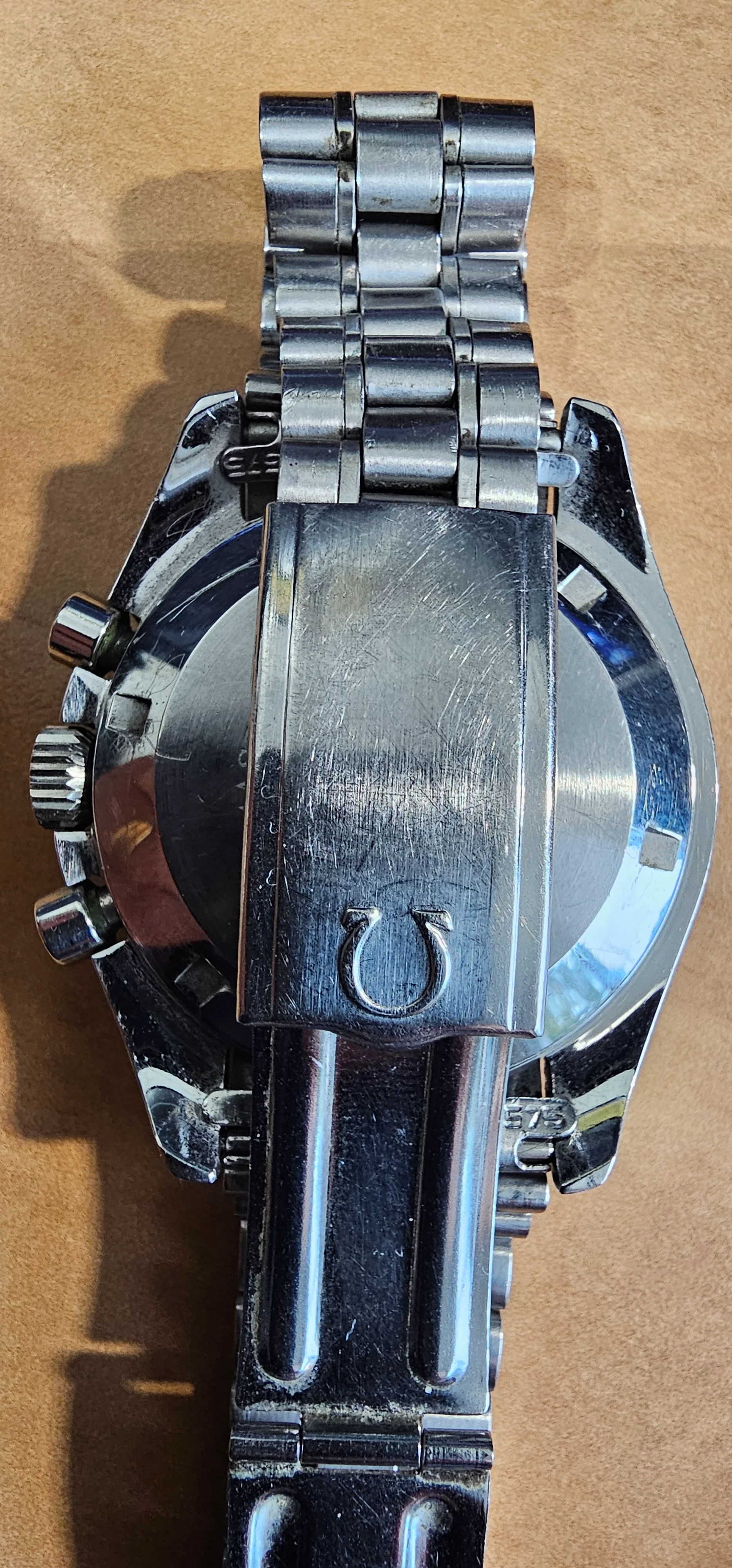

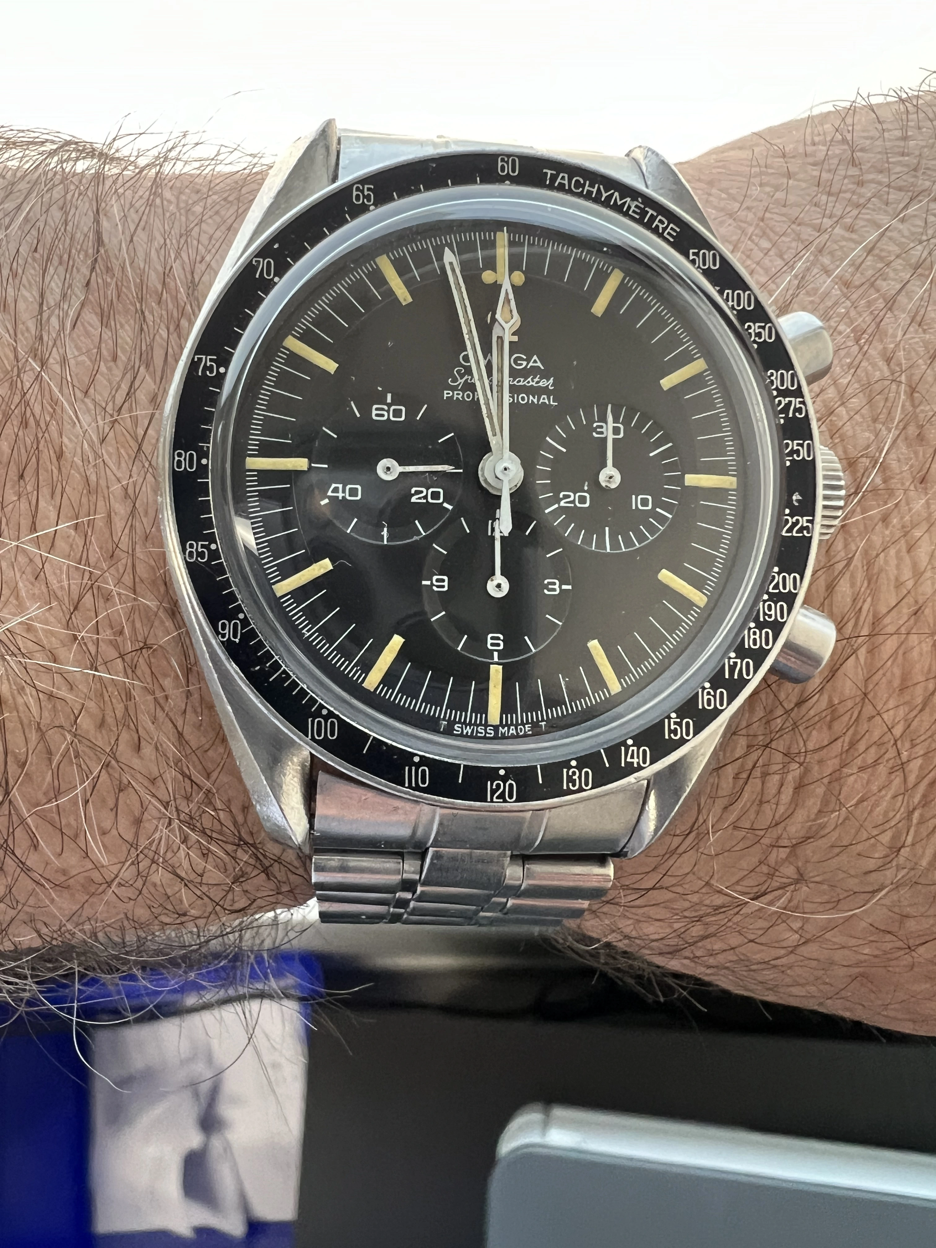

Hoping for help identifying an inherited Speedmaster before I have the caseback opened.
Provenance: it belonged to my grandfather, an engineer who used it for factory timing work. It passed to me and has sat in a drawer for several decades. I can say with confidence that no money was spent servicing or refurbishing it after the early 1970s.
Condition: heavily scratched hesalite, degraded gasket residue around the bezel and crystal seam, some green corrosion at the pusher tubes and between the lugs. Scratches on the outside of the caseback.
Photos attached.
My questions:

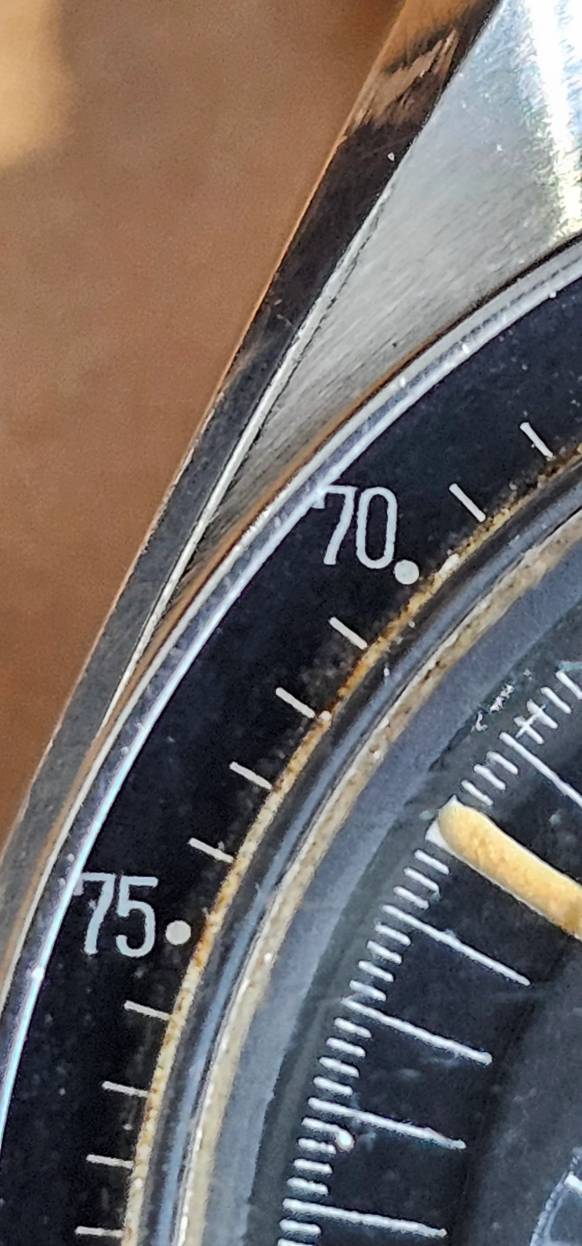

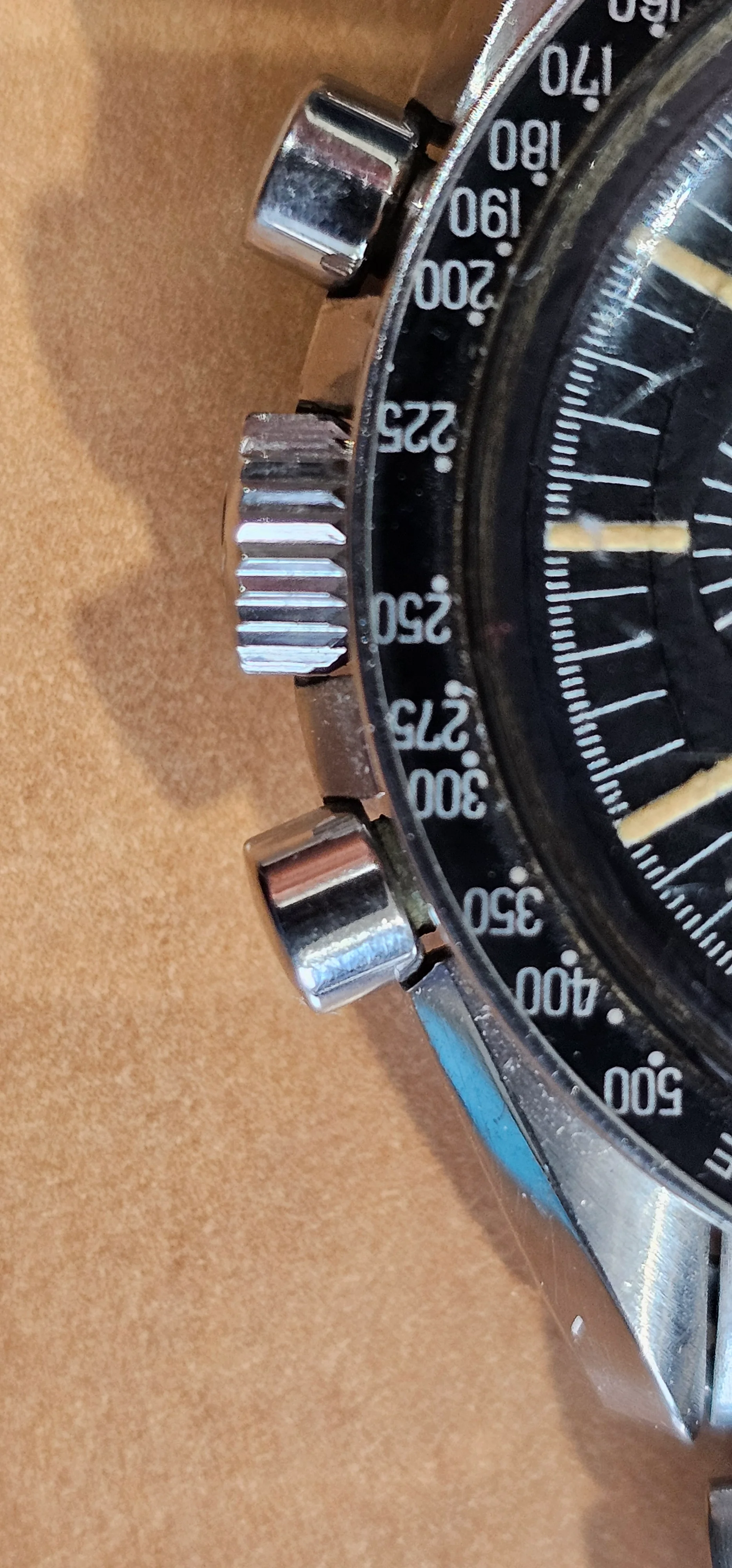

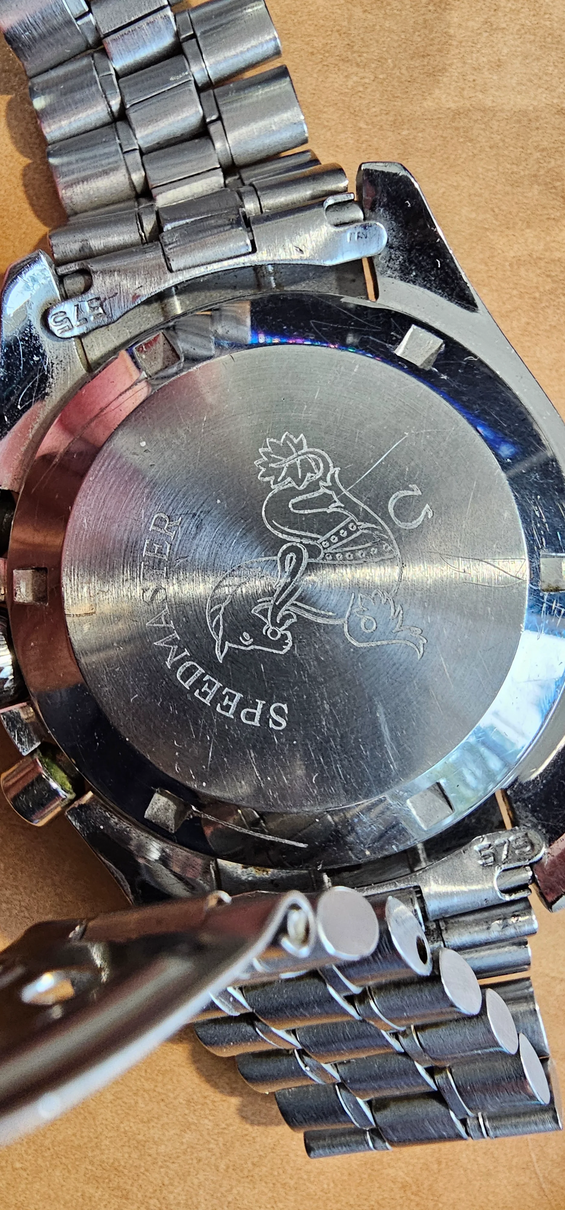

Can you narrow the reference from the exterior? Asymmetric case, crown guards, applied logo, "Professional" dial, pre-moon caseback with seahorse and no NASA text. I'm reading it as 145.012 or an early 145.022, and the pushers look like the taller straight-sided type rather than the short 105.012 pushers. Does that hold up?

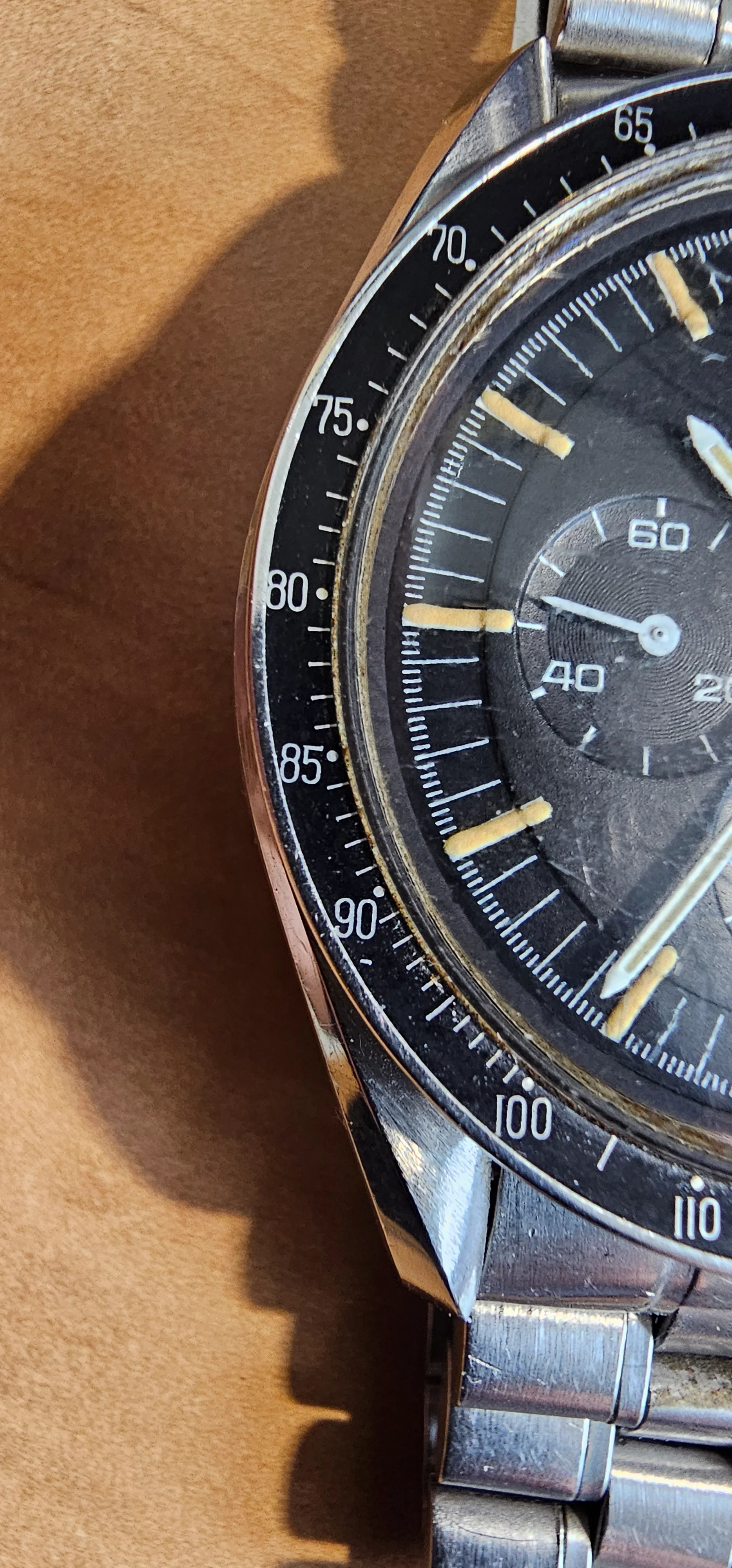

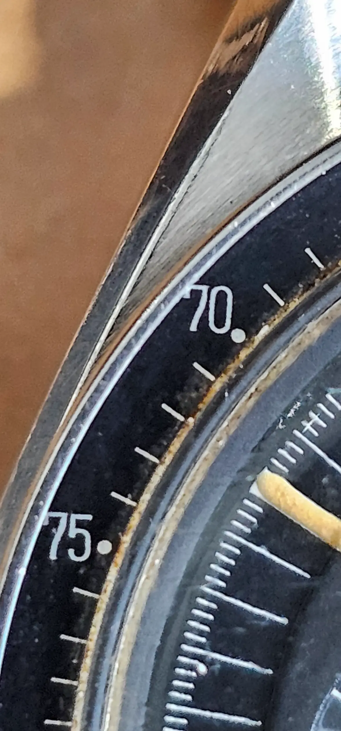

Bezel: I read it as an accented TACHYMÈTRE with dot over 90, dropped dot at the lower right of the 70, and a serif on the 7. Can you confirm DON, and confirm it's a period insert rather than a later replacement?

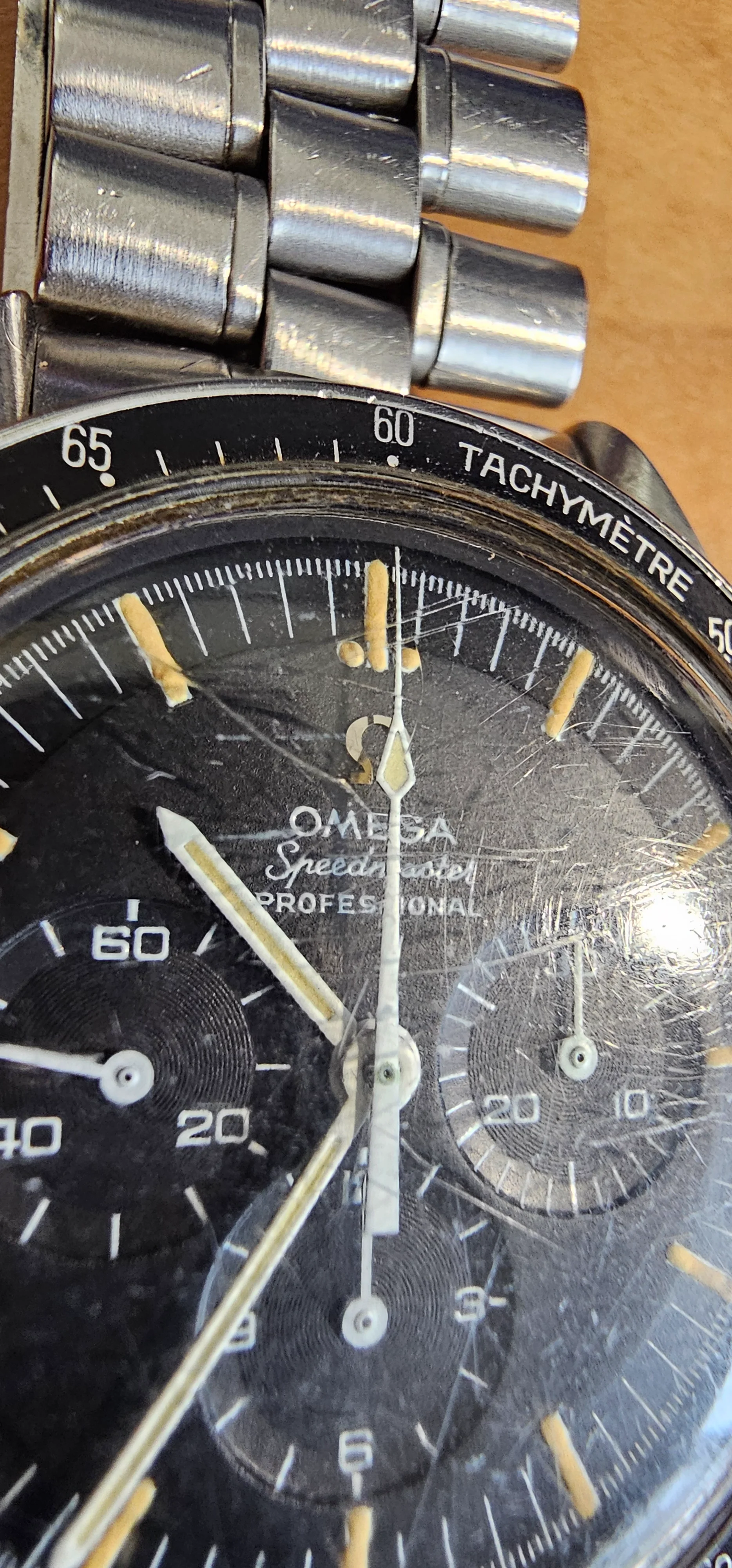

Dial and hands: does the dial read as original tritium with no relume or refinishing, and are the hour, minute, subdial and central chronograph seconds hands all correct for the period?

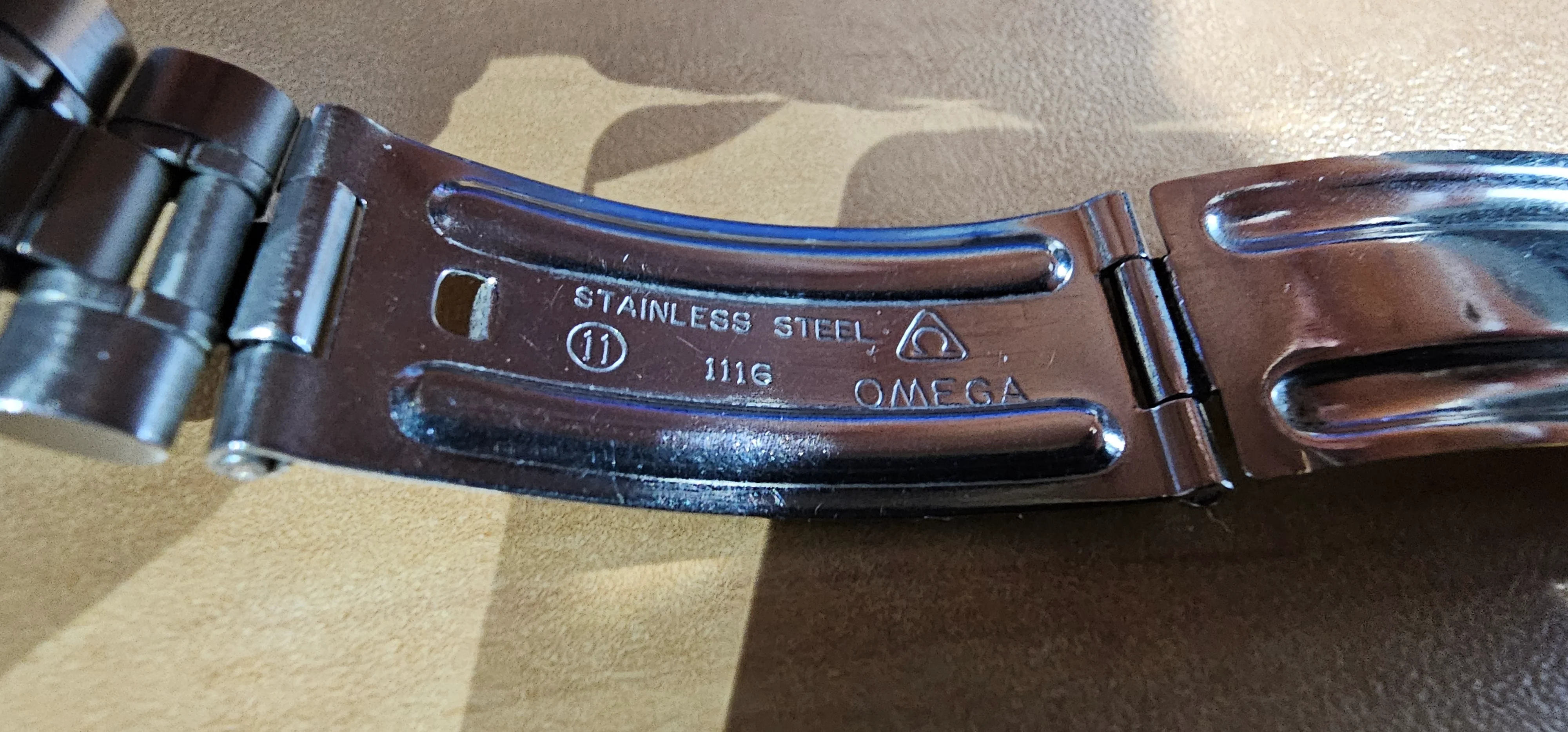

Bracelet: 1116 with 575 end links, clasp stamped STAINLESS STEEL / 1116 / OMEGA with a circled 11. What does the circled 11 date to, and is the bracelet plausibly original to this watch?
Anything I'm missing or getting wrong?
Once the reference is narrowed I plan to have an independent open it for the caseback stamp and movement serial.
Thank you.

I’d say you are spot on in your assessment it looks like 145.012 in good condition and will
Clean up nicely with service and crystal polish. It could also be a 145.022-68 transitional but less likely
And the bracelet reference is contemporaneous to the watch and most likely original.
You have clearly done your homework.
Please confirm when you see the insides.
13,539
23,486
I think it’s as you say. An all original Speedmaster from the late 60’s. Bracelet is also highly likely to be original.
Really nice piece and heirloom.
It’s either a 145.012 or a 145.022-68. My money would be on the latter but the only way to know for sure is to get the caseback removed.

I also think a 145.022-68 transitional, mainly because of the center seconds hand. Did the 145.012 ever come with the slab-sided seconds hand?
10,784
16,787
You mean as opposed to the spear kind seen earlier? Yes. All models from the 145.012-67 onwards can be found with the square end hand, there isn't a defined cut off but it is unusual to see a spear hand on the 145.012-68 or 145.022-68. As already noted, it could be one of 3 models really, and as such both 321and 861 movements could be inside. If I had to guess, I'm with 145.012-68 but it's just a guess.

1116 was original option for 145.012
But in reality it’s difficult to say with certainty what was the original bracelet
