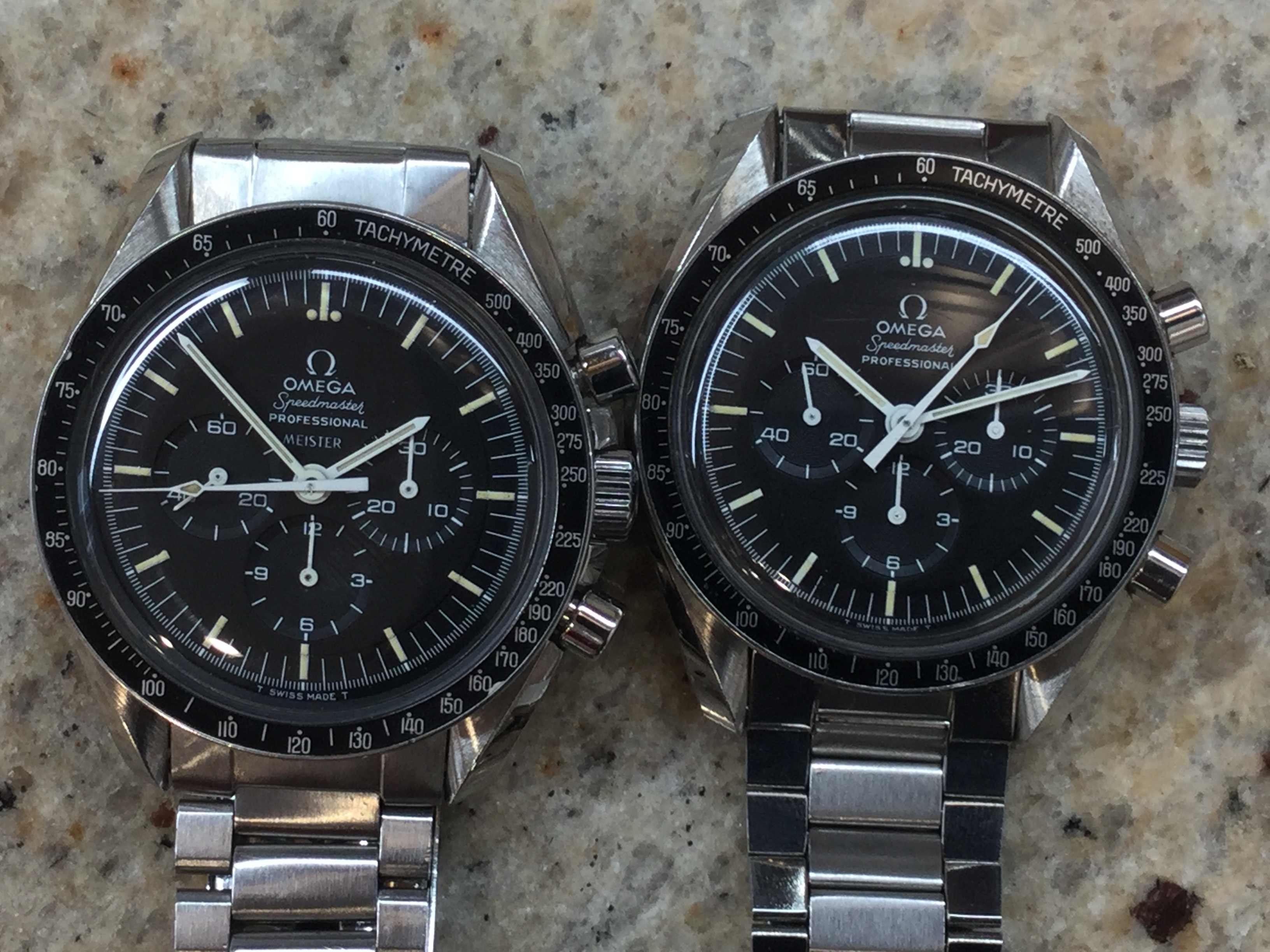

145.022-69 with 220 bezels

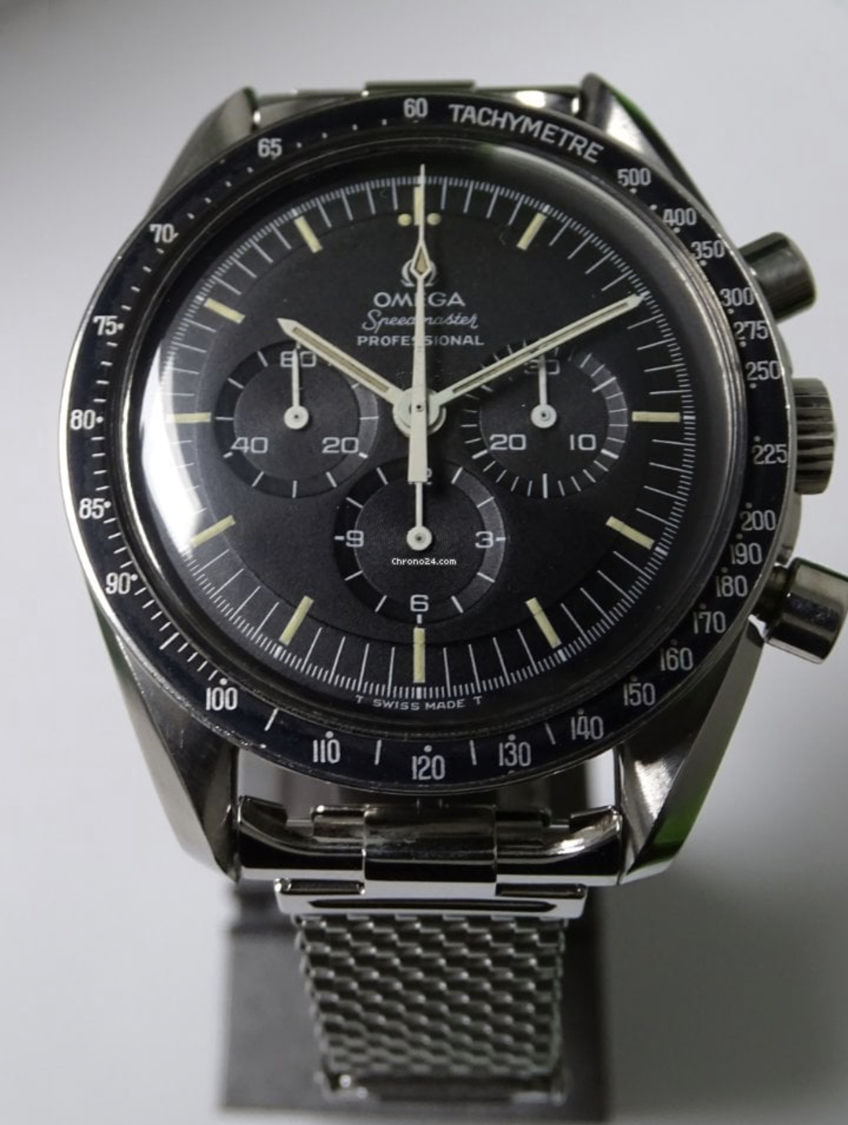

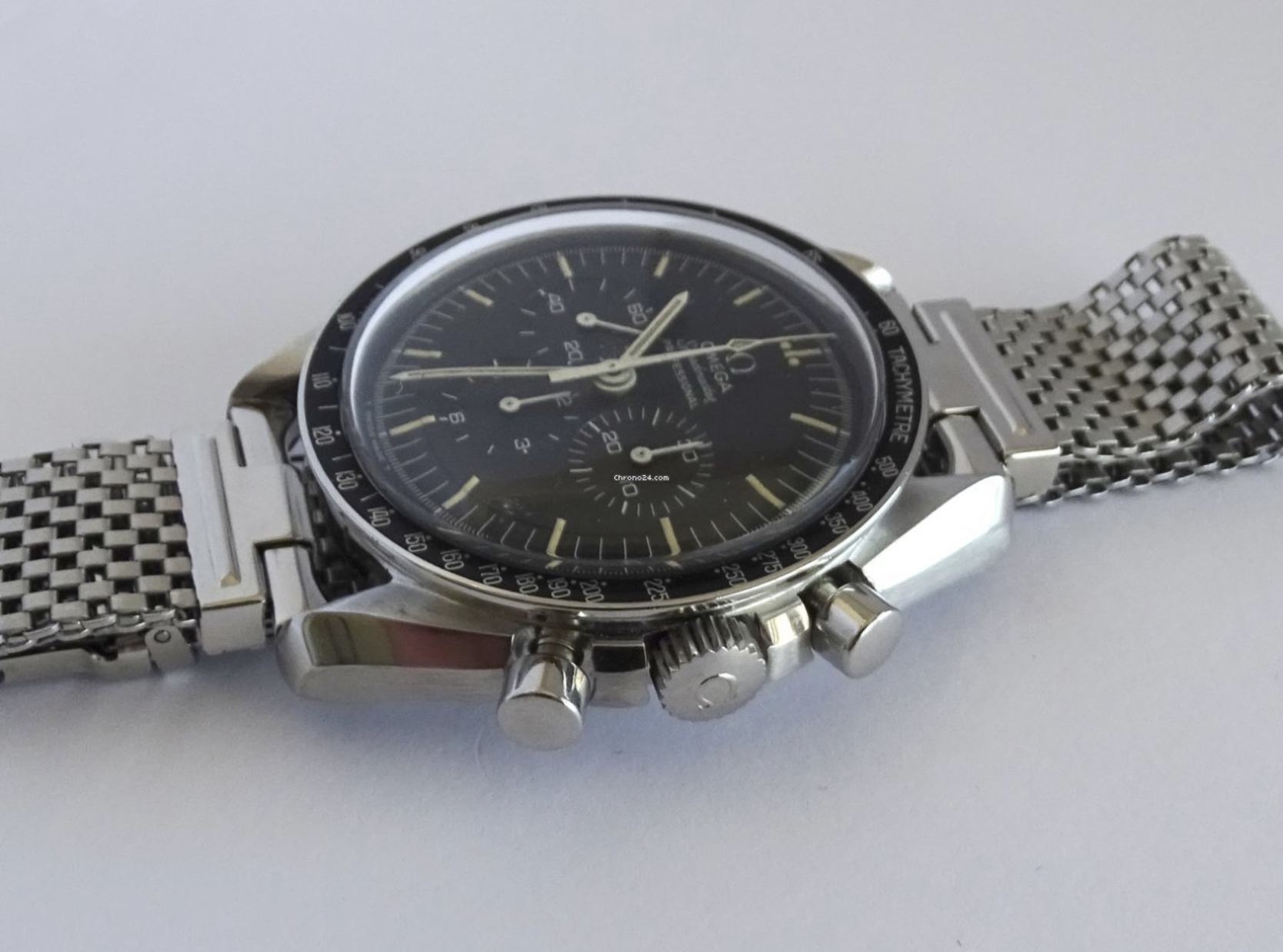

What do you guys think of this 145.022-69 DNN?
Except of the pushers and the crown the watch looks good and original, in my opinion. I would say it‘s good to very good. The bracelet is a Frostner, ot very expensive (125 $ new). I‘m skeptical of the bezel. Is it original or replaced?
