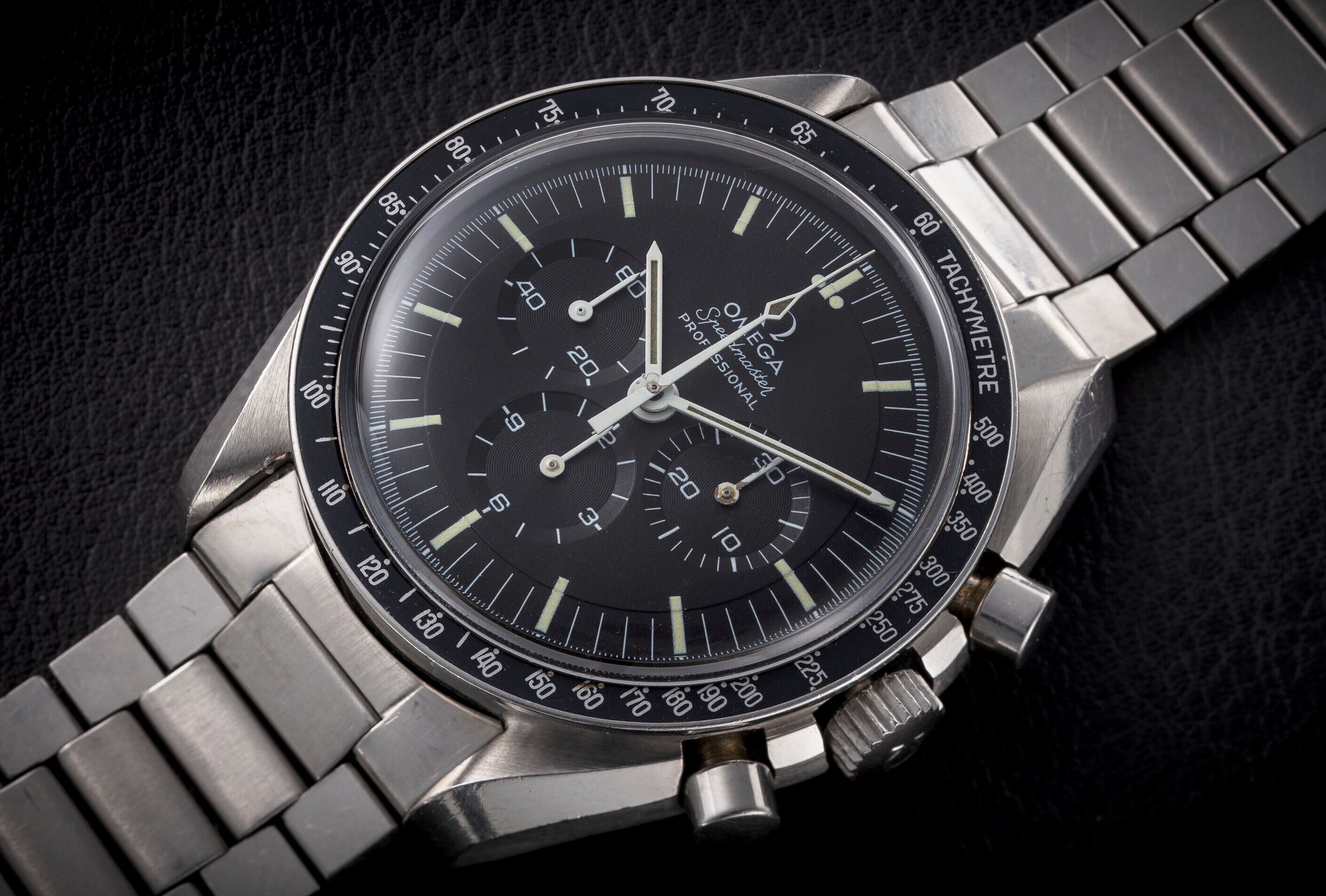

OP, listen to what others are telling you. You don’t want this watch. Read everything on Speedmaster101.com and then everything that you can find on the 1969 reference. The Moonwatch Only book will be very helpful in this regard. Look at other examples and ask questions of other members here as you did with this watch. You don’t want your first Speedmaster purchase to be an expensive mistake.

The price chart on Speedmaster101.com is a good starting point. Note that the price range varies by condition and that the prices are for the watch head only (a bracelet will add to the price, possibly significantly depending upon the type of bracelet and condition). Possible places to find one are the OF private watch sales forum, eBay, Chrono24, auction houses and vintage watch dealers. TAKE YOUR TIME AND LEARN FIRST. Vintage watches are a minefield. You need to gain the knowledge to make a good selection and that doesn’t happen overnight.

Tip from a pro: don't buy a watch with a wrong dial and think you will make it right by finding the right dial later. It does not usually end well, even if it is possible sometimes.

Smart. It's exciting when you decide you want a vintage Speedmaster and then find one that interests you. Very understandable. There are also sellers who know that and will put together watches hoping someone with little experience will buy it.
One of the first commandments is condition. Another is buy the seller, not just the watch. Lastly, you may not think it right now, but there are plenty of watches. Best to be patient.
And when you eventually do find your watch, you'll look back to this one and be grateful you waited.

The correct bezel depends on the serial within the -69 range. The 220 bezel may be correct for that watch since it is in the early part of the DN90 range. All -69 Speedmasters should have a step dial.

You said in your first post that new was an option and then you decided you wanted a vintage piece. In your case you might want to reconsider a new 3861 which has certain benefits, including a five year warranty and better precision, or look at the previous 1861 versions made in the last ten years or so which are available all over the place at relatively reasonable prices. You really don't want a first Speedmaster that has issues right from the start, and then it becomes a project watch. That's a total buzzkill. There is nothing wrong with new, or nearly new.

Hands and dial are wrong. Most likely late 70’s device replacements.
Right, but when I wannted a new one, I didn‘t know that the new one are not the same as around 1961. That was why I had a look for them A 321 is too exoensive and a 69 pre moon is the real Moonwatch, in my opinion.

As many already mention wrong dial and hands.
The wrong dial would have been enough to run fast, especially since apparently it was not disclosed.
