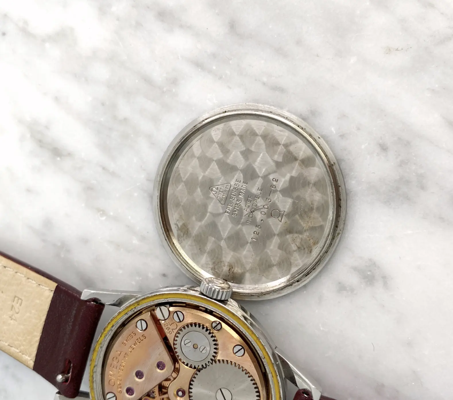

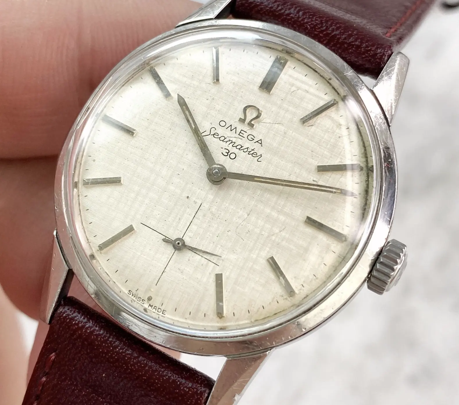

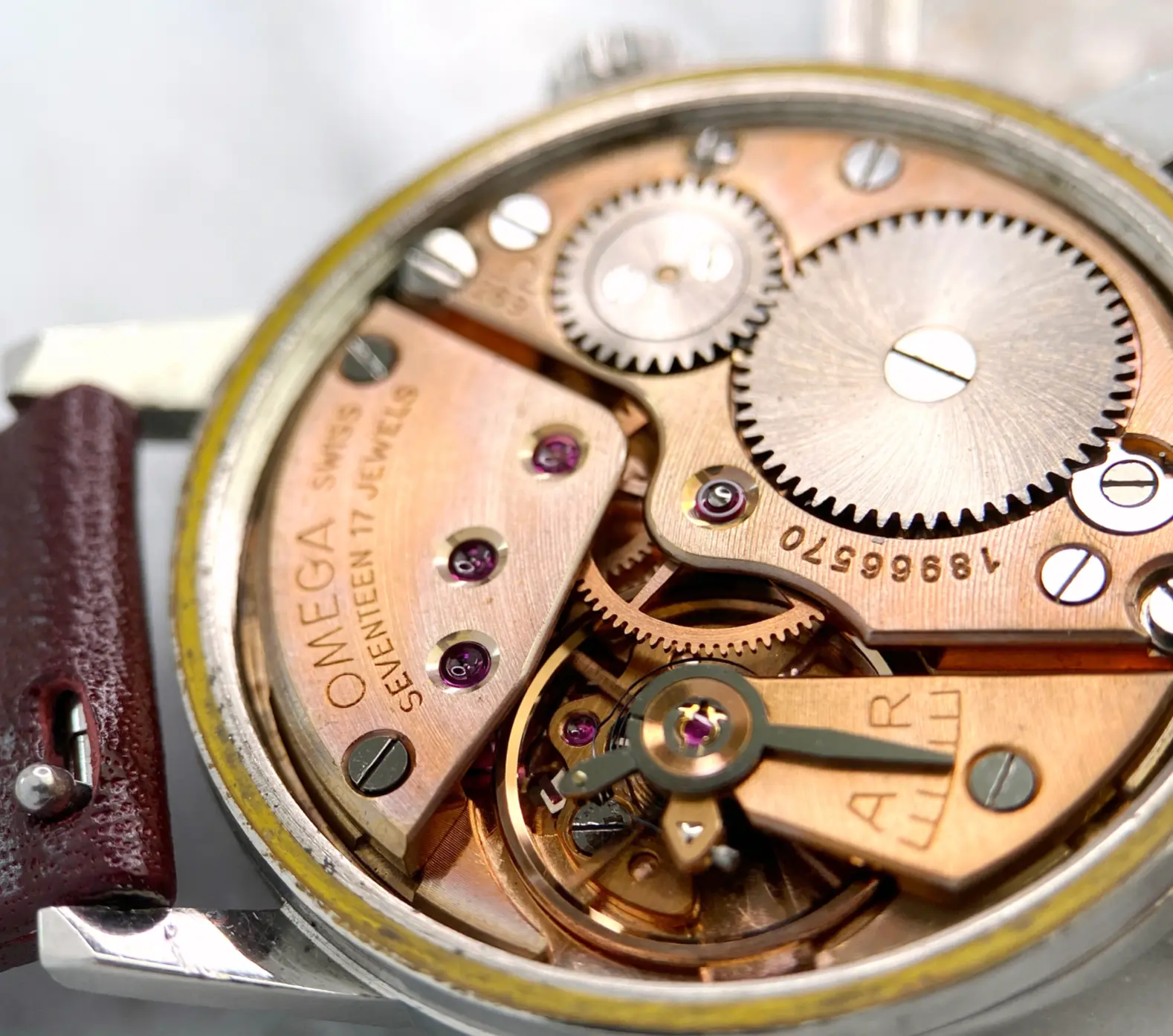

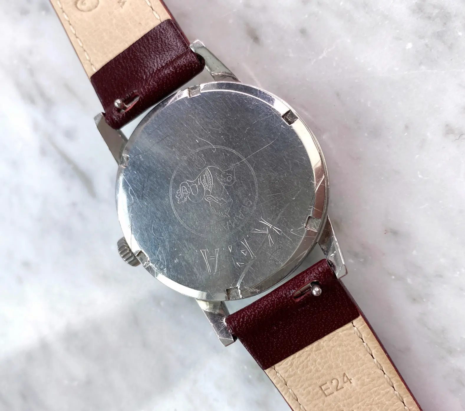

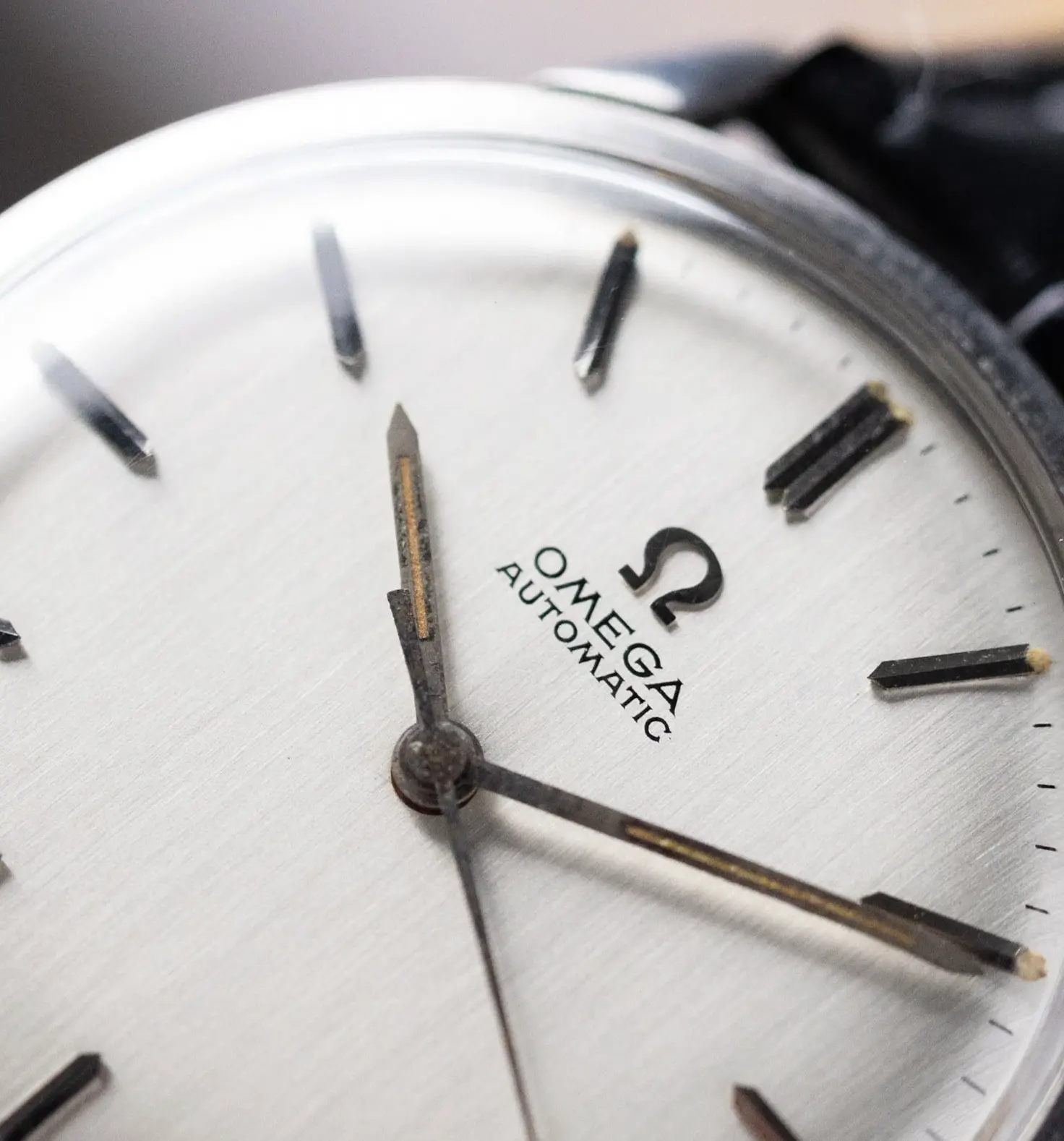

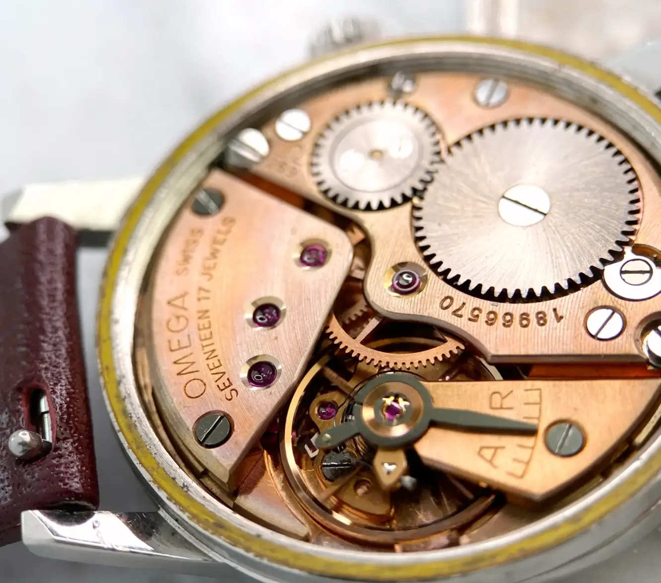

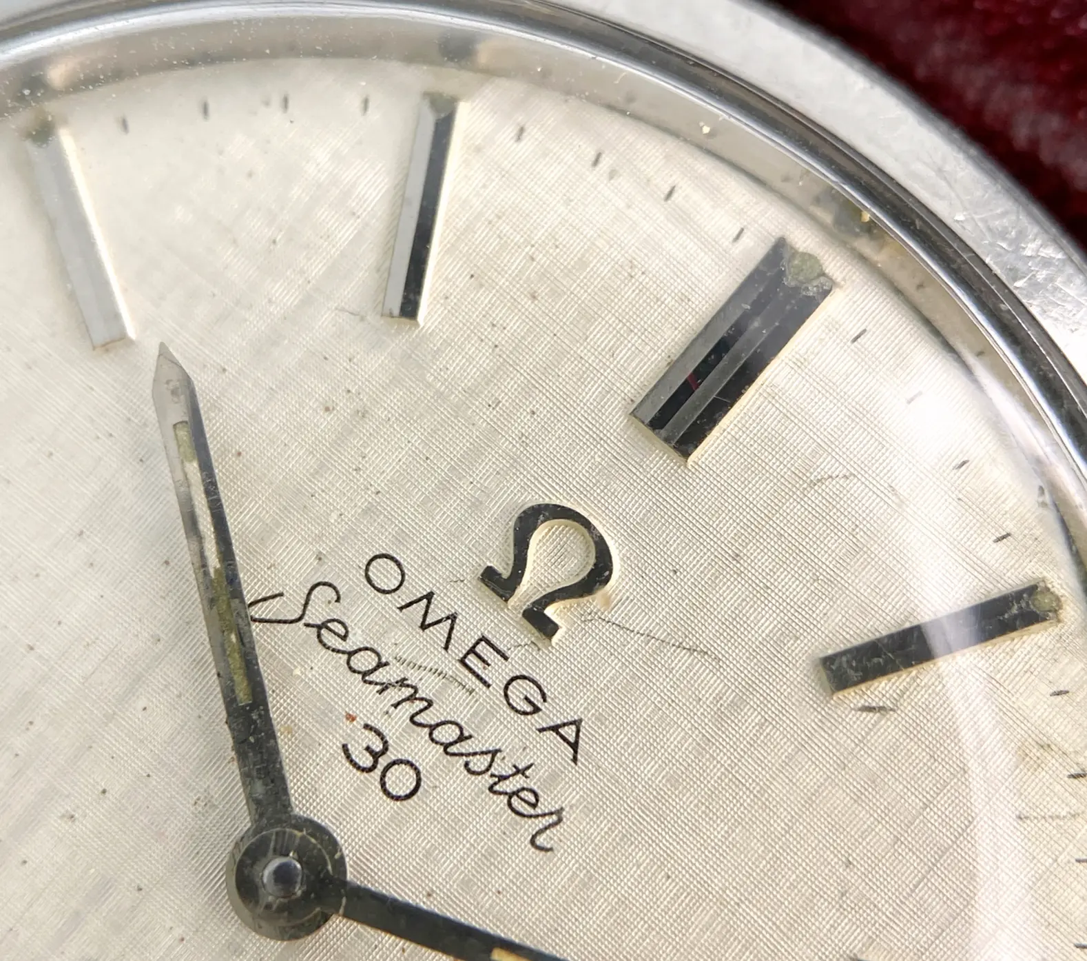

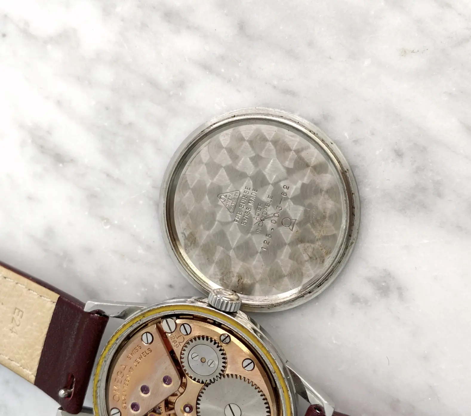

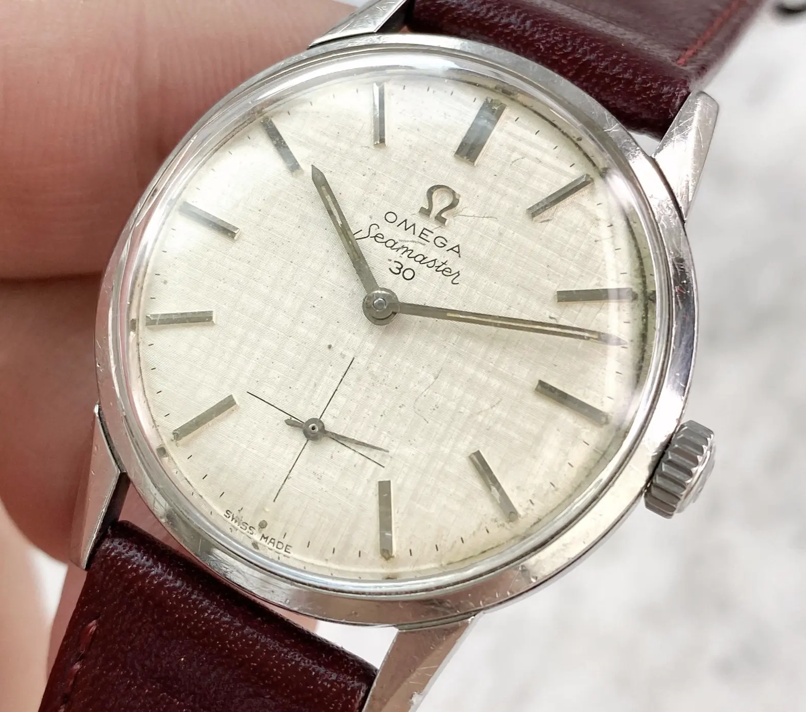

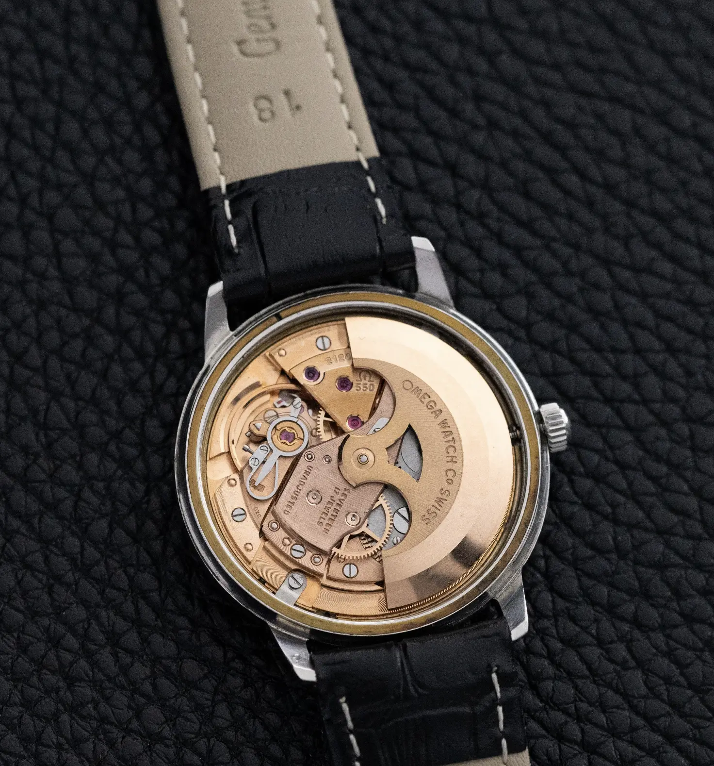

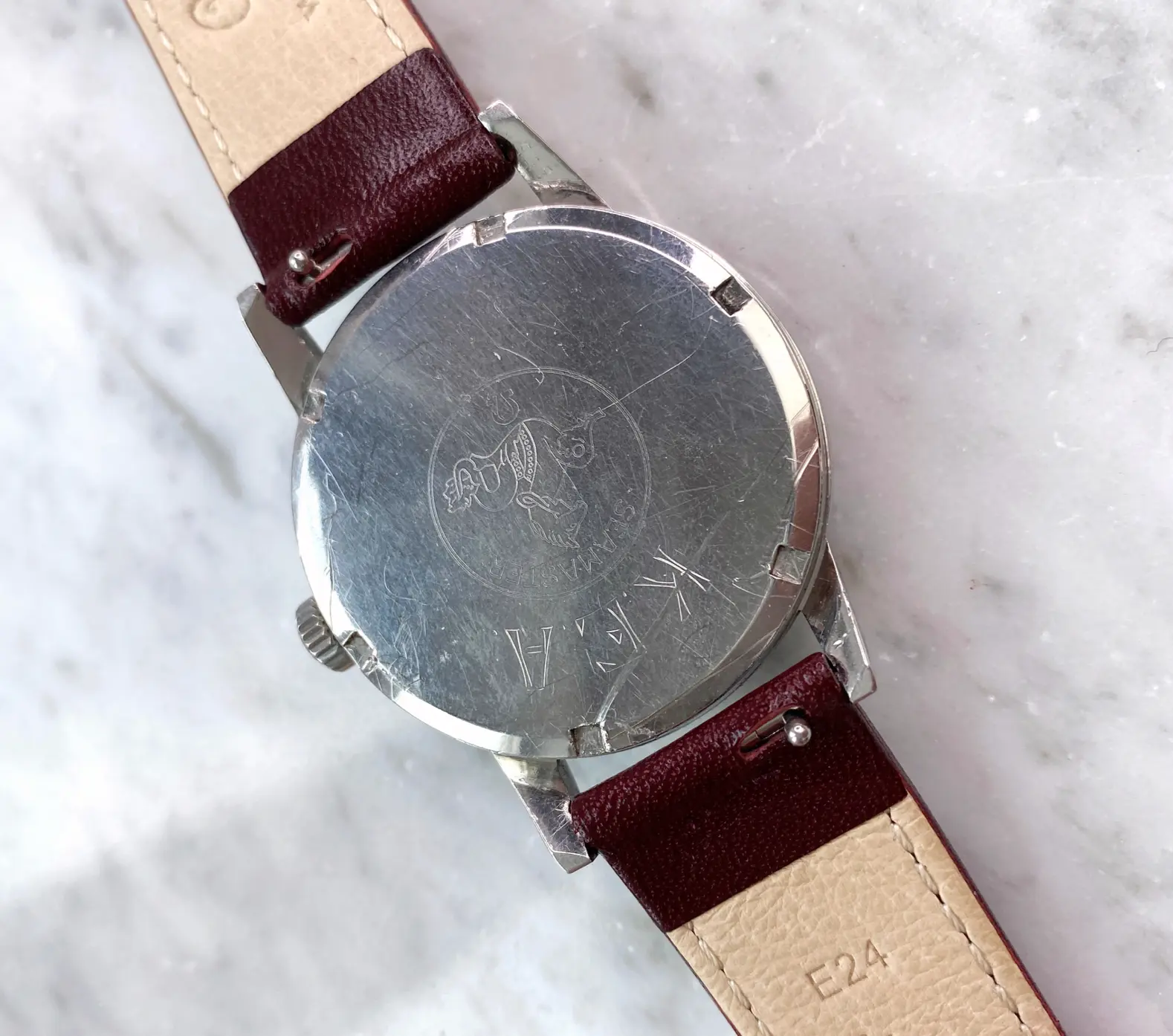

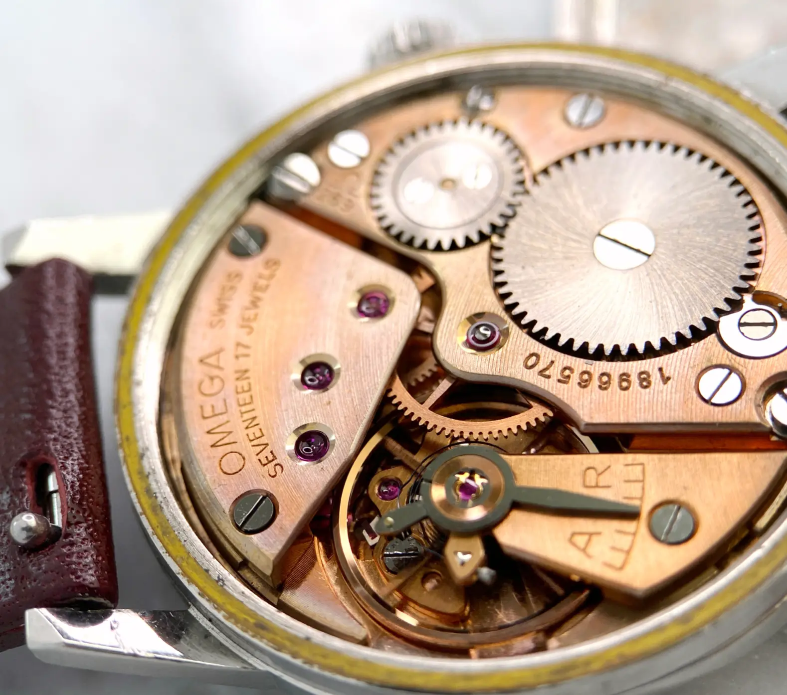

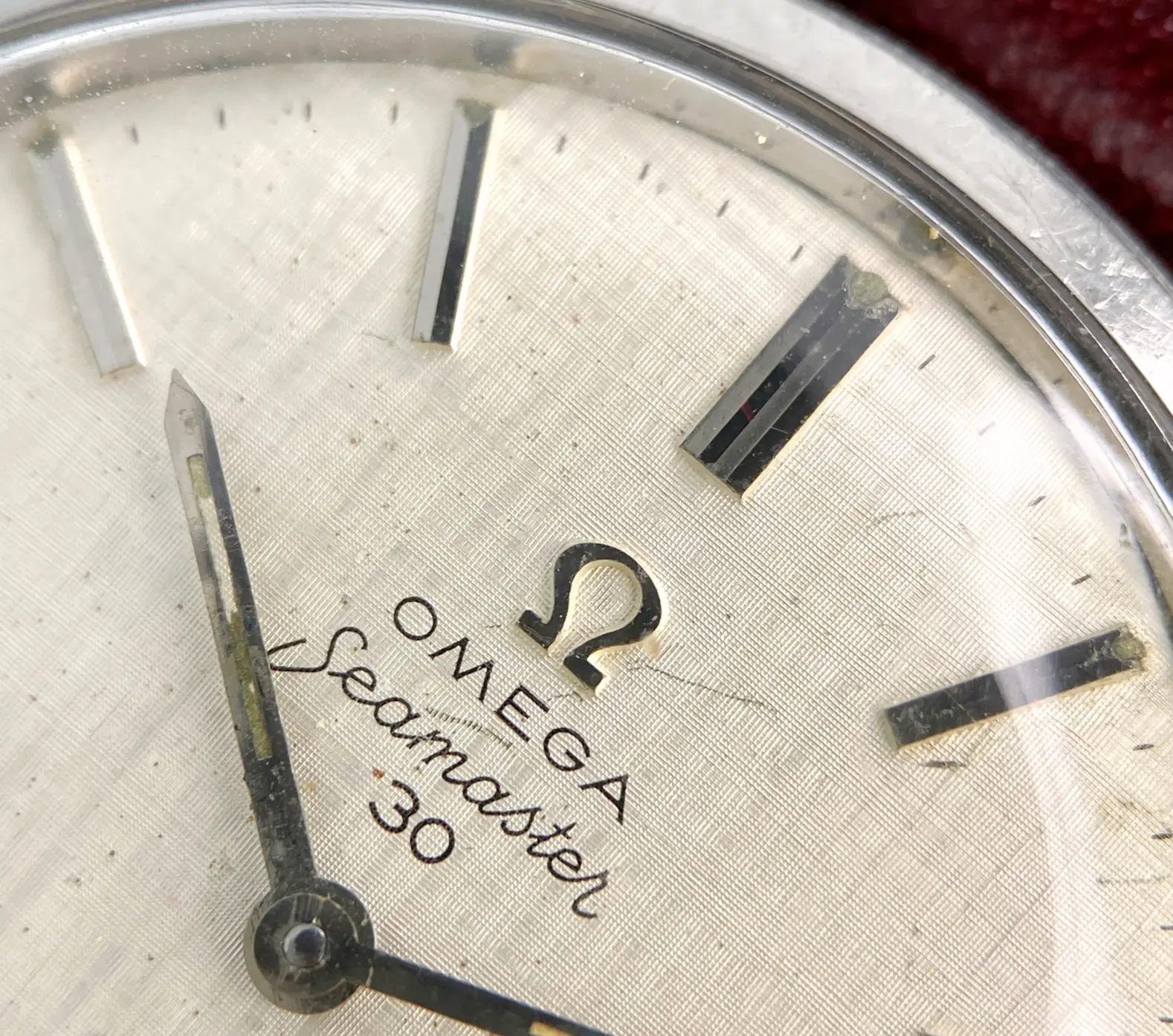

First one: Seamaster 30 Vintage, ref 125.003 (1080eur)

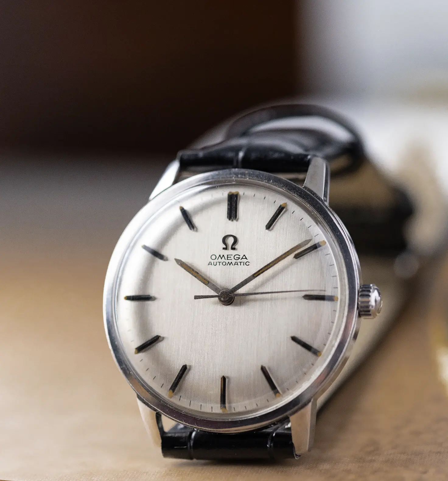

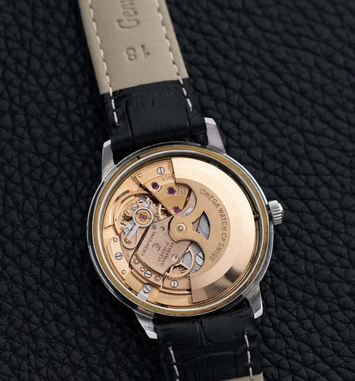

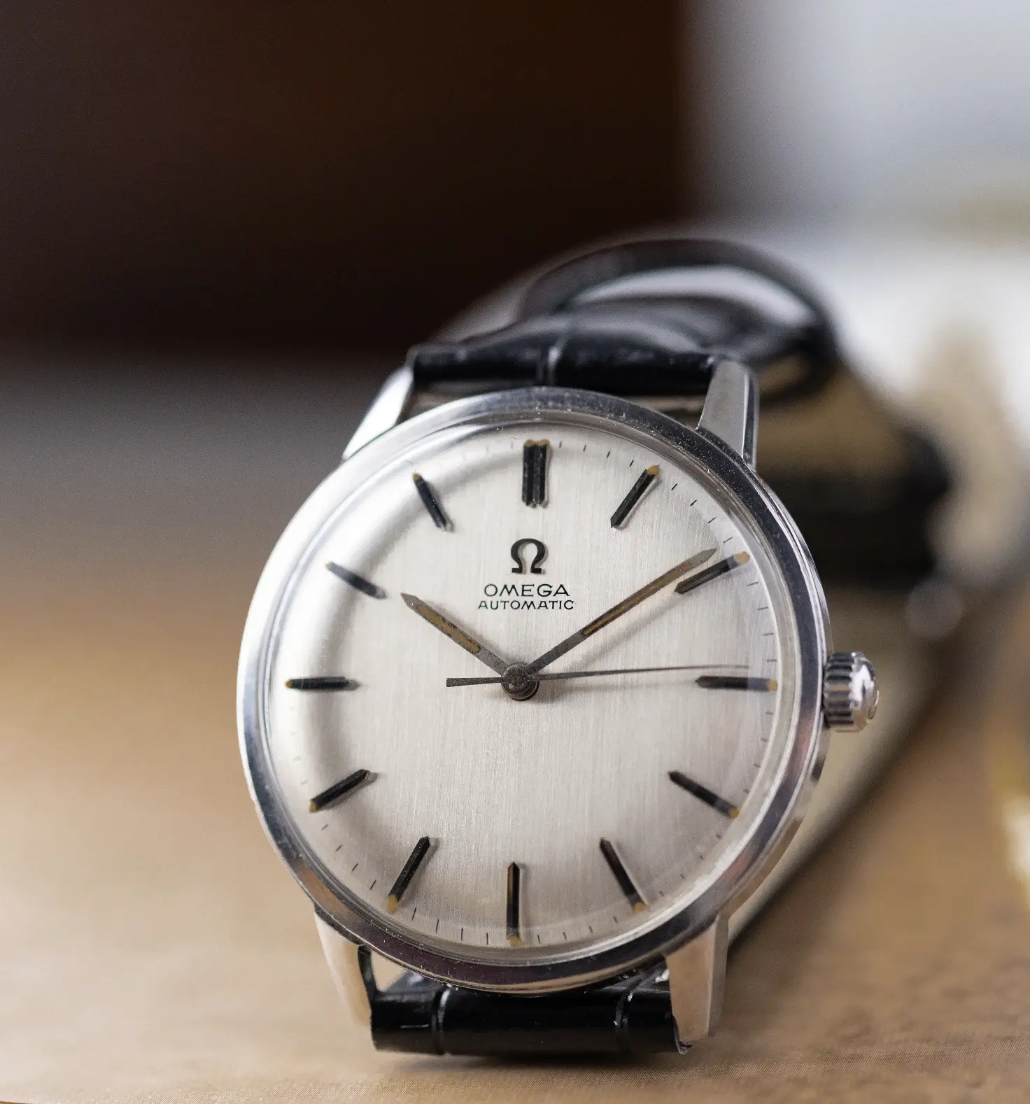

Second one: ref 185.022 (1490eur)

Avoid vintage-portfolio. He’s been banned from the forum multiple times for a reason.
The second one is vastly overpriced unfortunately, even for a dealer. If they charge a high amount I’d at least expect them to offer a properly serviced example, not a watch with an old, broken gasket.
24,541
54,515
Agreed about vintage-portfolio, you want to stay away from him. The second watch looks decent, but at least double what I'd consider paying.
