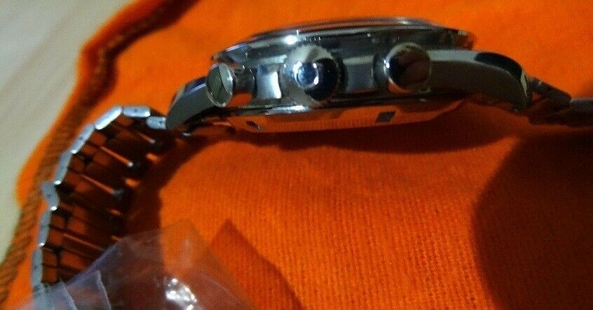

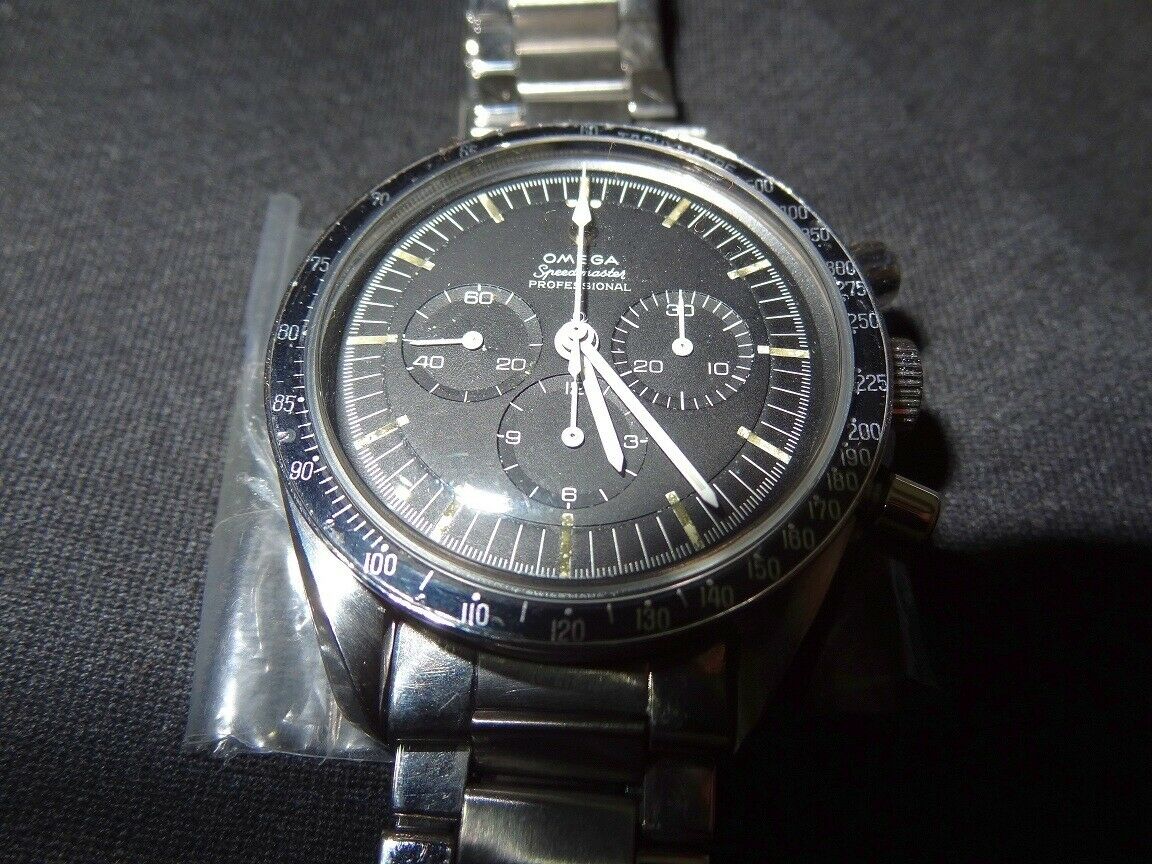

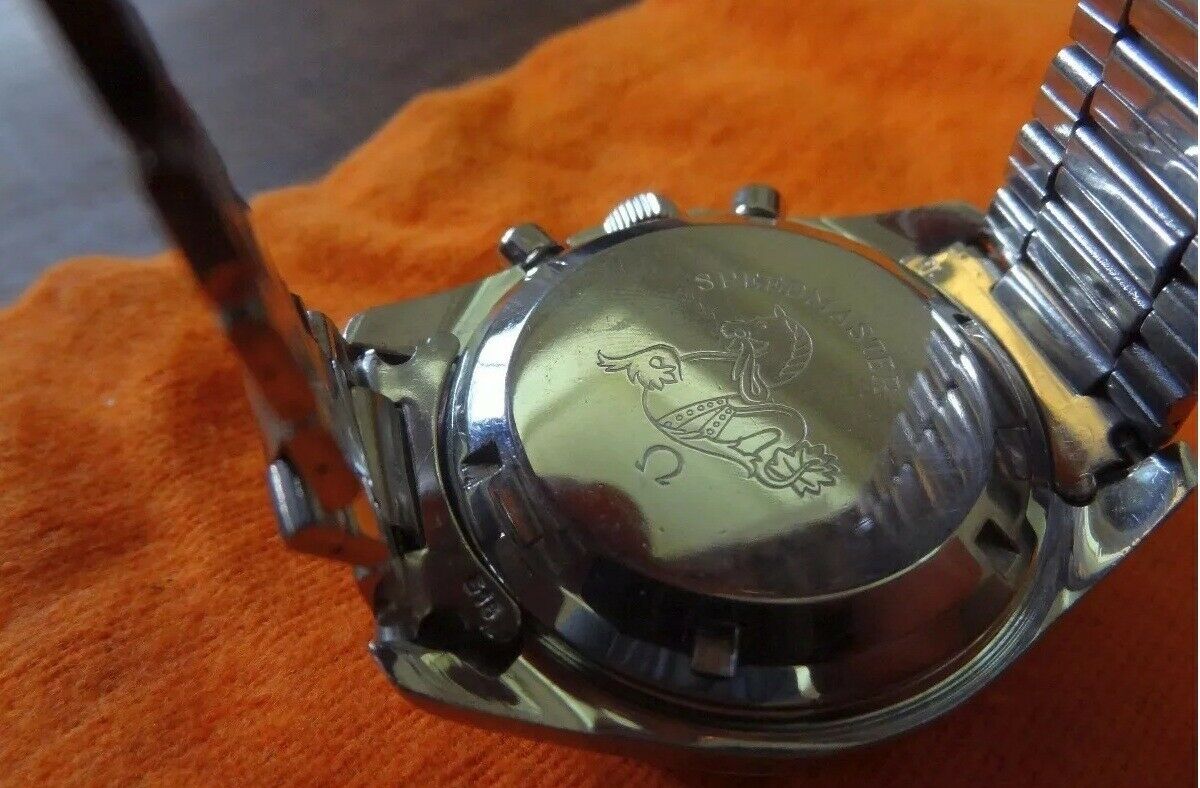

Hi OF,

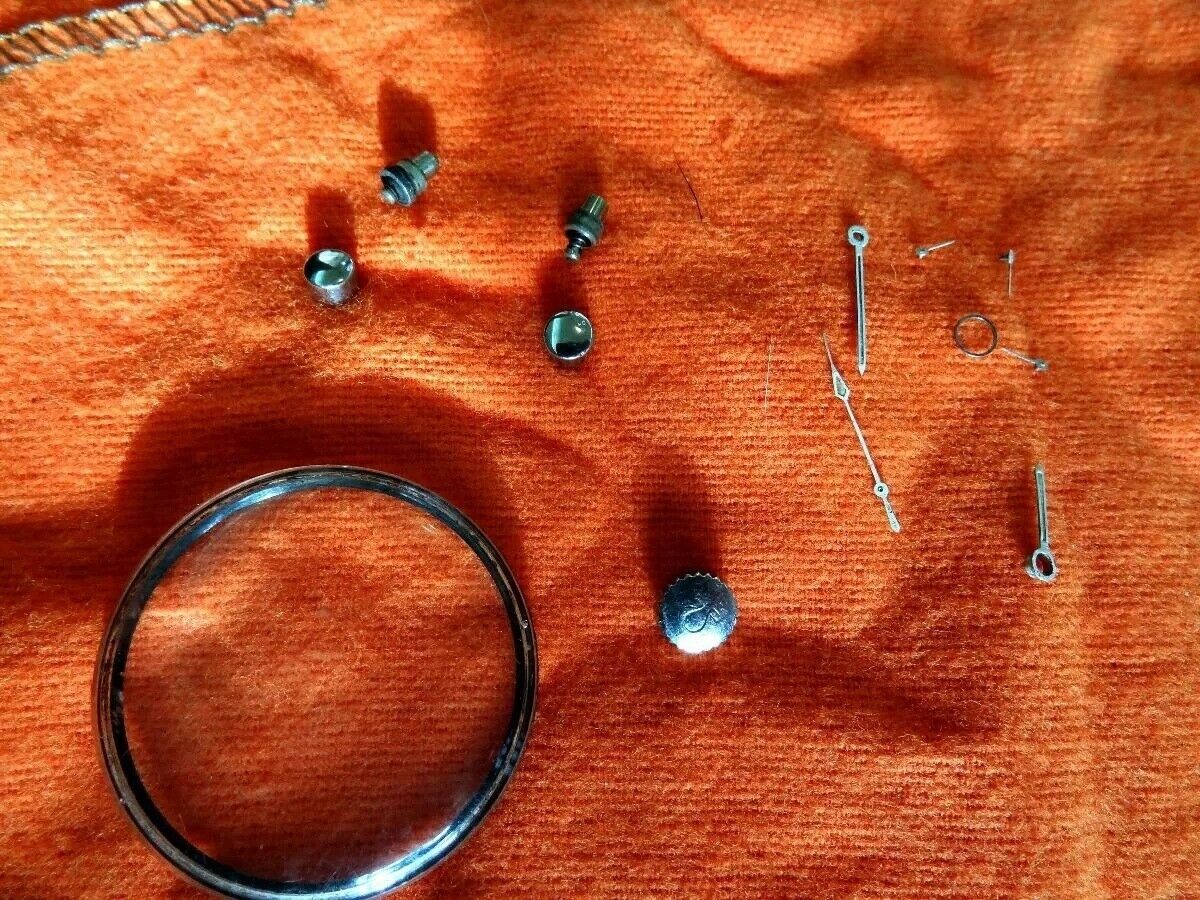

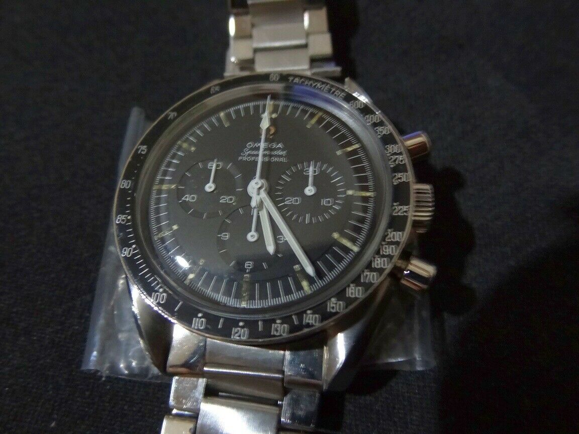

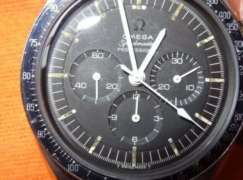

Need some advice on a potential purchase. Seller is from Cali, Colombia and photos aren't great, but would like to see if anyone can tell if the dial has been refinished / repainted or if there are any other potential red flags on this piece. Hands and crown are service replacements but will come with originals (shown in pictures below).
Seller advised that they purchased the watch in person second hand in Florida in 2015, and last serviced in Nov 2019. Serial number is 22 million. Seller doesn't know how to open up the case back so no movement photos.
Any advice appreciated. Thanks!
913
1,596
The dial has not been refinished or repainted. The lume is well deteriorated as you probably can tell. I don't find it attractive in it's current state.

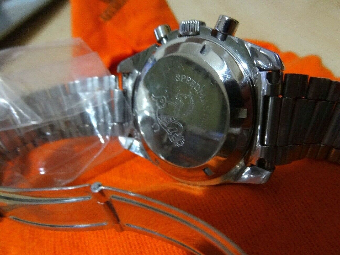

I wouldn't be buying a watch of this kinda from Colombia (or anywhere) without a movement shot. How does the seller know it's a 22m s/n if he can't open the back? If he had a watchmaker open it for him, then he can have the watch open it again to take a photo.

Thanks gdupree. I did have some concerns that the "T's" on the "T Swiss Made T" may have been refinished. Agree on your point that tough to confirm movement is a 22mil serial, and will need to open up the movement upon receipt to confirm, in the event of purchase. Unsure though that if this is inaccurate, whether it would be covered by Paypal's buyer protection.

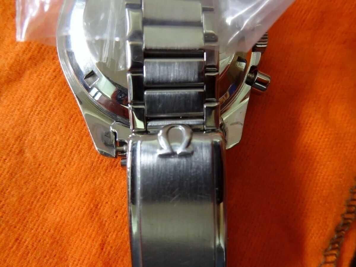

Agree with above. The lume is very unappealing but maybe you are ok with it or prepared to relume it? I can not even tell if the spare pushers are correct from this pic. Also hard to tell state of polishing from these pics. For me this is an easy pass.

Spare pushers look correct (fatter vs thinner replacement pusher tubes). To my eye looks polished but not aggressively. Intention would be to get it re-lumed, but yea I'm on the fence on this one and requesting better photos to make a call.

I have seen T's to be aligned lower than Swiss Made at times. I don't have any suspicions about the the dial. It's not an attractive dial, but it's authentically unattractive one 😉. Jokes aside, the attractiveness is subjective but the authenticity is not in question.
https://omegaforums.net/threads/speedmaster-dial-crooked-ts.57519/#post-711312
Since you asked about any other concerns, you may consider that with badly decomposed lume, the tritium flakes/dust come loose and are free to fall about the movement and eventually cause wear and problems. This is another reason I would want to see a movement shot and proof of service in 2019. Given the hands are replaces and old parts are intact, it probably was indeed serviced at some point, but a movement shot could give clues to the quality of work done, and confirm the S/N... I can't speak to Paypals protection exactly, but I would definitely not be risking that.
