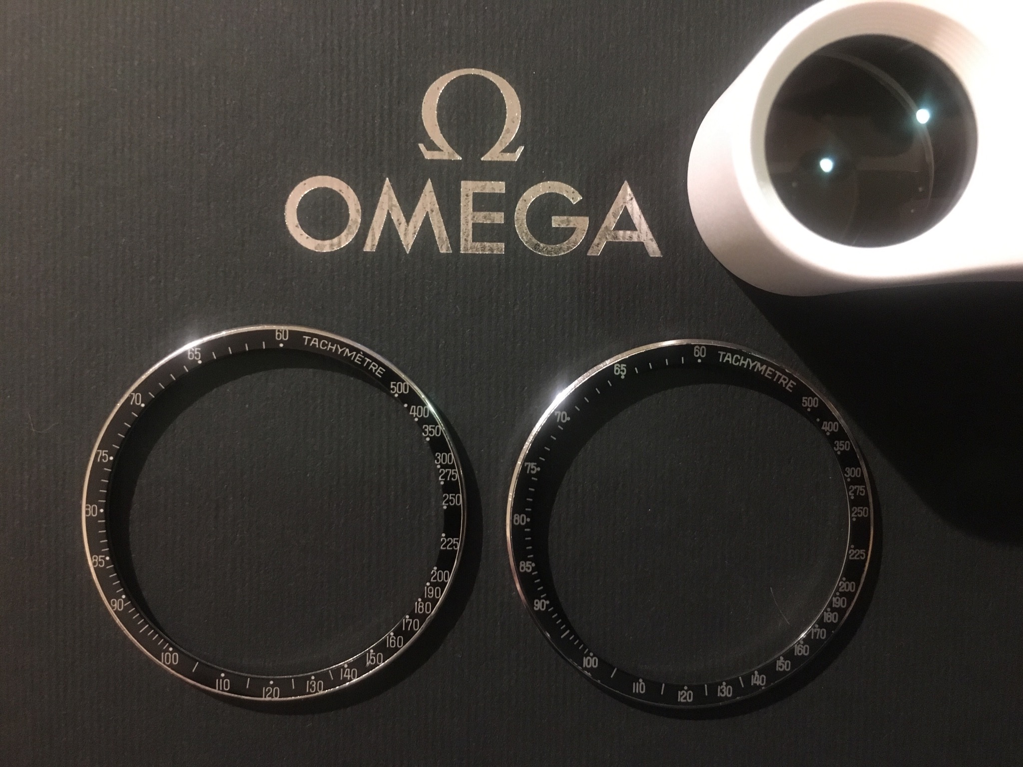

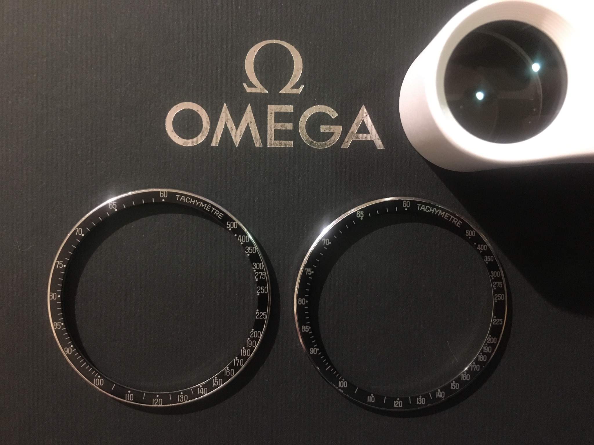

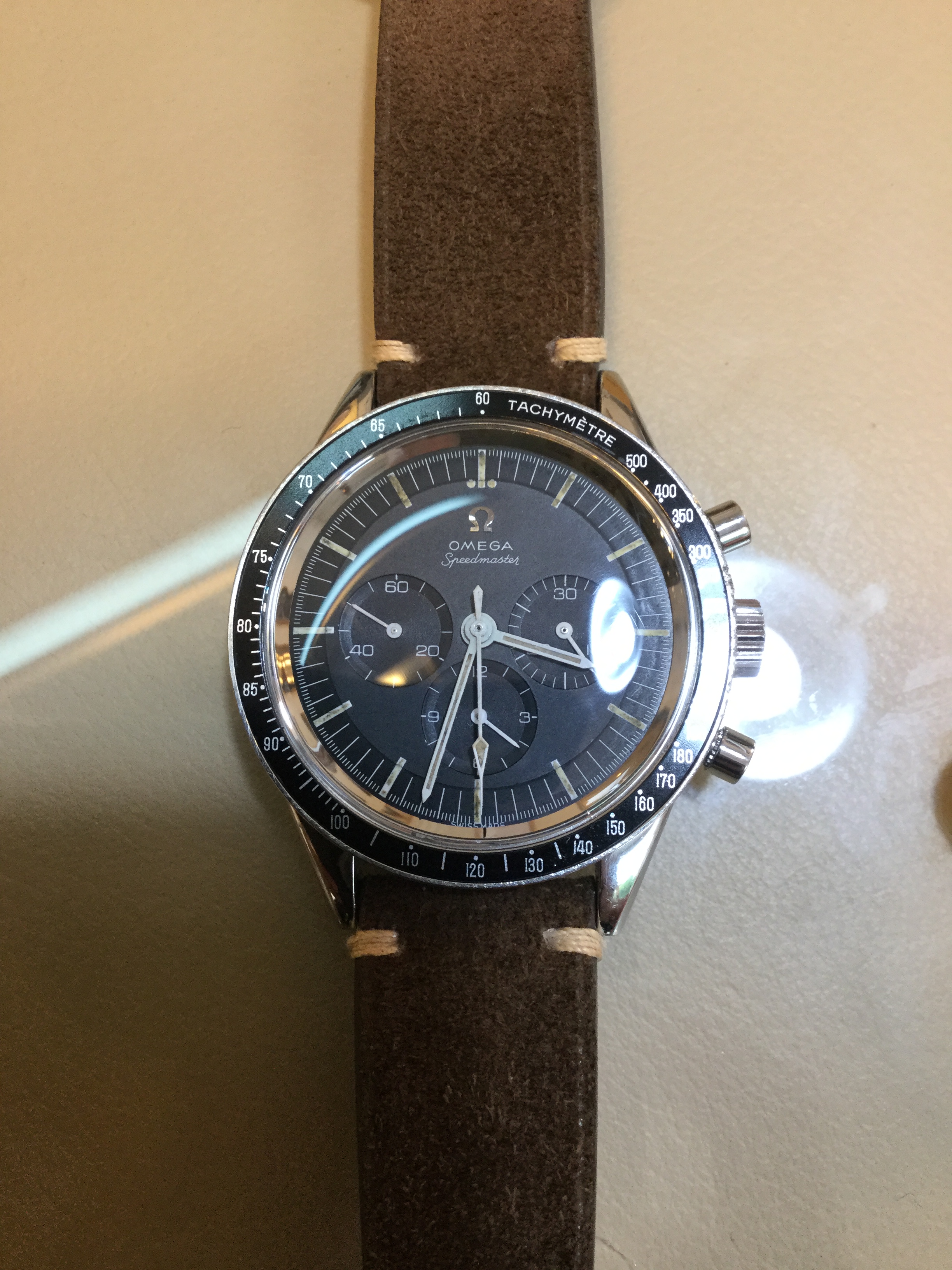

Can you guys tell me what stands out on this bezel to make it a reproduction.
The matte rather than glossy anodized finish for the aluminum insert, and the overly thick steel rim. You can also easily identify reproductions from vintage variations by the side profile. I don't think any repro has gotten it right yet, though a few are pretty close.
2,086
2,899
I could tell you, but I won't, because this would inspire the fakers... 馃槣
Just kidding...
It's the shape of the bezel ring in relation to the insert as said before. But first of all it's the wrong font and size of every single digit and letter. Since I don't have @gdupree 's talent, I can't make a GIF for you, but if you compare the pictures of his above post to the one your question is about, you'll see the differences.

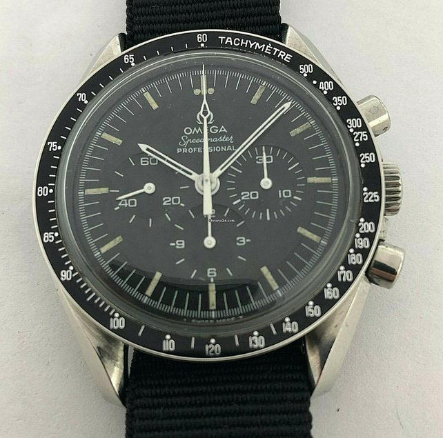

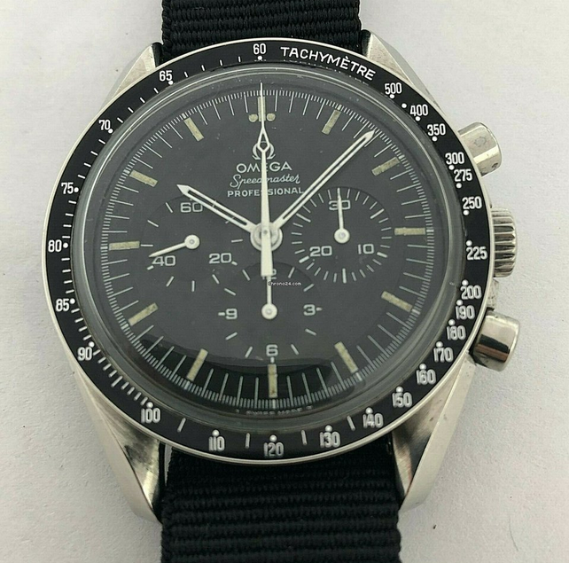

Today I saw this 105.012 with a DNN bezel that - to my untrained eye - has the 140 dot in the wrong place as well.
Has anybody seen this before?
1,134
1,690
I think that might be OK. It's the serifed and accented modern DNN, right?
I have one of those. I checked and it looks like those bezels have dot near "1" of 140 quite closer than the latest DNNs.
Compare to:
So I guess maybe the fakers started out with the serifed accented DNN?
Hello, I believe the bezel looks fine, I have a DNN and looks alike except for the dot on the 70.

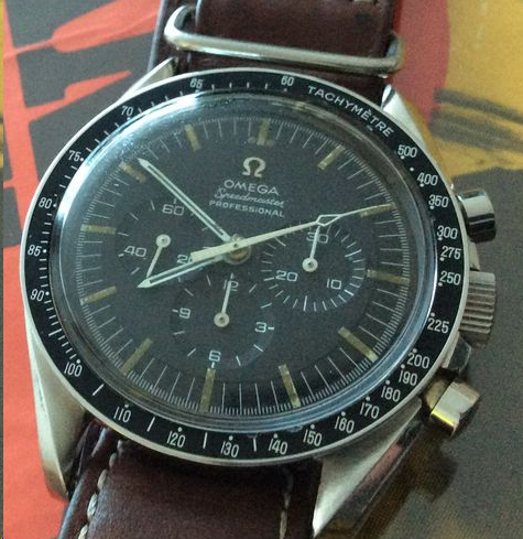

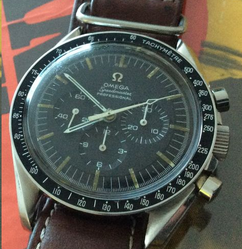

2,597
5,666
^ fake
There seem to be quite a few tells but you really have to know what to look for. It certainly helps to have MWO as a reference. Plus of course condition is impossibly good compared to the rest which should raise suspicions. Seller lists the bezel as being original but maybe they鈥檇 argue that they didn鈥檛 say the insert was.

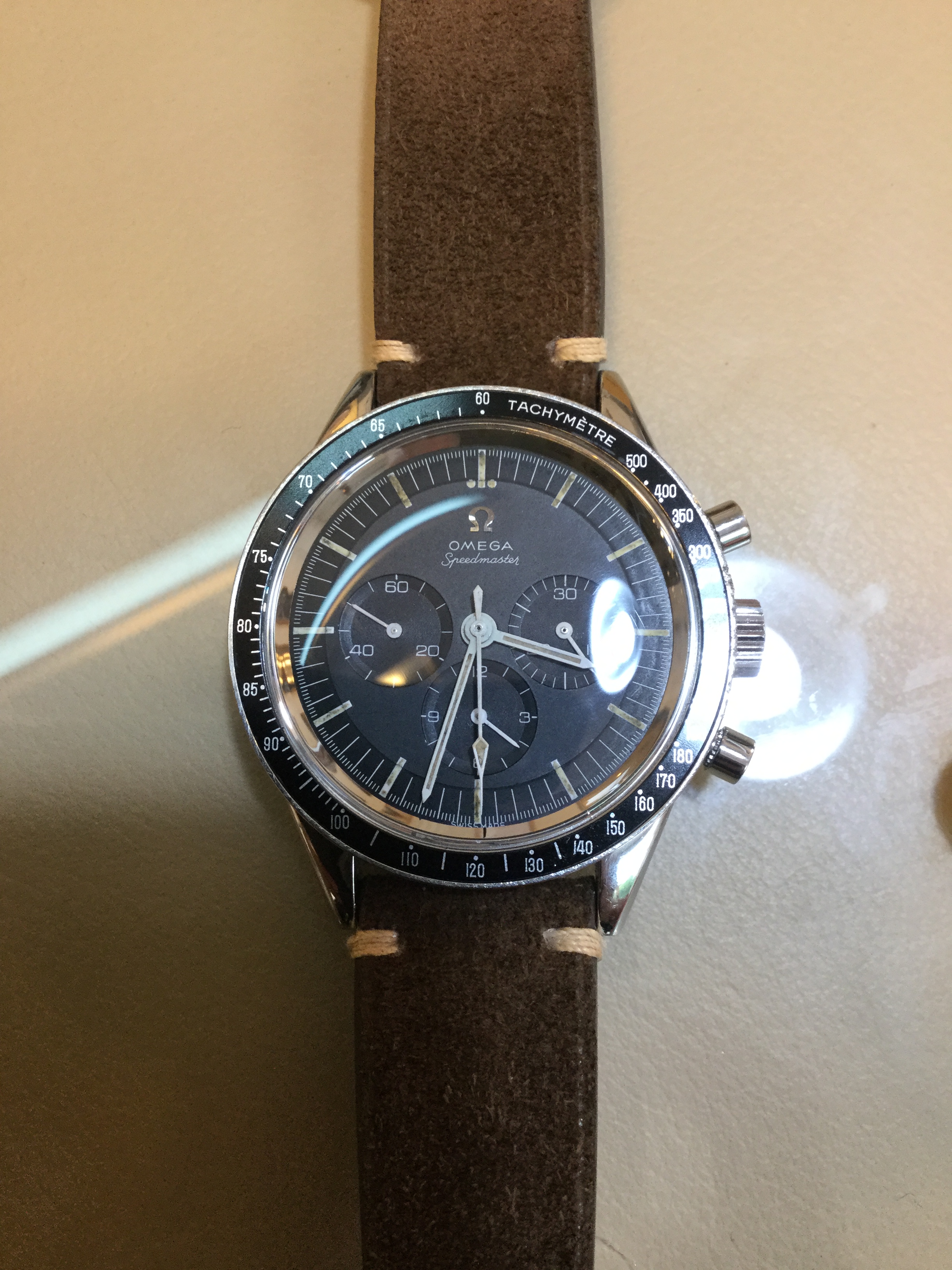

Listed today. How many seconds do you need in order to tell if the DON is real or fake?
None 馃槣
Actually though, I'm 99% sure this bezel was one of the eBay repros identified before. The seller of that bezel stated that the inner diameter of the bezel is slightly larger than an original, among other tells. The gap between the crystal and the bezel insert is clearly greater than what would be the case for a genuine bezel. "Superwatches LLC" seems to just be one of those unscrupulous sellers trying to pass off aftermarket as genuine.
