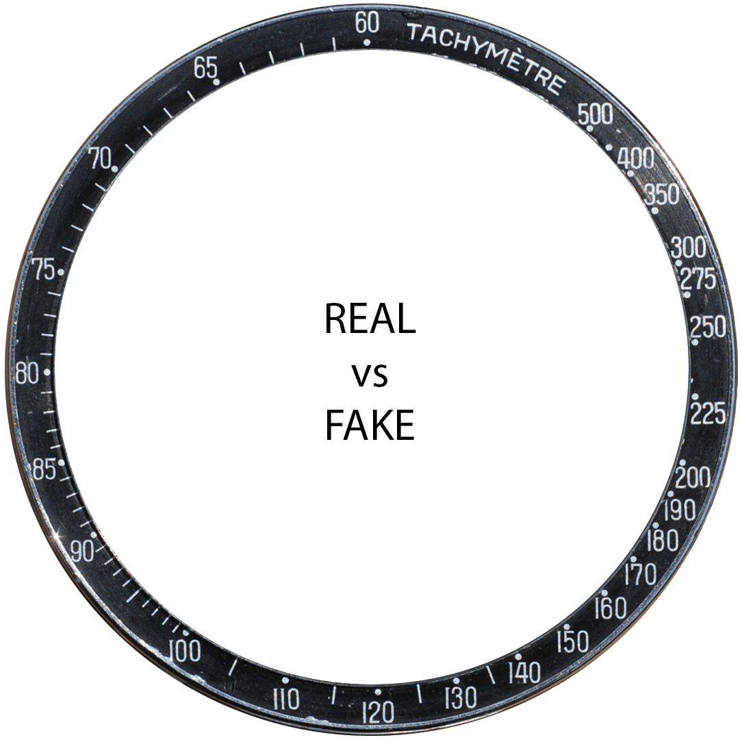

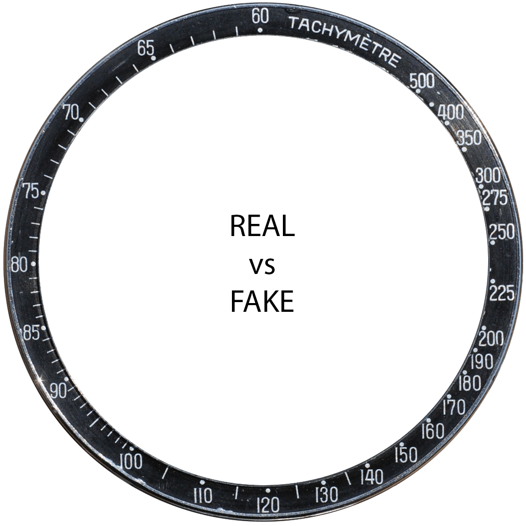

So...
These repros have already started to trickle down through the auction houses. ::facepalm1::
Not surprisingly, Antiqourum...
Good catch, that misplaced dot near 140 is a dead giveaway once you've noticed it. I'm sure this seller "didn't know" either, same as the last one.

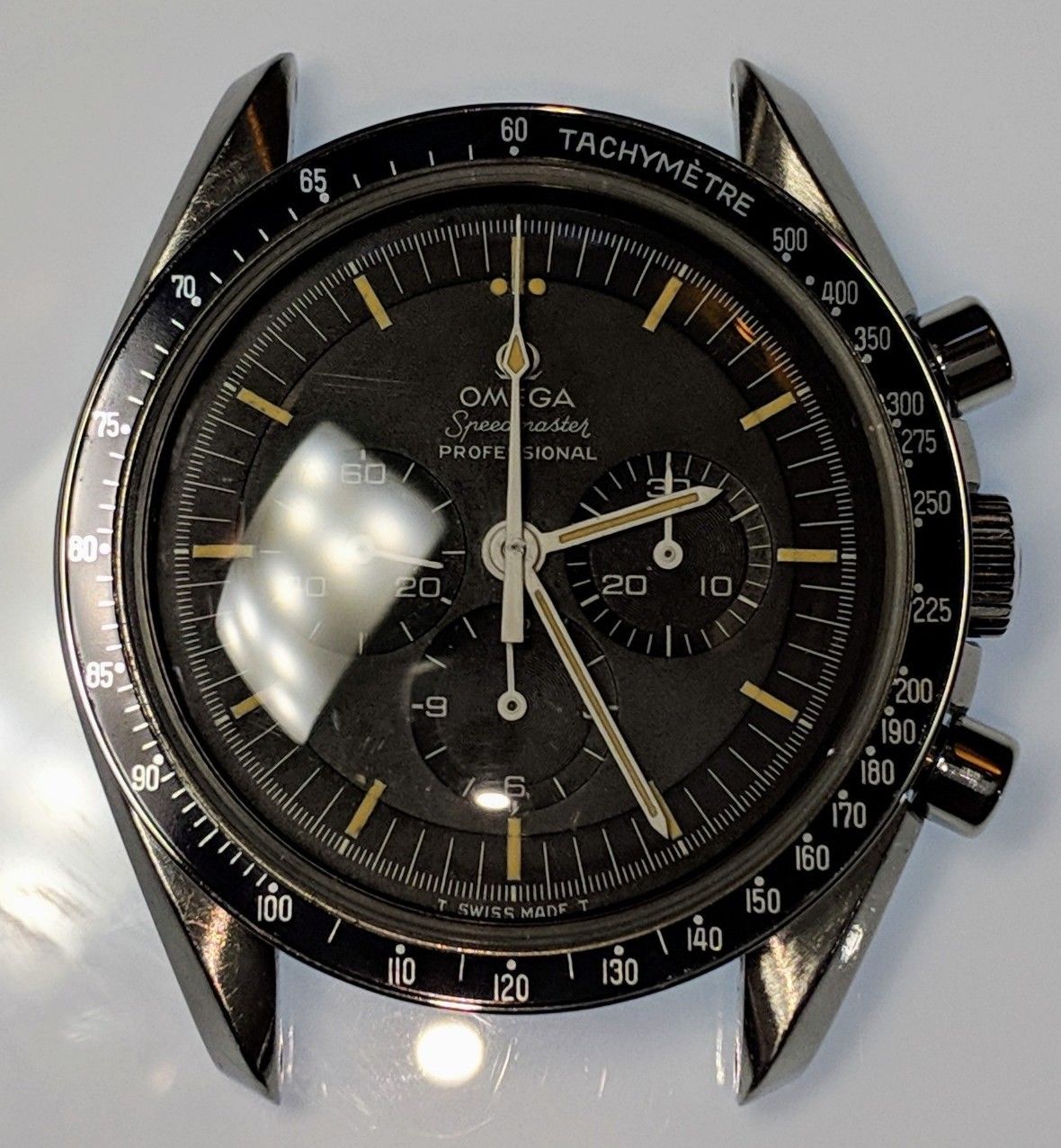

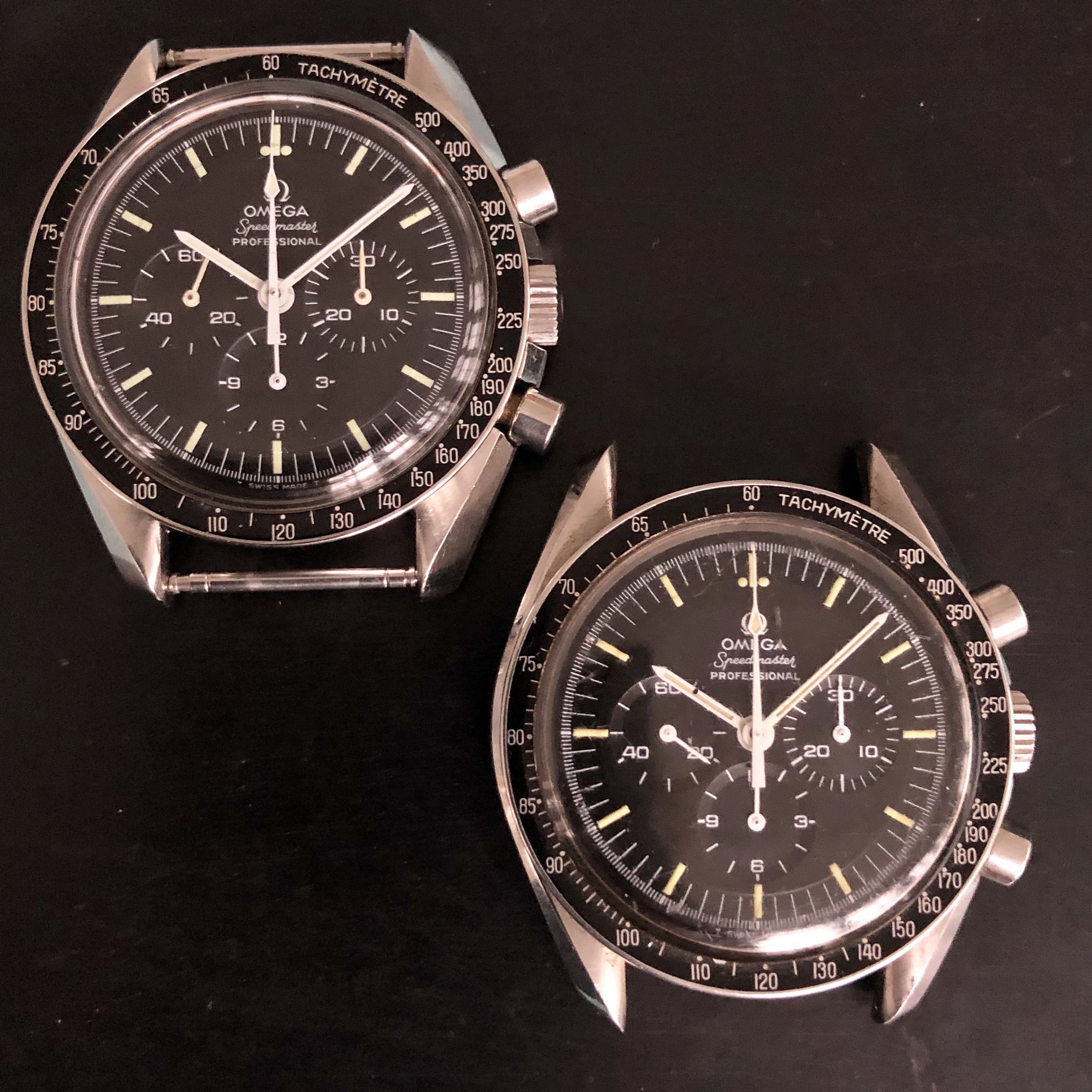

Well since I bought that AQ watch it’s going back. I wonder if it will be a fight?

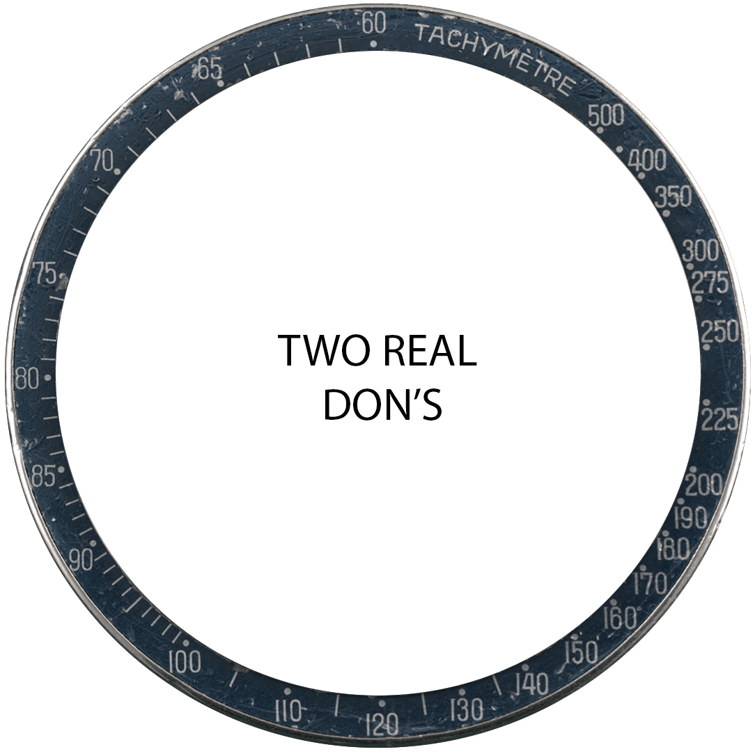

Here it is compared to a one owner example.
I am embarrassed to say I did not spot it until it was pointed out to me after I was showing off on IG. That will teach me.
In my defense at the time of sale I had not yet seen one of these.
Trouble is what will we do if they correct the tell?
Sorry to hear this. It is scary to see that even biggest collectors can be fooled by a new iteration of a forgery.
I guess that now, being aware of the fake's level of detail, I guess we're all going to apply much more scrutiny to each watch we'll be looking at

Maybe if you guys started a private facebook group or something that wasn't posted all over the internet for the counterfeiters to improve upon, then the fake DON's would be much easier to spot. If you guys continue to post macro photo fonts and show the discrepancies to the fakers then you will never be the cat and will always be the mouse..
NOTE: the dot placement above the 140 has already been corrected on subsequent revisions. This is an older counterfeit DON, the new ones have the dot above 140 closer to the 1 as the genuine does.

DJ: Dont you think the original fakers did just that? They took a perfect DON and essentially scanned it. The problem is that even perfect DON's have variations, perhaps a nick here or there or an out of round dot, for example. In this case, the artist replaced the dot over 140 in a general location because it probably didnt pull up clearly from the scan and was re-done. Luckily it was re-done slightly off point so we all caught it. The new ones have the dot moved to the proper location so that is no longer the tell.
I still know a tell in the current version that lets me know it isnt genuine, but I'll be G-D Damned if you think I'm gonna post it on the Omega Forums.. Just be careful out there, when they look this perfect that's a tell right there..

The 140 isn't the only tell, all of the dots are slightly out of place from 200 to 130. It's just most noticeable on the 140.
Are you referering to this one as the current version? Lots of mistakes but I don't think anyone would miss the dot over ninety being in the wrong place, it's the first thing we look at.
388
565
I don't have a timeline of which revision of fake is version 1,2 3 etc, but I think this was one of the earliest versions because the dot over 90 was the biggest issue which got corrected. Then the dot over 140 got corrected. This is not the current version/revision.
Funny thing, even when they correct one problem, they often introduce a different one.

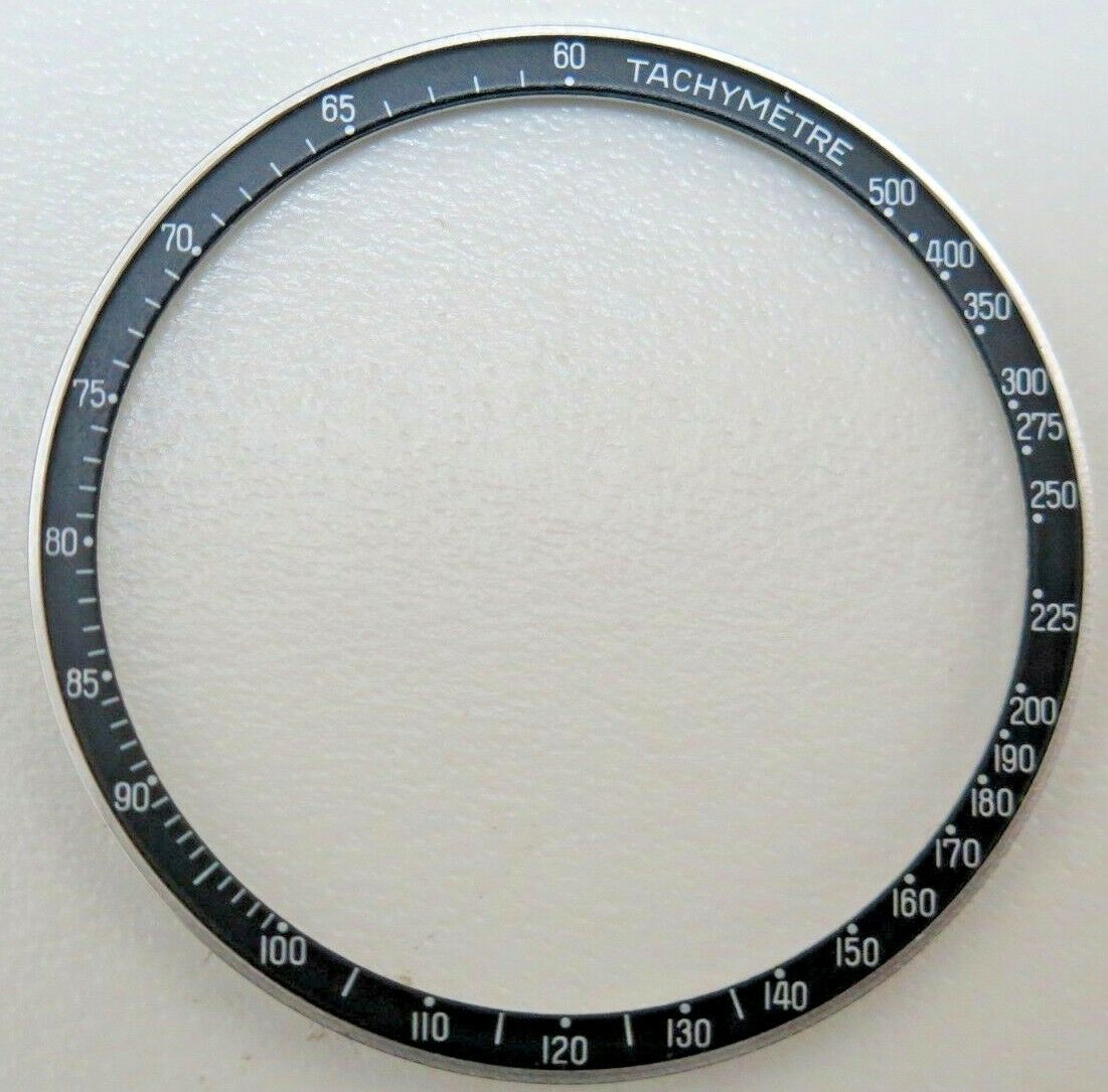

Can you show a picture of the one you are talking about? I don't think it's been mentionned yet. I remember this one from ebay but it's the worst of the lot:

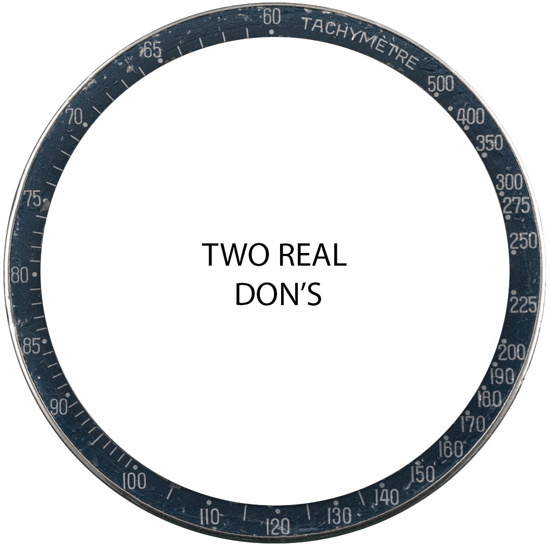

Damn, yall... It's tough to know how much info to share, but IMO sharing knowledge is all we have left. If the mod's don't think it should be here, they can make that decision.
The closer you look, the more tells there are. Check these gifs... The placement of "275" strongly jumps out, as well as the overall placement of many elements as others have mentioned. I still don't know if I could point most of these differences out without a direct comp like this, so it would still be very tough to recognize this in the field. But, our due-diligence efforts will simply have to be increased. Obviously this is only comparing a small sample (one fake to two real), and we may not know exactly how consistent the fakes are.
If I recall correctly, the listing description for that bezel distinctly identified it as a reproduction, and it said something along the lines of having some tells baked into the bezel so the replacement could be told apart from the real deal quite easily. Scrutinizing that bezel isn't going to benefit anyone when it's already identifiable as a repro. On the other hand, the makers of the other bezels who are trying to make fakes and sell them as actual DON bezels that are the real issue, IMO.

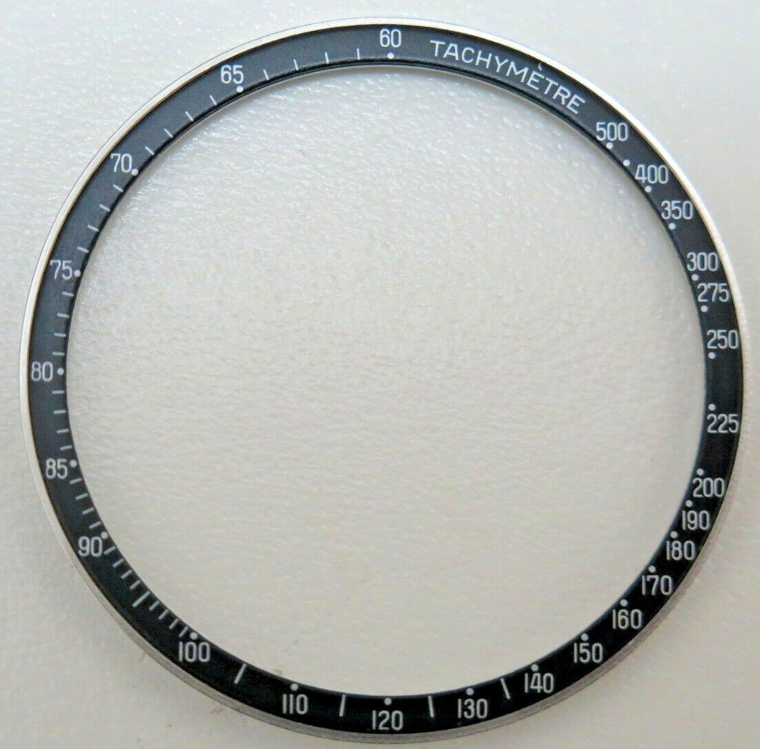

85

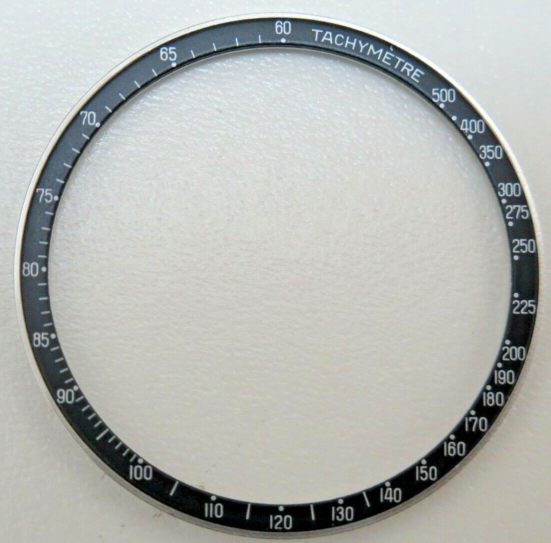

Can you guys tell me what stands out on this bezel to make it a reproduction.
