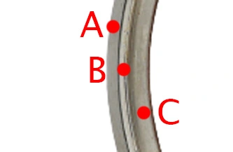

With a staking tool you can punch (I usually do that in 8 positions) the backside of the bezel (the inner edge) => it will allow the bezel to be pressed on the case tightly
How risky would that be? Deformation, cracking of the insert? Have you ever run into trouble?
I have done it several times, never had any issues. I am a watchmaker so I guess I am used to take some precaution => flat surface , protective non-adhesive film on the insert
May I ask where you punch? A B C?
618
928
On your pic, I assume the C is the back of the insert.
So at the inner edge of the B
Okay, I’m puzzled: if the bezel is loose, you punch on the inside of “B”? Is the idea to decrease the diameter for a snugger fit, or get it tighter via other means?
