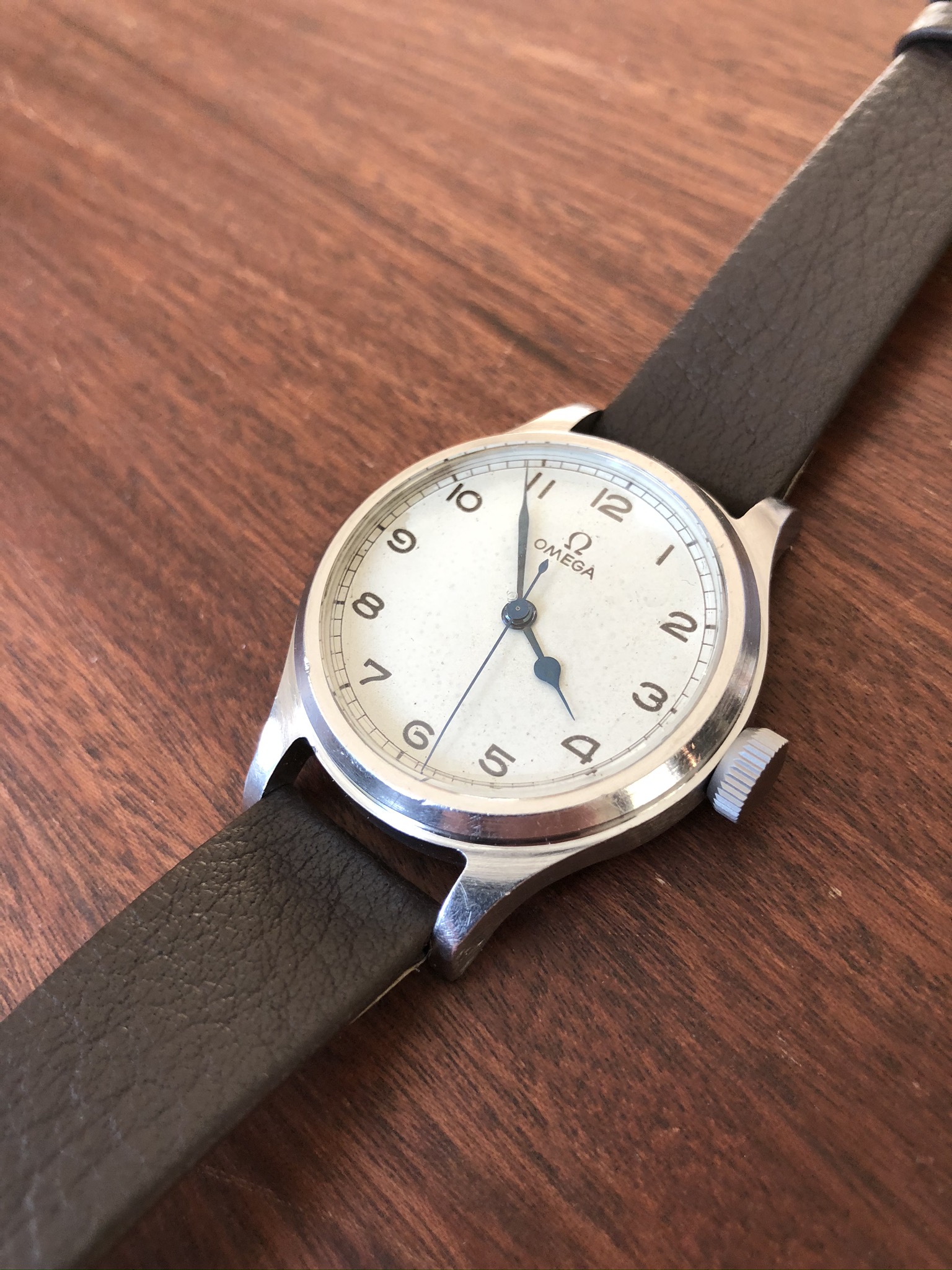

I had my CK2292 6B/159 watch serviced by Omega and they replaced the original glass with one with a omega logo etched in. I think it ruins the classic look of the watch but omega said there is no other option. Does anyone know where I might be able to find one without the logo?
(They also replaced the bezel with an unsightly after market one as seen in the picture but they have changed that back).

The crystal for this watch doesn't use a tension ring, so any generic crystal of the same size can be used:
062PN0302 | GLASS PLEXI D30.20 H3.15
Did you by any chance mean "crown" when you said "bezel"? Omega would not use a generic crown, as there is an Omega crown available for this case - 069ST35002.
Cheers, Al

The bezel looks scratched, so I'm assuming the crown was replaced.
