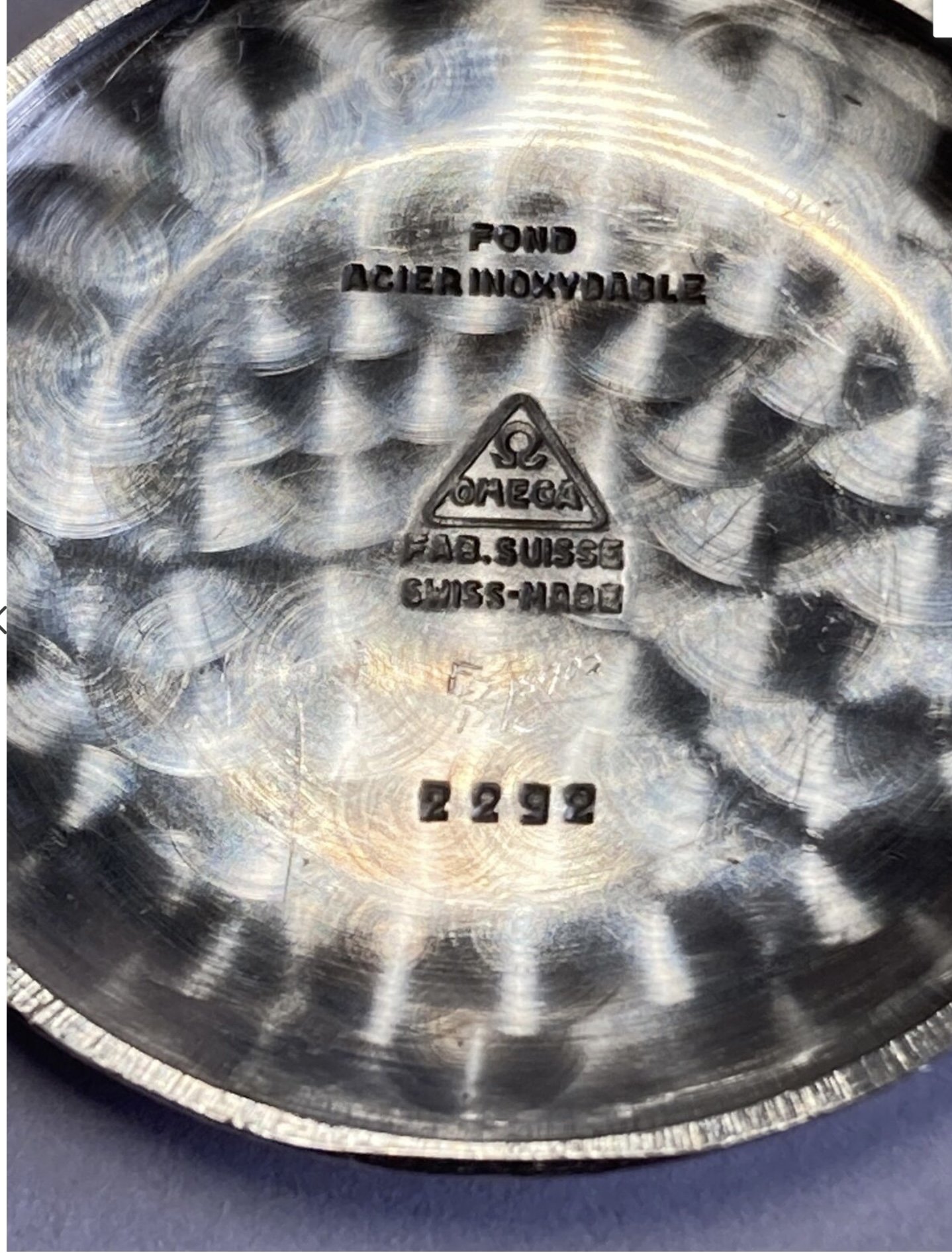

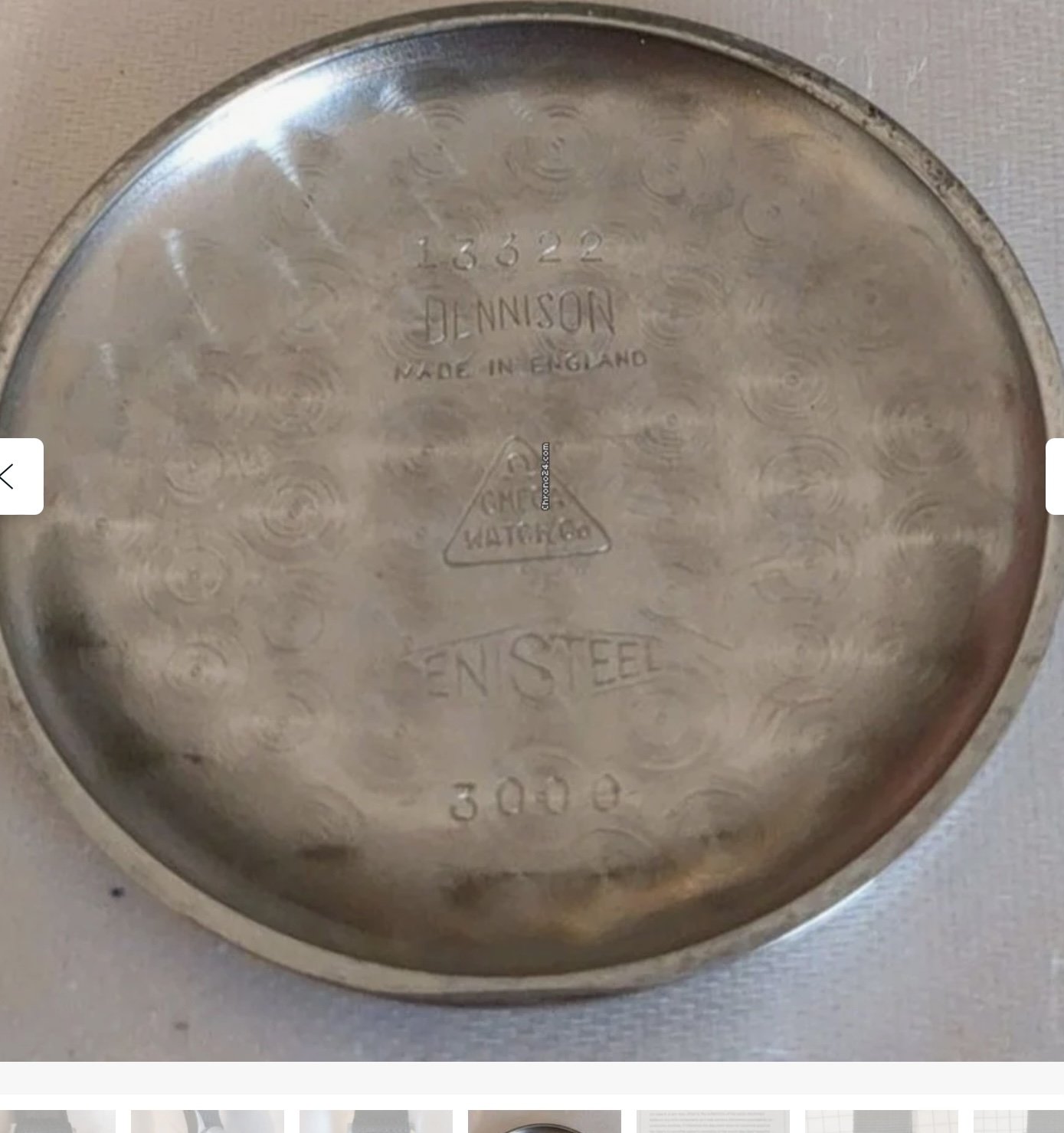

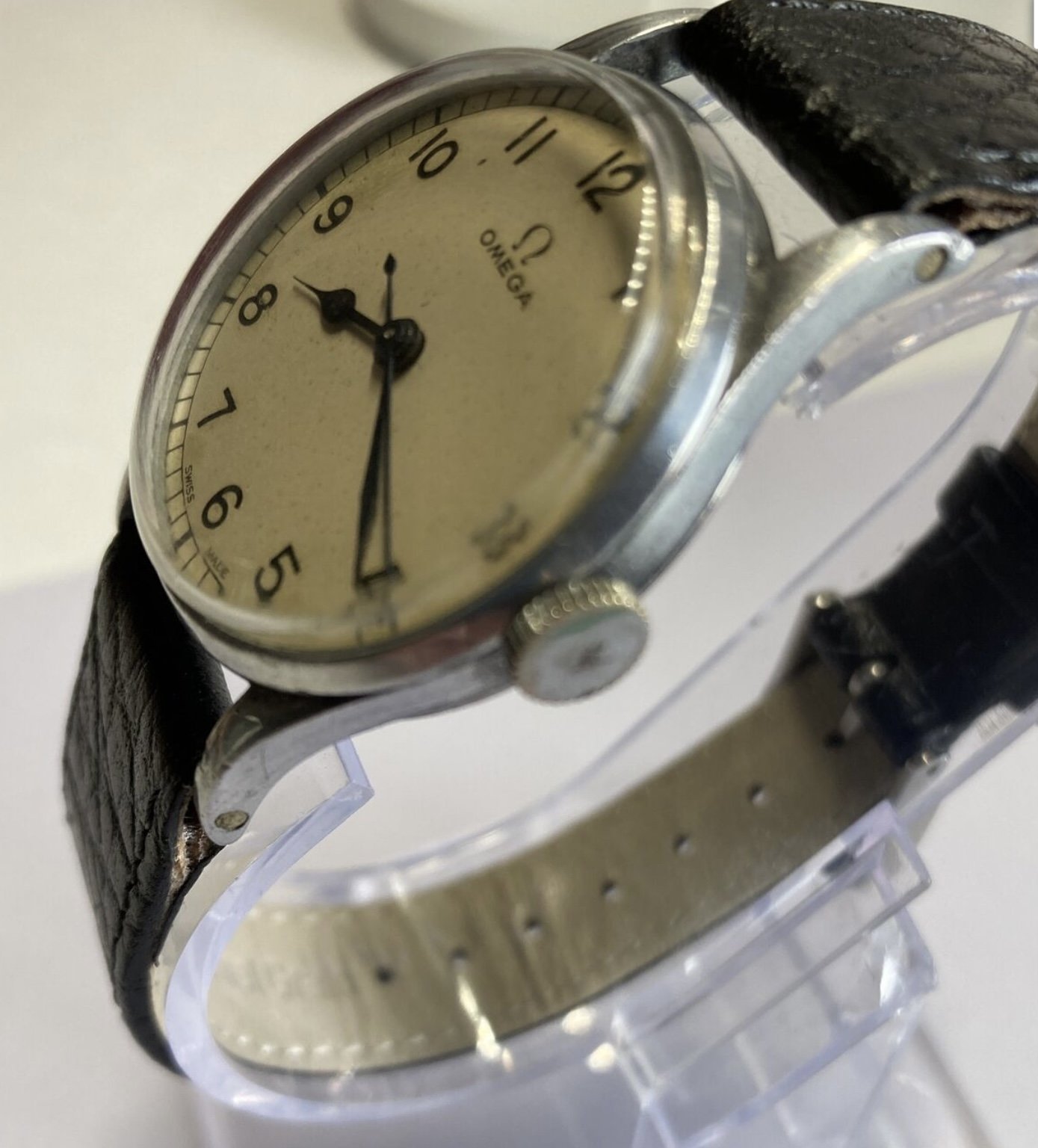

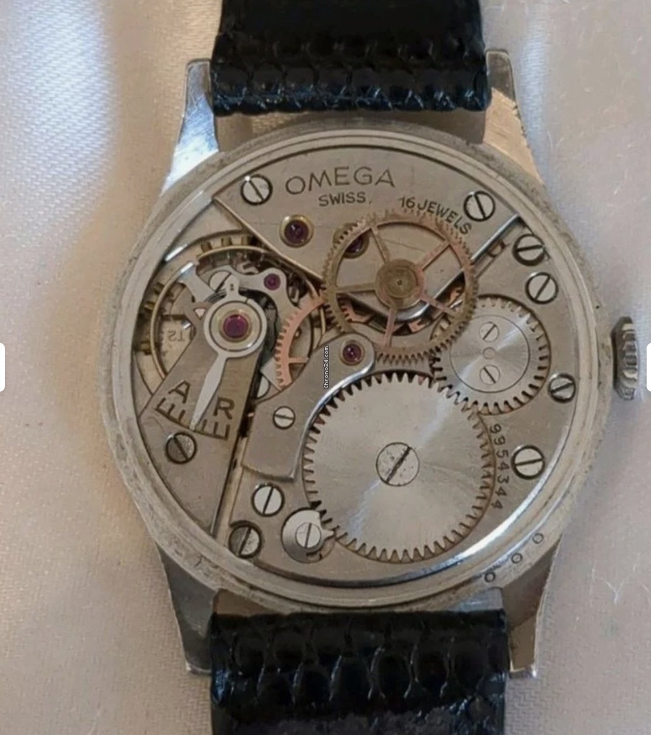

There are two exemplars that caught my attention, neither have the military marks on caseback (well, the marks are cool but I can live without them). One has the “old” alloy Omega case, long lugs, fixed springbars, a decent cream dial. The other (it’s on the European Union, more convenient for me because I’m from Spain) has a Dennison steel case, but one of 33mm no screwdown back, shorter lugs and, I think, removable springbars.

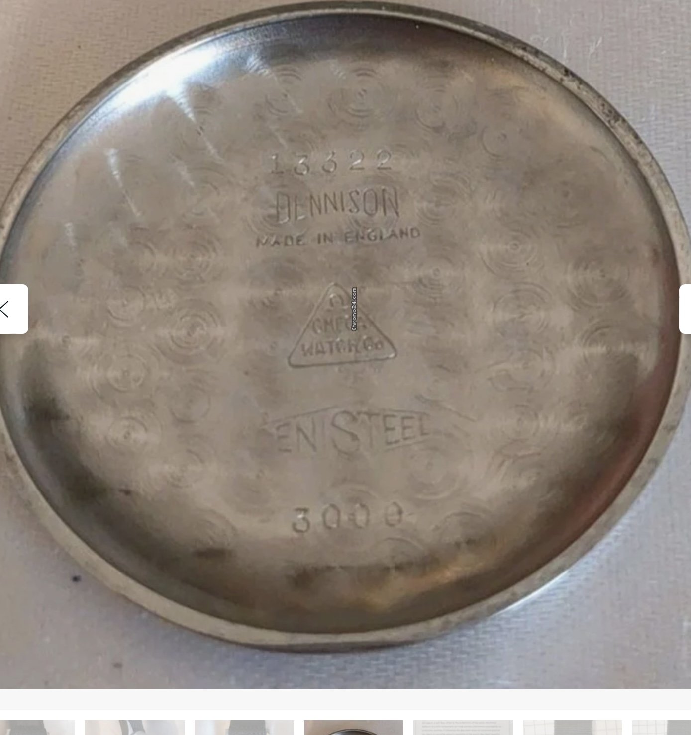

As far as I know, in the 50’s, many watches were recased with bigger (36) Dennison cases with screwdown back, but my question is: a Dennison 33 case, no screwdown back and with both Dennison (“made in England”) and Omega written in the inner caseback is a wartime 40’s recase or a postwar one? I assume that it must be prior of larger 1956 recases. The dial is the old creamy one, pretty decent.

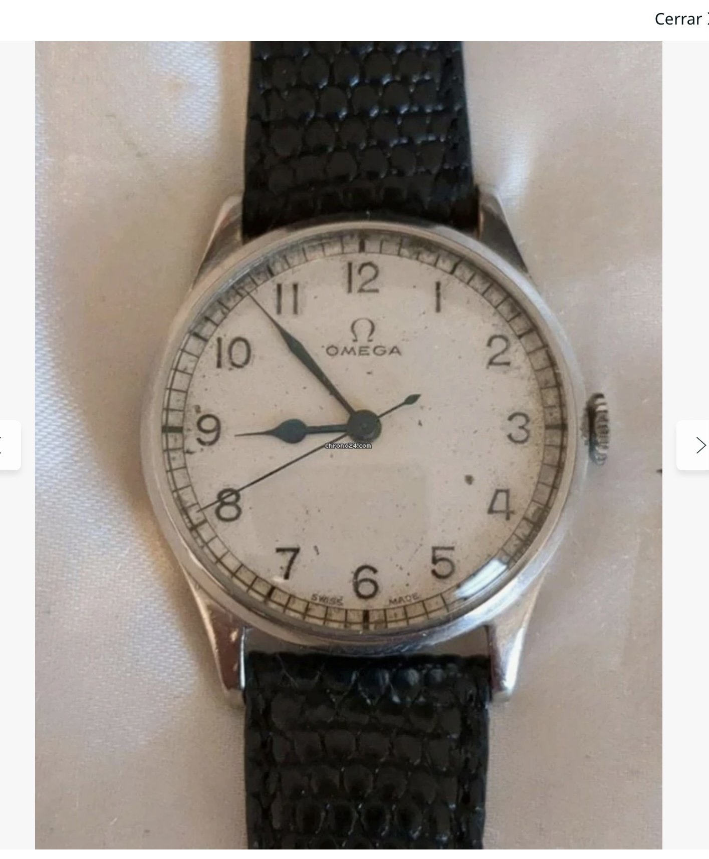

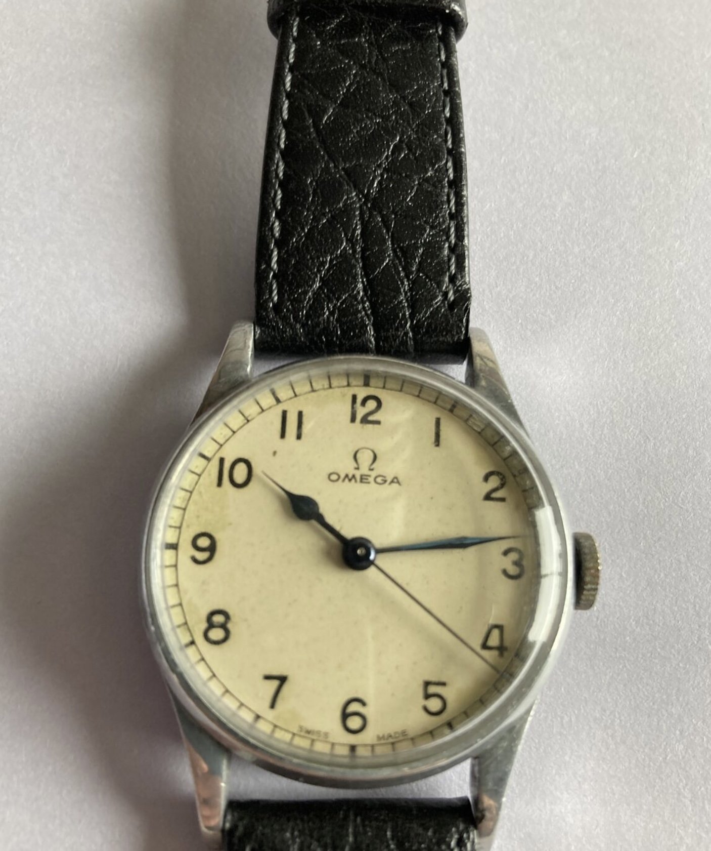

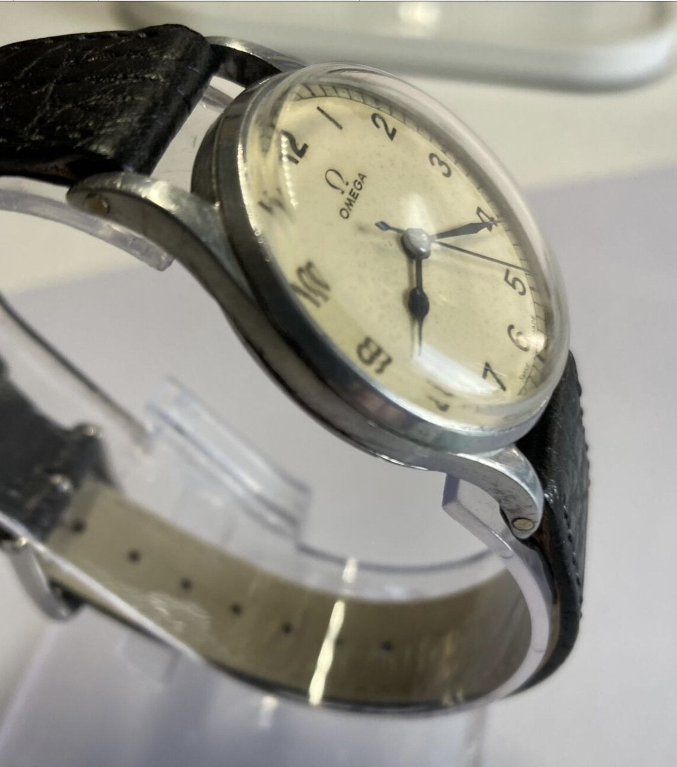

The one with Omega alloy case:

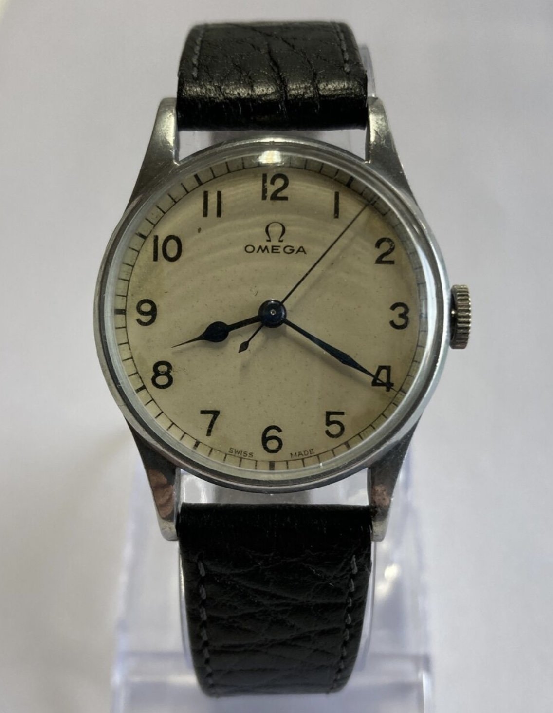

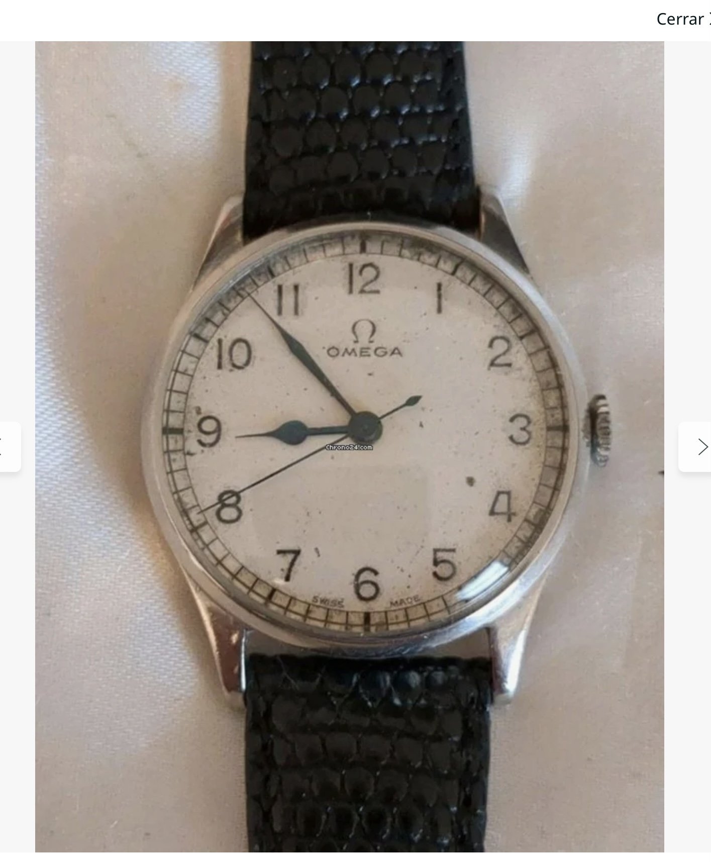

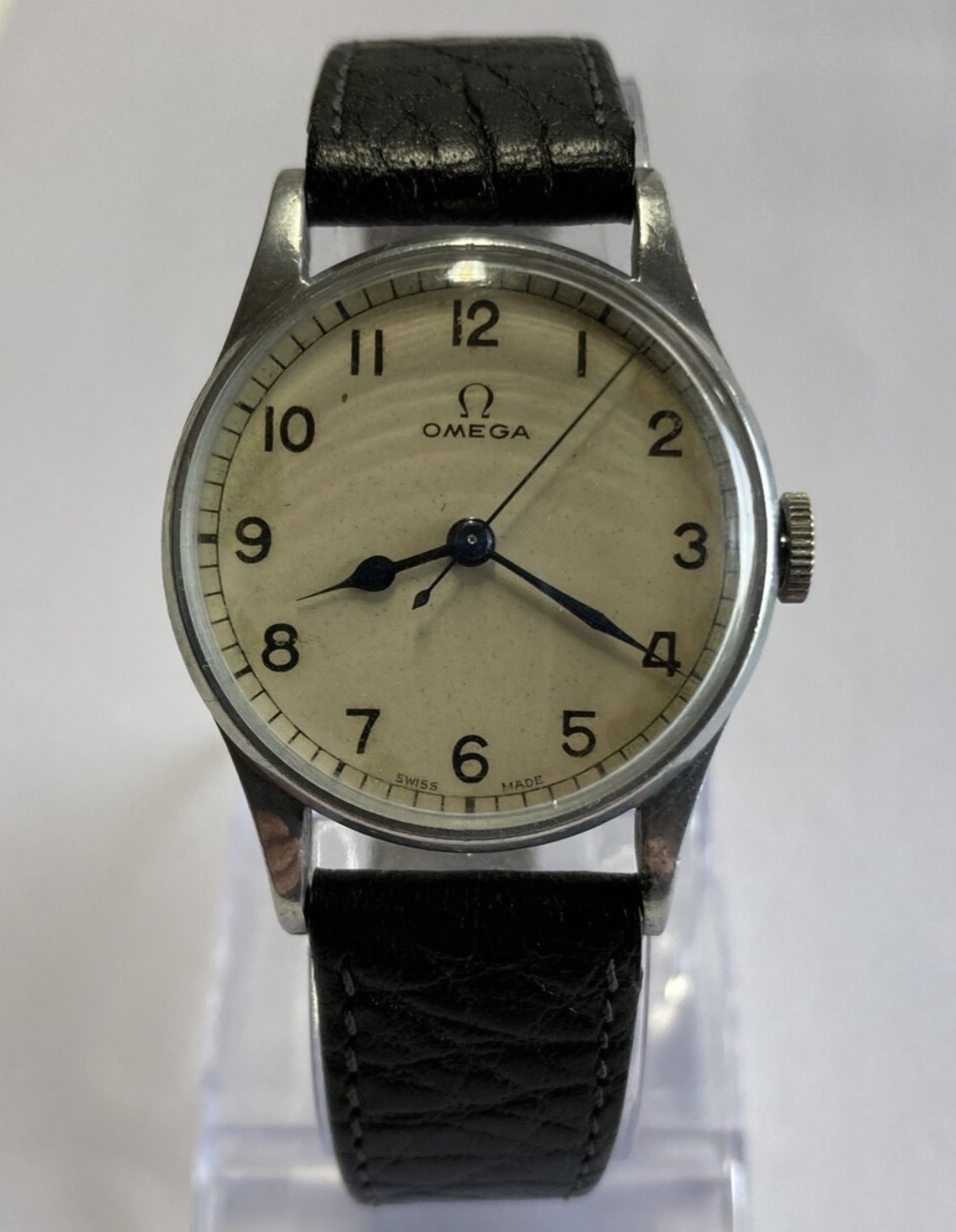

The one with Dennison (has omega archives paper

That's your call. Alloy case: collectible. Good Dial. Allow middle case rim, that holds the back, destroyed around 9 o'clock due to Idiots open the back...
Dennison: Dial not very good. Not really collectable as a military watch.

Dennison 13322 case is a post war surplus disposal case. It's a superior case to the alloy 2292 case, imo.

Thanks for the detail. So, we can be sure that the Dennison is a postwar modification (but I suppose that it’s prior to 1956 bigger Dennison cases)

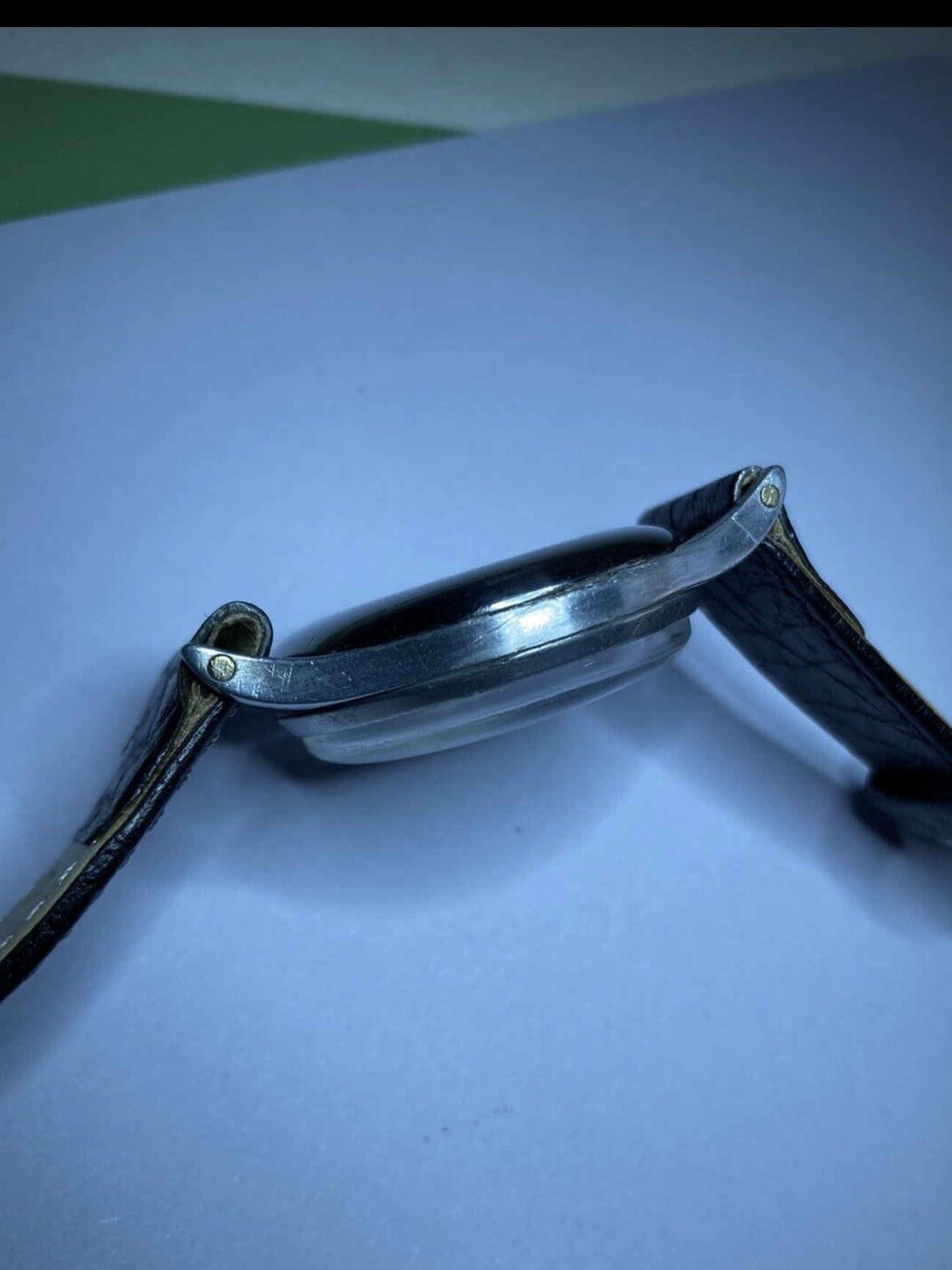

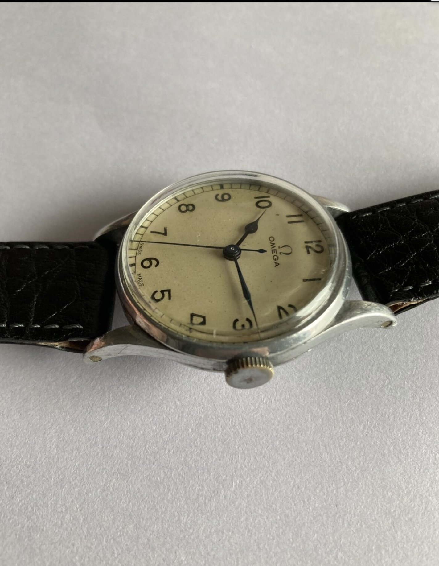

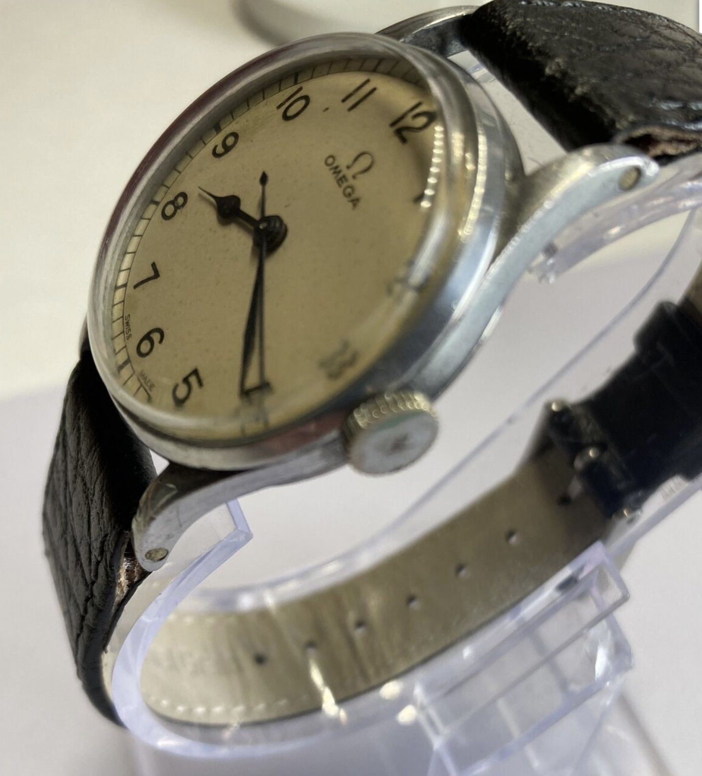

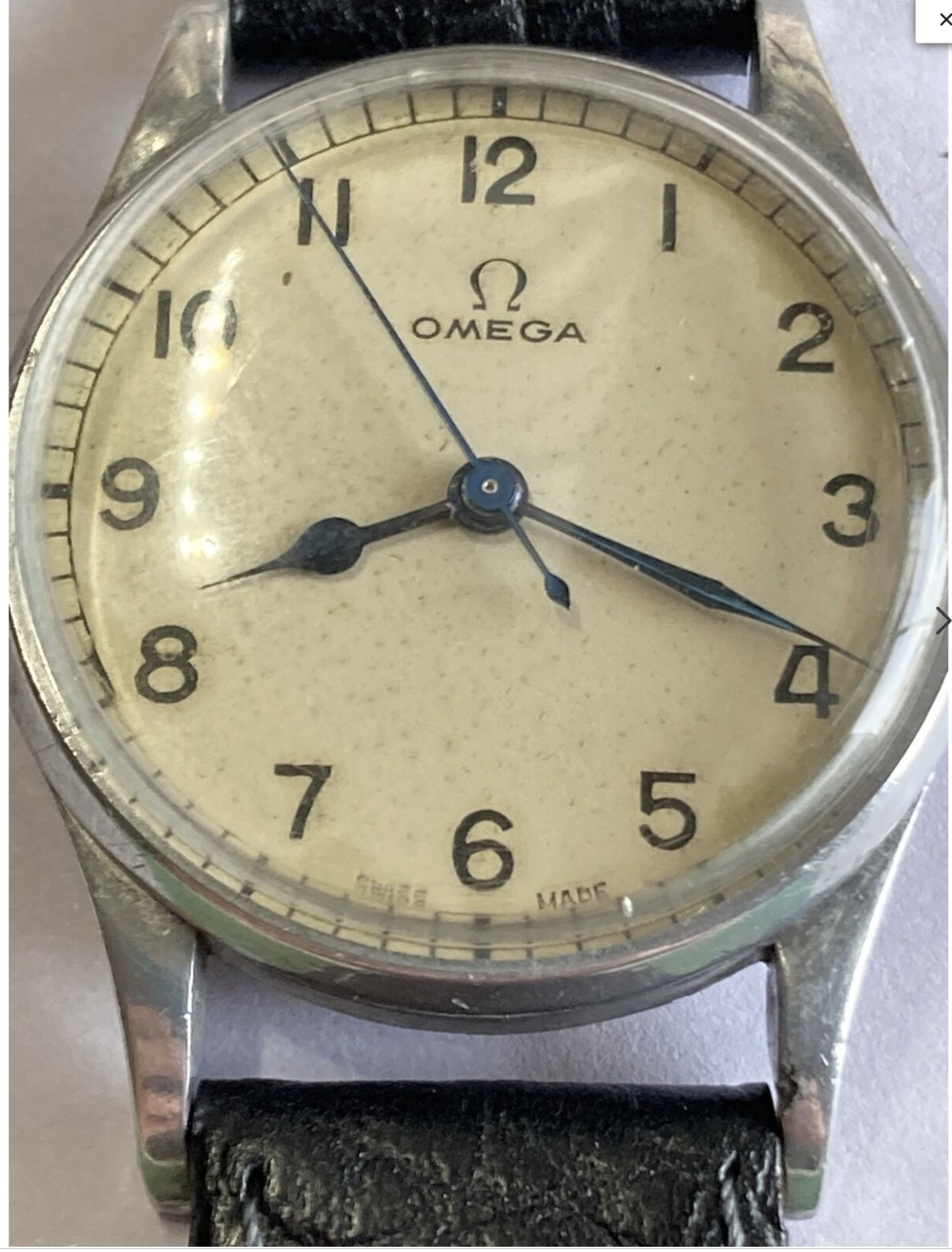

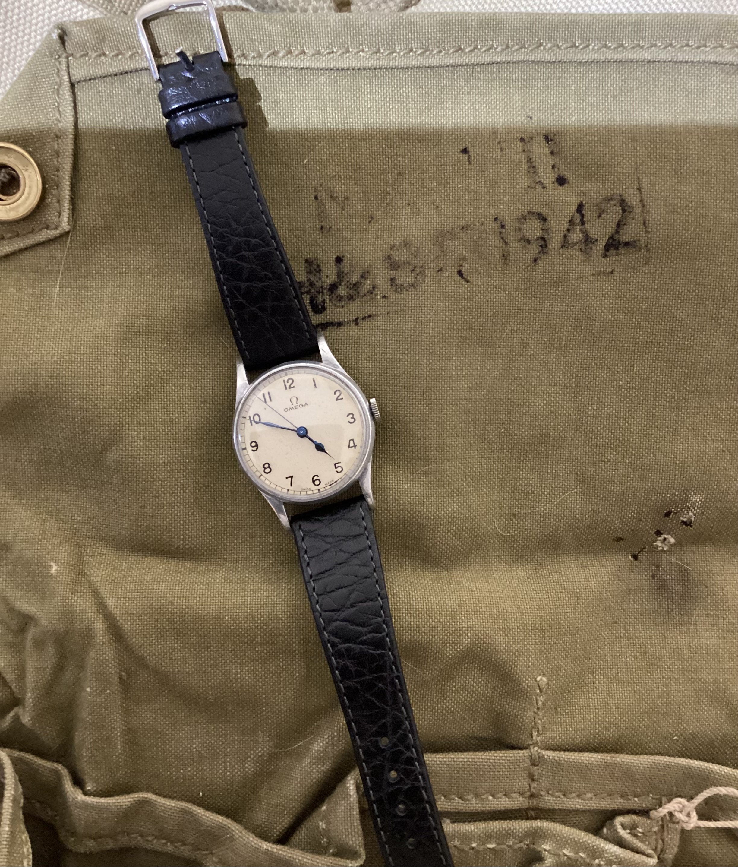

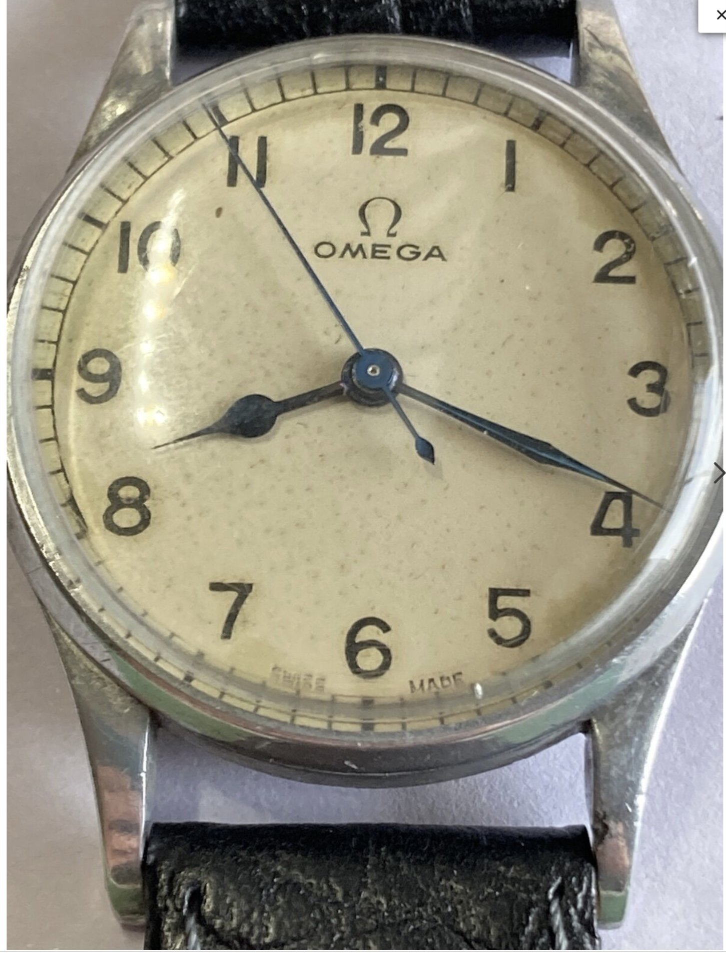

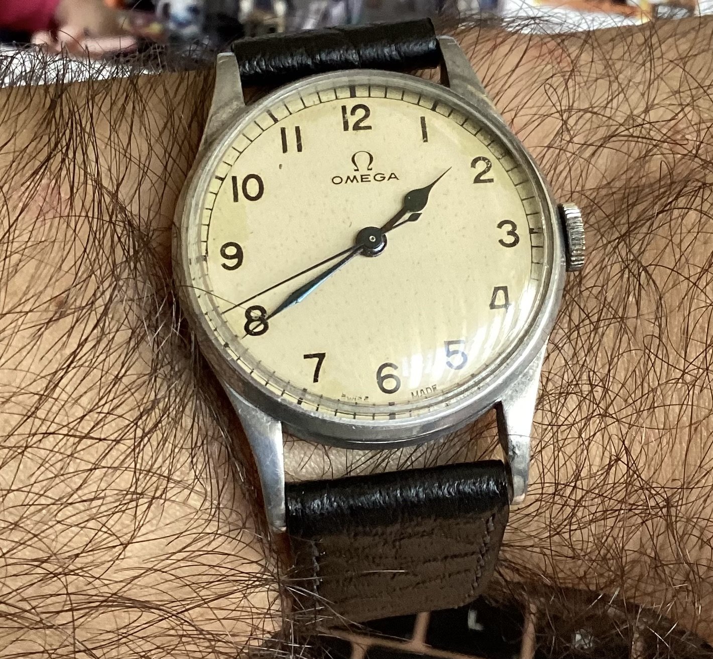

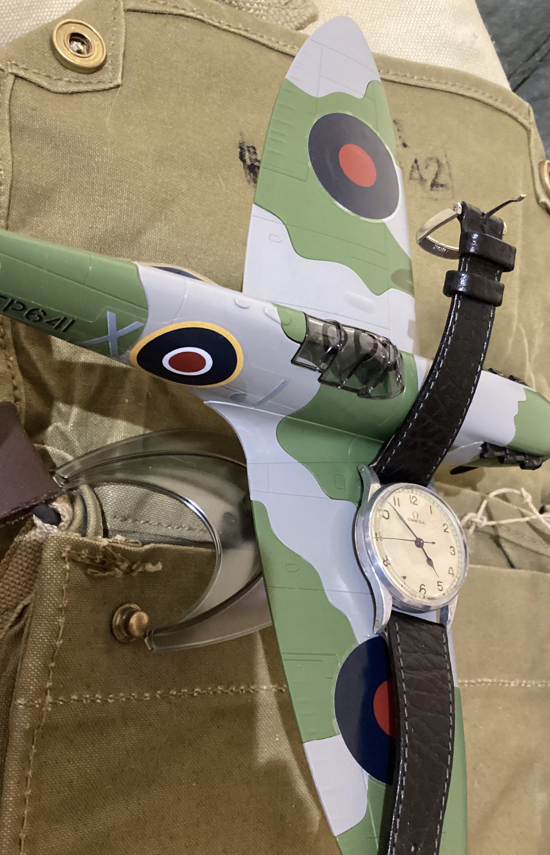

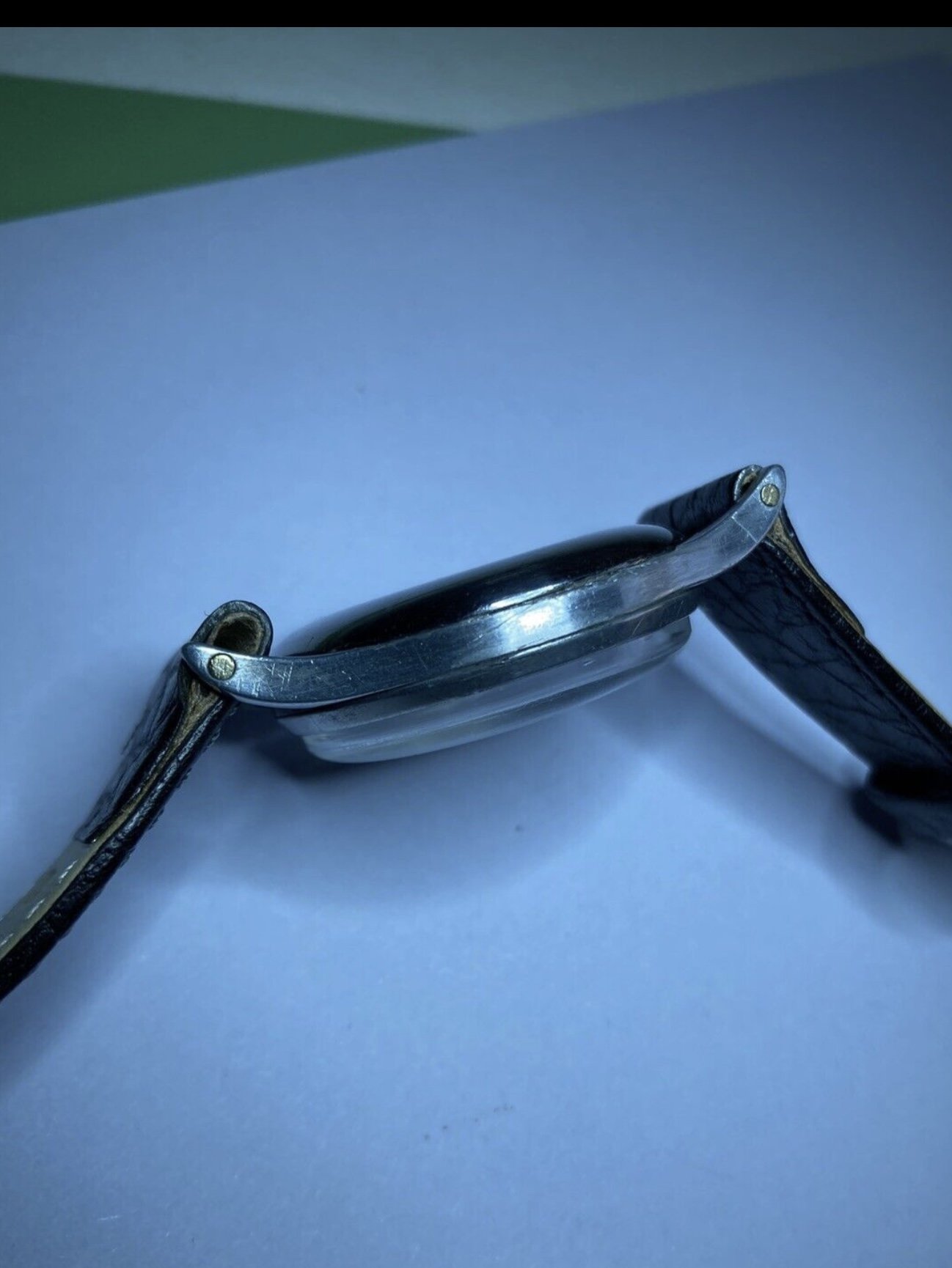

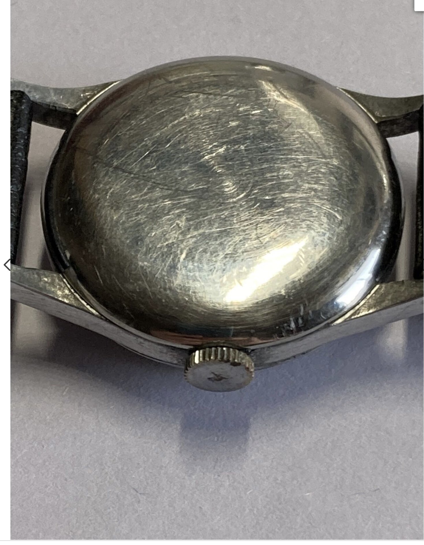

Hi to all. Finally, I have purchased the alloy exemplar, as you adviced it’s more authentic and has a better dial (but in detail has spots). The watch is on his way, I post some pics in order to know your opinion. Seems Ok? Do you think that the crown is original? (I thought original crowns we were of steel). The damaged part of the case can be seen clearly on back, otherwise the case seems good.
7,689
22,049
Congrats, it’s a nice looking watch- you’ll have to be careful wearing it as those long lugs are notoriously fragile and breakable.
This crown is not original, a collector named Antoine has had modern steel replicas made of the original.
He goes by the name of Antoine on the Military Watch Ressource forum and sells on Ebay under the name Latriaz.

Yes, for that reason I considered too a steel Dennison-cased one, but I love the authenticity of the alloy one, the long lugs and the heritage. I intend to wear it a lot buy carefully.
Many many thanks for the crown advice!

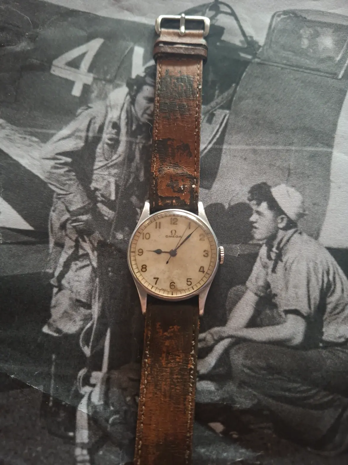

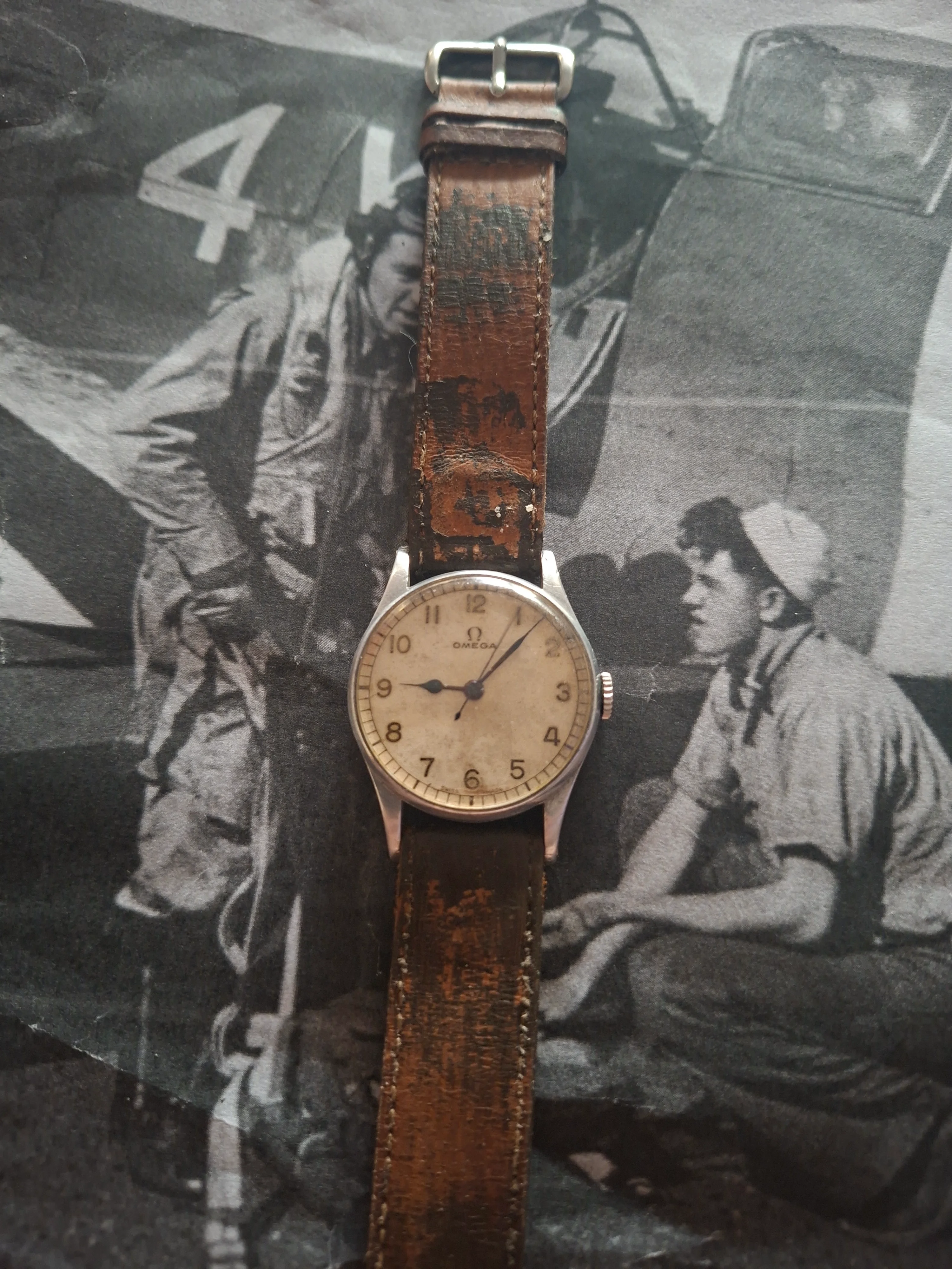

Hello there,

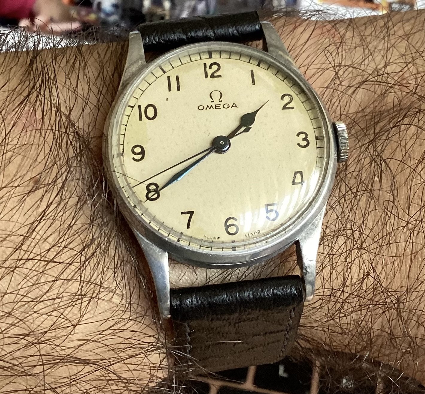

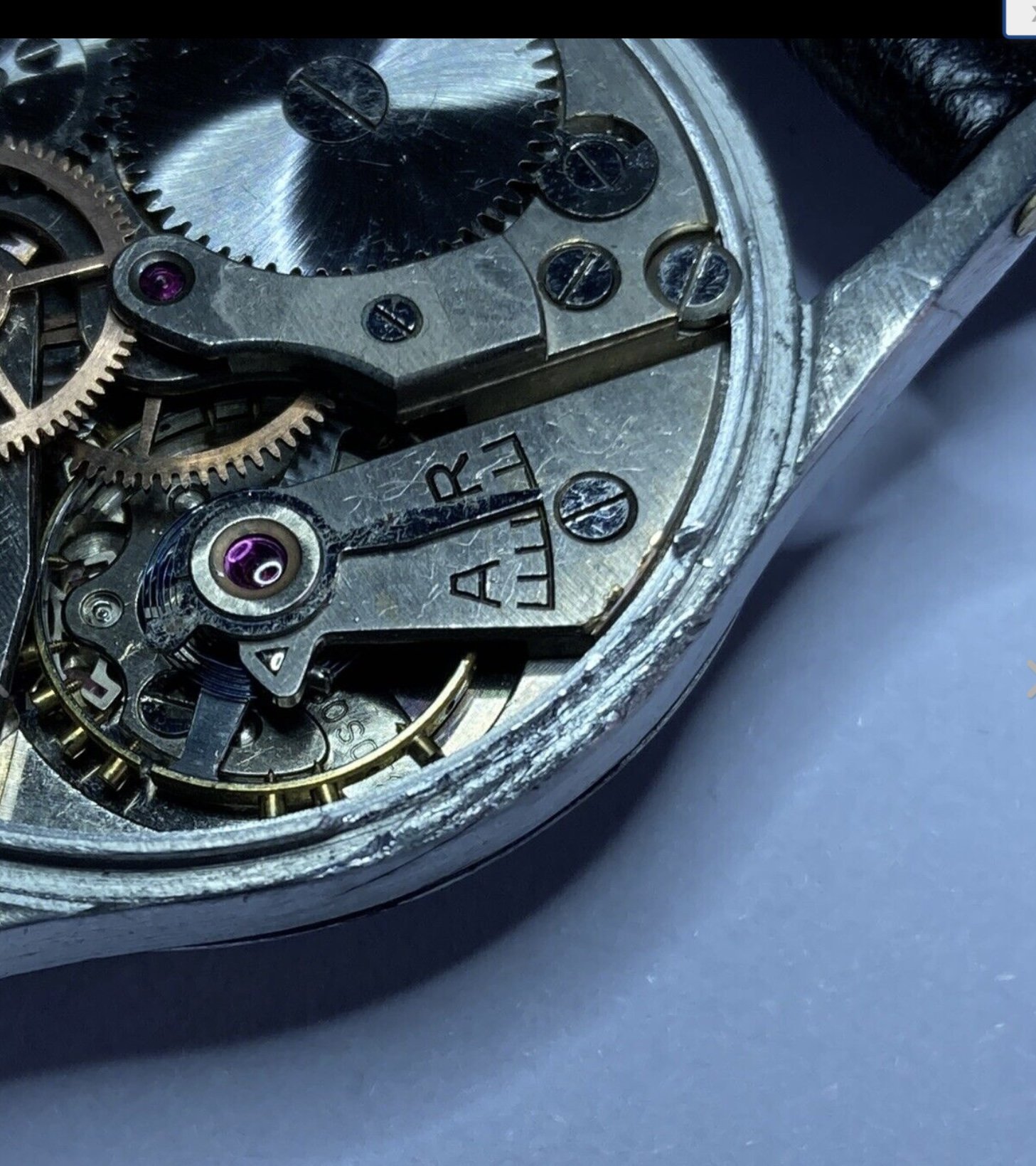

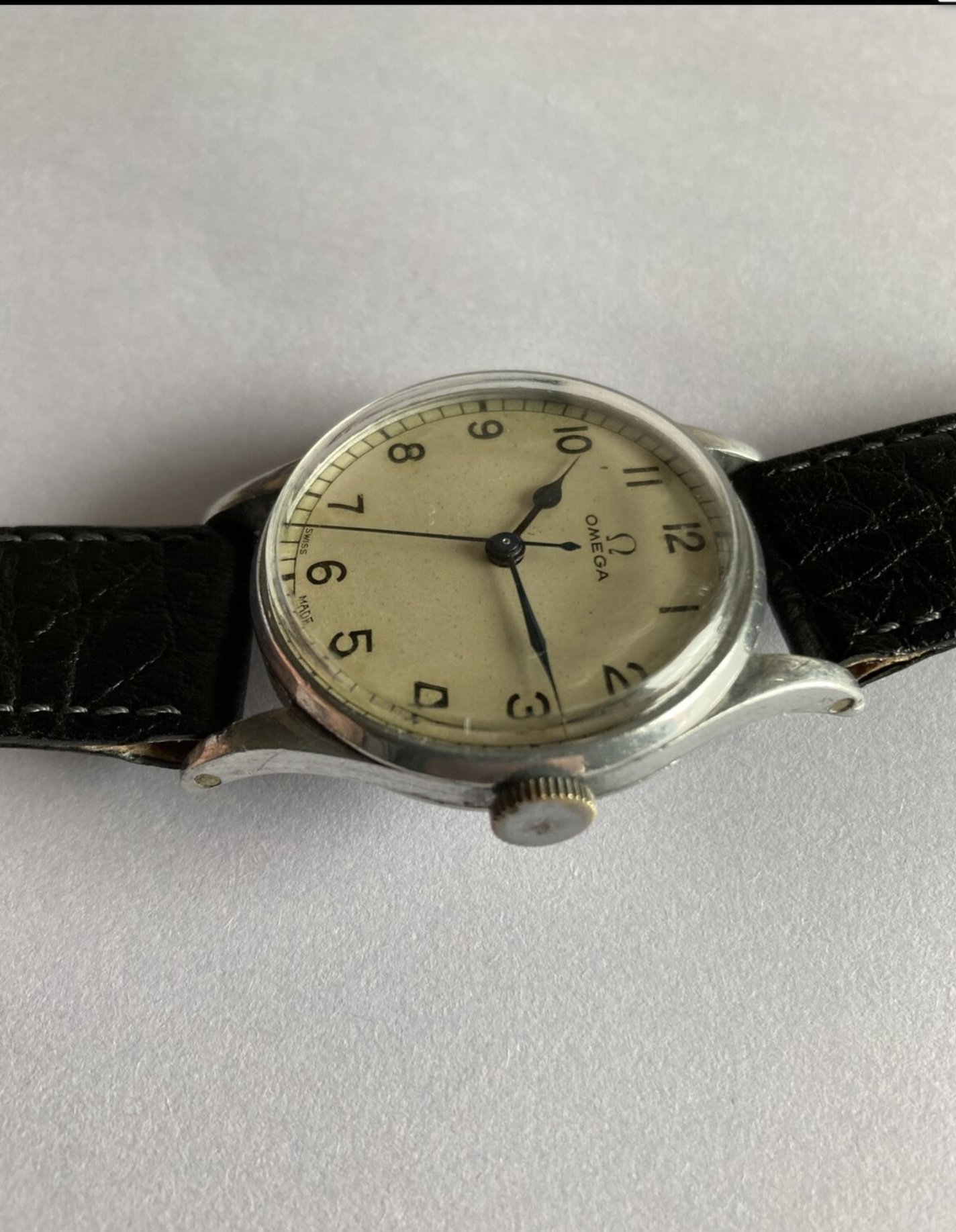

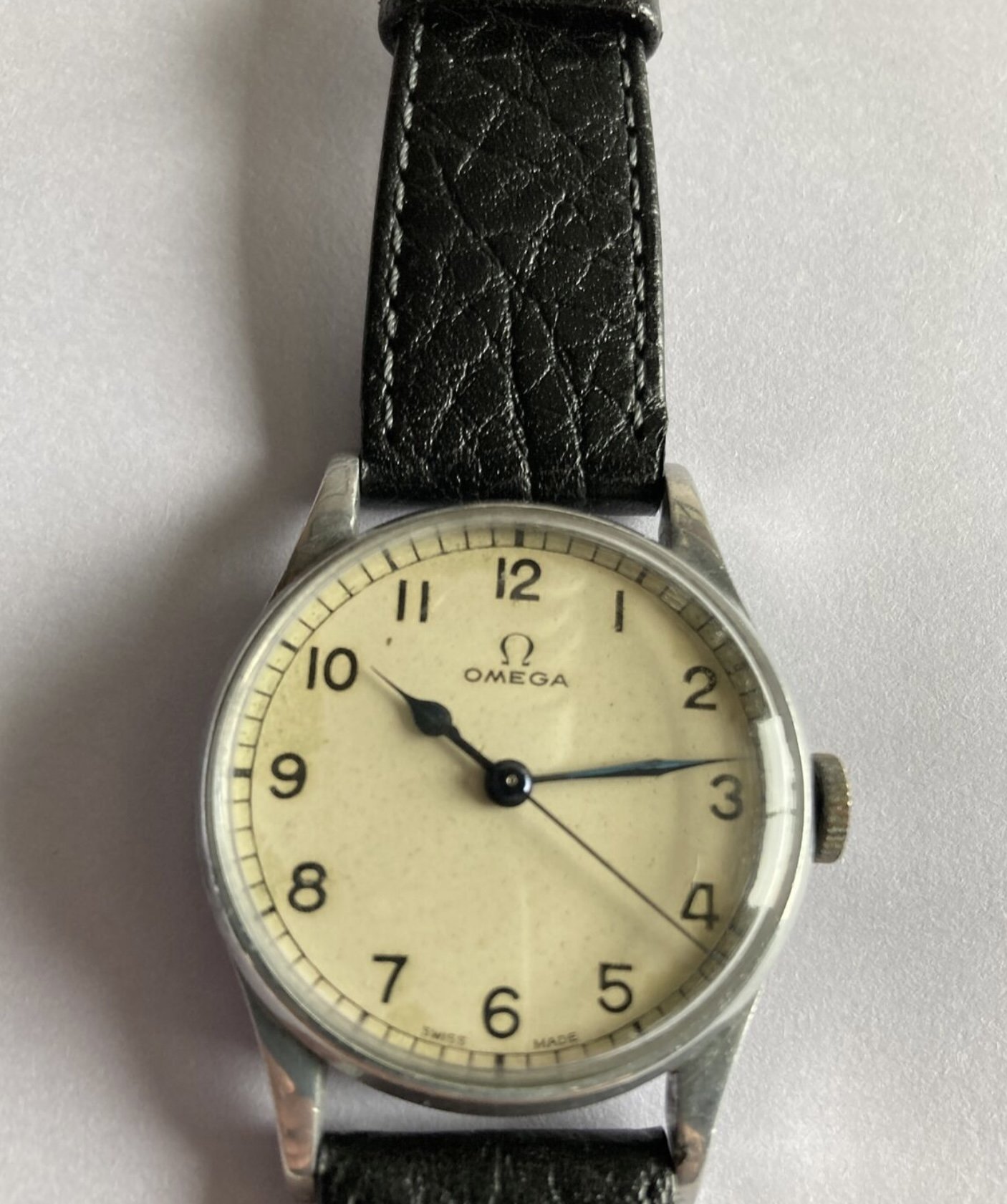

the watch has happily arrived. In person looks better, great dial and case (except the dent at the back, but is less pronounced as expected).
I have not open it yet, since I have pics of the inside. The results in the timegrapher just out of the box seem decent to me: (standard 51 degrees, I must search the correct lift angle) dial up 310/280 amplitude, 1.1 beat error, +14 secs, in other positions variates 260, 1.4, -8 secs and crown down +1/0 secs. I must check further. I suppose that the values can be better with service, but I think they are not terrible.
Serial number is from 1943 and alloy case makes it a wartime watch, but no RAF markings at the back. There were civil versions during the war or simply the military ones were removed the official markings and casebacks?

Very nice and those metrics are very good for a vintage watch.
Indeed a good idea to share on MWR, what user name did you use to sign up there? Feel free to shoot me a private message with the email address you used to sign up and I can flag your account to the admins.

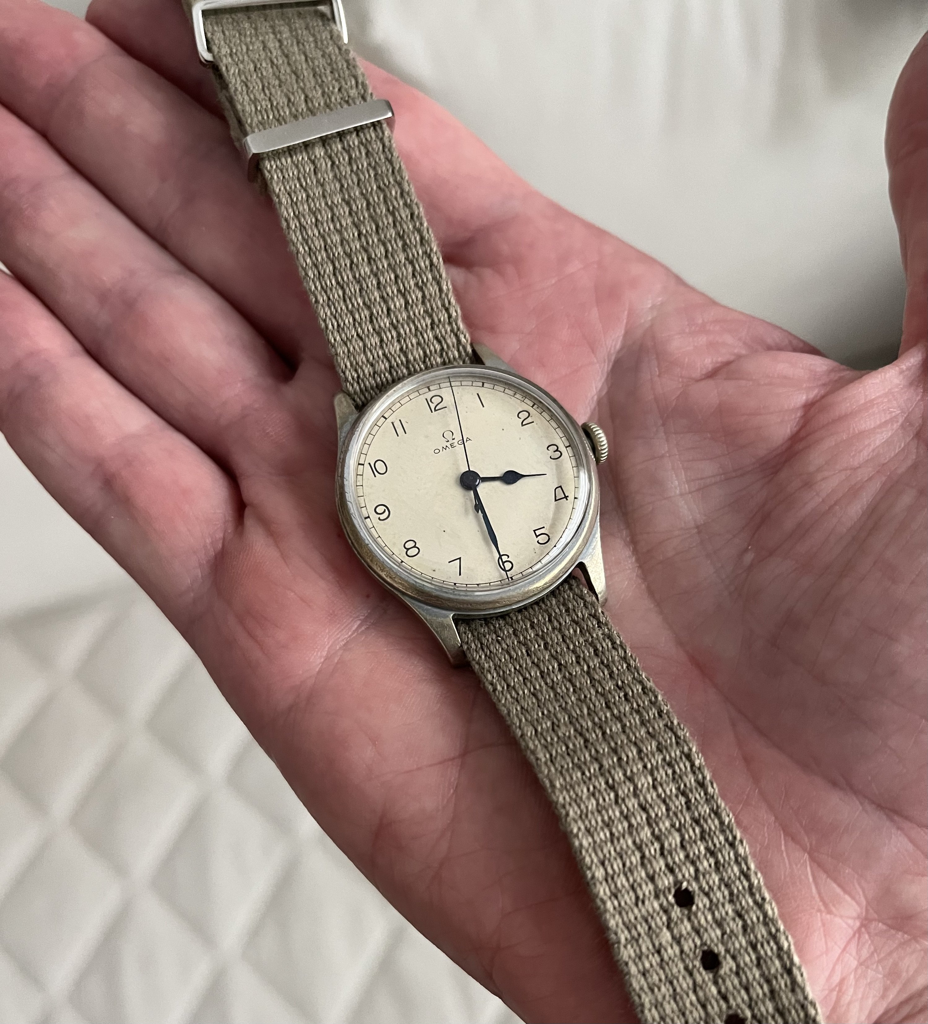

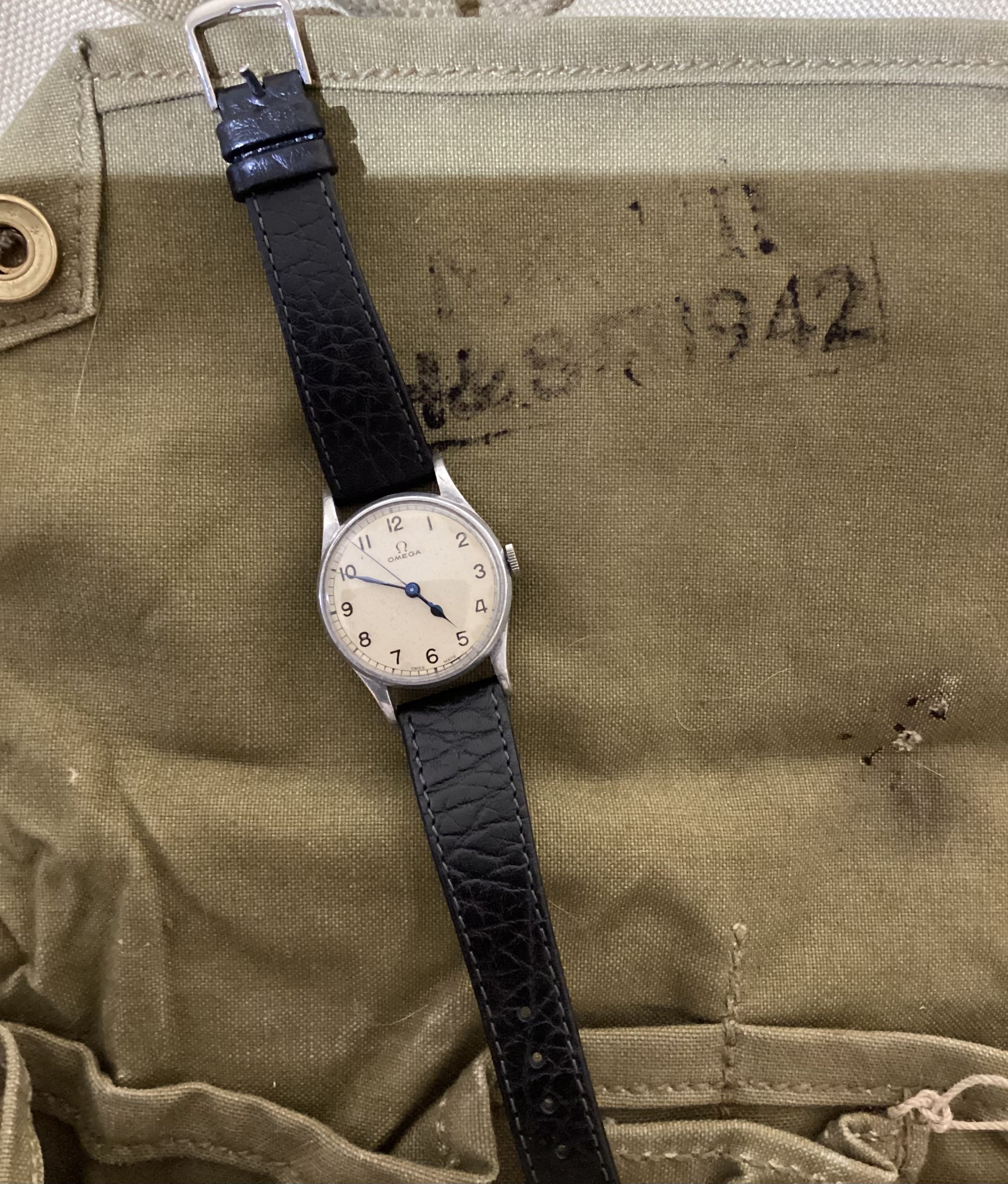

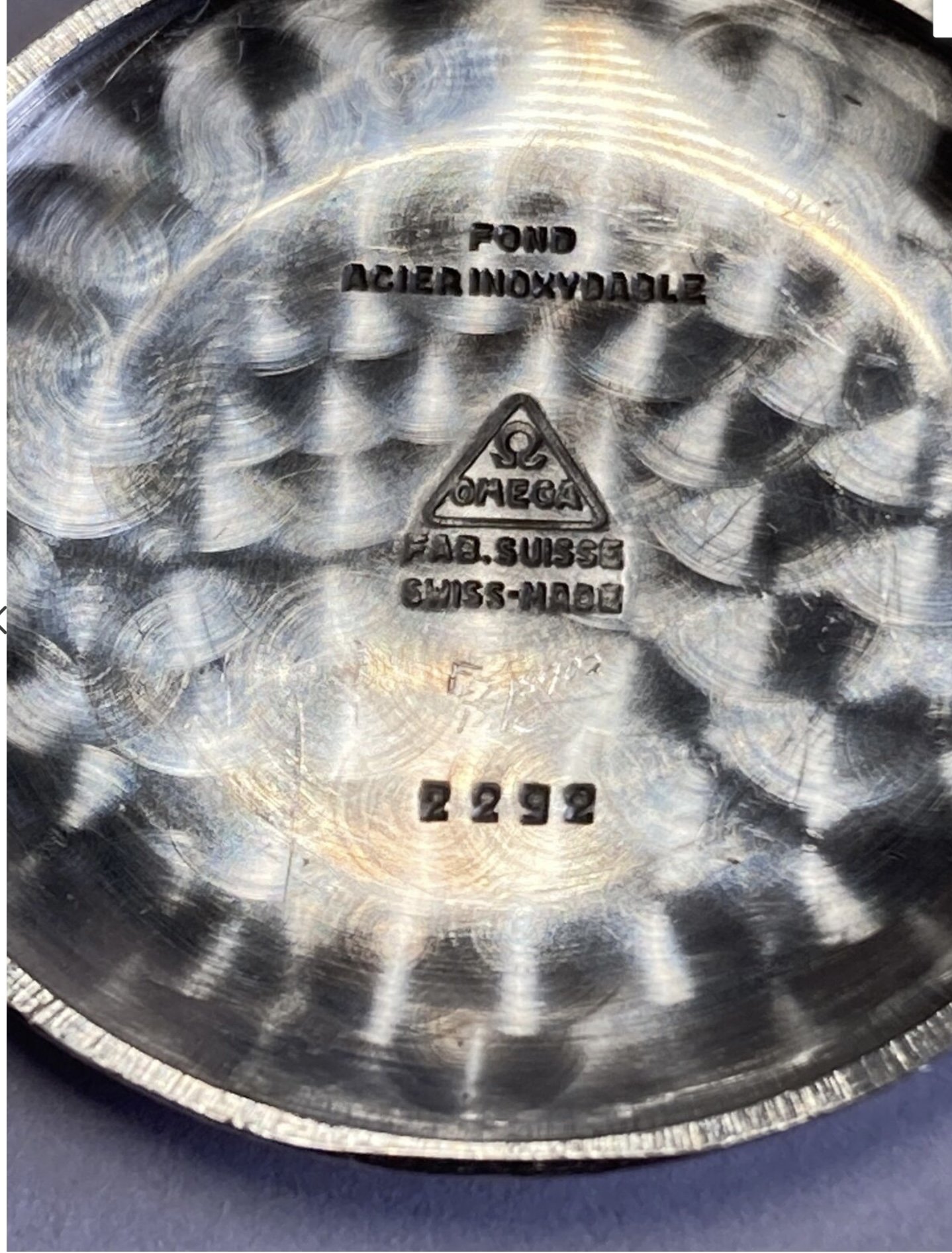

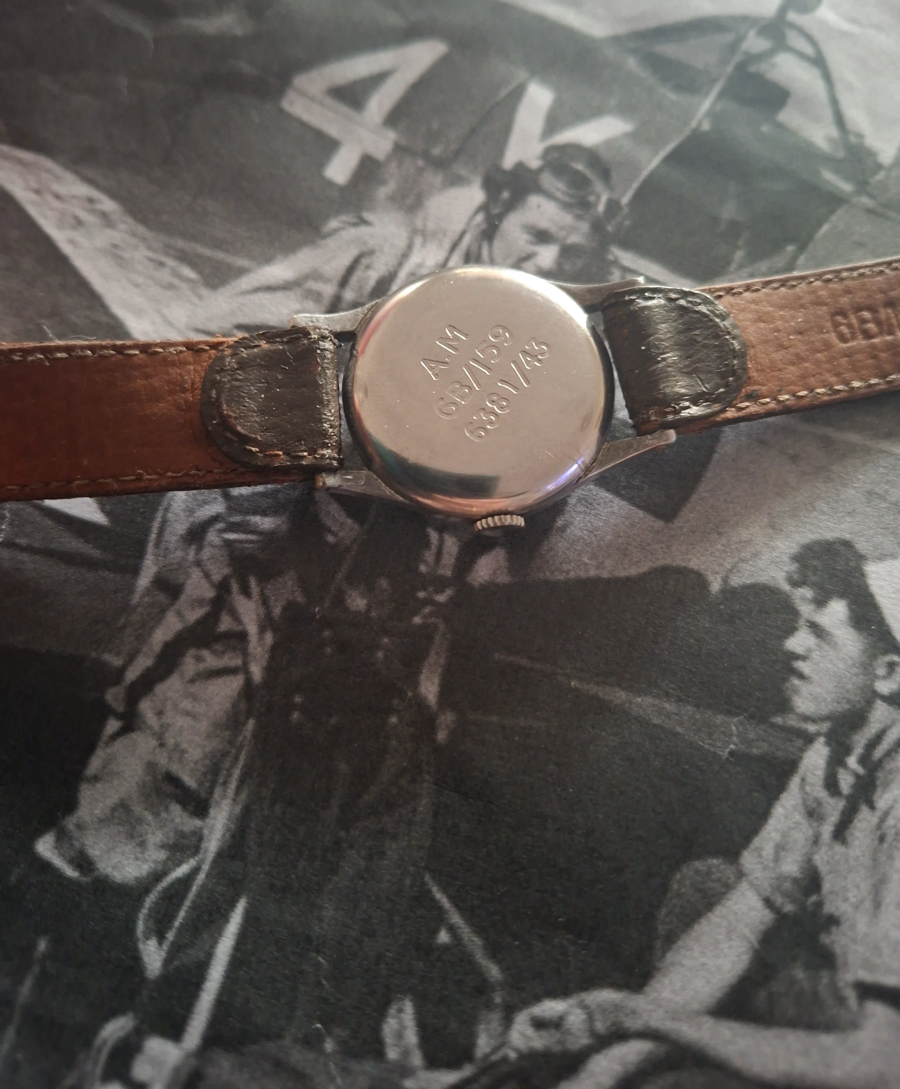

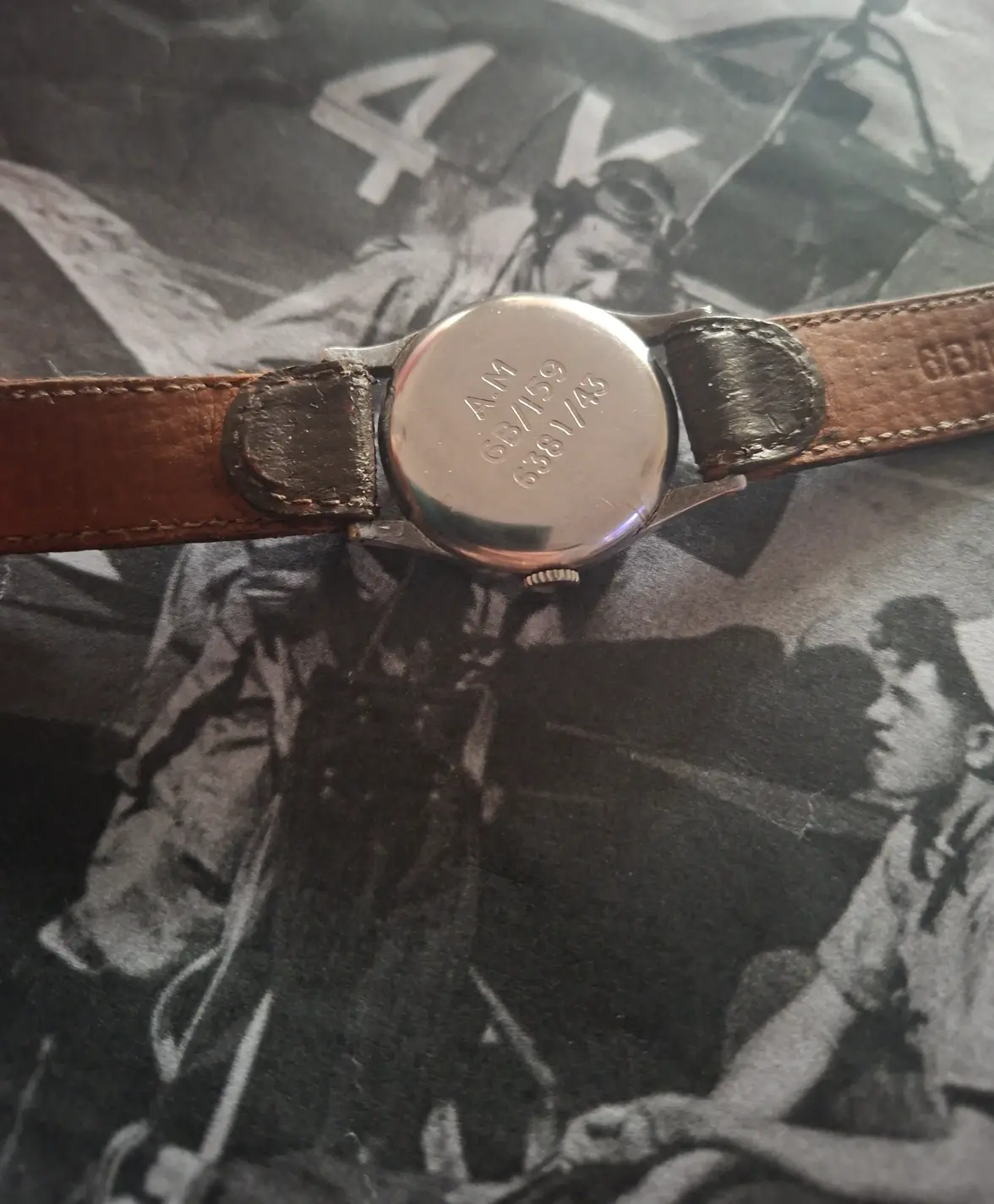

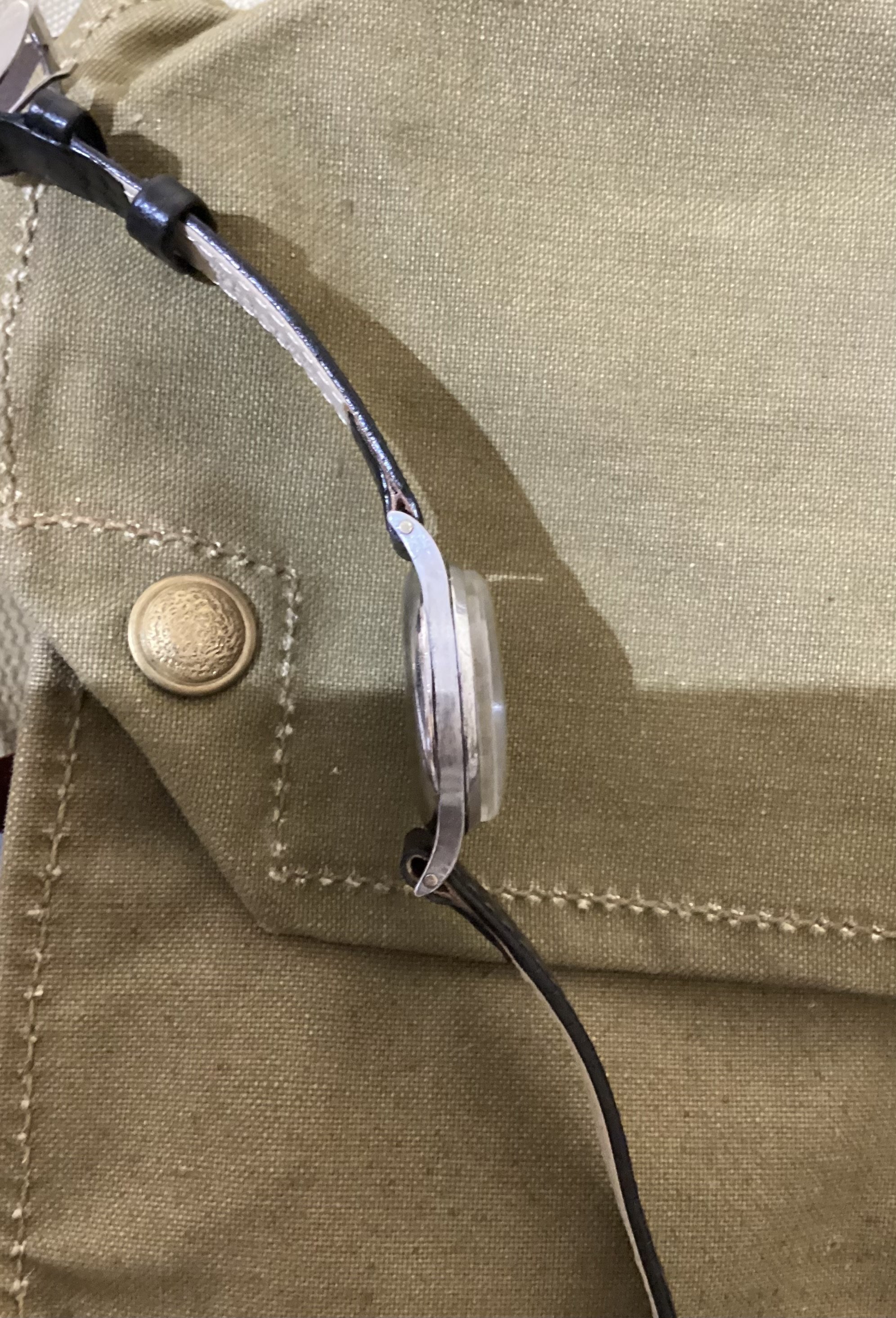

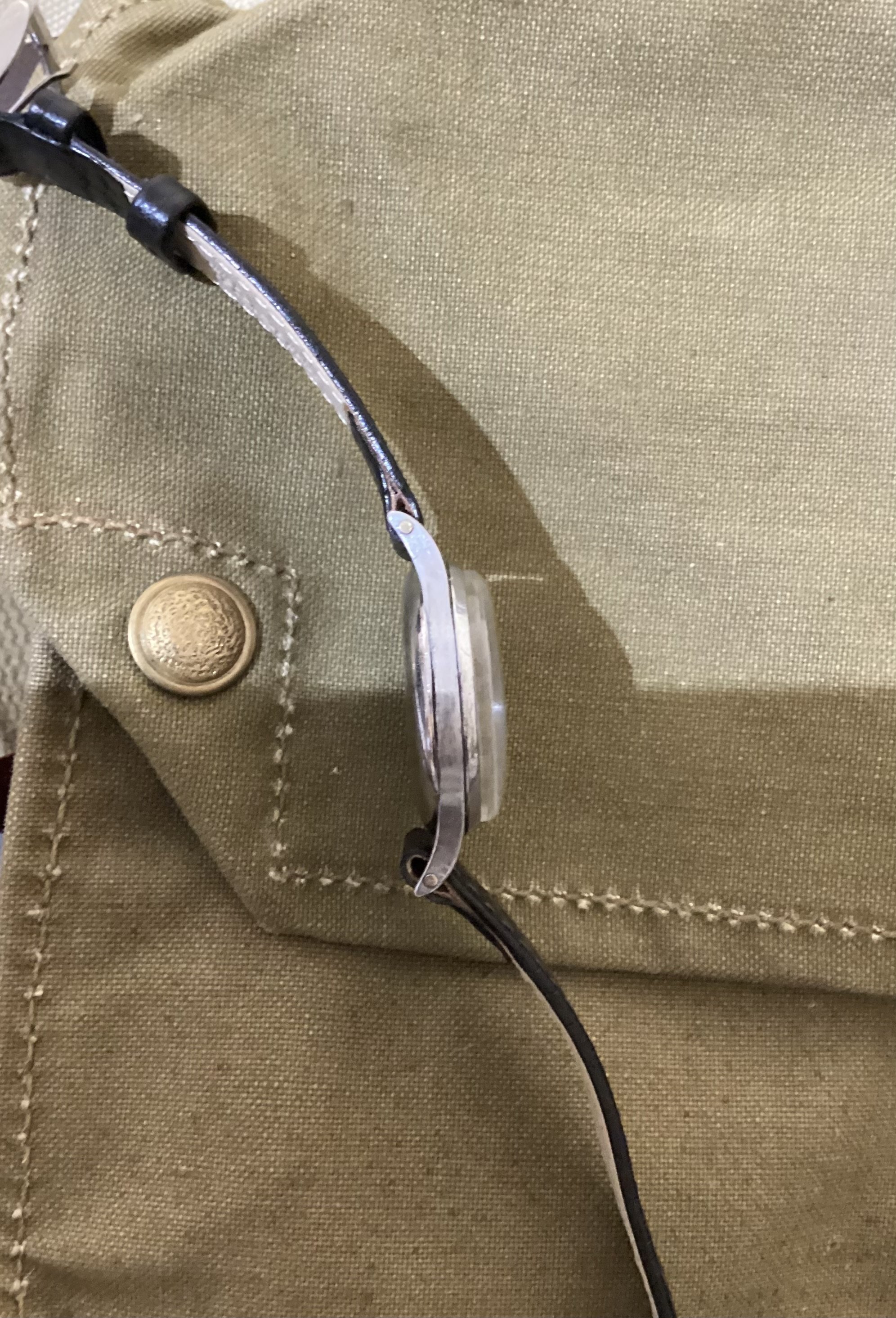

I've never come across any civilian versions with fixed bars. Even the Royal Navy Fleet Air Arm HS↑8 version (which is what mine is) had spring bars. If the watch has been worn a lot, the engraving could have worn off. Possibly the original "owner" polished out the issue markings when he decided to keep the watch. It is my understanding that, technically, the watches were the property of the British government.
Edited to add:

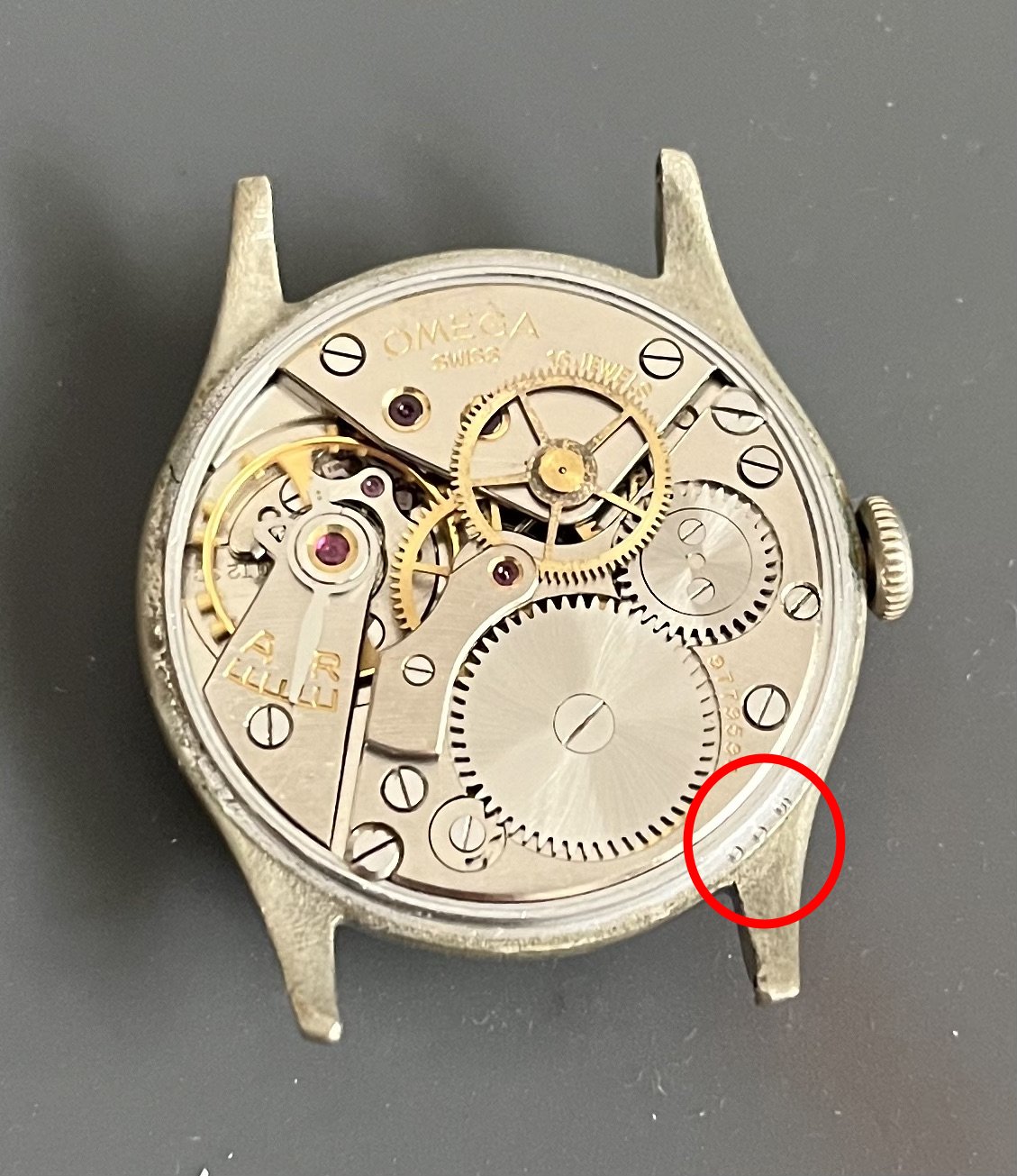

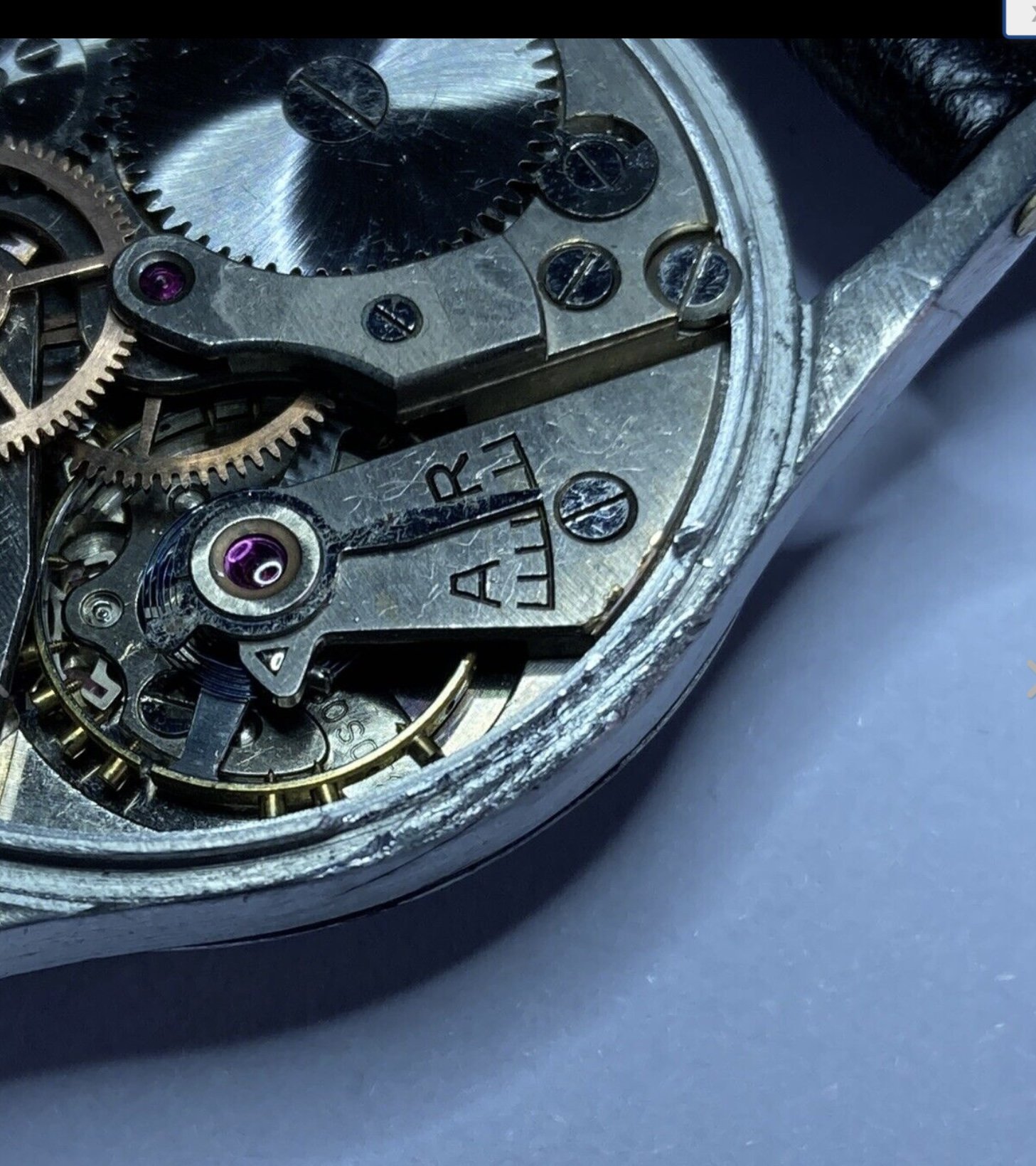

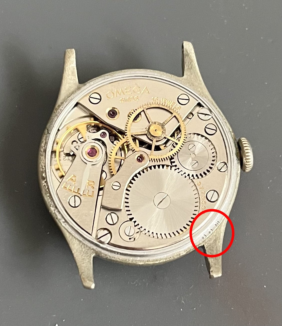

I don't know if the 6B/159 watches have the same engraving, but on my HS↑8 the issue number is also engraved inside the case near a lug. It's very small and easy to miss, but perhaps you can find something similar if you're comfortable opening the caseback.

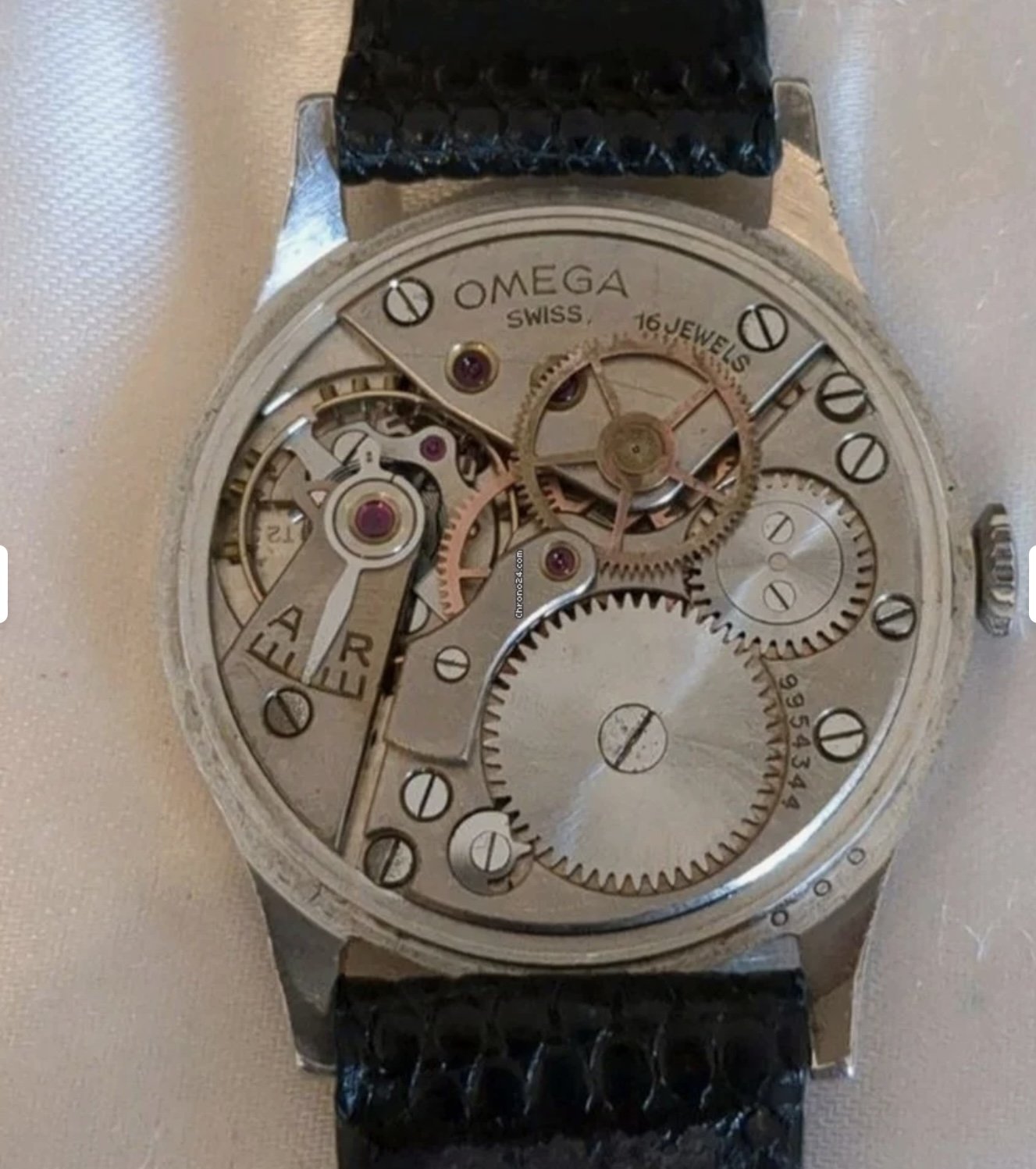

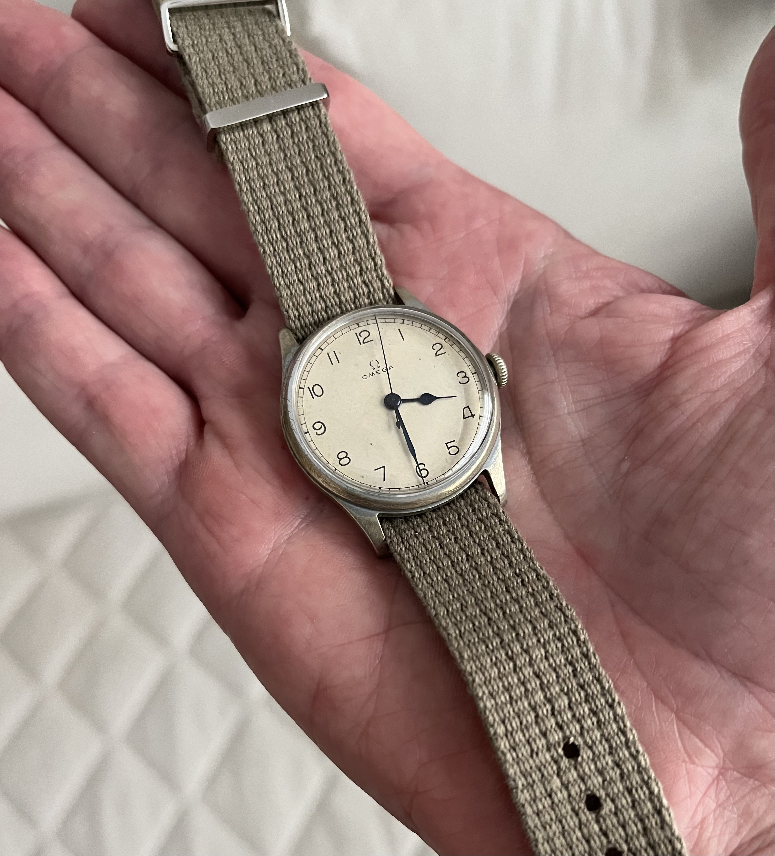

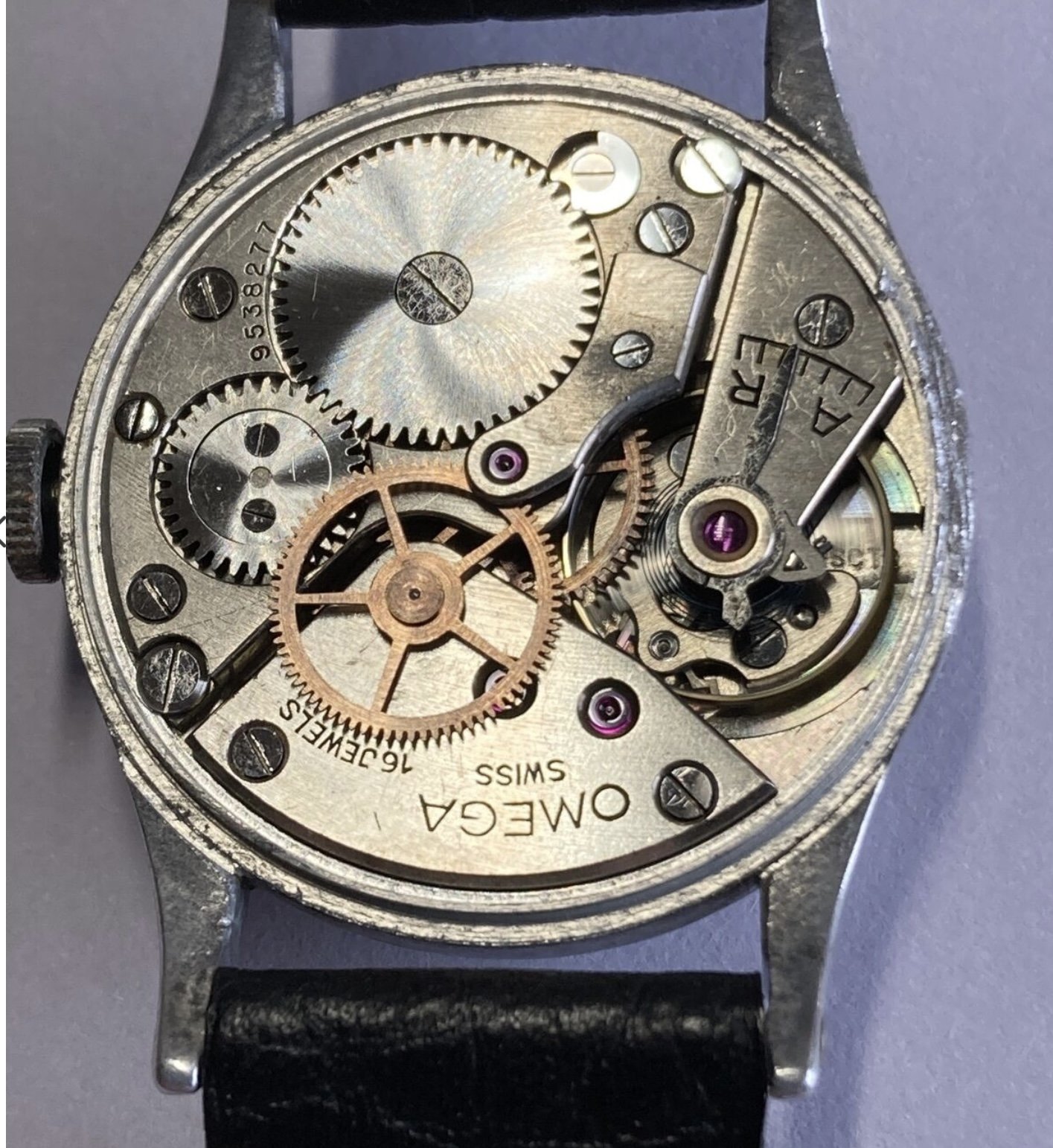

Thanks for the advices. Your strap (and watch) looks great. At the moment, the watch comes with a leather strap glued to acommodate the fixed spring bars, similar to that of the old Omega advertisement. In a future, I intend to get period correct single pass straps as yours. I have a pic, not made by me, of the inner case. Not sure if there is engravings; at some moment I will open the caseback and inspect carefully with a loupe.
