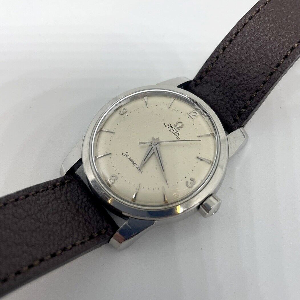

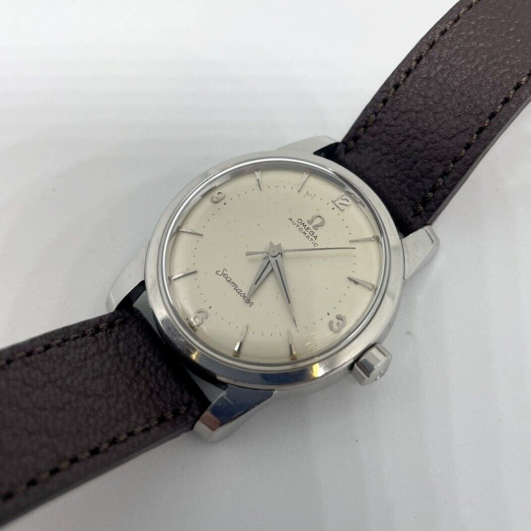

Hey, we're all new at some things, right? If you're willing to help me learn, for the sake of argument, what would distinguish a good one from this one? I'm happy to be pointed to another thread if you're aware of one.
Find a reference you like (number marked inside the case back) and study as many examples as you can. You've already spotted the problem with "AUTOMATIC" in the example you posted. Additionally SWISS MADE is in the wrong position and Seamaster is not really correct as well.
Details will vary from reference to reference and so do dial styles.
As others have noted, with some patience there is really no need to settle for something which isn't correct.

The case has been polished a lot to remove the facets from the lugs and bezel. An SS watch should have a crisp look and not soft like a bar of soap. This is a nogo by itself.
The dial has numerous problems to a collector despite a “clean” general appearance. The minute marks have a few problems, Swiss made is too high, fonts are incorrect, automatic and relume as noticed by you, second hand too short. So many issues would be hard for me to overlook.
I don’t think these are so uncommon so wait for a better one or pay a little more for a good one. You are trying to recreate your memory of an authentic watch, so best stick with original condition ones.

Soft case and a poor redial. I would put the value below $400.
