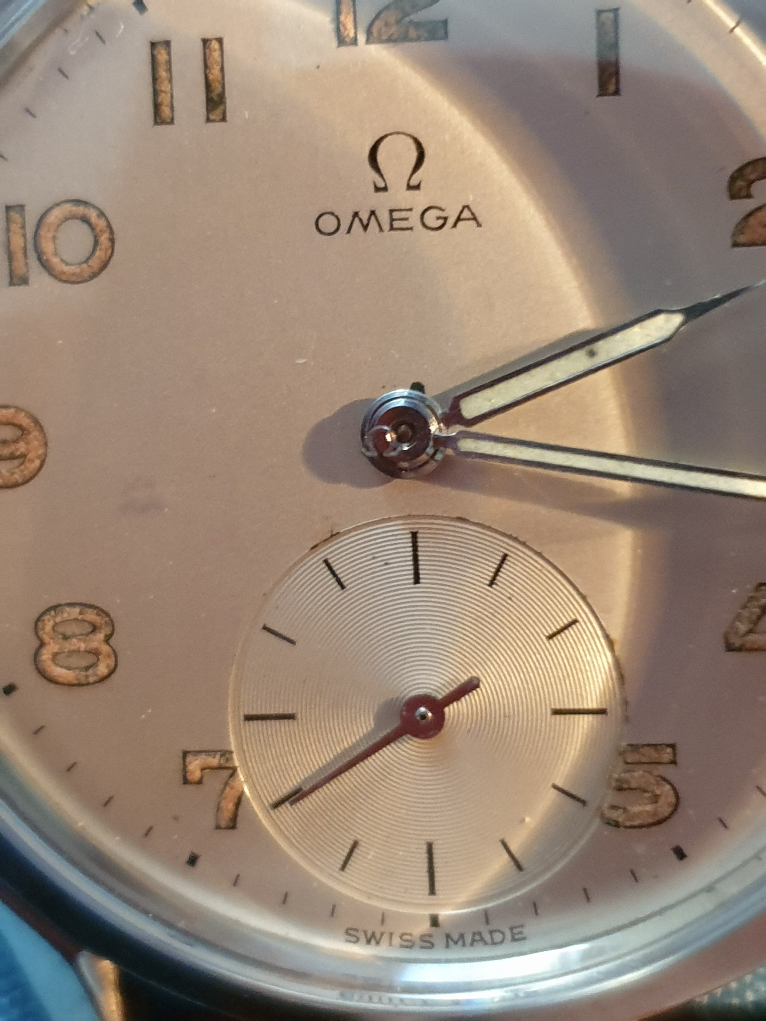

Came across this Omega 2639-9.
It has a really clean look and I personally like it nontheless. Can anyone tell me is this a redial?
Thanks.

Dial looks ok to me, but the hands were re-lumed.
Yeah they definetely are :/ I'm a newbie when it comes to vintage Omegas. Is the dials being re-lumed considered as a major flaw?
Im glad the dial looks fine tho.
Hands relumed, not dial. I also think that the sub-seconds hand is probably a replacement.
Yes sorry I meant the hands.

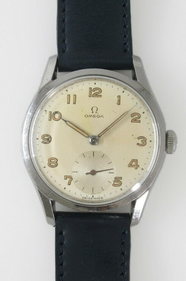

I don't think so. Seconds hand looks like many others. Currently in Ebay:
And an incorrect one - I'd say it should be longer? It doesnt touch the outside of the circle.

I was told by the previous owner that everything is original. Of course that doesn't really guarantee anything as we see...
How big flaw is it considered if the hands are re-lumed? Assuming the sub-seconds hand is original. I guess the hands could be replaced if one happens to come by any original spare hands..
I dont plan to sell this but would be still nice to know if this has any value.
Reluming hands was not uncommon during a service. So although it is not completely original anymore, it wouldn't bother me too much.
And I guess if the sub-seconds hand happened to be a replacement part it would be possible to find an original hand and replace it.
Yes. Anything is possible. 😉
As I said, I don't believe, the hand is wrong. It is a tad too short, so it might be broken. But the shape is imho correct.
If you like the watch, leave it like it is.
Yeah. Thanks for the information. Im gonna get this one a nice mesh bracelet and enjoy it. The size
/fit of the watch is perfect for my skinny wrist...

As said above the color of the lume on the hands doesnt match the aged lume on the indices . I would only go for it if the price was pretty low and tempting .
I guess the original lume was radium and during a service it was replaced with something else?
Such a shame really, because the utility of the new lume is close to zero and
still it comes with a cost of breaking the aesthetics and originality.
With a closer inspection of the sub-dial it looks indeed that the tip is broken.
These flaws dont really bother me too much, but I will explore options if I could somehow
find original set of hands with original radium lume and a new subdial hand.

if I could somehow
While I am not afraid of radium lume in watches, I would not search for them just to install them on a watch that i already like. You should be aware that radium lume is still problematic as its radioactive.
Most probably, your watchmaker can adapt the colour of the hands' lume to the colour of the dial's lume. Would be cheaper and less problematic.
Such a shame really
Not necessarily. The old lume could have fallen out. We don't know what happened to the watch and why the lume was reapplied.
