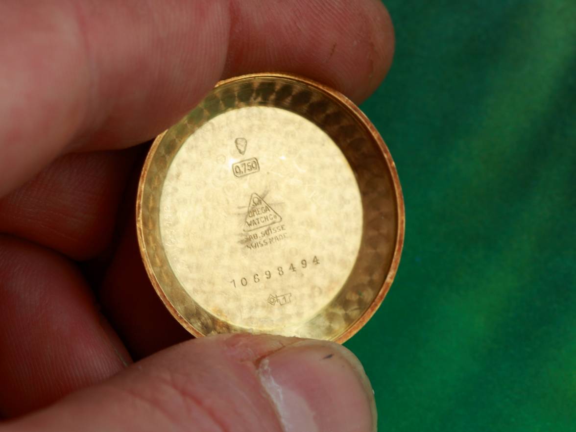

Is it typical for the inside case lettering (OMEGA) to have such an irregular, hand engraved look?
1,320
741

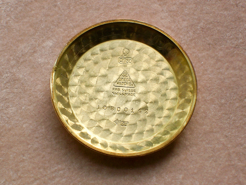

Here for comparison is a picture of the inside case back of my 2445 of c1946, serial numbers in the same range, also 18k. You will notice quite a lot of differences, but maybe these are just down to different case manufacturers?
8,109
36,567
Yes, it's quite normal. Here's another example of this spidery text, this is a 28.10 from 1945.

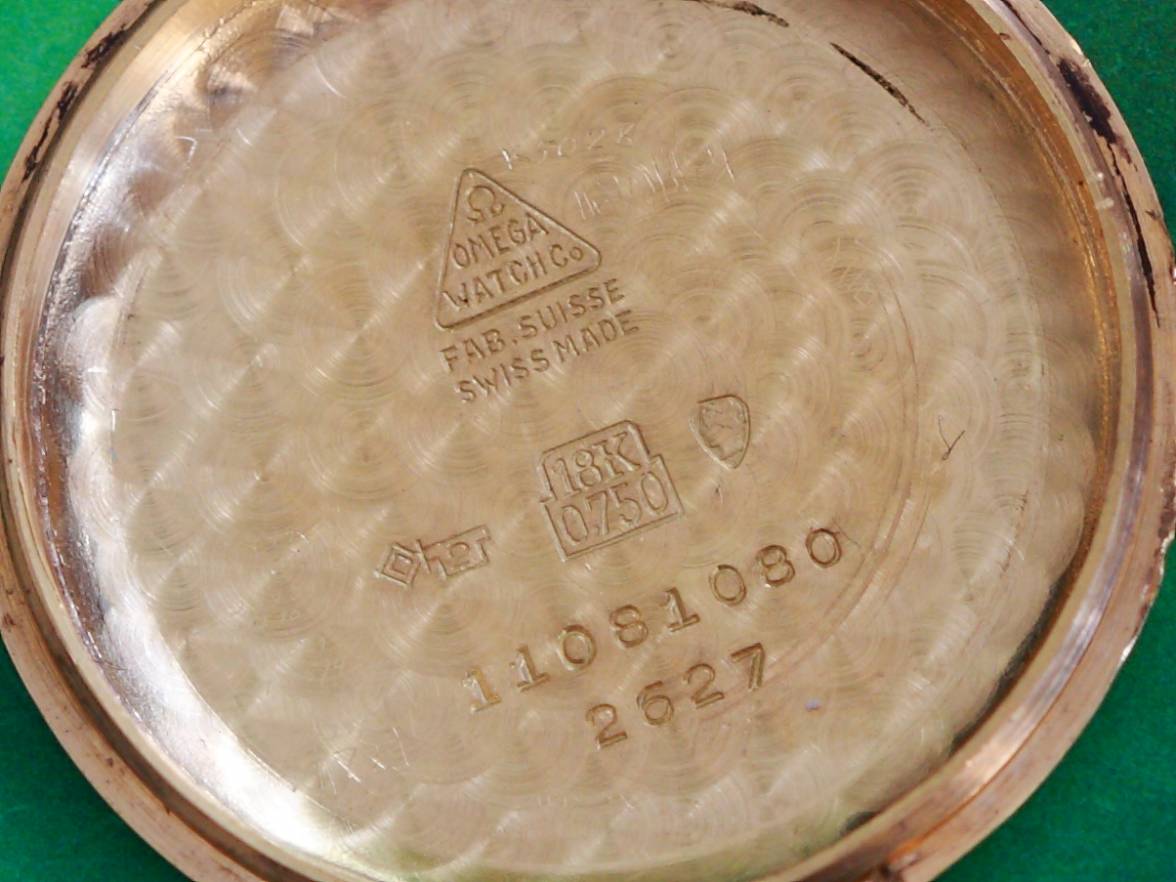

and here a 2627 from 1950.
