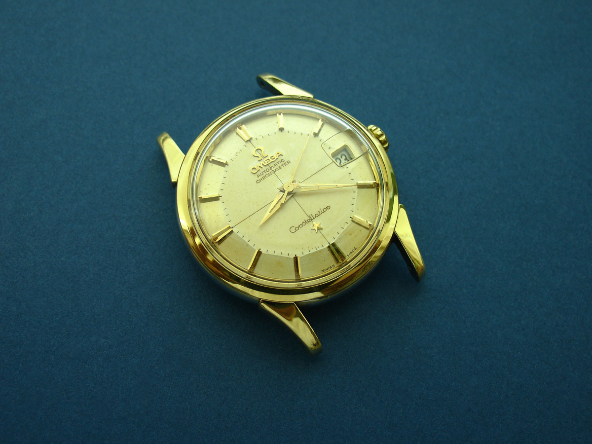

Anyone recognize the reference 10761975 ?
Movement is 10,xxx,xxx from late 40's ?
Trying to figure the case diameter ? ? ?
33mm without crown

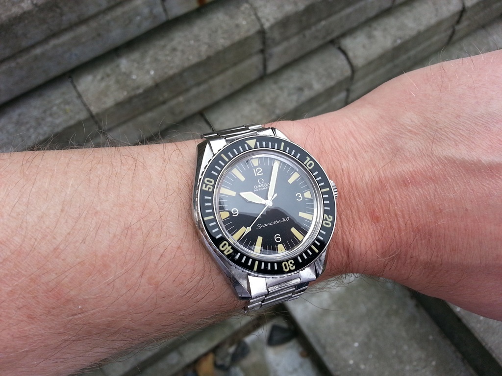

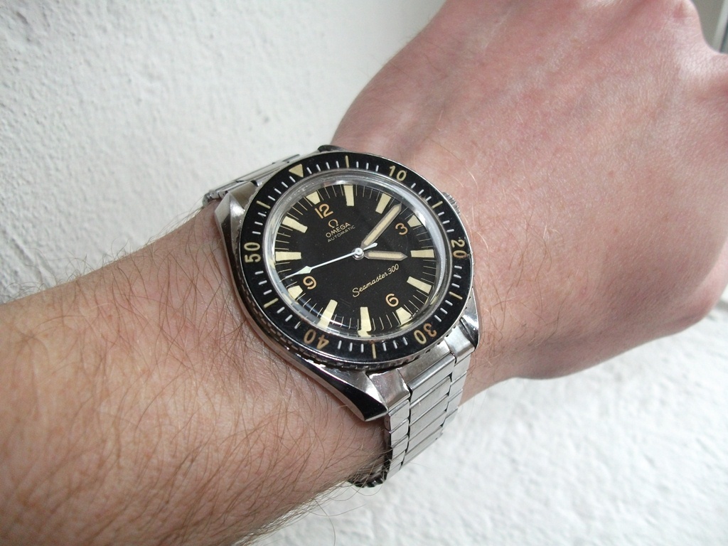

Ended at $3550, which I think is rather high for one with incorrect hands, cracked crystal, and no bracelet, no?
Yes, hands should be broad arrow ones on this serial, changed around '65.
My 165.024 with about same serial; 24.71x, has broad arrows + same type bezel and is original.
My 165.024-64 with serial 23.7x has stick hands and early bezel
On the other hand, could be okay. These transition phases are allways full of "if's". Lume and rest of the watch looks okay and correct.
Prices are also climbing for the SM300's, but yes, this one is a bit on the top side.
