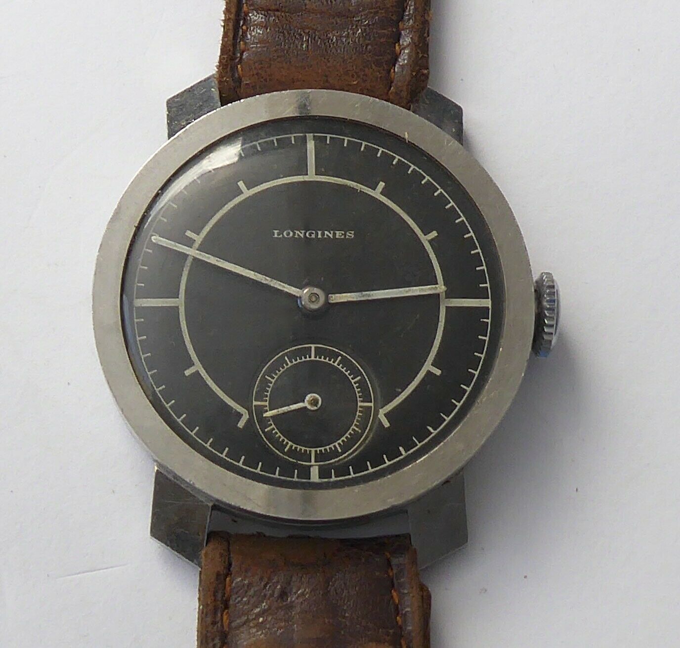

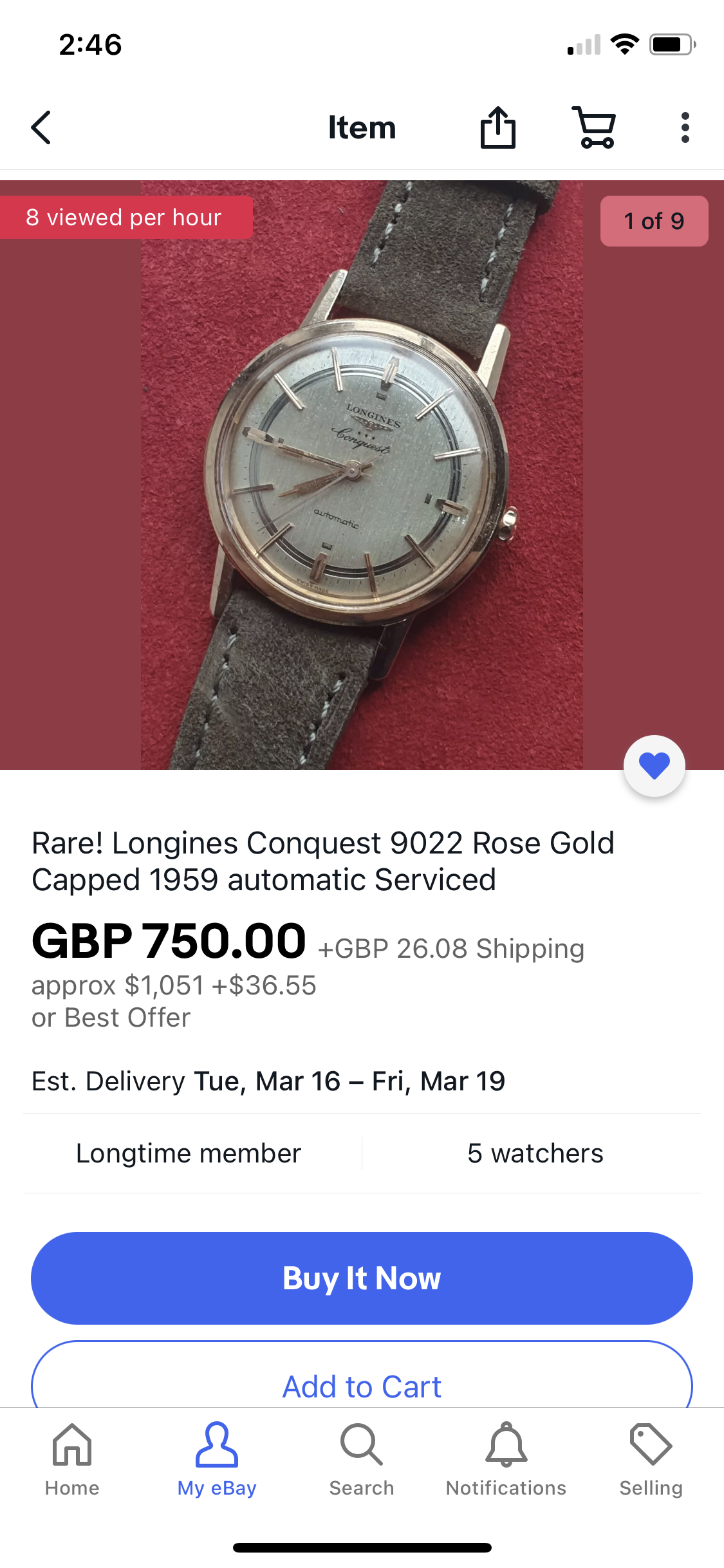

I'll answer your question, but please understand that this is in the wrong thread. If you have a question on a particular watch, please open up a new thread for comments.
This watch looks to have had an older redial job done many years ago. You did not include a picture of the inside of the caseback, which would identify the model number and whether the case was commissioned by Longines.
I would not buy it.

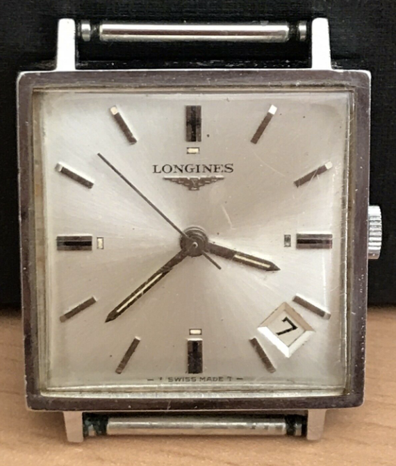

Hungary is not where I usually look for watches, and this is so clean that I was initially suspicious. The same seller has a mix of other listings, most are good, but one is a re-dialed Tissot that is not disclosed. After looking quite carefully at this watch, and comparing with other examples, it looks legit for me, so I decided to post it here. Still, I welcome comments if people feel I've recommended this in error.
https://www.ebay.com/itm/Longines-Vintage-Cal-30L-Stainless-Steel-1968-Oversize/293723657916?ssPageName=STRK:MEBIDX:IT&_trksid=p2060353.m1438.l2649

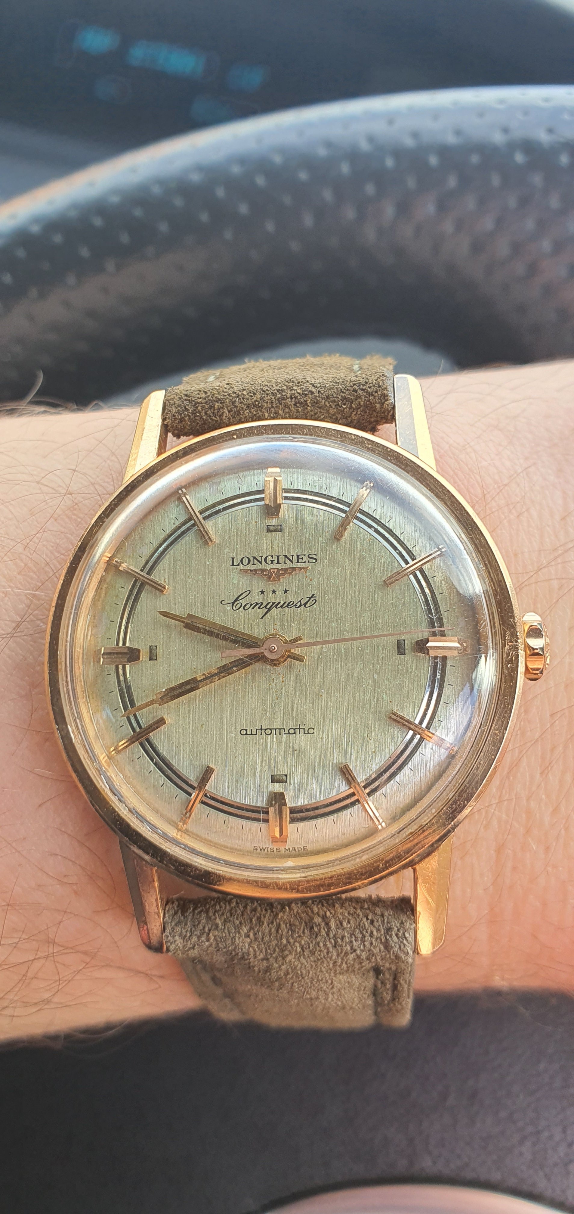

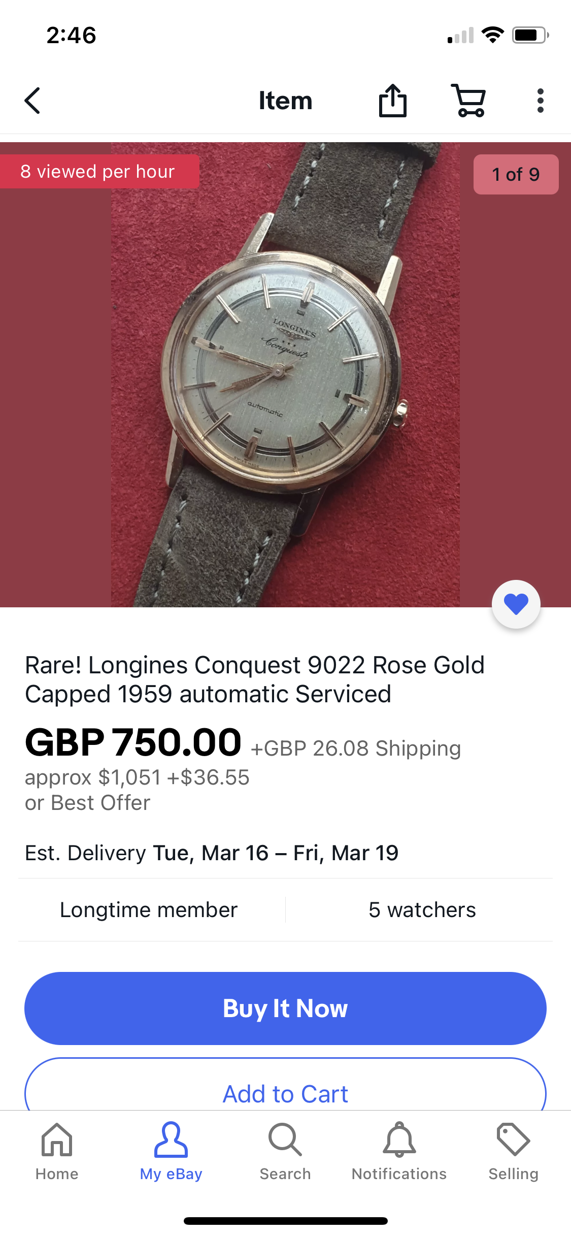

Looks very nice.
But after the Brexit, I should add 205 pounds to the asking price to buy this 🙁
Make a 300gbp discount offer and maybe still ok 👍
3,095
3,605
Thank you,
I've managed to buy it for 525 , it's not perfect but i like it ...
Way to go!
That's the original scallop crown I believe. Impossible to source.
Most have lost their scallop crown over the years.
There might be a 3 or 4 digit number on one of the lugs
that matches a serial on the movement(or is it the case back number, can't remember),
if these are like the Power Reserve.

Thank you,
I wouldn't have thought that the seller would accept such a discount. Good haggling and congrats!

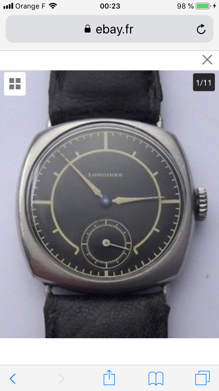

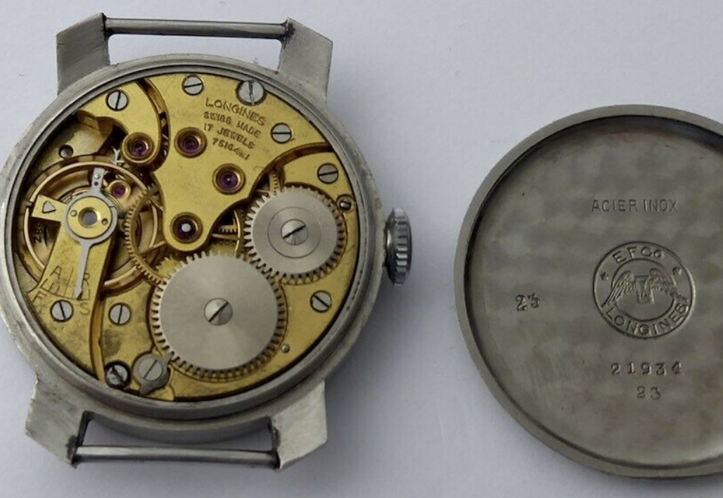

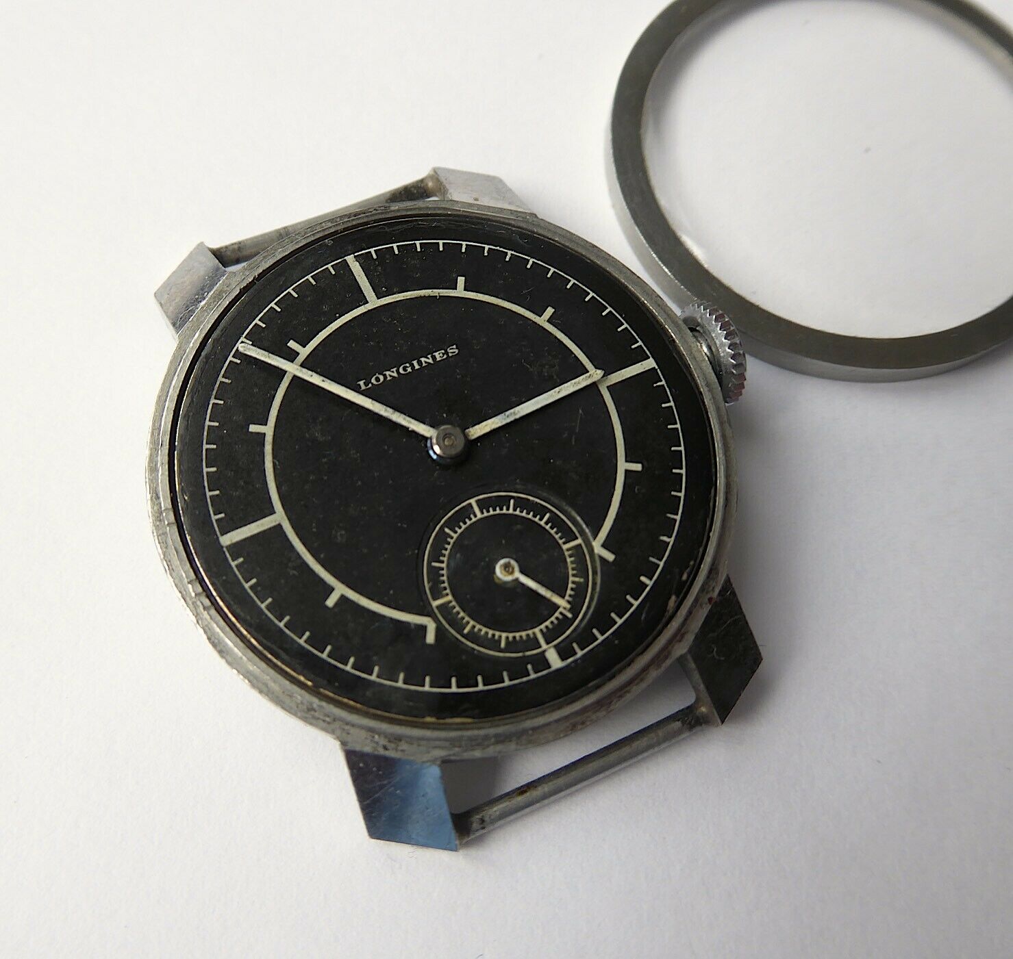

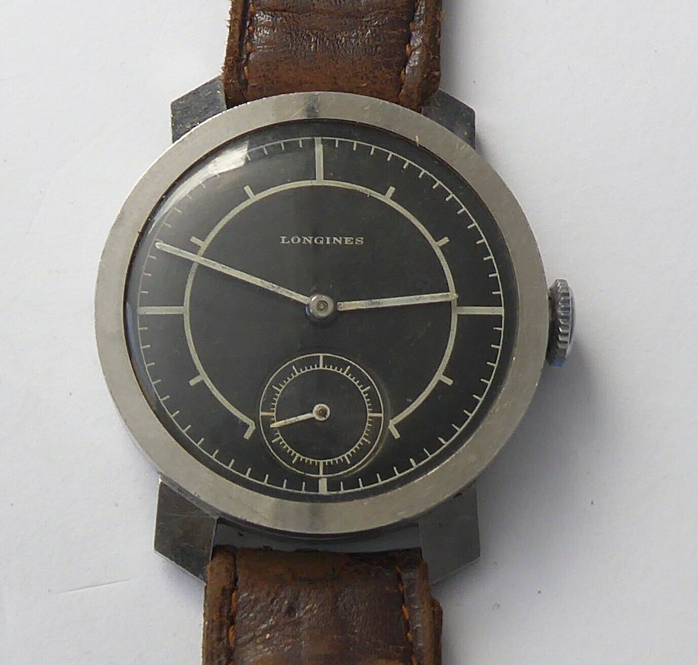

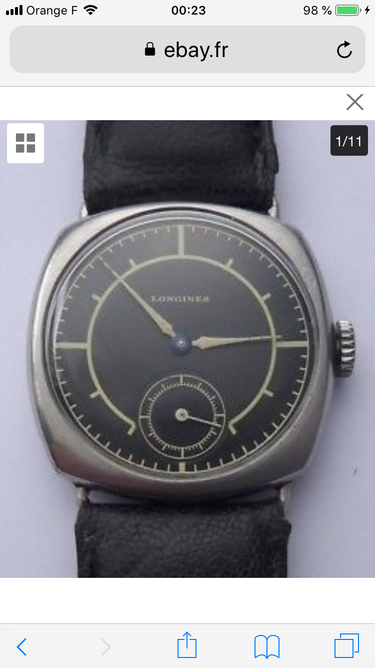

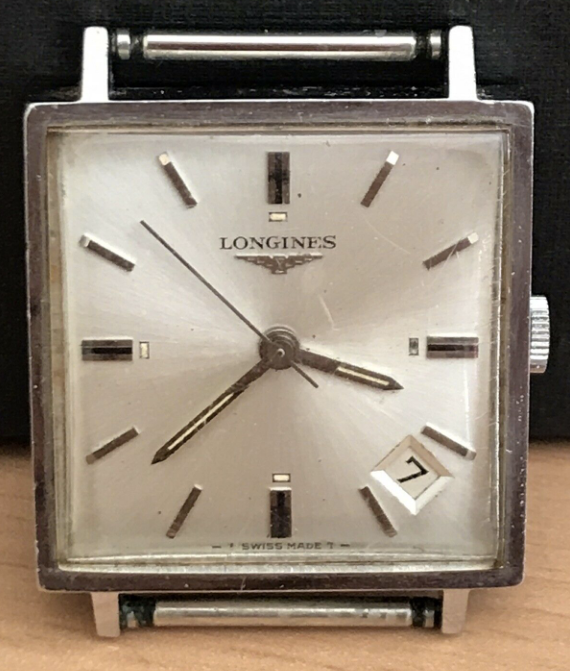

Lots of problems with the flat-bezel piece. For a start, the movement serial number (7'516'4x1) dates to circa 1949 whereas the order number (21'934) dates to the early 1940s. I suspect that the movement and case do not belong together, i.e. it's a franken. Beyond that, the crown is incorrect, blued hour hand is incorrect, and I am suspicious of the dial too. The signature does not look quite right, to me, but I am not certain. All in all, I would certainly not recommend this piece. As for the cushion-case example, I notice that it also has blued hands. Maybe both watches were created by the same "creative" person?
