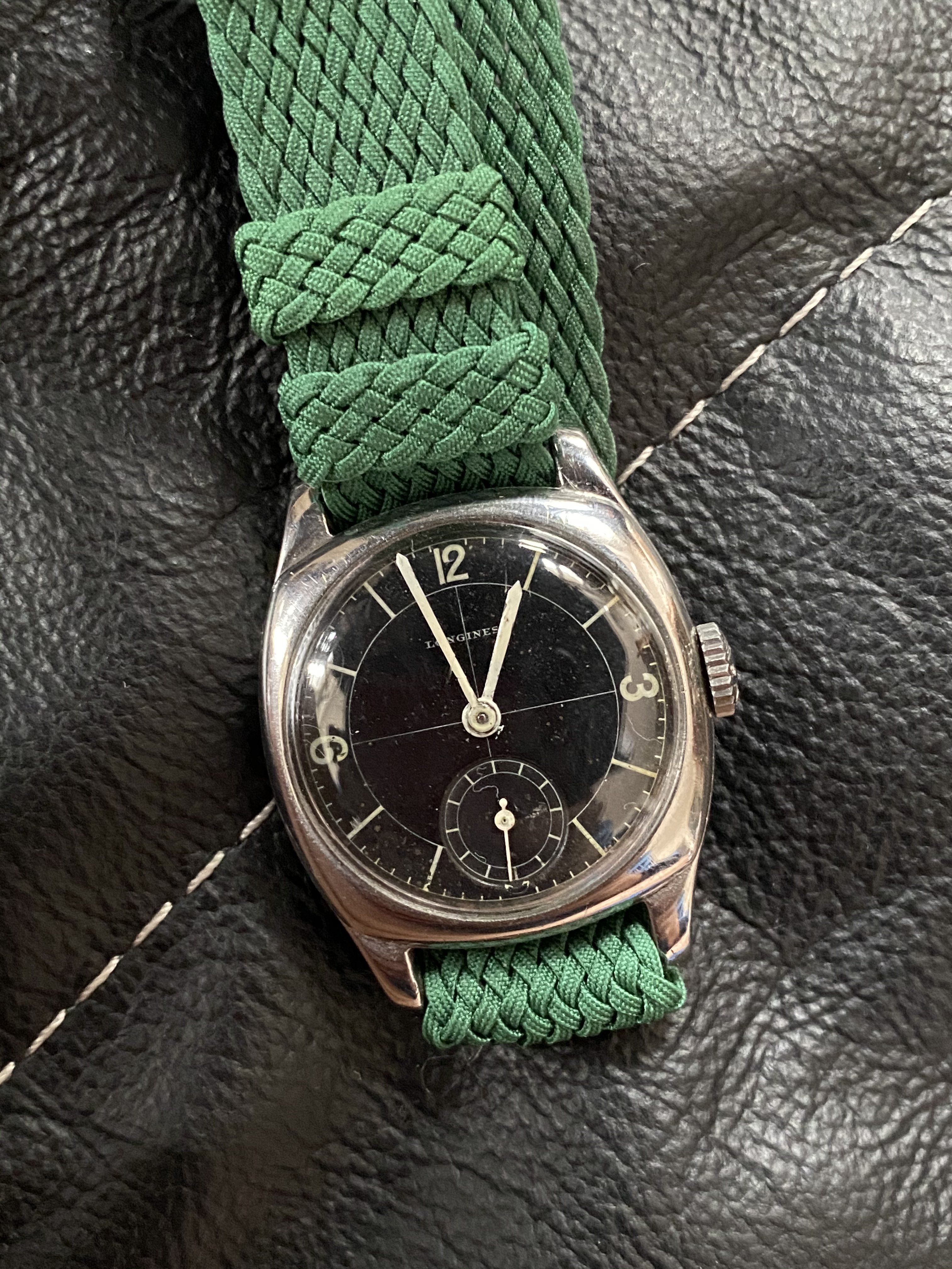

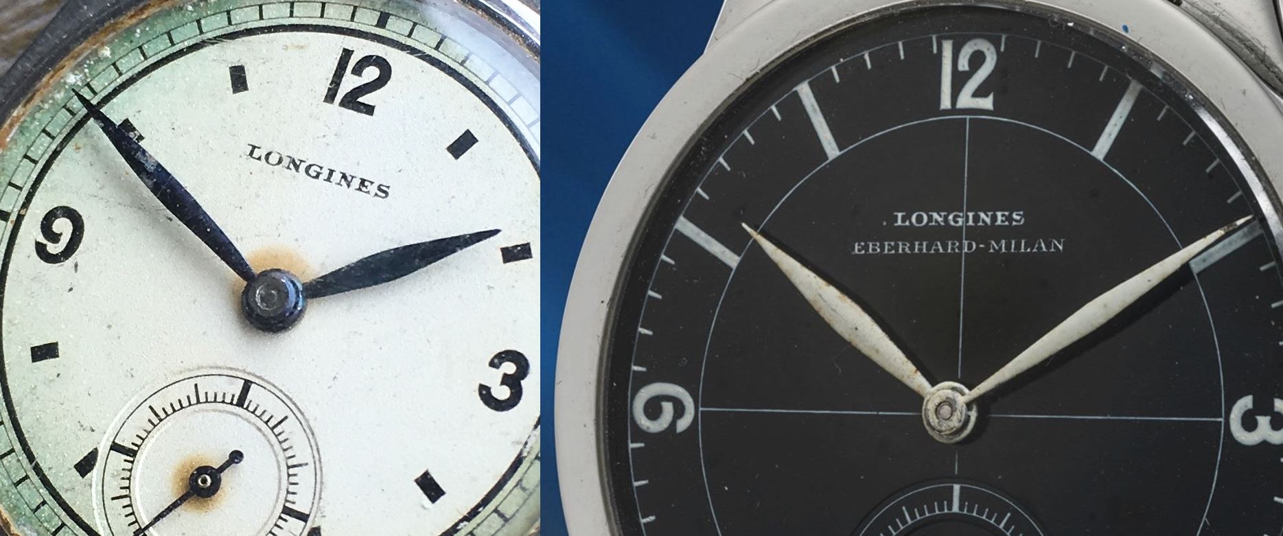

Lots of problems with the flat-bezel piece. For a start, the movement serial number (7'516'4x1) dates to circa 1949 whereas the order number (21'934) dates to the early 1940s. I suspect that the movement and case do not belong together, i.e. it's a franken. Beyond that, the crown is incorrect, blued hour hand is incorrect, and I am suspicious of the dial too. The signature does not look quite right, to me, but I am not certain. All in all, I would certainly not recommend this piece. As for the cushion-case example, I notice that it also has blued hands. Maybe both watches were created by the same "creative" person?
One important thing I would add is that the dial is a typical 1930s dial- how it landed together with an early 1940s case and a late 1940s movement is not so much of a mystery, given that this chunky case may well be bigger than the original one.
If I were betting, I would say this dial indeed probably started its life in a 31mm cushion case like the beautiful one from @chronovantage2 below— and the small size might explain the urge to relocate the dial to a larger case.
Also for comparison, another black sector dial from the same era in a cushion cases. (Mine, with thanks to @yako54 for selling me his).
You’ll note in the Ebay watch the uneven space between the bezel and the minute index, the dial looks like a small person borrowed someone else’s oversize sweat shirt.
Remember those dial types are prime transplant candidates, as proven in the thread below.

One important thing I would add is that the dial is a typical 1930s dial- how it landed together with an early 1940s case and a late 1940s movement is not so much of a mystery, given that this chunly case may well be bigger than the original one.
If I were a betting, I would say this dial indeed probably started its life in a 31mm cushion case like the beautiful one from @chronovantage2 below— and the small size might explain the urge to relocate the dial to a larger case.
Good points.

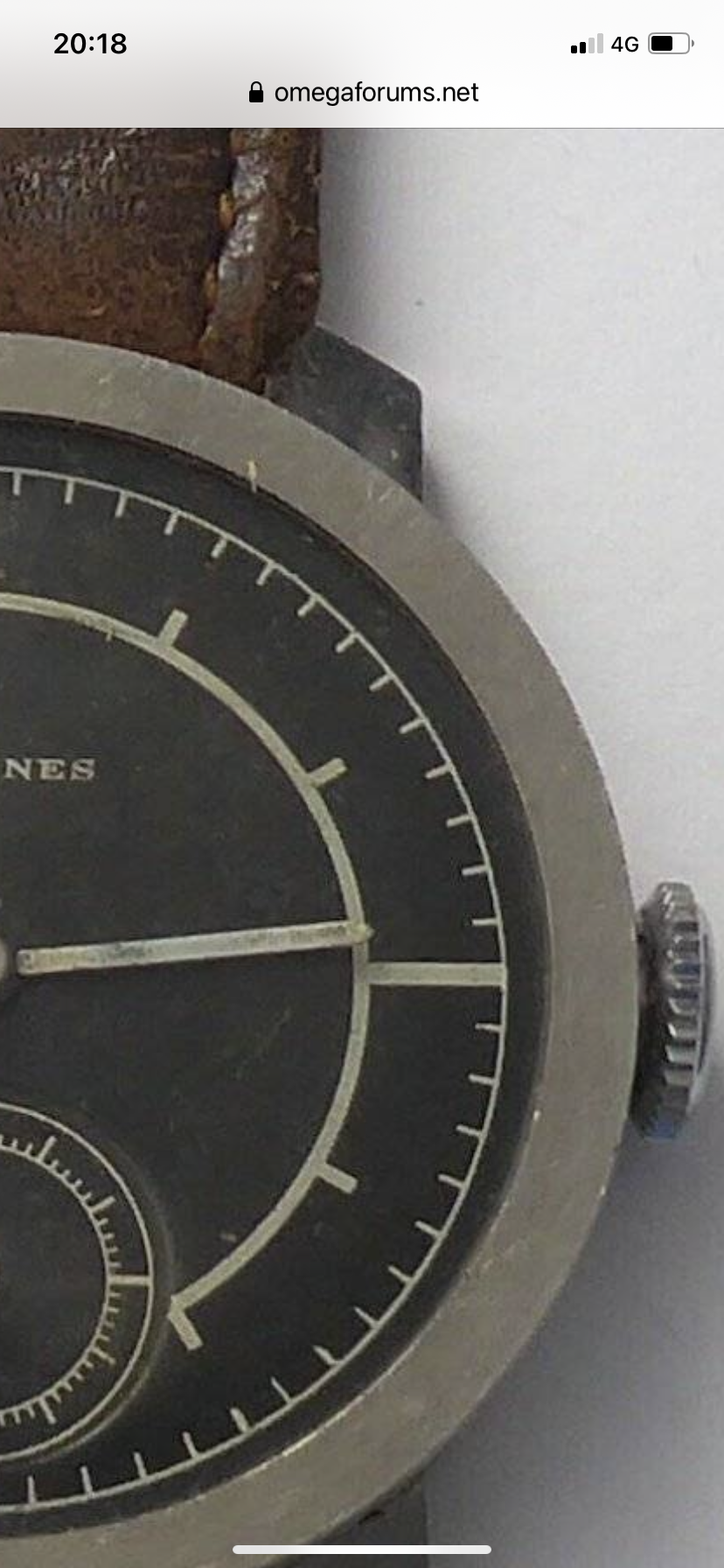

I wonder if this could be due to the angle of the photo and/or distortions from the crystal?
2,971
6,344
Surely it is. We have a photo of the dial without the bezel and all is even. The bezel is tall and there is possible distortion.

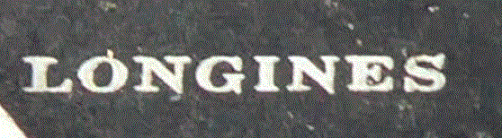

Look at the two letters "N" in LONGINES of the Ebay watch. They are quite different. This might indicate a redial...

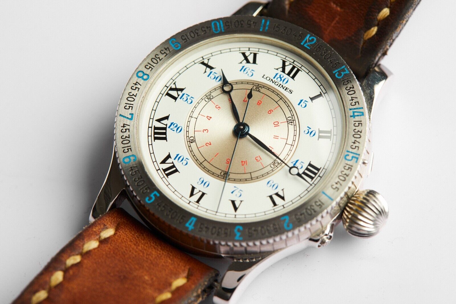

I rarely post Longines watches but this is the 1980’s LE re-edition of the Hour Angle with full set in excellent condition going no reserve and has the wooden Spirit of St Louis and the leather briefcase it comes in too, very cool
https://www.ebay.com/itm/266074677238
6,537
22,296
Very cool. This could make me break my no new watch vow for 2023

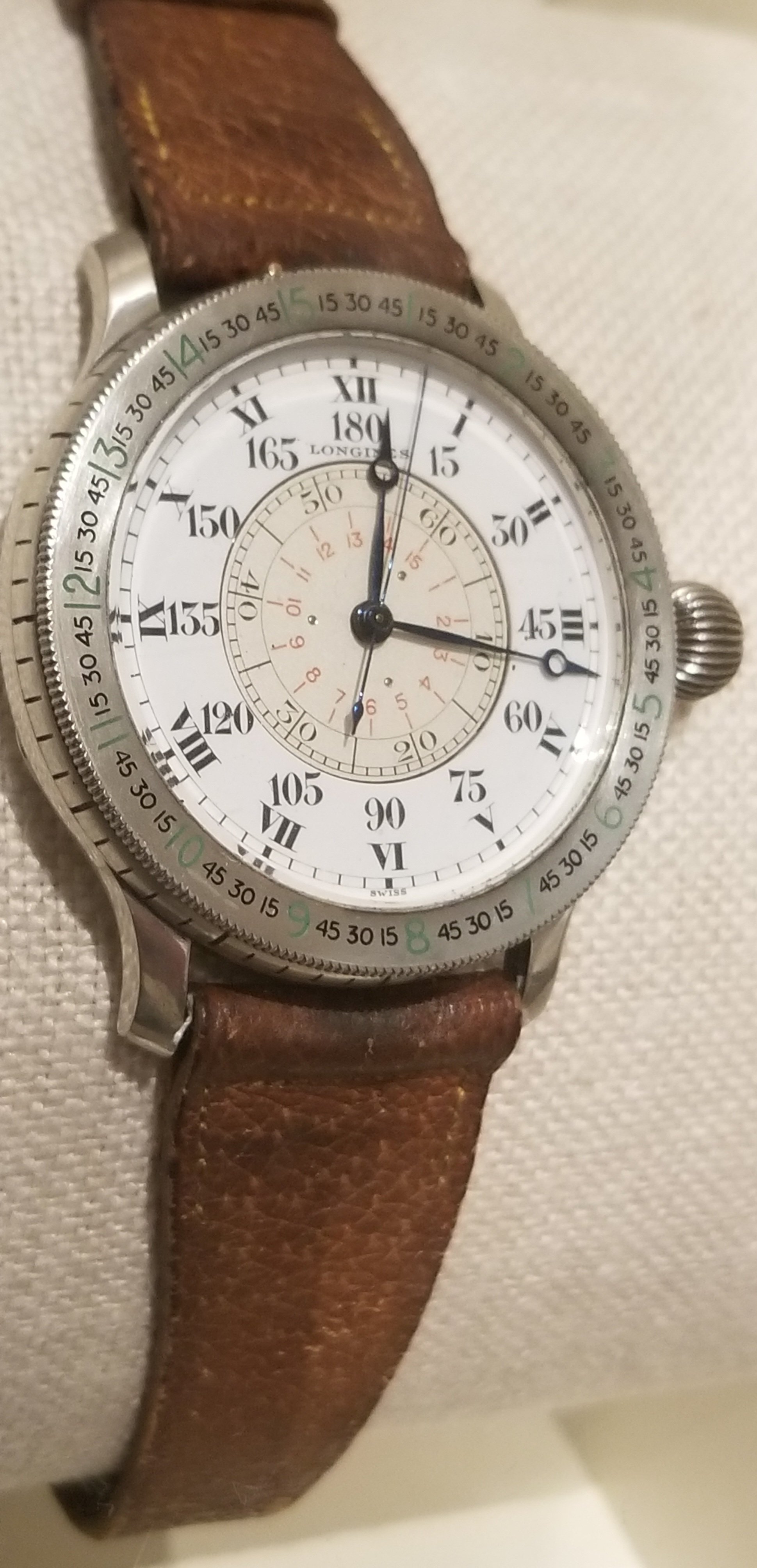

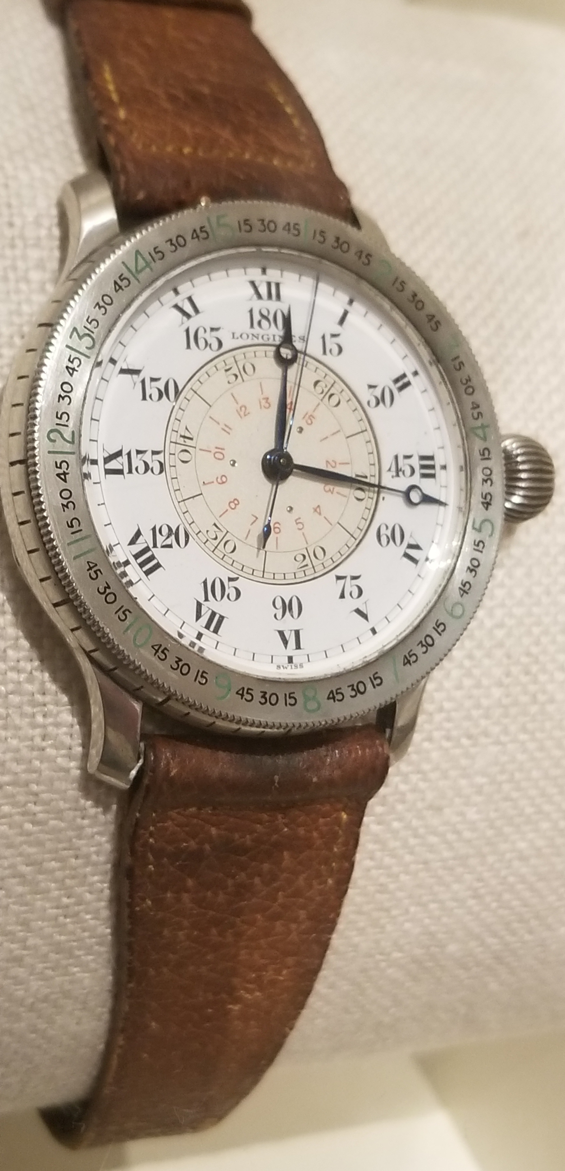

The real one for comparison:
