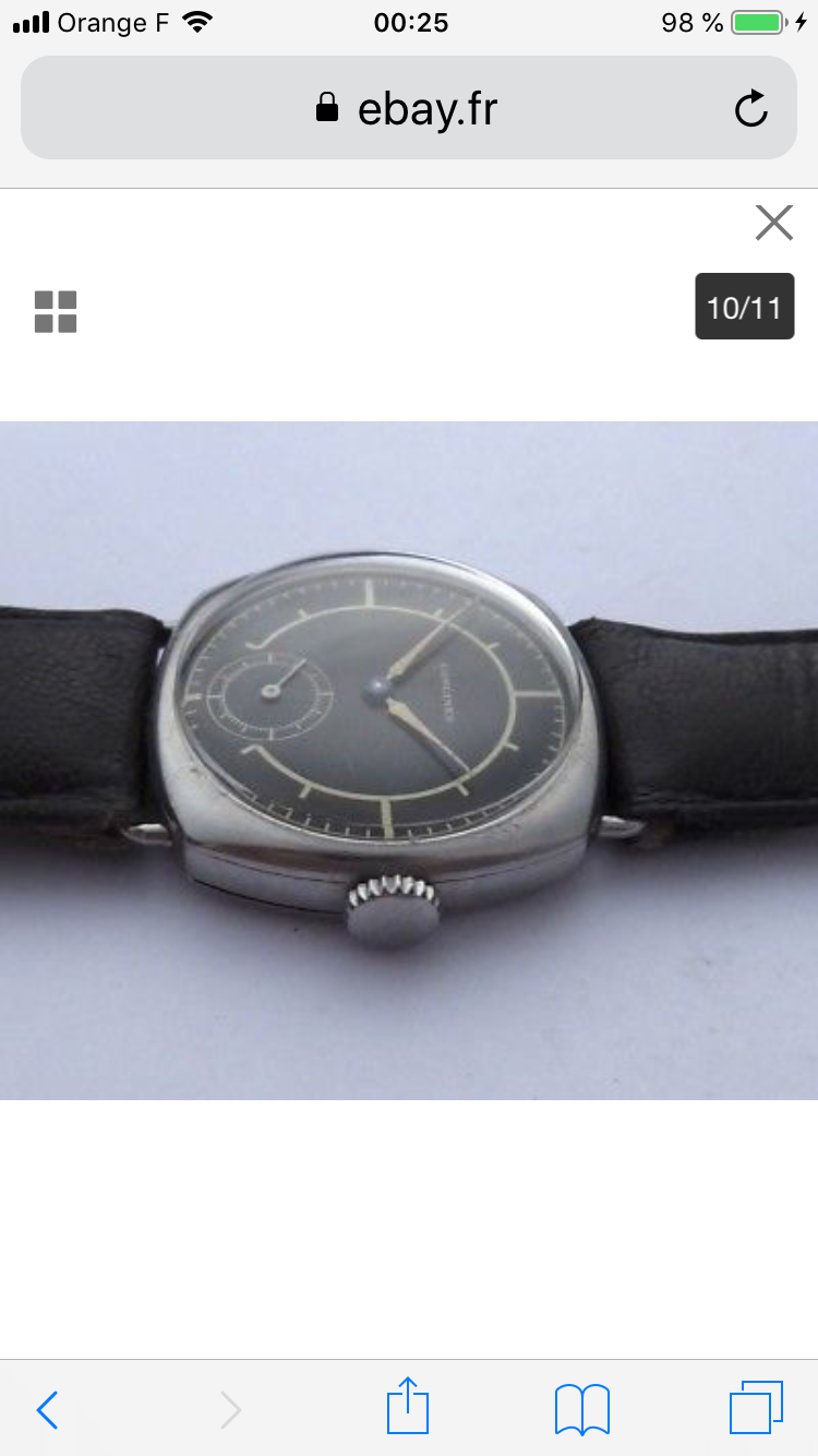

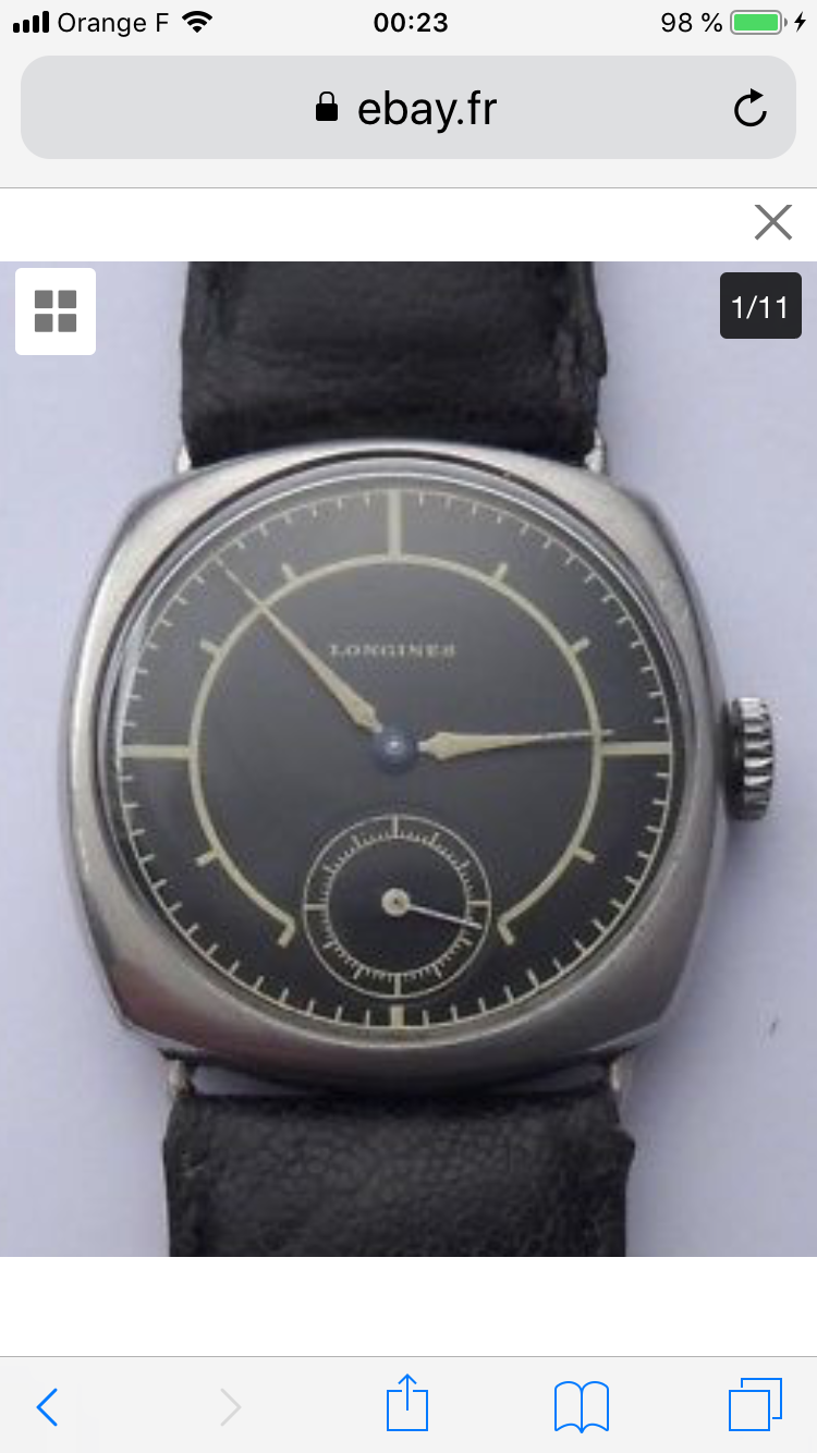

Interesting to see how Longines dials are traveling from watch to watch. Spotted this one on an early 30s watch some months ago... https://www.ebay.com/itm/133002469036
Very interesting did you retain pictures by any chance? This will not be the first example but it’s always more fun to document the various stages for posterity..... I’m curious to see how high the auction will go unless of course it just vanishes.
1,145
5,654
Interesting, do you got pictures of the other watch before it turned in to
a big bux tre tacche?
38
129
Unfortunately I did not. However, I recall it being a cushion shaped 20's / 30's case and movement before it was Frankensteined. Dial looks very nice though. Nifty eBay description by the way. Dial = original. Case = original. Movement = original. But the sum of the parts? ;-)

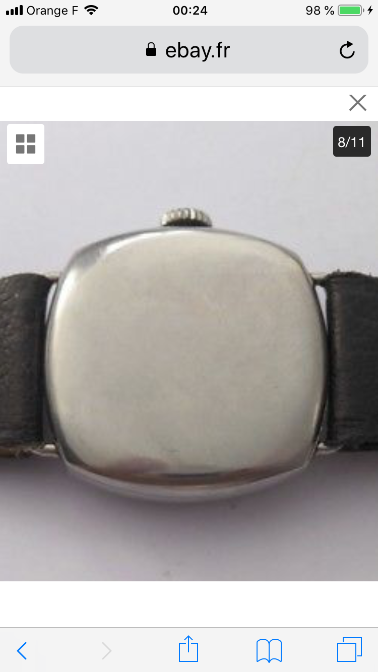

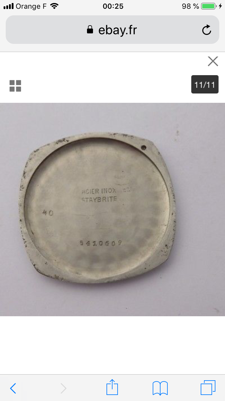

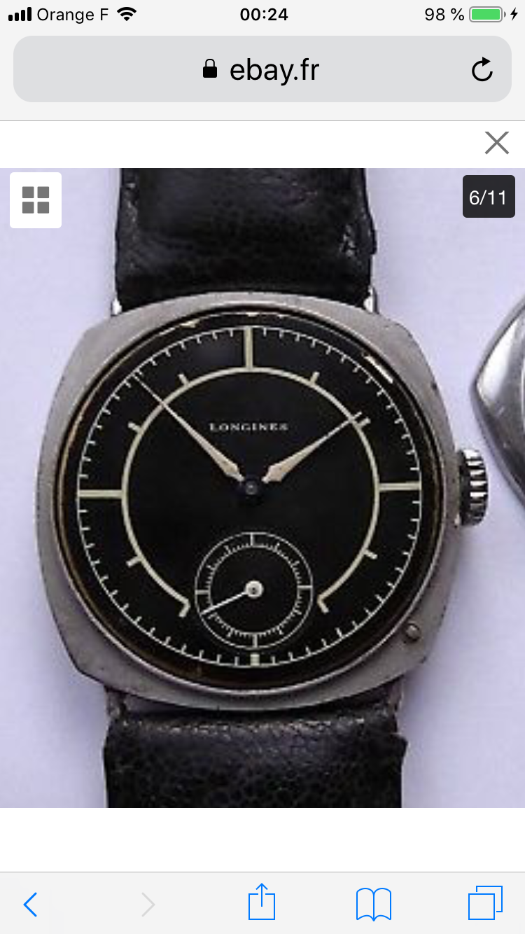

....I recall it being a cushion shaped 20's / 30's case and movement

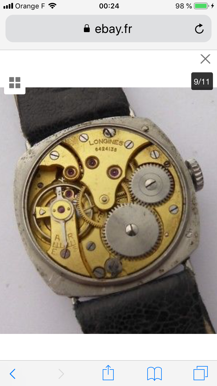

Are you sure it was the same dial? I have found these pictures I had saved in early december - but the dial does not appear to be raised index.
Interestingly that cushion case watch also appears to be frankenized - as the movement serial number does not match the one on the case as it should. While the case serial number is a 1937-ish serial number the movement serial is a 1940s one. And Interestingly also the hands appear very similar.

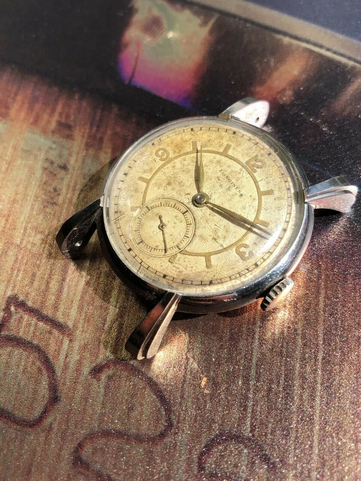

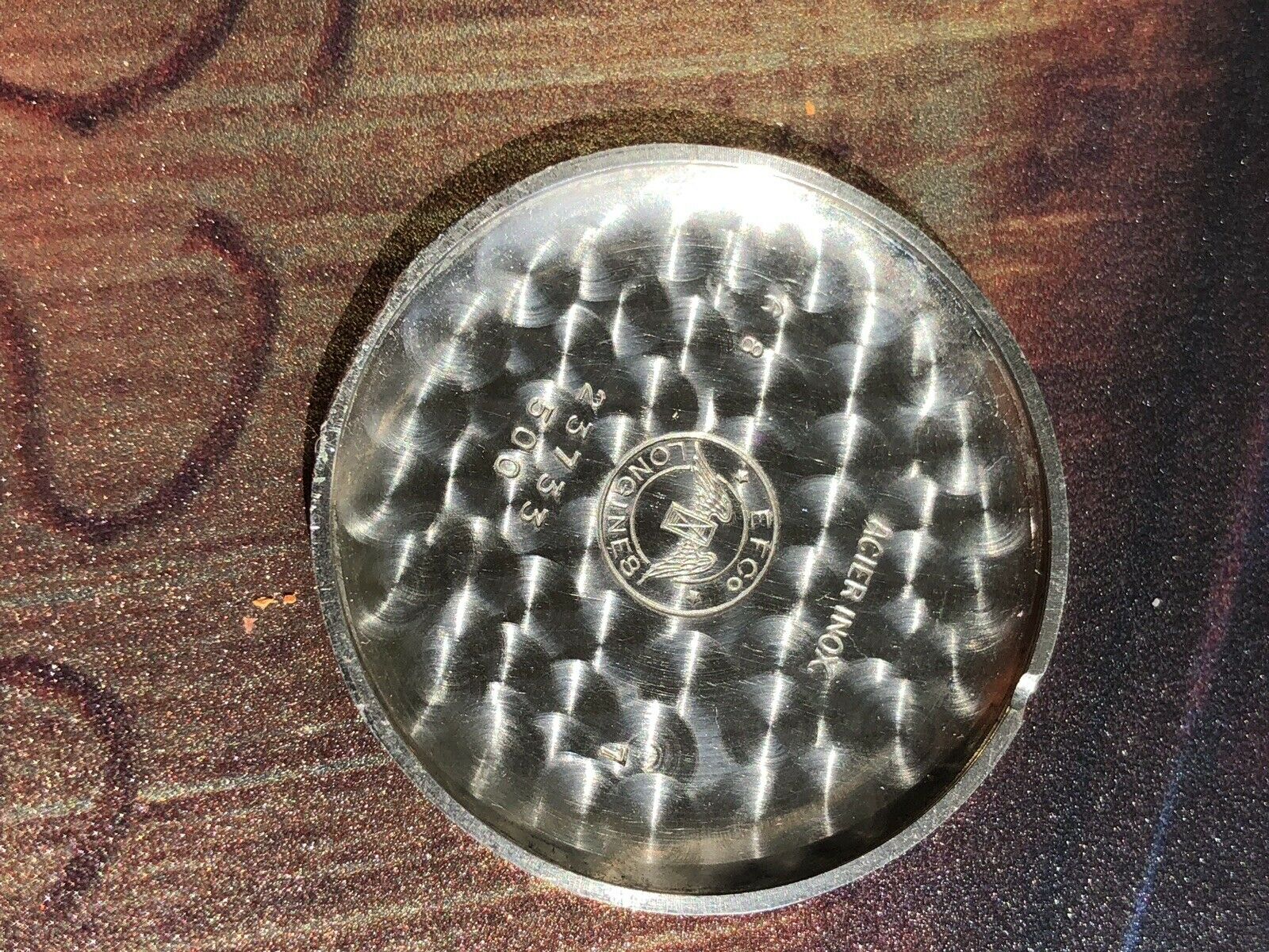

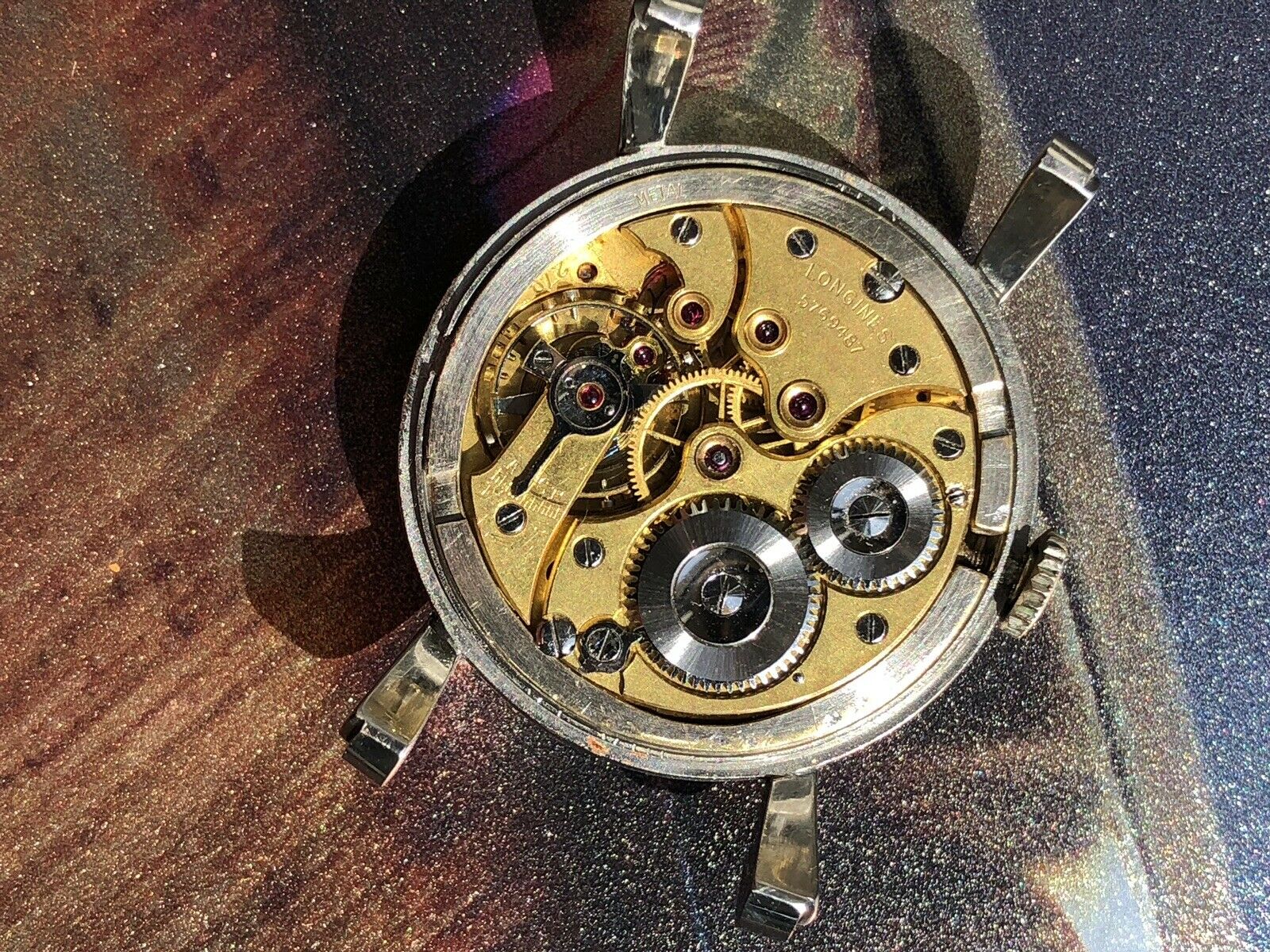

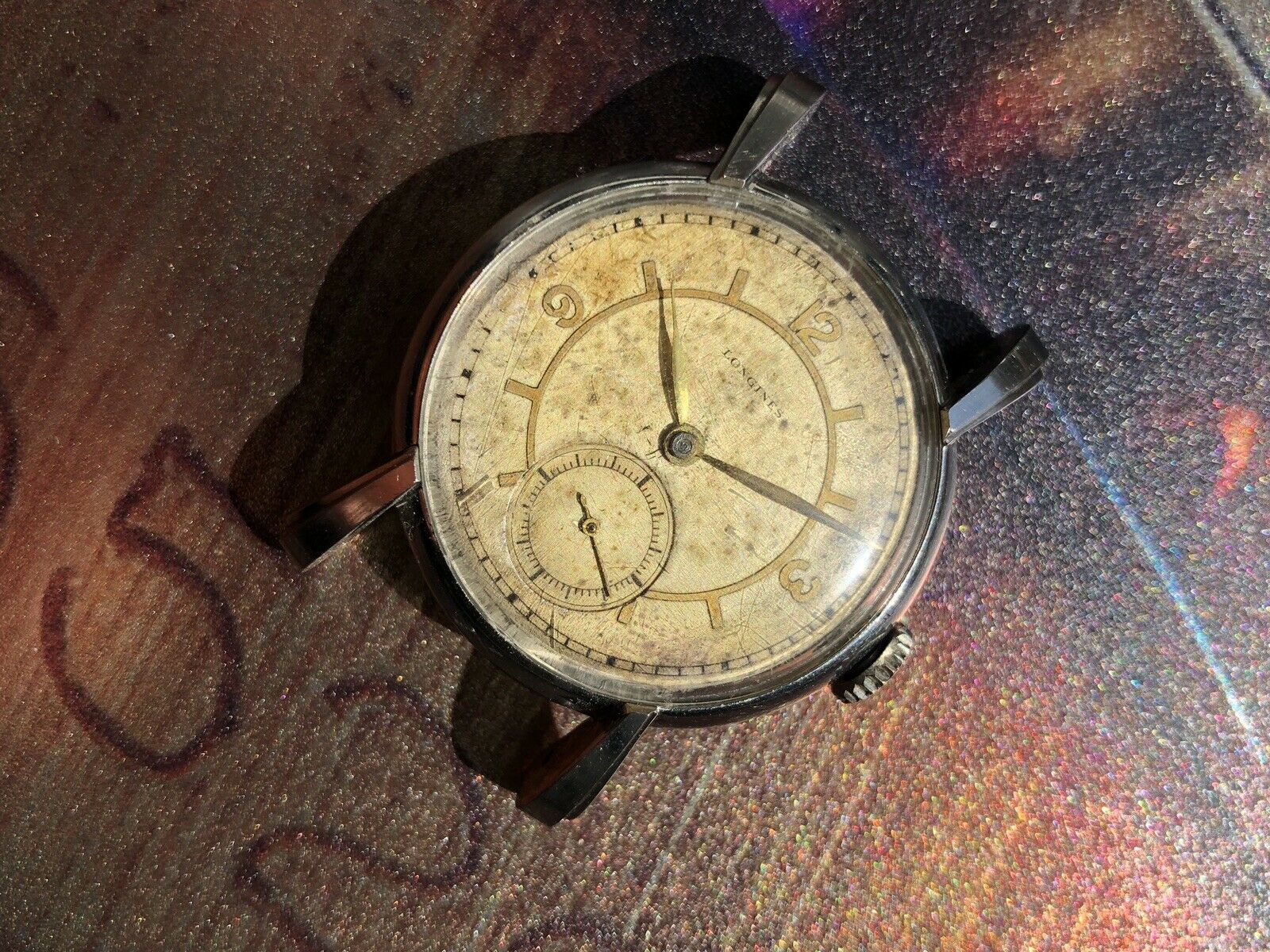

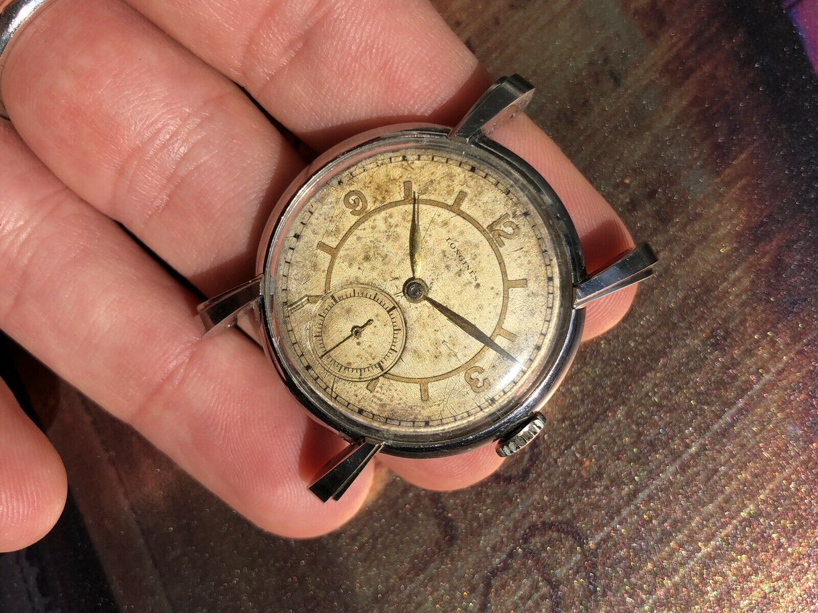

This is my LCPR on eBay. Auction only.
So many questions. Along with the interest shown...Thx by the way. Has been eye opening to ME. Not bothered. But it’s simply worth noting a seller just can’t be expected to reply to each and every query.
Love to my watch fam here, of course. But please. Jump in post your own due diligence/review of posted pics. It’s an honestly described watch. Nothing held back.
This one works at a time parts are harder to source for Cal 294.

Firstly, this thread is not for inquiries. Secondly, dial and movement are lovely but in the wrong case. Movement is from late 1930s and case is from mid-late 1940s.
You are probably right but knowing the production logics of that period, I would not be surprised by a gap of some years.
