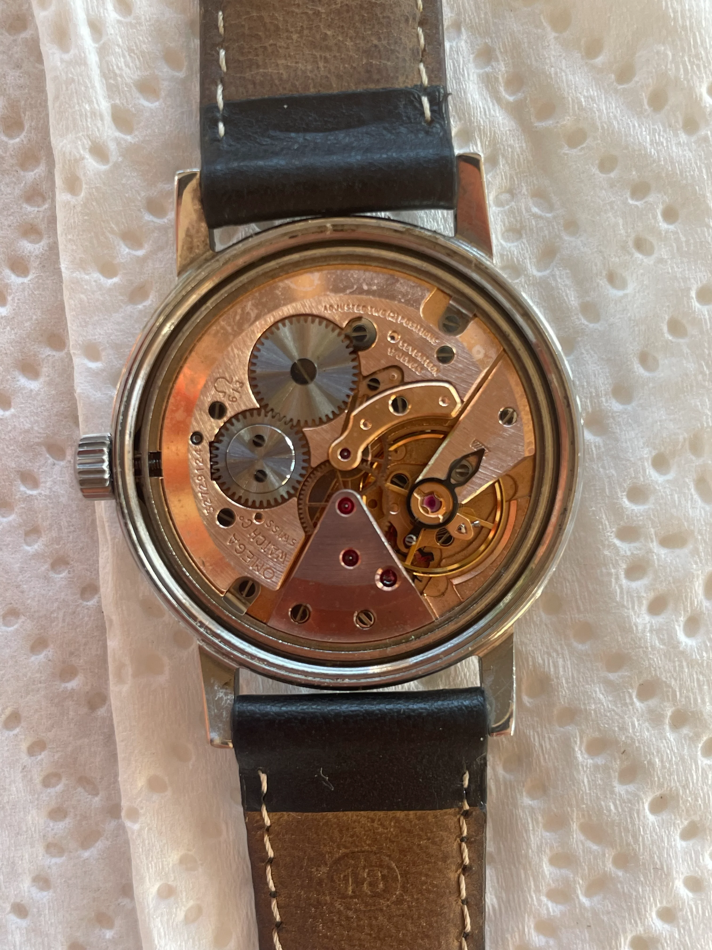

Whattttt!! It is totally crap. Look at the movement. Some baby has scratch Omega name on it. Sorry that I did not see this post before

I can't see anything wrong with the movement. Care to explain your concerns?

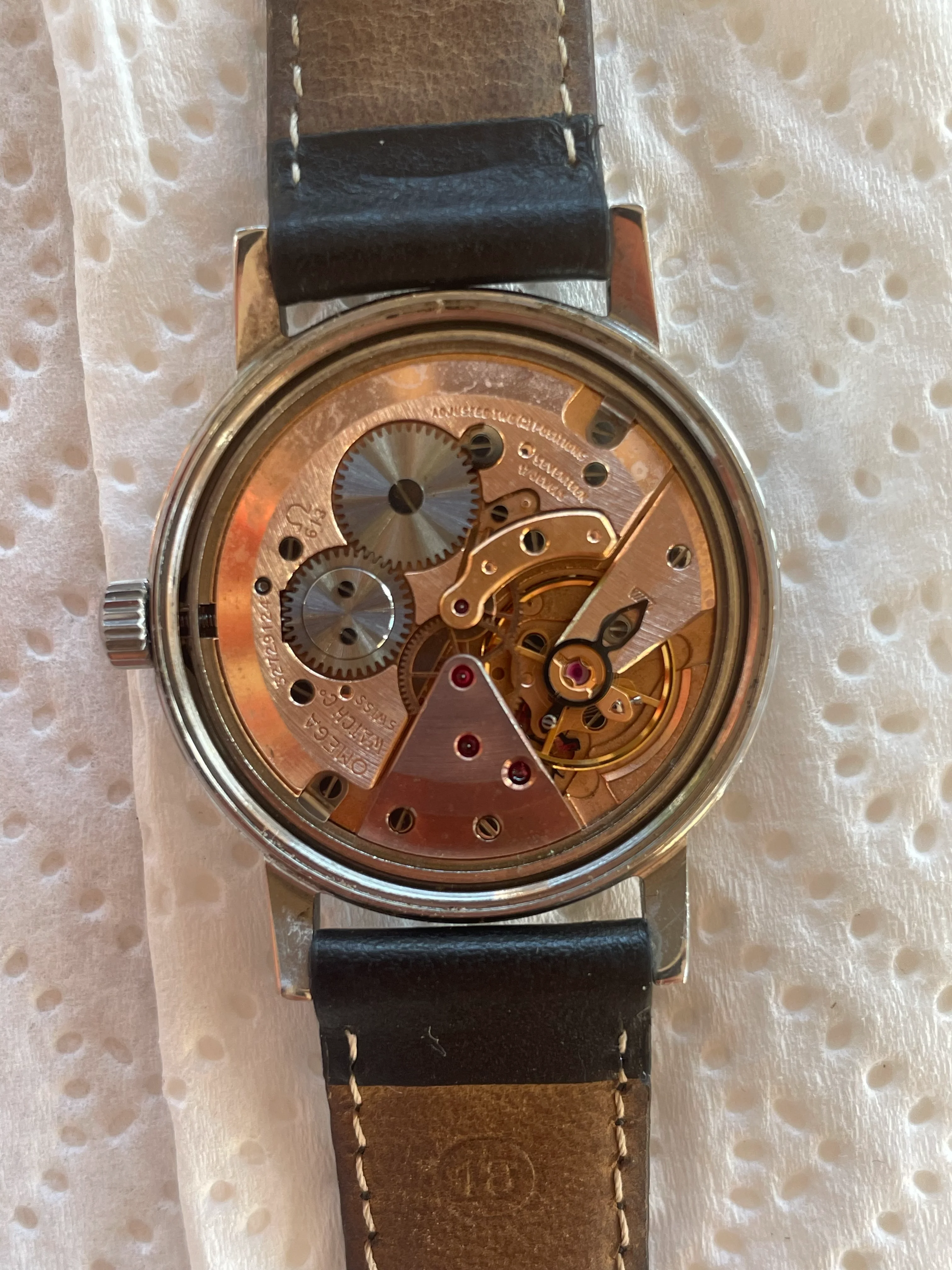

well. Let’s compare the 613 movement that you said “no problem” with a photo I collect online. Do you really think that an omega movement should has script like that
1. Movement tou said that is “ok” @JimInOz
2. Photo of omega movement 613 I collect online

Those scripts can’t even stay straight and in-line with each other. Look at the pointed “A” in OMEGA and WATCH; compare with the more flat “A” in other photo. And well, I think they were engraved by hand by someone. Agreed!?

The seller's photos are heavily edited so that may account for the bad picture. I would like to see the OPs movement in a decent photo when they get it.
The markings on a movement are done by an automatic pantograph engraving machine. Sometimes a stylus may become worn or loose in a collet and produce less that satisfactory markings, but I can't see any evidence of frehand engraving.
Sometimes these lesss than satisfactory examples slip through the QA net, but not too often.
Haha very funny. So please could you explain why the serial number in this photo still looking good and the gear, the teeth and everythings else of the movement are not deformed. Only the scripts are looks so so bad.

well you’re right. I did make two wrong advices in recent days but I admited them when others pointed them out. If you insist the caliber 613 left the Omega factory like that then I have nothing more to discuss btw :-/

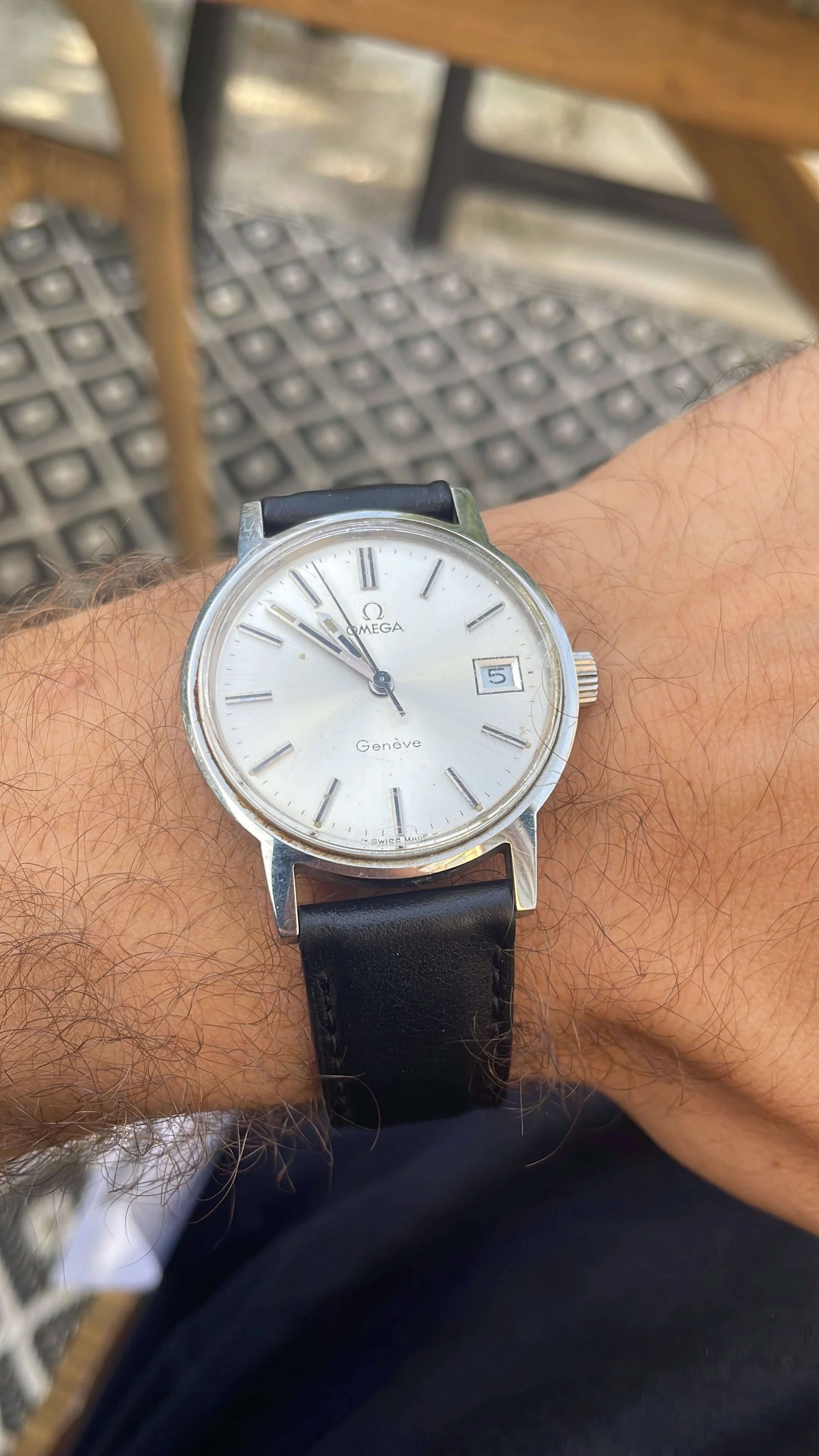

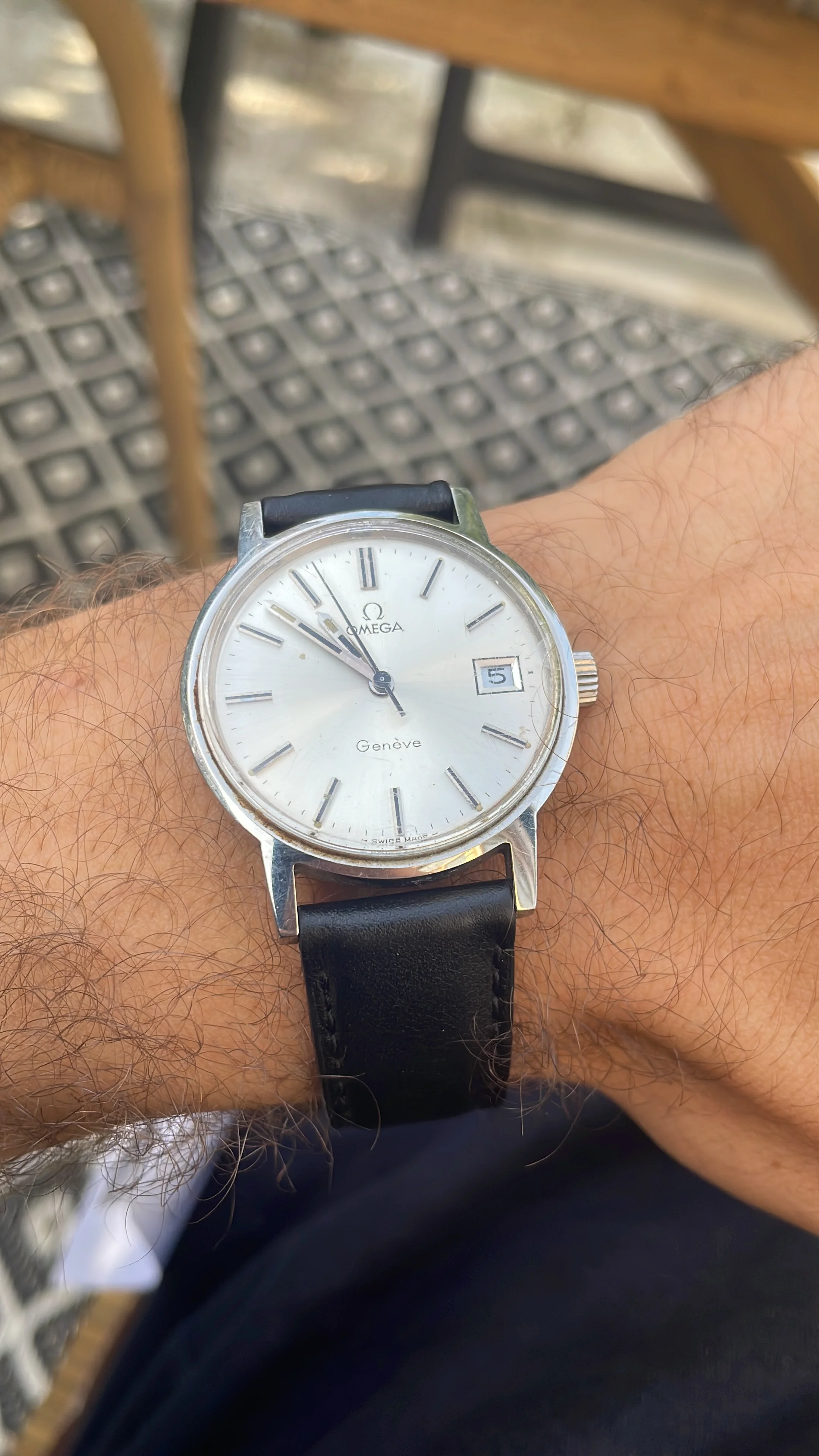

Hi. Here are the photos I took. Would you say it's not worth keeping and servicing, considering I paid almost 400€? Is it overpriced, as it's been stated? There's also a video that shows how the mechanism stops. Thanks!
What are your concerns exactly? I don't think anyone in this thread made any plausible points that would lead you to return it. Paying for a service is another question altogether. That's a sizable expense for a watch like this, and maybe you should live with it for a few months before deciding.
The second clock hand is not working. As you can see in the video, it stops after a few seconds. Briefly, the mechanism doesn´t work.
