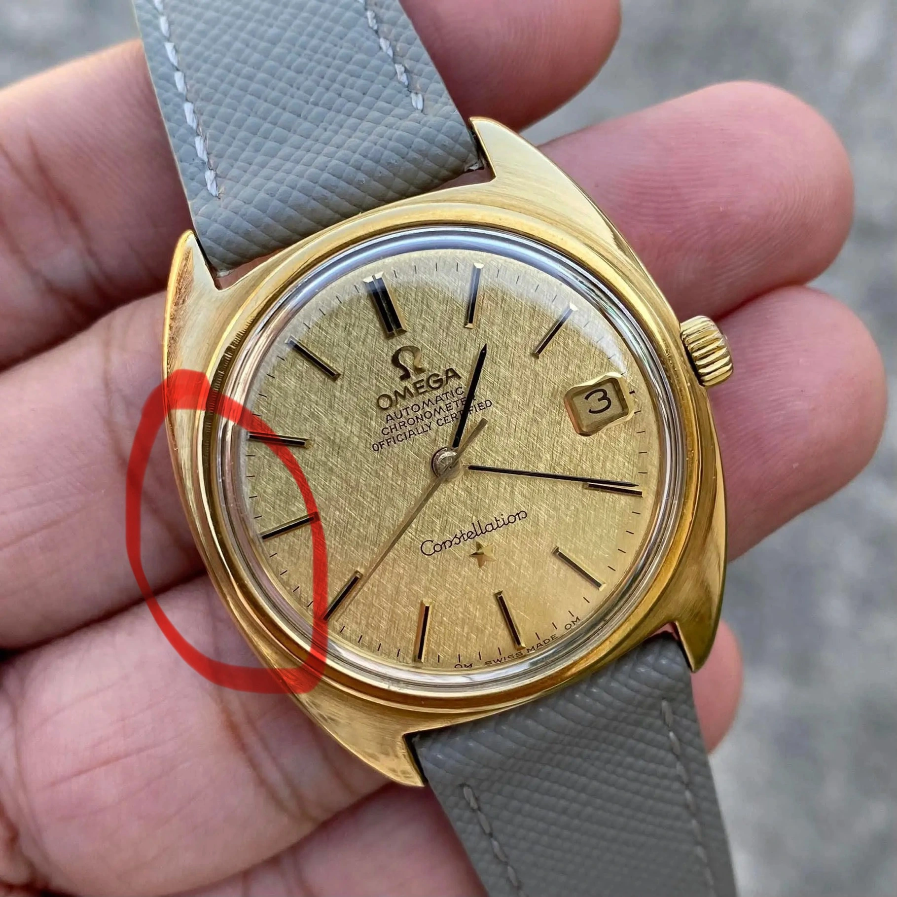

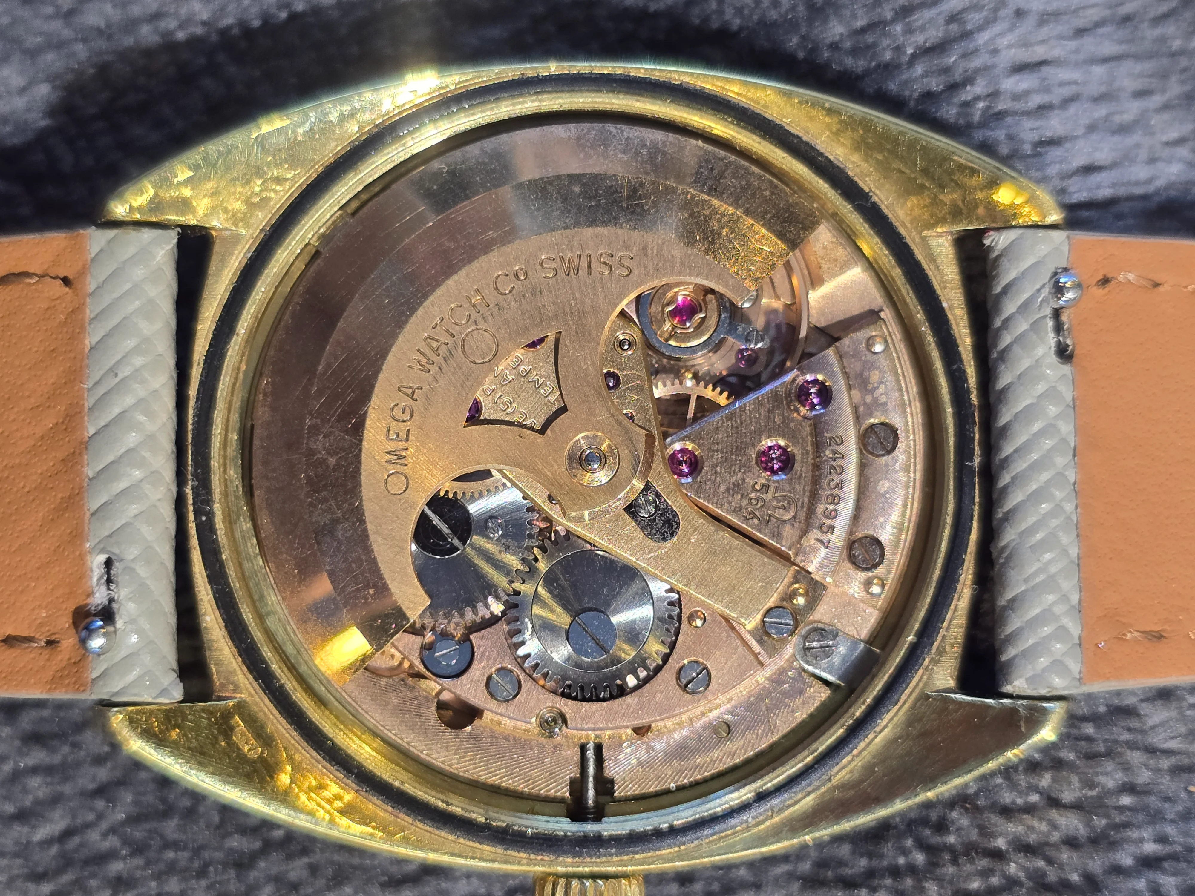

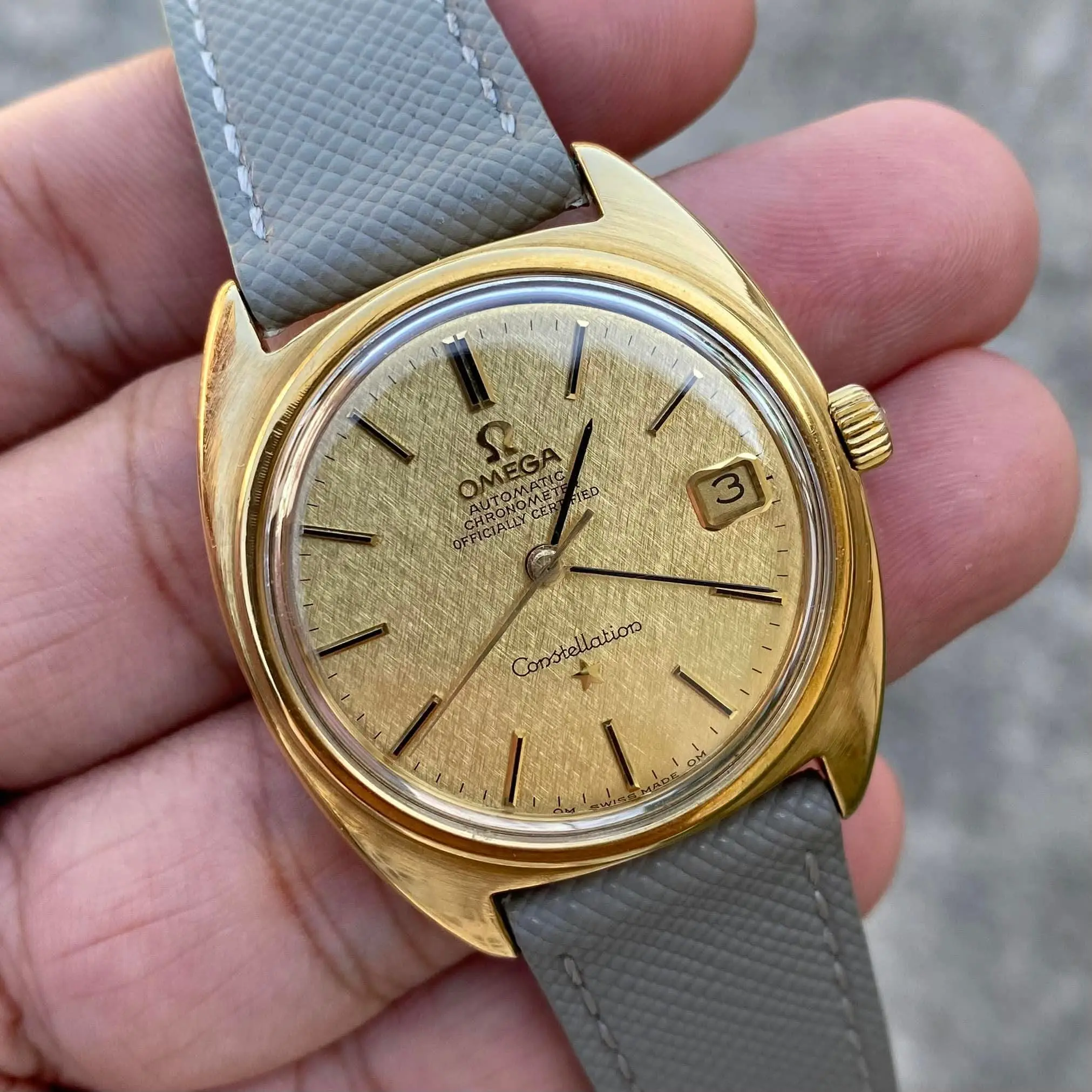

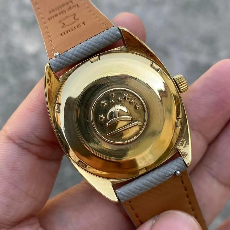

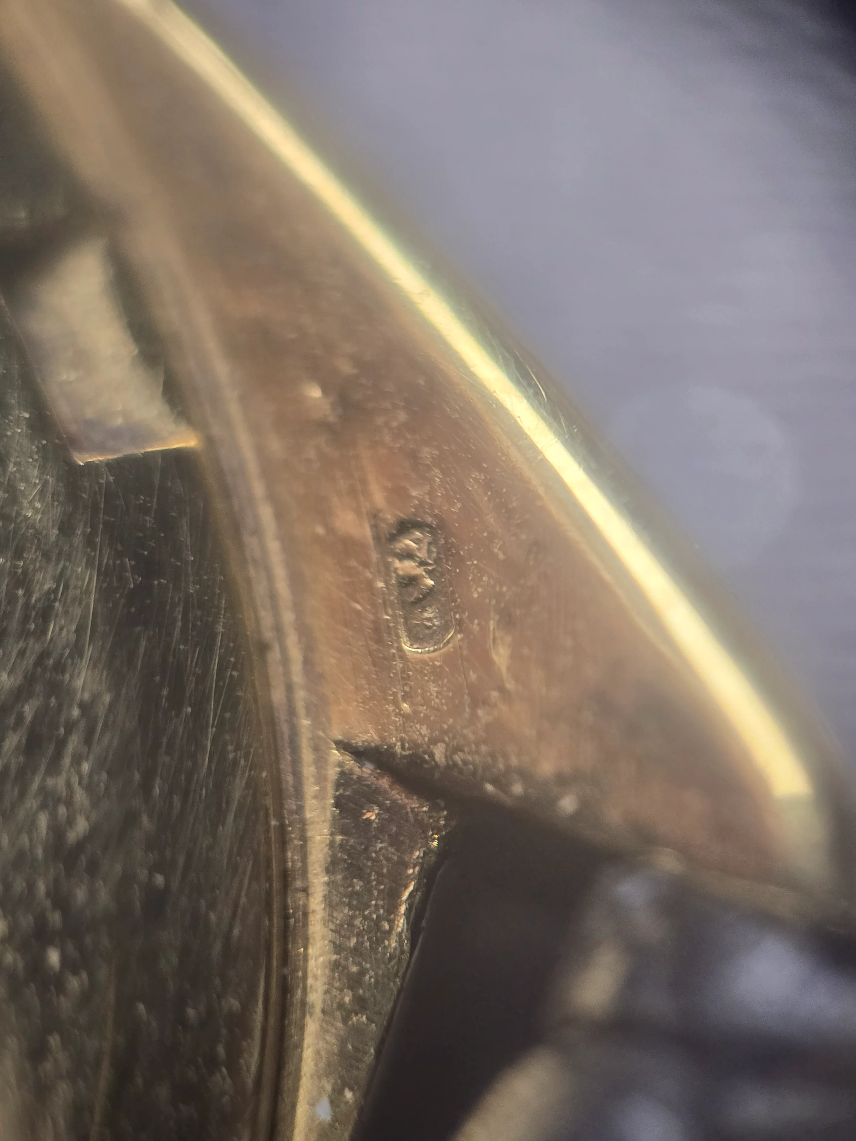

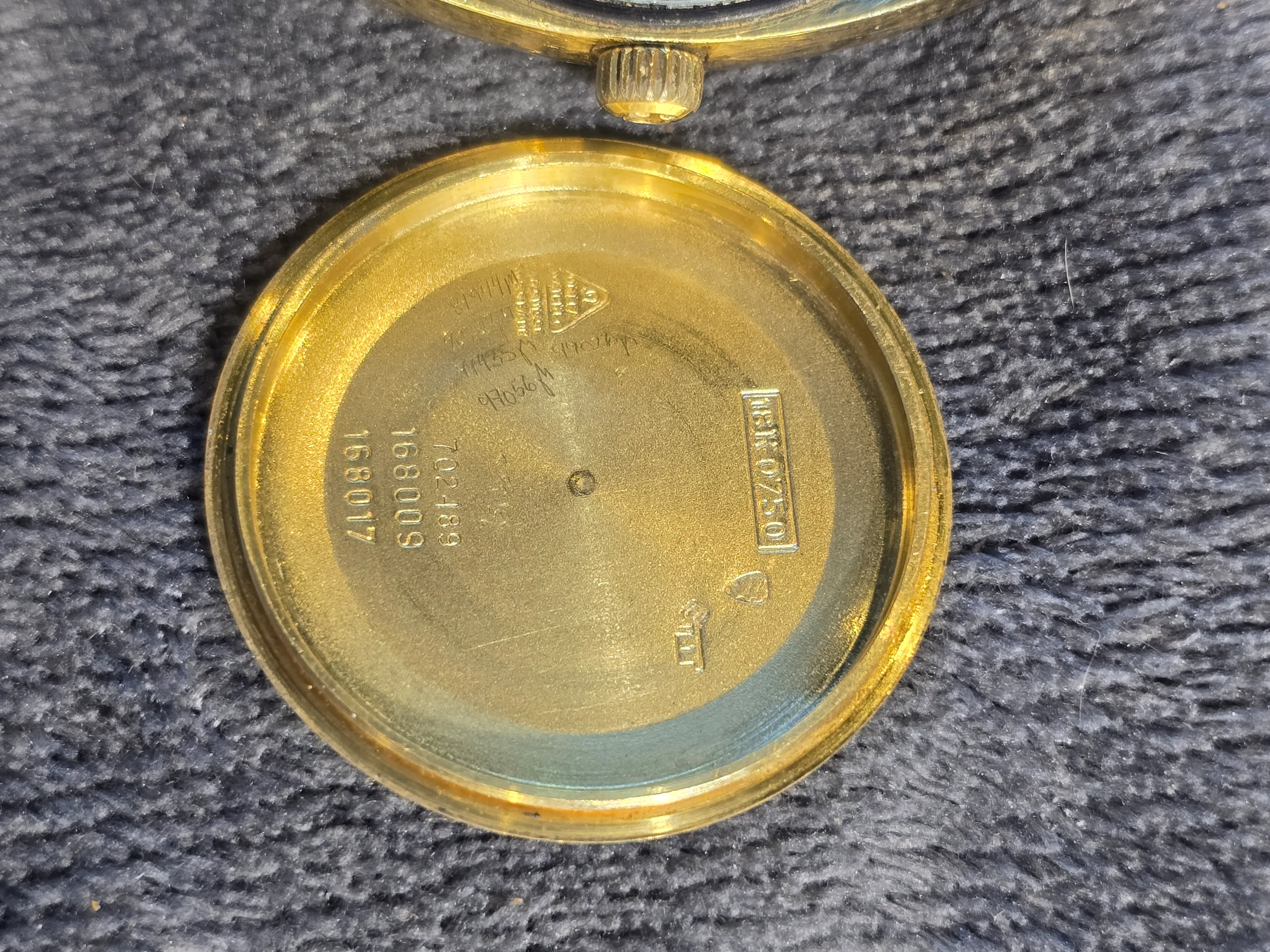

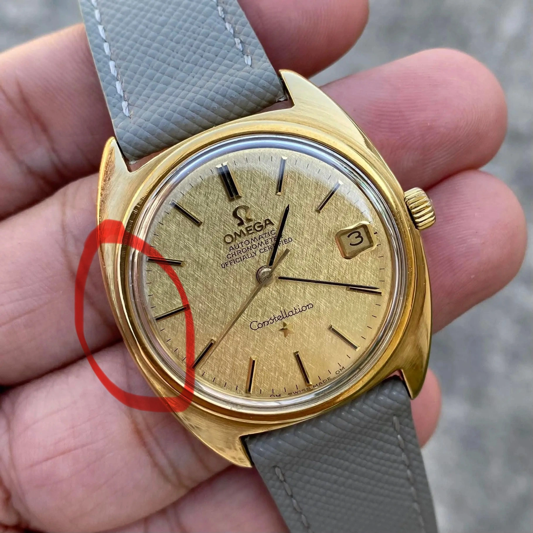

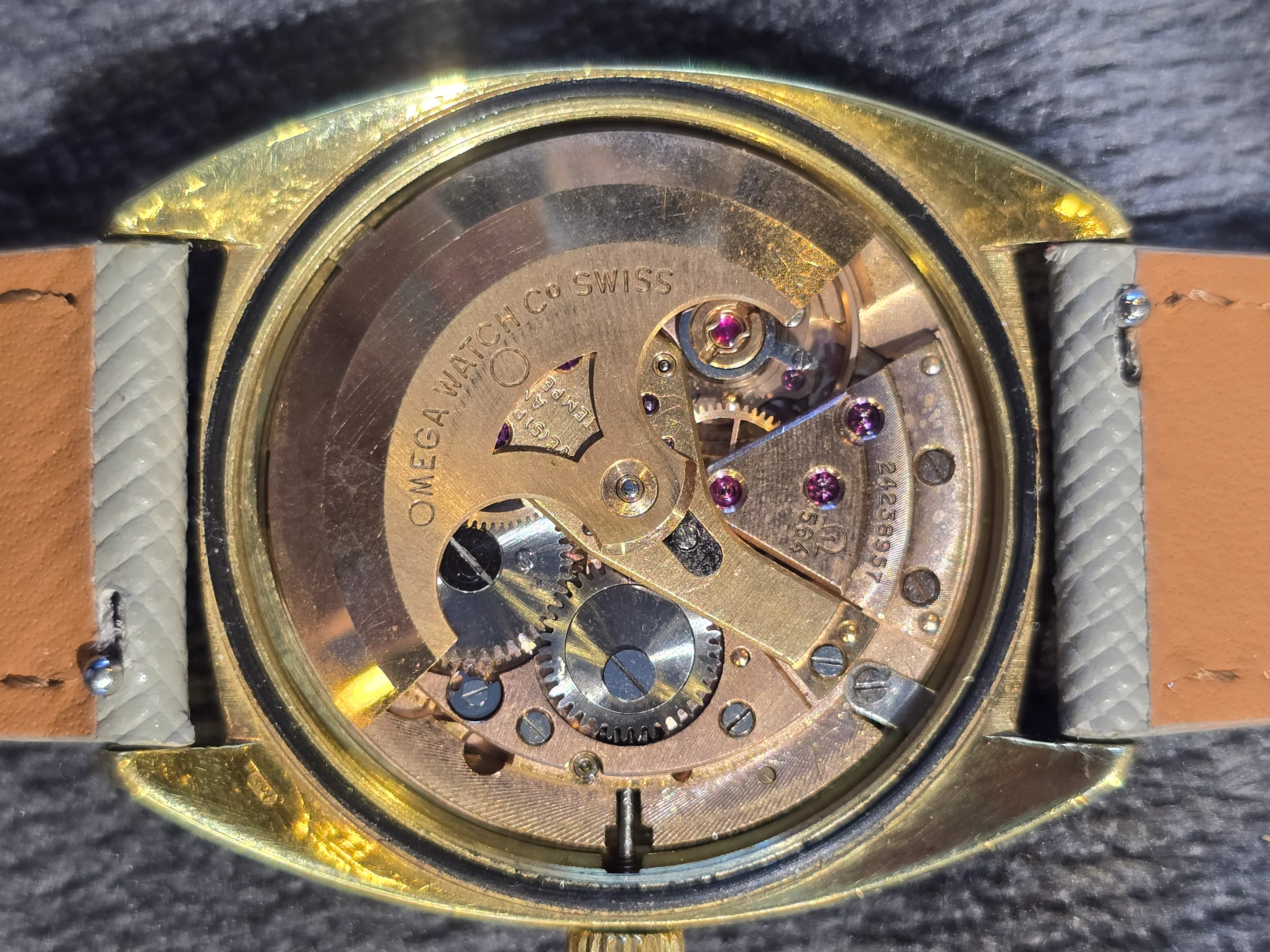

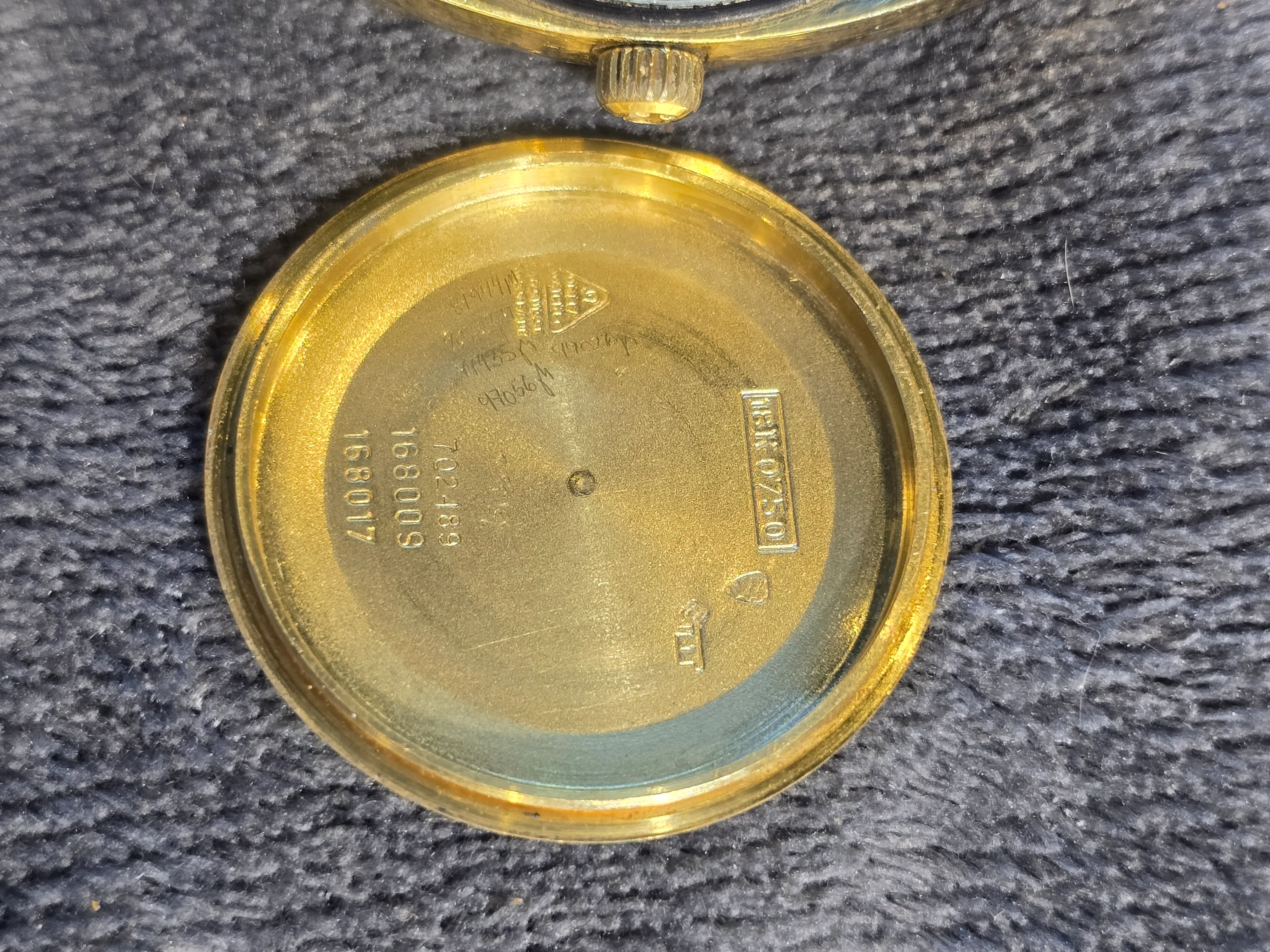

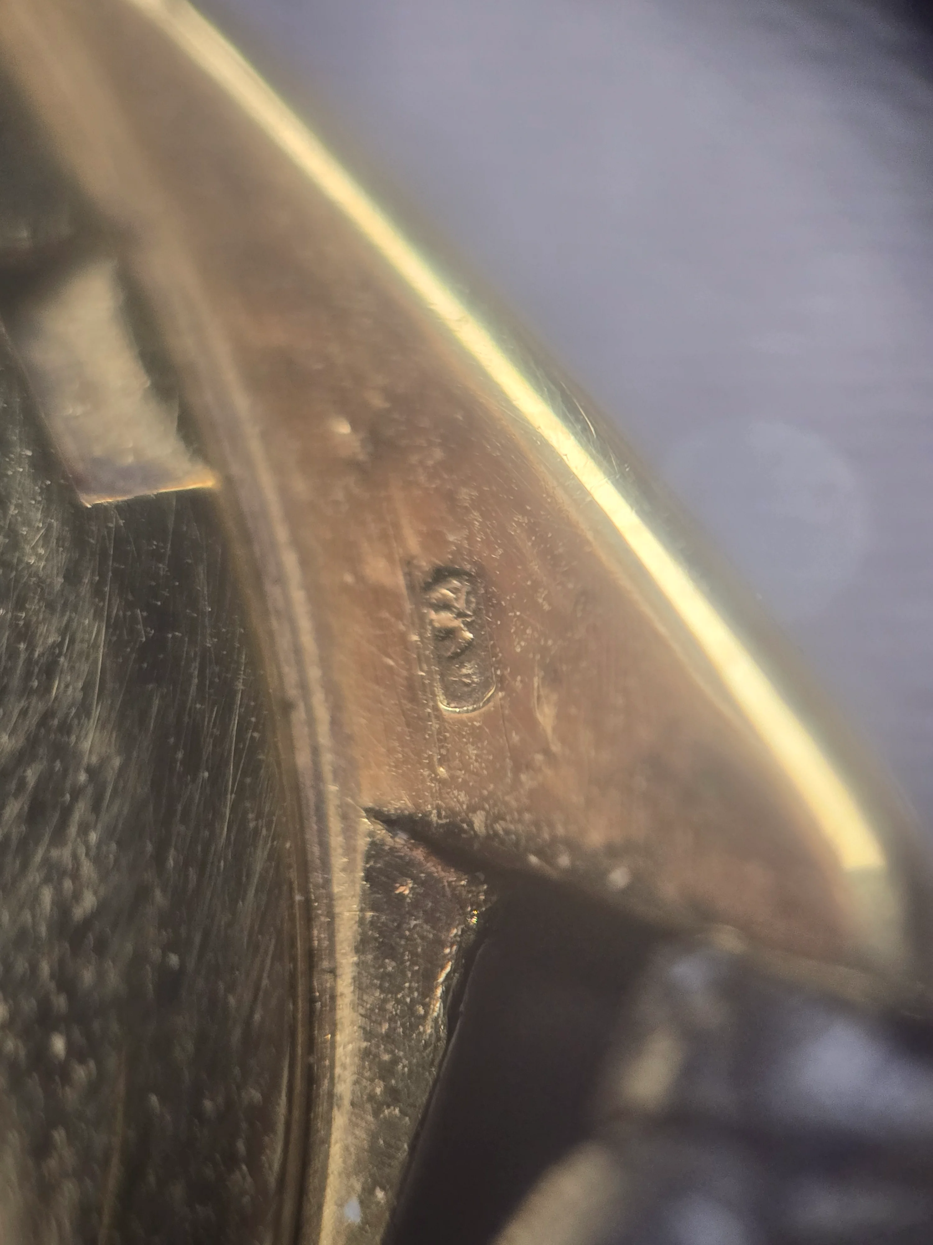

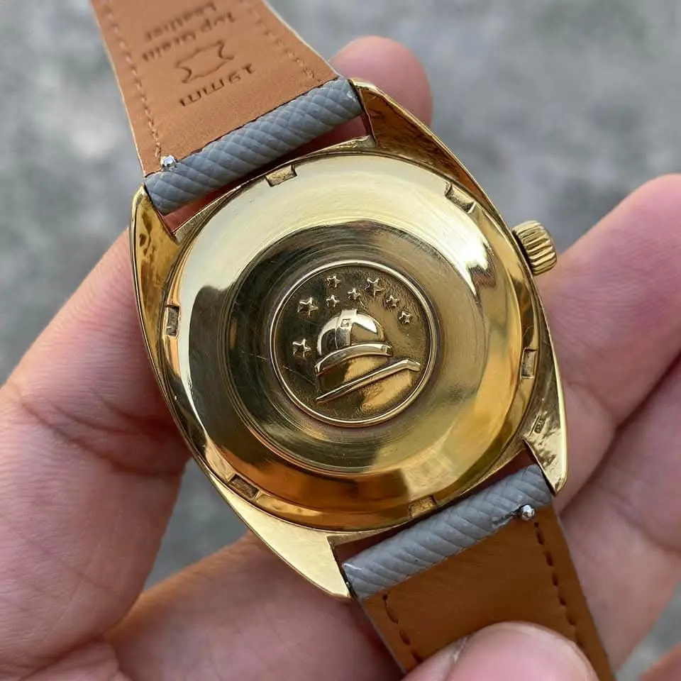

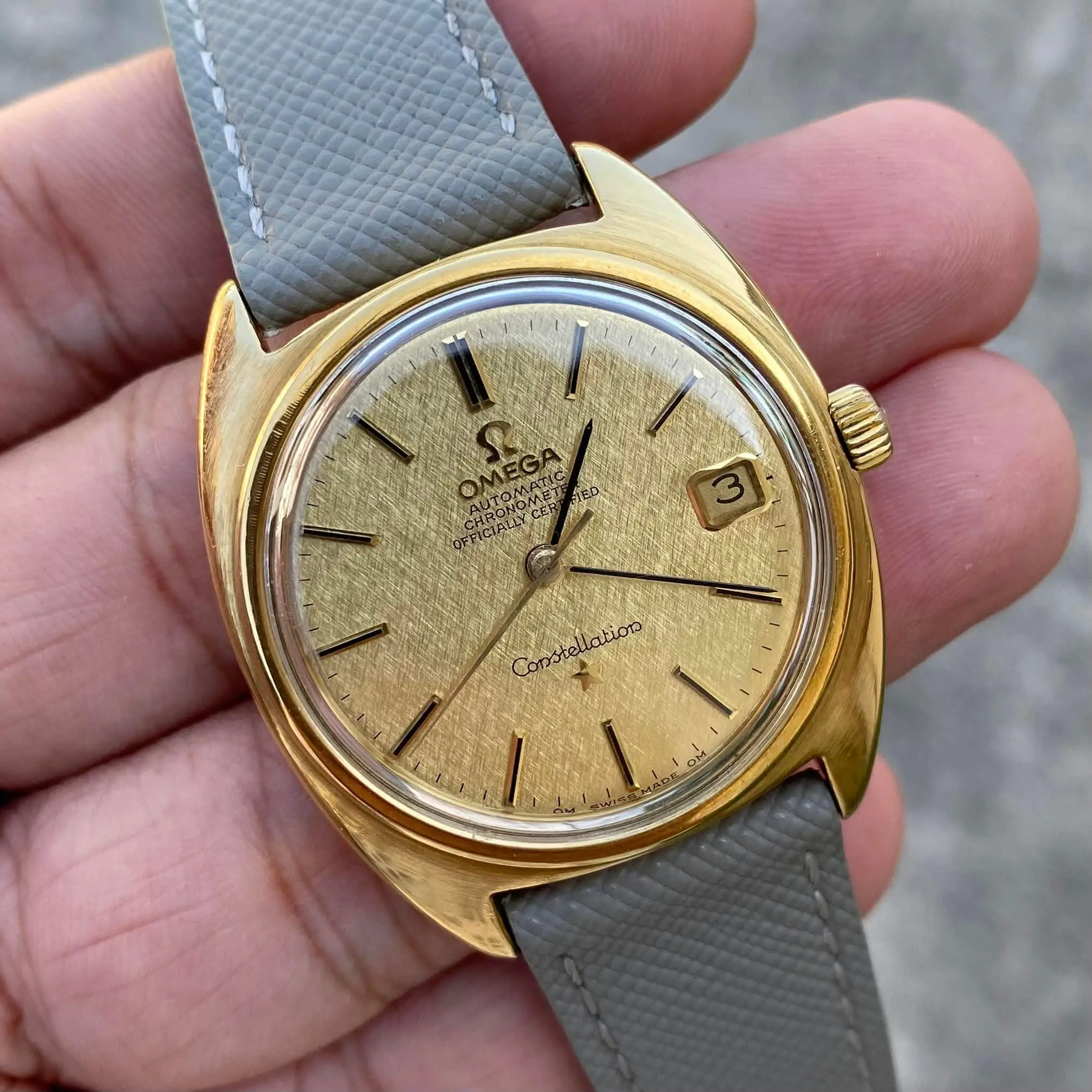

Hi guys I just bought a vintage omega constellation 18k solid gold with the dial that have "om" on it, want you guys help to identify if this is a legit watch with all original part. I will attached all the photo as much as I can.
Thank you in advance

OM indicates a solid gold dial.
Case was made for Omega by Ed. Wenger SA of Geneva.
I can't see any problems with the watch other than the colour of the strap.
馃槈
Thanks so much, I totally agree with the strap color, currently i'm looking into a new one as this is the old owner strap. Any suggestion on color?馃檹馃徏馃ズ

IMO the case has been polished and seems like the left edge of the case is not straight.

I would suggest a black strap which will go with the indices and paint in the centre of the hands

Has the fluting been polished off of the bezel?
Not all of it, there's still a remnant between 10 and 11.

Legit but polished like others mentioned and while its not a rule this model usually came with thicker baton hands - and no, I personally haven't seen a replica C-Case yet, only some models have half replicas
