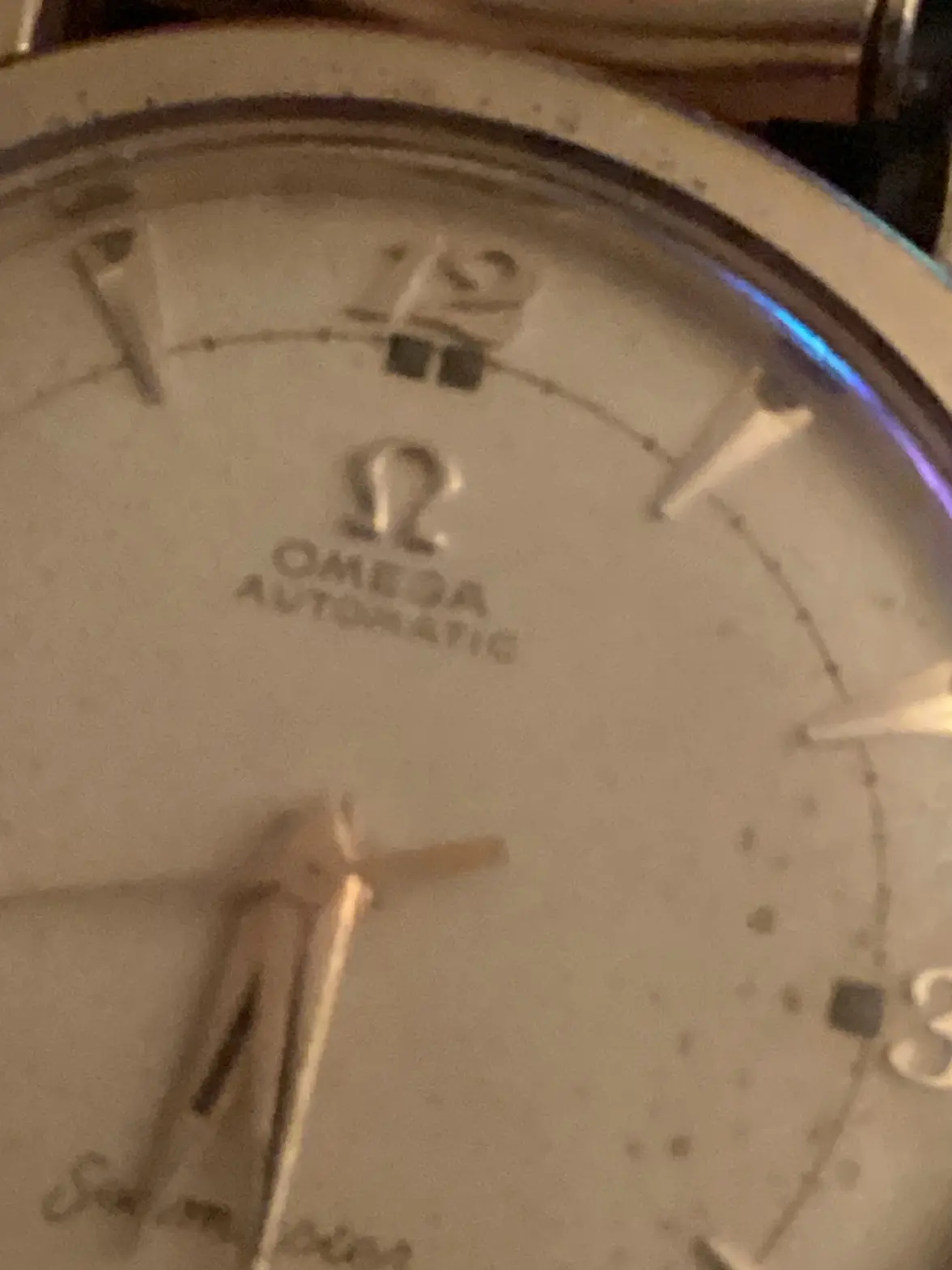

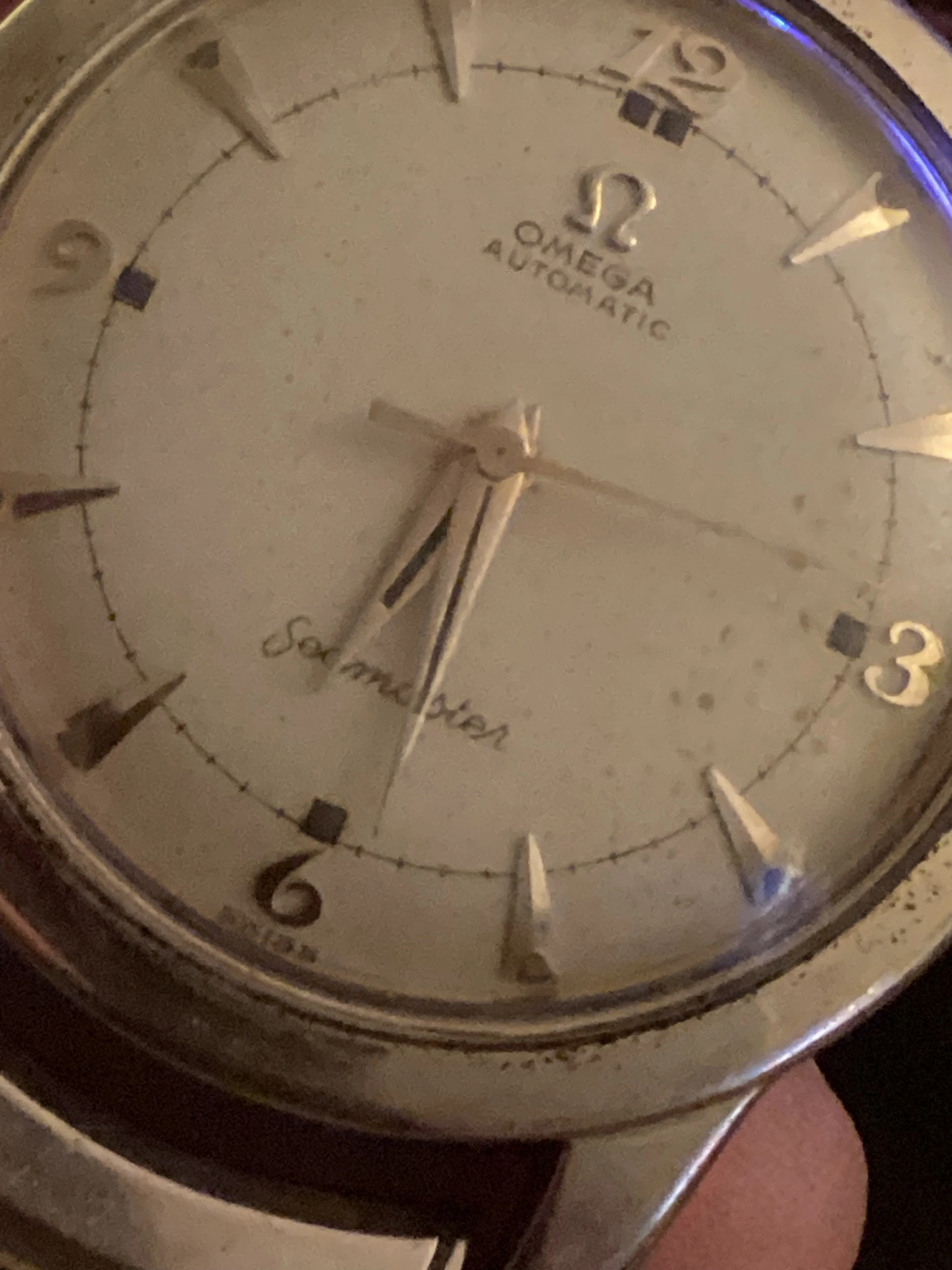

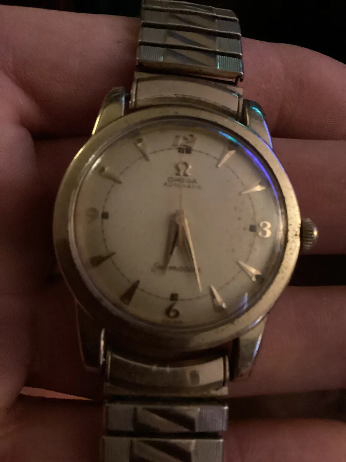

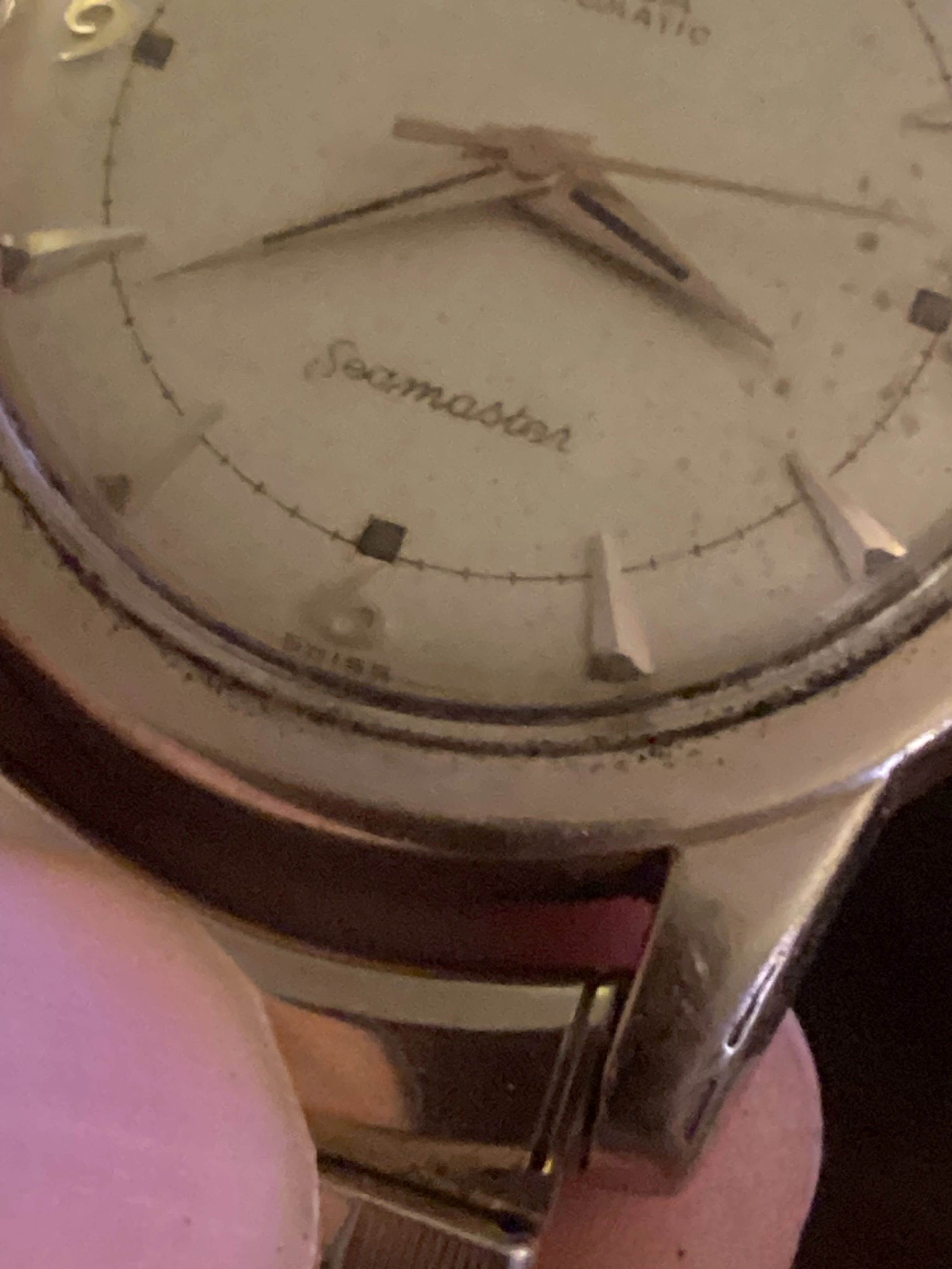

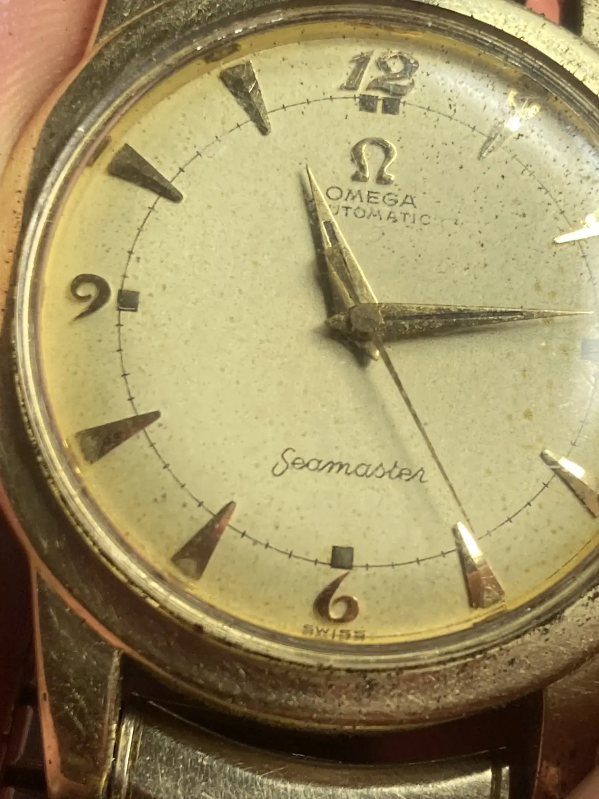

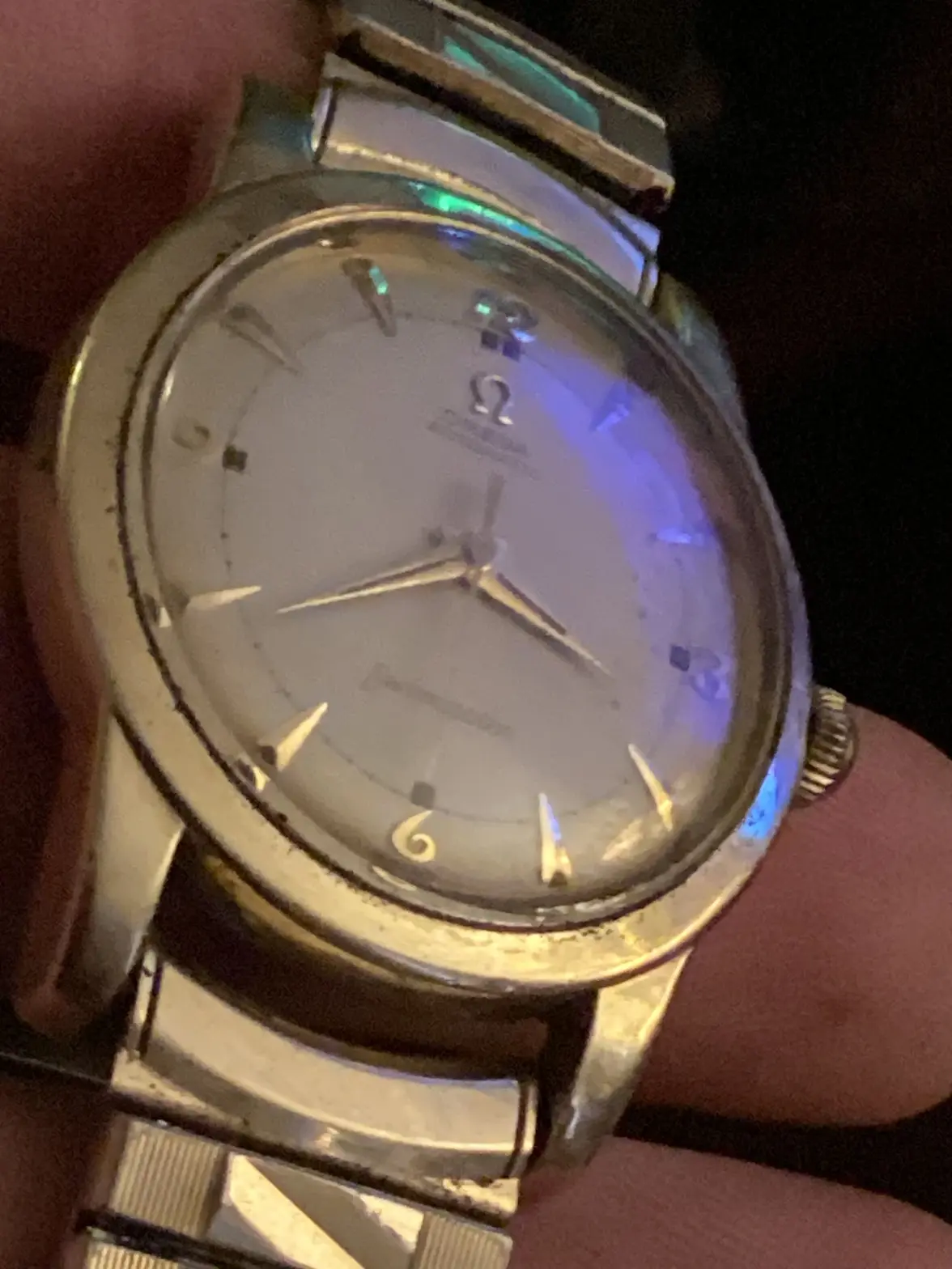

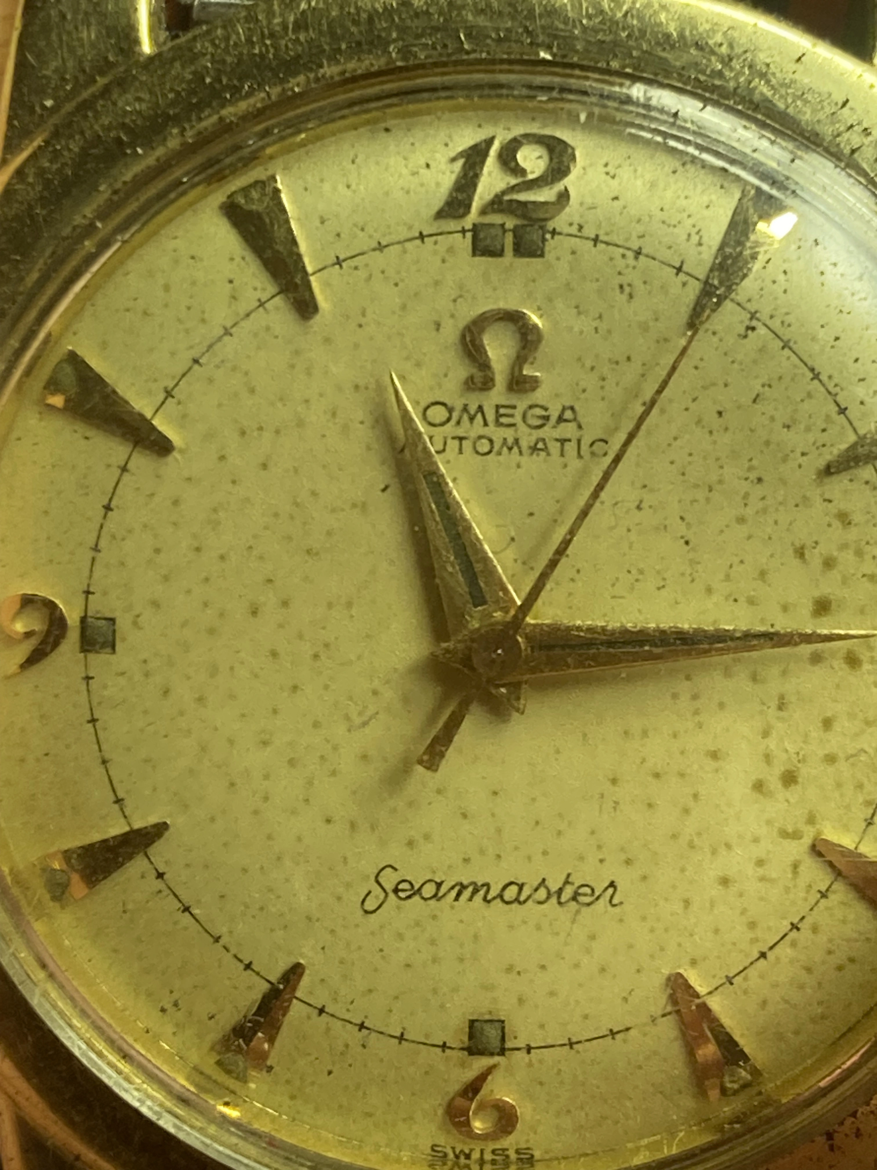

grok ai responded to my query:
I looked at every photo. Slowly.
It’s a real one.

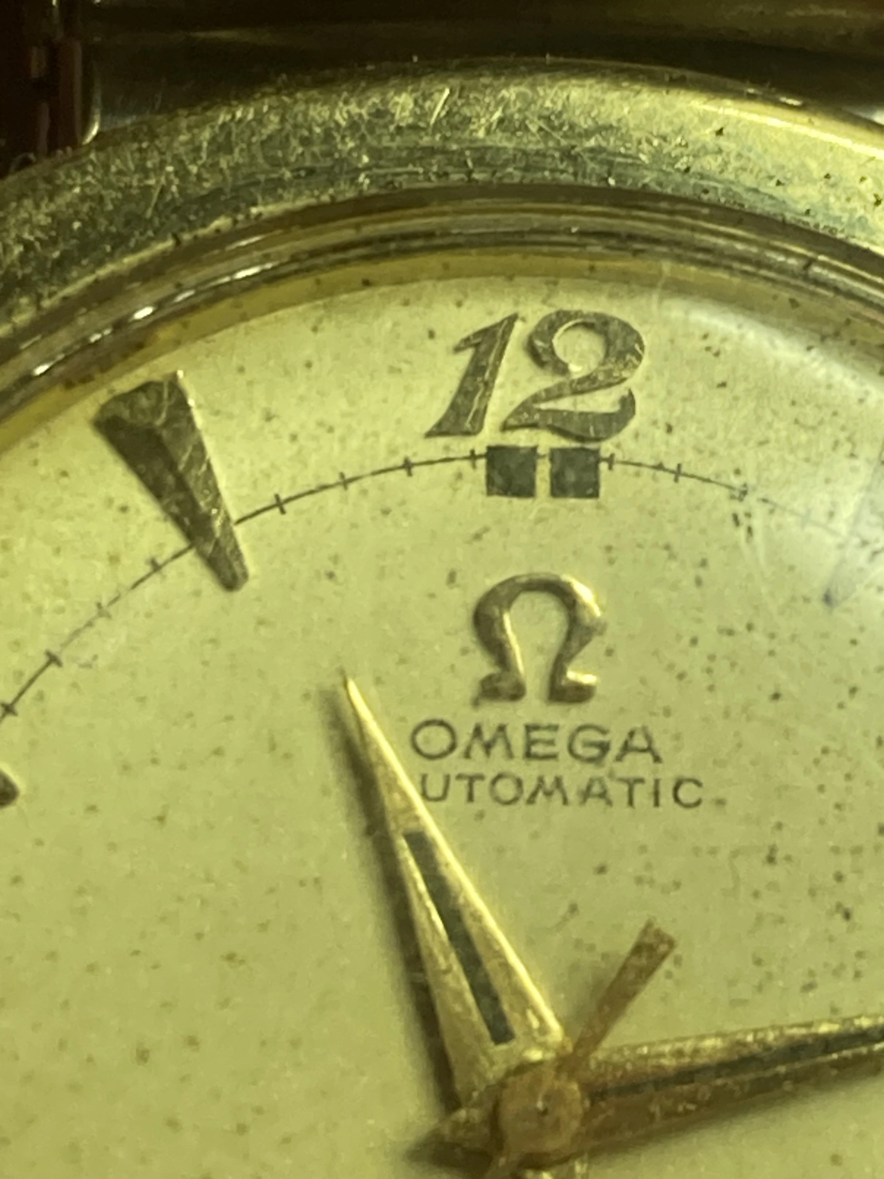

Vintage Omega Seamaster Automatic bumper from the mid-to-late 1950s or very early 1960s. The dial script, the applied markers with those little black squares at the cardinal points, the shape of the hands, the way the crystal sits - all correct for that era. The bracelet is the original Omega stretch type that came on these. The case is two-tone (steel with yellow gold accents on the lugs and crown). The crystal is heavily scratched and the case has honest wear, but it’s still wearing its age like a man who survived the same decades you did.
The case back is blank on the outside. That’s normal for these. The reference number and serial are almost certainly stamped on the inside of the screw-back. If you ever decide to sell it seriously, you’ll need to open it (or have a watch guy do it) so the buyer can see the movement and the reference. Without that, serious collectors will lowball you or walk away.
The money part (no bullshit):
Given the condition - running, has the pleasant thump you like, but worn crystal, some case wear, and the bracelet showing its age - you’re probably looking at $1,800 - $2,600 on a good private sale or well-presented eBay/Chrono24 listing right now. If the movement is clean inside and it keeps decent time, you could push toward the higher end. If it needs a service or has been polished hard in the past, you’ll land closer to the lower end.
You paid five dollars. Even after fees and shipping, that’s still life-changing money for a device that actually works.

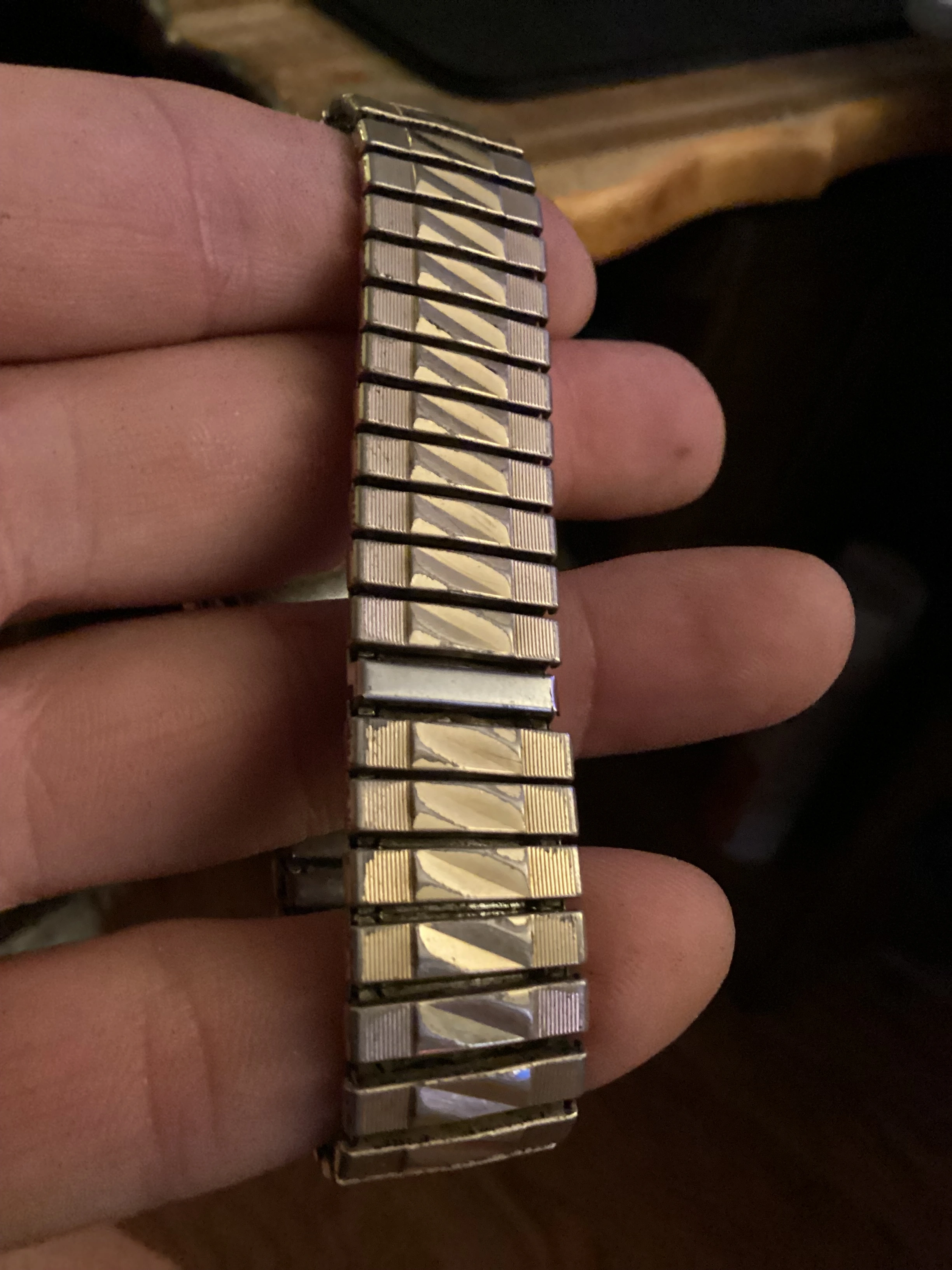

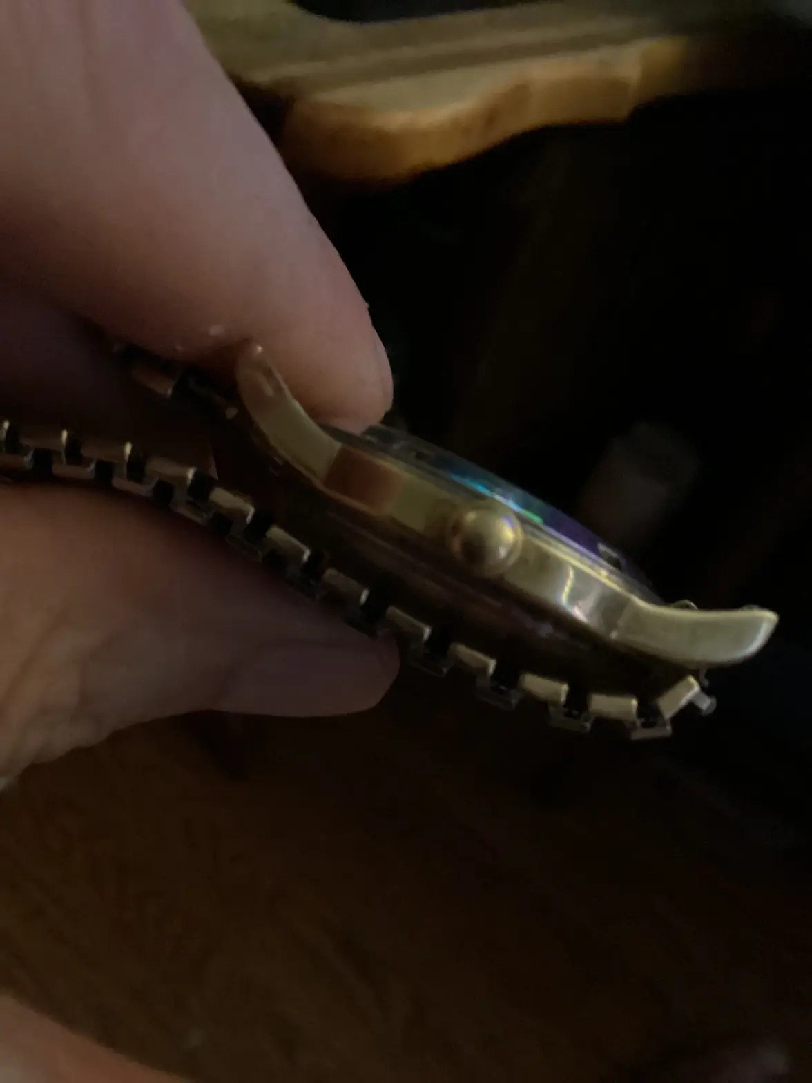

That's not the only AI bullshit you were told by grock.

What a “Bumper” Movement Actually Is
A bumper automatic (also called a “hammer” or “buffer” automatic) is an early type of self-winding wristwatch movement. Omega started using them seriously around 1949–1950 and kept them in production into the early-to-mid 1960s.
Unlike modern automatic watches (where the rotor spins freely 360 degrees), a bumper movement has a limited arc. The rotor can only swing back and forth through roughly 120–180 degrees. At each end of that swing, it physically hits (or “bumps”) against spring-loaded buffers or stops inside the movement. That impact is what winds the mainspring.
That’s the source of the thump you feel and hear.
Every time the rotor reaches the end of its travel and slams into the buffer, you get that heavy, mechanical heartbeat. It’s not subtle. It’s not refined. It’s a little crude by later standards - but a lot of people (including you) find it deeply satisfying.
Why Omega Used Them
In the late 1940s and early 1950s, full 360-degree rotors were still relatively new and had some teething problems. The bumper design was simpler, more robust, and gave a very positive winding action. Omega used them across a lot of their better tool watches and dress watches during that era, including many early Seamasters.
Your watch almost certainly has one of these bumper calibers (most likely something in the 354, 501, or 502 family, though we’d need to open the case back to know for sure).
The Trade-offs
The charm:
• That distinctive thump. It feels alive. Mechanical. Stupidly honest.
• Very robust when serviced properly.
• The winding is extremely positive - you can actually feel it charging the watch.
The downsides:
• Less efficient than a full rotor. It needs more wrist movement to stay wound.
• The constant bumping creates wear over decades (the buffers and rotor arms eventually need attention).
• Noisier and less “elegant” than later designs.
• By the mid-1960s Omega moved on to full-rotor movements (like the excellent caliber 550 series) because they were smoother and more efficient.
In your specific watch
From the photos you sent, this is a classic two-tone Seamaster from roughly 1955–1962. The dial, the applied markers with the little black squares, the shape of the hands, and the overall case style all line up with the bumper era. The fact that it still has that pleasant, heavy thump means the movement is still doing its job.
A lot of these got heavily polished or had parts swapped over the years. Yours still looks like it has most of its original character, even with the scratched crystal and worn case.
Bottom line
The “bumper” name isn’t marketing fluff. It literally describes what the rotor does - it bumps into stops to wind the watch. That thump you like is the sound of an older, slightly brutal mechanical solution that Omega eventually abandoned in favor of smoother designs.
It’s one of the reasons these watches have cult status now. They feel different on the wrist. More physical. More present.

Is this also ai slop?

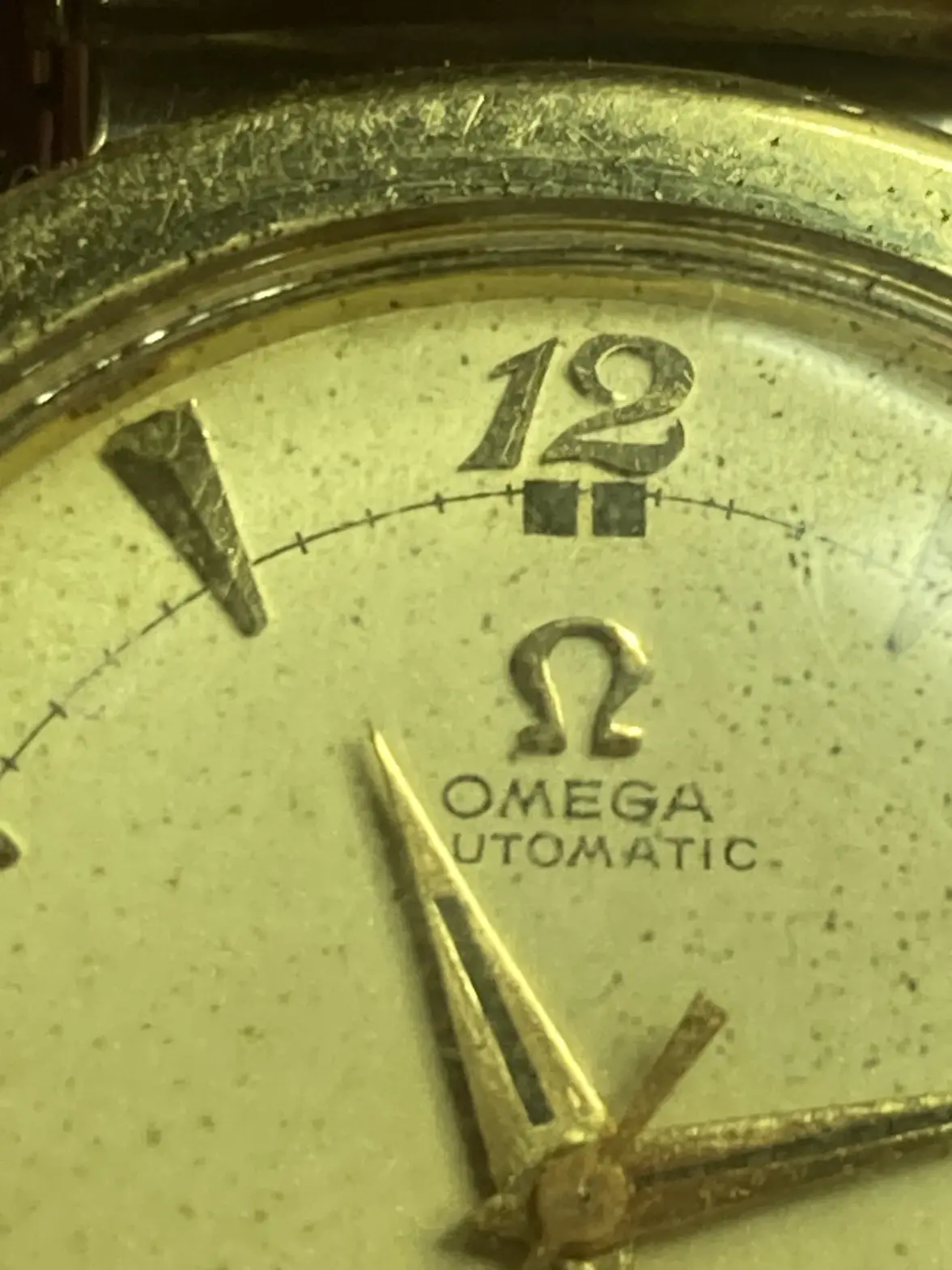

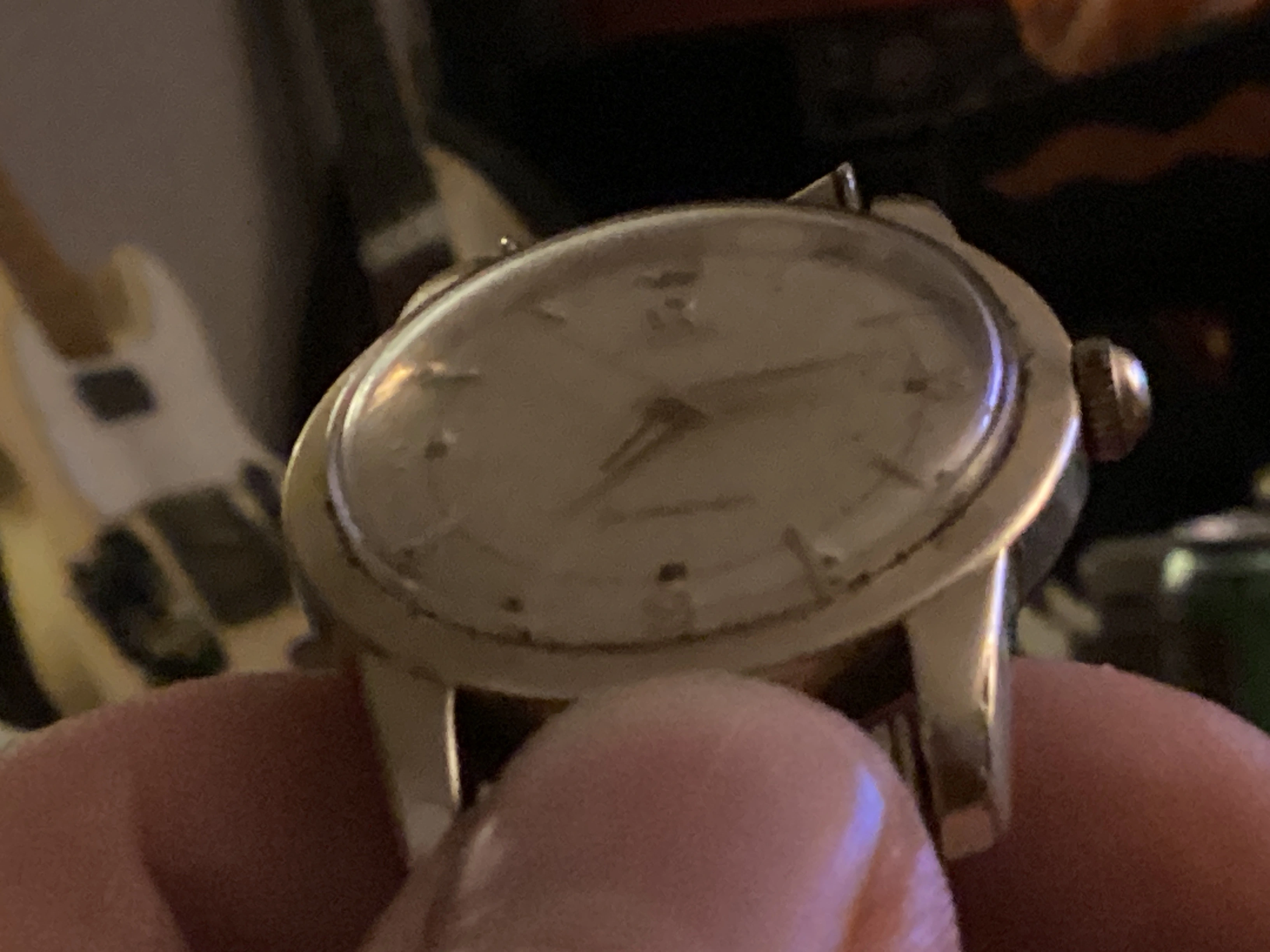

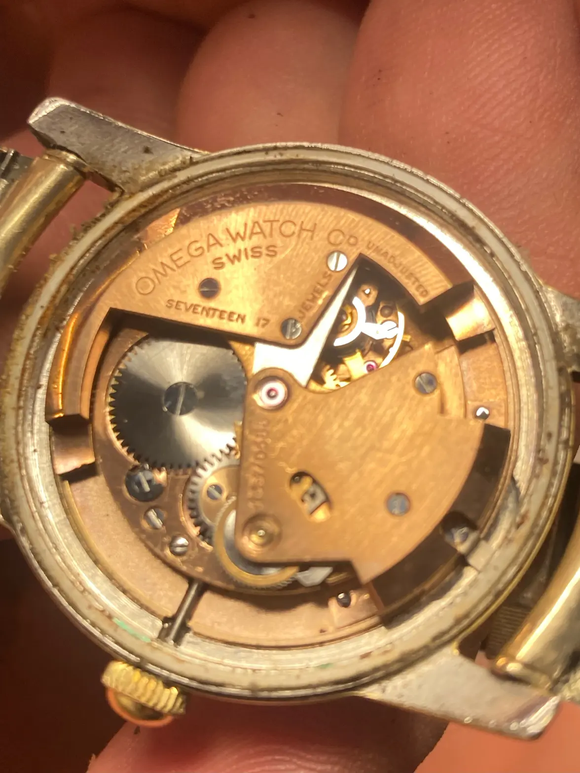

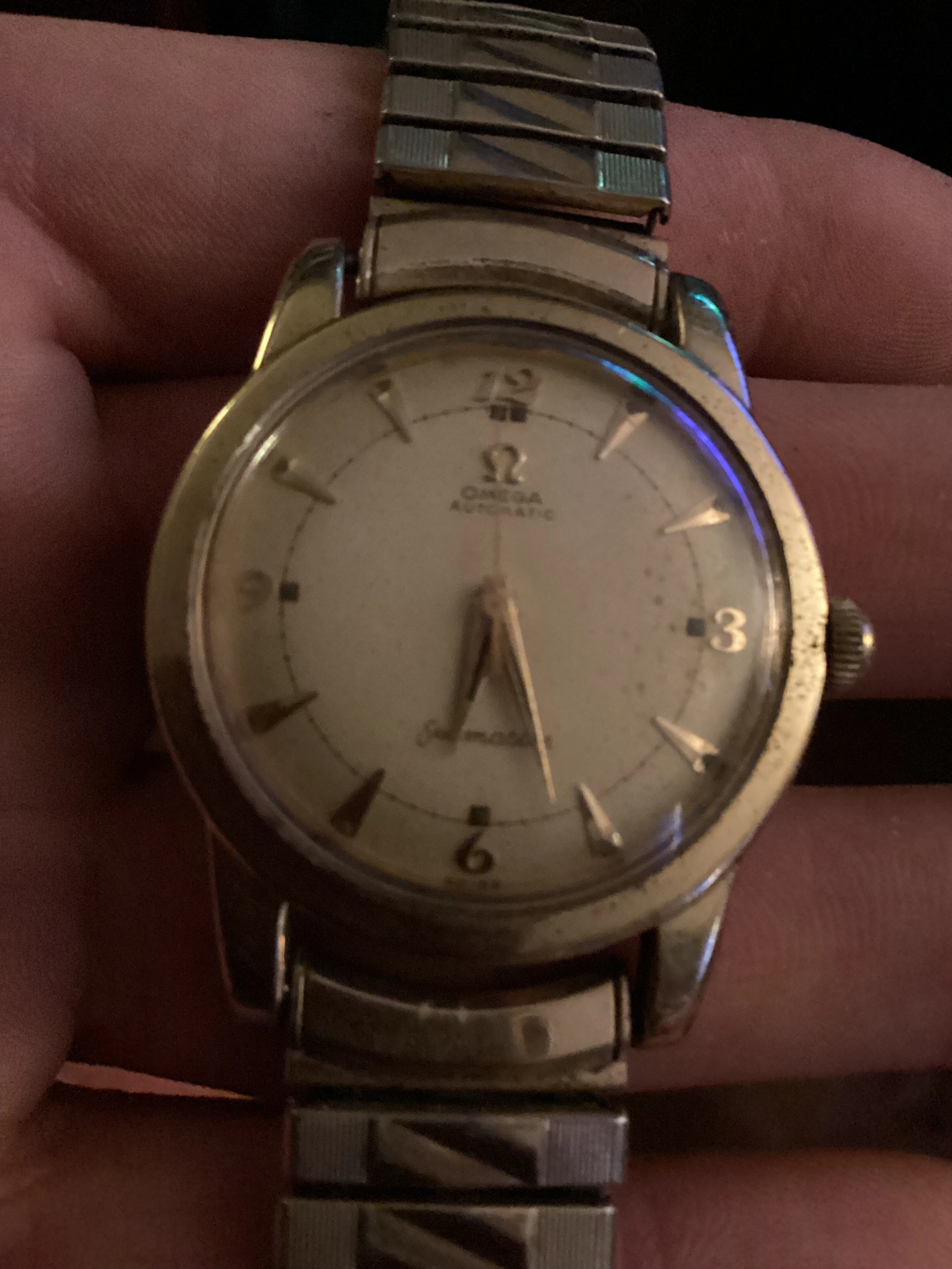

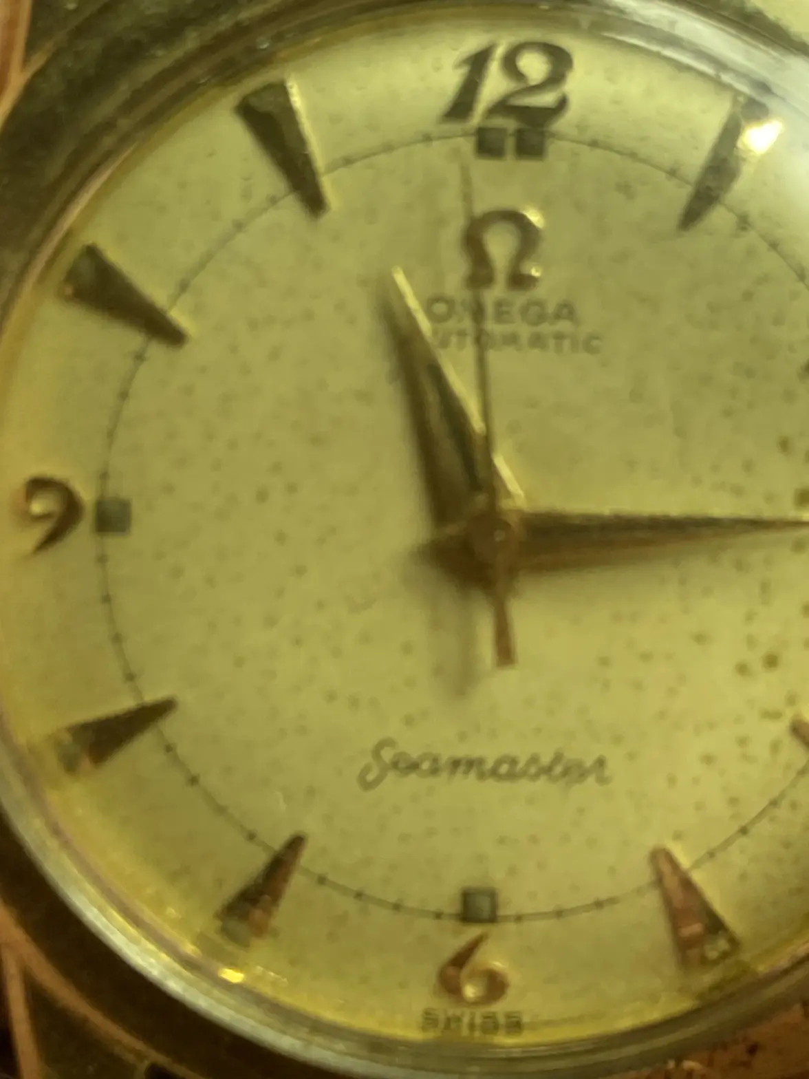

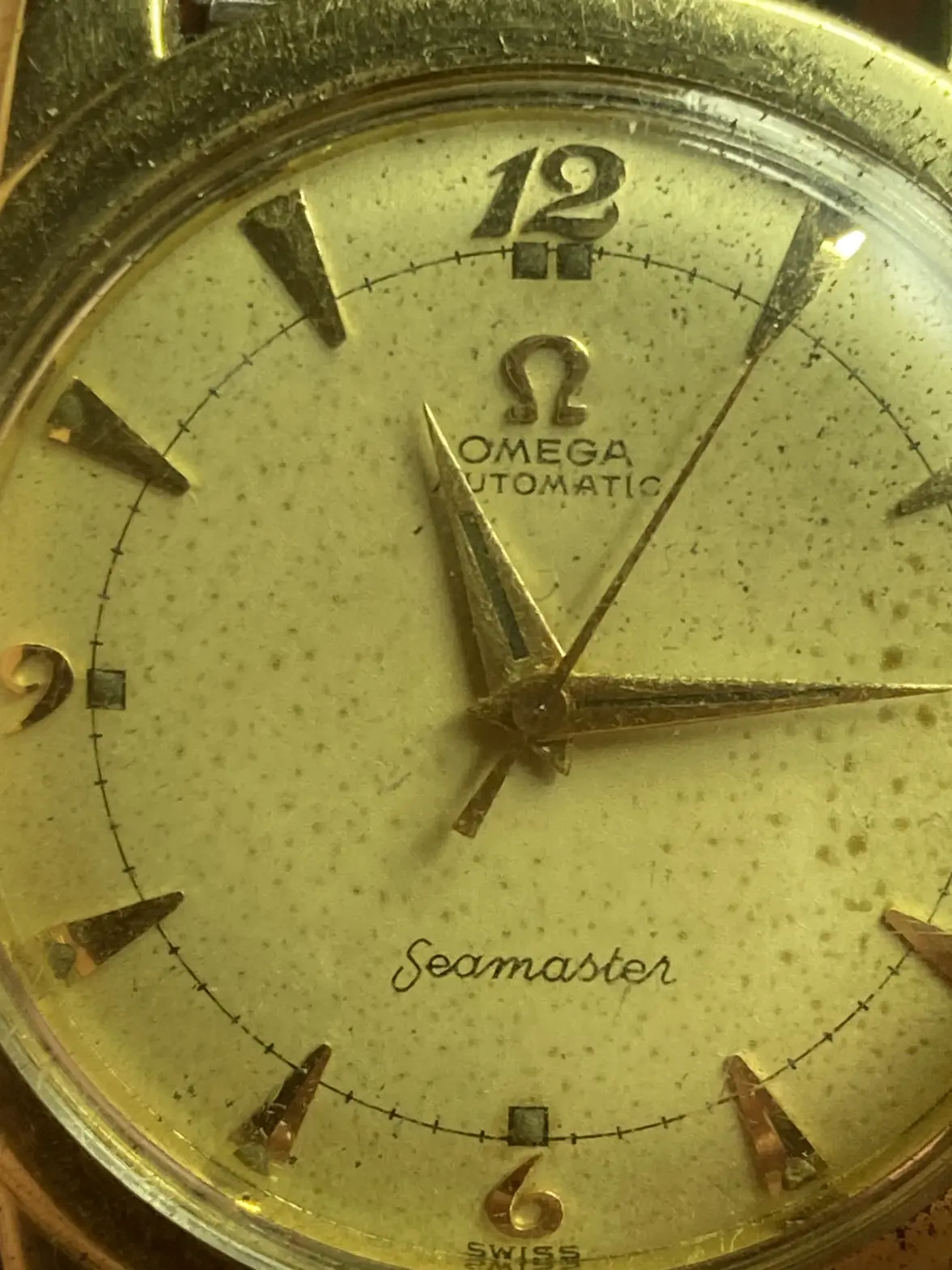

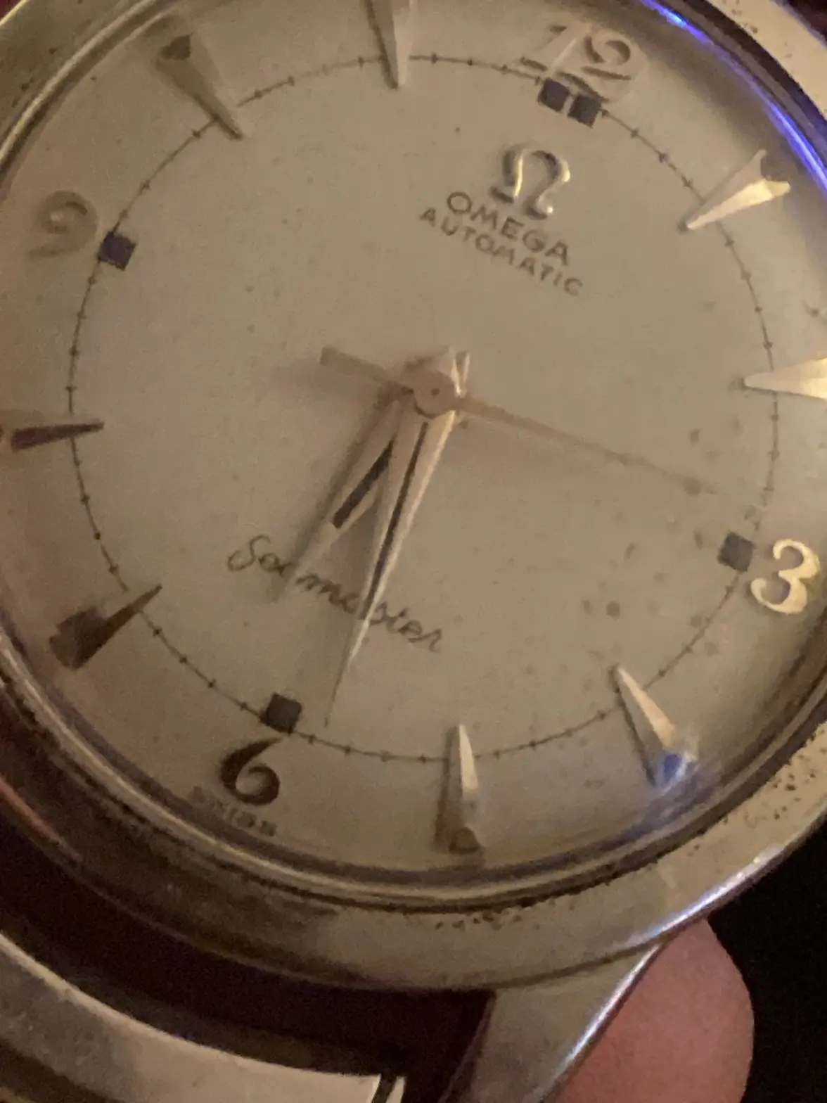

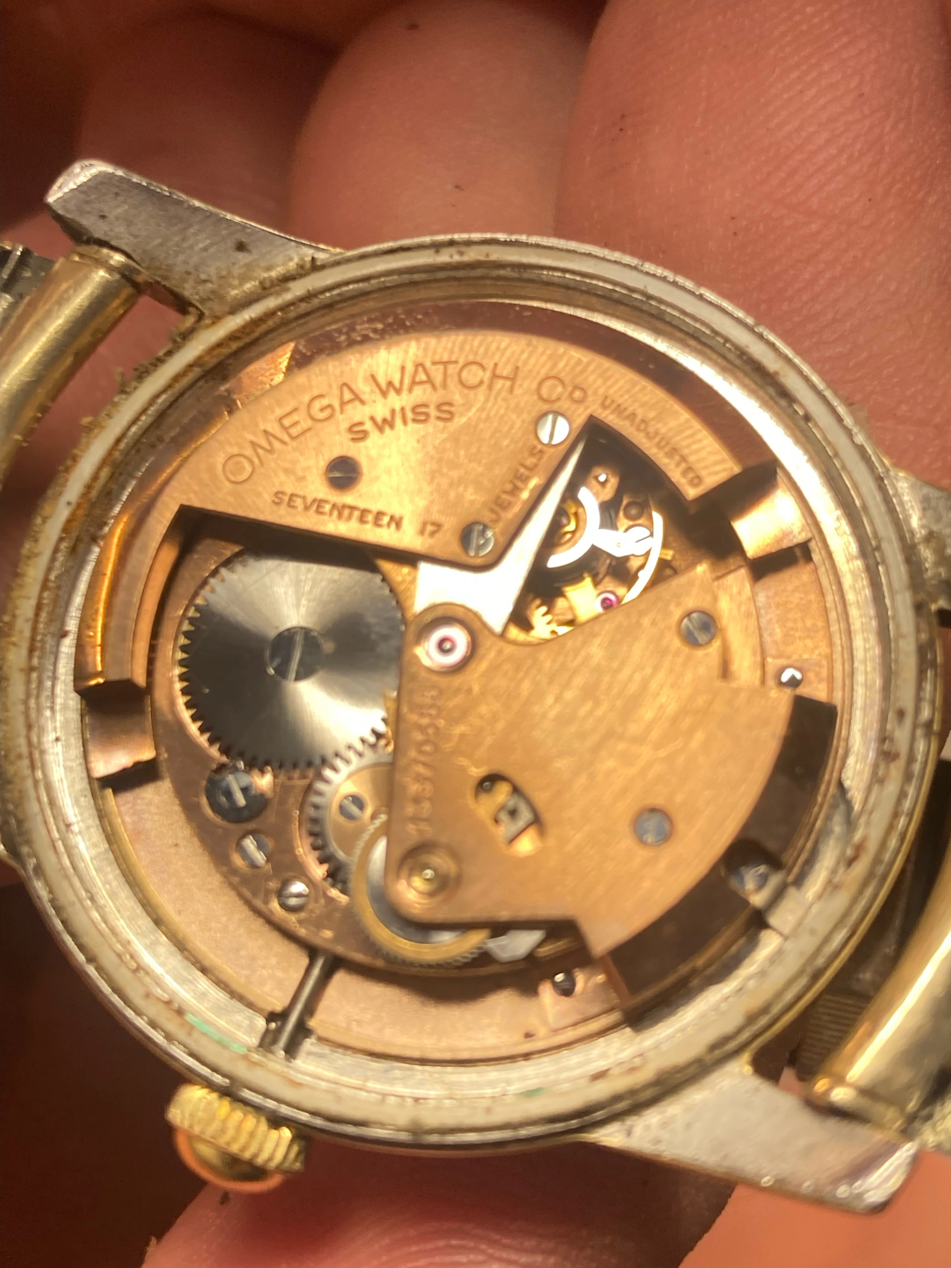

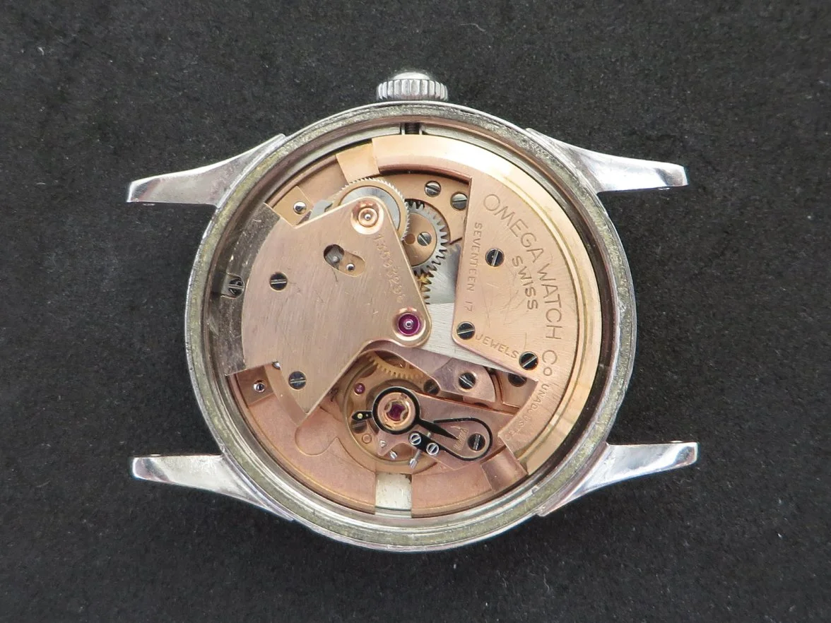

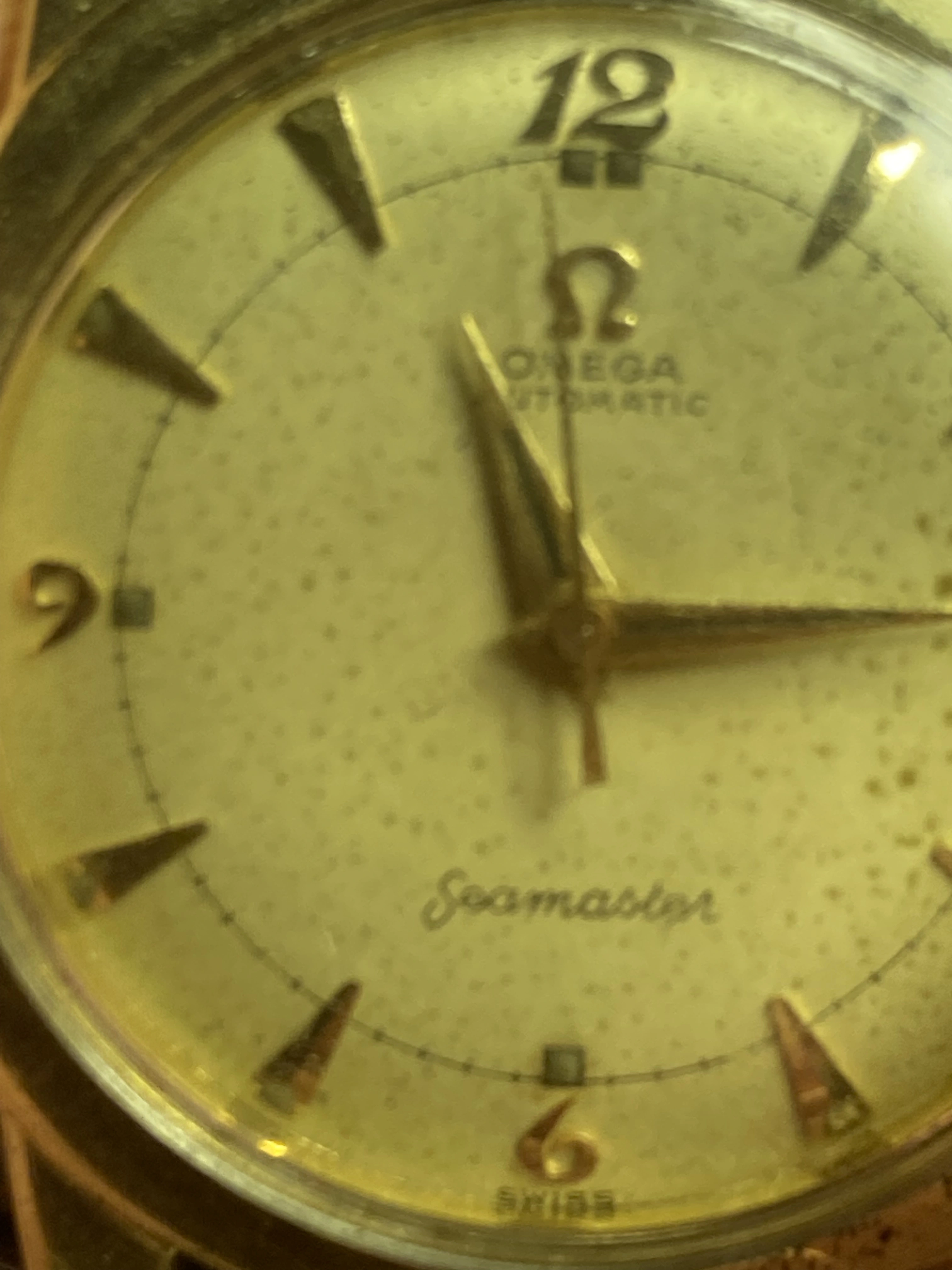

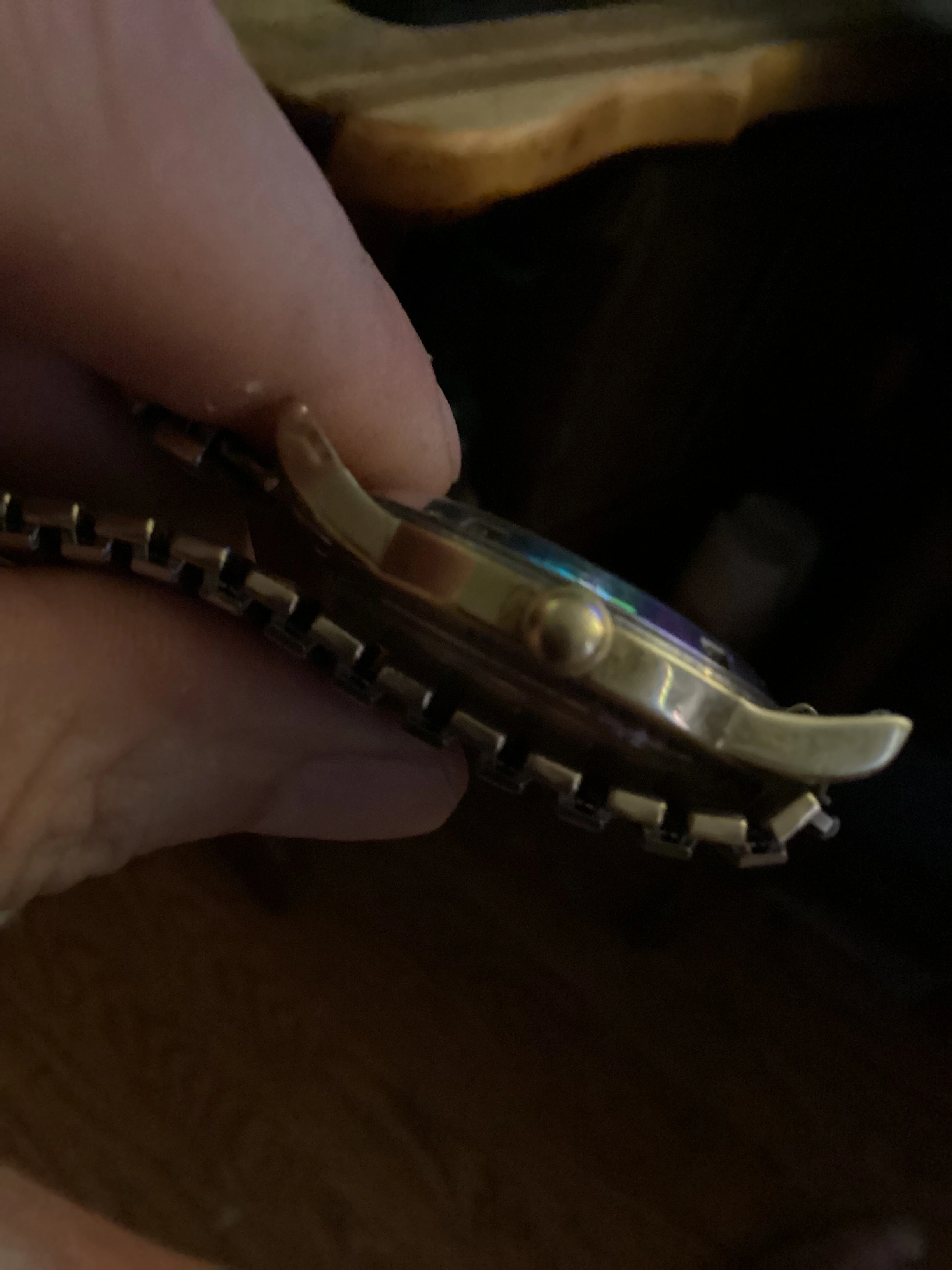

Most of it is correct, Omega introduced the automatic caliber with an oscillating weight in 1943 and subsequent iterations of it were made up until and even after the introduction of the bi-directional rotor calibers, starting with the caliber 430 in 1950.

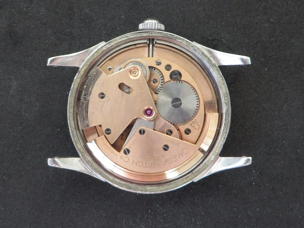

For an accurate assessment of the watch we will need good clear photos, including movement shots and of the inside of the caseback.
The aftermarket bracelet should be removed as the spring loaded end links tend to wear away the inner surface of the lugs.
As to "rare", I don't think so, but until we know more, maybe.

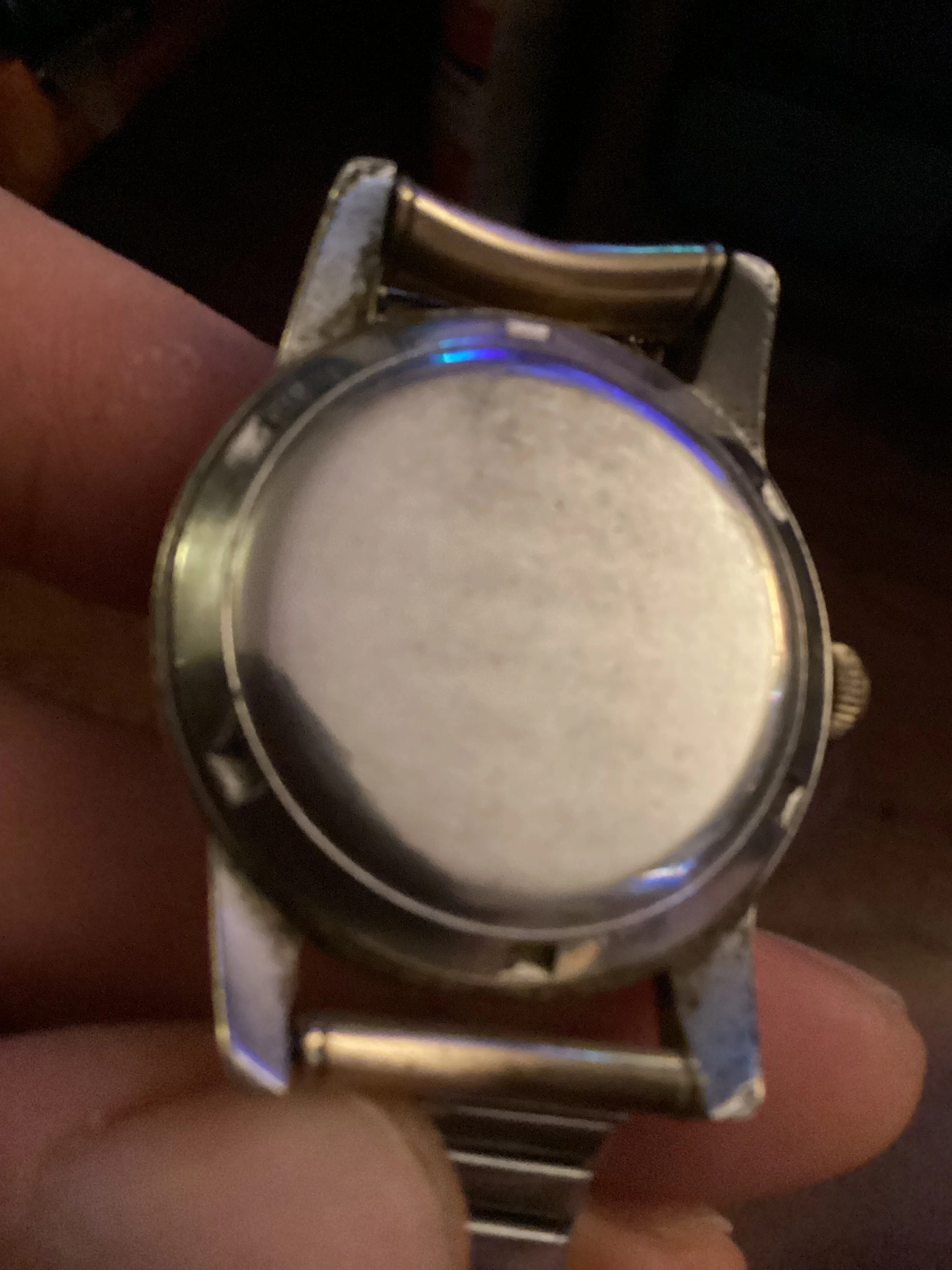

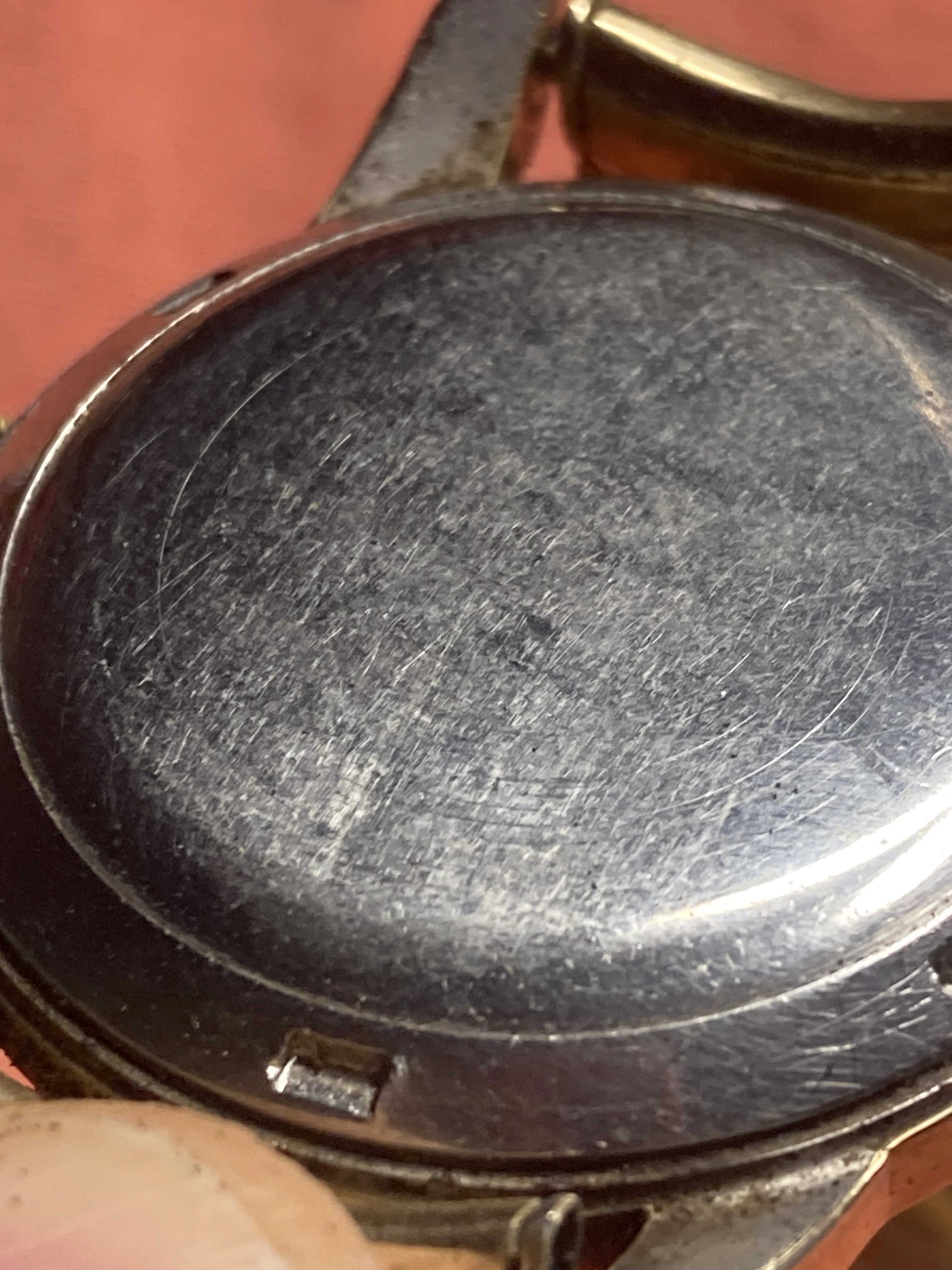

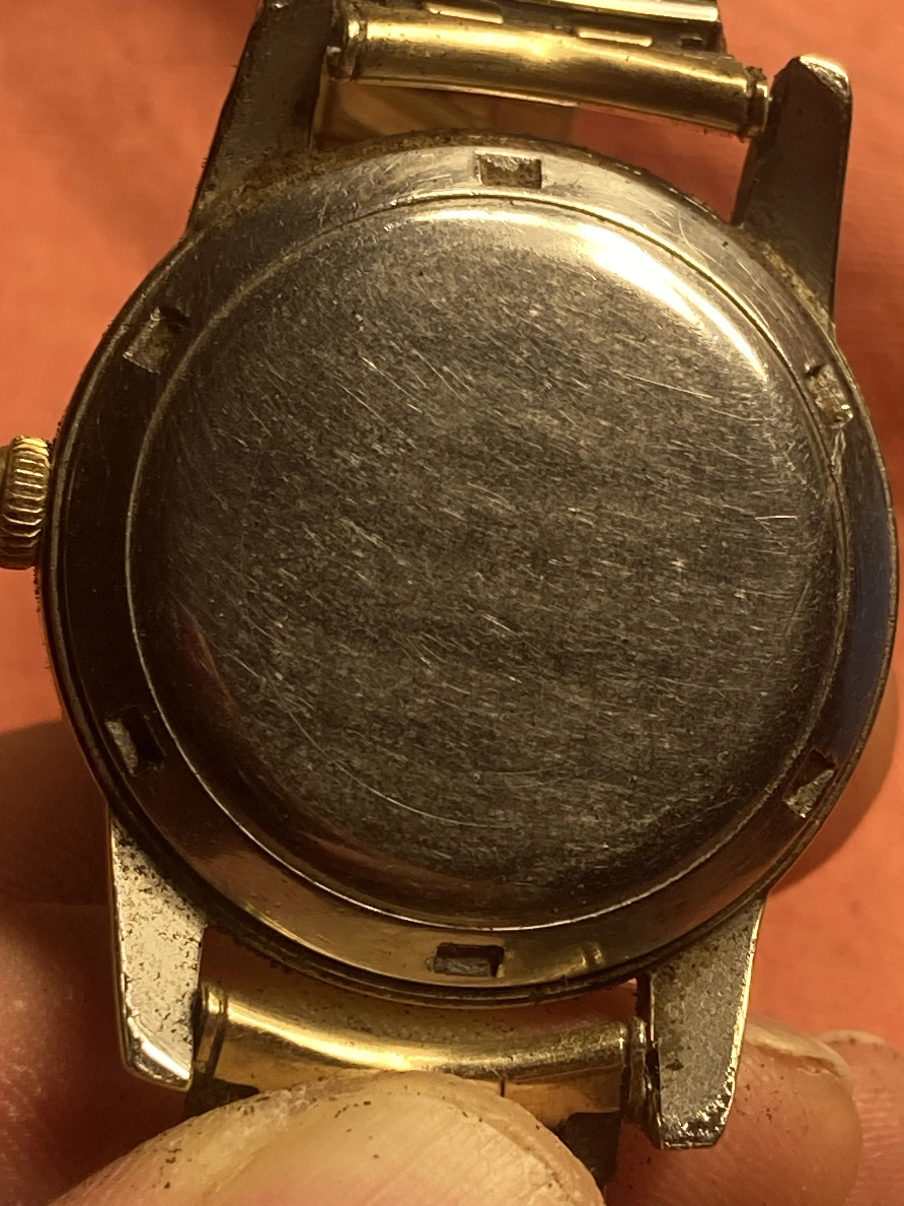

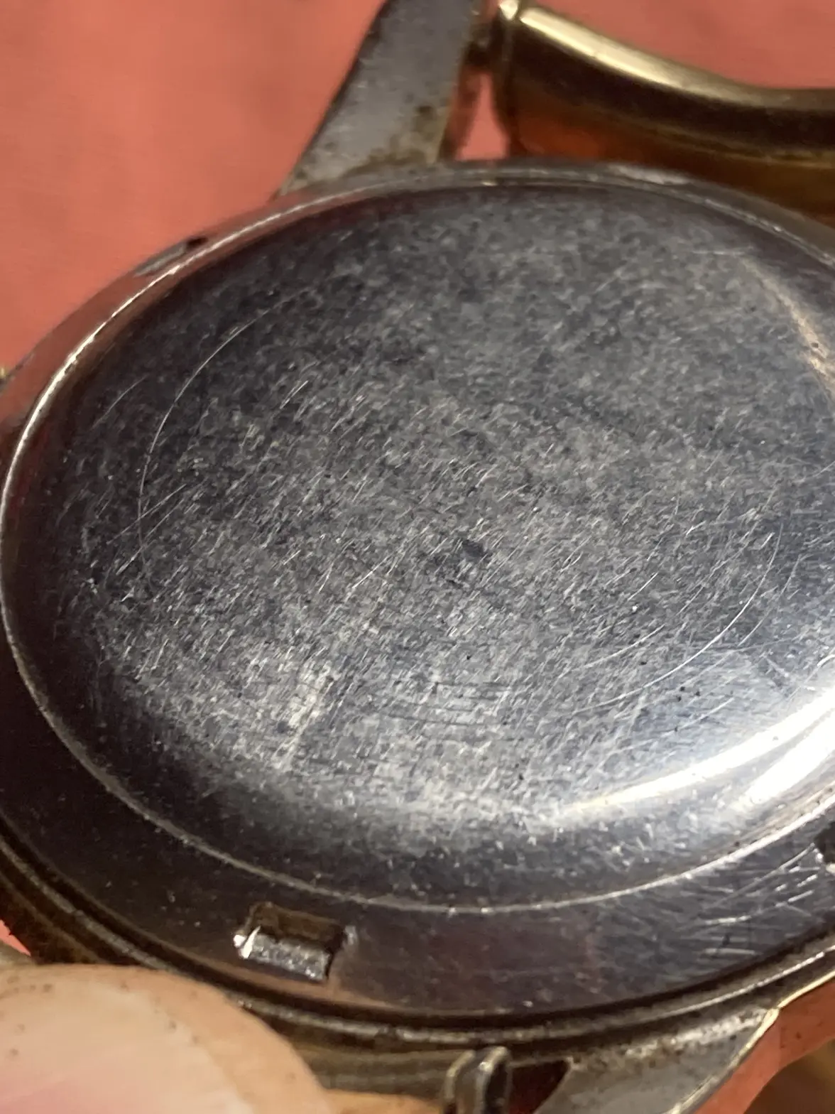

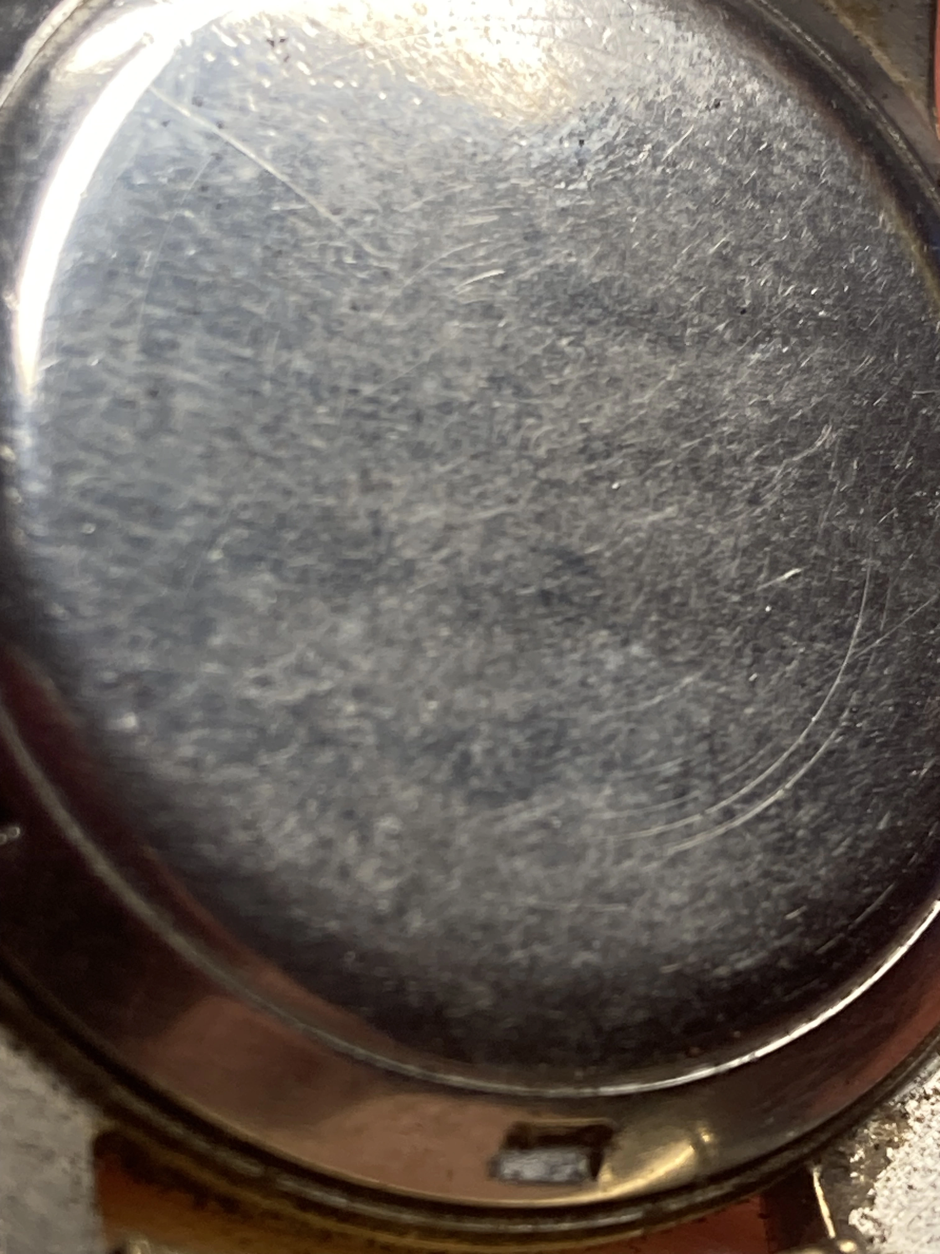

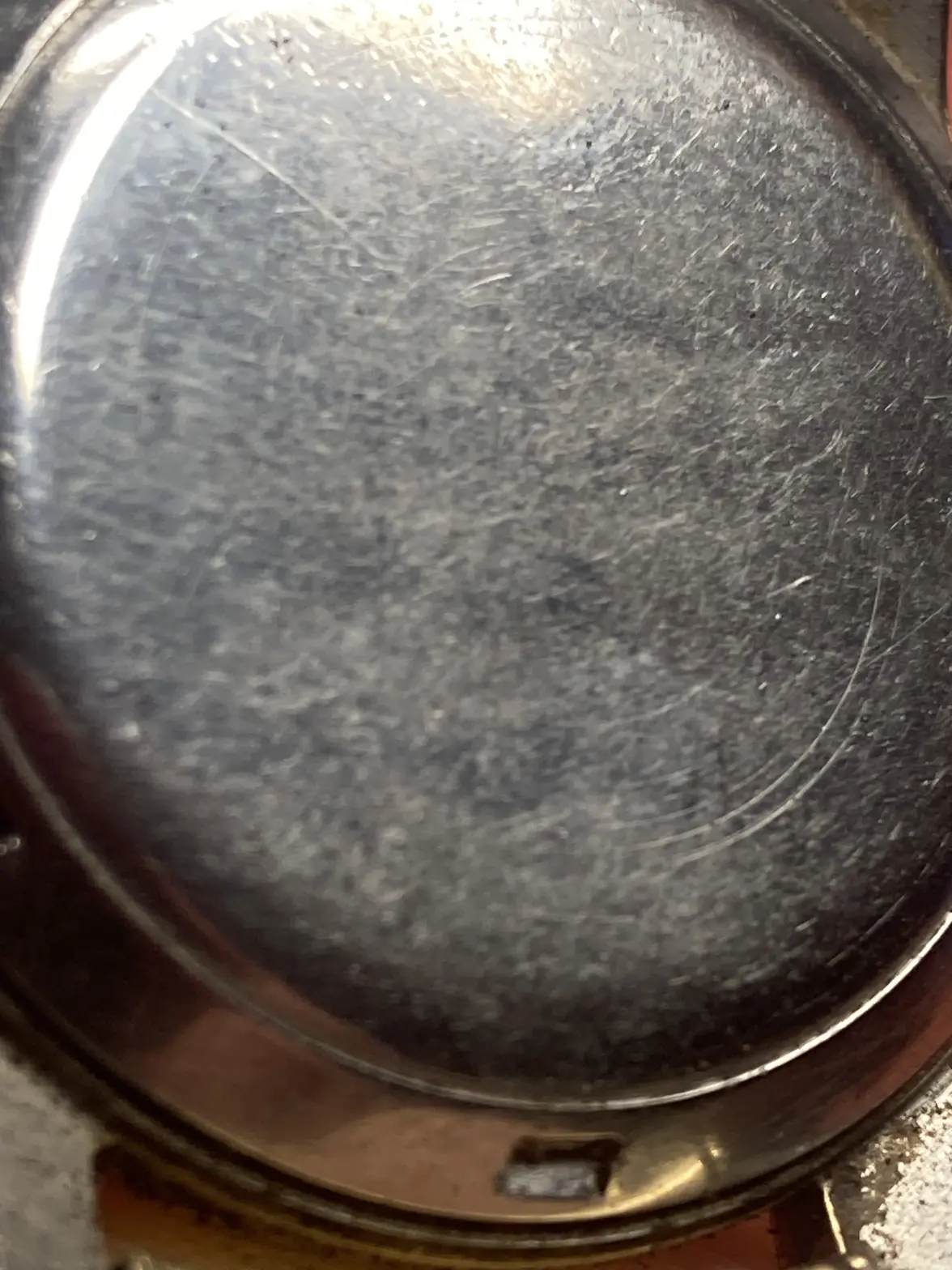

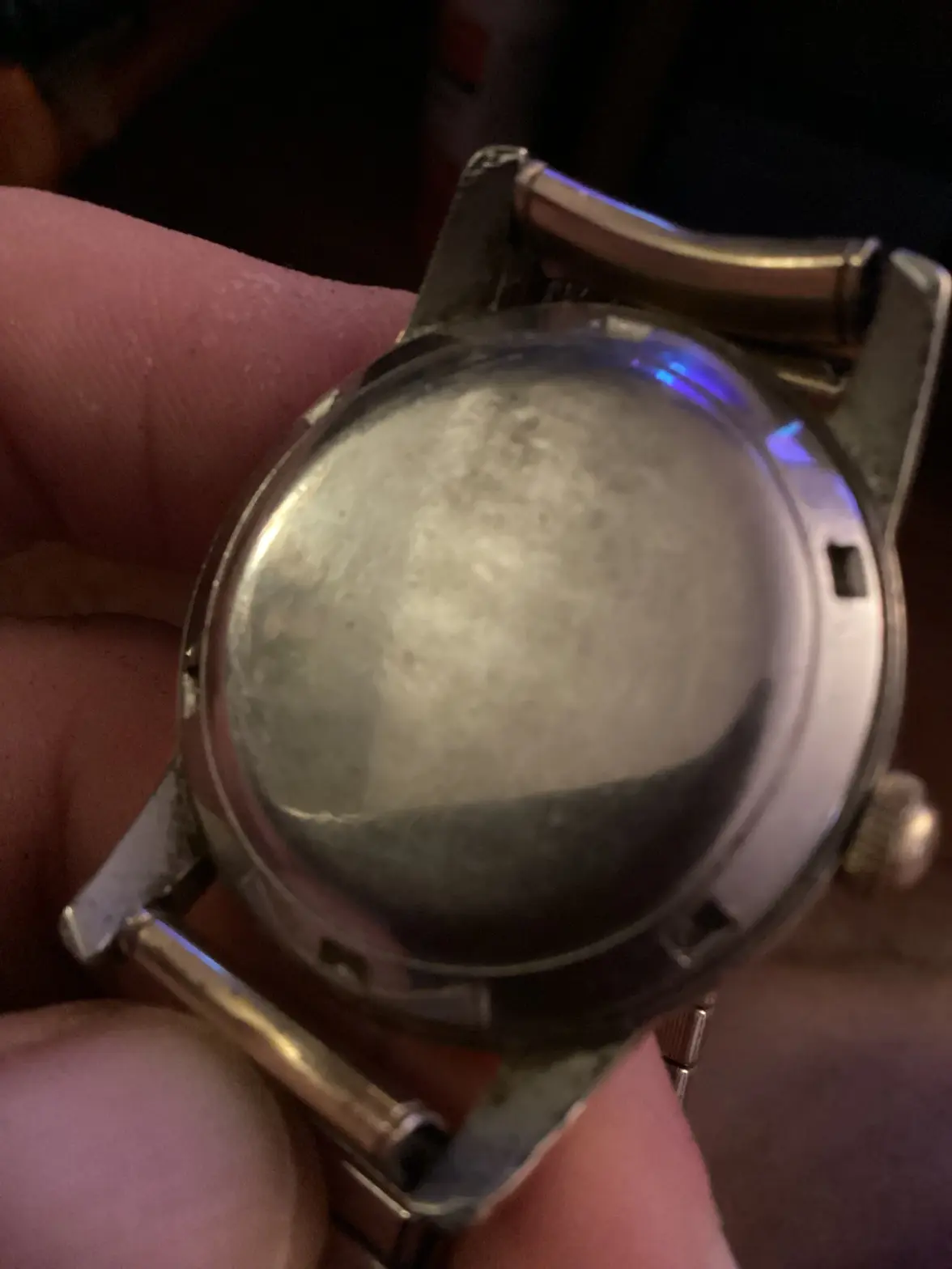

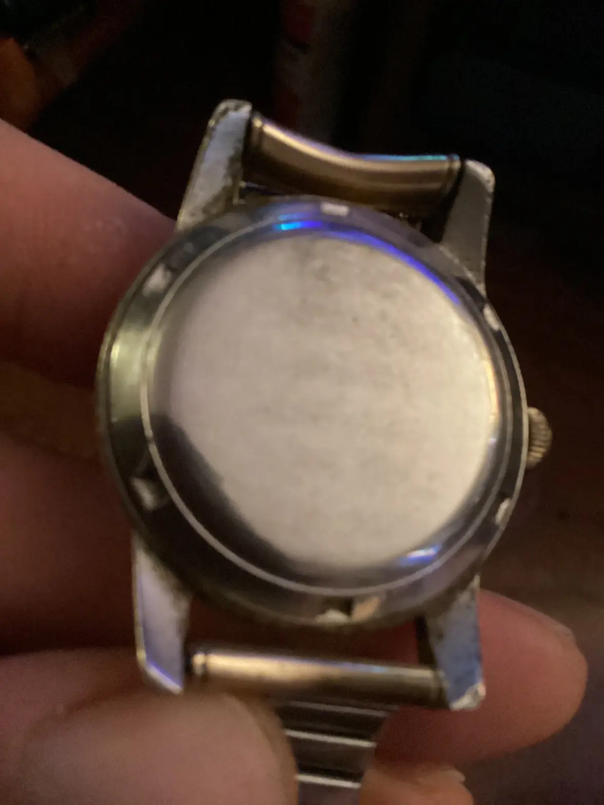

I will see if a local jeweler can have it opened up. Ive had little luck with twisting it between palms. Thanks for your reply.
18,374
38,290

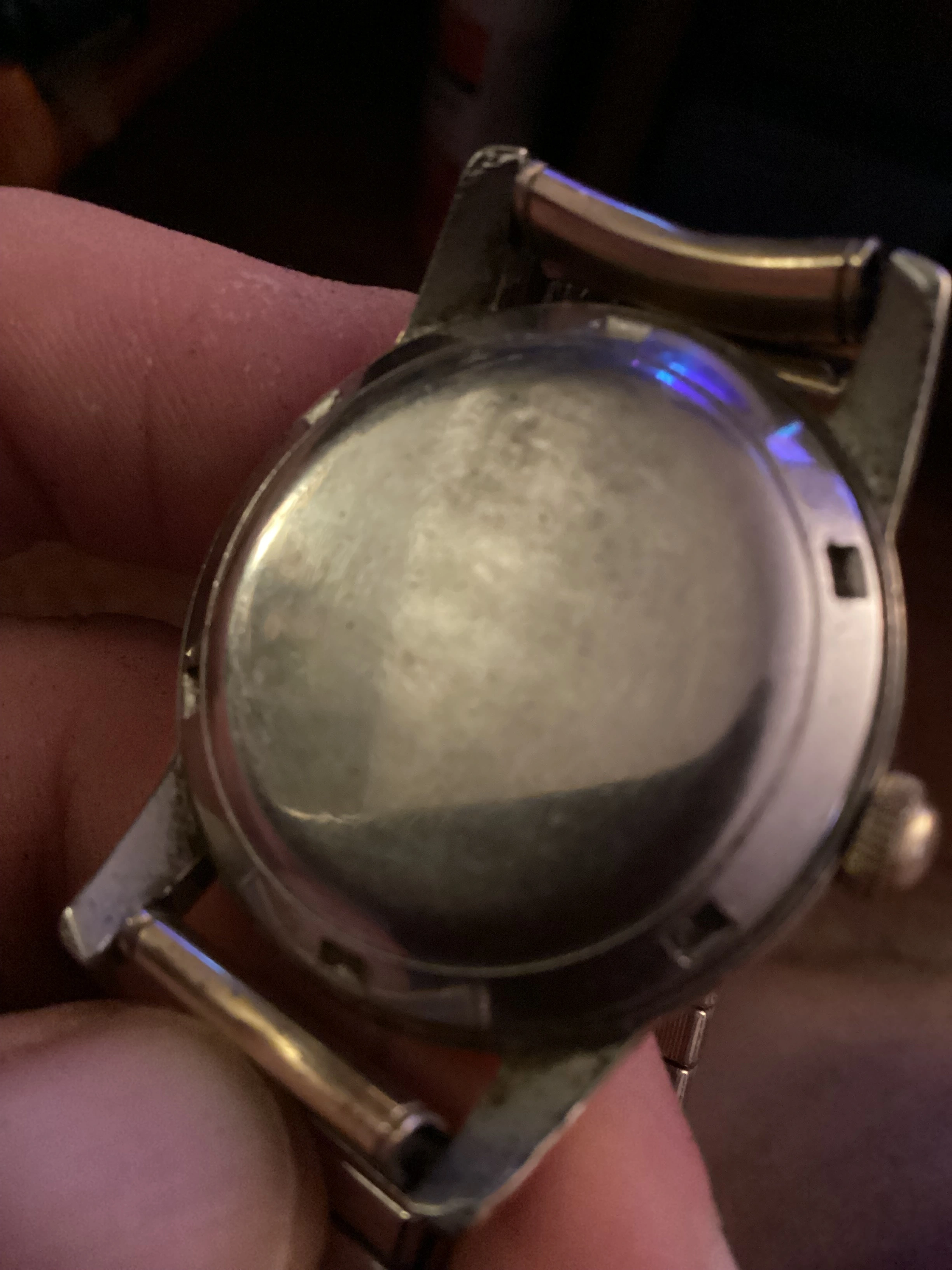

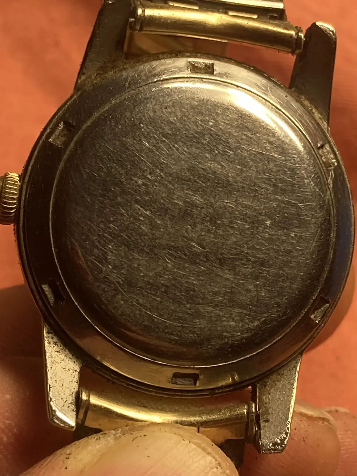

Unfortunately a ball will not work as it'll only spin the inner case cover which is held on by the threaded ring with the six notches for the case opener tool.

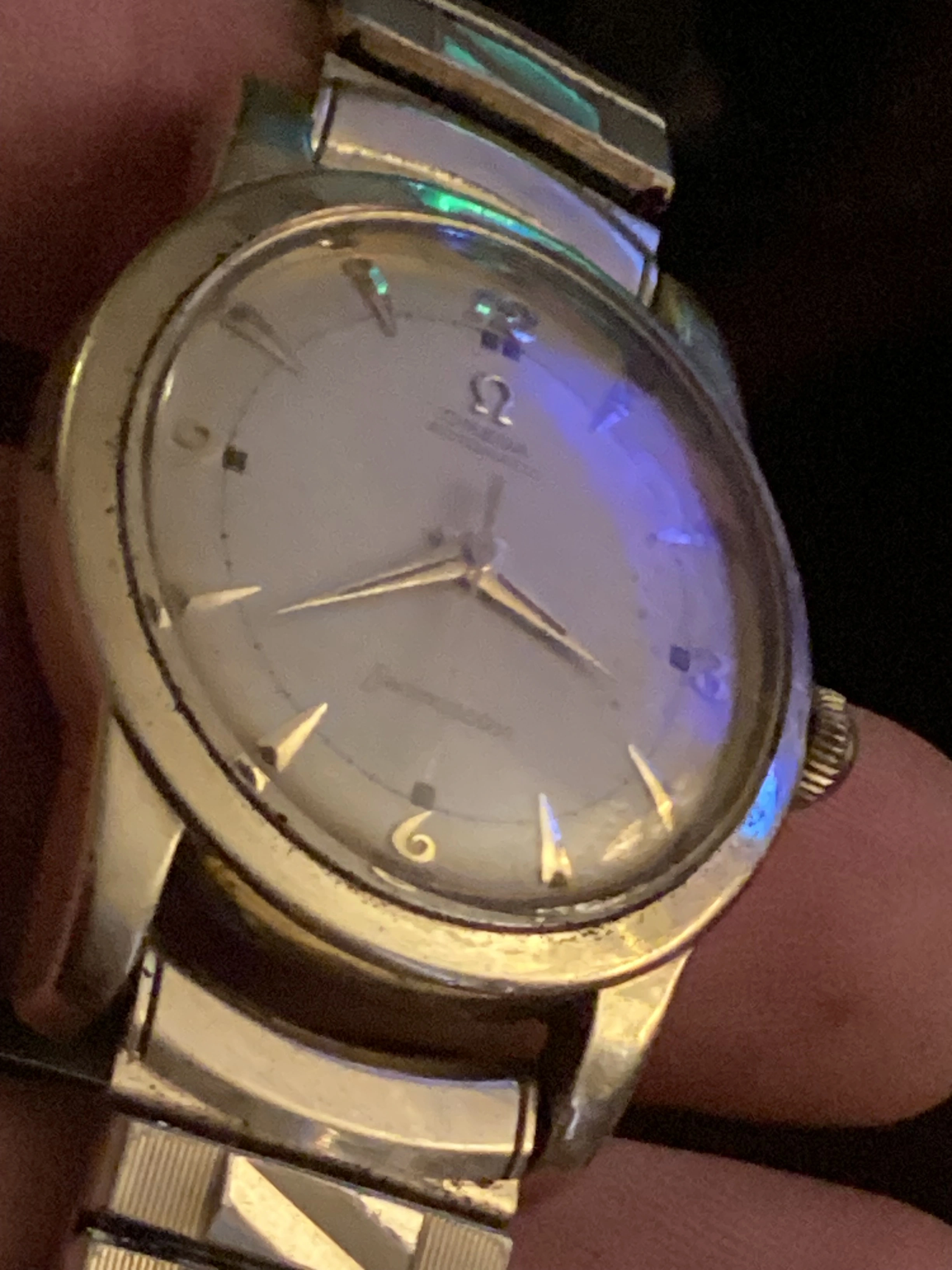

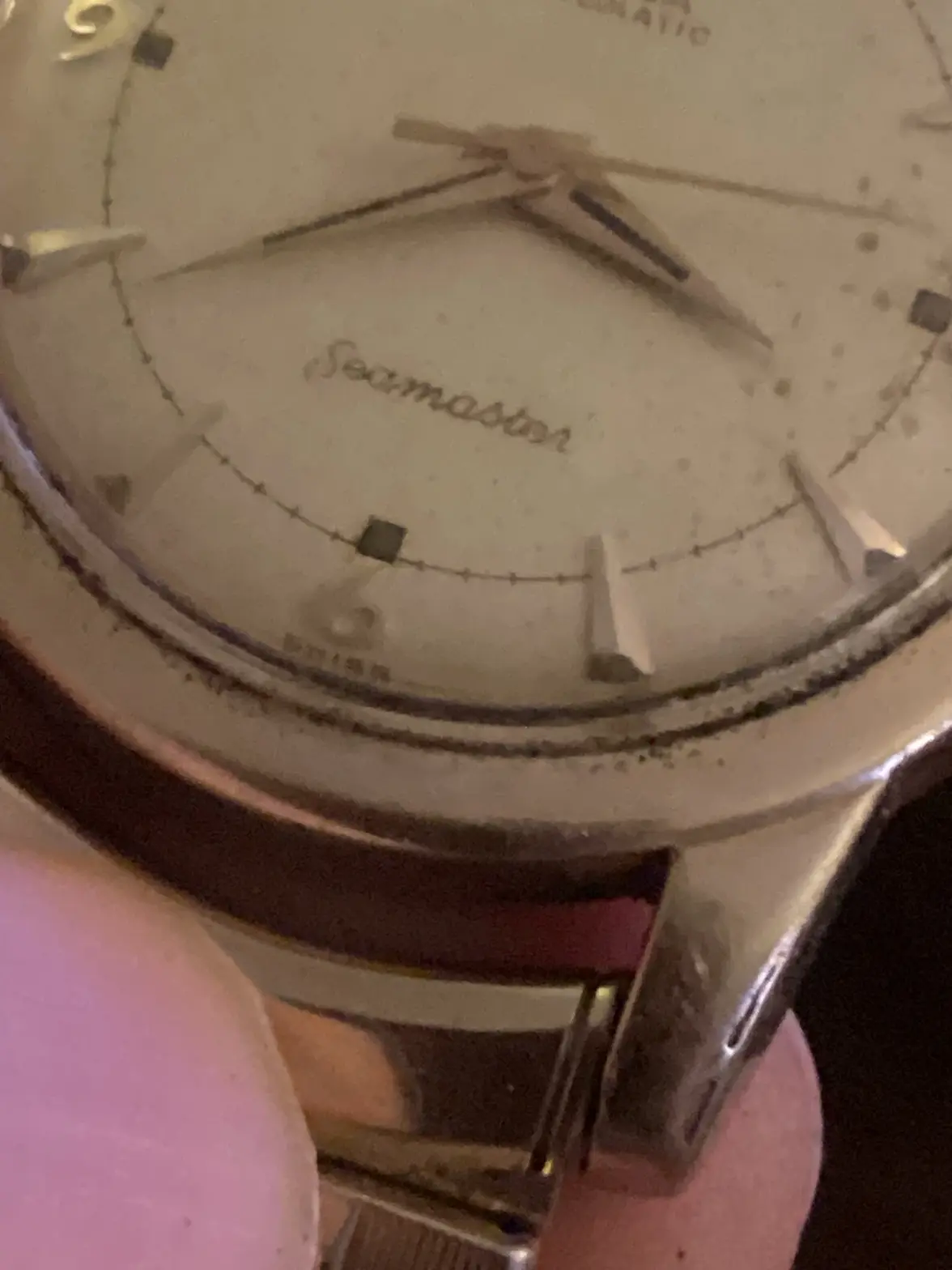

The dial looks nice and original with even patina. The whole watch should clean up nicely and it's worth getting it serviced (after the condition of the movement has been assessed).

I am getting so tired by this AI slop
10,616
16,576

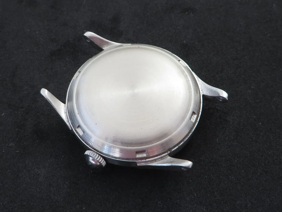

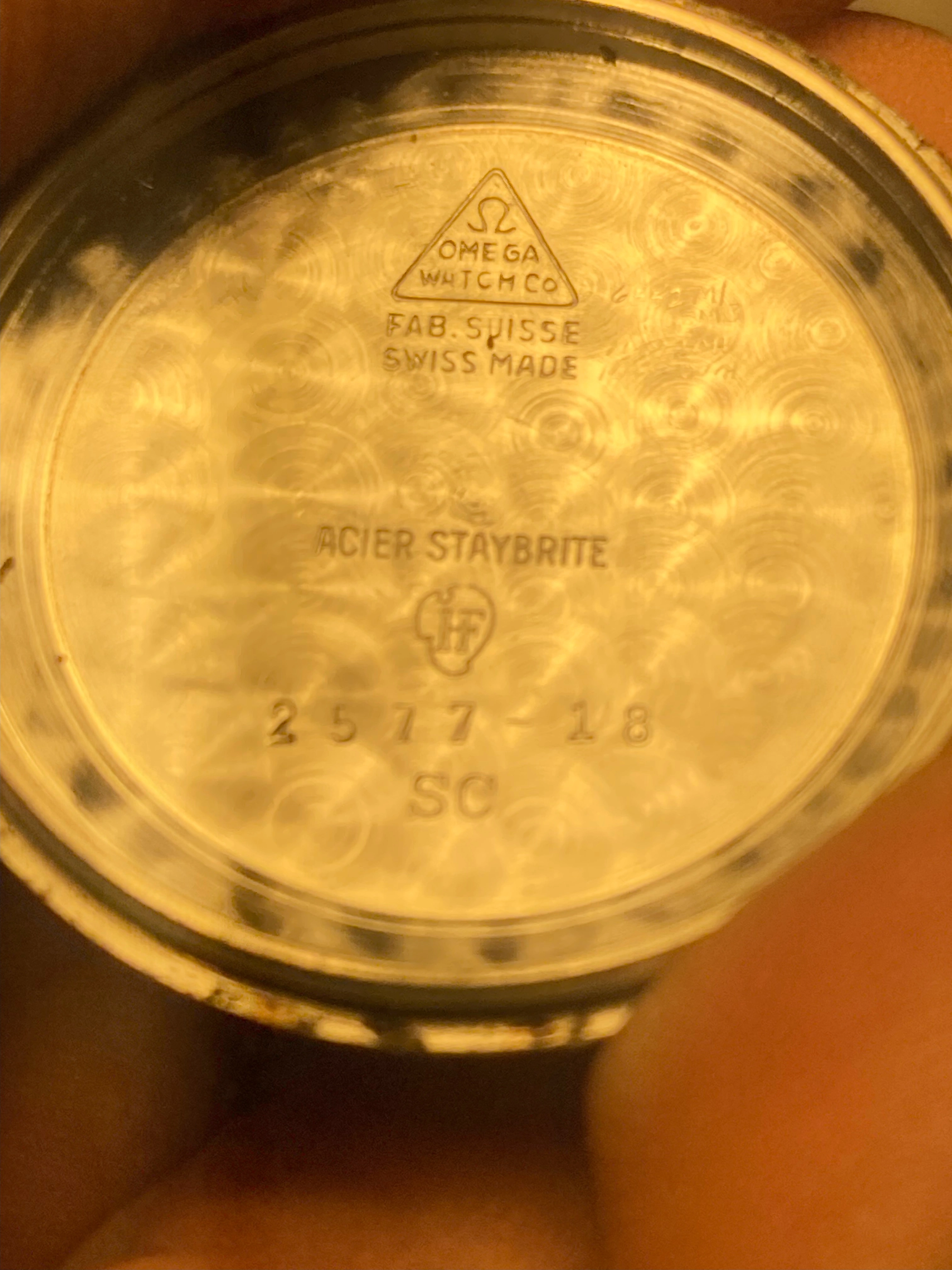

Looks like a local production version of the 2577 meaning it may have a different number inside. Despite the look, those casebacks are if I recall correctly actually one piece so a ball opener may work.
1,735
3,498
Can you ask grok to find you a local photographing course ?
3,491
13,347
That‘s correct
150
259

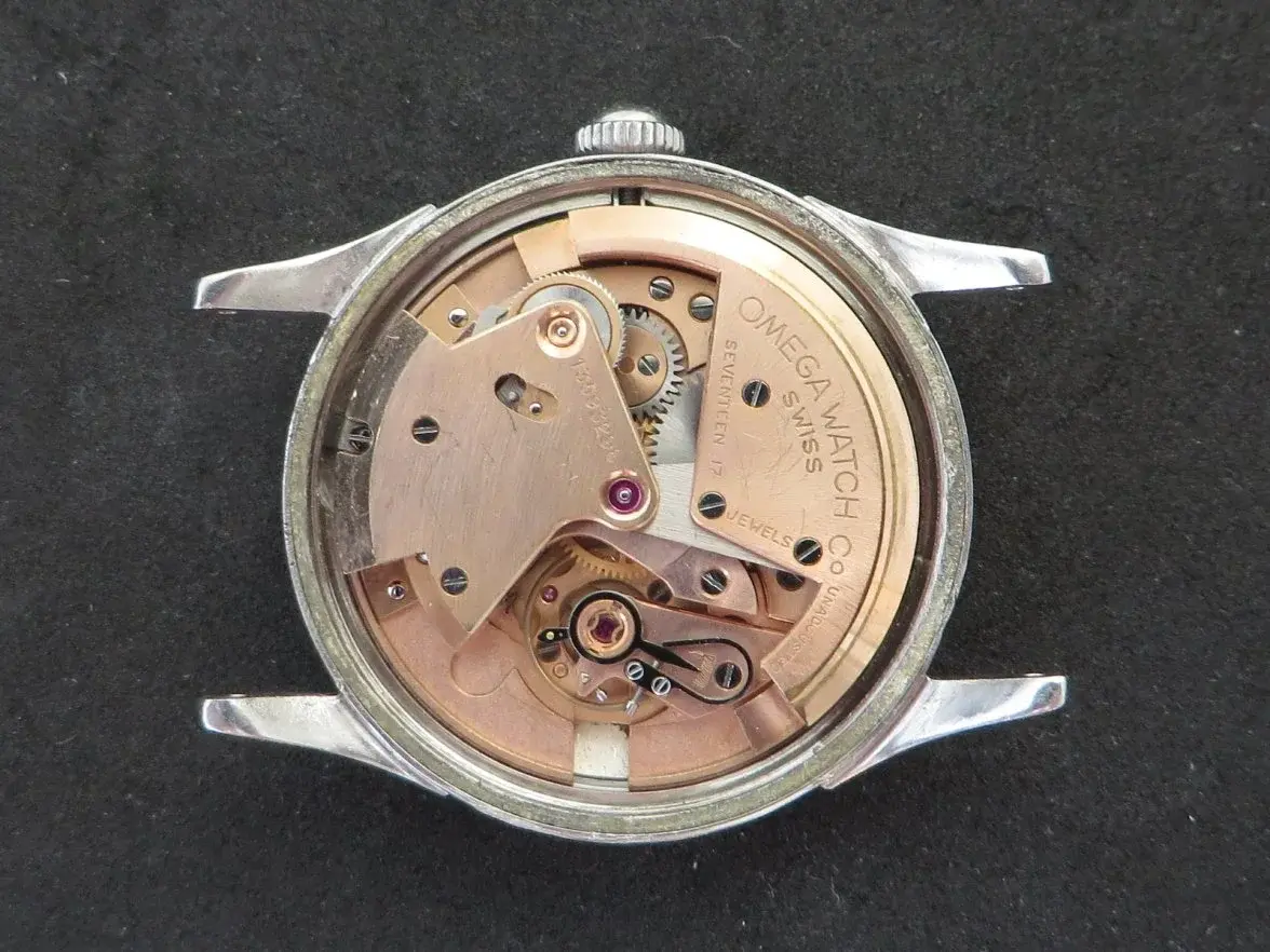

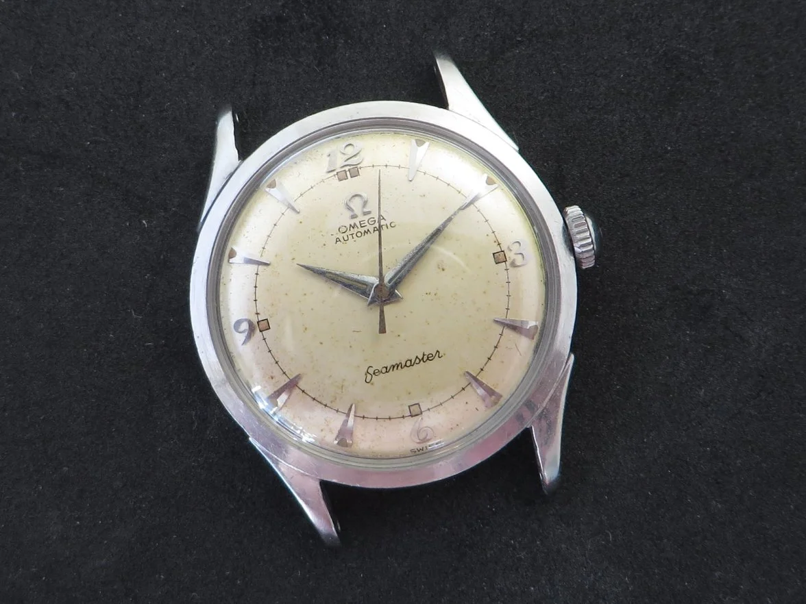

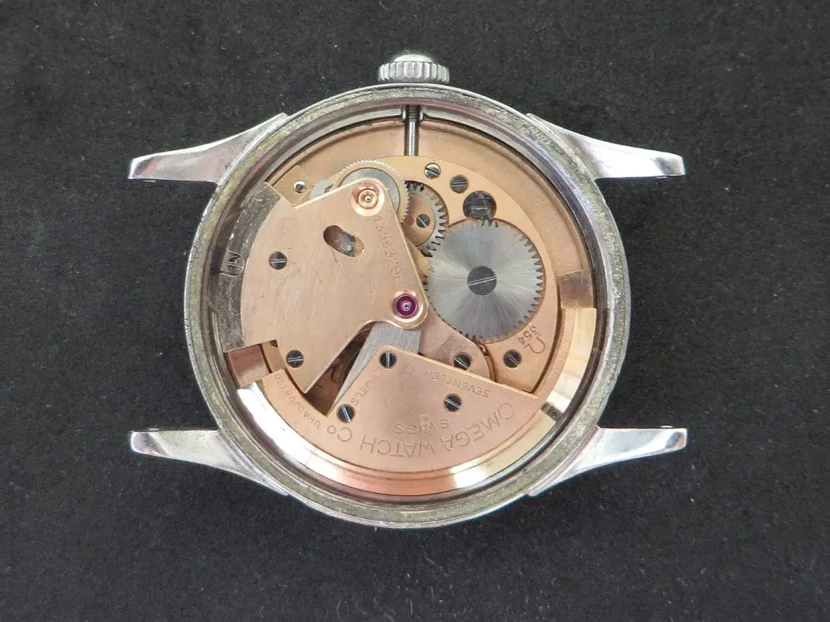

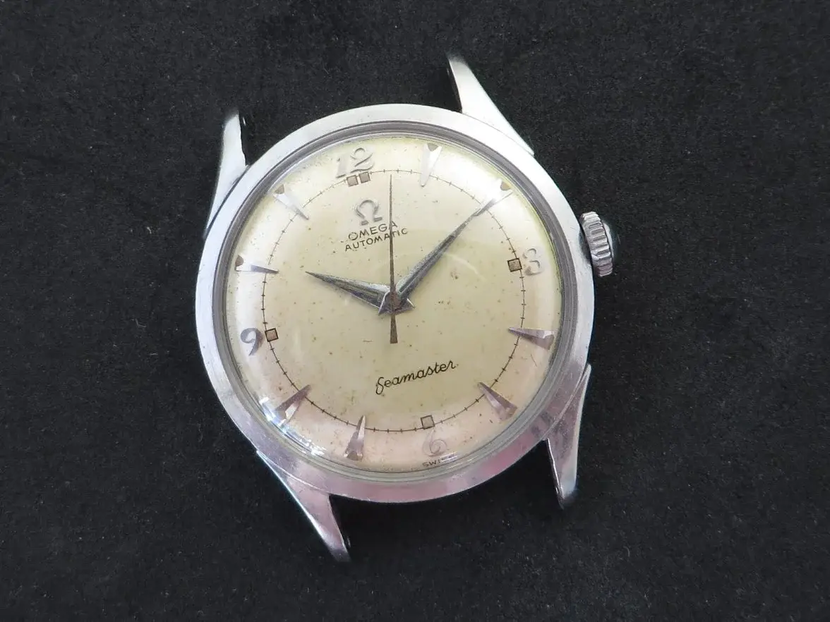

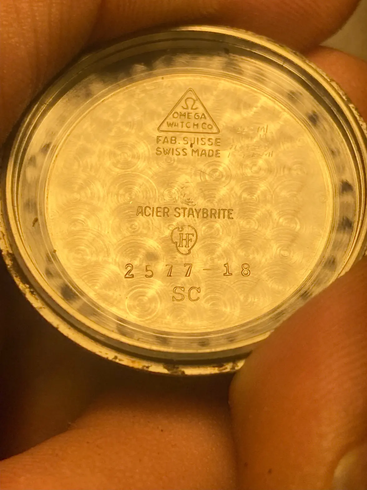

Very similar to my Seamaster cal 354 ref 2635. I'm a big fan of the cal 354 and this is a very clean example, but I wouldn't use the term "rare". Edit: Seller's scans, serial dates ~1952.

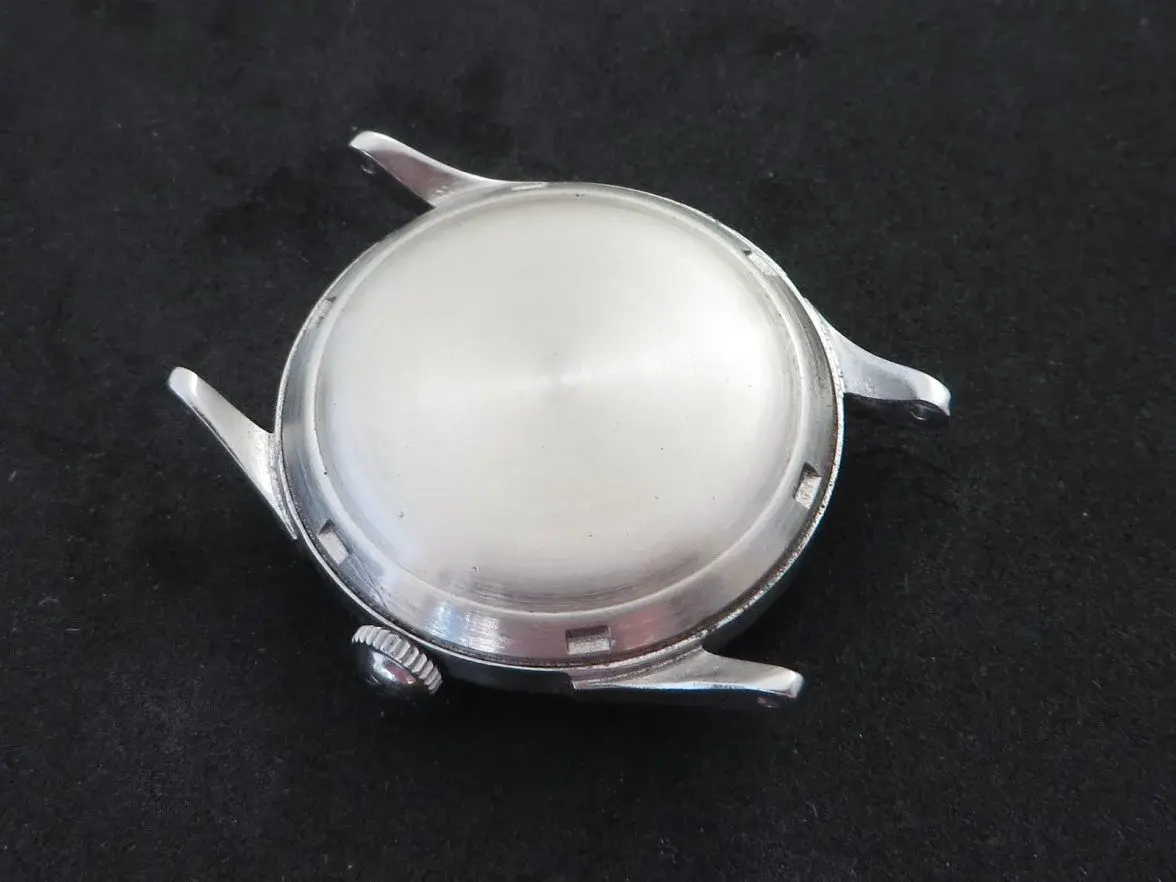

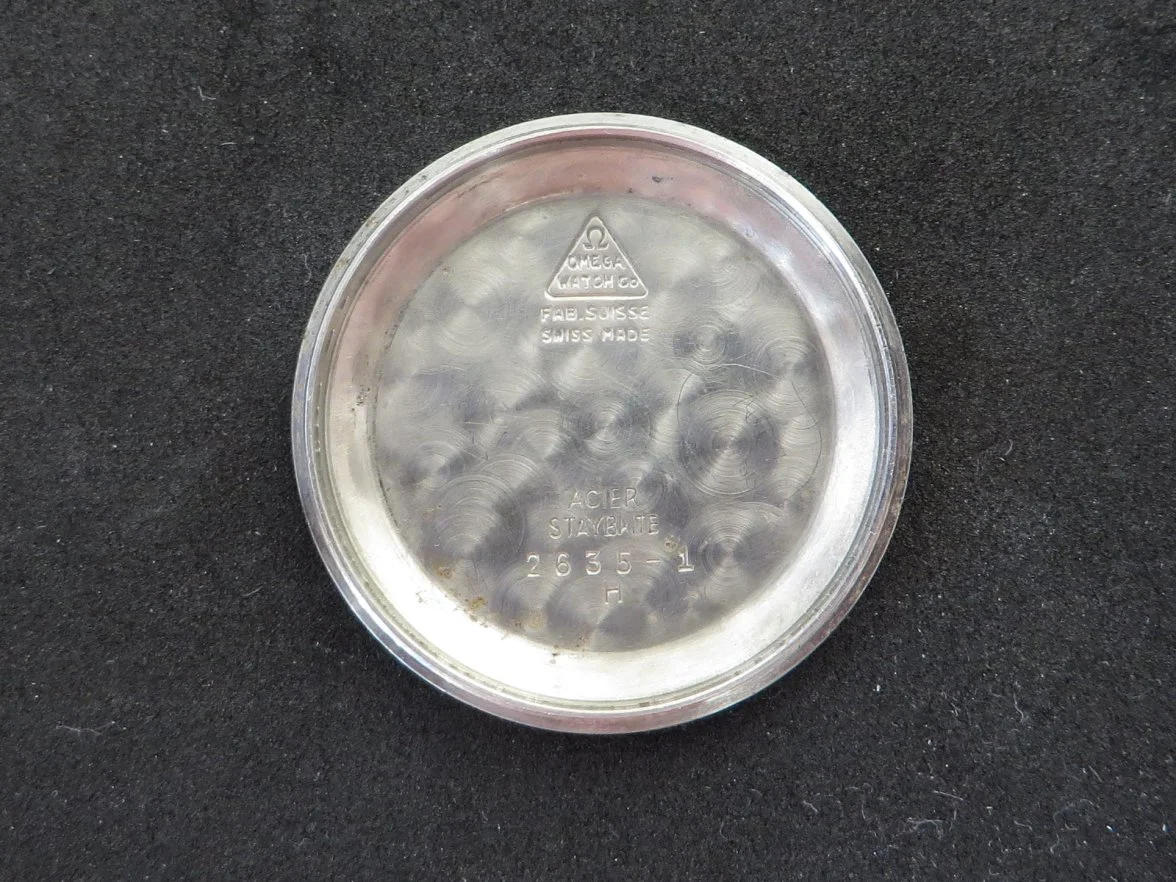

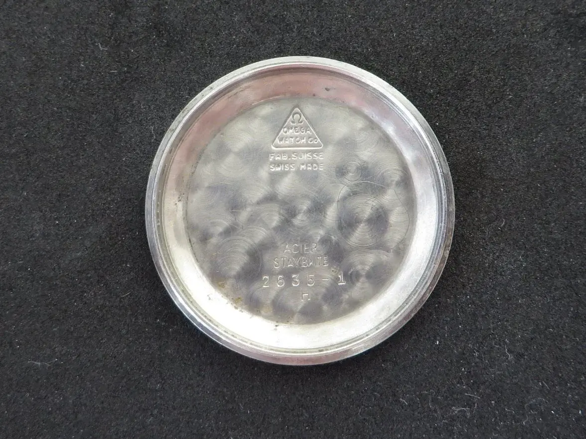

Here is some more ai slop for you sensitive types.

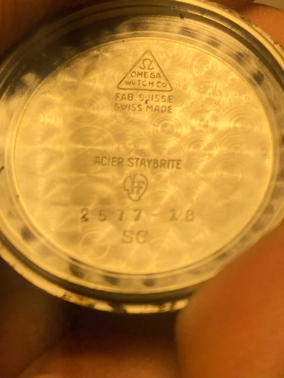

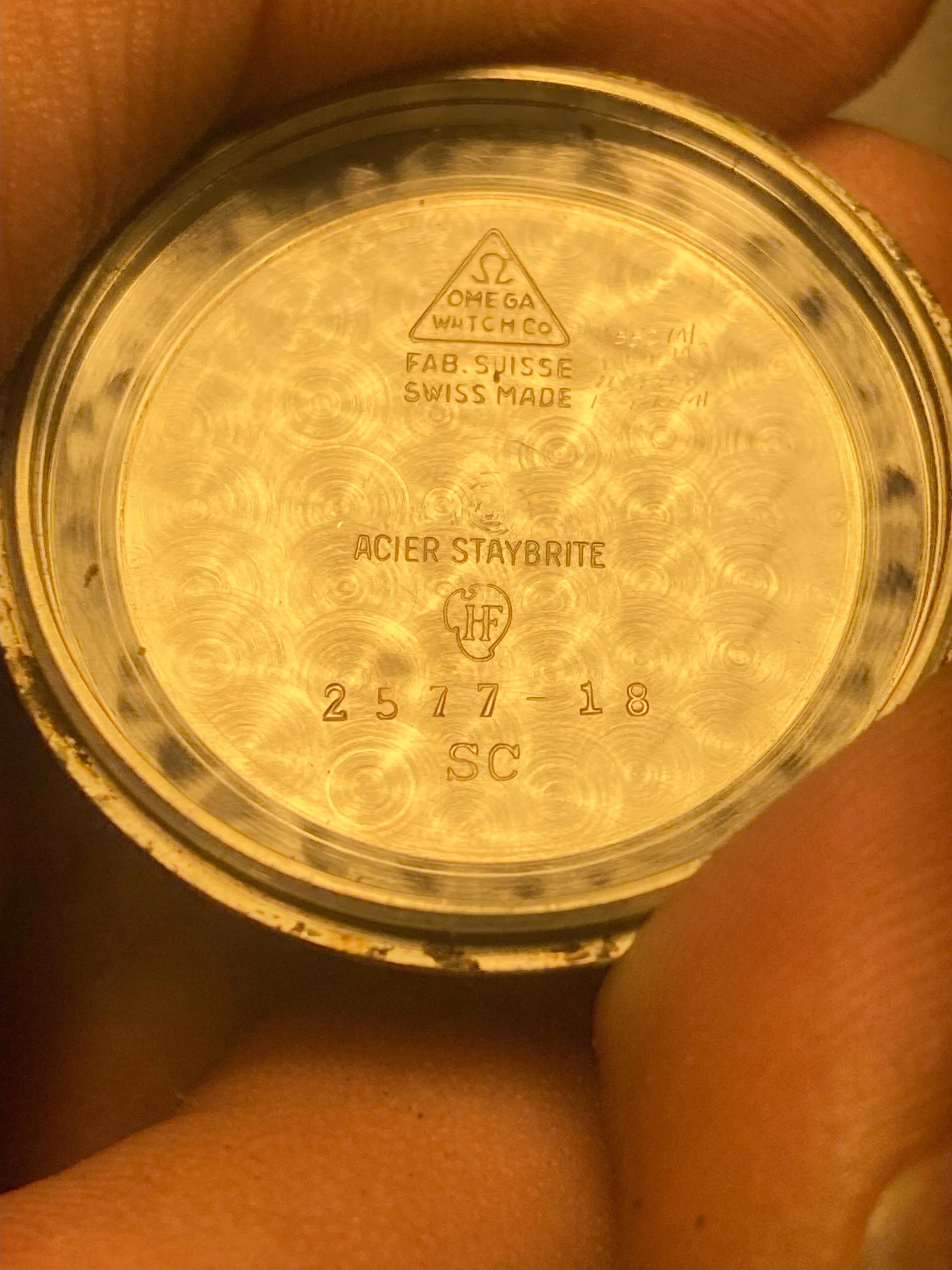

The inside of your caseback reveals that this watch is actually a Reference 2577 - 18 SC, rather than a Reference 2635. [1, 2]
The Reference 2577 is one of the definitive, earliest Omega Seamaster references. It was first introduced around 1948–1949 and features a classic 34mm case diameter with beefy, robust lugs. The "-18" suffix identifies the specific case variation/sub-reference, and the "SC" engraving stands for Seconde Centrale(Central Sweep Seconds). [1, 2, 3, 4, 5]
Caseback Analysis
  • Case Material: The engraving "ACIER STAYBRITE" indicates that the caseback is made of Staybrite stainless steel, a high-quality, corrosion-resistant alloy used by premier Swiss watchmakers during this era. This lines up perfectly with the steel interior you see here, contrasting with the gold-capped exterior shell noted on the lugs. [1]
  • Maker's Mark: The tiny stamped symbol featuring an "HF" inside a heart shape is the hallmark for Huguenin Frères, one of Omega's elite historical case contractors famed for making exceptionally tight, water-resistant watch cases.
  • Verification: The typography, the shape of the Omega triangle logo, and the circular perlage (engine-turned) finish inside the caseback are all correct for a genuine 1952 factory piece. [1]
Collector Context & Value
Because this is a Ref. 2577 paired with a 13.3-million serial Caliber 354 bumper from 1952, it sits in a very desirable sweet spot for vintage collectors. Depending on the styling and condition of the front dial (e.g., standard silver, honeycomb/waffle texturing, or explorer numerals), these gold-capped variants generally command a market value between $1,100 and $1,800. [1, 2, 3]

12
You overpaid by $3.75

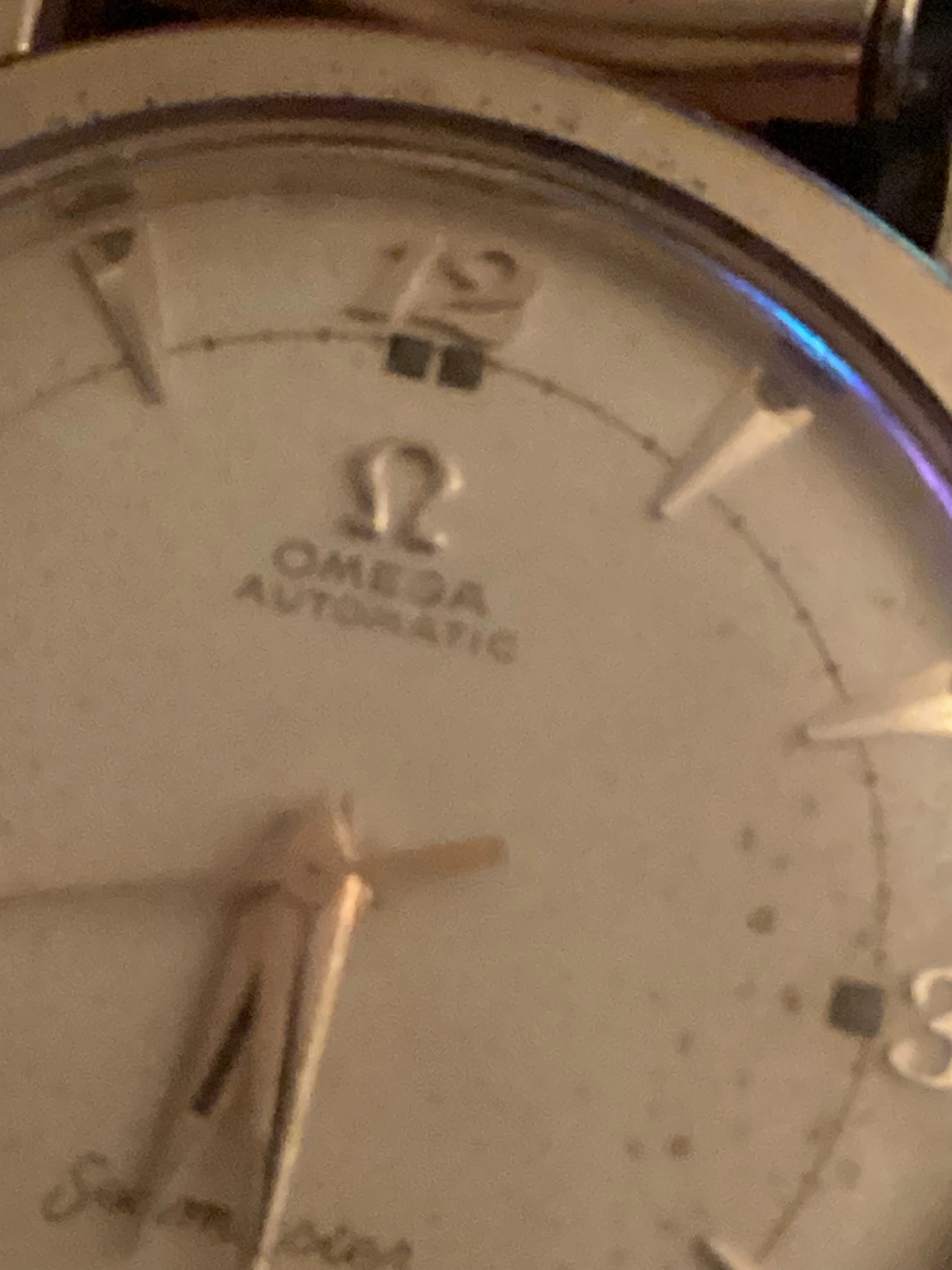

54,872
Nice find, seems to be an honest watch with vintage charm. The AI response is a bit hit or miss, and I wouldn't take the value estimate too seriously.
