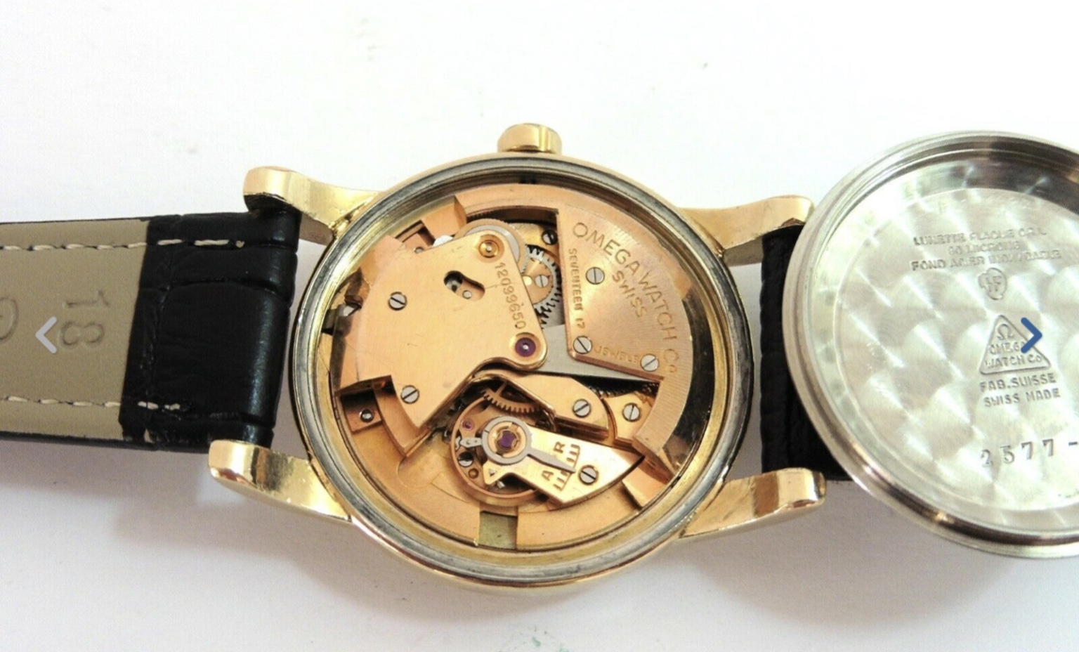

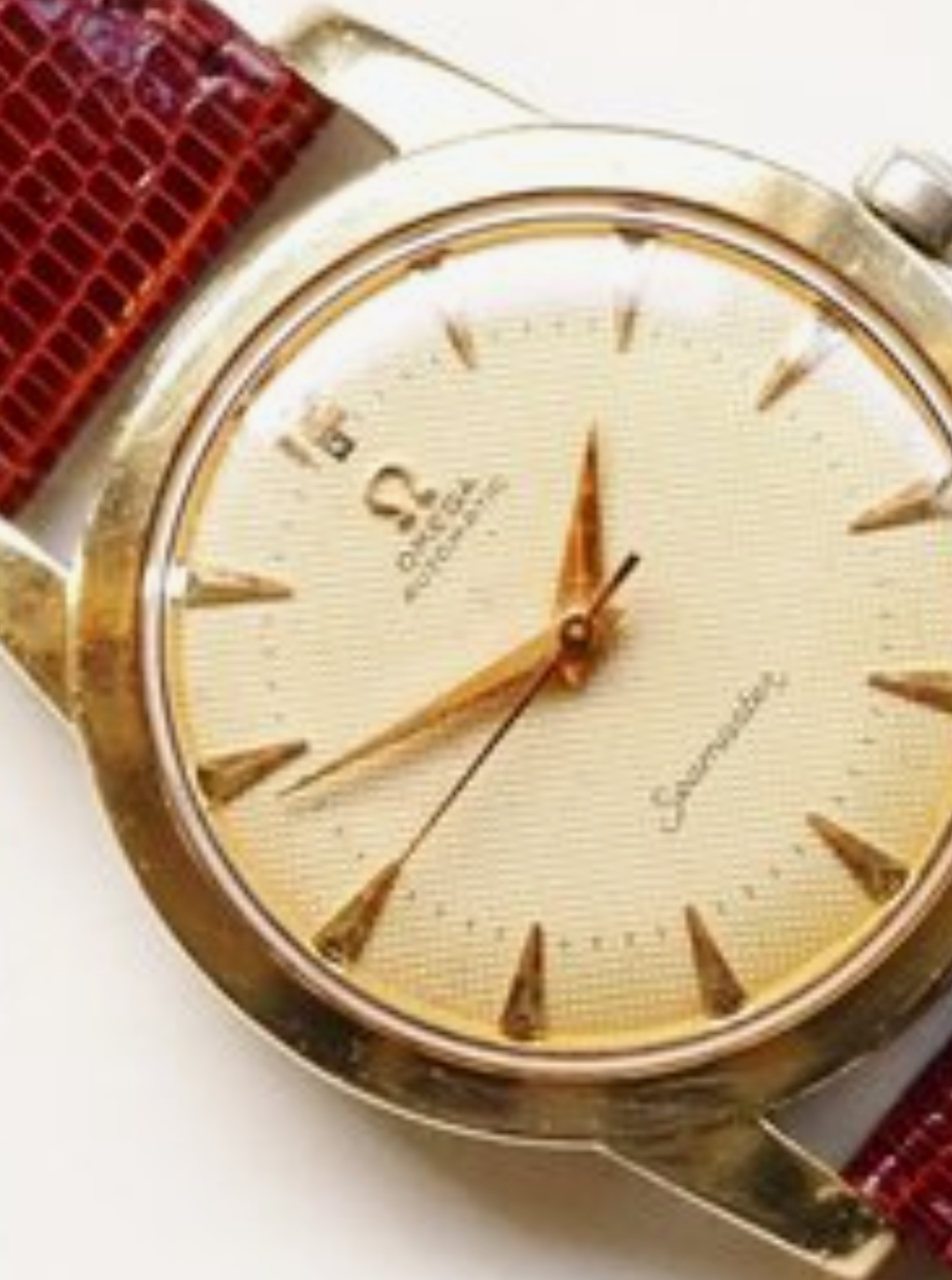

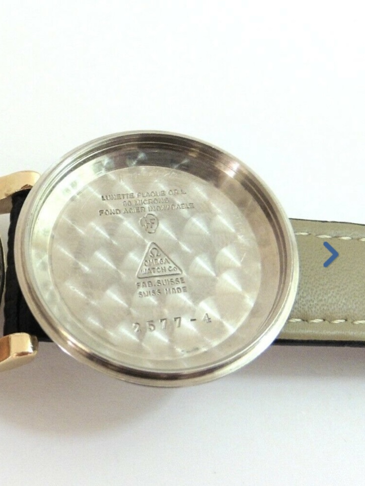

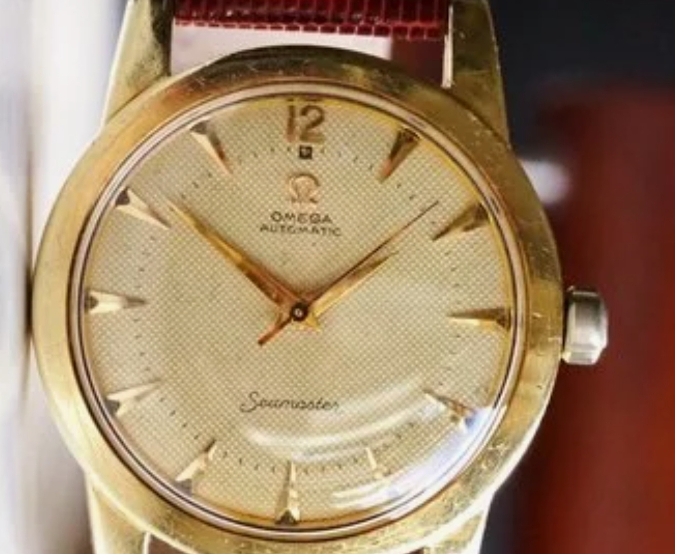

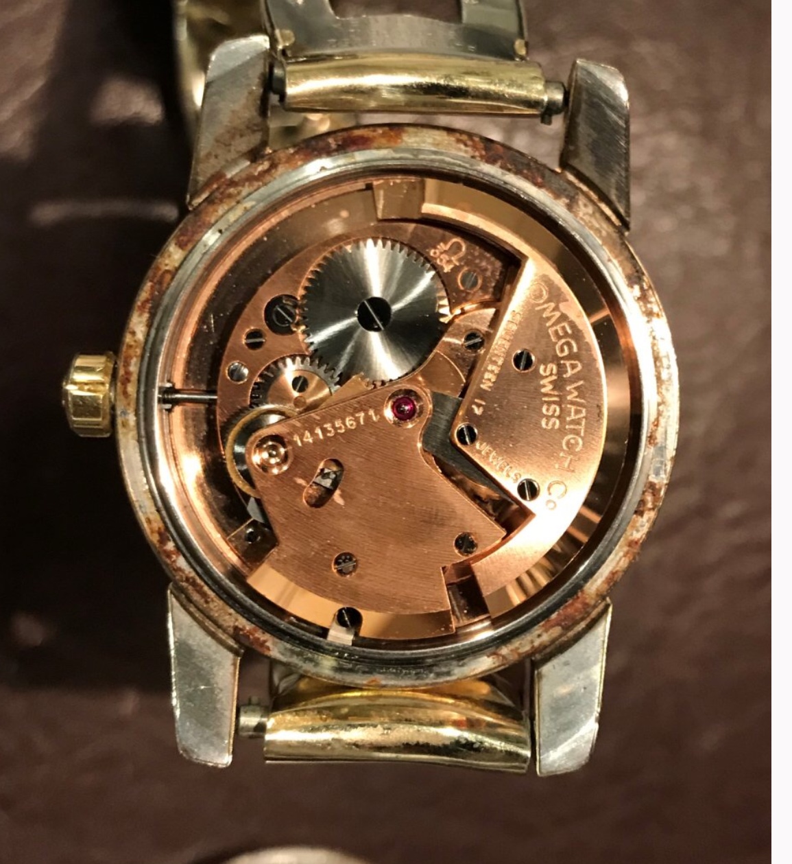

Dear forum members,
I have just registered on this forum.
I sometimes go through your interesting questions and doubts and thus gain some insight into the world of vintage omega.
On a private website I have found a 1952 vintage Omega Reference 2577 18 SC
It runs on Calibre 354.
Seller says it is in good condition, however, as I am a novice compared to you guys, I would like to ask if (~1000USD) is a good price for it?
One peculiar question is that the dial has honeycomb and numeral 12 only, other indices are just marks.
Is this looking genuine to you guys.
Kindly advise.
Seller says it was recently serviced, a cliche, but yeah...

Looks OK. Sharper pic wanted 😉
3,592
13,543
I hope the quality of the watch doesn’t „match“ the quality of the picture.
Better pictures needed for evaluation. This way, all we can do is guess.
A couple thoughts from the one bad pic alone:
-1000$ for a gold-capped 2577? Even in good shape that’s an optimistic asking
-is the minute hand too long? It’s protruding the minute ticks
-12-only is a known configuration and nothing to worry about
-the crown likes like it’s lost all gold-plating and would need replacing. Not a big issue, but should be kept in mind. For 1000$ I‘d expect better.

Welcome aboard the good ship OF - I like your handle btw. Of course more and much better photos are needed, but for now, do I spy empty spaces where lume pips once lived? Hard to tell, but that would corroborate the point about possibly changed (and lume-less) hands.

Thank you. Will keep in mind. It is a screen shot thus bad quality pic.
Those black quare where once lume lived also set me off...

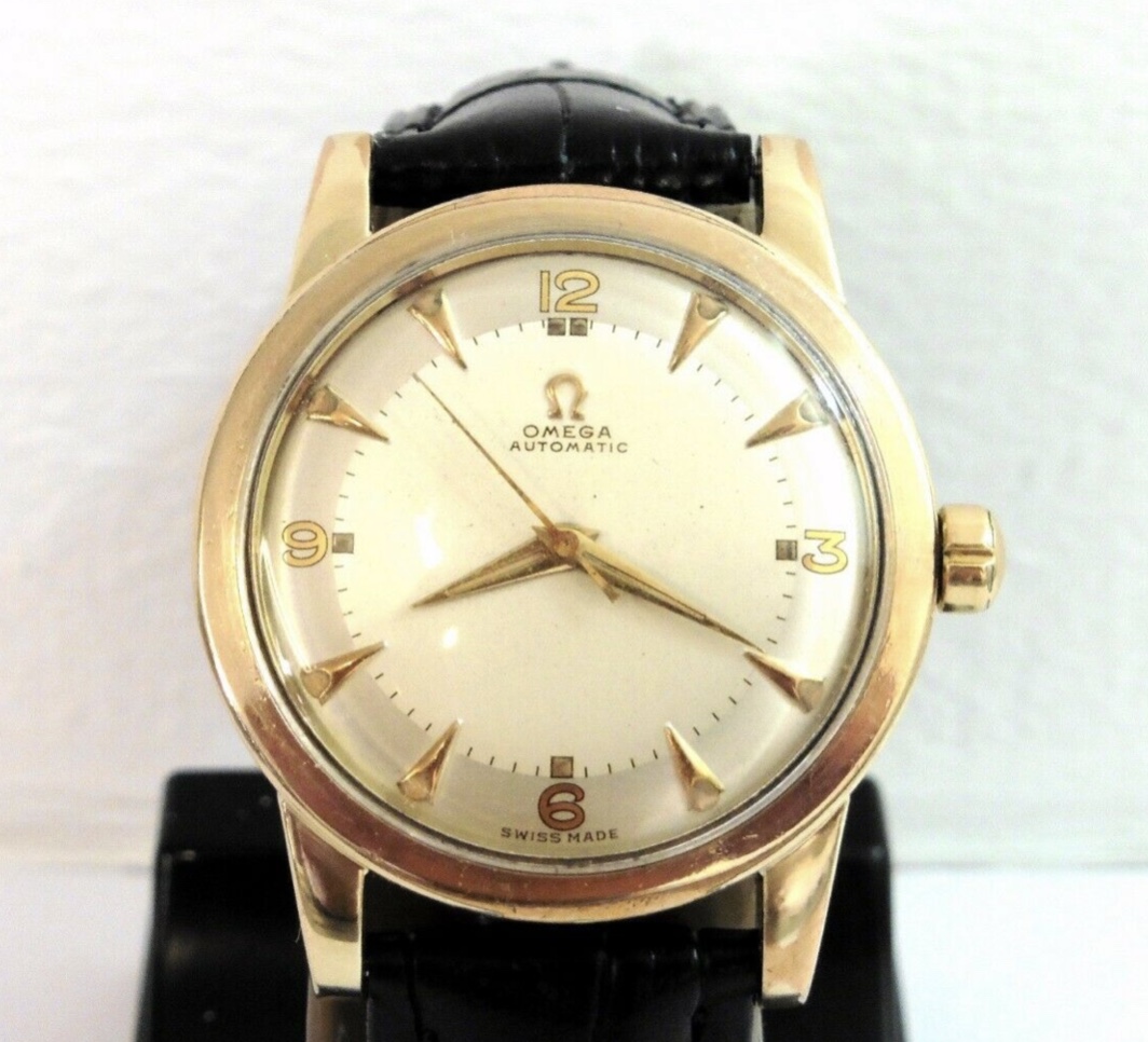

My 2577 for comparison although it has a 351 movement.

Thank you
The one I have been looking to buy ia 2577-18 SC automatic produced in 1952.
It has honeycomb dial.
By the way, yours looks quite nice. I couldn't find 2577-18 on Internet or on official omega website for vintage watches references. Thus, the doubt...

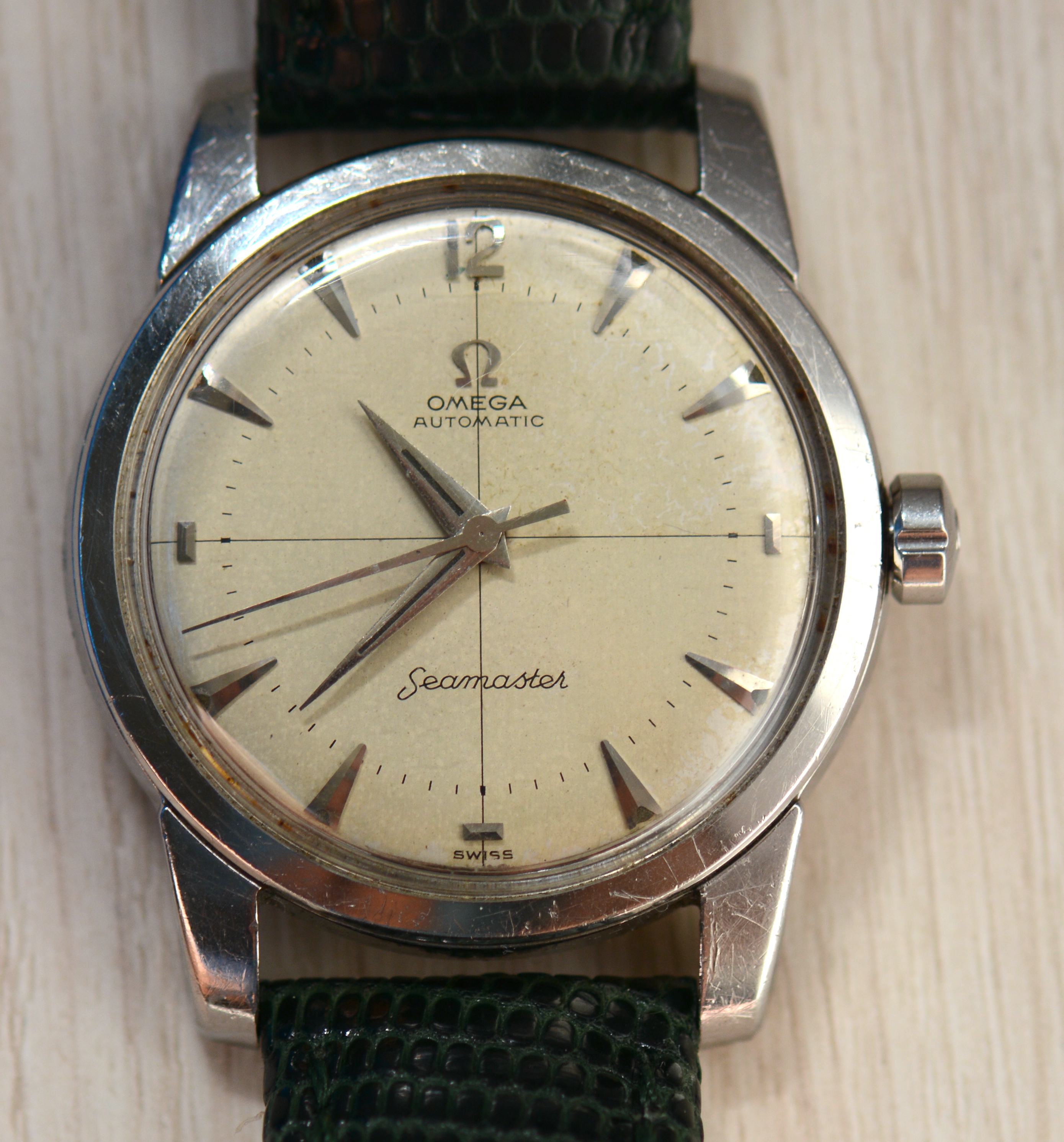

There are hundreds of different configurations. 3-6-9-12, 12-only, even numbers only, all kinds of different indices, dial structure and colors, etc etc. Not all 2577-18s will look identical - quite the contrary, actually. The watch on the OVD is just an example.
Upload clearer pictures here and you’ll get a good evaluation. Don’t, and we’re left guessing.
Regarding the missing Swiss Made: It’s often hidden under the tension ring of a replacement crystal that’s not quite the right size / an Omega part. It might also be missing, which would indicate a redial. Again: Impossible to tell without clear pictures.

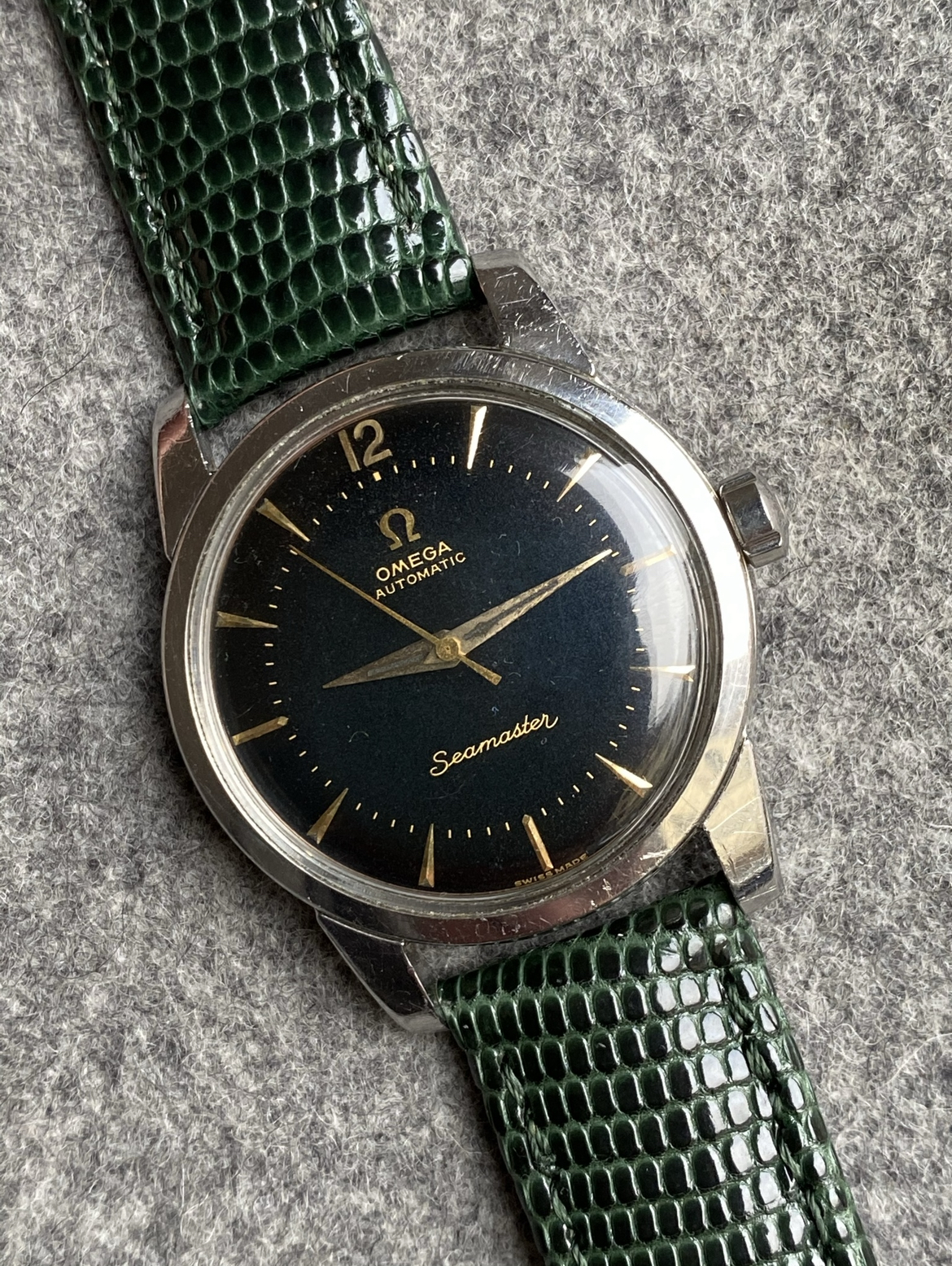

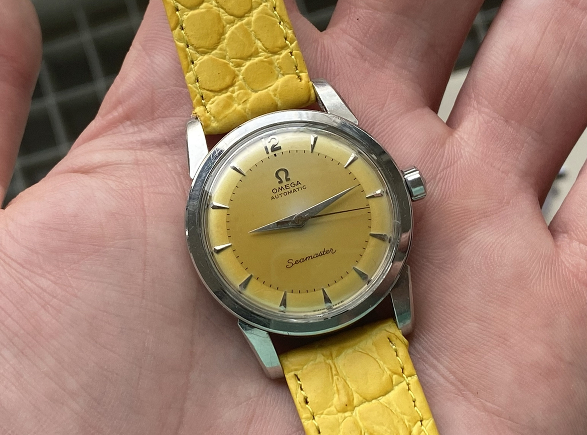

Just because we like pictures around here, here are three examples I’ve found in my own pics of 12-only configurations on 50s Seamasters:

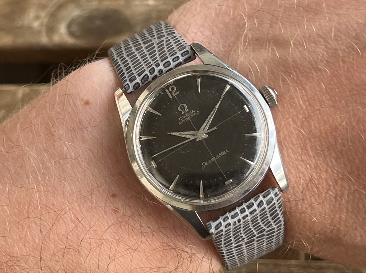

Here's another of mine with just a 12 at the top of the dial, and a 354 movement. But it is a 2767.
Mine also has 'Swiss’ at the bottom but it is hard to see because it’s partially concealed by the tension ring.
The yellow strap with that dial is an arresting combination. Really makes the watch pop.

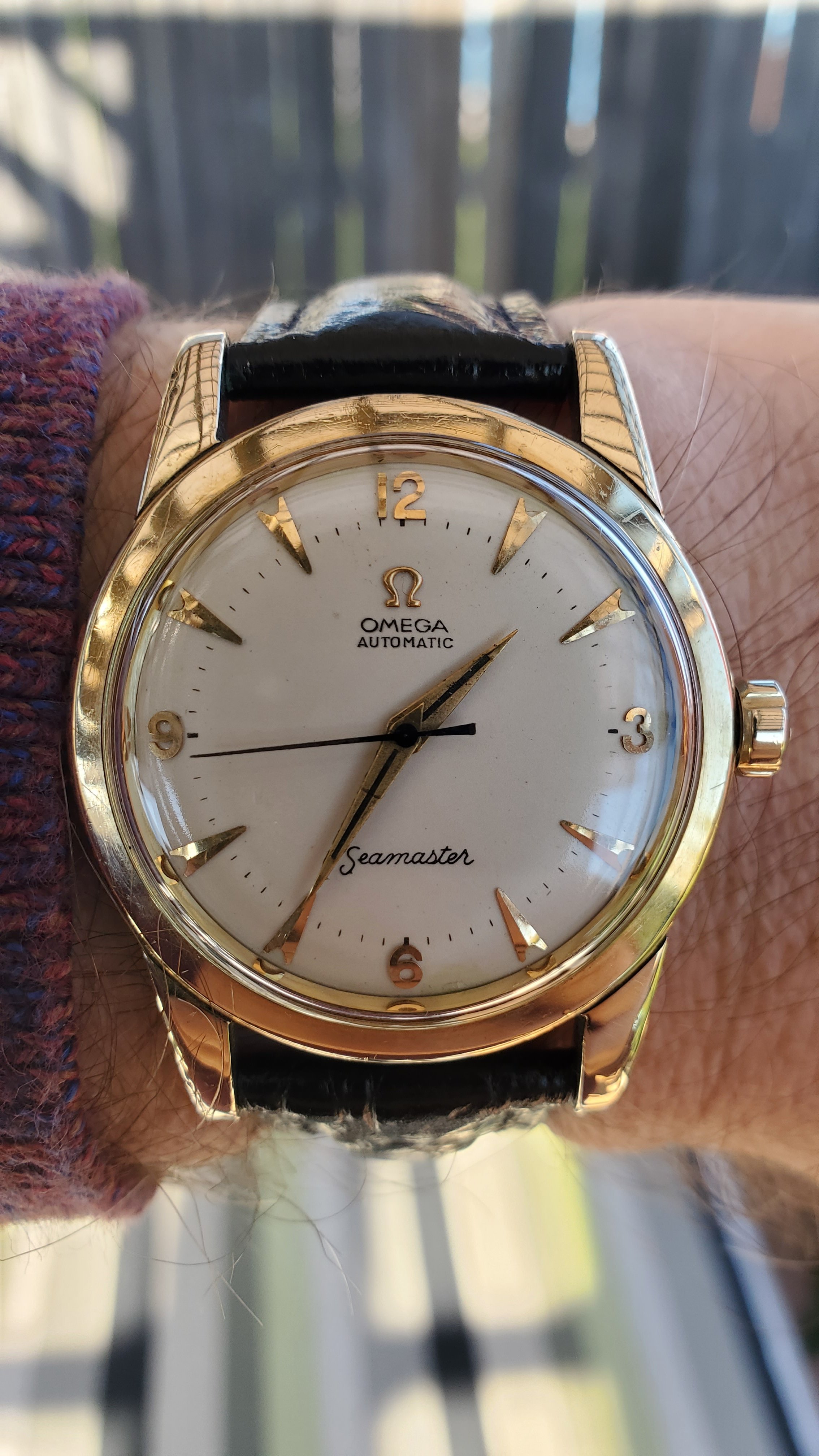

I too think the minute and second hands are too long. Here is my 2577-11
