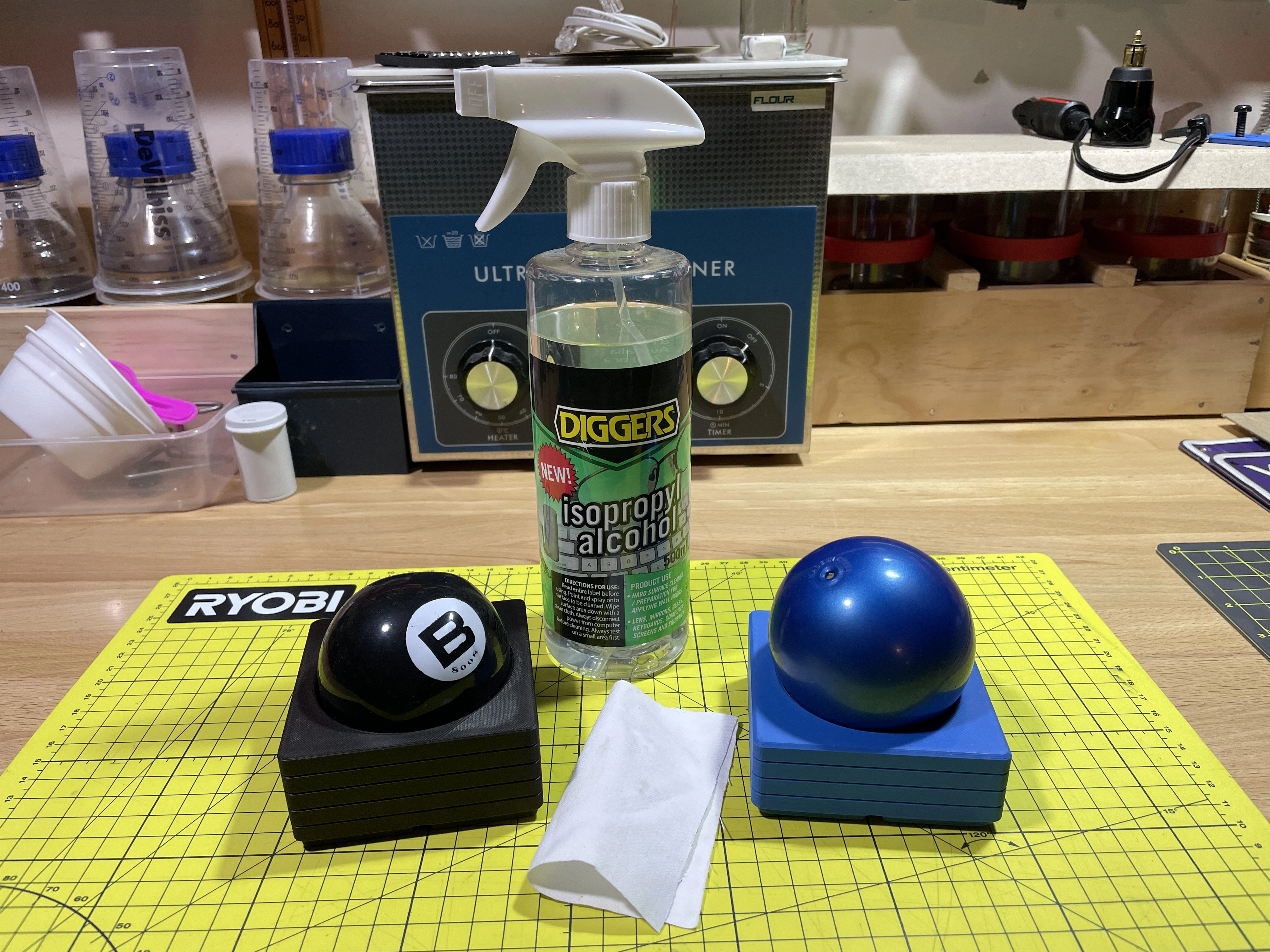

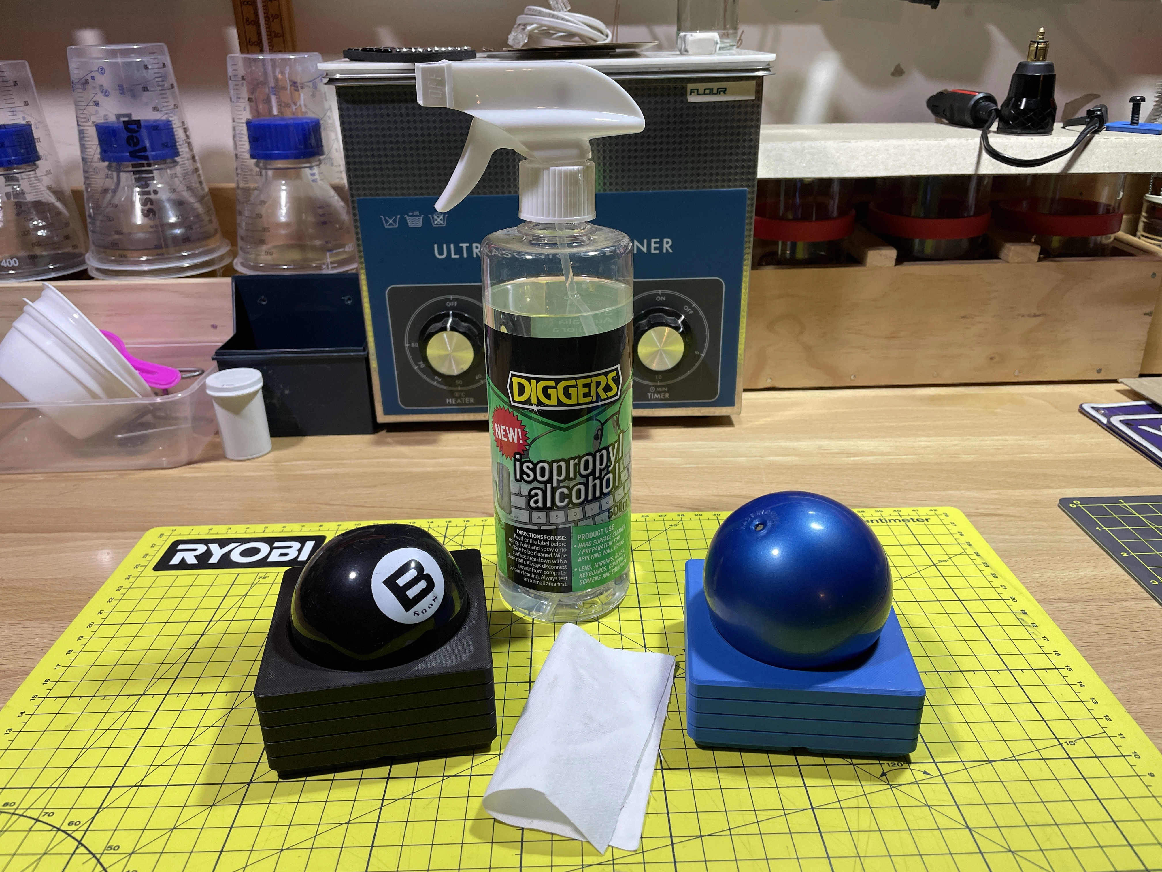

They do a great job, just make sure you keep it in a plastic bag or something so it doesn't get dusty and maintains its "tack".
2,298
3,155
Even more curious now! 馃槵
18,776
39,021
I've never found the need to put my balls in a bag.
They sit on the bench and prior to use, I give them a small spritz with IPA.
Just a wipe with an IPA damp lint free cloth (ball and the caseback) gives perfect "grab".
I must just have dirtier balls than you, in fairness it鈥檚 quite humid up here in Queensland

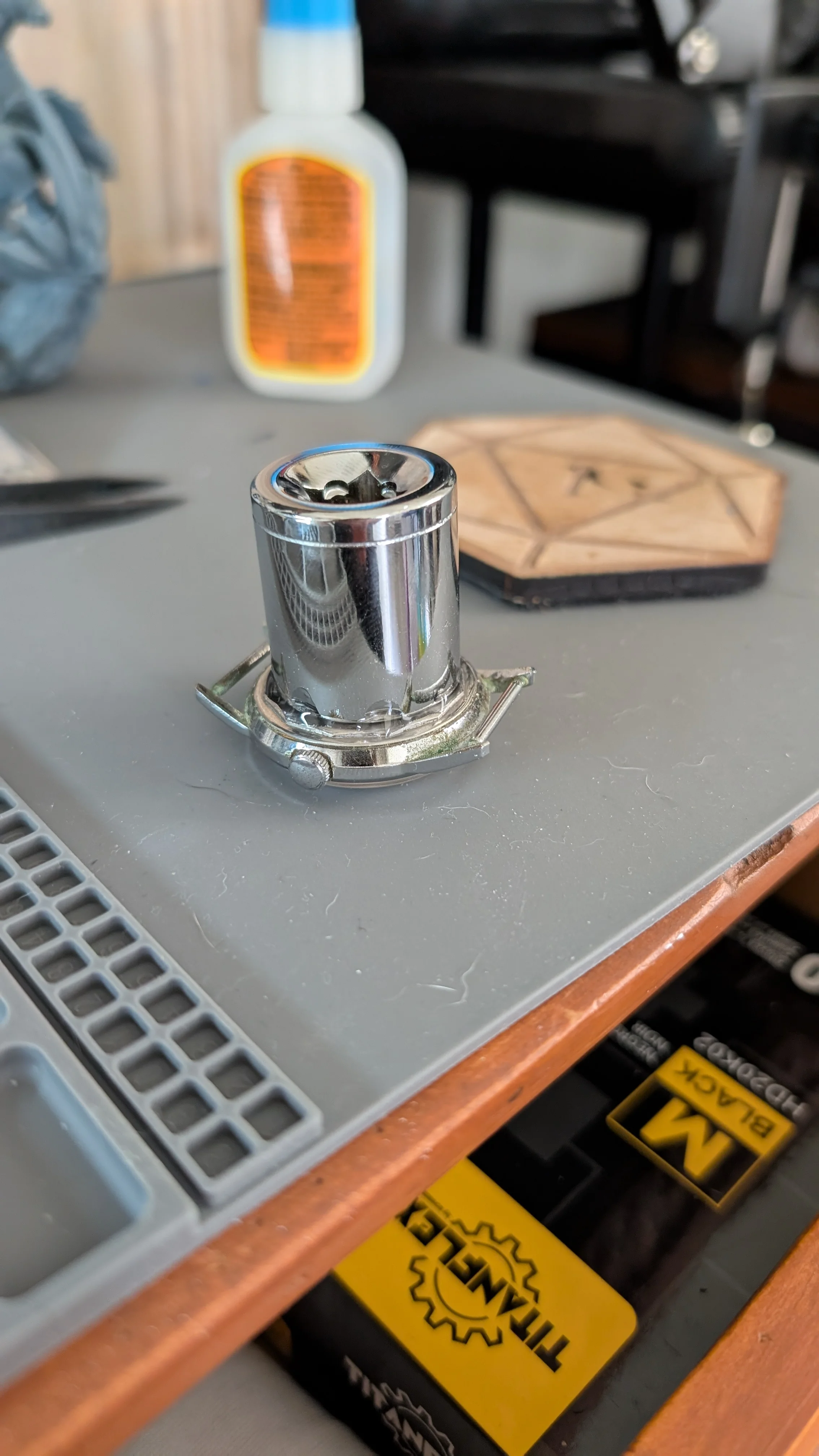

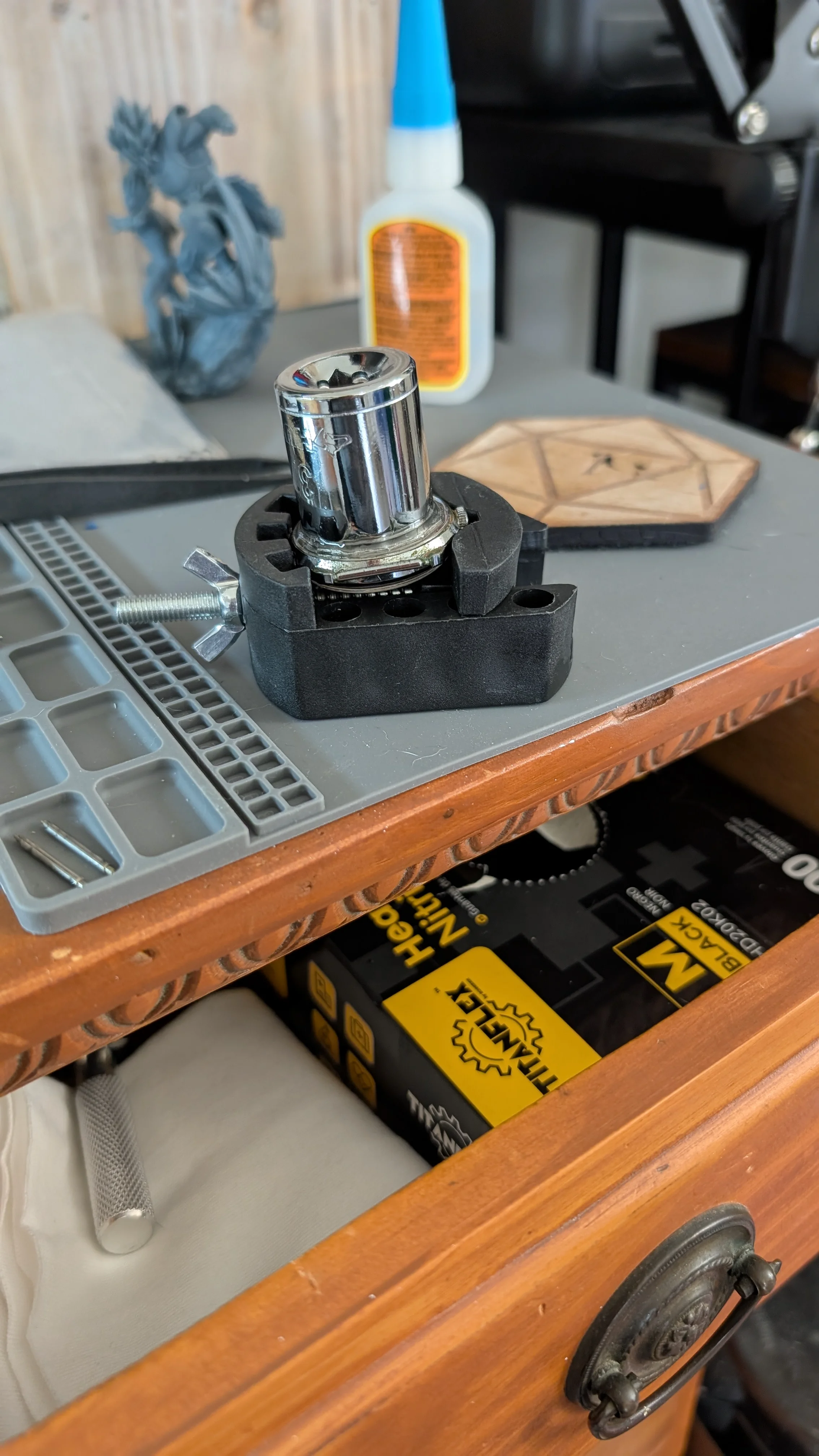

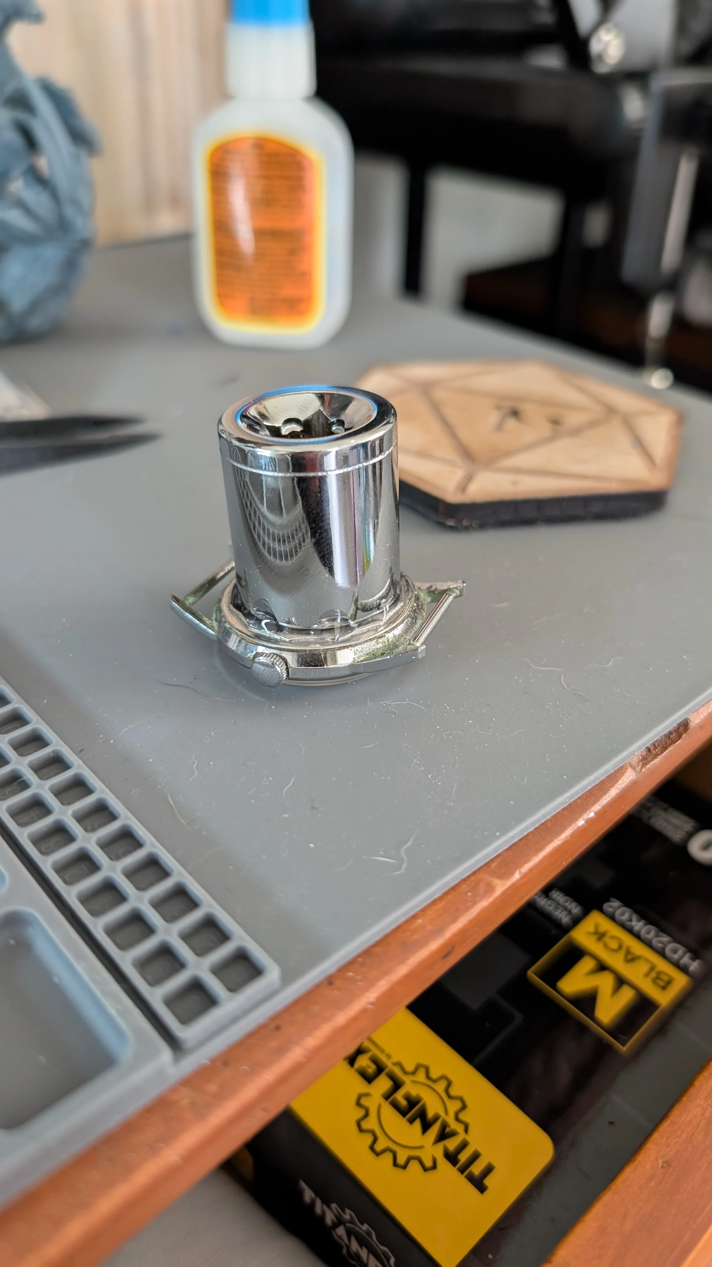

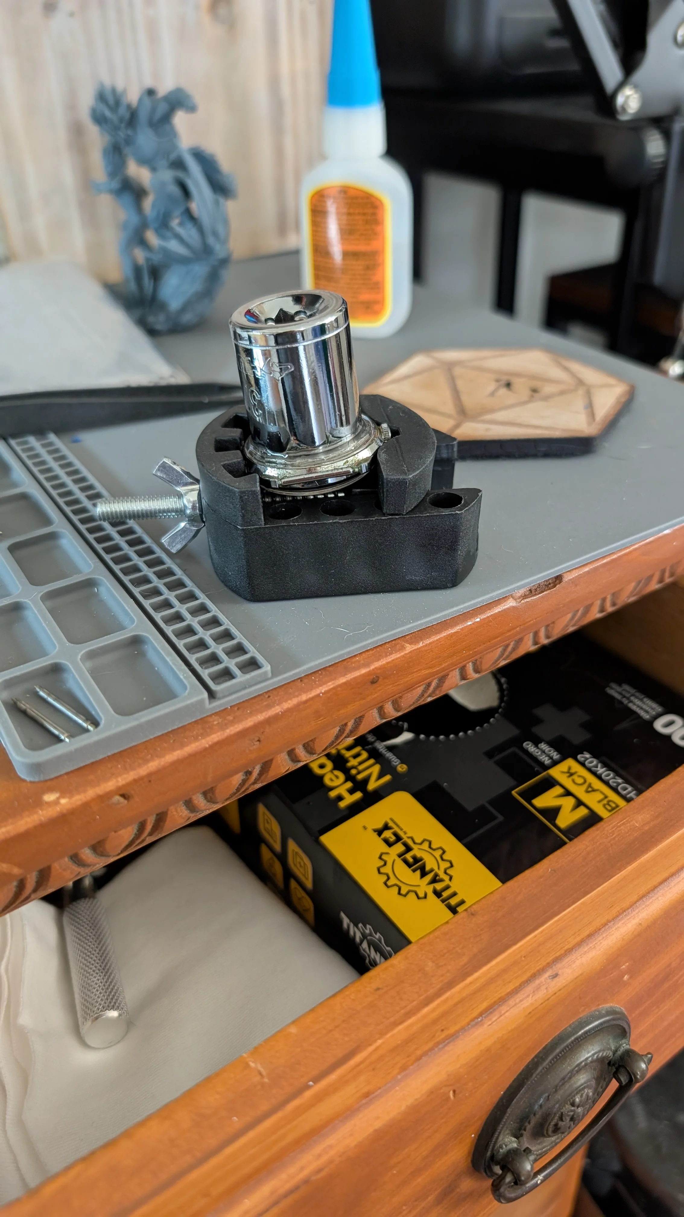

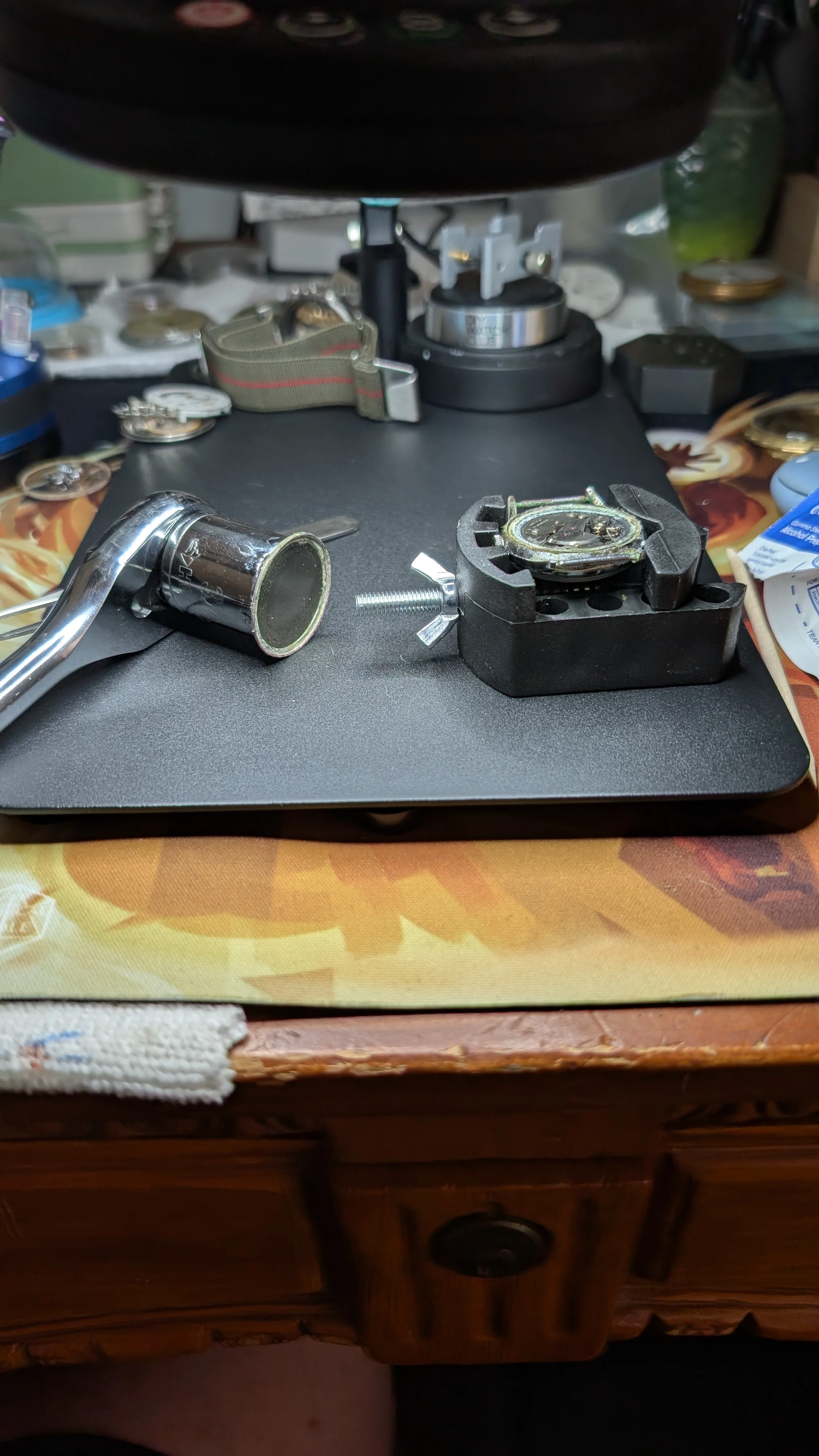

Superglue a nut to it and use a wrench
191
84

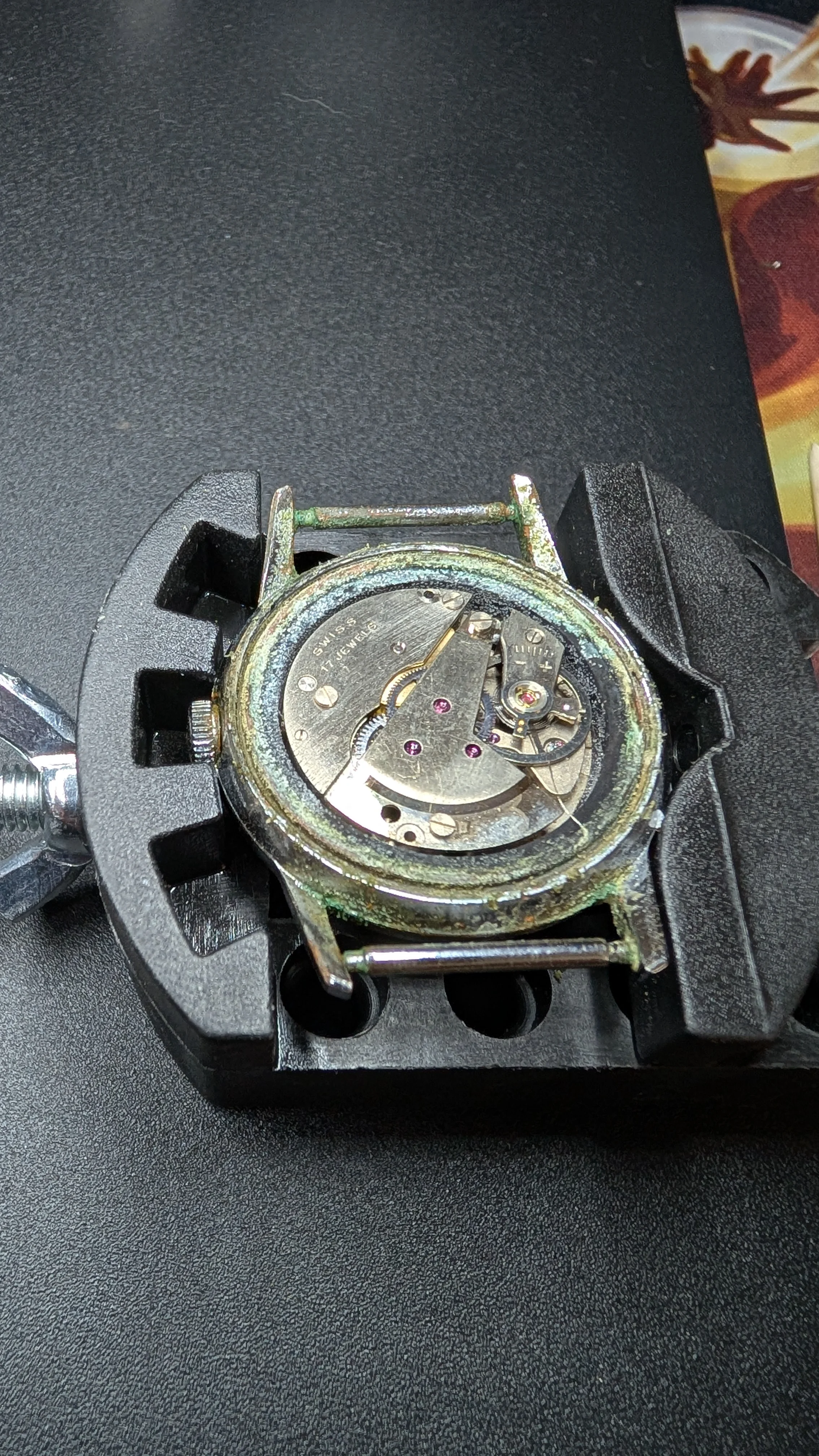

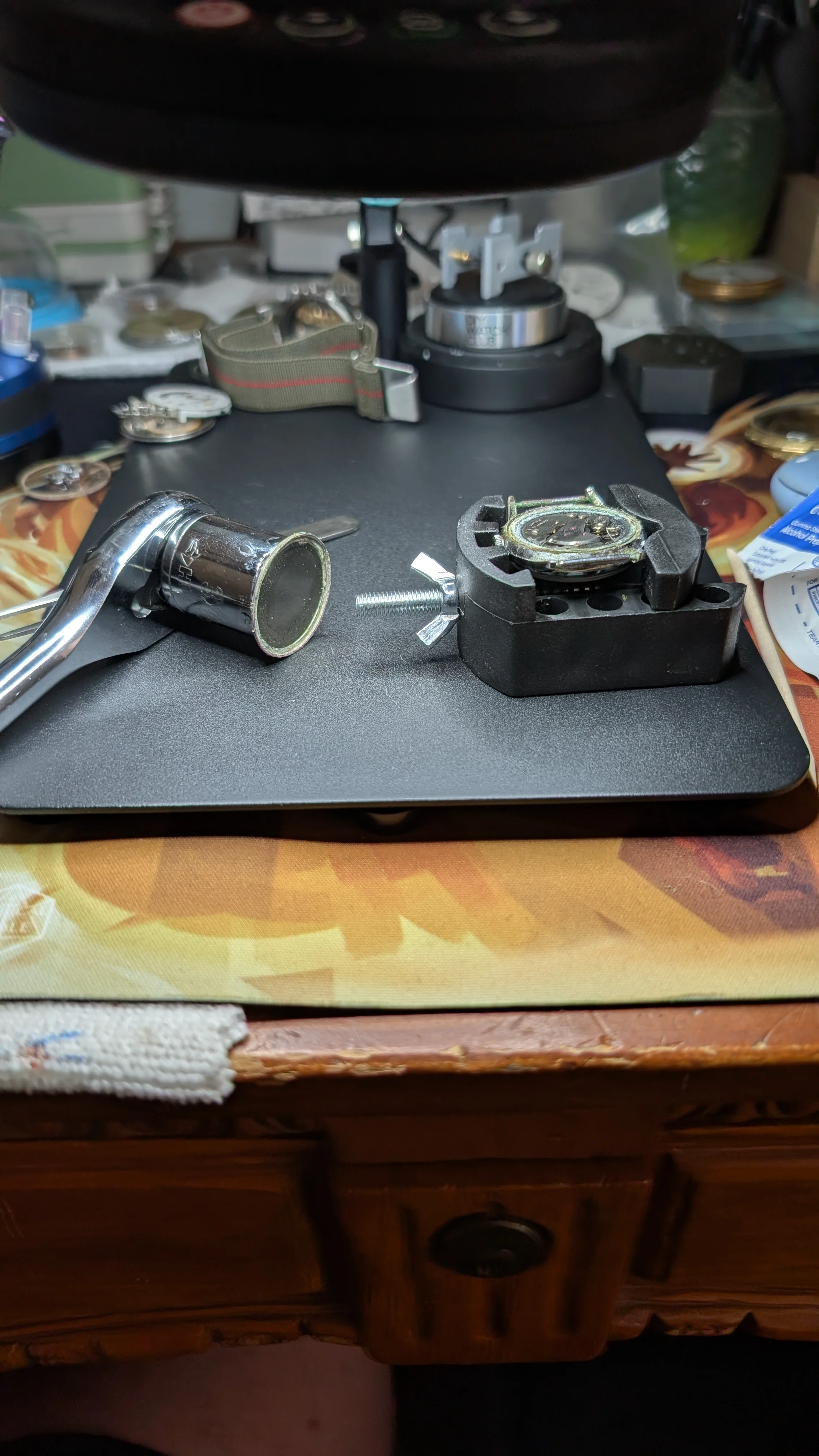

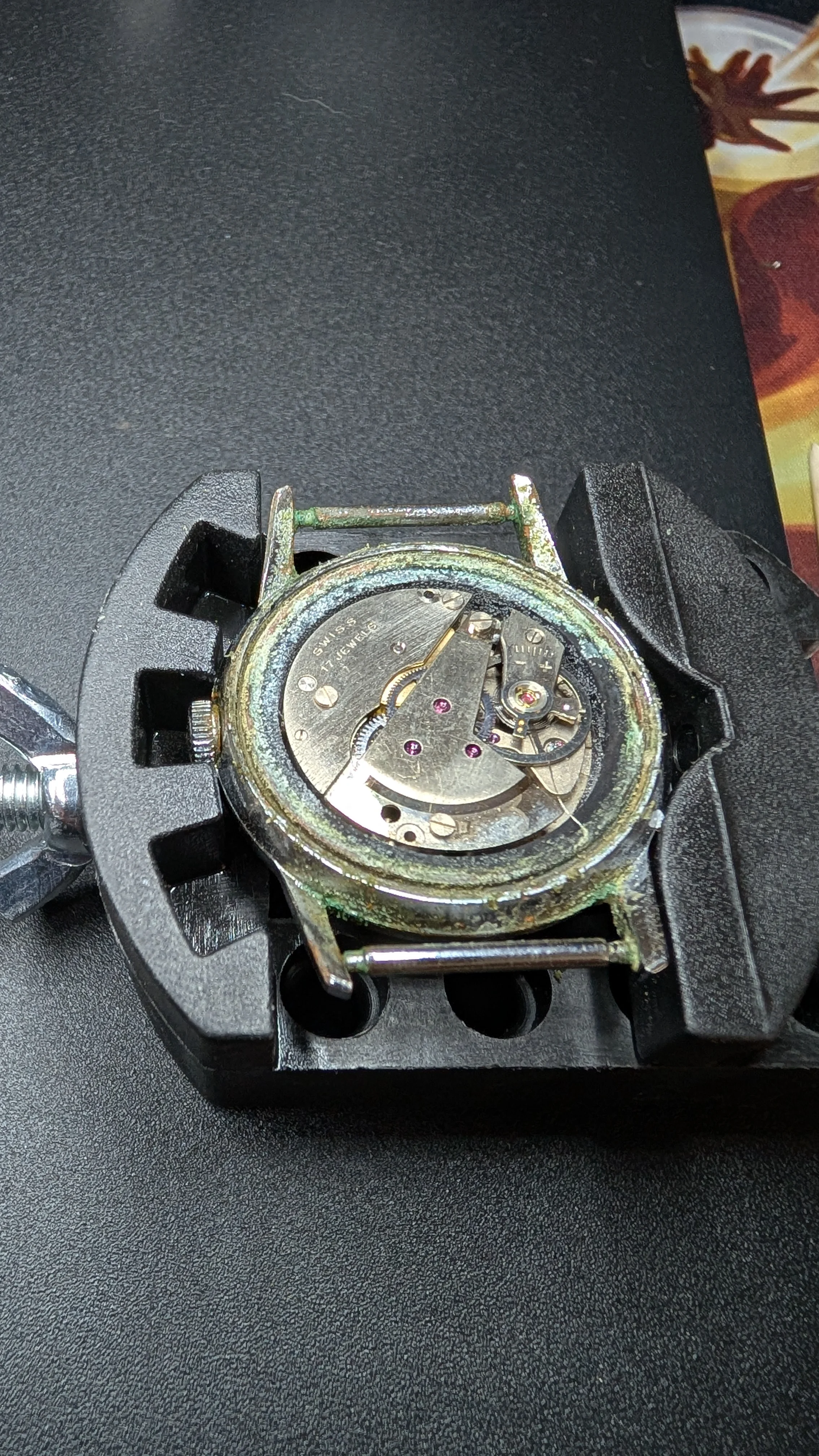

Success! But ... I'm not sure this watch is salvageable. The balance is spinning so may be something I can work with. We'll see. I didn't have a nut, so just used a socket. Still worked!
2,639
2,818
Glad you got it! The movement itself doesn't look too bad, but a cheap one, balance looks like a pin pallet I saw previously, but obviously can't tell from that.
Discoloration is all green, which means it is from copper coming out of the base metal case, so not necessarily that water got in, so much as touched the gasket.

Good to know. Since I'm going to try to electroplate this case, seems like a good candidate if I mess it up. I like the face and the challenge so if I can restore it, though cheap, it'll be priceless to me. 馃槀

Projects are their own reward! I'm trying to stick to movements with commonly available parts in case I lose them/break one.
Though even if I can't fix it, it's a fun time anyway!
