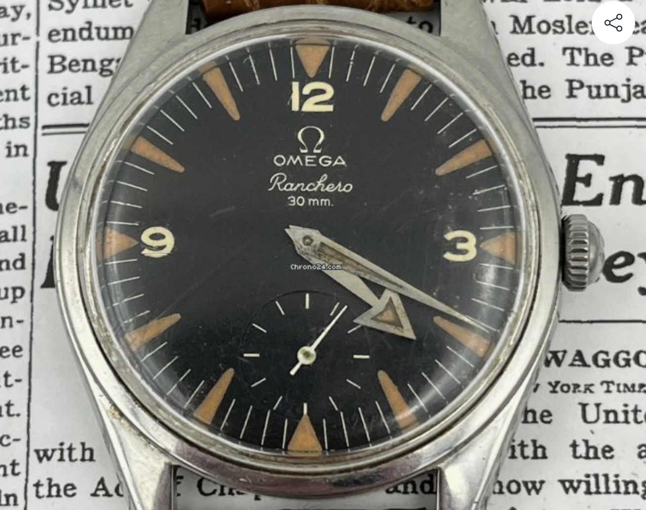

Hey Guys,
what you think of this? No seriffs, consistent lume, fonts seem right. Just looks a bit too nice in my opinion?

Unfortunately you seem to be right. It seems to be a redial, the luminous markers are too long and too "sharp" Not even sure about the hands. Hands (at least hour and minute) are not original. I am more experienced with the 2990 Ranchero (low second), but I believe that the second hand is also not original

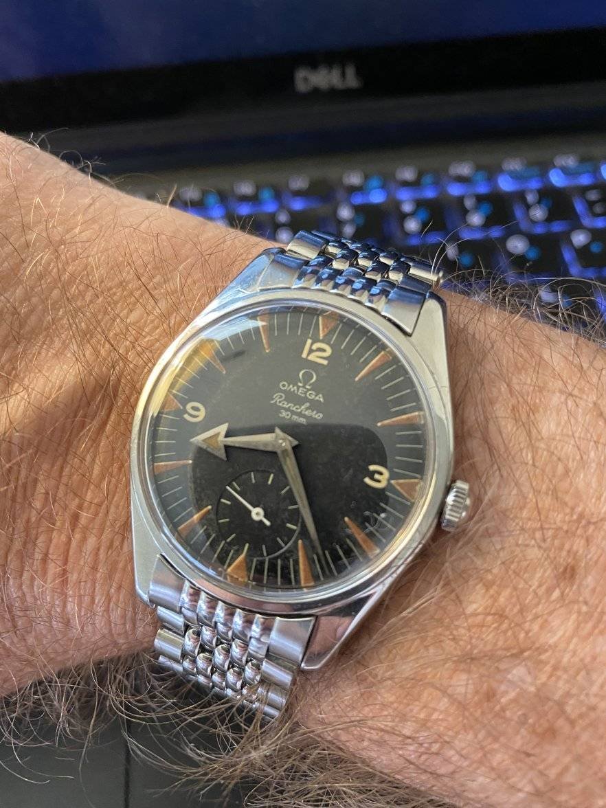

Hi everyone, I'm looking at this 2990. I don't think it's a redial, but me and @gbesq are doubting whether the lume is original or redone. What do you think? Perhaps a geiger counter test will tell us more, but not sure how many sellers have on at hand?
https://www.youtube.com/shorts/7ZigNIy20iU?feature=share here's a video of it. I've tried to embed the URL but I keep getting an error.
122
60
From what I can see I would consider it to be the original lume. The paint is precisely on the markings, usually repaints are rather badly done.I have a similarly patinated lume on one of my rancheros. On the 8hour marker the lume looks a bit wavy on the edge but I guess this is an optical aberration on the pictures coming from the scratches on the glas. UV light would also work as a first test. The lume should glow up shortly blueish and the brightness should vanish instantly (<1sec) after UV is off. You could ask if the seller has a UV light. How is the overall condition of the dial. Guess most scratches are on the glas?

Thanks- i must say i was closer to saying original lume rather than relumed. Perhaps someone else has a different view? And yes, scratches are on the glass so I think dial is in fairly good shape.

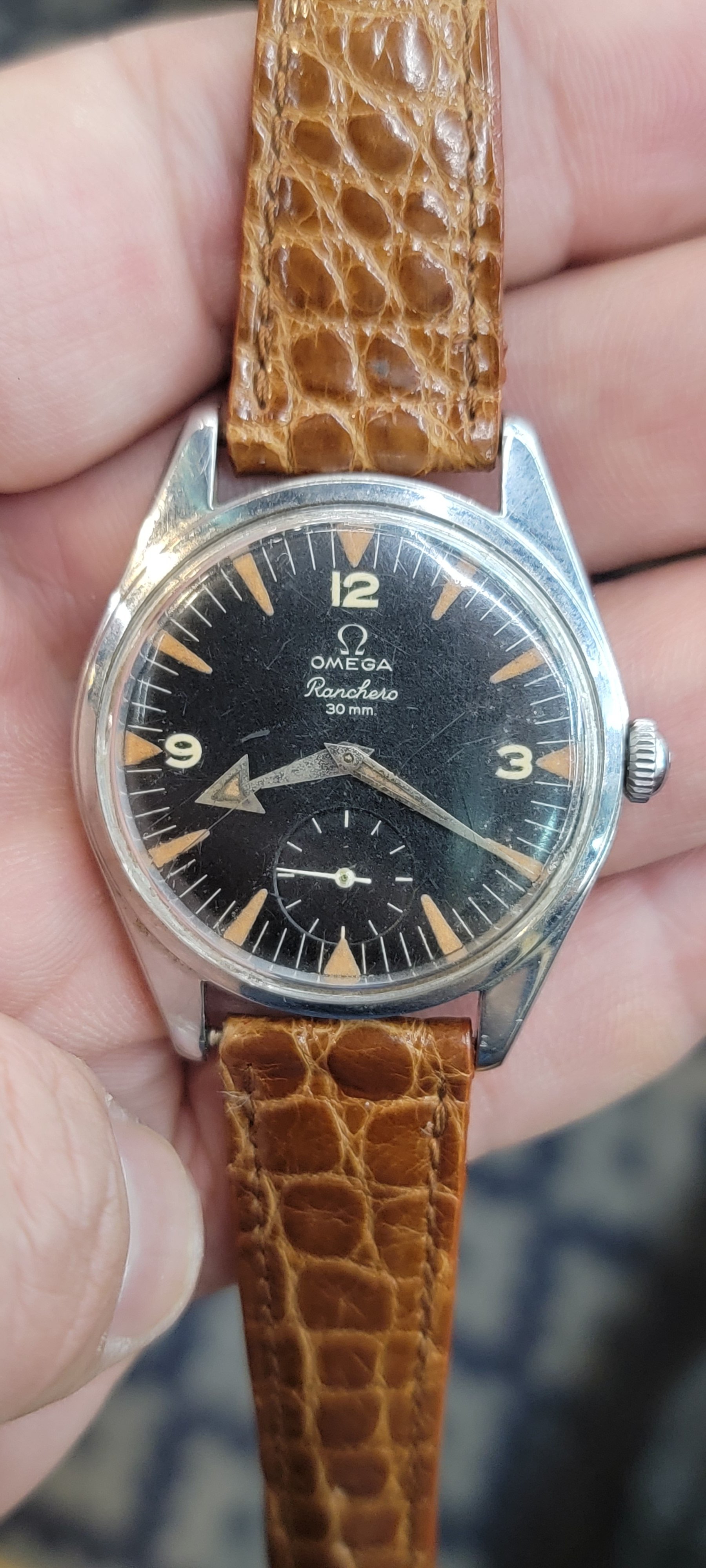

I’ve compared the photographs my Ranchero. My only query would be that the thin ends of the lume are more rounded than they should be. Possibly a little thicker at the perimeter as well.

I've been comparing it to other photos as well (like the one below), and I agree the markers look a a bit thicker at the top. Part of it could also be an illusion because the dark pumpkin patina of the example below does leave a less patinated small border at the outside, making it look 'sharper' than the one above.
Seller claims that it's all original, not redone, because 'his watchmaker checked it'. I am inclined to let this one go, unless a fellow member here convinces me to go for it.
