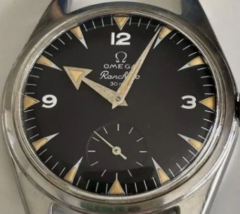

Ok, after a few years, it's time for an update as there are a couple new generations of pretty convincing redials out there.
Here's a common one:
Notice the frames/surrounds on the triangular markers...they are in the style of the white Ranchero dial, but are NOT CORRECT for the black dial. Also, notice how the "9" has uneven thickness in it's curves on top and bottom. Also, notice the subtle serifs on the "3":

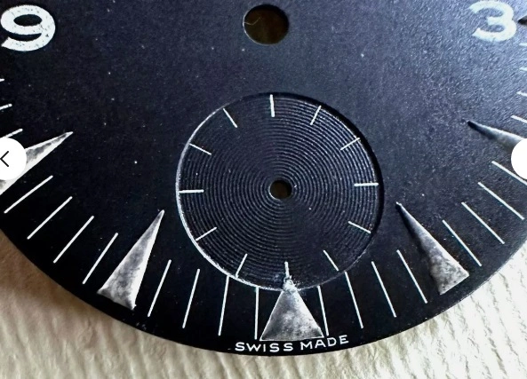

Note here that the triangle at the bottom of the subdial is cut short. that is a very easy giveaway that should automatically set off alarms for you. Also, notice how all of the arrows are far from touch the rehout...that's another sign of a redial, however, it could sometimes be due to the watch being fitted with the wrong crystal and tension ring.
and last one. this one was otherwise, very convincing:
But look carfully at the subdial: it should NEVER have concentric rings on the Ranchero:
Also, the arrow markers are just a bit too sharp and exact.

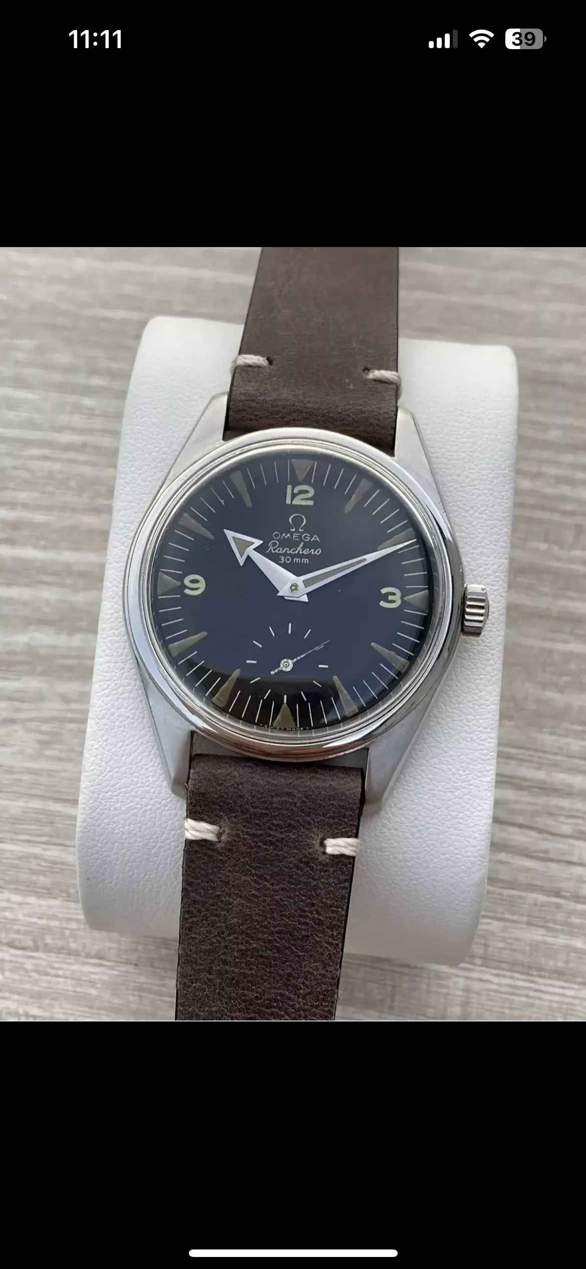

Greetings Ranchero Experts! I was convinced that I had a decent - albeit redialed Ranchero - but now I’m noticing that the the sub seconds don’t have the recessed section like the other examples. The sub seconds appear to be flush with the rest of the dial. Any thoughts on this?
122
60
Good morning, I am sorry to say, but I do share your fears that the dial is not original. Unfortunately the list is slightly longer. Both hands (hour/minute) appear to not be original, they are both too broad especially at the basis. The lume of the minute hand is broader than that of the original hand and it should end more sharply on the outer edge (yours appears little rounded) - maybe the hands come from a 2996. The lenght though quite wll matches the origlnal. Hour hand should just touch the 5min markers. And the corwn isnt the typical boulder-head. However, this is definitely not the worst re-dialed and re-equipped Ranchero I have seen.
I don't understand the question. You say you know its "re-dialed" (it is),
so what's your concern? That your redial doesn't have recessed sub second
area(like other examples of what)? At least you knew what you were buying.
yes, the latter
15
27
thank you, I appreciate your reply very much.
15
27
I see it's on ebay now.
Had a feeling you were testing the waters
Yep, added it at what I think is an appropriate price given the redial. Happy to take any feedback on the price point. Learned a good lesson! Will pony up the 8-10k and do it right as I want an original.
