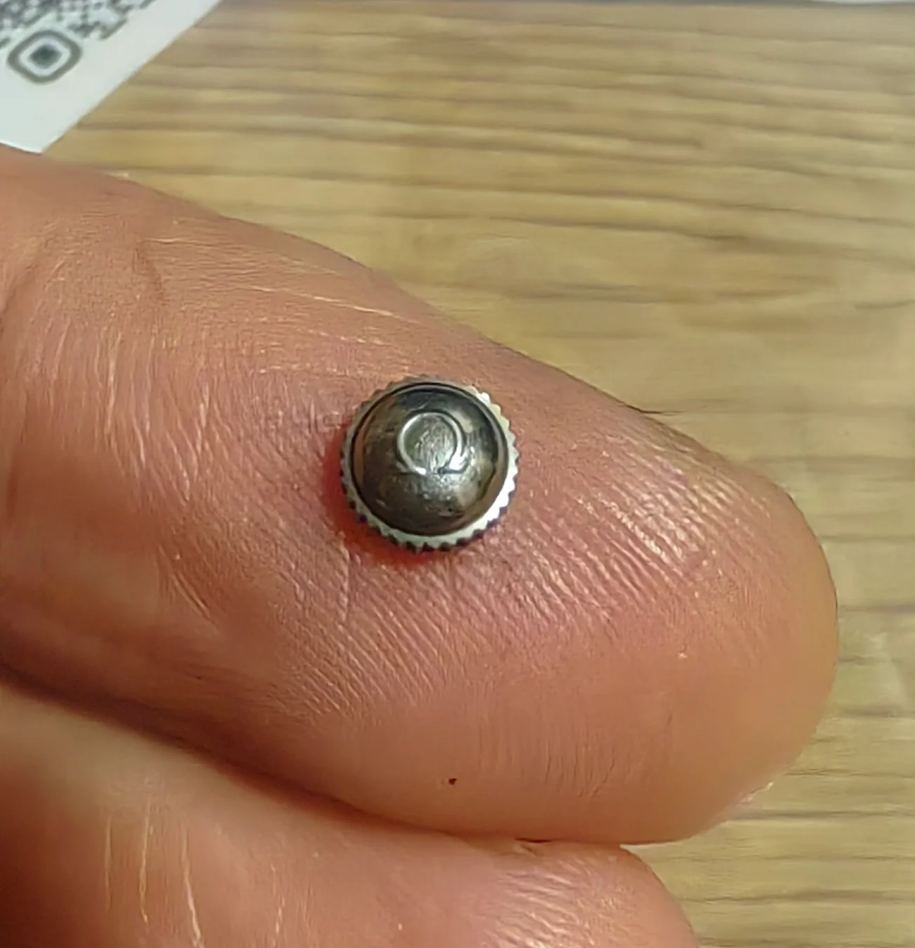

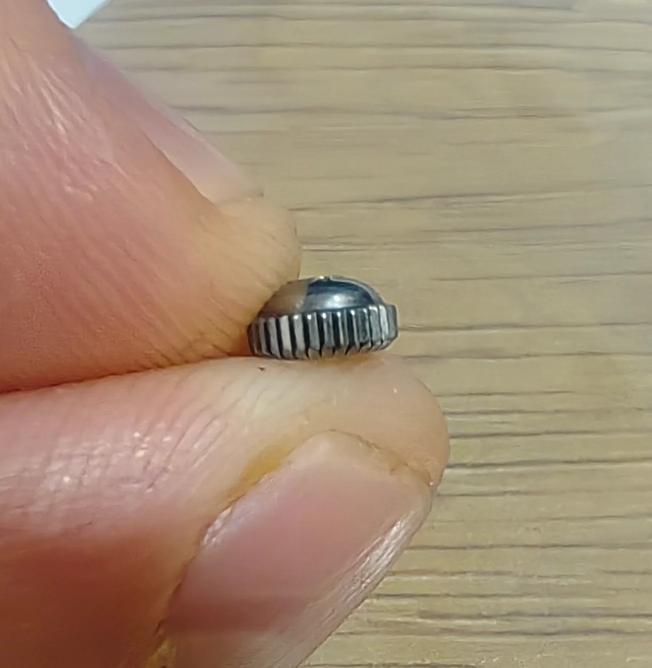

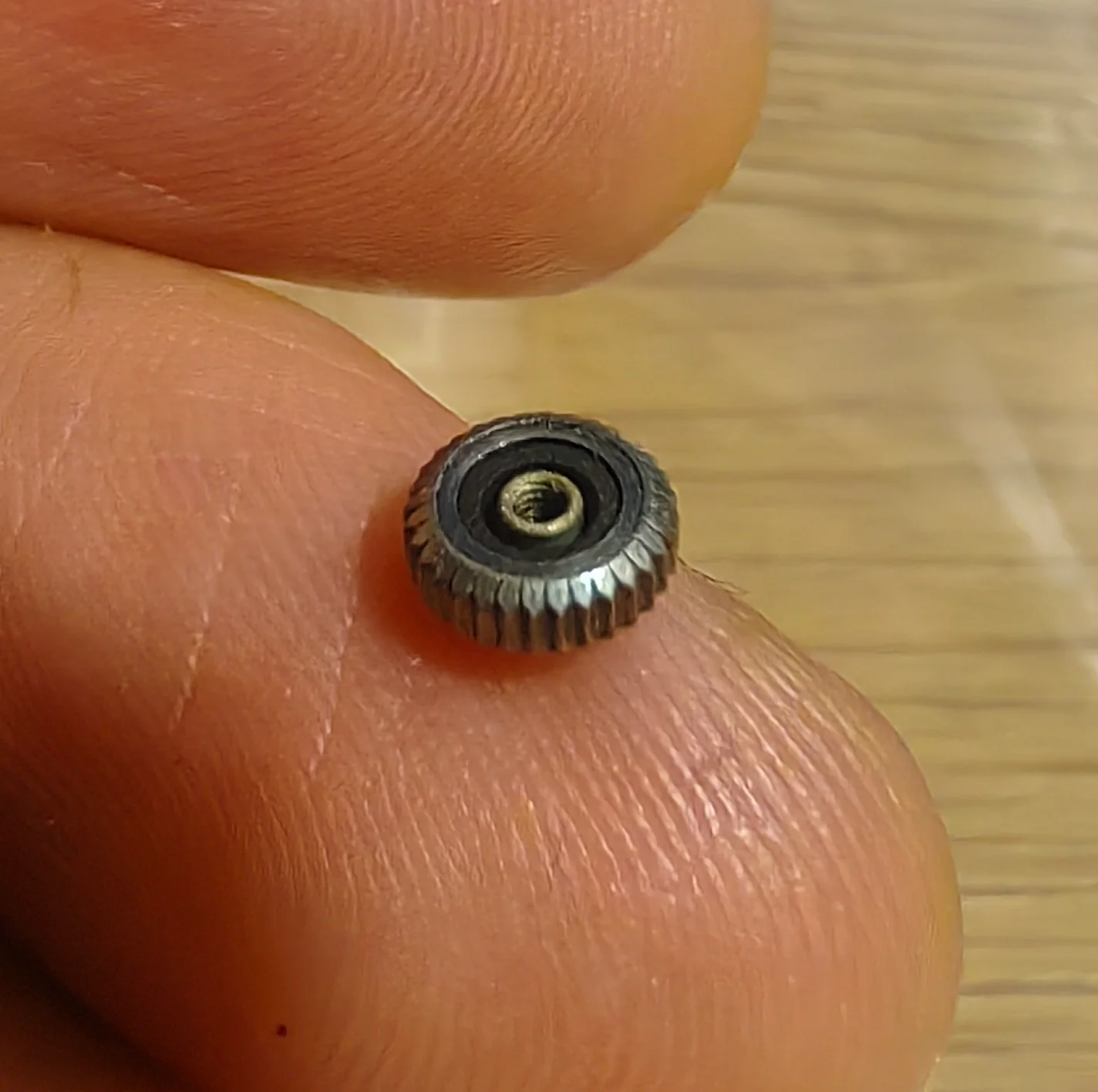

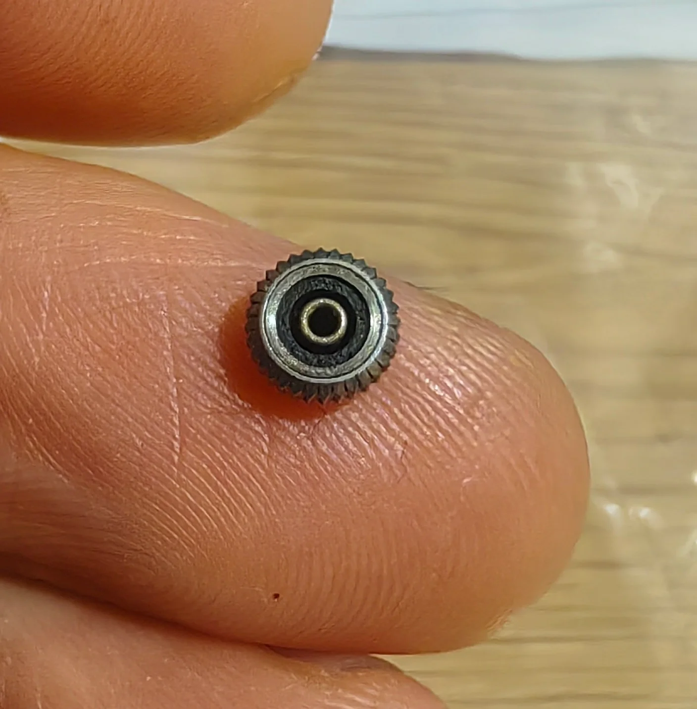

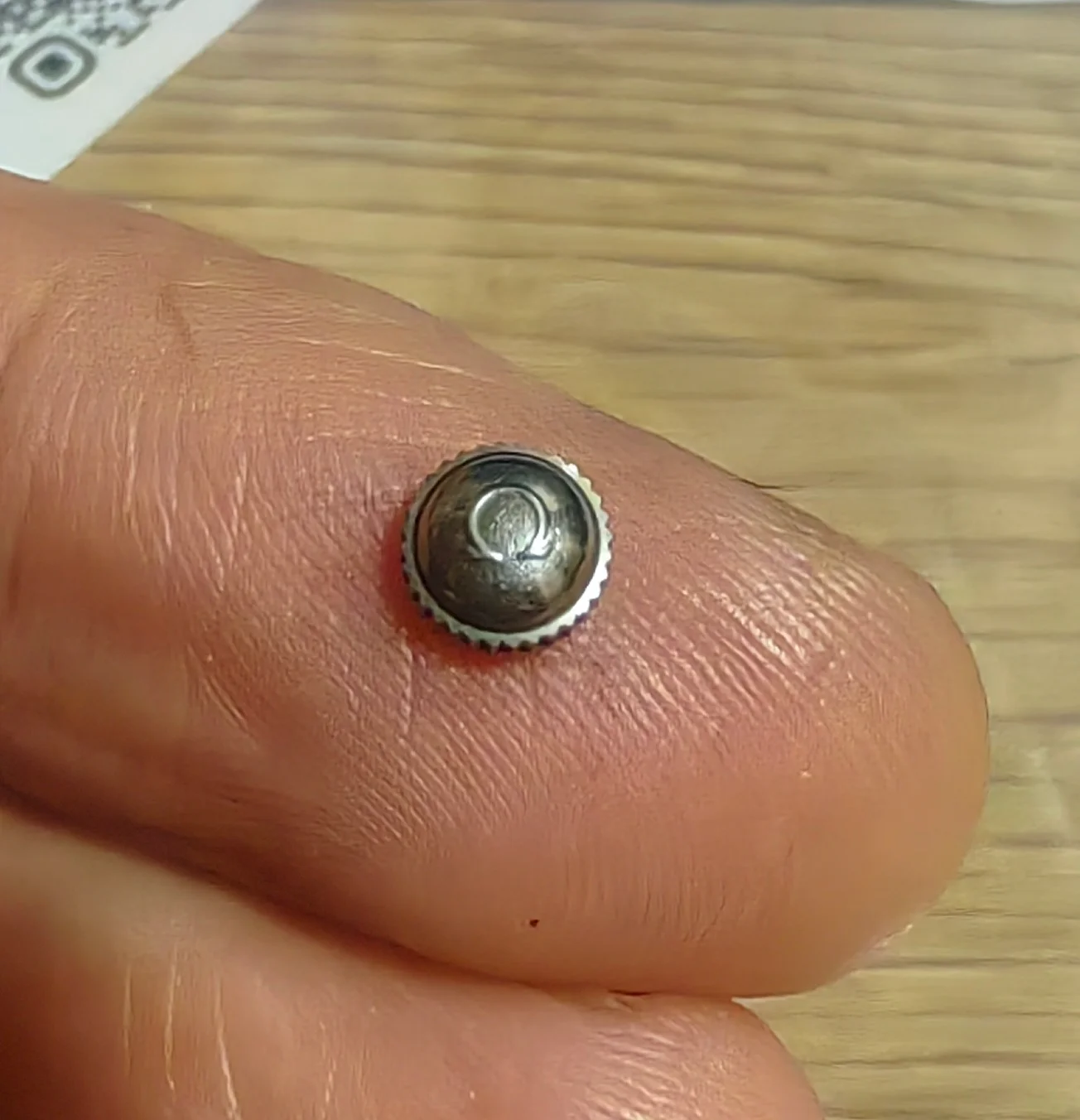

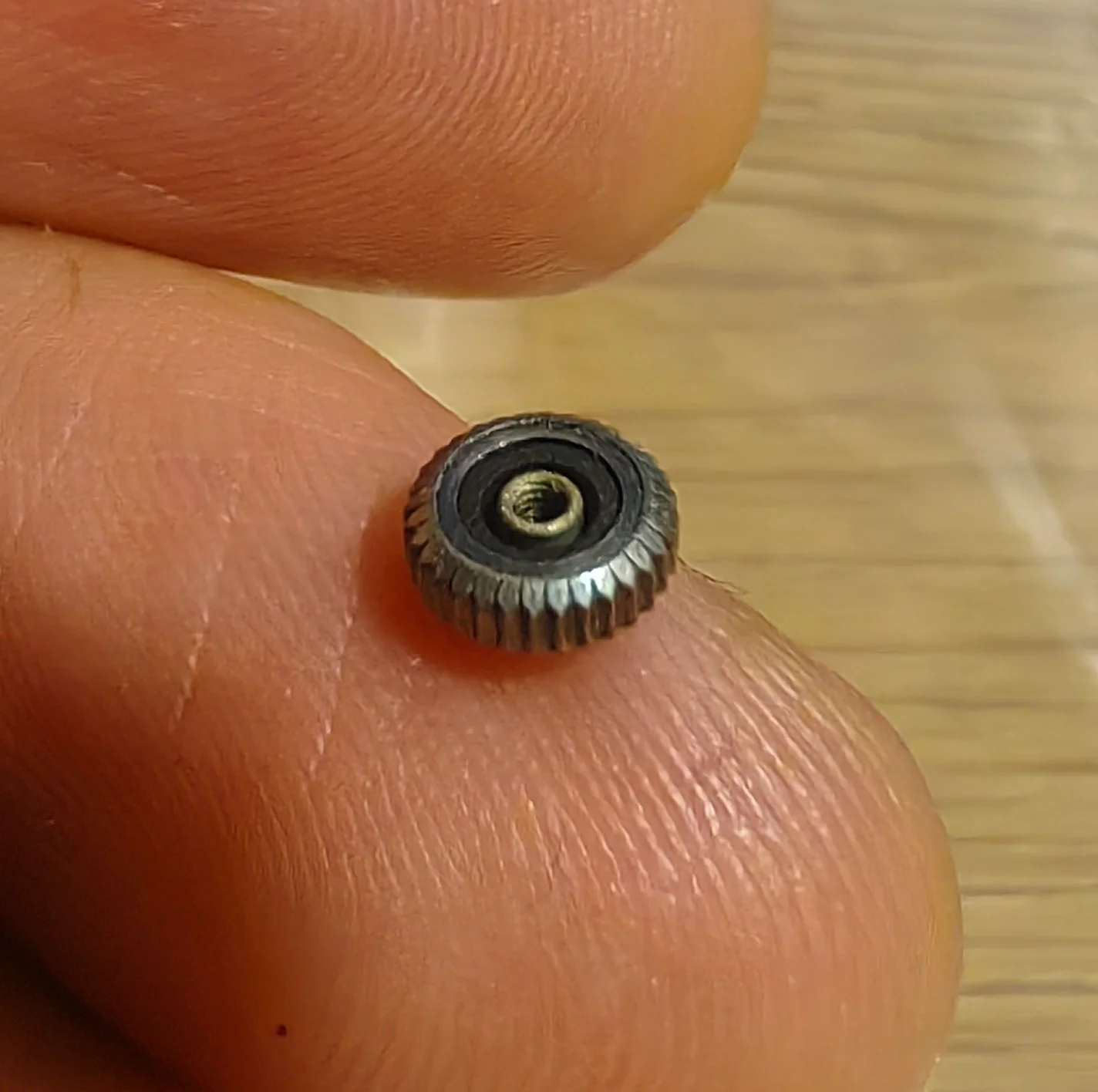

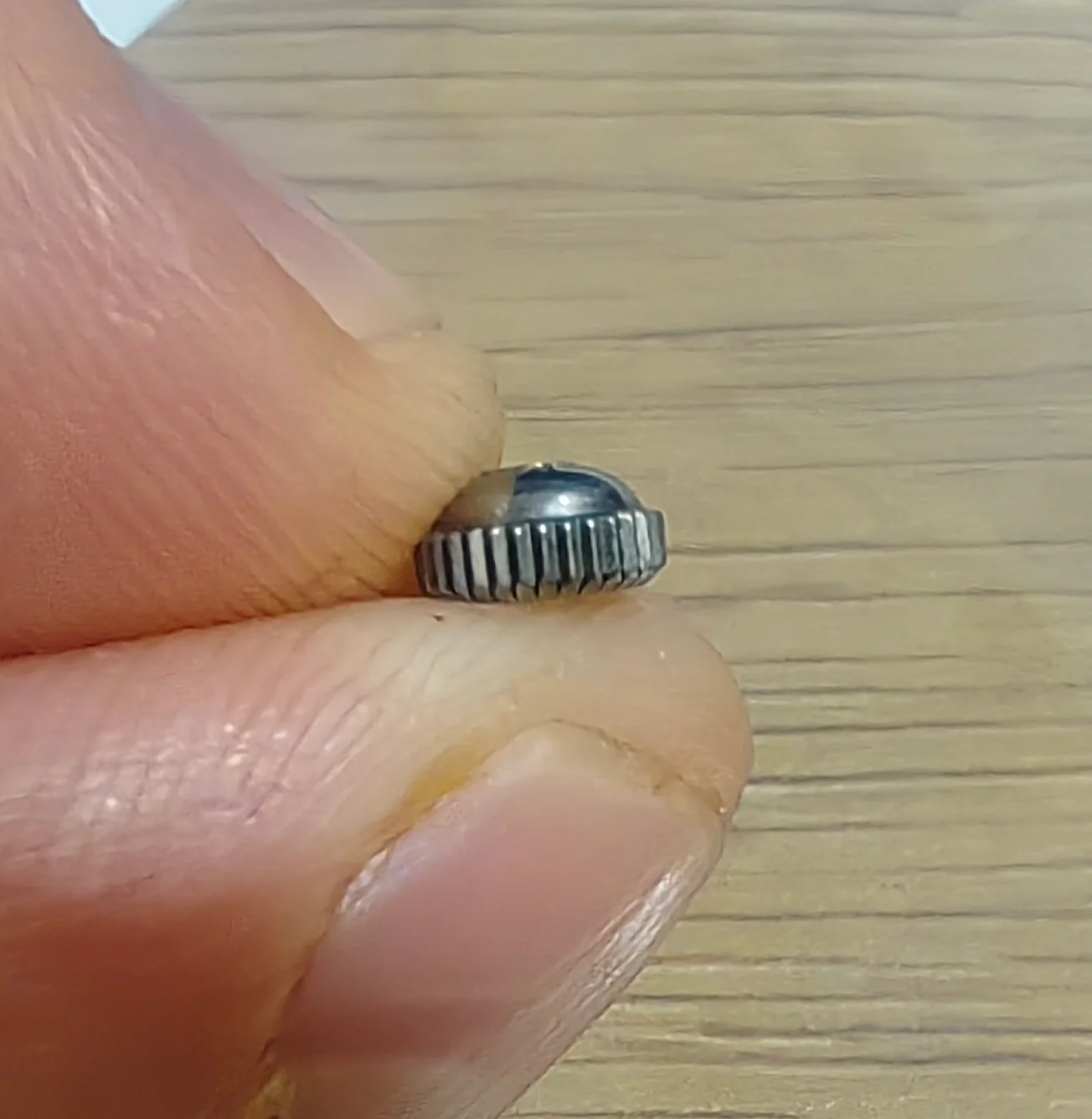

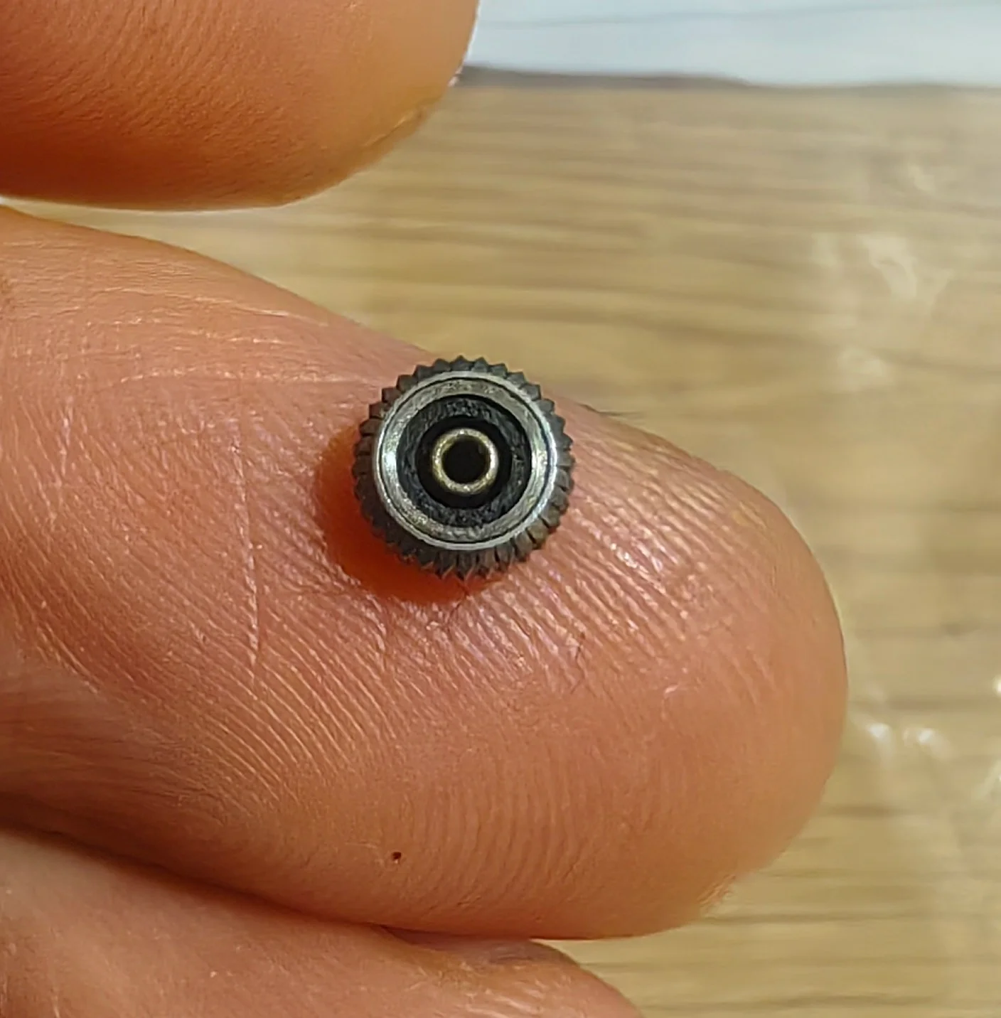

Posts 282 Likes 64 SerP ·Oct 9, 2024 Good evening. Please tell me if I am right in attributing the crown: I believe that this is a crown for Ranchero 2990-1. Dimensions: 5.5x2.9mm, thread for shaft 1.0mm (not 100% sure that this is M1, as I don't have a suitable shaft at hand).. Thank you..
Posts 10,124 Likes 57,937 gbesq ·Oct 9, 2024 I don't have the specs, but the appearance is certainly correct (Bowler hat style).
Posts 282 Likes 64 SerP ·Oct 9, 2024 gbesq I don't have the specs, but the appearance is certainly correct (Bowler hat style). Okay. Thank you..

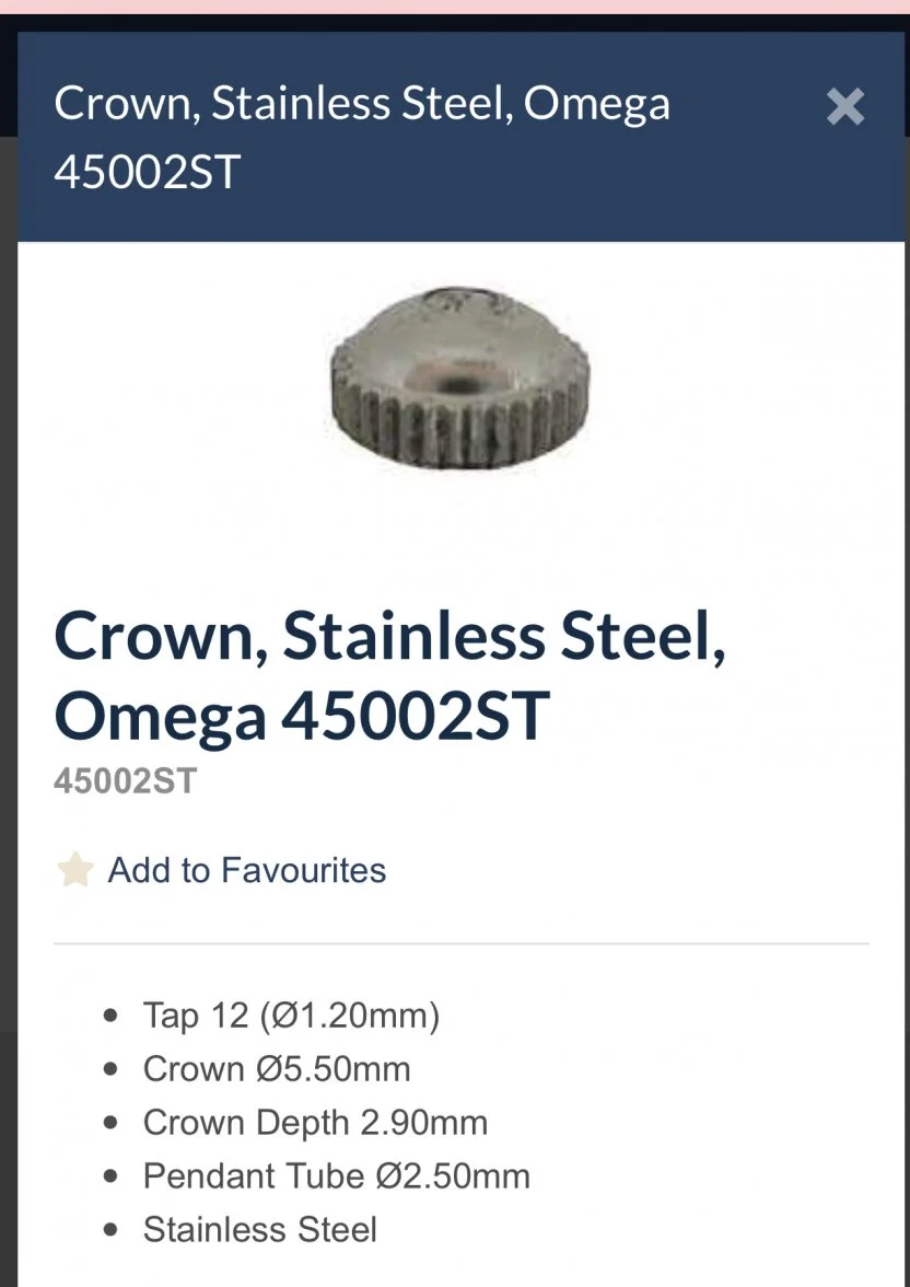

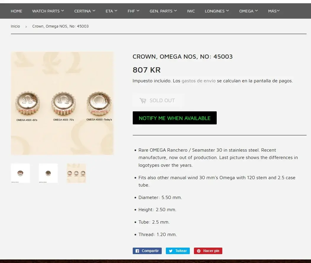

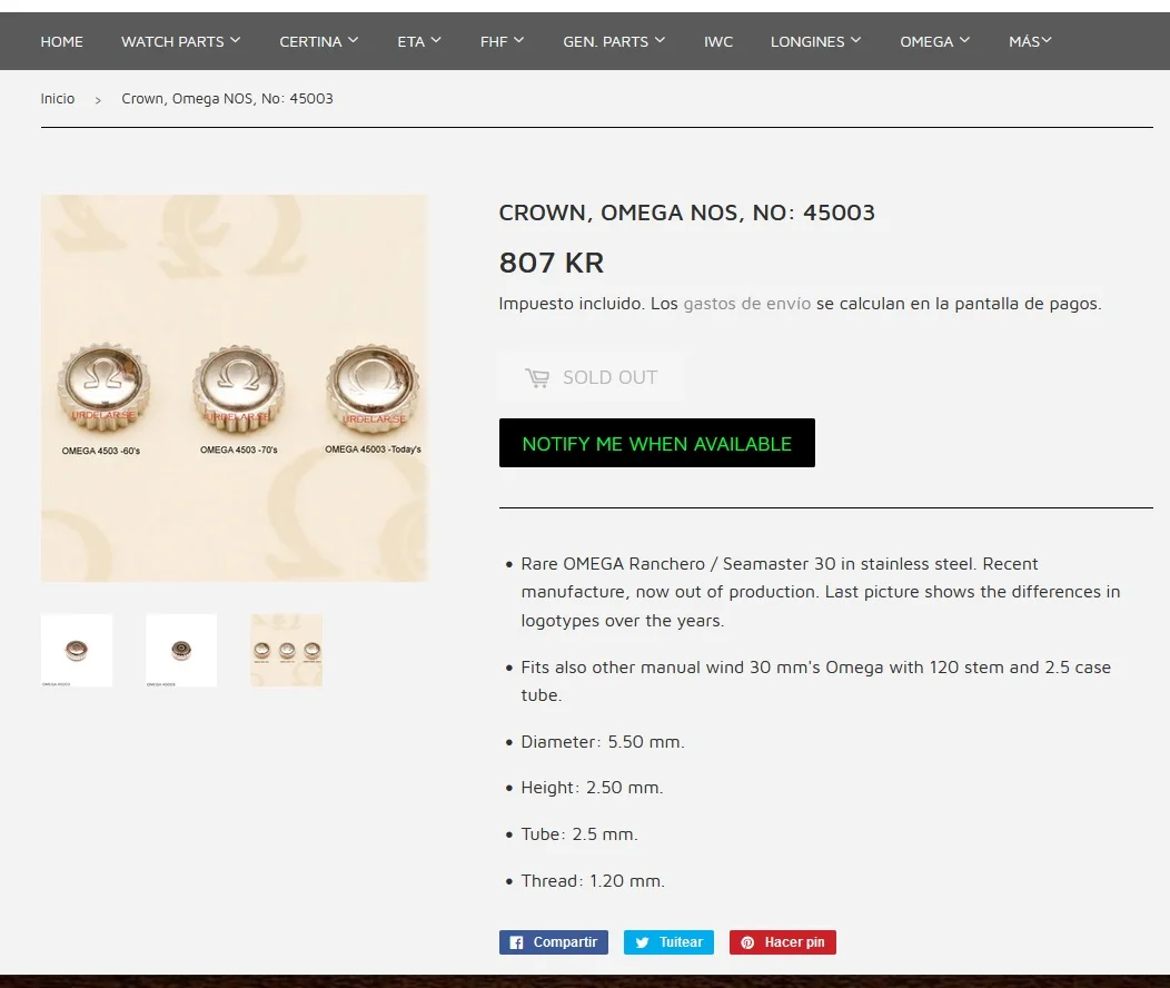

Posts 465 Likes 461 td69 ·Oct 9, 2024 I have this picture on file for a Ranchero crown even though my other note has Ranchero crown (bowler hat style) under reference 45003.

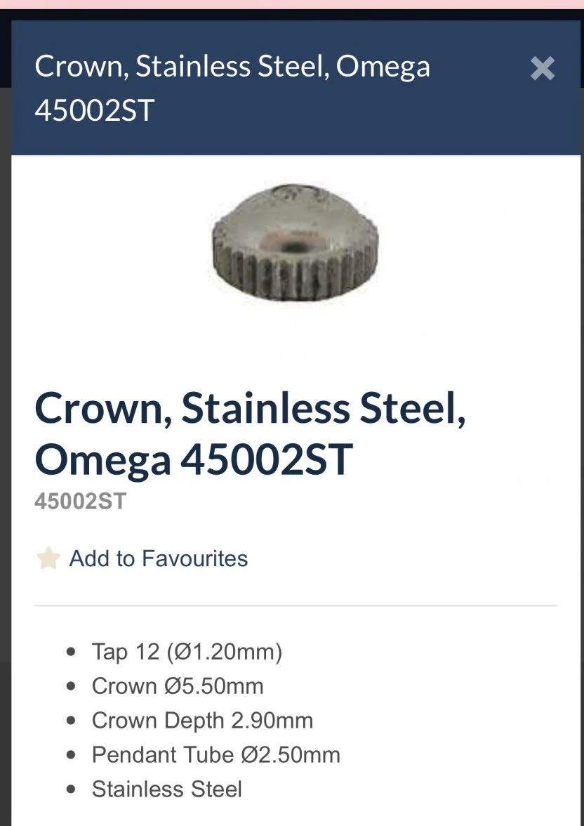

Posts 282 Likes 64 SerP ·Oct 10, 2024 td69 I have this picture on file for a Ranchero crown even though my other note has Ranchero crown (bowler hat style) under reference 45003. Thank you for your answer. 45003 has the same dimensions, but different in shape - it's more flat vs more domed 45002.
