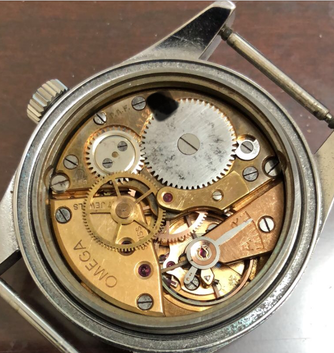

Hi OF, I am the owner of the PAF rm and I suggest Joel to open this thread. I am not even talking with the trade deal now as it is quite obvious now that we will not move on but now I am more interested to understand and confirm what the issue are ( I will.keep it as a beater btw ).. The idea was to answer some questions we had after we discovered the issue above. As a fool, I only rely on white light lume test and visual inspection when I got this watch. As Joel state, dial and hands really behave like old radium / tritium after white light exposure but the UV lamp test and the geiger count clearly show it is not. So can we all agree that the dial and hands were relumed? Or is there any other people having seen some dead radium / tritium behaving like this in the past? (Just asking..).
This is an issue that I have recently dealt with, and it's a thorny one.
I had a chronograph from the late '40s/early '50s, so there was no question about the original lume having been radium. Under UV light, both hands and markers behaved exactly as one would expect from radium, and the decay was also consistent (i.e. very fast). However, using a geiger counter app on a friend's smartphone, it barely moved the needle. There were other watches tested at the time, and some tested strongly, so the counter seemed to be functioning. Oddly, one that was tested by the same brand as my chrono also tested weakly.
As both dials appeared to be original (hard to imagine that they were redials), it occurred to my friend and I that there were undoubtedly different amounts of radium used by different factories, and the formulas were also variable. So, my very unscientific and tiny sample take-away from this experience was that even high-tech detection results may not necessarily be 100% dispositive when it comes to very old radium.
Given that the watch being discussed on this thread is less old, I would be more wary of originality.
Finally, different coloured bridges are an automatic red flag for me.

I have seen this watch 2/3 times in the flesh, and I would have never thought that it had been relumed. I'm like John Snow when it comes to PAF Railmasters, but I know Heuer Bunds a bit and a lot of them are not original anymore because Bund watchmakers replaced often a lot of parts in order to make the watches reliable.
I would say that this watch's value is purely down to the condition of other PAF Rails: is this one worth having, and if so, at what price ?

if you relume with water based tritium and cover the plots after that with dried and re watered black tea residue, you get exactly this result. the whole radium geiger discussion has a place with collectors, but you still get access to radium based medical stuff to mimic the geiger readings. Russia and China still have radium base paste. if you really want to fool anybody, that is the way to go. expensive rolex watch collectors know that. Geiger readings are just one facett in evaluating vintage watches. you have to handle a lot of watches to become more certain, what you are looking at. in this case the different colour movement plates would kill it for me. the chances of tampering are too high. i had many PAF railmasters and we contributed to the evaluations of the factory research regarding the PAF watches with John Diethelm in the 90`s. still, i`d not trade with this Speedmaster , as requested with the OP. only with the much rarer FAP Flightmaster. not the more common PAF examples. kind regards. achim

Thanks Achim, I think we all agree that the trade will not happen. there is very interesting information in this thread and yours are very important. Now, Michael content is also very interesting beacuse i undertand now, that when talking about vintage tool military watch, the common 'standard' we use to have for non military watch are maybe different. But still a rough task to understant what is acceptable and what is not..
