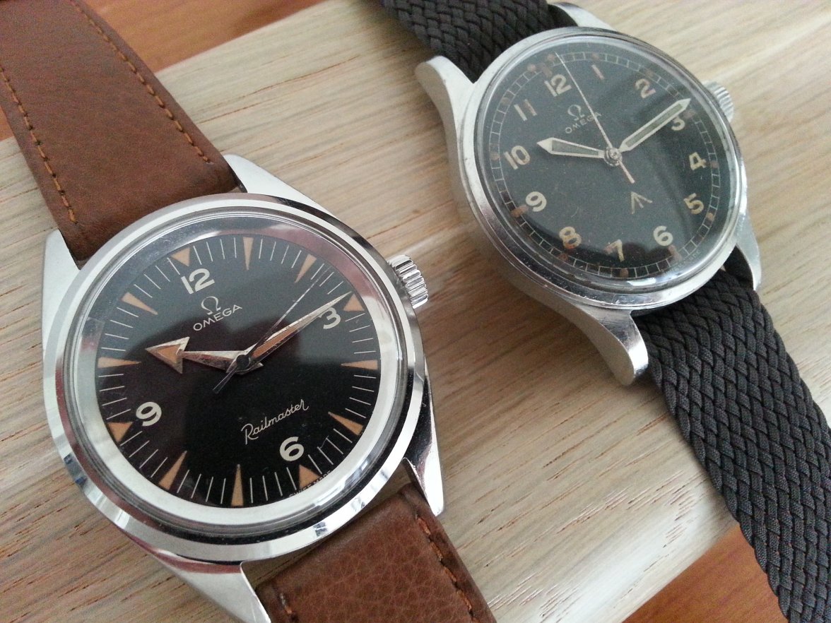

Railmaster 2914-5 PAF -- but.....

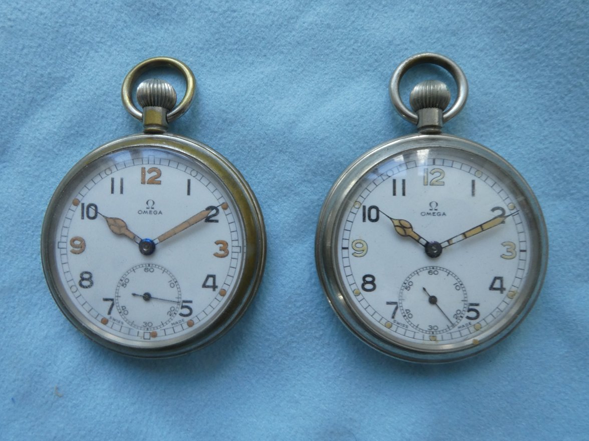

Just regarding the "strength" of the radium the following observation:
I have these two Omega pocketwatches which - to my untrained eye - look more or less the same.
I had them tested at the local university and the one on the left (slightly darker Radium) got a reading of 17 µSv/h whereas the one on the right emits only 4 µSv/h
They both are GSTP and have a F04xxx number (anybody happen to know if that means anything in particular?) and have been in the family since over 50 years. And they haven't been serviced in that period. (I know, there are some dots astray on both and the hour hand of the one on the right lost some radium, but that's not where the difference comes from)
To get to the point: very similar watches, same brand, same size, same age but very different emission of the radium. So I get the impression that a Geiger counter reading doesn't always have to be a sure sign of Radium having been tinkered with.
Please correct me if I'm wrong.

I‘m no expert on lume, but I am ex Military so perhaps I can come at this conundrum from a different angle. Is it possible that one of two things happened here ?
1. The re-lume was, for whatever reason, either a botch job or a quick fix. Was earmarked to be re-lumed properly at a later date and it just never happened.
2. It was mentioned earlier on the thread that military watch servicing wasn’t always done by the most experienced watchmakers. Could it just be a simple case of a qualified, yet inexperienced watchmaker applying the wrong compound ?
Having done my time and seeing enough low tech repairs on high tech equipment, it wouldn’t actually surprise me.
Well to my untrained eye, the one on the left has had lume liberally added to the hands and dial, as evidenced by the fact it is covering the cathedral hand section partitions and if so would naturally have higher emissions if this was done with more radium paint.
206
163
Well looking with a 16x loupe the thickness seems the same. Its mainly the color that differs, but anyhow a factor >4 just because of a slight difference in thickness?
9,936
15,606
The metalwork on the LHS one is covered in lume, the one on the right isn't. Doesn't that suggest to you that lume has been added? I am not suggesting recently, this was likely done in period but it sure looks that way to me. These do indeed look like GSTP watches, which were presumably regularly serviced by MOS or WO personnel without too much consideration for aesthetics, more for practicality and function. Yes I can fully believe that a good coating of radium paint will give a much higher reading that the original skim. How do they behave under UV? That may be instructive bearing in mind the main topic here about older radium vs tritium on the OP RM.
2,052
5,991
i am thinking that hands on the left are mounted on the wrong face...
9,936
15,606
Wrong way round you mean? Yes I Hadn't thought of that.

This is the closest I've ever come to owning a PAF 2914 (dial sold long ago before anyone asks) I didn't own a Geiger counter or UV light at the time unfortunately.
572
2,588
My understanding (including watches I've measured myself) is that a radium dial should measure at least 2000 cpm. This is obviously not in the ball park. It is further my understanding that all Railmasters - including PAF's - up to 135.004 should be radium (despite the fact that other contemporary watches - like Speedmasters - were already transitioning to tritium). So, looks like this dial has been relumed.
FWIW @oddboy, I found a recent geiger resultat of my 2914-3 to compare with. Maybe not the highest radium resultat outthere but still well into the "danger" zone. And even if the PAF dials were made in another batch, it would be very strange with such a big difference in radiation. BTW: the 2914-5 PAF's were produced in 1960, so that would still be the normal radium periode for Omega for all the masters, also the early 2998s produced in 1960. The transition was a couple of years later.
Just to completely rule out the use of tritium from the factory on the OP PAF ... unless PAF ordered them with tritium 🤔 Properly not, but maybe they were/became aware of the radium problems, just like the RAF with the 2777 FA vs TA. And just like the RAF they changed the lume themselves inhouse (well RAF also repainted the dial)...perhaps not to a very high standard, but still? And we do consider the 2777-1 FA a legit version, don't we?
The dial does look affected by radium burns, but then again these dials are made of iron and it could also just be some oxidation marks.
Random thoughts over
And a wristshot to keep your lust for one burning. They really are great watches. And funny enough, I sold my 105.002 to make room for this one ...and still haven't regretted it for a minute 😉

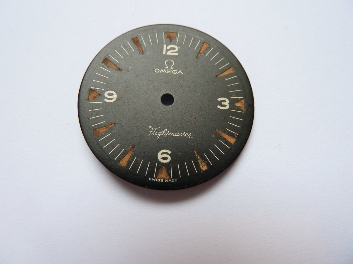

Hey Ash. Aren't the Flightmaster dials only FAP issue??
I thought the PAF had Seamaster dials?

Michael, that is a FAP/Peru. Not PAF/Pakistan. kind regards. achim
I think you mean Ash?
The Flightmaster dial was never mine, wish it was though.
Cheers, Michael
5,410
9,250
oh oh..... getting old..... yes, dash 1 dial. i still have my FAP Flightmaster . kind regards. achim
